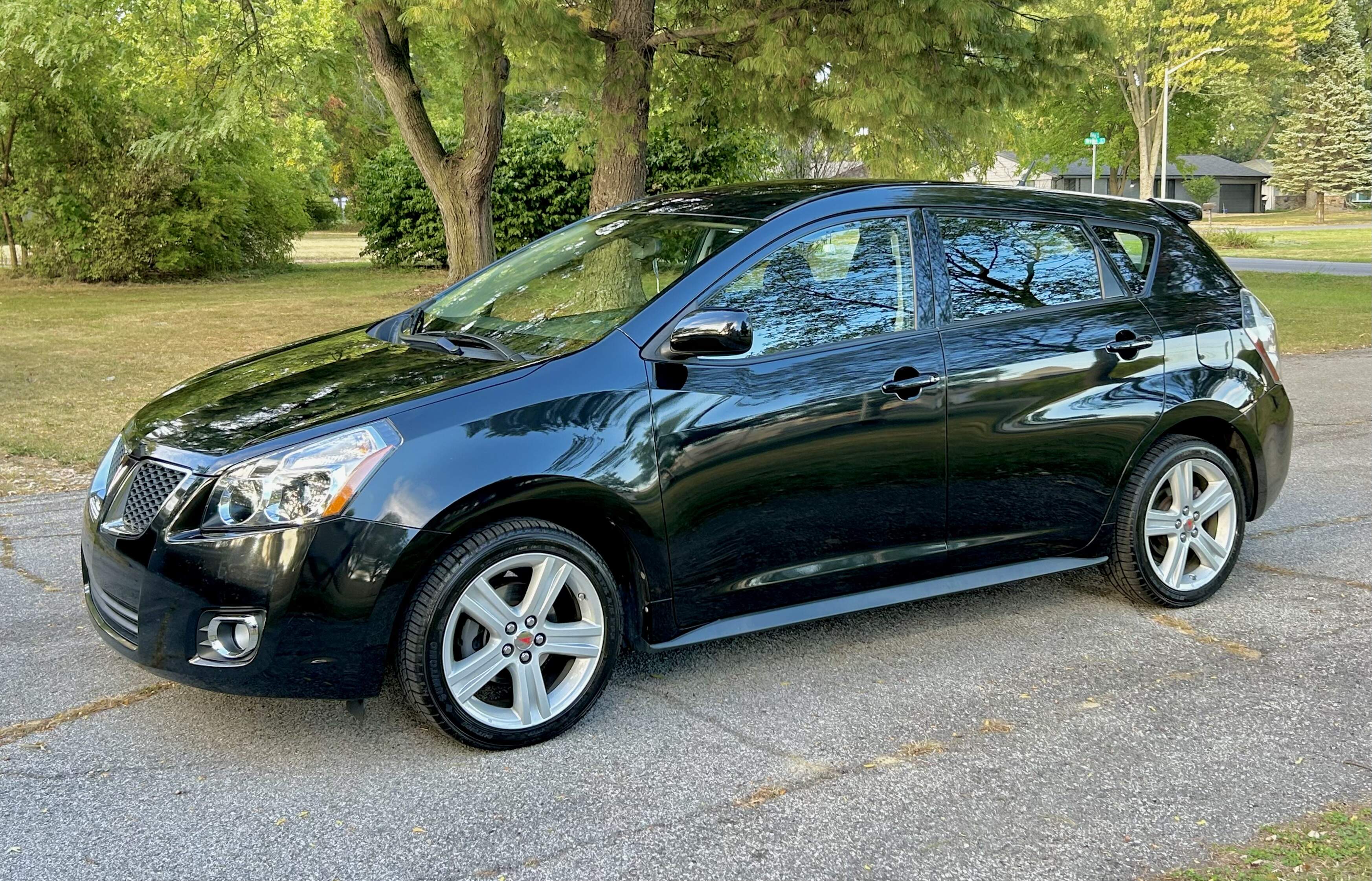

I spent five hours today washing and waxing the Vibe. Had to get some glamour shots afterwards..

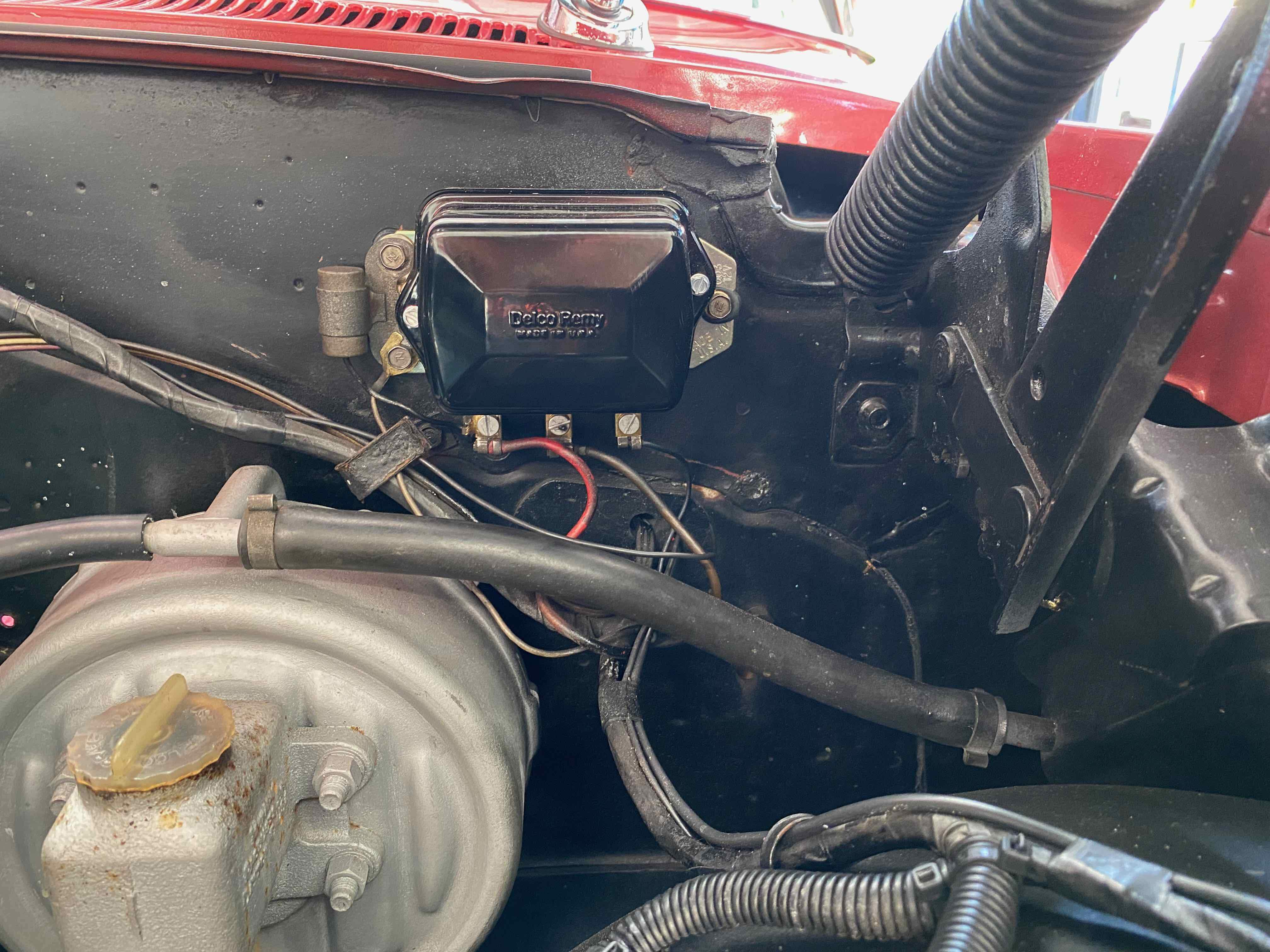

The Voltage Regulator is  Adjustable....(designed that way)
Does your car have the standard voltage regulator or the transistor type regulator...Could be either one...Both types can be adjusted...
Photo of regulator...???

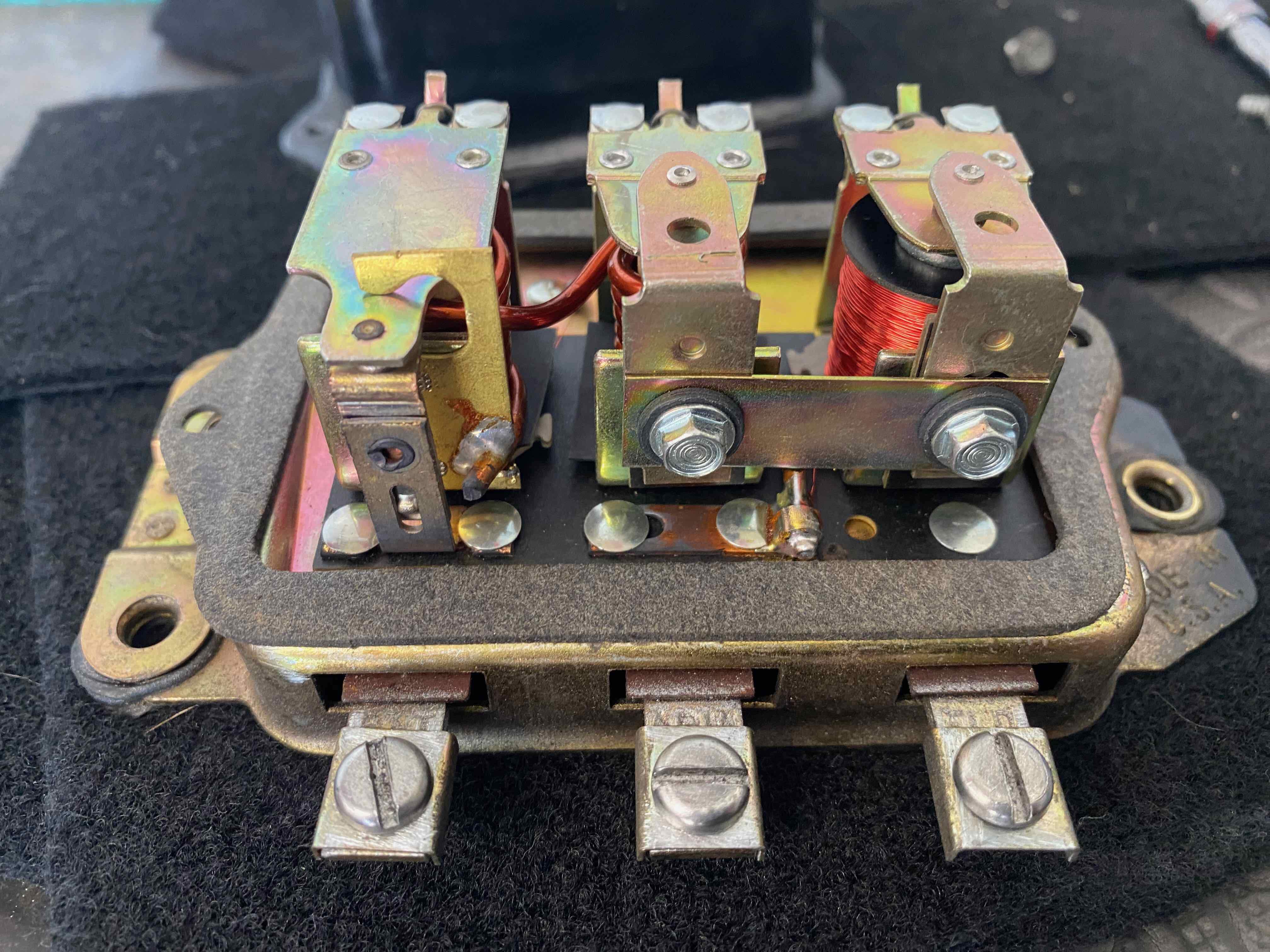

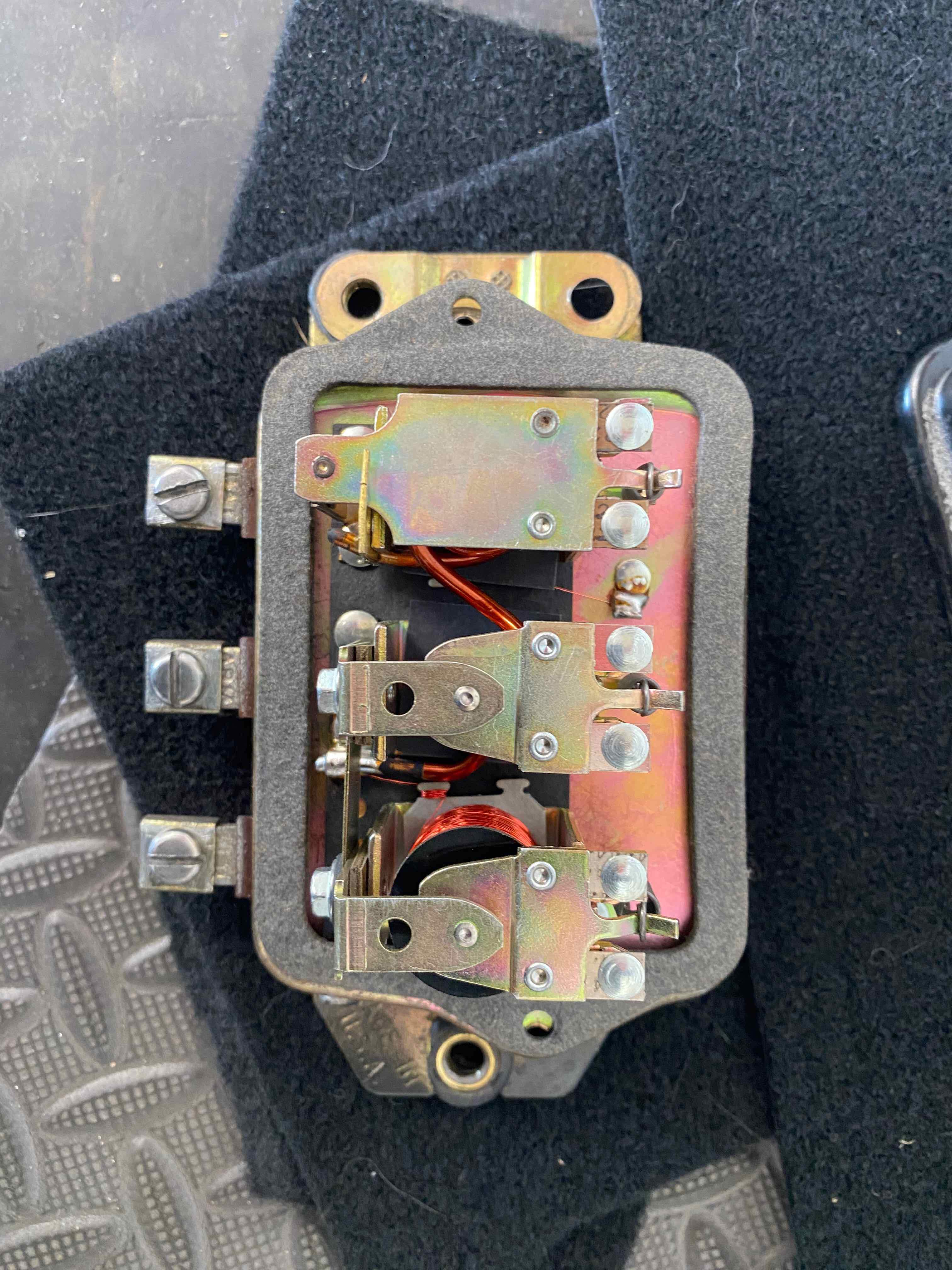

Hi there,
Yes it is a standard style regulator - part number D618.
Photo attached.
Yes your voltage regulator is definitely adjustable...Kind of pressed for time at the moment...(have a dinner date with a real girl).. Will post up the adjustment Parameters/ Procedure within the next 24 hrs.... If you're interested...

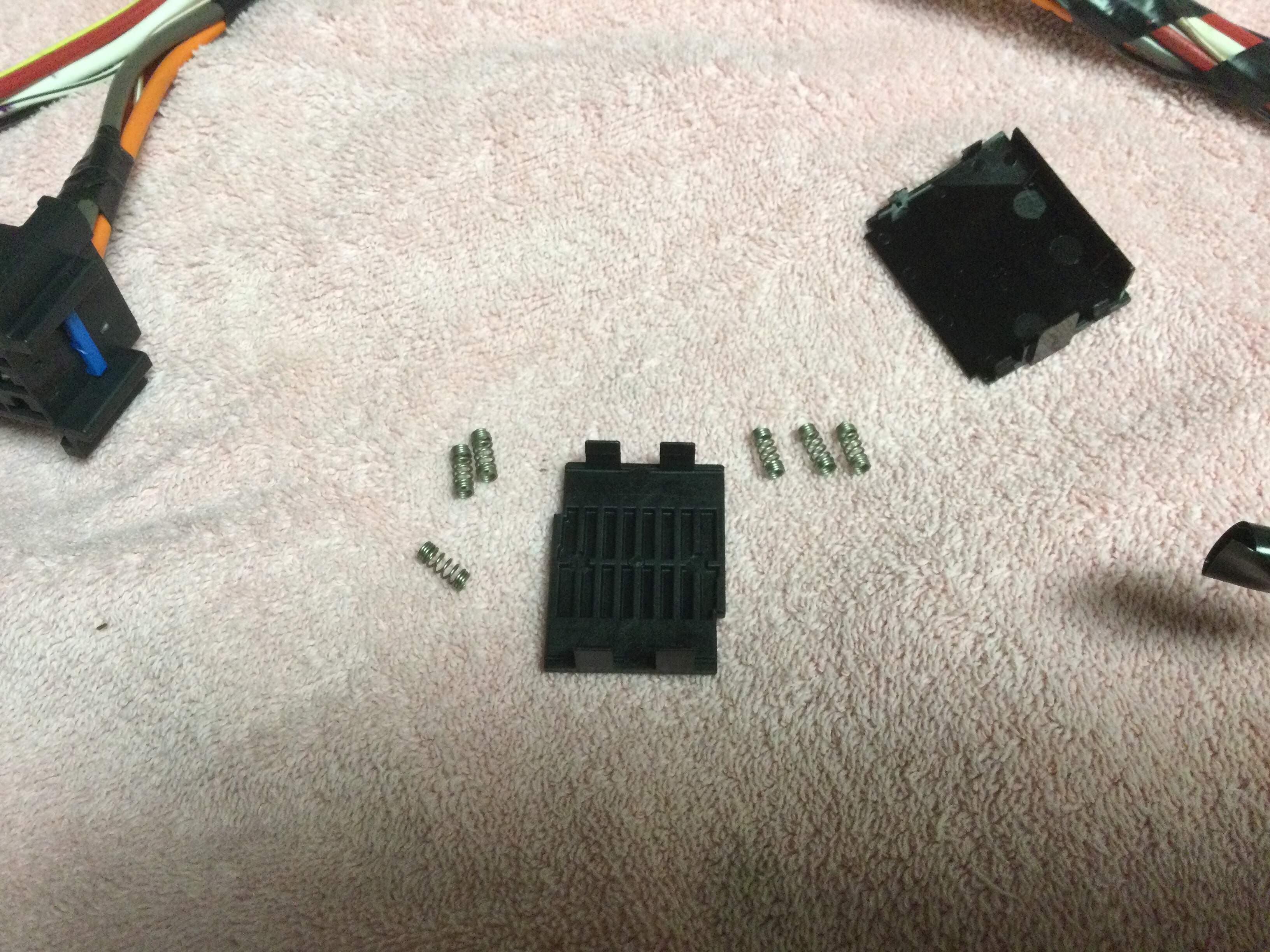

Finished the ignition harness a week an a half ago! Talk about ridicules! Needed to order a new Odyssey battery. Mine’s 8 years old, so might as well bite the bullet & start fresh. Lots of cleanup from the coolant flushing, some aluminum needed re-polished, so needed to pull most of it out make it all shiny again. Hopefully I get the battery this week so I can get a little drive time in before the Indian goes up for winter. Did I say WINTER😳!? Oh crap! That means all the indoor projects start! :willy_nilly:

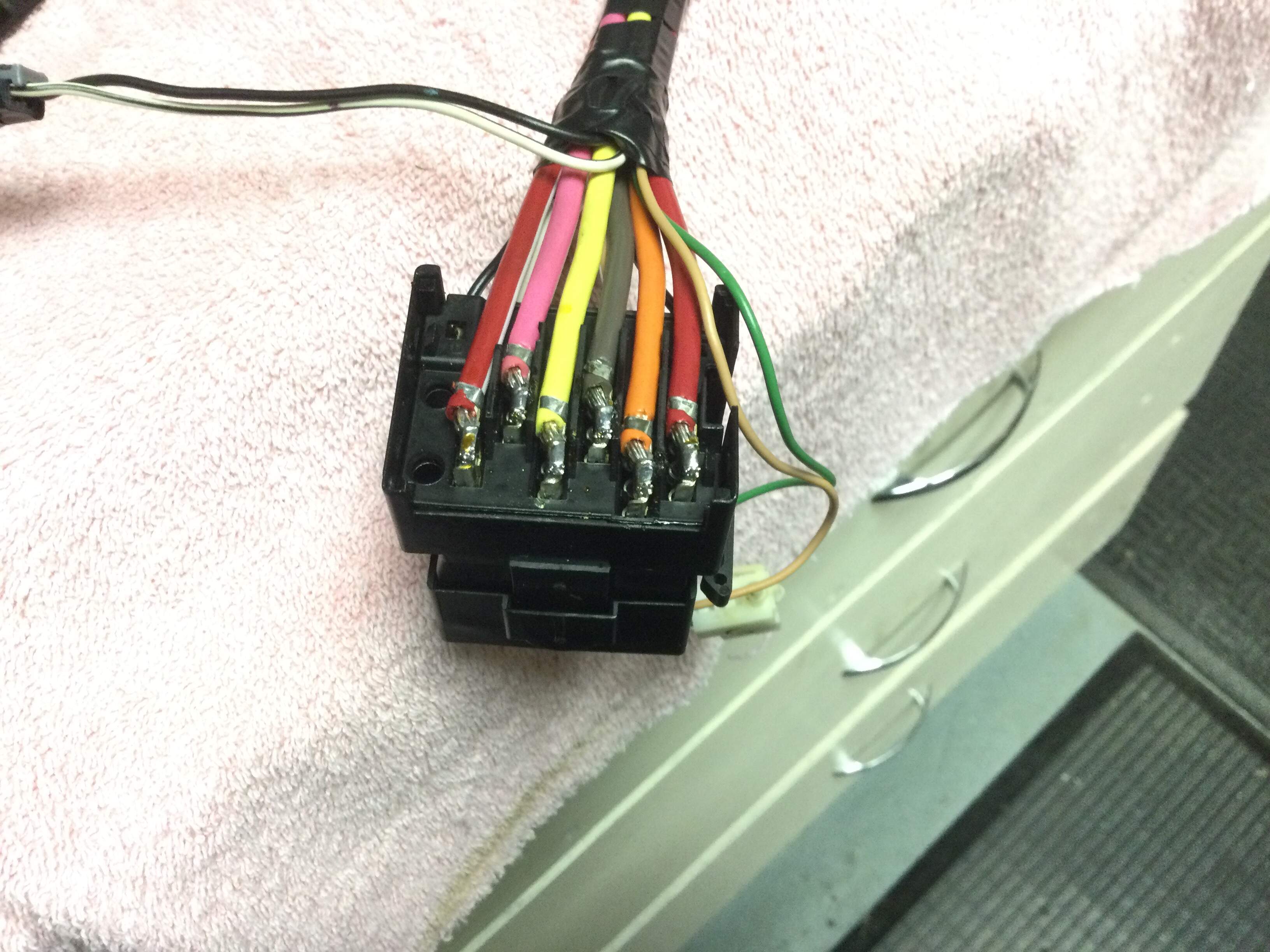

So here’s the switch setup. I stand corrected there are six hot wires one in, 5 out. Those distributed out from the switch to various components. The real dumb part of the switch that I didn’t take a picture of is the inside rotating cam that depresses the springs you see in the one picture. Which moves a finger tab to make contact with another fixed opposing tab! What happened to just supplying 12 volts to a fuse box? So when you turn on that component there’s power at the source you turned on?!
All purty again!
below the double wire loom on the far side of the motor was original one single bundle. Which was to bulky to run between the valve cover & the redesigned engine mount. So I tandemed the single bundle into two, but specific wires had to be placed in the proper bundles since some would go in one direction & others in another direction. Likewise all the wire looms that run parallel to the core support needed divided & redirected downward as some looped up in the air, as is obvious in the last picture. This all took a lot of work because most of these wire runs are actually formed with a particular curve. Which in most cases means not all wire lengths were equal.
JustA side note. What most folks don’t realize, unless you own one & look close, is all the work involved in the rewiring that had to be done to change over to my redesigned engine mounts & valve covers.

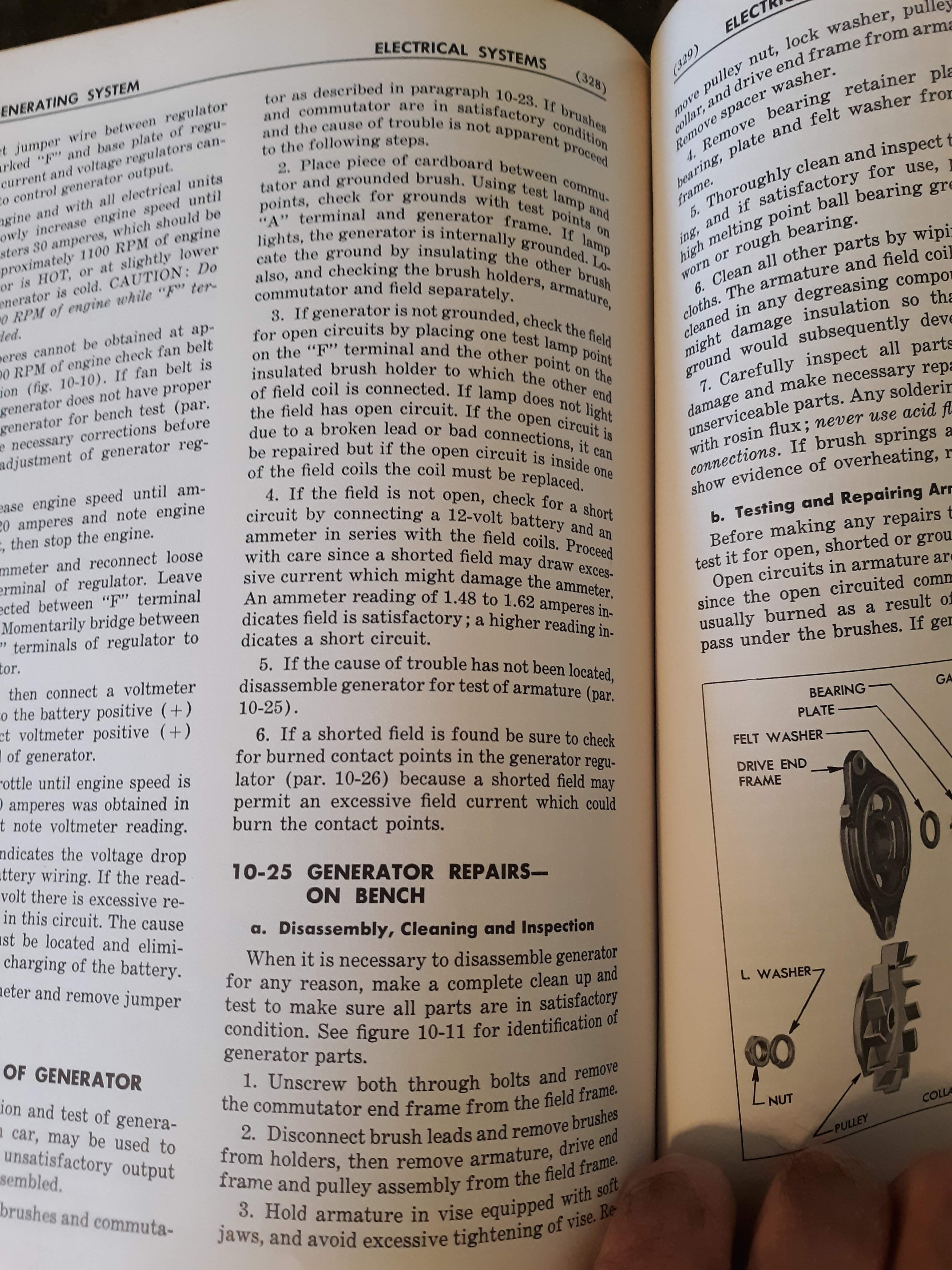

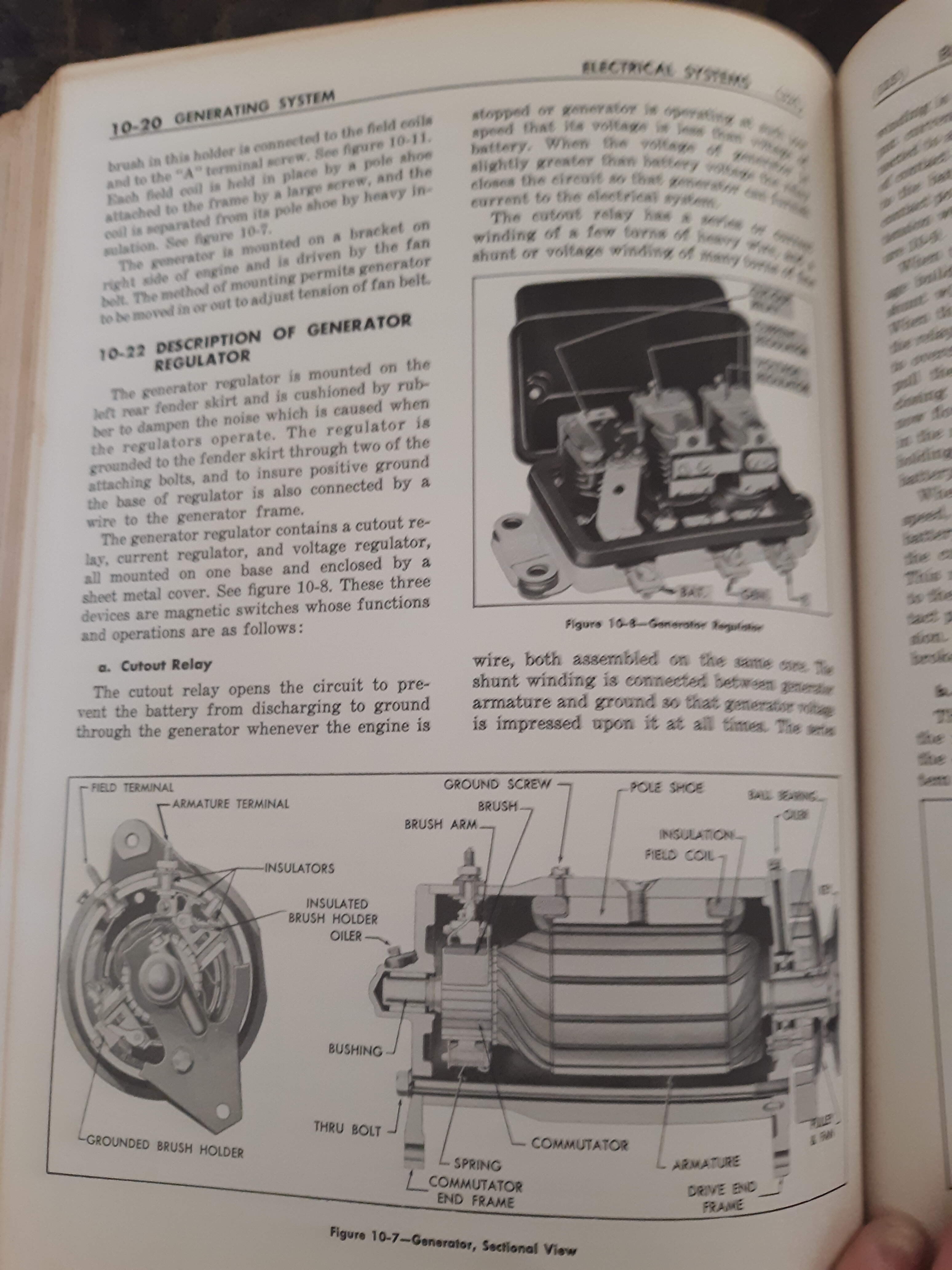

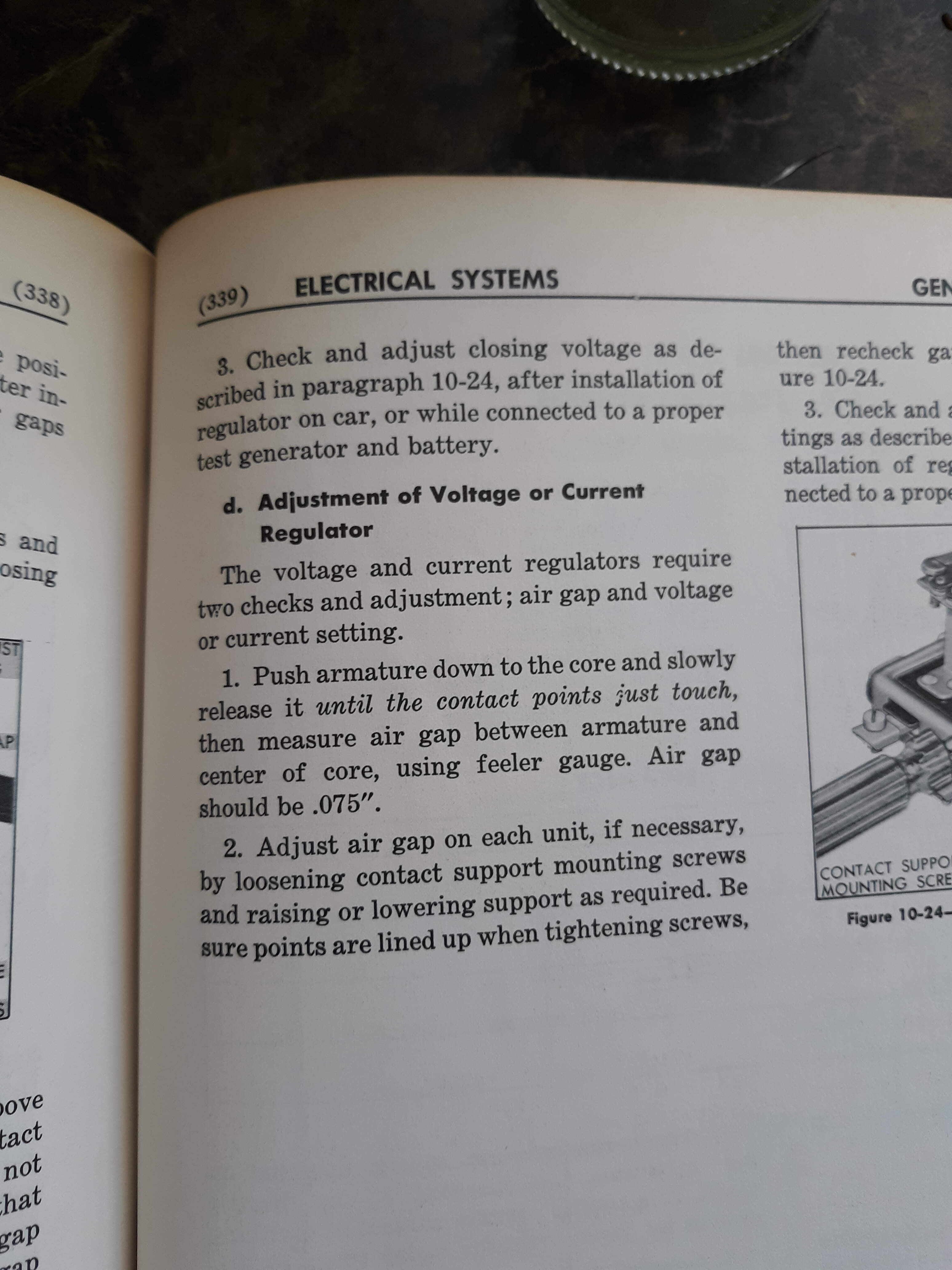

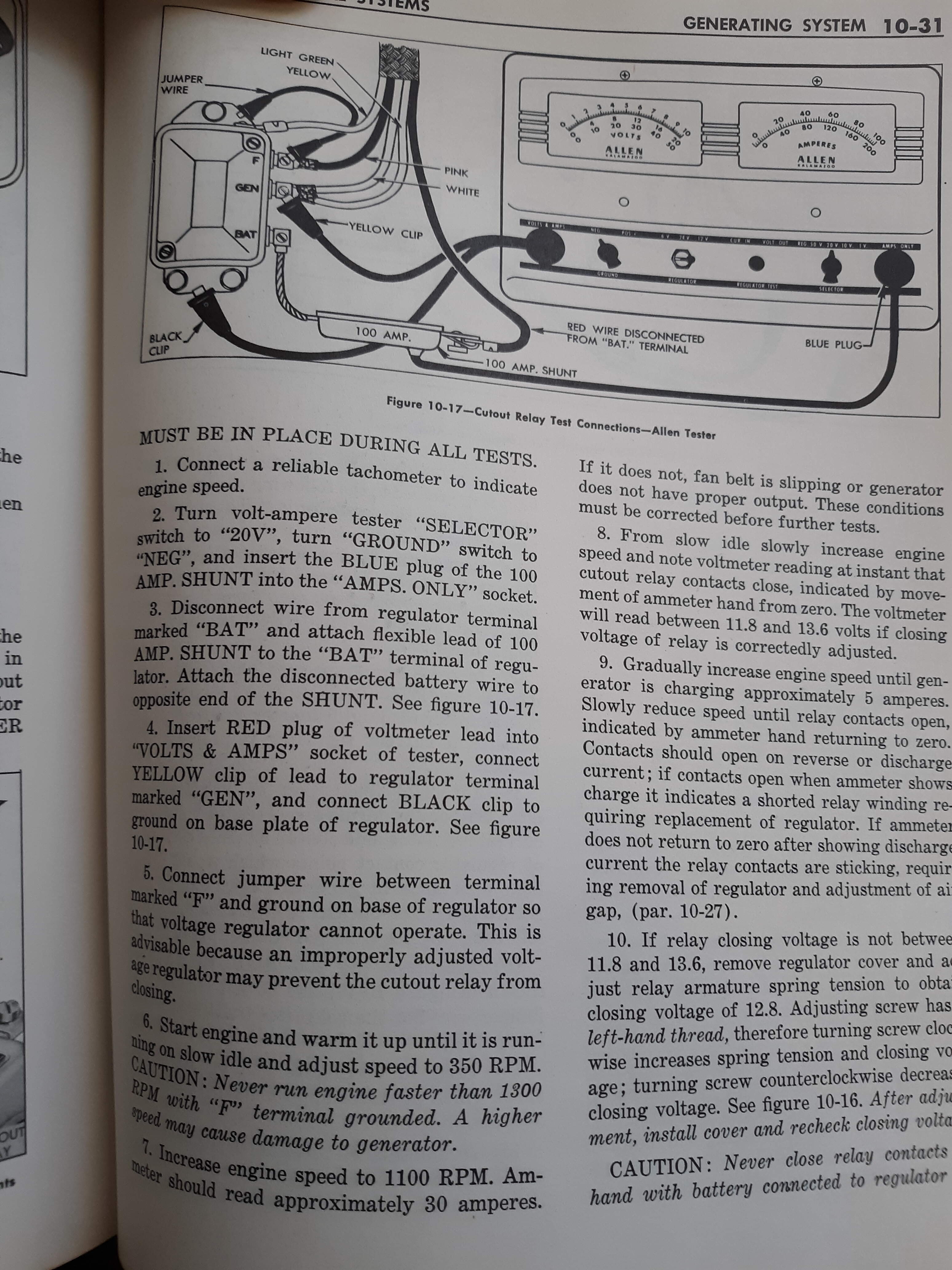

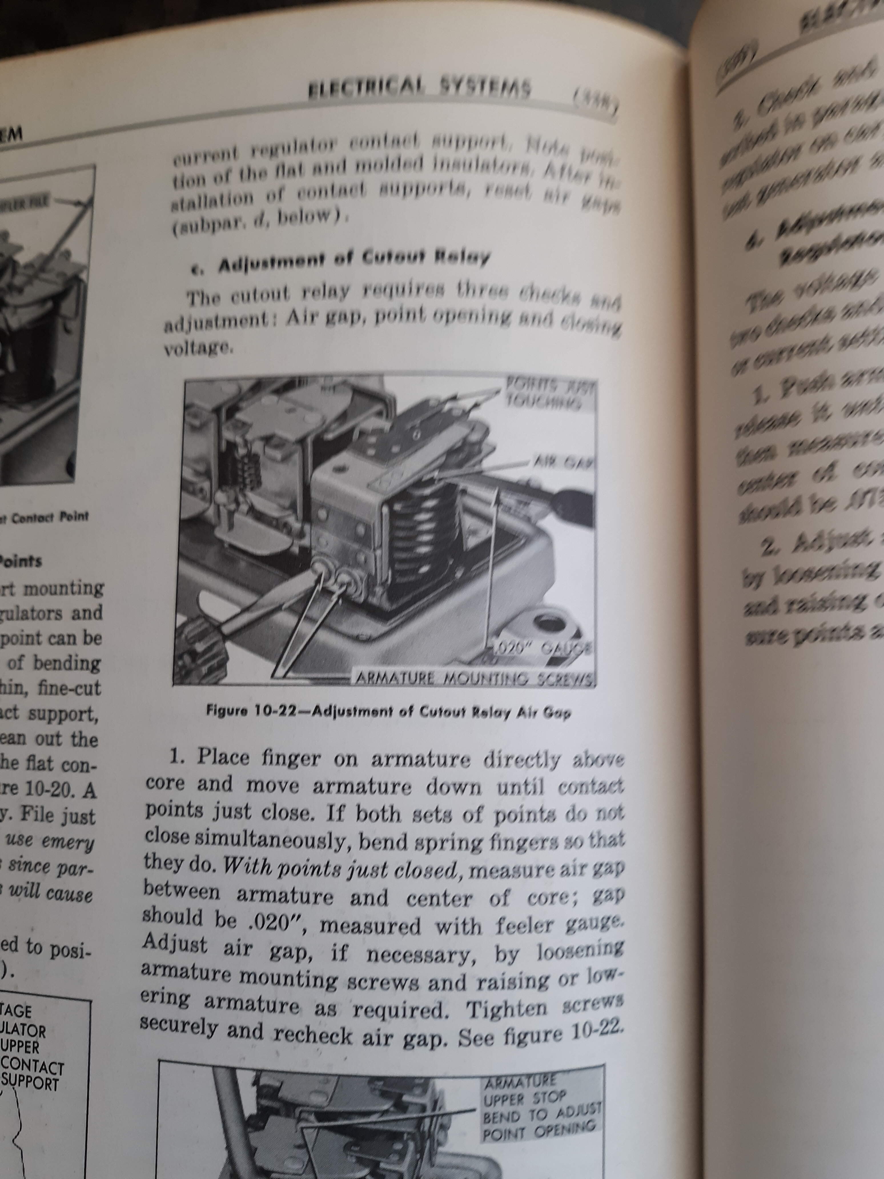

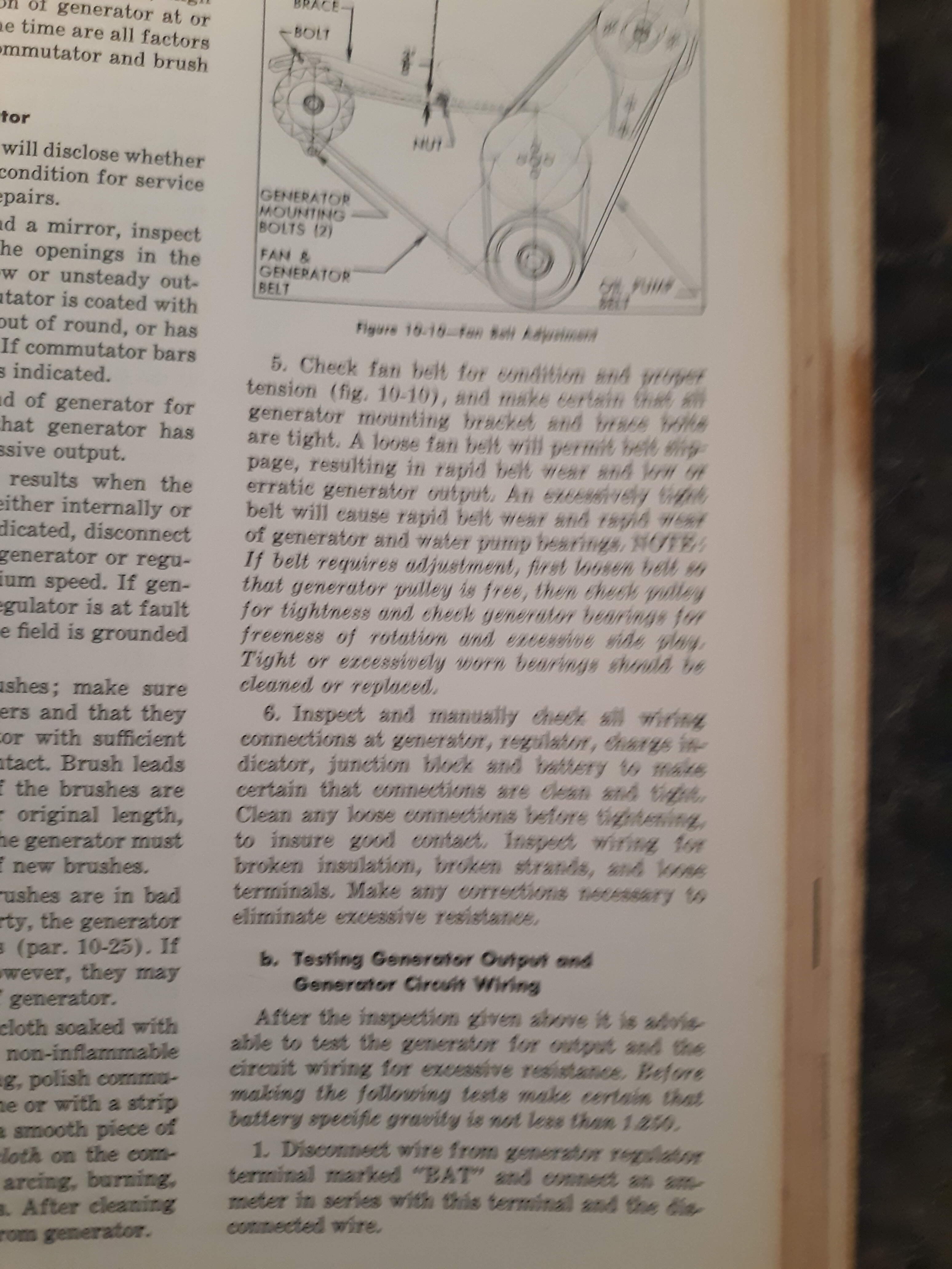

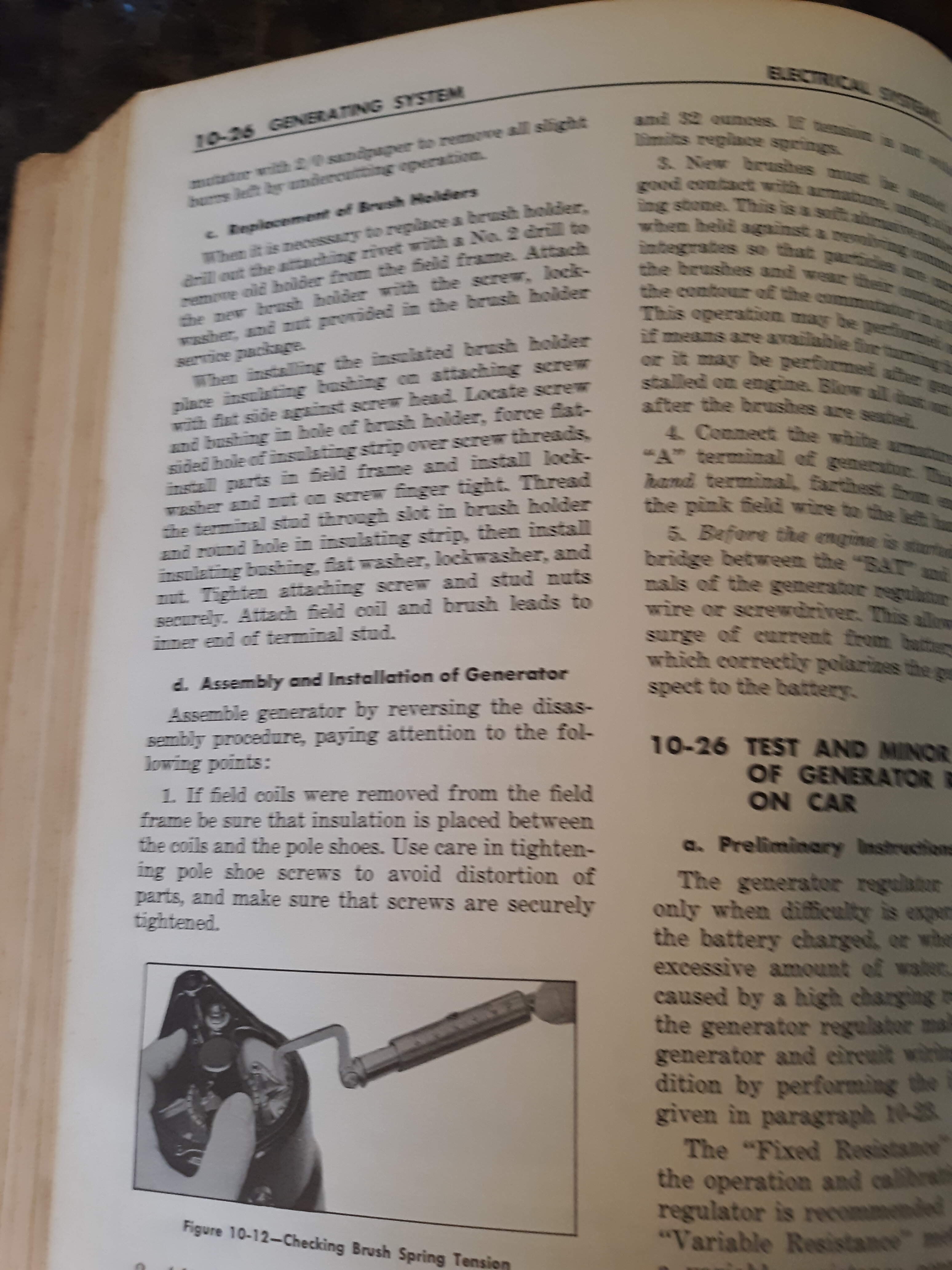

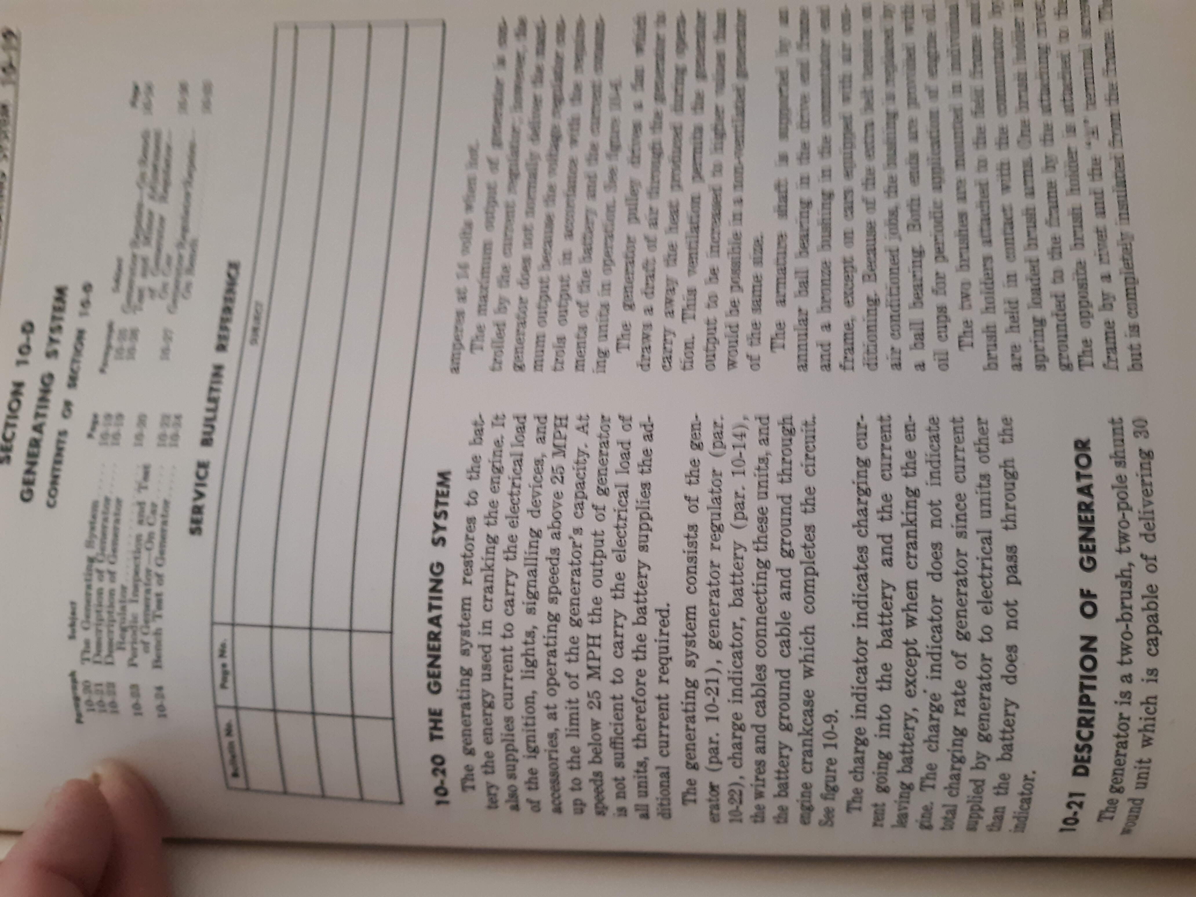

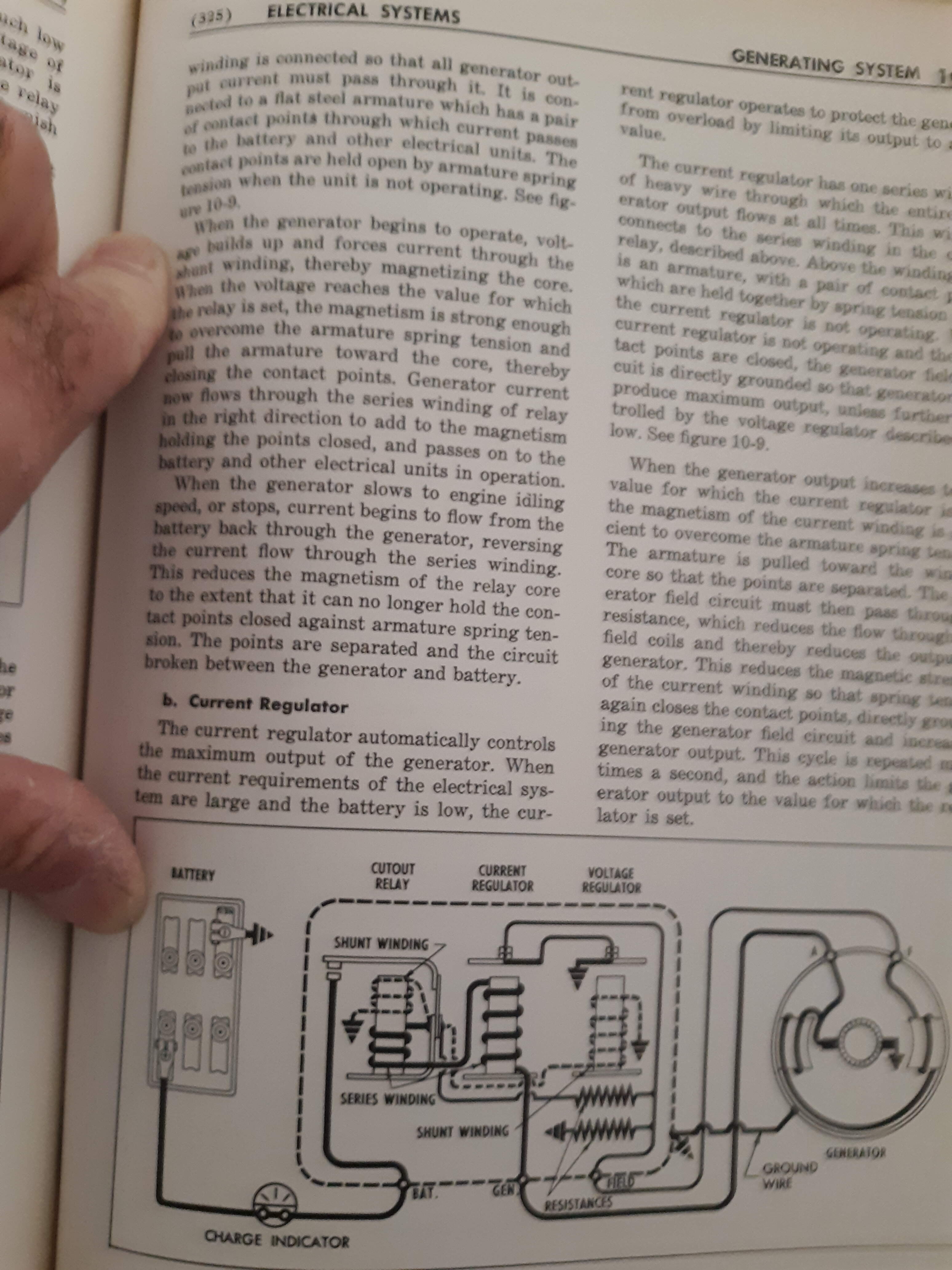

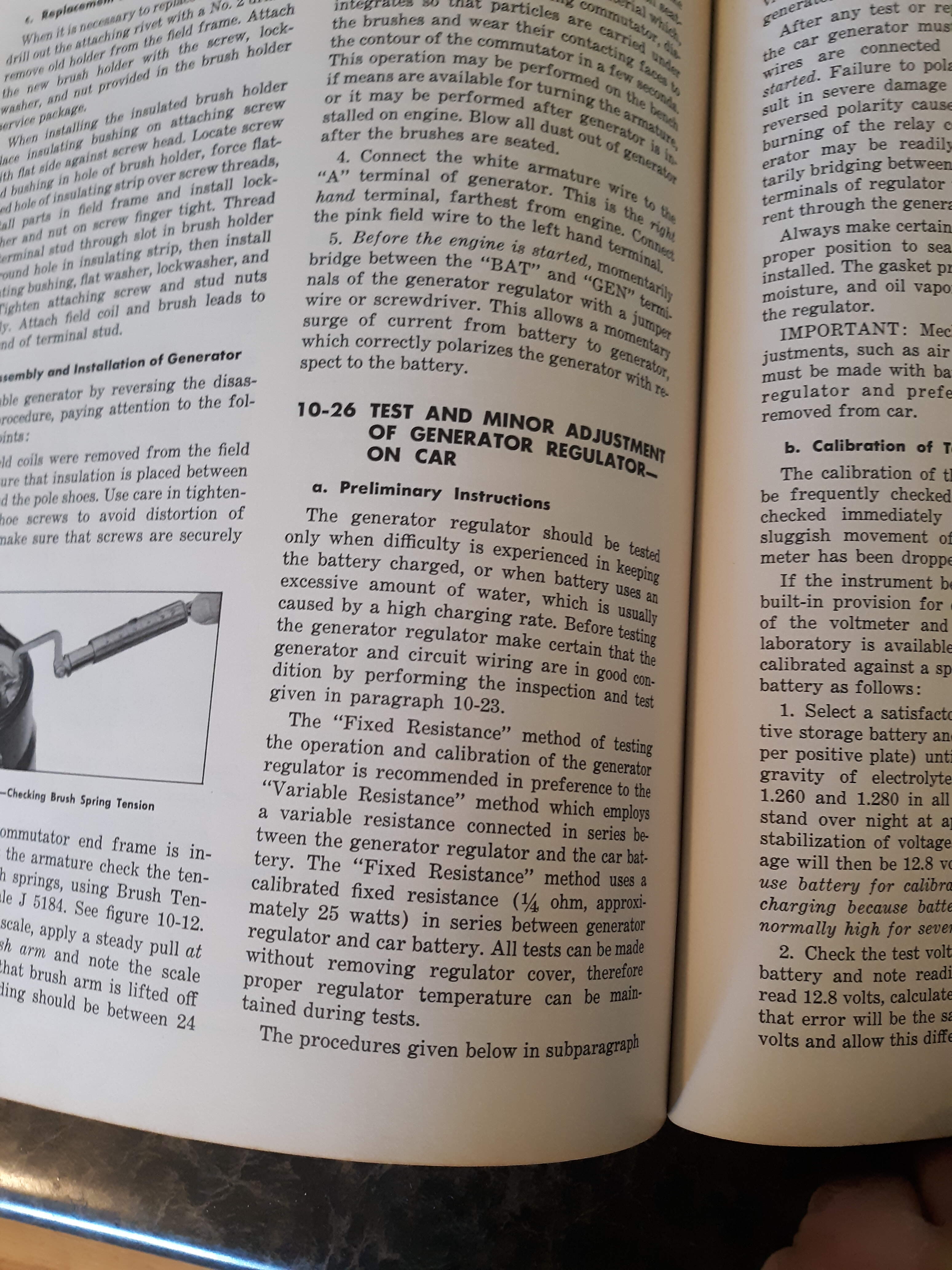

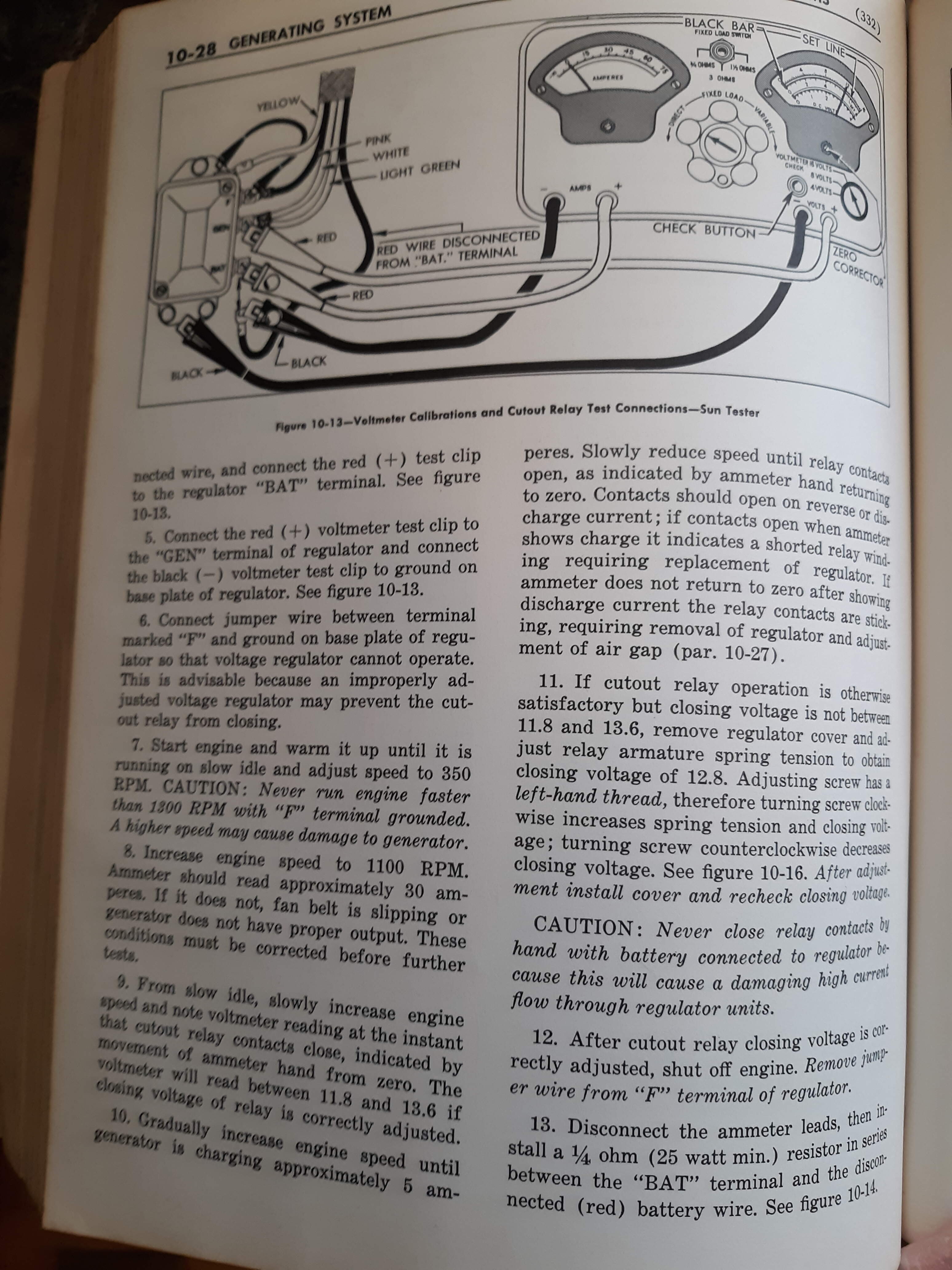

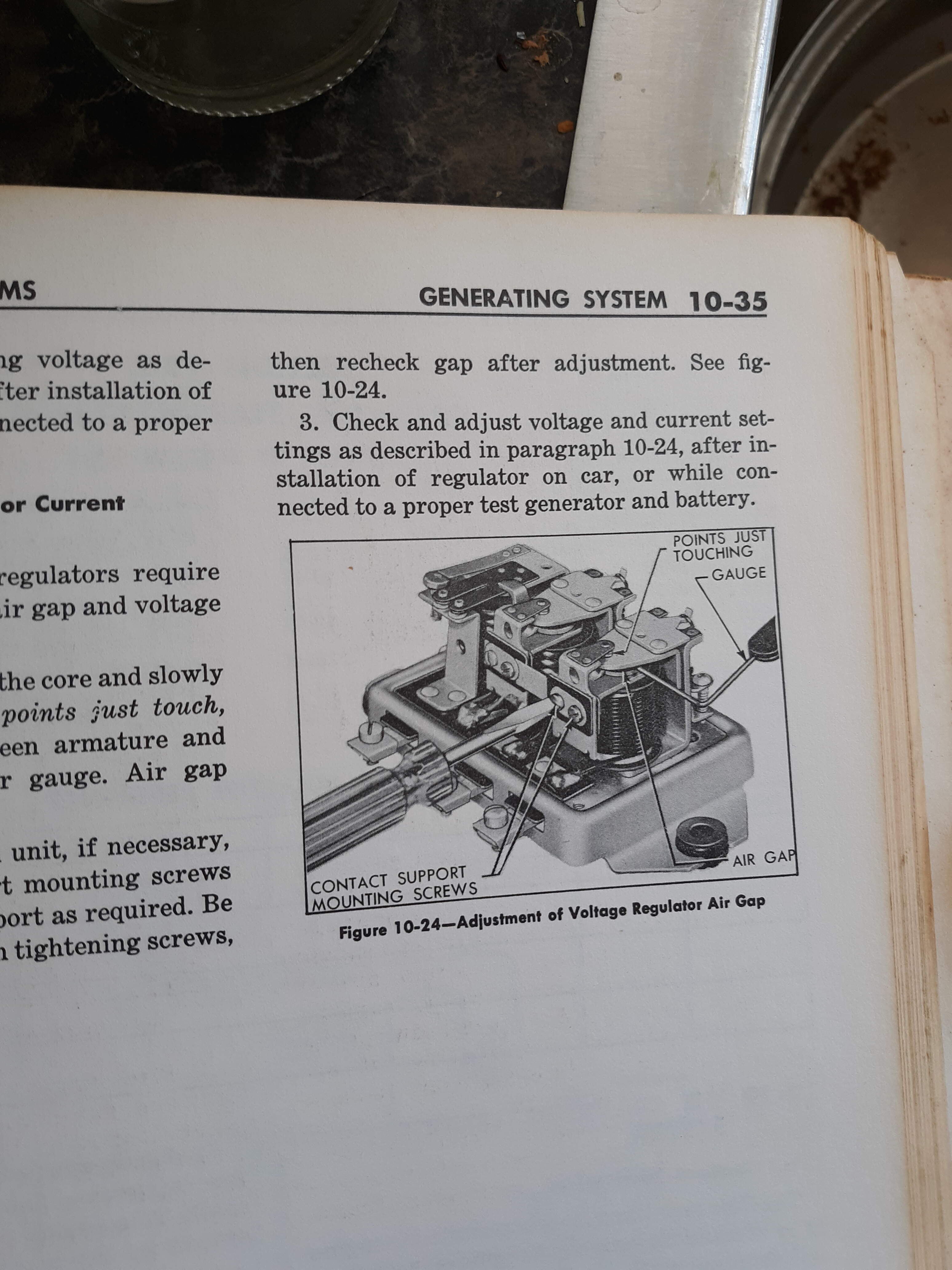

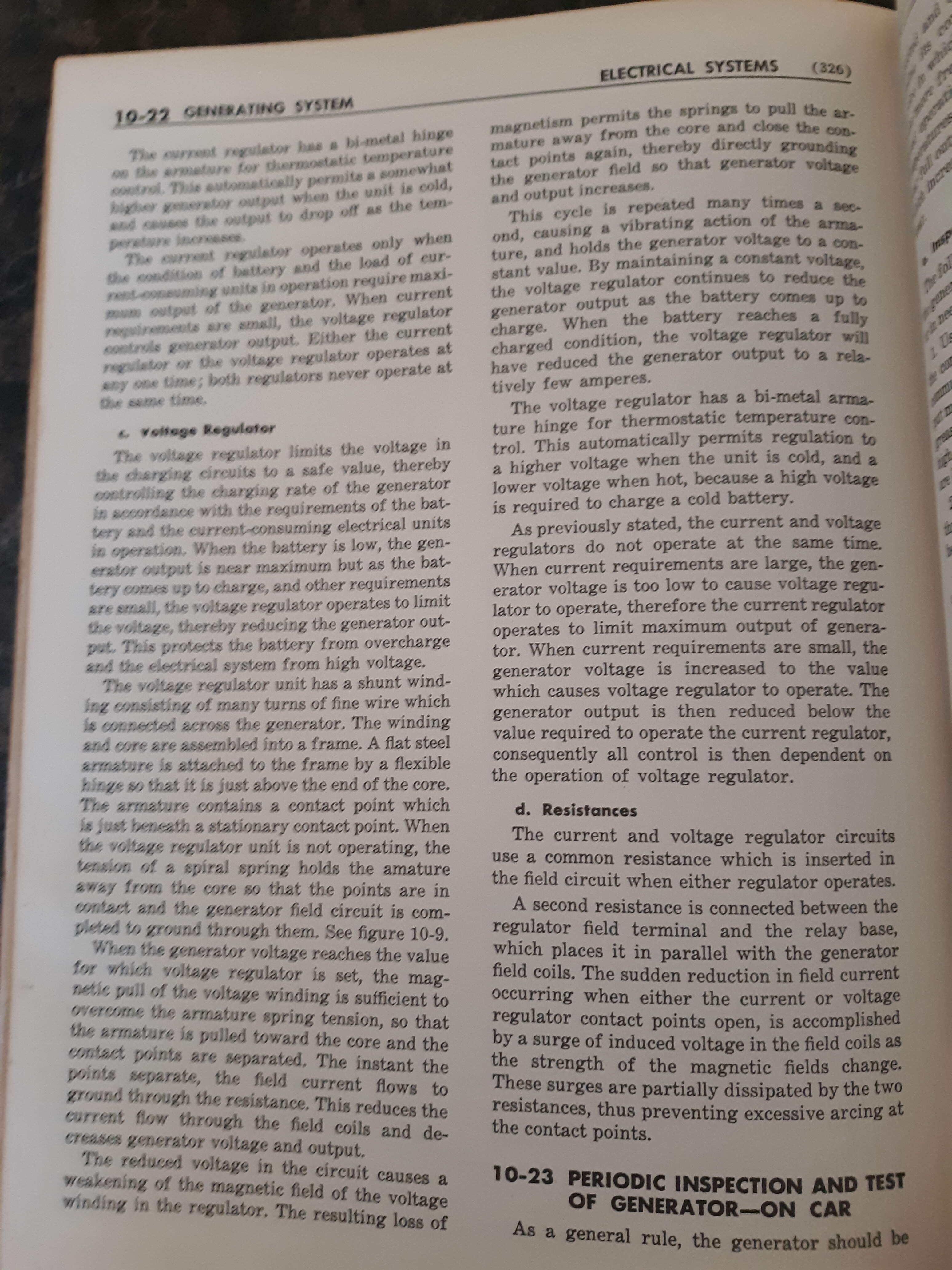

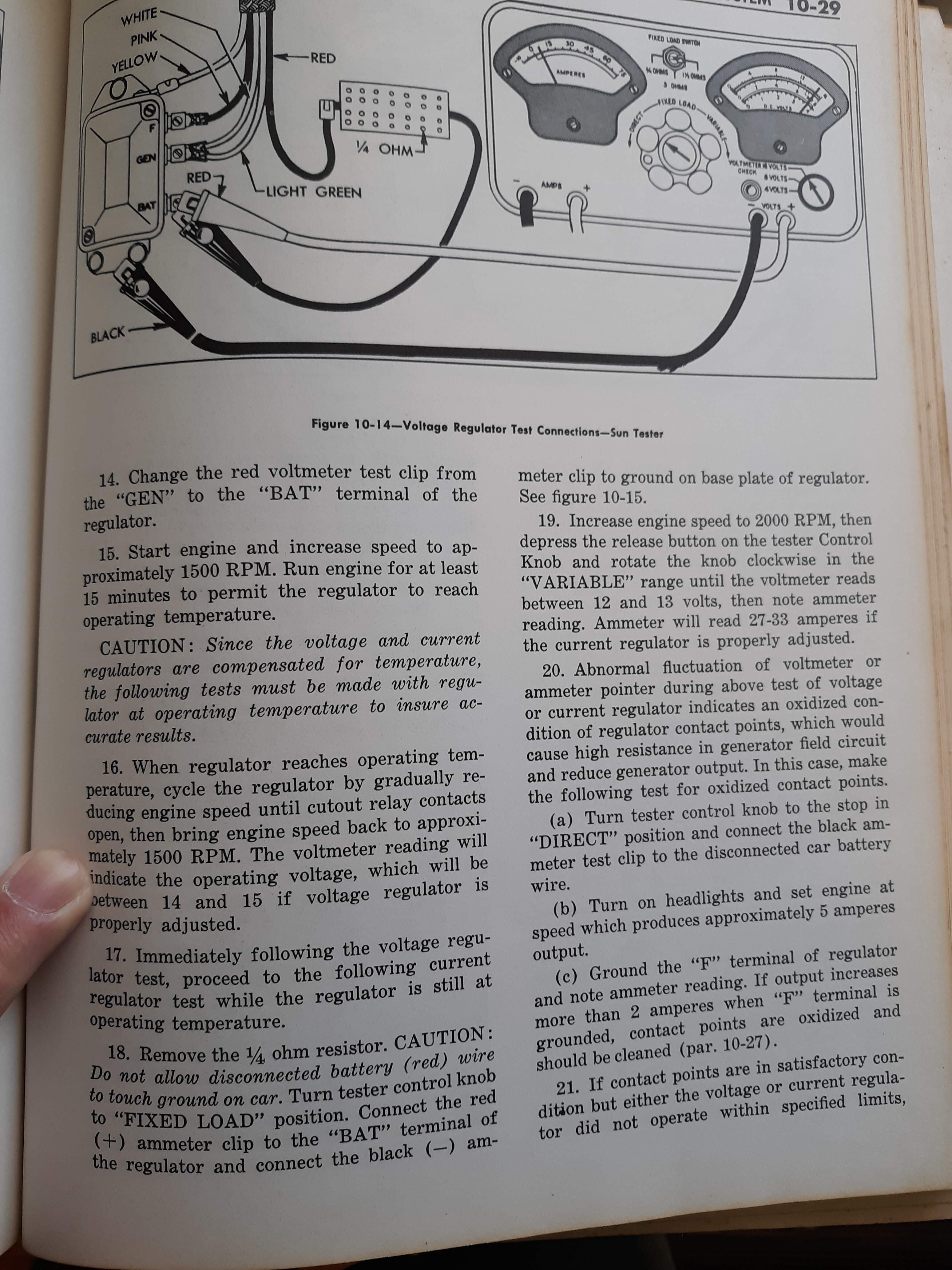

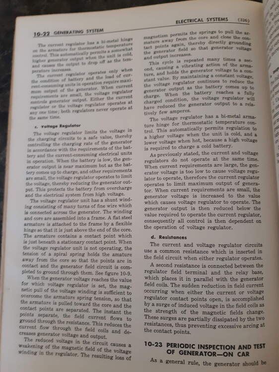

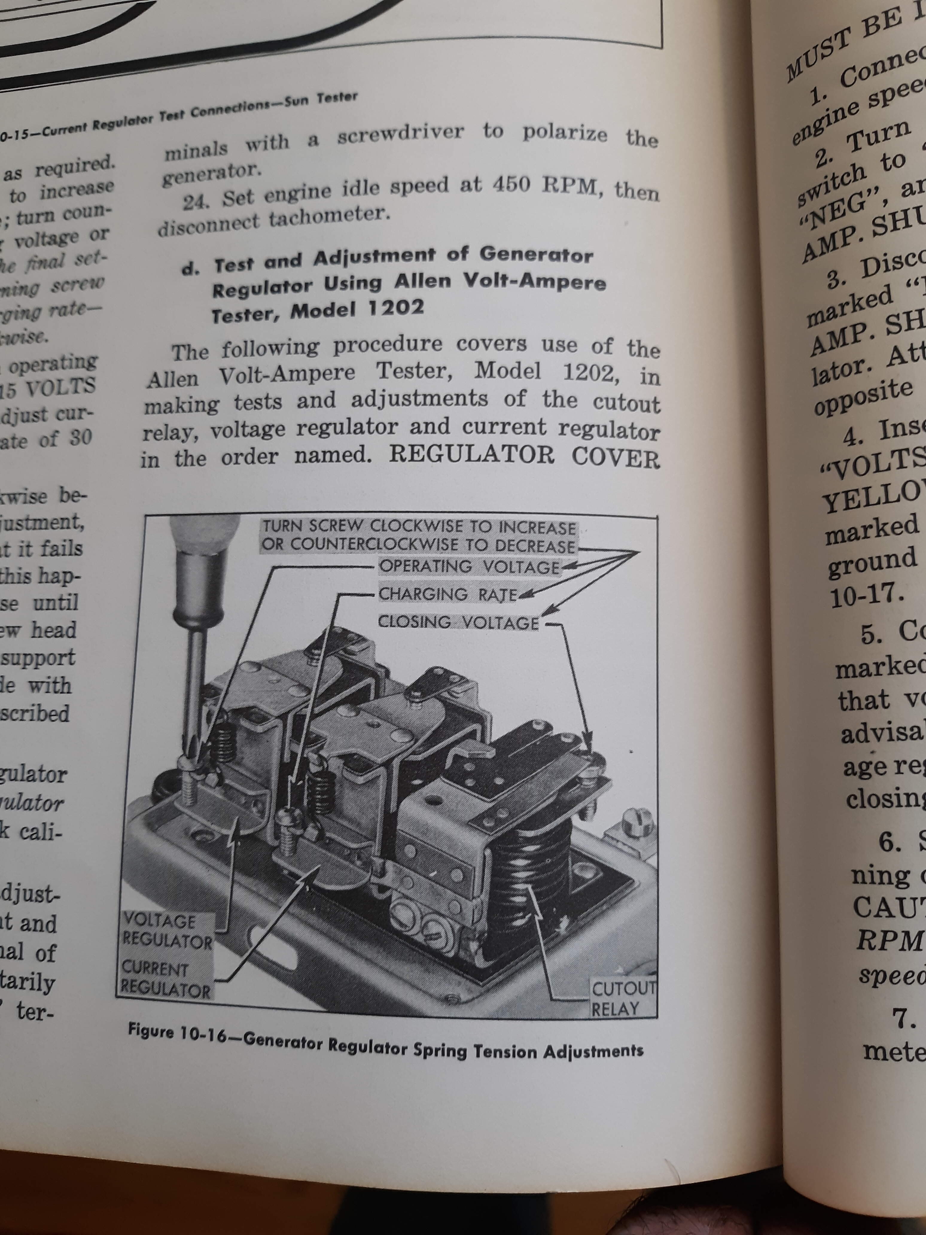

Was looking at the test/ adjustment procedure for the voltage regulator and requires a specialty combination volt meter/ ampere tester ...That would have been common in most shops 60 years ago...But today not so much...My dad had one...But I haven't personally seen it in at least 30 years...and was probably liquidated during the estate sale 20 years ago...That being said...If you happen know an old school mechanic who may still have one then you may be in luck...Anyway here is the procedure for testing/adjusting the generator/voltage regulator...Hope this is legible enough to read...As I have no other way than the camera on my phone...
This particular manual is for a Buick...
None of my Pontiac shop manuals go back far enough to cover cars with a generator and the voltage regulator adjustment procedure...
For GM cars with an alternator (1963 forward) the external Voltage Regulator adjustment procedure is different and way less complicated...
I'm 99% sure that the same Generator/Regulator adjustment Procedure...is universal across all the GM brands...

Hey @TWO LANE BLACK TOP
Thanks for the info!
While you were on your extended dinner date, I did some more research of my own - I actually possess a Workshop Manual for the '61, which describes (at length) much the same process as what you have sent through.
Looking at it, I made the decision that I had neither the equipment or expertise to do the job, as I didn't want to kill my brand new generator, battery or regulator.
But digging that little bit further I discovered that my regulator (whilst being listed by numerous sources as the correct replacement part for the car - AC Delco D618, 55-63)), is not adjustable (see attached photos)!
So, off to the auto electricians AGAIN tomorrow, hopefully this time for an actual resolution. I'm a little over being told to replace parts that in the end are not changing the fact that the charging system is simply NOT charging sufficiently to maintain a healthy battery charge level.
