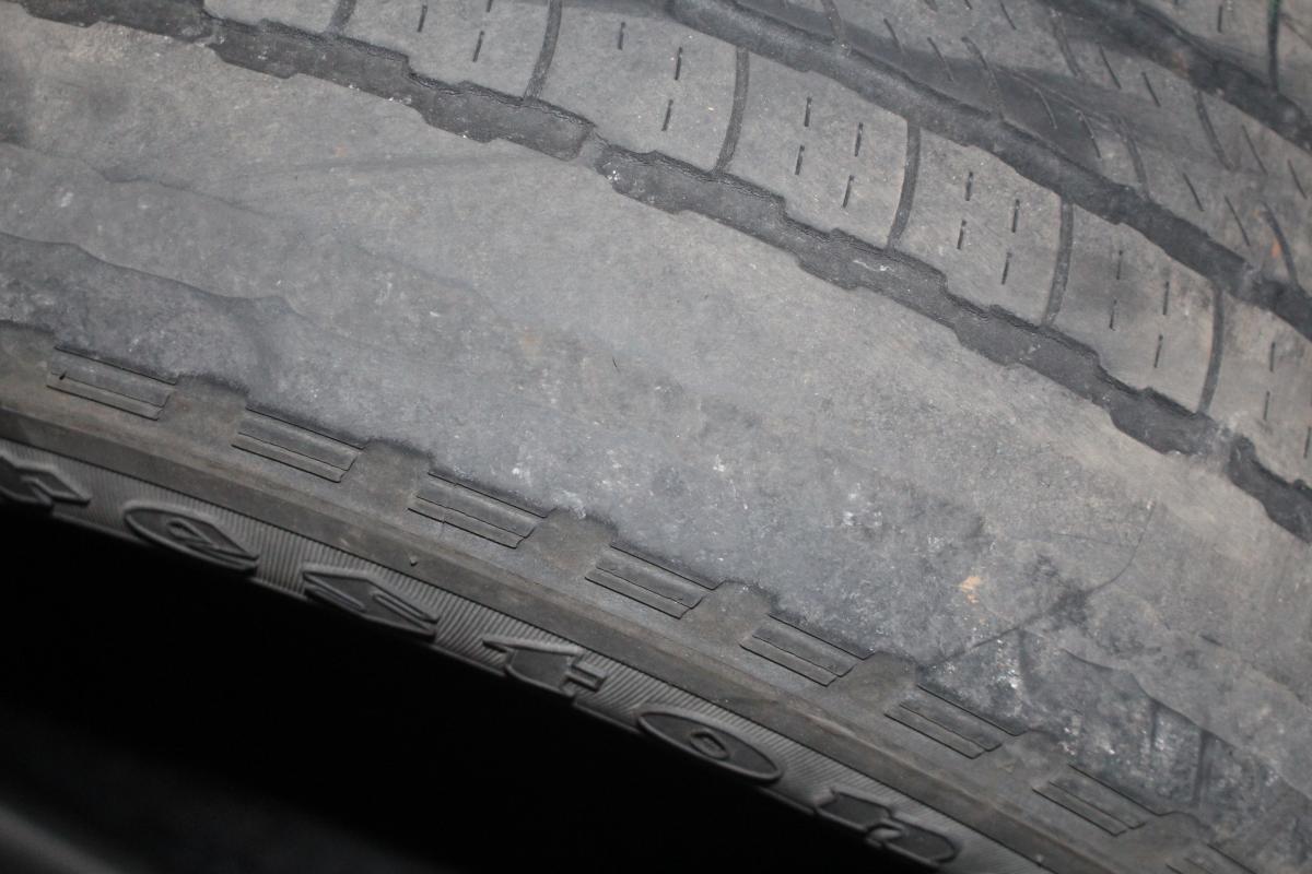

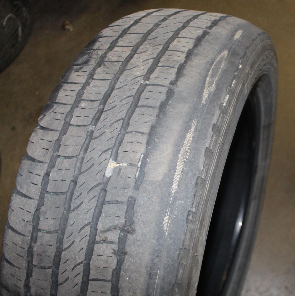

I took Black Beauty (my black Envoy Denali) in for an oil change, lube, and tire rotation this morning. I got a bit of shock once they went to rotate the tires.
Seems like I need new tires. I need to replace the passenger side sway bar end link since it is completely missing! The A/C belt is starting to crack. The transmission is overdue for a flush and filter (based on the mileage only), they didn't check their records since that was done in December. There is some slight play in the front end - not sure if its the rack and pinion or the tie rod ends, ball joints should be okay.
Oh and by the way sir, the tires are down into the steel belts, way past the wear marks. Say what?
Yup, it's true....seems the front tires are completely shot from the inside.
So now I am the proud owner of a new set of Bridgestone tires. I will have to run to the auto parts store tomorrow for the A/C belt and a pair of sway bar end links. I figure if one side is completely gone, the other side is probably compromised as well. I will have to figure out time to get it to alignment shop to check out the rack/tie rod ends/ball joints issue.
I rather expect Killer to say this due to the quality of Michigan's potholes and roads. I'm inclined to agree with him too.
Those trucks like to eat tie rod ends, and you see what it does to tires. I might suspect the ball joints as well because of the inner wear.
Oh GM, you sure know how to make truck IFS setups... :lol:
If fluids are overdue, I'd service the front diff...I know that's another issue with that platform.
