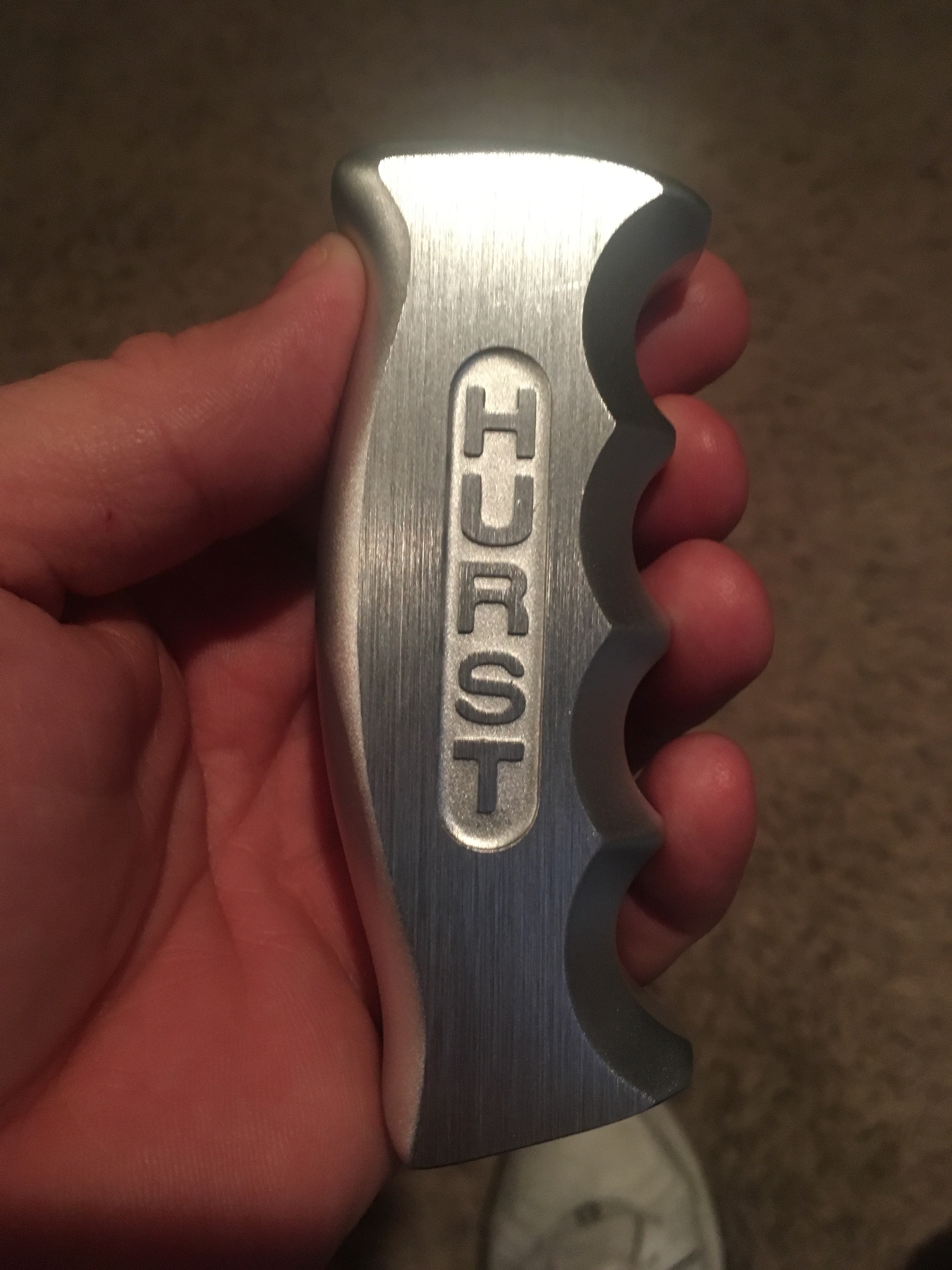

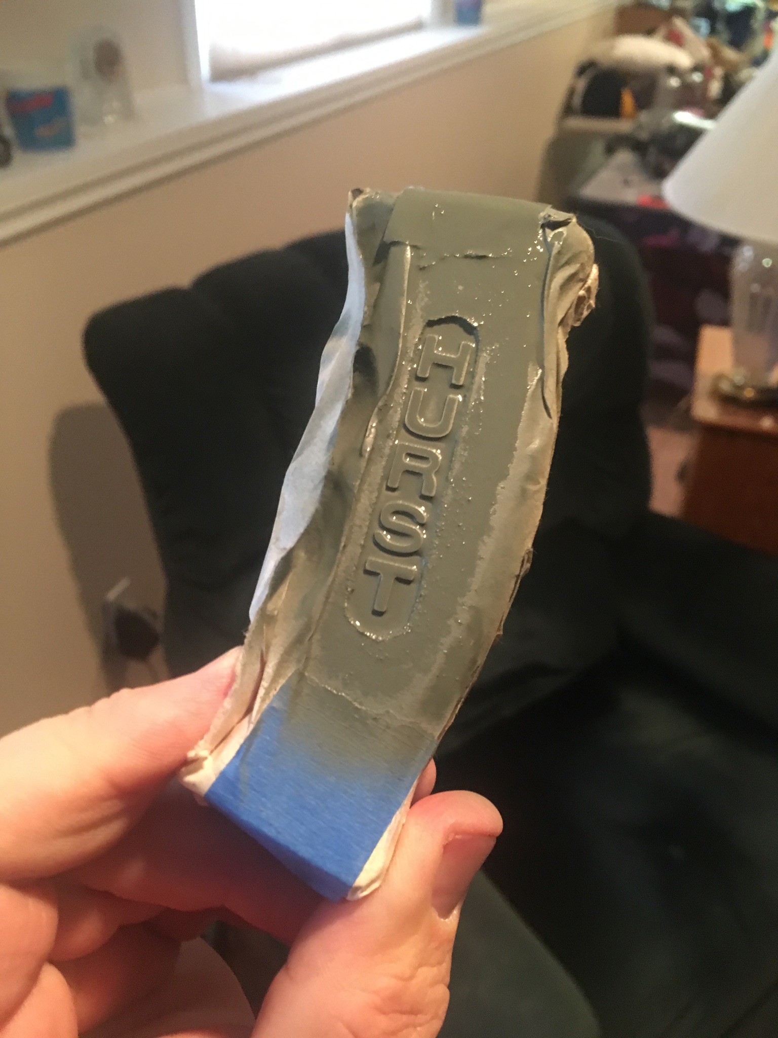

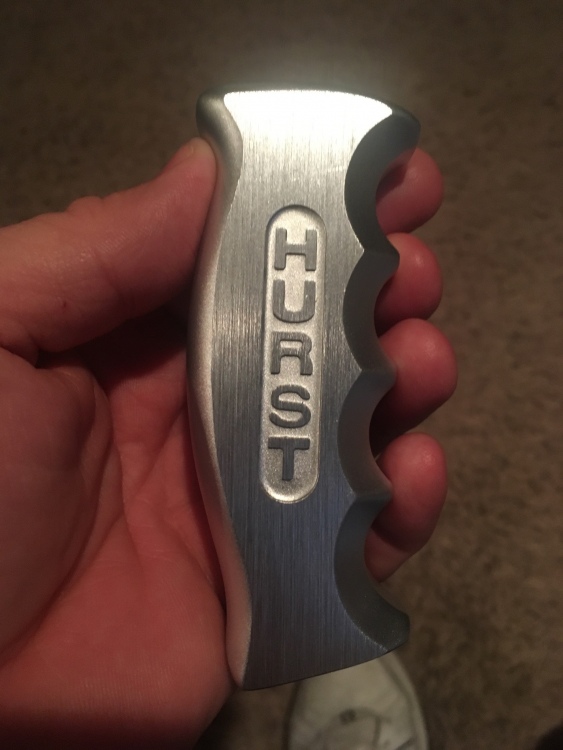

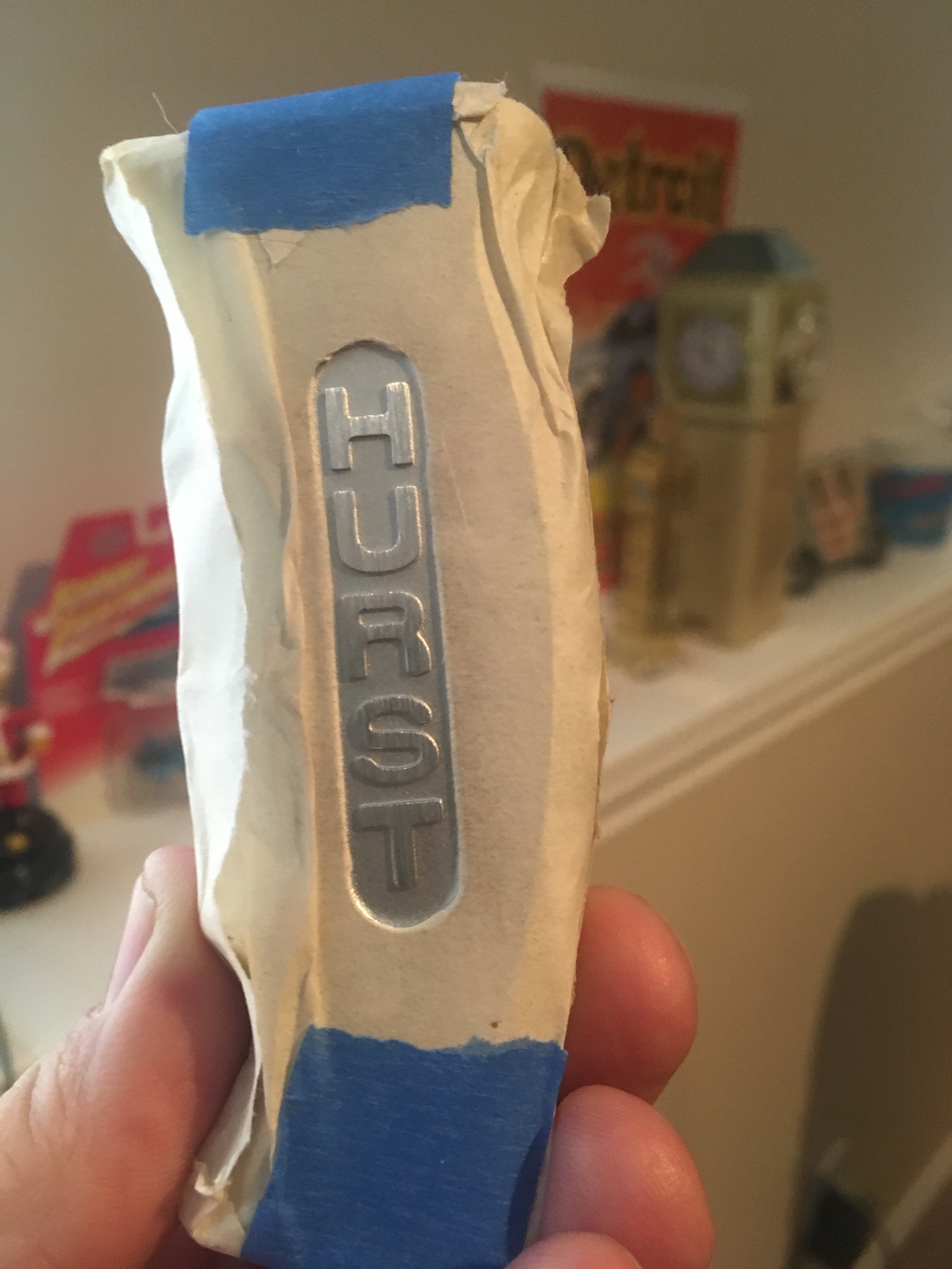

I have pulled the Hurst pistol grip shifter off of Lucy so I can paint the Hurst logo on it.IMG_1142.JPGIMG_1143.JPG
I bought some gold and black automotive touch up paint that includes the clear coat. I also got some self-etching primer that works on aluminum, an X-Acto knife, a red scotch bride pad to create some "tooth" on the metal, and some painters adhesive paper to cover the parts not getting painted.
Right now it has been primed. Color is next.

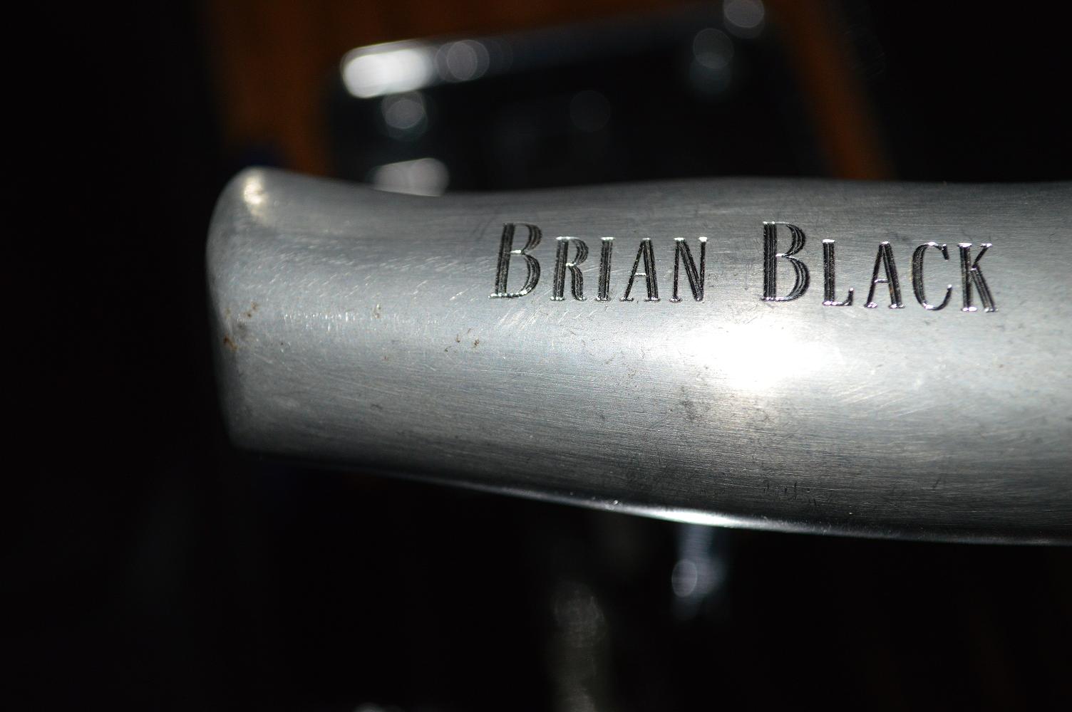

Will have to take notes on this one.   Had Brians name etched into my Hurst T handle and will need paint.
Show it to me the next time we get together. Depending on how it's etched it could be done a couple of different ways.
I don't have the depth you have to work with.  It already has plenty to bite on, so I'm thinkin Justa brush BLACK in and go. No real room for primer.
Sweet T-handle JUSTA!!!
The self-etching primer is so there to provide a solid bond for the metal and paint to adhere to. However, I agree with your technique. I would also add some clear coat in the same way as the black paint just to protect the black paint and prevent chipping. Give lots of drying time between coats (per the paint directions).
