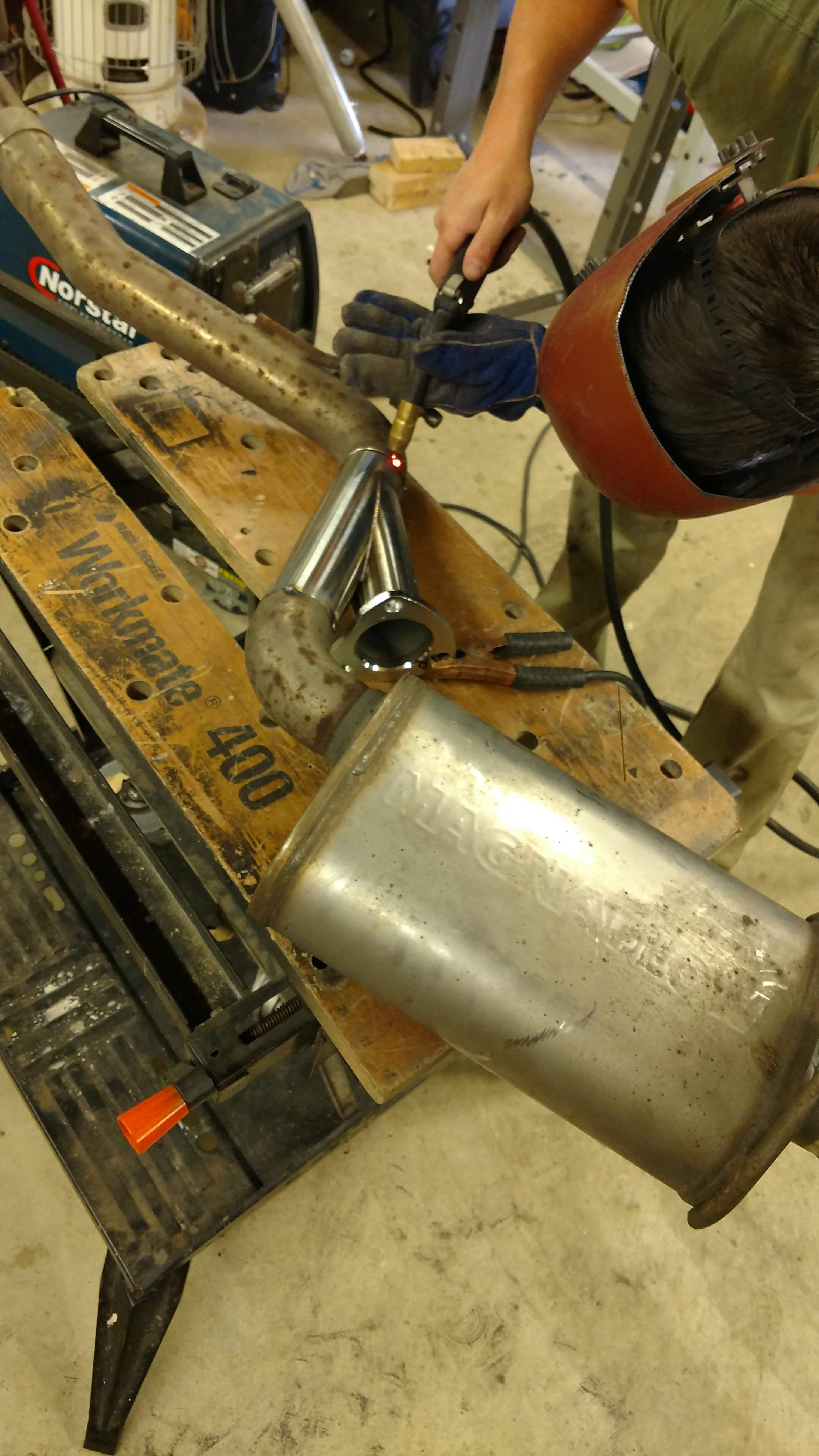

Welded in some cutouts! Letting that 6.0 breathe.
Somebody is taking after Indymanjoe and plans on disturbing the peace! Nice.

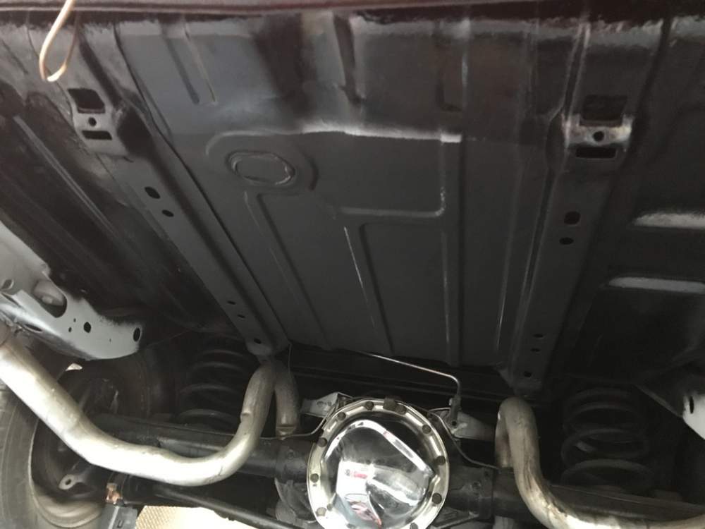

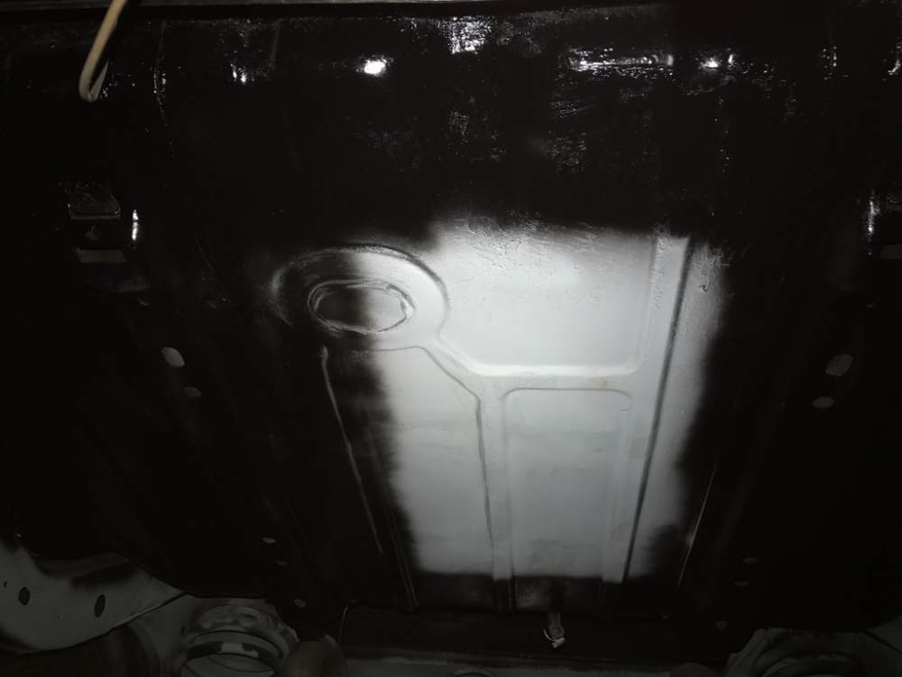

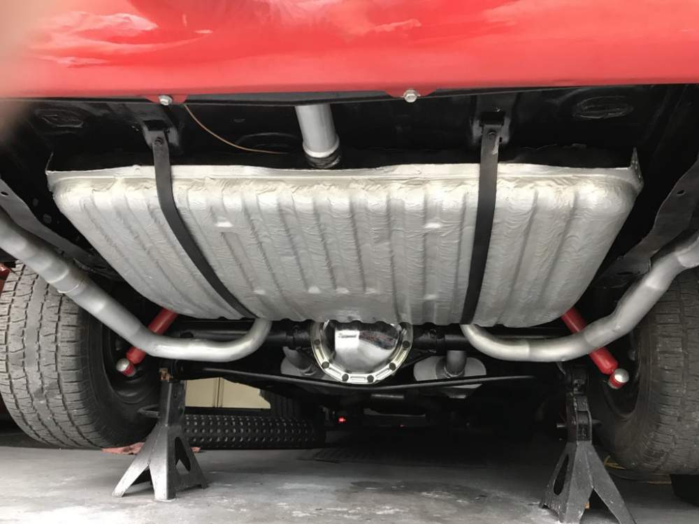

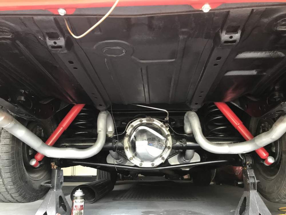

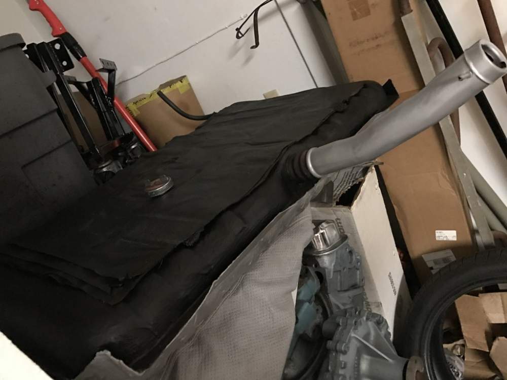

latest project. When I buy a car, I like to take it apart and inspect so I know what needs attention and what I can consider done and reliable. I pulled the gas tank to 1. Look for a possible build sheet and 2. check the fuel lines and look for body rust. Well I found plenty of rust between the tank and trunk floor and in the axle tub for lack of a better word. So for 2 weeks I've been sanding/grinding, primering, chassis painting, and then truck bed liner all surfaces including the suspension, floors, torque boxes, shocks, exhaust, axle,frame, and tank , She shouldn't see a speck of rust for a couple of decades hopefully,The truck bed liner only really went on the floor panels above the axle and the underside trunk between the gas tank and the floor above the tank  here's some pics.

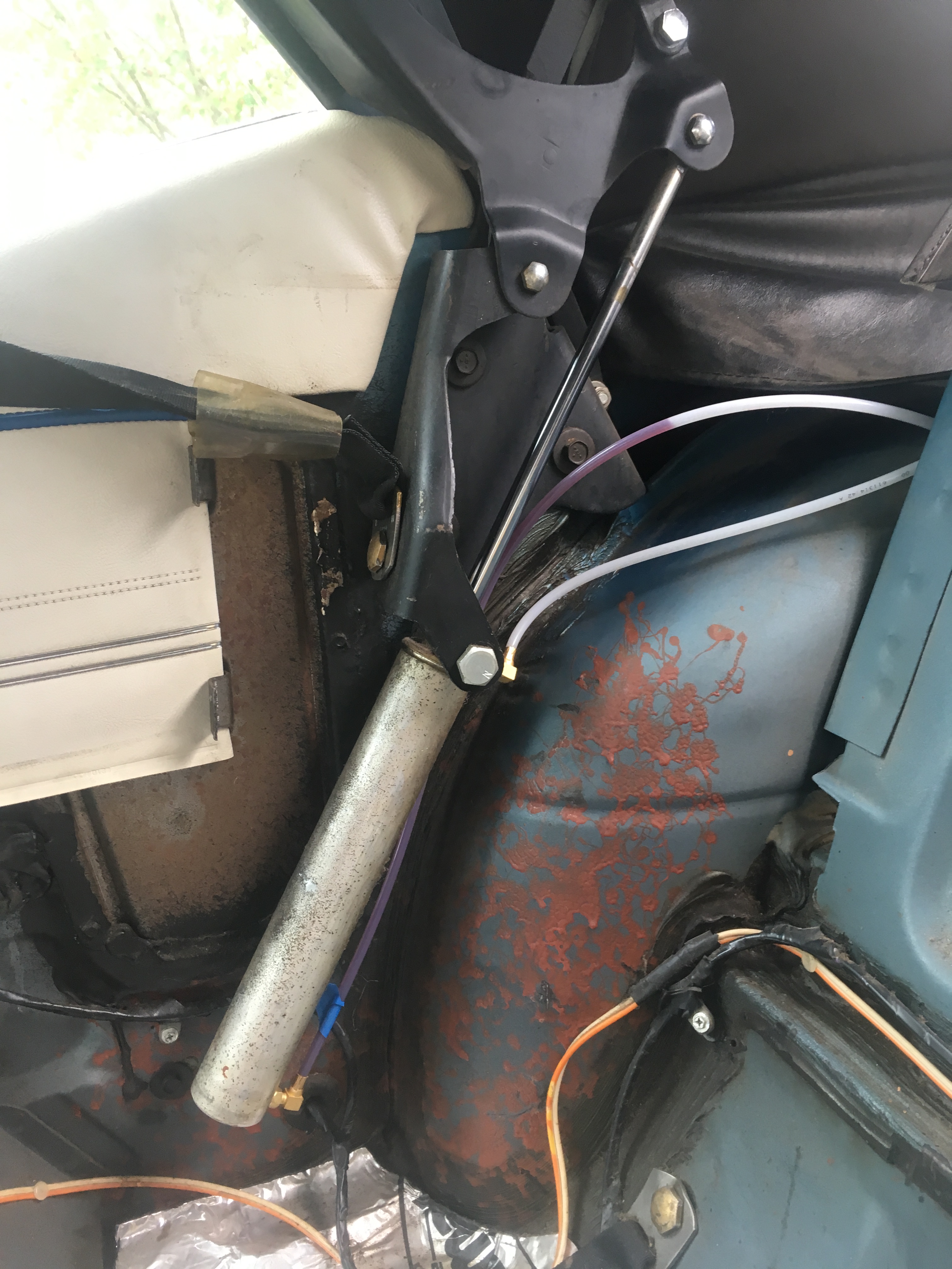

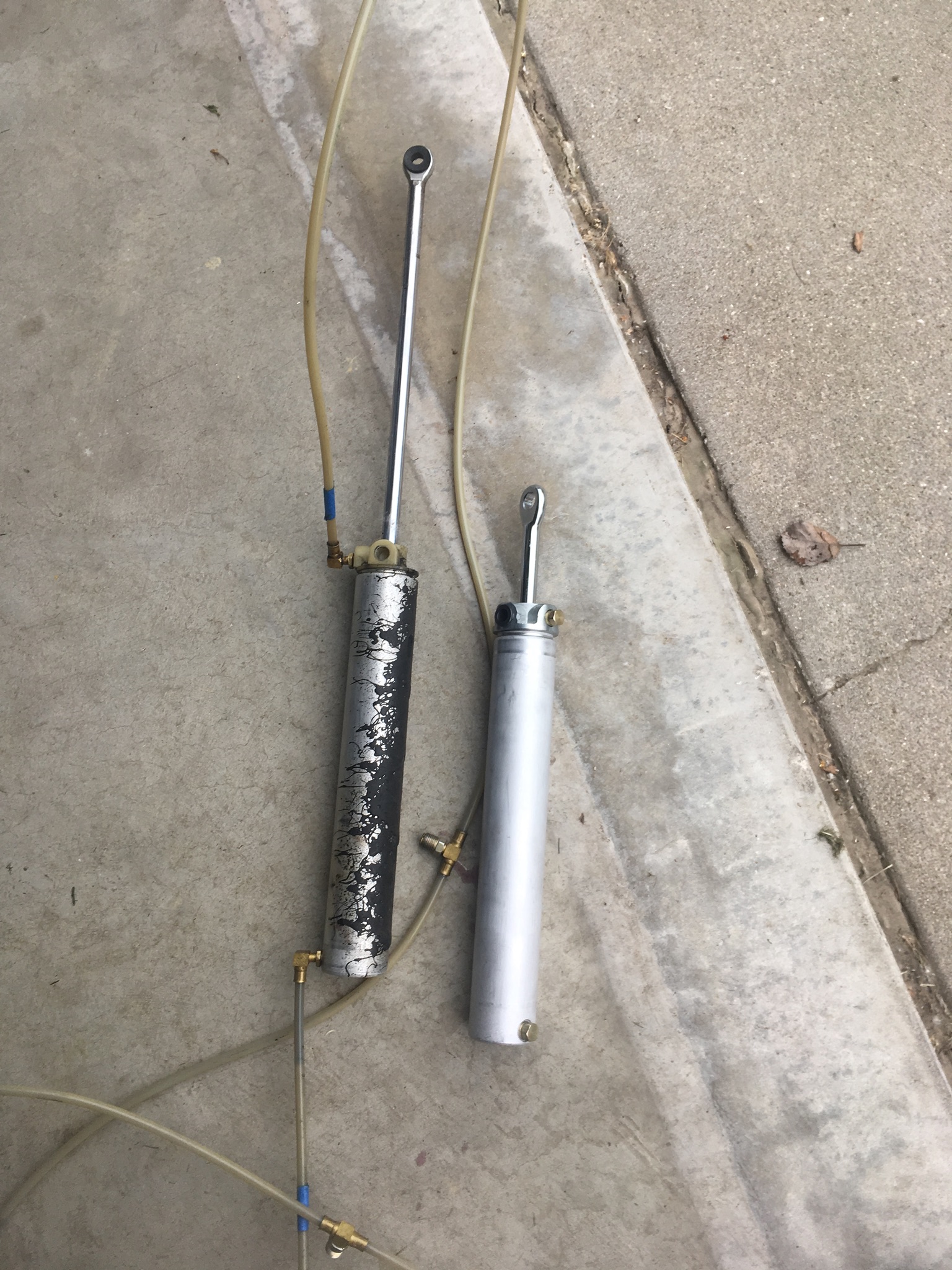

If you recall, I took Lucy to a car show in the early spring with JUSTA6 and Indyman Joe - only to discover the top would not come down. At first I thought I had a bad switch, turns out to be leaking hydraulic lines. After 45 years, the originals gave up. I guess somethings just don't last anymore. Anyway the following weekend I bought new lines from National Parts Depot in Canton, MI ($100). Got them installed only to find that the upper hoses would not fit into the upper connections on the rams. The old and new lines have a slightly different thread pitch. So I had to buy new rams to fit the hydraulic lines. So a $100 repair ballooned into a $350 repair and that was when I ran out of time with the kid graduating from high school and time to uber clean and repair the house in preparation for a high school graduation open house that is still a month away (July 15th). Along with that came the start of travel baseball literally every weekend in June and July - except for Father's Day weekend.....

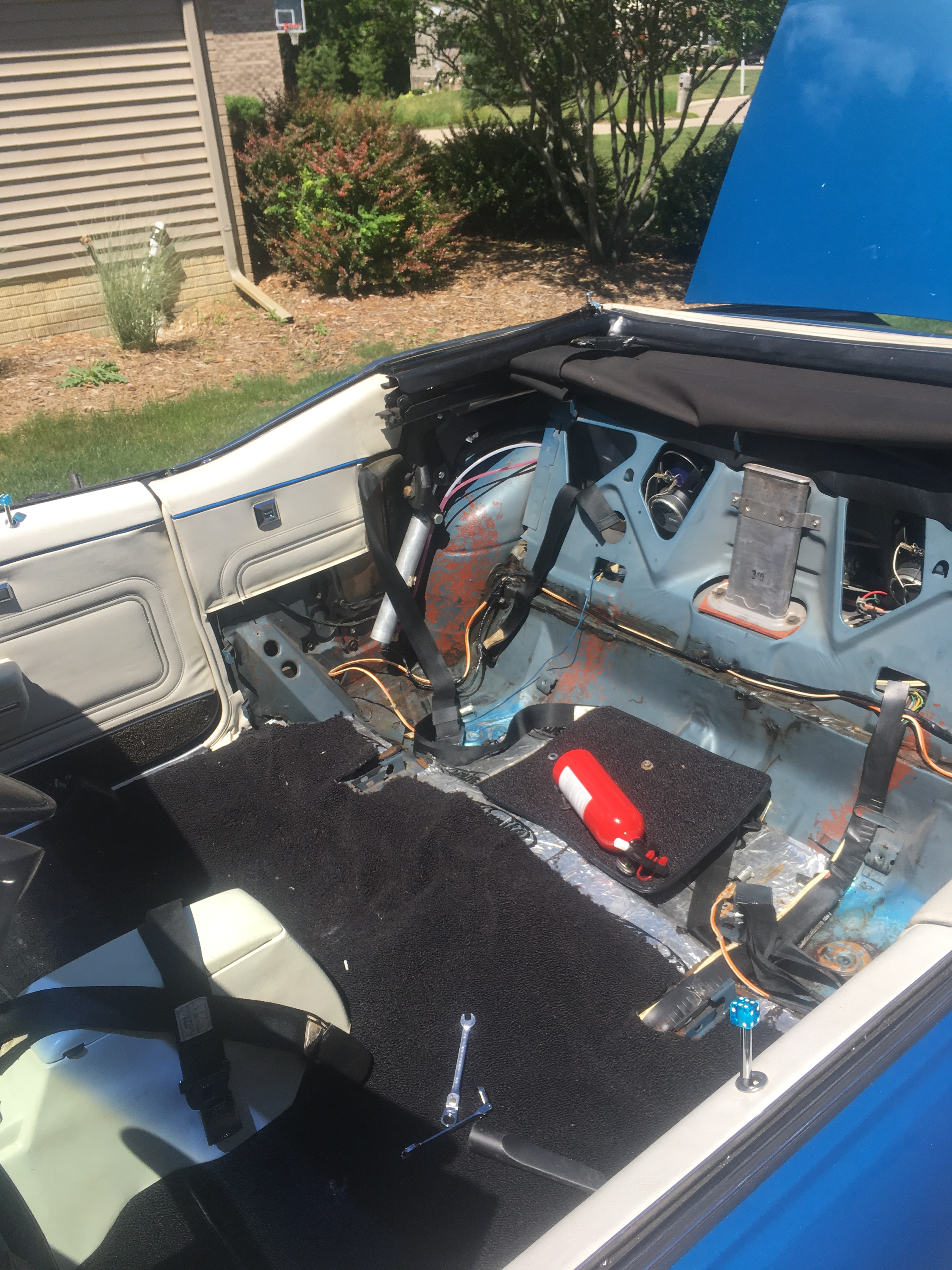

Which brings us up-to-date. So Lucy sat for the last six weeks untouched with the dash torn apart (I originally thought it was the power switch) and the back seat completely torn out of it.
I used the blue painters tape to differentiate the upper and lower hose lines when I was replacing lines one at a time, starting from the motor in the trunk. Some of that saturated Dynamat and sound deadener has yet to be removed when this photo was taken.
If you look to the left of the red fire extinguisher, you will see that I had to cut out some of the Dynamat and sound deadener because it was saturated with transmission oil (a.k.a hydraulic fluid). I had to do the same thing to the passenger side as well.

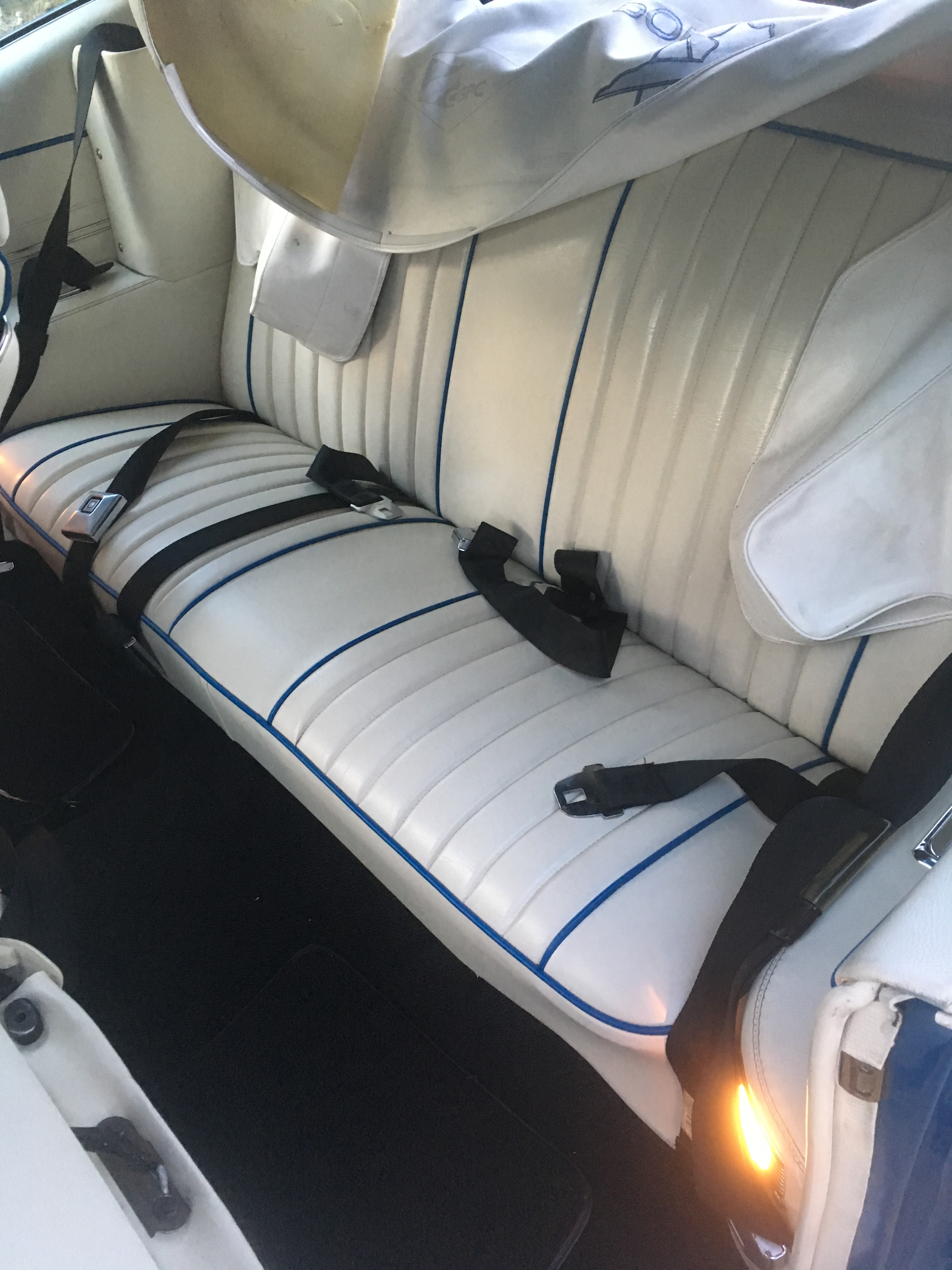

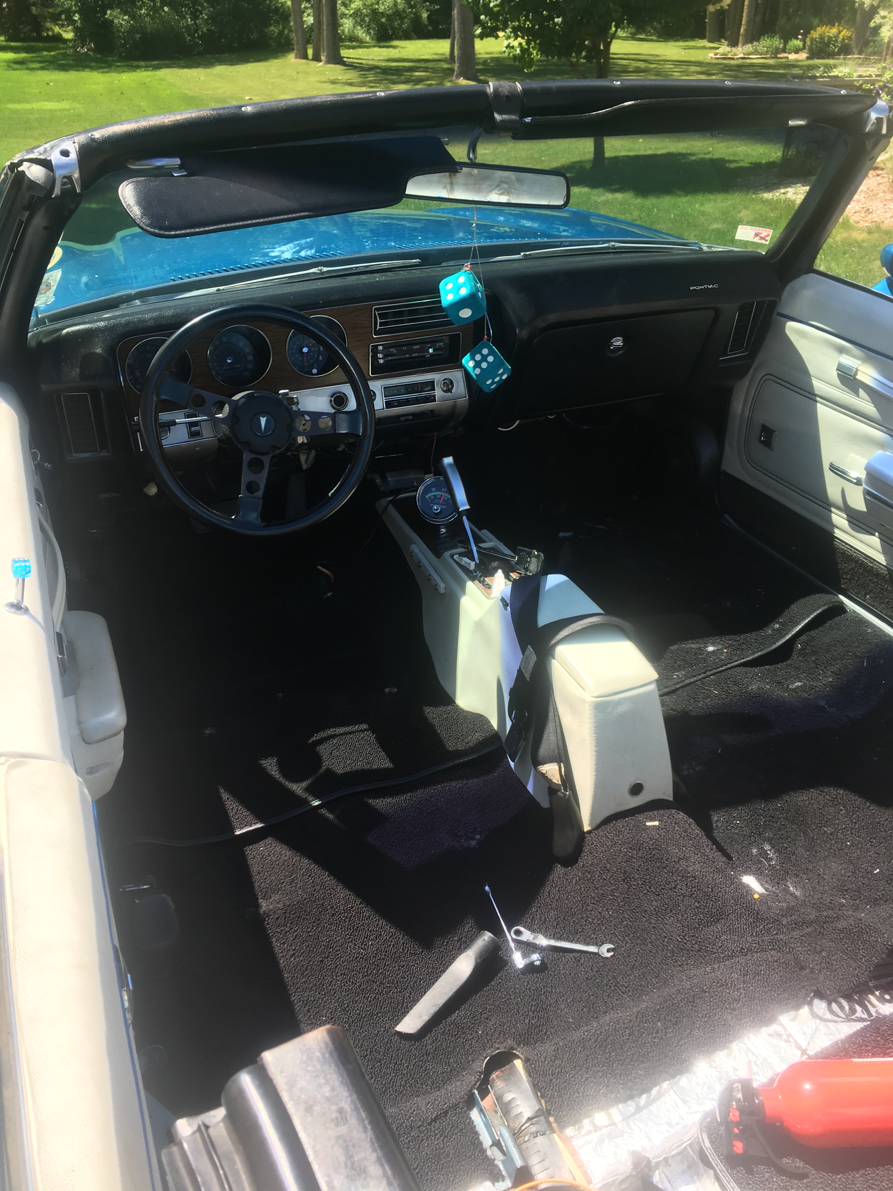

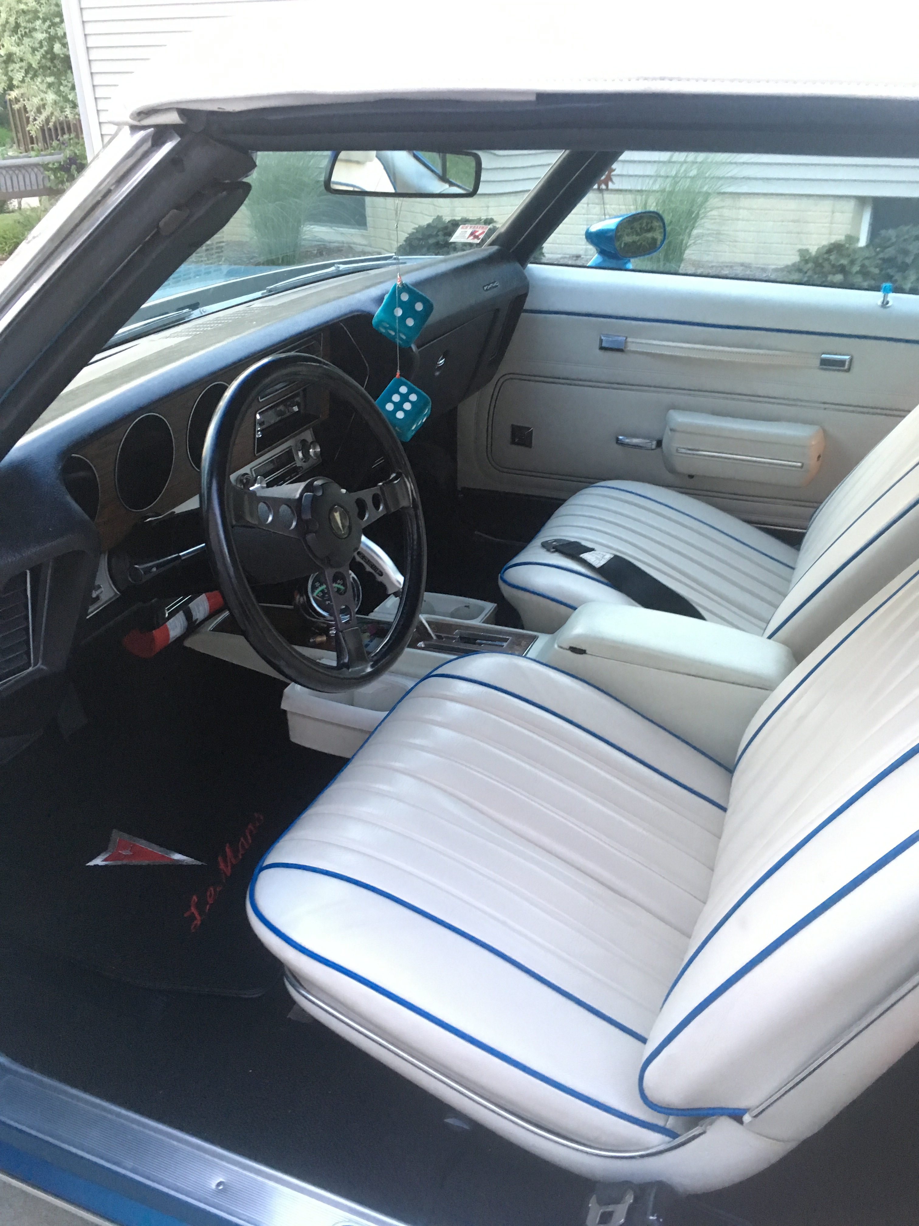

I removed the front seats for two reasons - it made getting in and out of the back seat a whole lot easier. It also made working under the dash and putting the dash back together much easier.
I finished installing the rams, bleeding the system, and making sure there were no hydraulic leaks on Saturday, then the rain came in Saturday night. So I was left with putting the car back together on Sunday after I had Father's Day brunch with my dad. I started around 3:00 pm and I finished at 9:00 pm.
Along the way, I was cleaning every part before I reinstalled them. I would clean them with degreaser, leather cleaner, or protectant, or perhaps all three. I also took the time clean the entire carpet (since the seats were out) with carpet cleaner and then I put stain guard on it and my new carpeted floor mats.
I still have to clean the dash, the door panels, some parts of the seats, but the interior is essentially clean.  Now I have to wash the car thoroughly on the outside and detail the engine bay.  I have to replace the front dash courtesy lamps but I can get the bulbs at Autozone.

Still think NPD screwed you into new rams with the wrong hoses.  Those same rams have been used in every brand convertible made.  Got my originals from a 80's K-car (used to raise/lower the hood on the Sunbird) After a mishap of the latch not opening before hitting the hydraulics, i replaced the destroyed ram with one from a 70's caddy.  Glad Lucy is back together N ready for some fun.
I think you are right JUSTA. I just found out about a place in Flint that will make custom hydraulic lines for cheap too. Dang it.
Nice work Frosty.
Thanks buddy.
Really nice car Frosty, love the interior color combo! Sorry about the thread issue, you said the pitch was different, makes me think they use British pipe instead. British pipe is one thread different, 19 tpi instead of 18 tip. If it was meteric the diameter wouldn't be close. Either way too bad!
Thanks Last Indian. The problem is two fold - the threads are slightly different. Further the top portion of the old ram is plastic with plastic threads, the new rams are all metal. So I was afraid of stripping the plastic threads of the old rams with the new threads since they wouldn't seat like the bottoms did.
