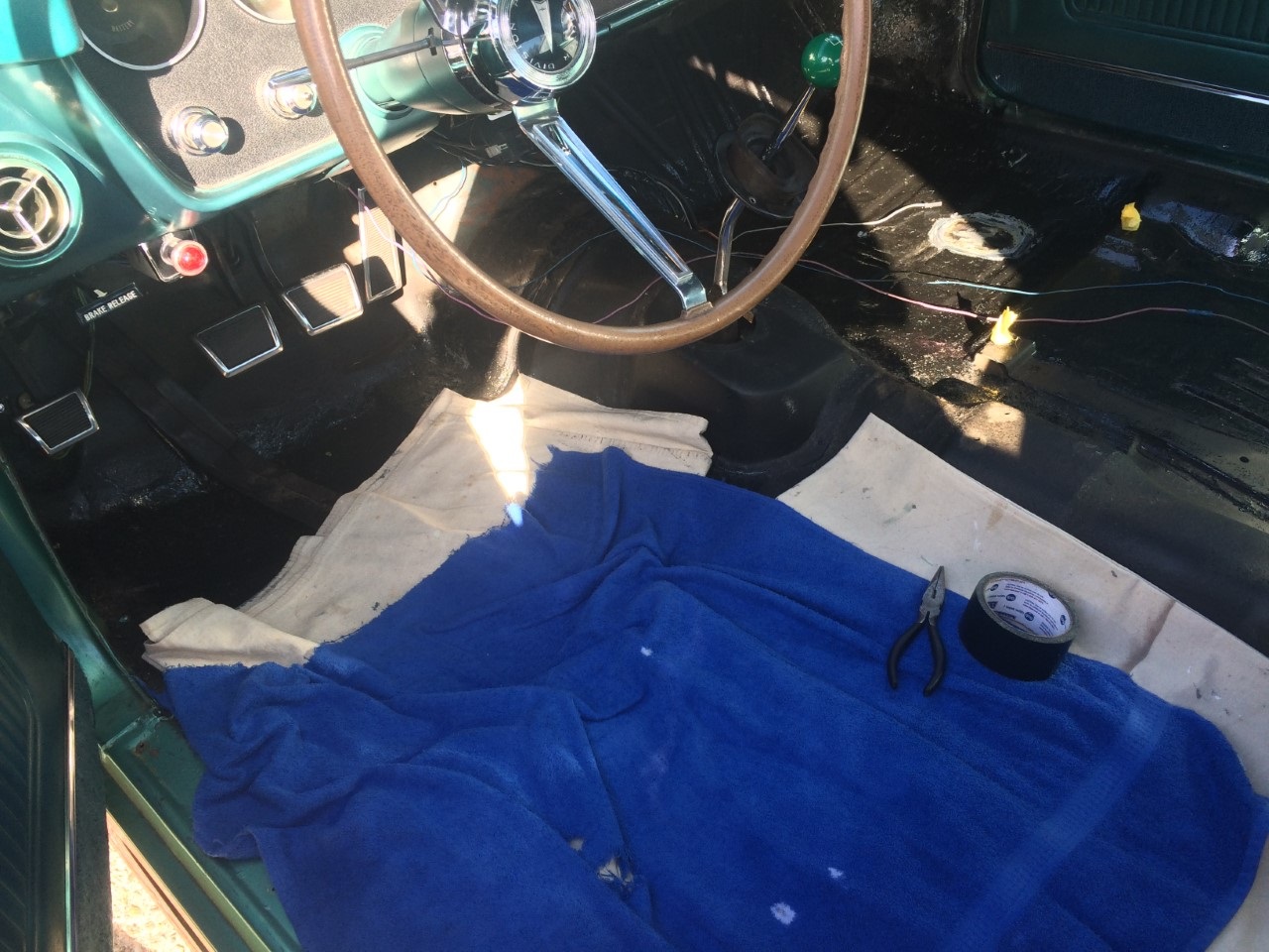

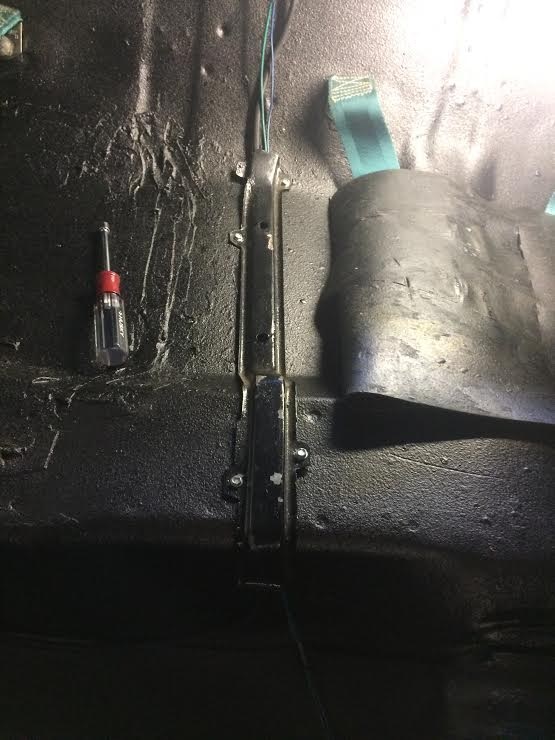

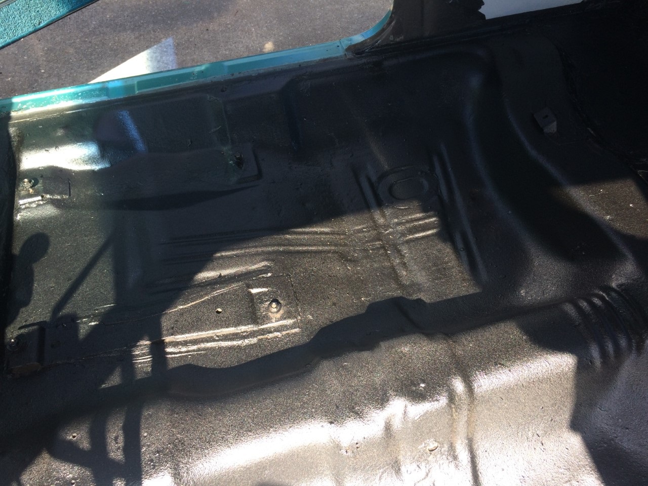

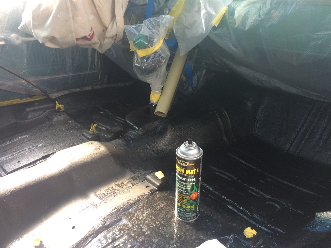

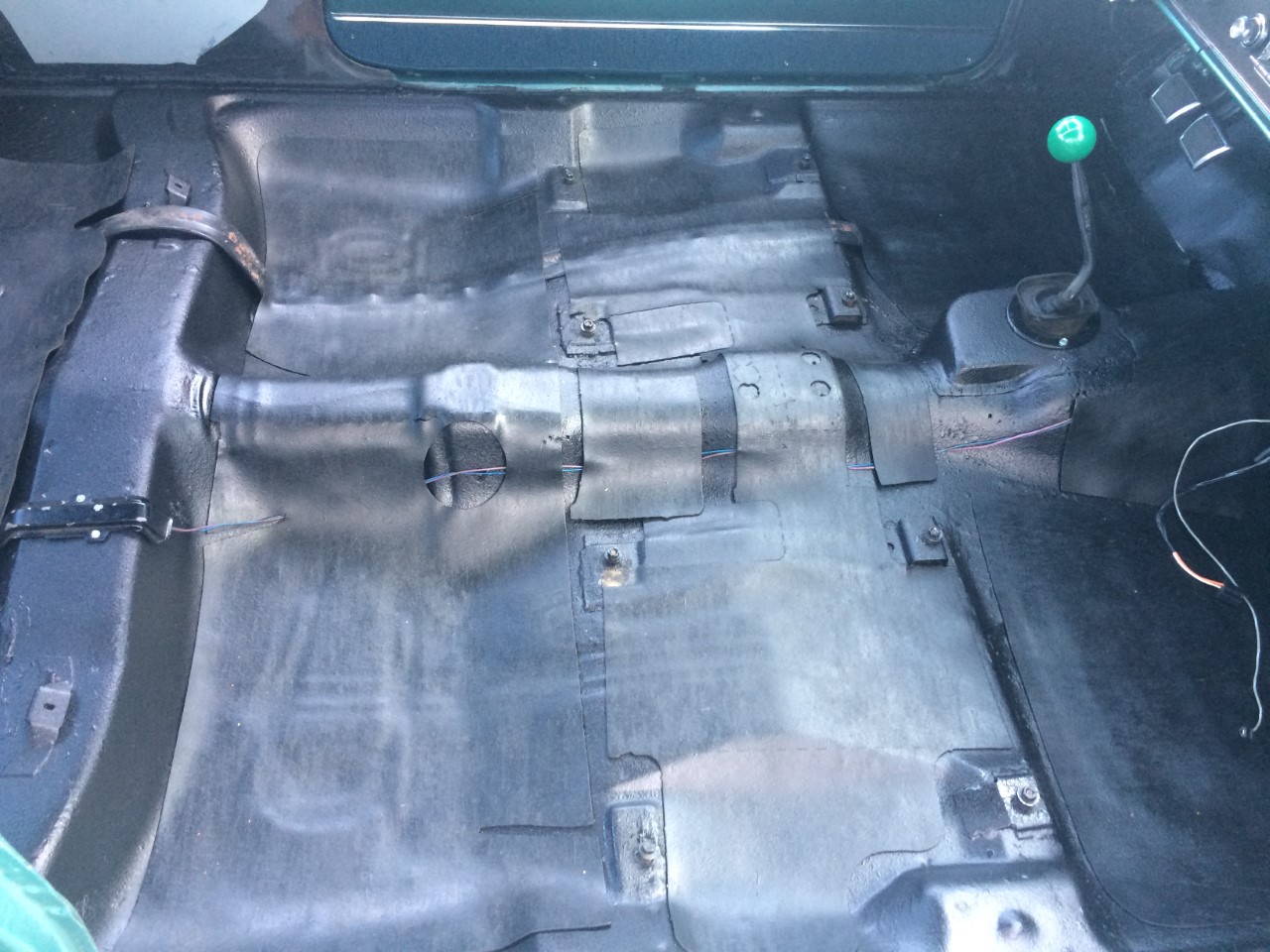

Knowing it was going to be near 70 yesterday I got a jump on the day hit the ground running by 7:30. I got further along then anticipated but like with any project, one thing always leads to another...After and hour removing the interior, I thought this would be a good time to apply the sound deadner I've been holding off on doing. So prep and clean the floor.  But wait have to mask off/cover everything, this prompted a few wiring corrections I noticed were needed. That lead to swapping out the main AC duct that has been on the list for over a year. OK all wiring is good, floor prepped, cleaned and coasted (twice) Let dry, eat pizza, drink beer. So now I can get back to the Trunk Release which stated all this :o

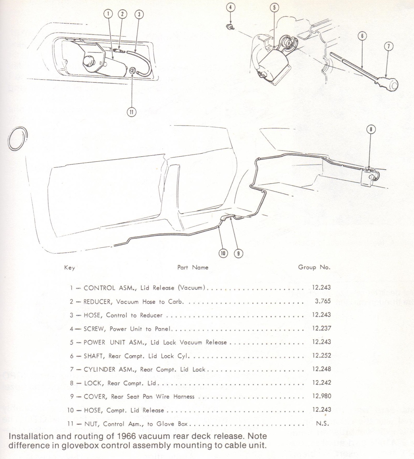

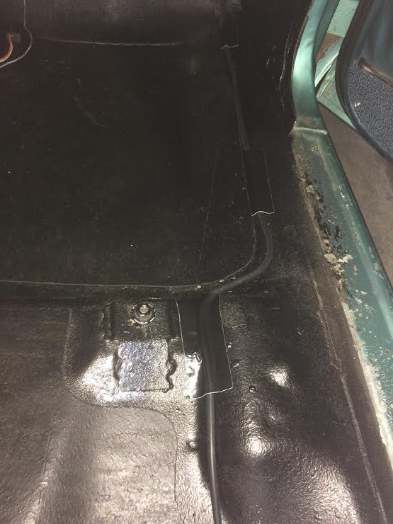

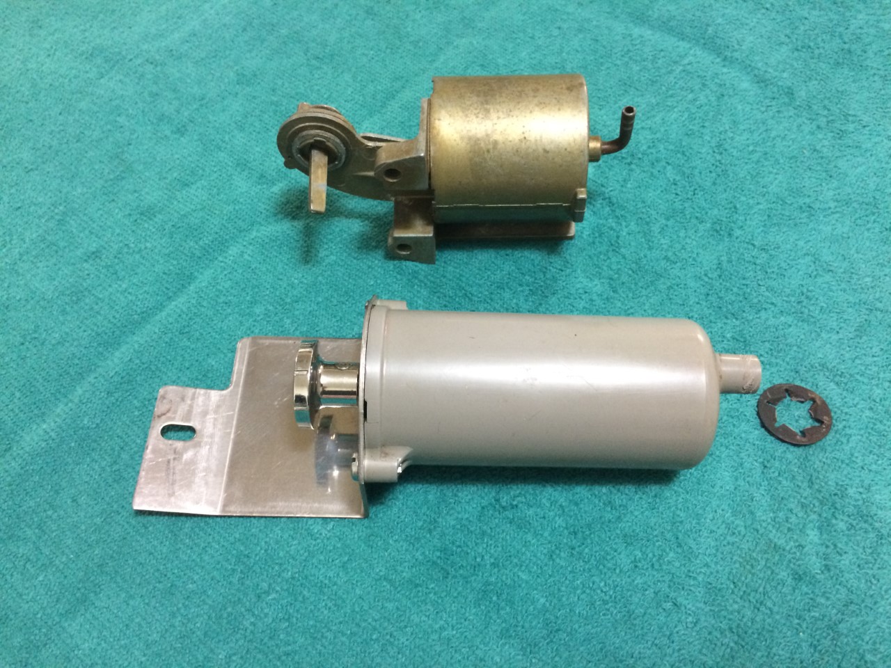

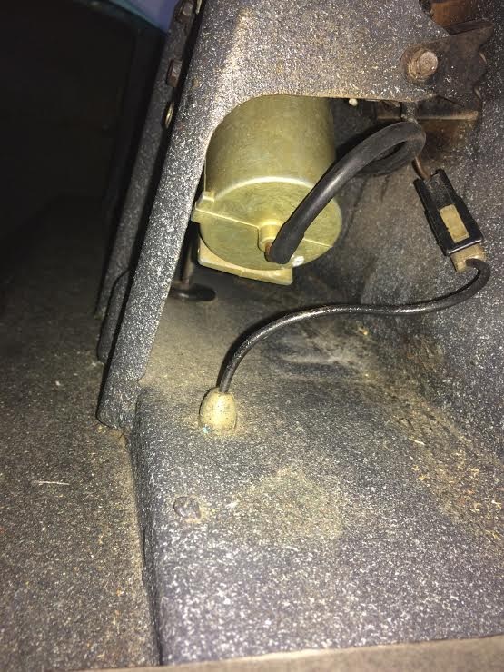

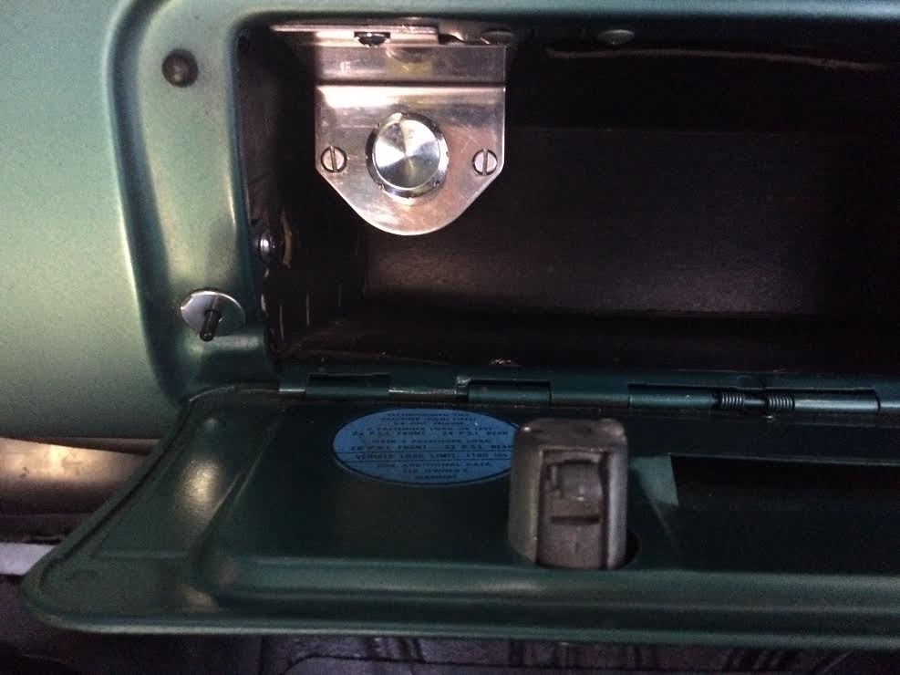

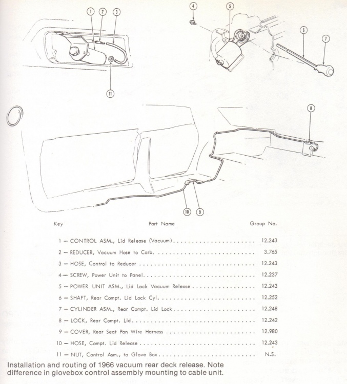

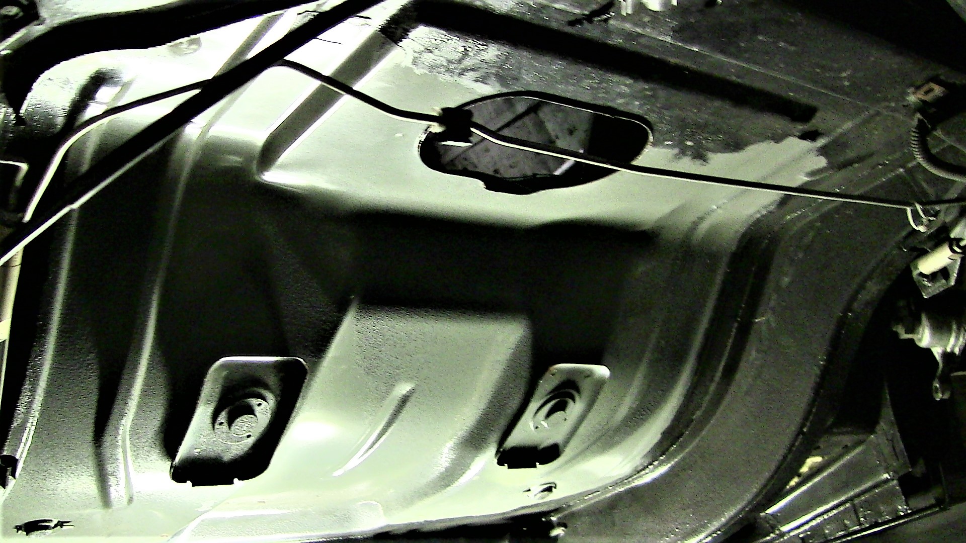

Well the weather had fallen back to normal and delayed my progress. However I was finally able to wrap up the VTR install today. The following is installation information for those who may want to install this in their 1966 Tempest/Lemans/GTO; This is a Factory and/or Dealer option referred to in the 1966 Accessory brochure as REAR DECK LID RELEASE option code 244 with a suggested retail price of $12.35 from the factory and $12.55 from the dealer. This is the second design over the first release option that was a manual pull cable, similar to the 1965 version. This Vacuum actuated unit was used in 1966 only. The 1967 release was a new power controlled unit. The system contains a glove box mounted vacuum canister "CONTROL" with a 3/32 ID vacuum hose/line approximately  6-8" long then to the reducer and increases to a 3/16 ID hose/line that runs along the passenger side of the floor and then under the rear seat within the factory wire protector/cover utilized for all rear accessories. There was no clear hose retaining guide, so I used HD cloth tape. The line then runs within the underside channel along the deck lid gutter over through the rear light harness clips and behind the latched support/bracket to the "POWER UNIT". This makes option #35 for my '66 and one that has been a long time coming. It is a very basic system that has amazing vacuum considering it uses approximately 23' of hose. Sorry for the long post but I just love the Factory gadgets :D

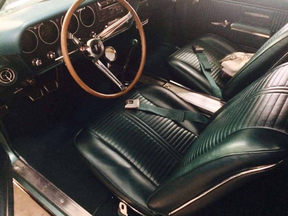

Patiently waited and finally the weather gods allowed me to get the interior back together, and to think this all started with a simple VTR :rolleyes:  A littel more detailing and ready to hit the road. The Season Opener is Sat the 1st and was beginning to think I would need some yellow caution tape.

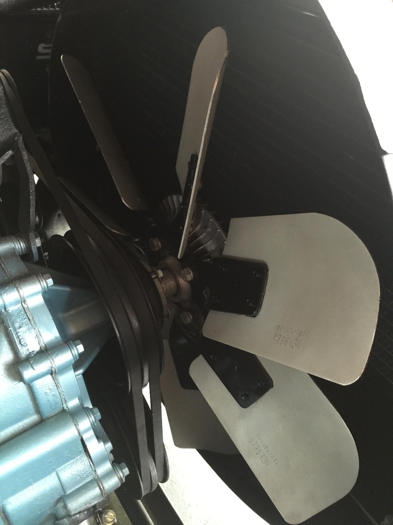

Made a new set of spark plug wires that wern't 6-8 inches too long.
Located, purchased, restored (sandblasted, repainted) an original radiator fan and clutch. Replaced a very noisy flex fan.

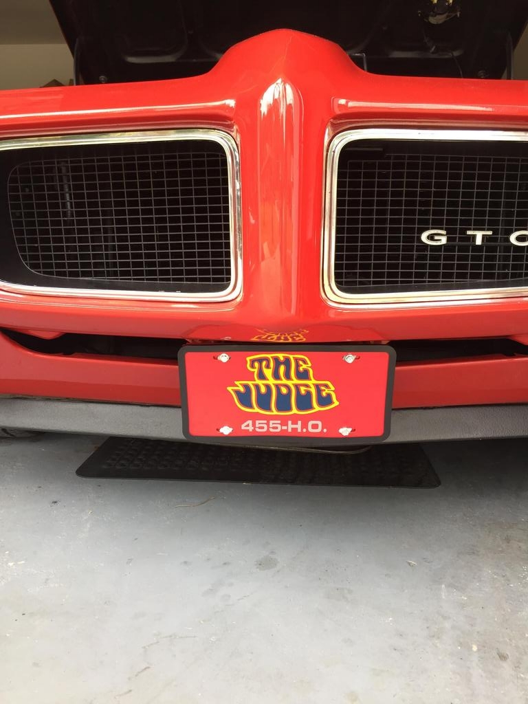

Bought all the brackets to provide a place to mount a front license plate and had them powdercoated. I installed a plate of my own layout and design.
fb896c77-a80a-449e-98d0-ea759b6edba9_zps
Just for looks, it was a rare option on the car as well. You gotta really love this restoration stuff, after all the parts, powdercoating, hardware, decals, and the plate my total ticket was close to $200 just to say I have a front plate on the car. lol. We gotta be out of our minds.
Between the inner valence support bracket that has the plate bracket mounts on it and the plate bracket itself, that's $100. $40 in powder coating, $40 in decals. $10 for the plate, $10 for mounting hardware. The good thing is, I got good parts and did the job right so hopefully I don't have to deal with it again. The fan, used, $60. My friend has a sandblasting cabinet and I just bought lunch for its use. some masking tape and a good black enamel, again, mounting hardware. So maybe $100 in the fan.

Thank you Steve. I really like the way this car is coming together. I purchased the filler piece that covers the space between the radiator support and the front nose to direct even more air thru the radiator. She ran around town all day at 185 degrees with the new clutch fan. Wither the old flex fan, Quieter, smoother running too.

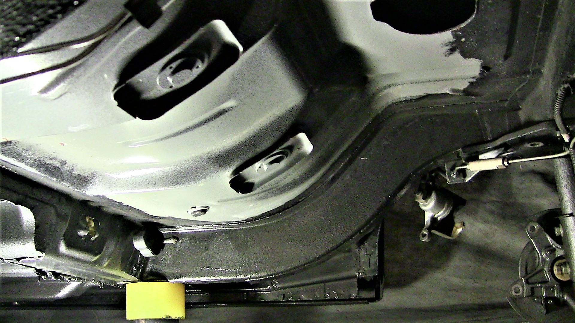

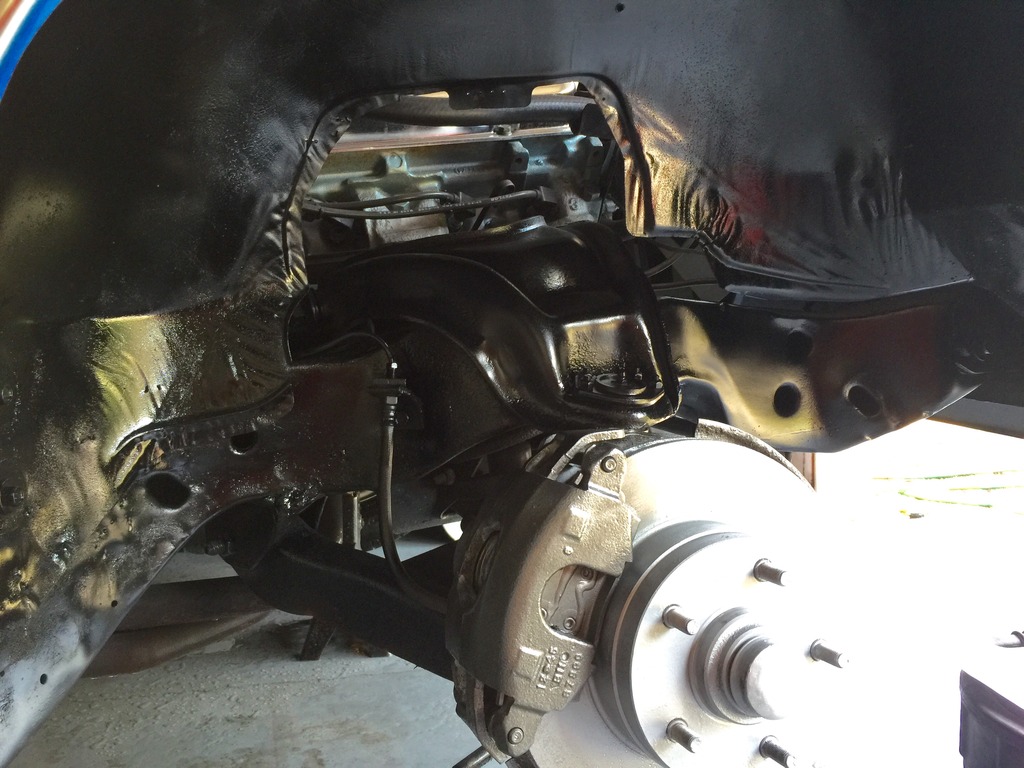

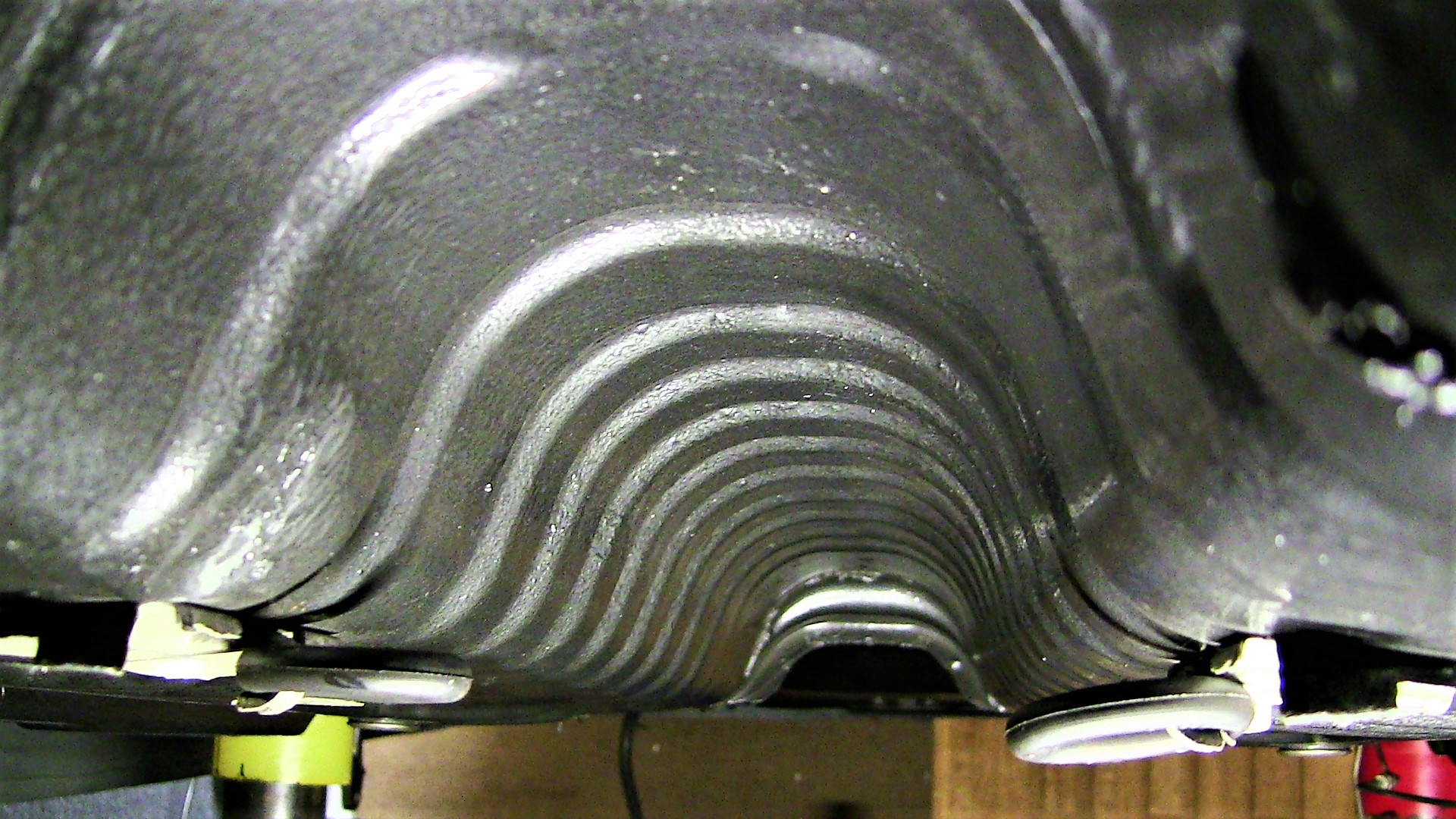

So back under the car working on restoring the chassis up to my standard so everything striped to bare metal, primered and recoated in some form of restoration paint. Rotors, calipers, frame, control arms, coils, sway bars, inner fender wells, etc.

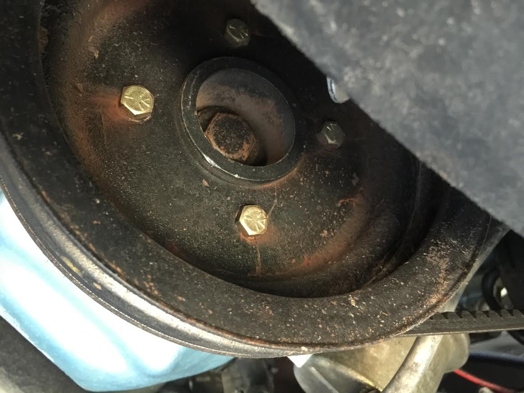

also discovered that elusive engine knock that has been kicking my butt for months, thank GOD it wasn't internal. A cracked lower crankshaft accessory drive pulley. Wrong bolts and no reinforcement ring used caused cracks around 3 out of 4 of the pulley bolts. This will be another upcoming project after I restore the other fenderwell and order a new pulley.
