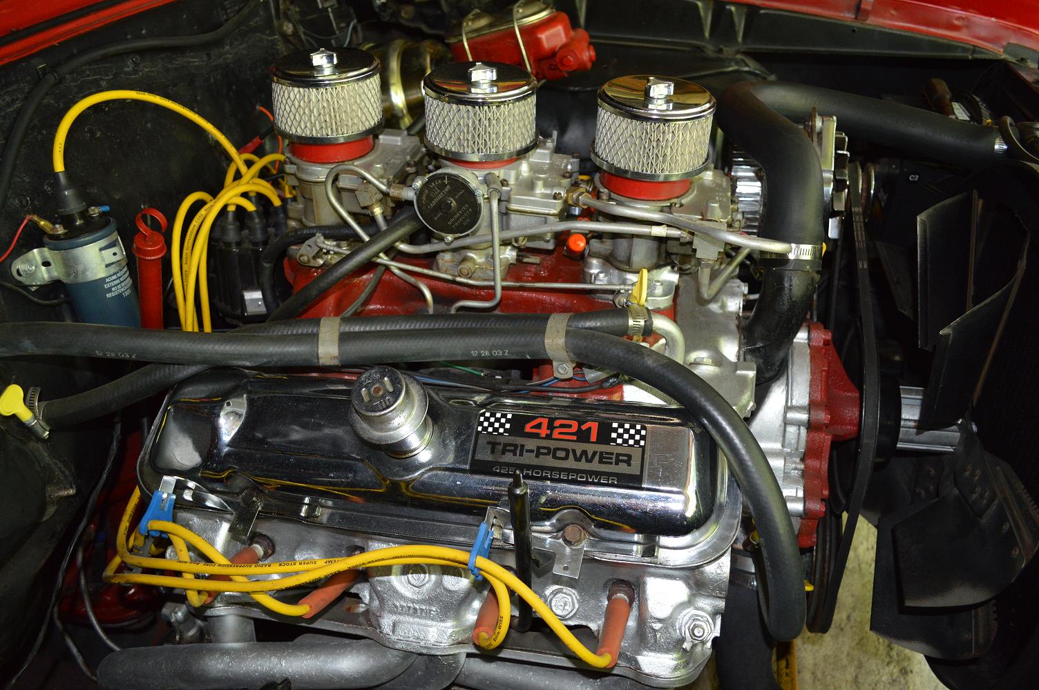

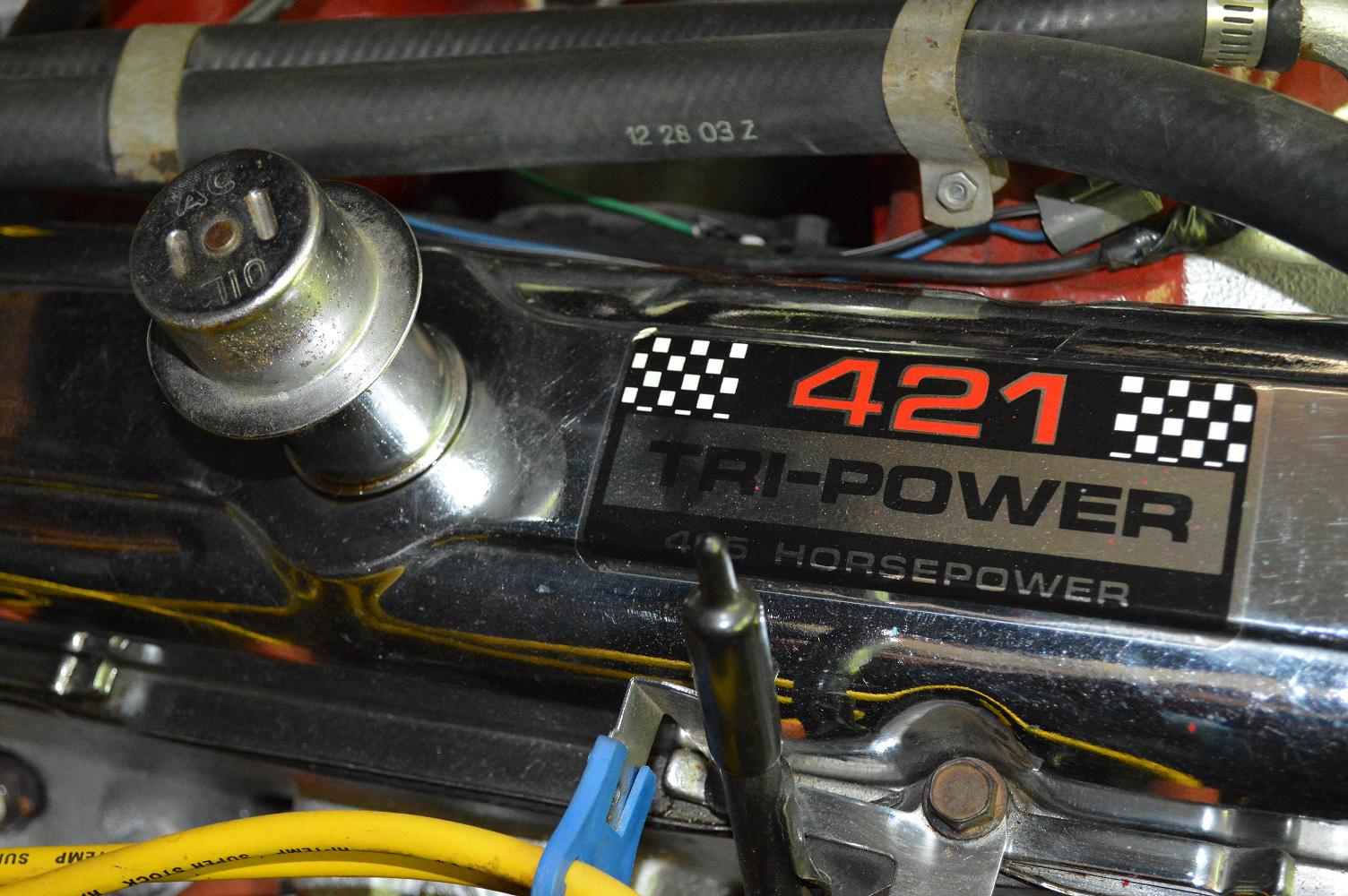

File this under WTF.   So my 421 has the original chrome valve covers.  One side has a plug in the breather hole.  1 inch.  This has been loose and leaking oil, dripping down and discoloring my exhaust manifold.  After sanding/repaint the exhaust, I took a small rubber band, twisted it once around the plug pulling it tight and stopping the leak.  So after arriving home after the show yesterday, I popped the hood to find oil on the bottom of the hood, and a noticeable missing plug in my valve cover. Lost it on the way home.  Question is....how much rubber material is on the backside of this plug?  Pulled the valve cover and cleaned the entire head and no trace of rubber anywhere. So did the plug pop out in one piece? or did it split leaving the backside of the plug inside my motor?  OPG sells a replacement, but only shows the top side.  Looked everywhere for the missing plug, but must have made it to the ground.  Backside of the V cover has a sharp edge the plug is suppose to seat against. I'm leaning towards a smaller LIP to hold it in VS the wider outside top of the plug.  Seems to me like anything 1 inch would have gotten stuck in a return passage in the head if it indeed split in two.
Steve you can build positive crankcase pressure and have enough of it to launch a valve cover plug if there is no other way for the crankcase gases to escape the engine thru another purge elsewhere. The crankcase pressure is usually caused by some enivetable blow by the rings. I run an oil cap on drivers side and a breather on the passenger side. I'm pretty sure on some valley pans there is a provision for a PCV valve as well. Jim Butler of Butler Performance will tell you "breathers are for tractor motors" but I'm sure you have to have some type of system to evacuate crankcase gases.
When I first bought the Pro Street blown Trans Am, I had a bad issue of pushing oil out of the valve covers and on to the headers at Boost and high RPM's to the point it looked like a mosquito fogger or smoke machine going down the road. I had to run  3/4" hoses from the valve cover breathers on both sides to welded bungs in the collectors of the headers to let the exhaust form a vacuum on those hoses to pull the crankcase pressure from the engine because at boost there is no vacuum to pull the noxious gases from the crankcase.
Edited by 360Rocket
ALL ENGINES have some blowby past the rings.  I have a PCV and the oil fill is also vented.  Never had that much pressure, plug was so loose you could move it around in the hole. Just enough to get the area wet around the plug and would eventually drip on my exhaust manifold.  I'm thinkin it wore out the inside of the plug after all these years and when I added the rubber band it was just enough to pull the plug up tight to the bottom of the valve cover.  LIL extra pressure and bye bye.  Glad it did it on the way home. Took the engine pic at the show.  I was worried about how much rubber might have come off N in my engine, but looking at OPG, Ames had a better pic of the plug, they showed me at the local parts store. As it's only 1 inch hole, it was never ment for a breather. Breather was my option going to the parts store, if they didn't have my plug. They had a correct 1 in plug, but its plastic.  They gave it to me to get me through til I can get a rubber one.  Once the plastic gets good N hot, can't see this lasting long so I put a thin layer of peratex to help hold it in for now. Shipping would be waaay more than the cost of the plug, so I need to make an order and knock some more stuff off the wish list.

My PCV is in the back of the intake, the oil fill is also a breather.  Nobody seems to make a 1 inch breather. Was my alternative choice going in)  All Pontiac listings have an original or aftermarket (rubber) plug.  Can't see this plastic working for very long, but don't have plans to take the car out til after the holiday.  Thank you for the offer bro.

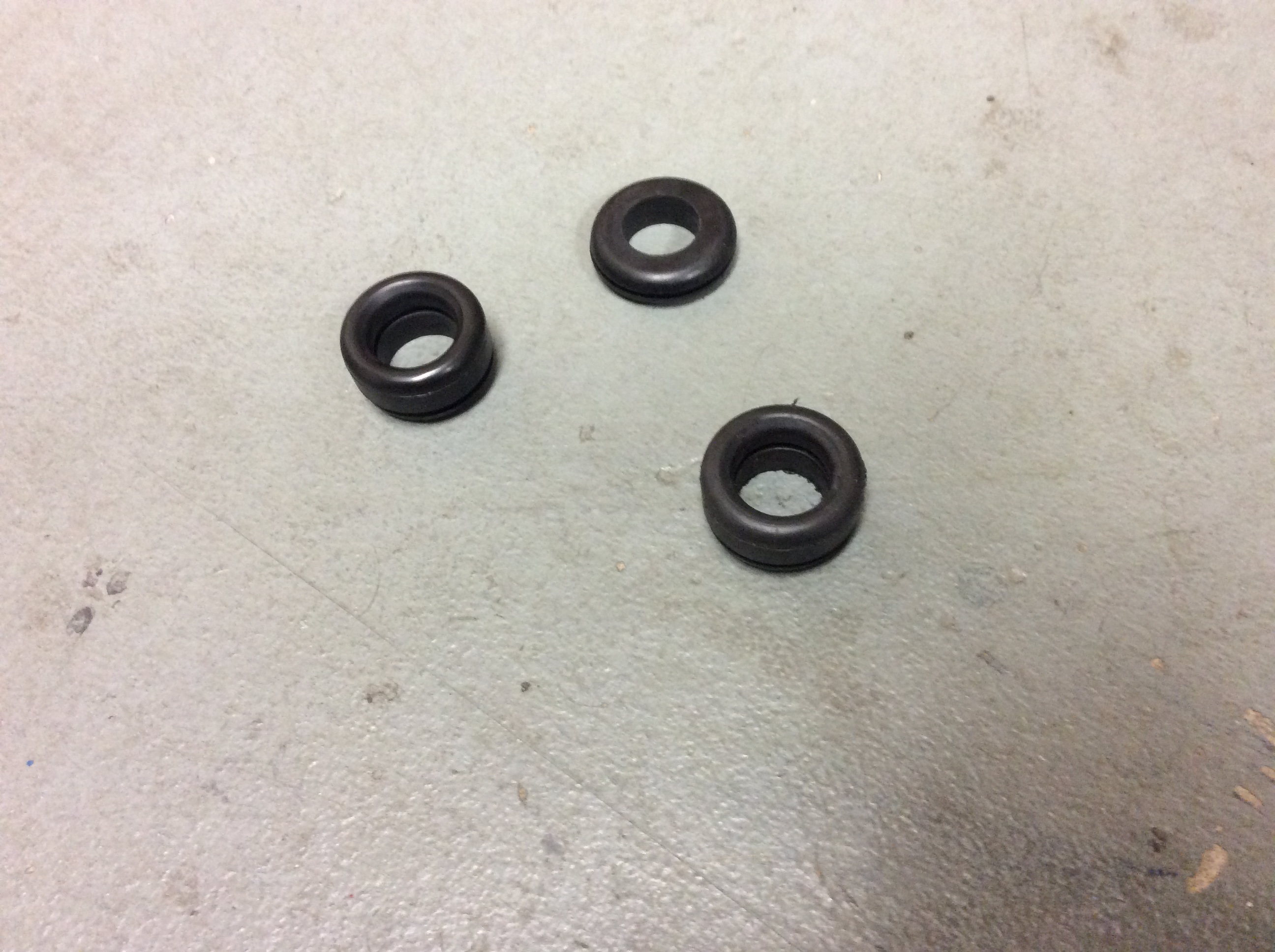

The ID of the hole is 1 inch. There are no 3/4in breathers, like you said, on some setups maybe a PCV would fit in there.  Here's a pic of the oil fill and vented cap. I put a wrist sweatband on it to soak up the oily air that leaves a film on the cover after driving. I ordered the correct plug from Ames.  Thats what it has always been in it.  With the Tri power small filters adding something else is JUSTA clutter.  Wouldn't be clean and even like your motor pic with all the beautiful goodies. That air filter is so cool.

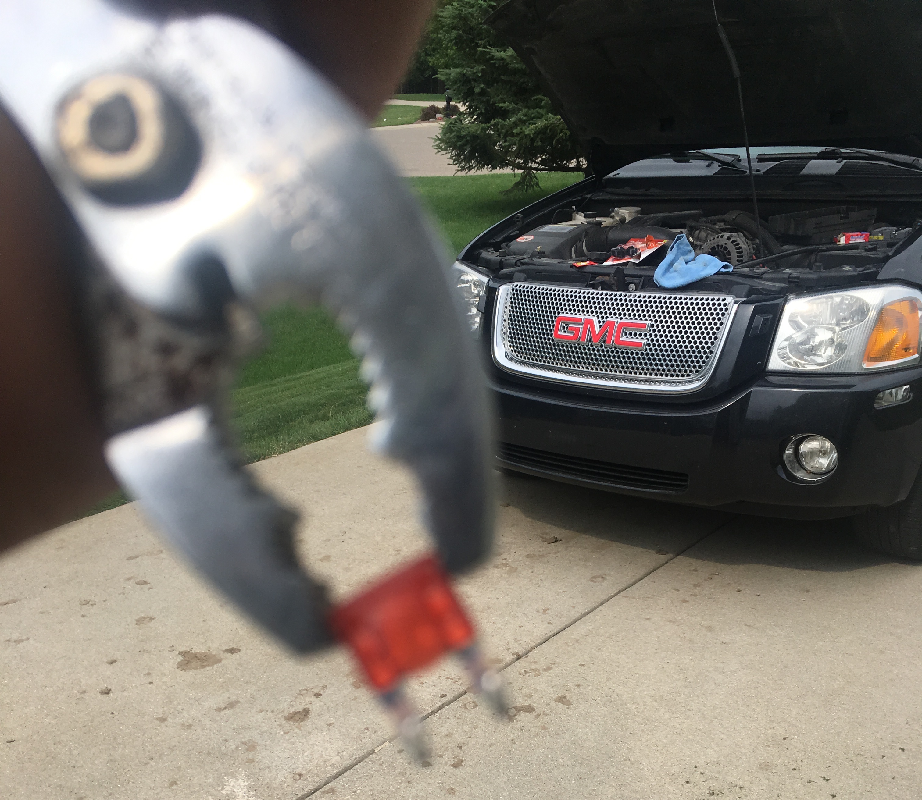

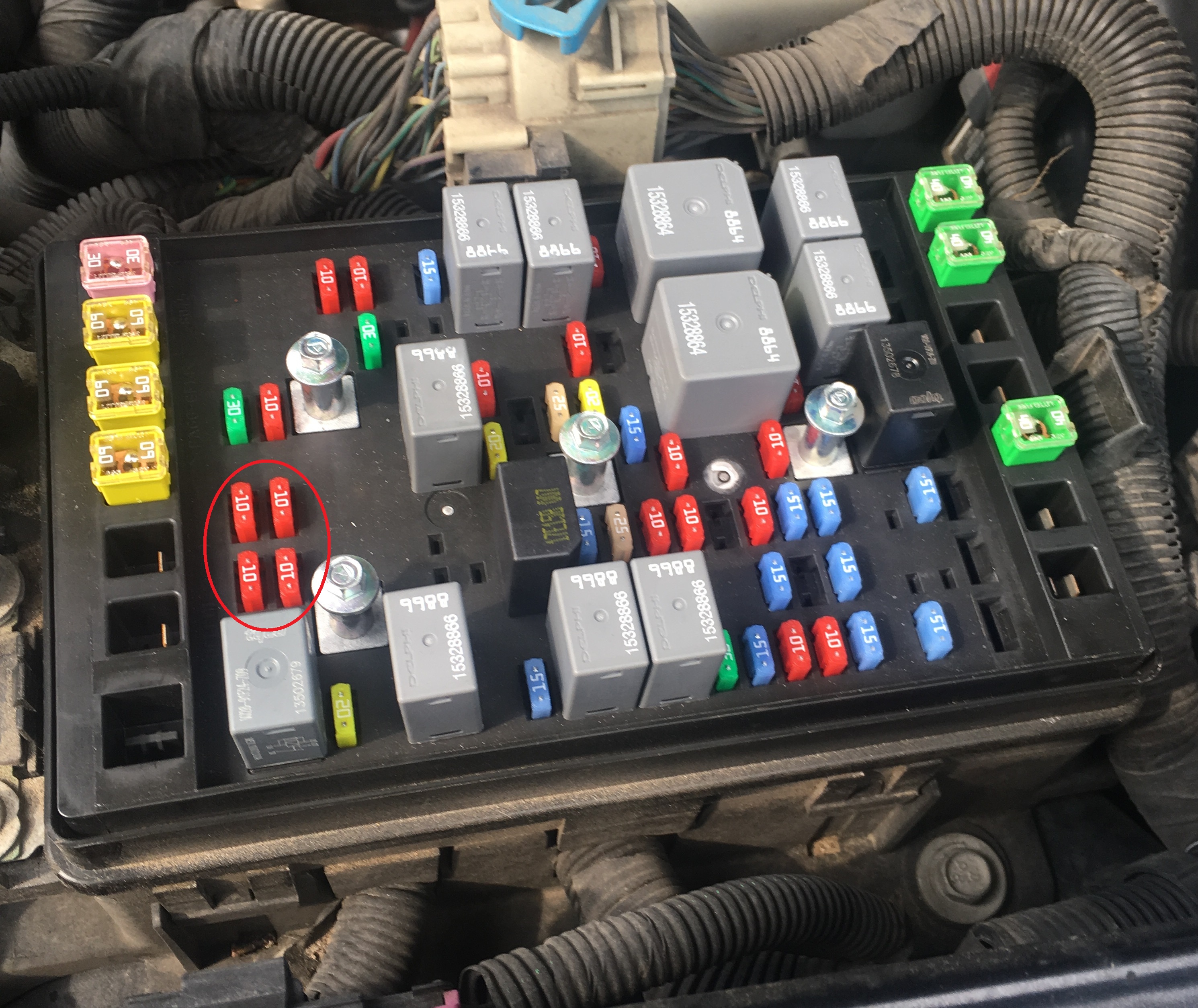

I had an interesting problem develop last night with the Black Beast, my 2008 Envoy Denali. I was visiting a buddy of mine. It got late, I jumped in the Envoy and started the thing up and I noticed I had no low beam  headlights. I had high beams but no low beams. Hmmm....odd. It's not impossible to blow both headlight lamps at the same time but it is highly unlikely too. I just replaced a burned out tail light earlier last week too.
So I run up to Autozone this morning and purchase two new 9006 bulbs. I install the first new buib and tested  it and it's not working either. Oh oh, it's not necessarily the bulb then. Something else is probably wrong.
I opened the fuse panel, which is in the engine bay. There are 4 fuses for the front high and low beam headlights. I circled them in red in the picture below. I pull and check each one. They were all good.
The fuses were all good - sorry for the fuzzy picture!

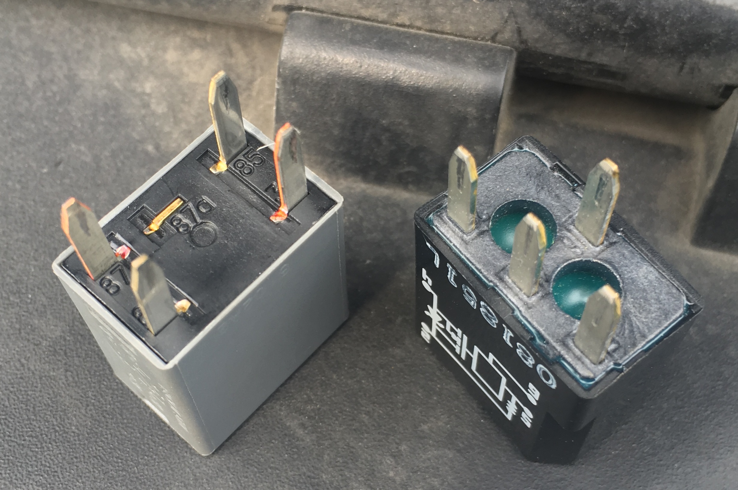

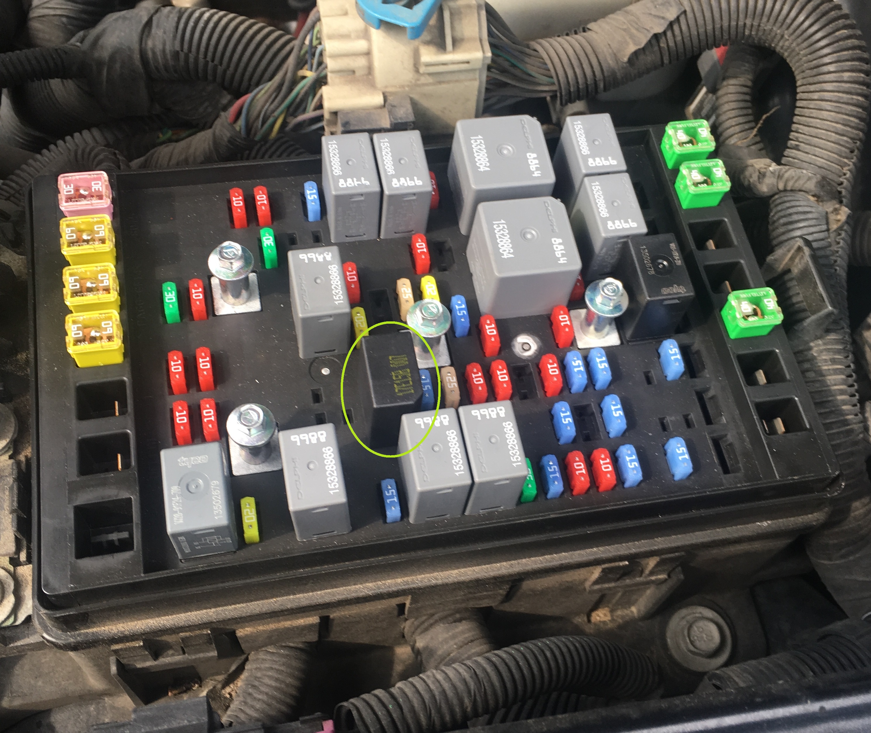

I remember reading something about Trailblazers and Envoys using solid state relays (SSR) to manage the Daytime Running Lights (DRL) with the BCM. I checked the panel. There is only one SSR listed in the fuse panel legend. Its located at the green circle. One panel legend is says it is the HDM relay.
While there are several relays in the fuse panel, you cannot interchange the gray relays with the SSR ones. They have a different pin layout as you can see below.

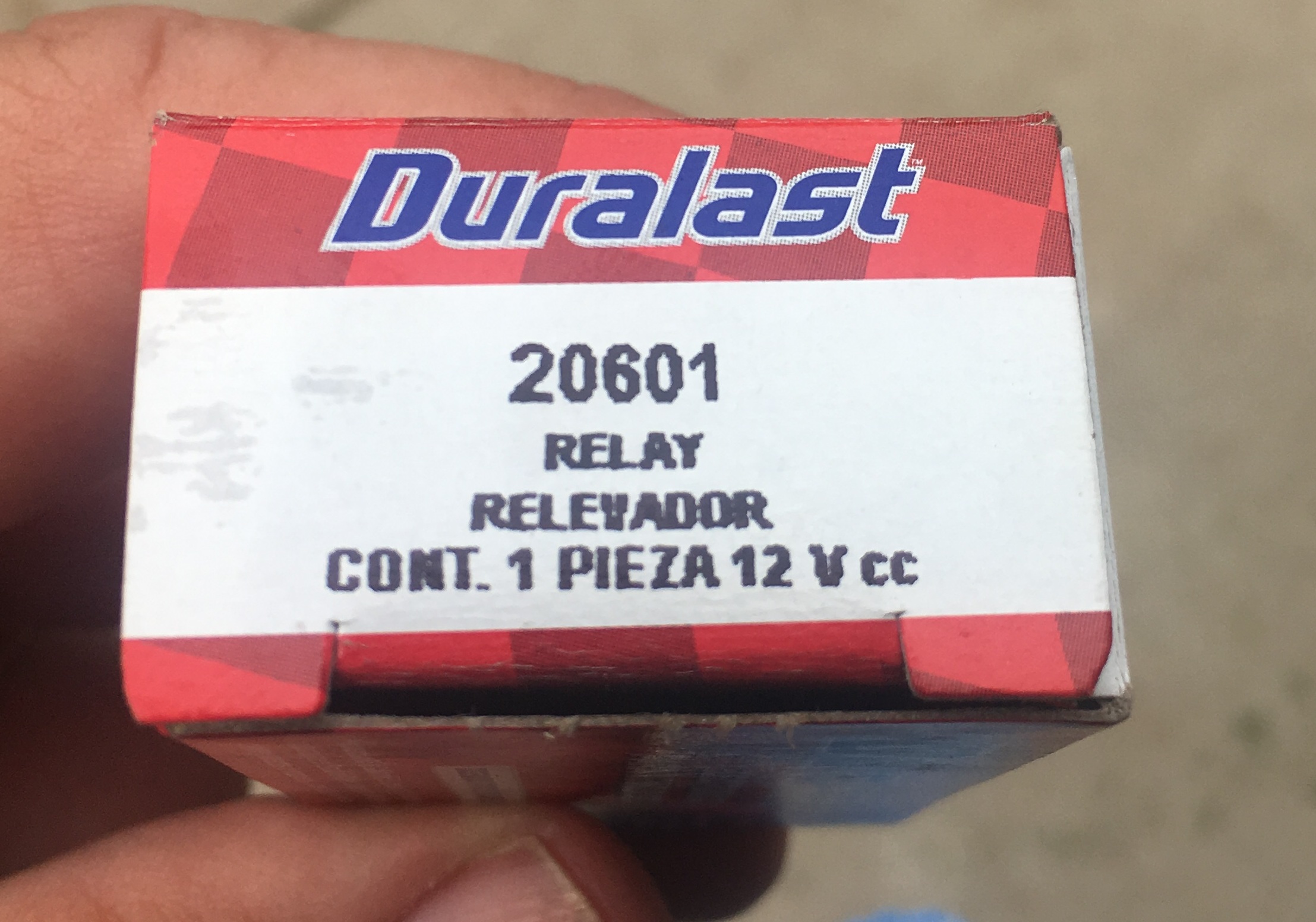

I ended up back at Autozone and ask the guy for a new SSR relay. His computer tells him that he has to special order this relay and its going to be 2-3 days before he gets it in, and its a $40 part. This angered me a little. I said "Look up Duralast part # 20601". He did, he had two in stock. It shows for a 05-06 Trailblazer radiator clutch fan relay. Guess what, it is the same relay. The Trailblazer used two SSRs, one for the low beams and one to manage the operation of the radiator clutch fan. The Envoy only has one for the low beams.
The attendant said he was going to have to remember that part number.
Oh, and the best thing was the part cost $26, not $40. I put it in the relay slot outside Autozone and. voila, I have low beams again!!!!
