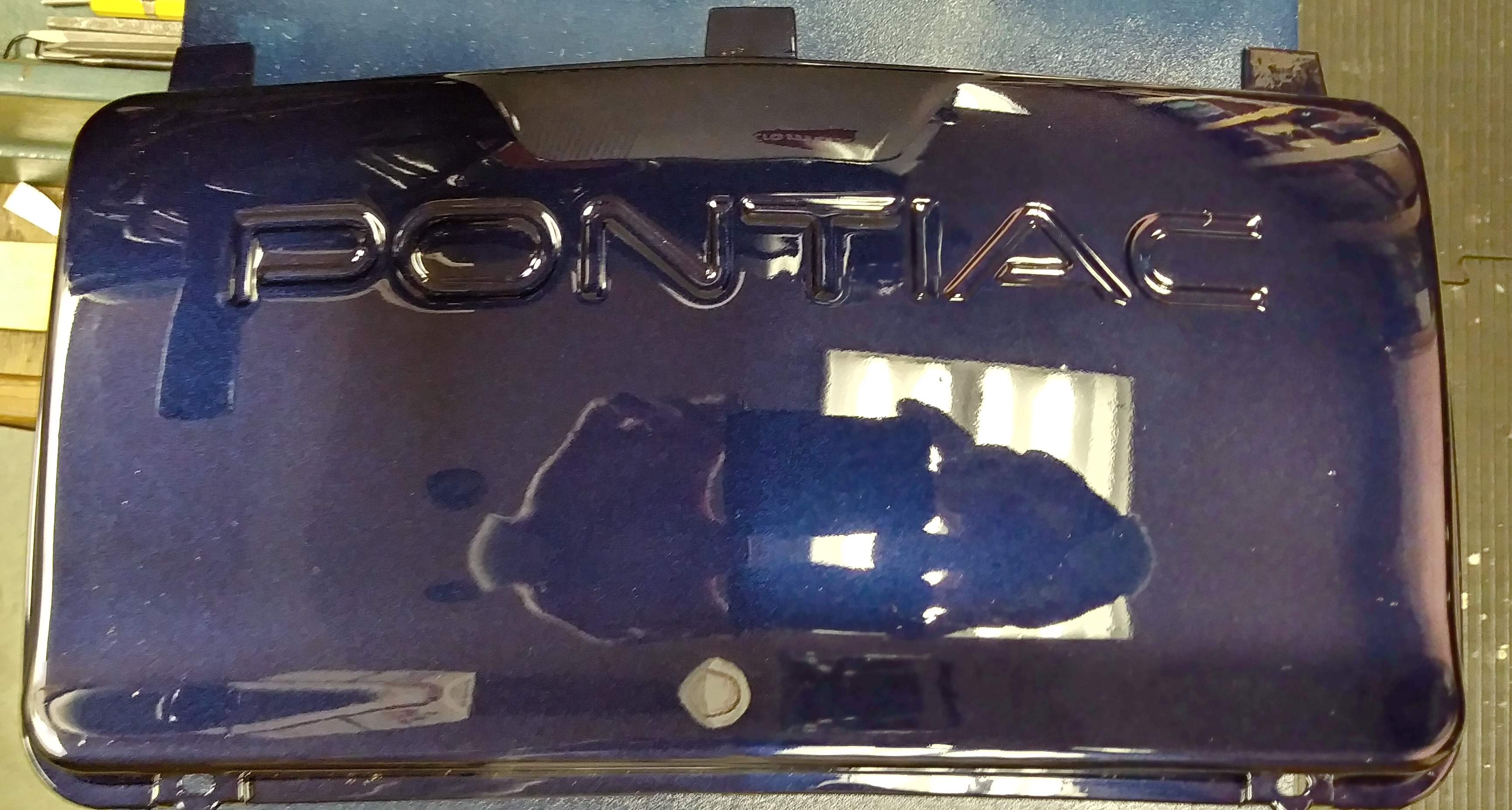

  • Did some light painting

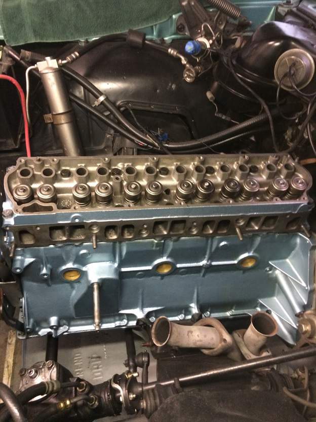

Sadly I wasn't able to wrap this up before the local SPRING DUST OFF Show 😞 First time in years I've missed it. However I am underway with the reversing process...

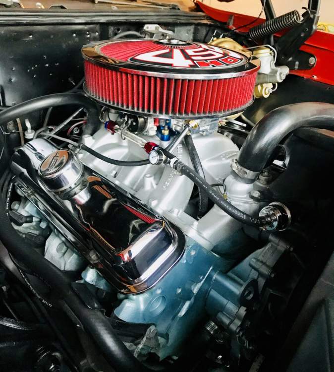

Cleaned up, dailed in, running smooooooth. Will change out that fuel injection line soon for something braided I'm sure but for now it feels good to drive her again.
Looks great bro.   Glad it's runnin better.

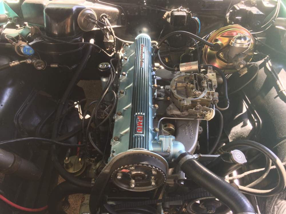

Went for a Drive!  Still a few bits to finish up, but all the big ticket items are behind me...
