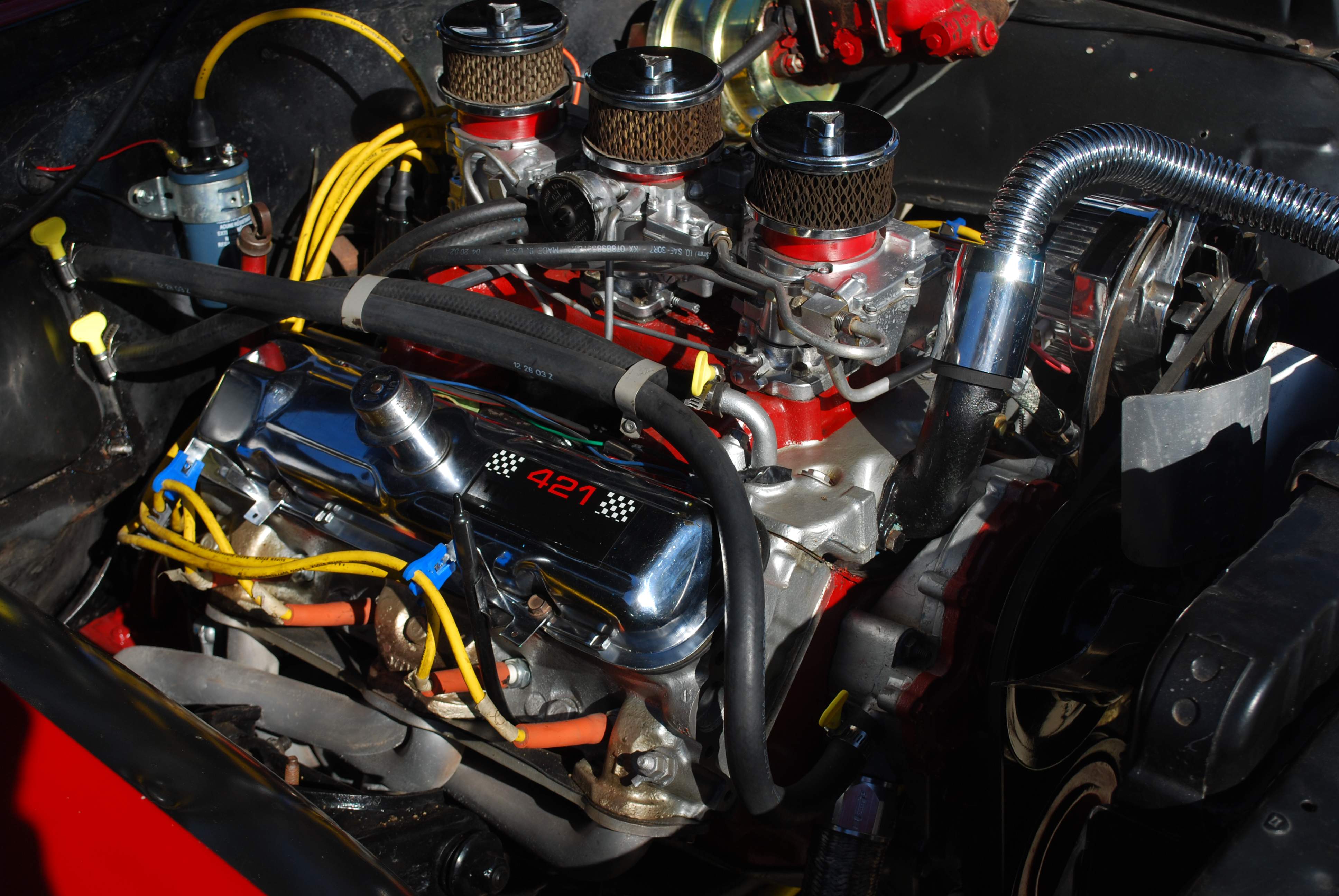

You don’t need to go expensive with the wire looms. Just something that allows you to keep the wires where you what them, but I would suggest plastic ones. Using metal ones can cause a shorting between wires when interconnected. Especially when rpms increase! When rpms increases resistance for the spark can increase. This resistance can sometimes jump through the insulation of the wire taking the path of least resistance, the metal wire loom, causing a basic short to the other wires!
While this is a completely different setup than your here’s what mine looks like.
Excellent advice. I was looking at the metal looms just because they look cleaner. However, your point about path of least resistance is a reason to pause.
Not the best pic's, but mine are chrome with plastic/rubber looms on the ends that hold the wires.  Never had a prob.

Yup! Those are good, the plastic heads insulate the wires from ground!

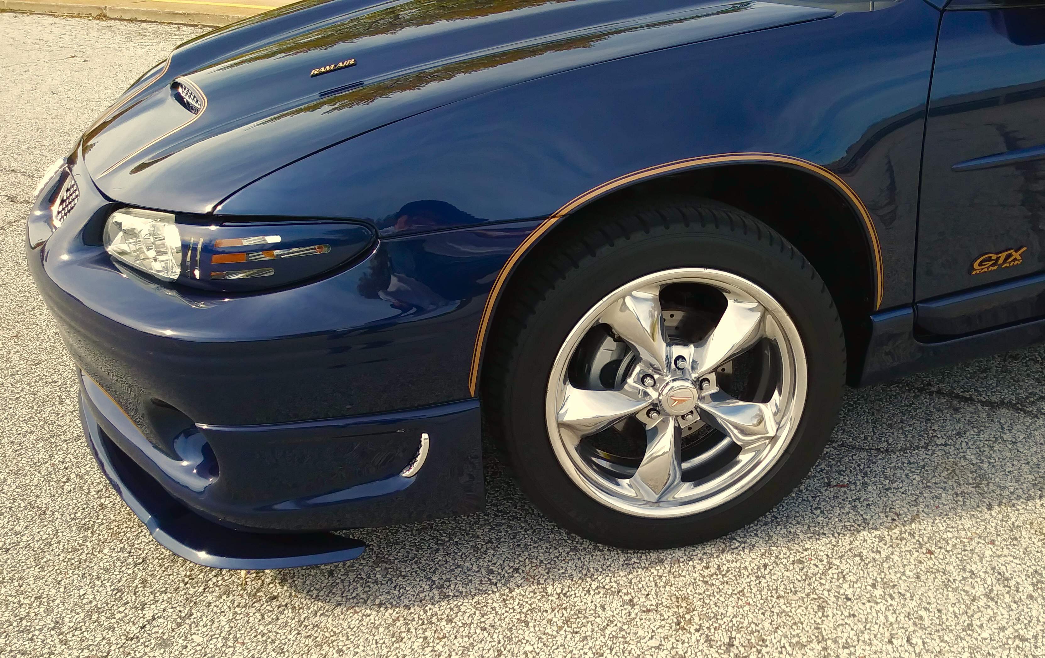

Well, picked up my new front cover from my favorite GM dealer! Great guy I’ve dealt with them for 34 years and have always gotten me what I needed, even in a few cases where it was the last part in North America that was sitting at a dealership in Pureto Rico, literally!
So what is the plan for this piece?
Well it’s one of those things you can’t put your finger on, at least not yet! Not till I get into it. I have a basic plan, but it will develop into a concept as I get into it a little further.

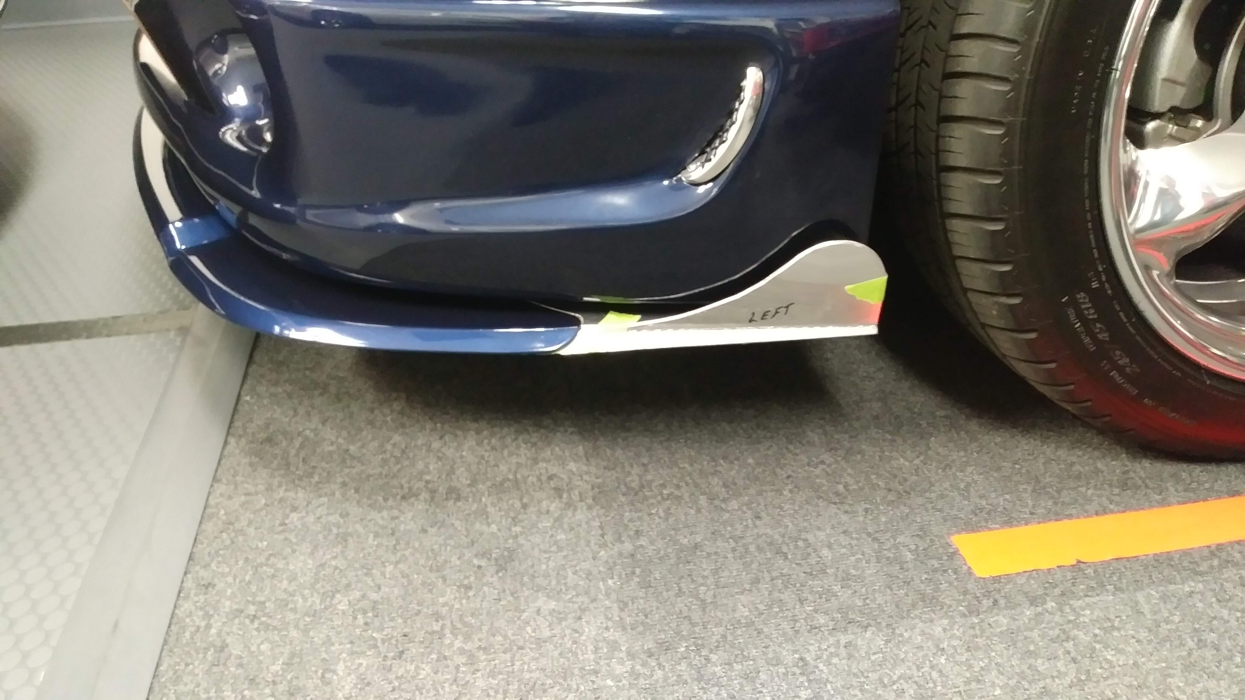

The gist is, while, again I can’t put my finger on all of it there’s just something lacking in the current front cover/Kaminari add on piece & the splitter. The splitter I know! It just looks incomplete, lacking, just kind of hanging in space. That I’ve already started to address, see pics! One of the things I did recently, while not necessarily obvious, without comparing photos. Is I cut down the center stanchion as well as the end stanchions, you can’t see those very easily. This helps to tuck the splitter up tighter to the cover bottom. You can kind of tell when you look at the pictures with the add on piece vs the picture the says current. The front cover/Kaminari piece I have yet to completely conceptualize yet, but it will be different than the other, especially the side Naca ducts.
Current splitter look is below.
Edited by Last Indian
Was thinkin it was perfect before, but it really does need the end cap for the splitter.   Dangit...droolin all over the keypad JUSTA staring at your pic's.
Yup! It does! Also at this point, the NACA duct that comes from the Kaminari add on, which overlays the OEM cover I plan to enhance the ducts and make them functional. That whole area on the lower side of the cover/Kaminari add on & the splitter become a low pressure area. Which in turn should become ideal for even a better Ram Air!

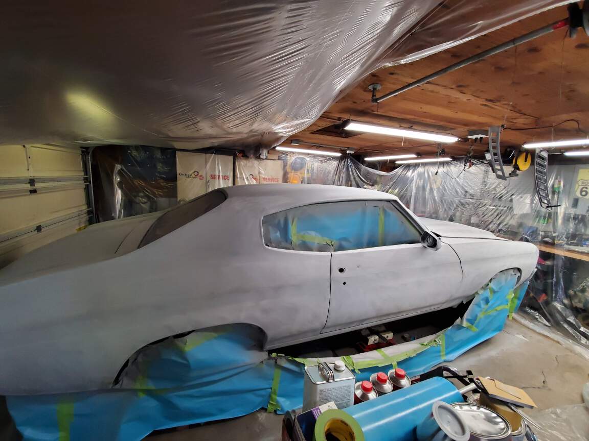

So pretty much this is how my car life is going,
Mask off everything
Sand with 220
Blow off car
Dust wipe
tack cloth
final prep wipe/ degreaser
Primer sealer
Blow off car
Dust wipe
tack cloth
Primer surfacer
Blow off car
Dust wipe
tack cloth
Sand with 400
Primer sealer
Gonna be sanding with 1000 grit and remasking the car ready for paint.

Blow of car?  Must be habit forming you seem to do it alot.
Great job buddy. It's nice to see the FrankenChevelle all one color....Canadian grey, eh?
