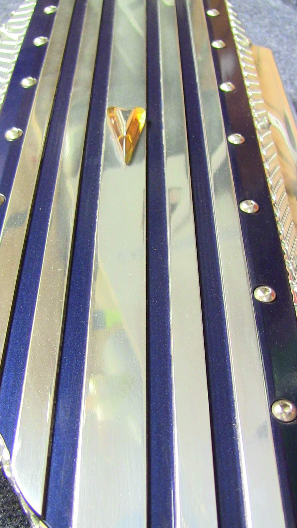

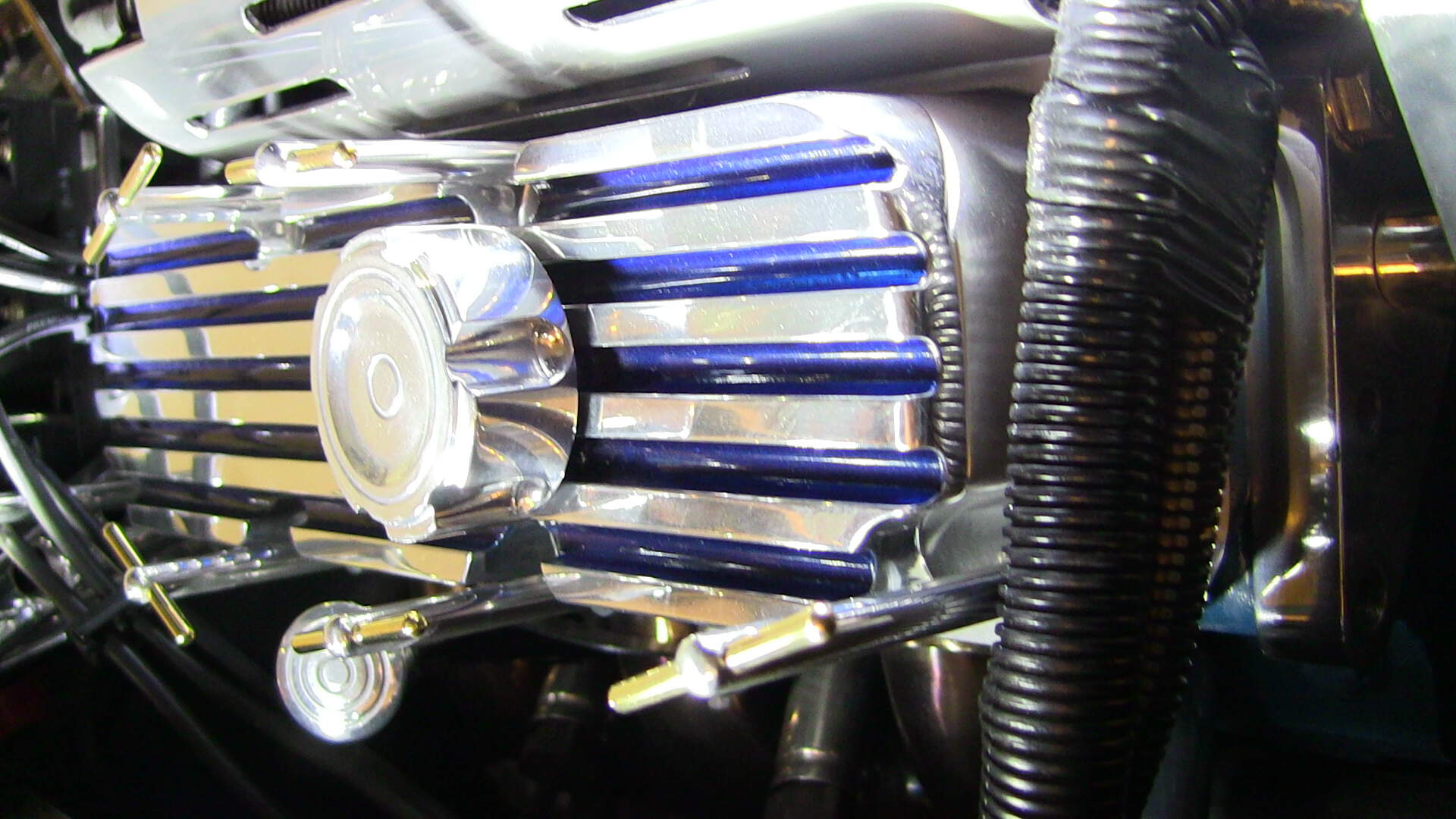

the mind boggles with what you will create with this simple slab of metal Last Indian 👍:cheers:

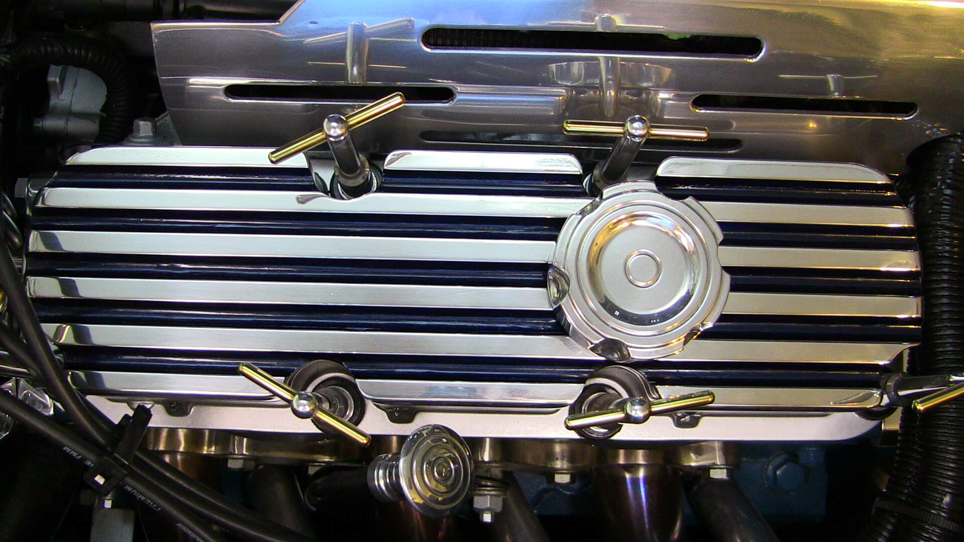

Well when I built the valve covers for the 3800 on the Indian I had the right stock, but when I built the plenum cover I didn’t! So I made do with what I had. So now I will design and build a new arrangement! Not sure what it will look like yet, but it will be different.
The valve covers have a deep fin, a more traditional look.
the plenum cover is very shallow. Not the same kind of look!
Edited by Last Indian

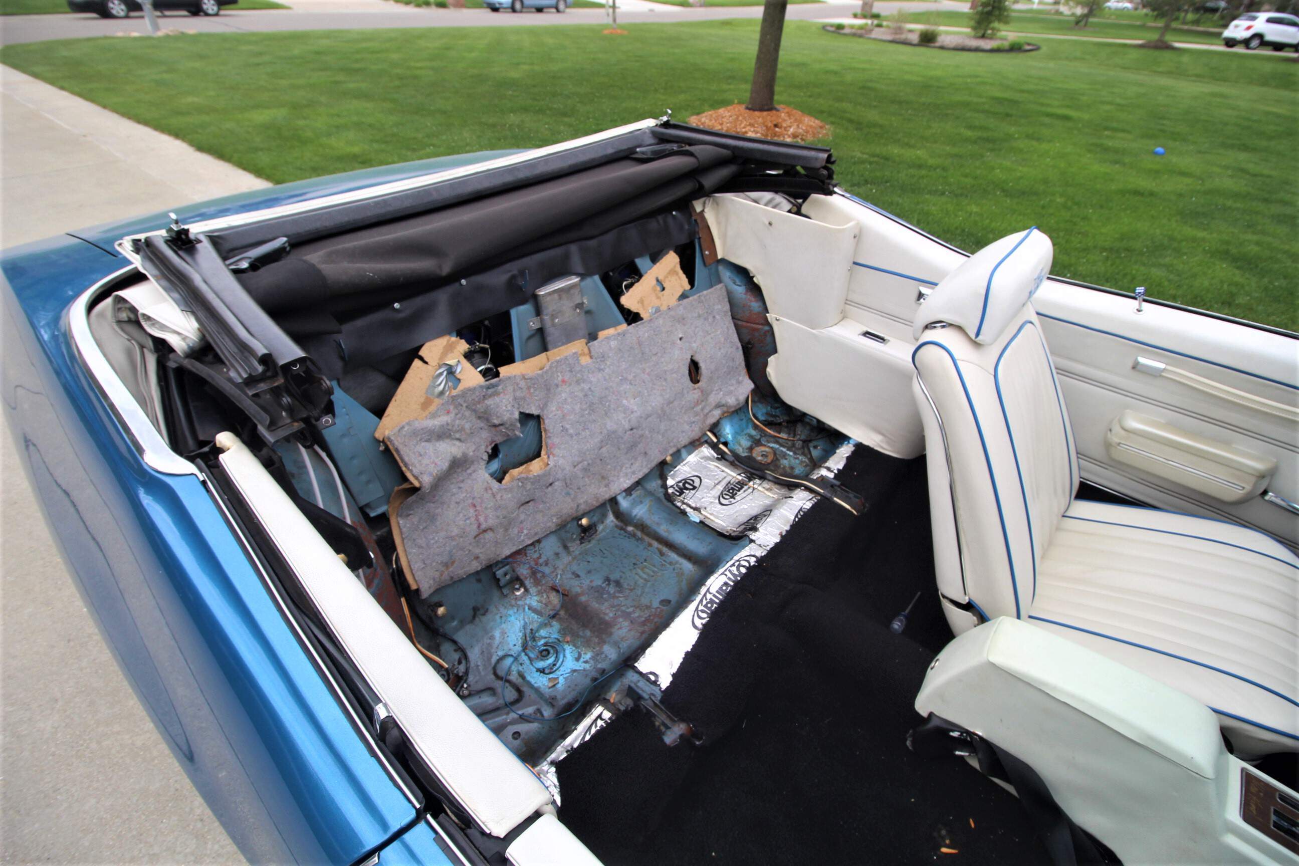

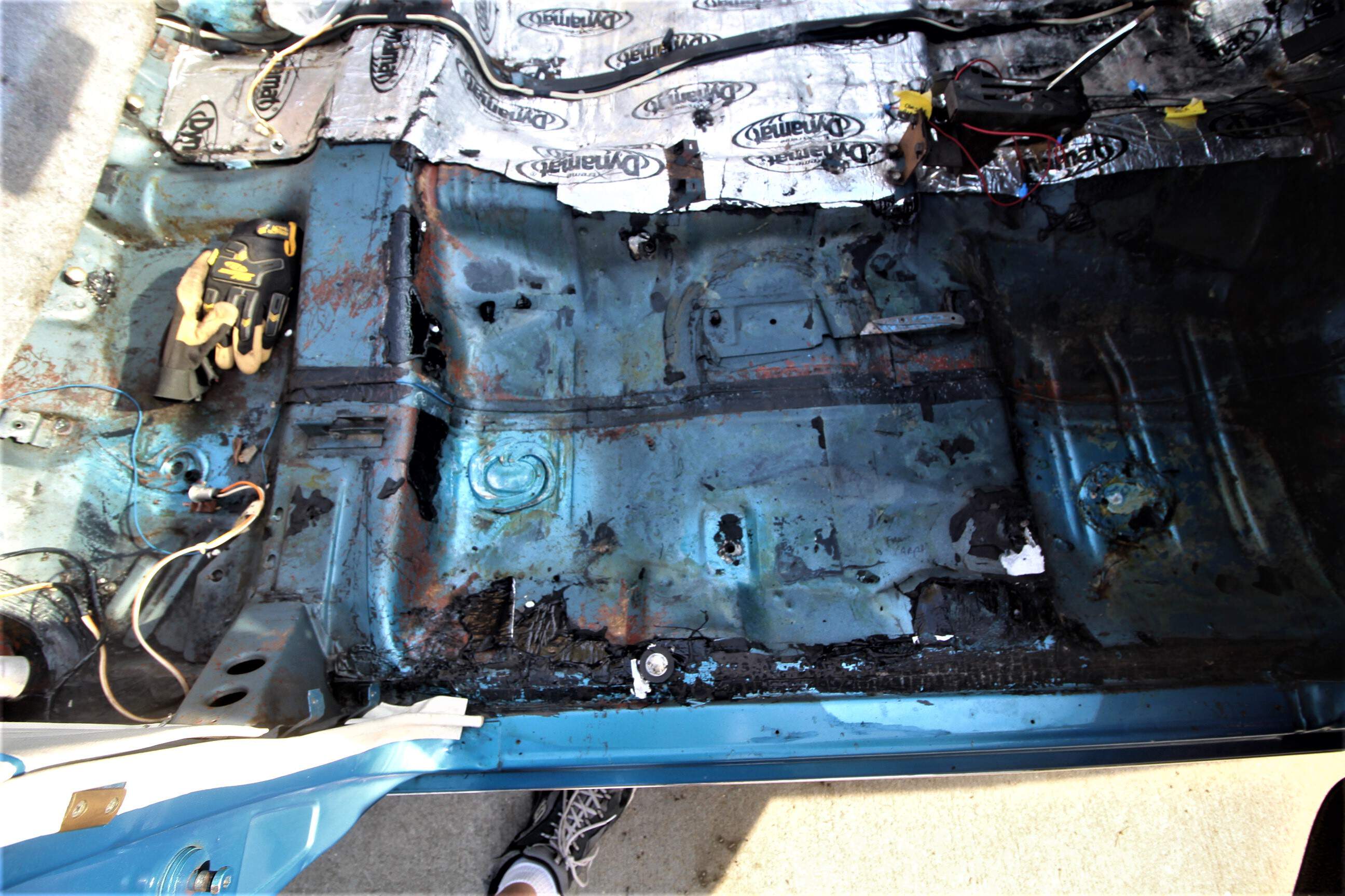

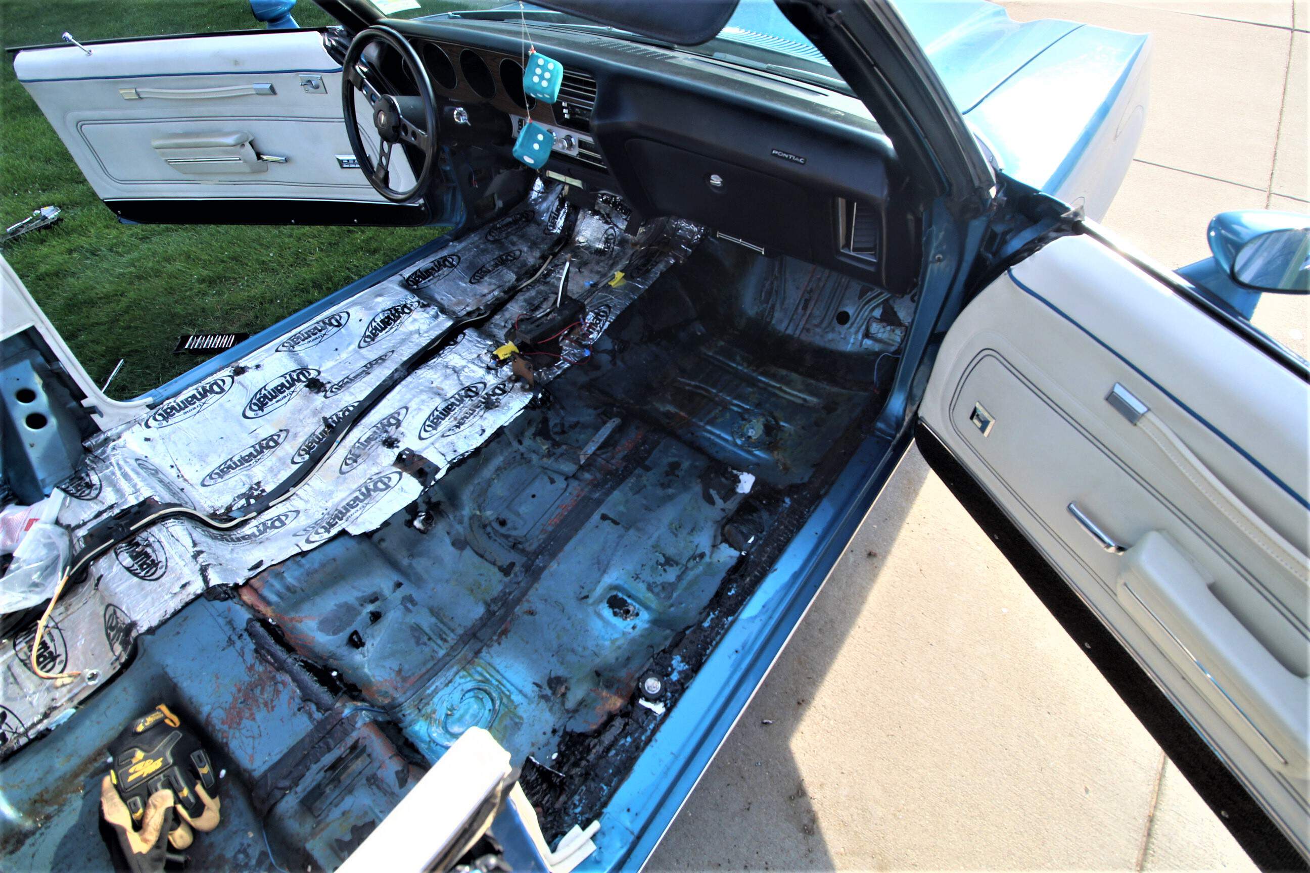

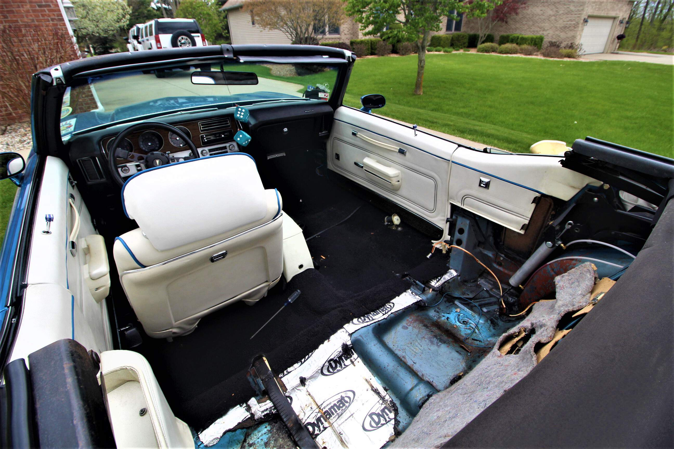

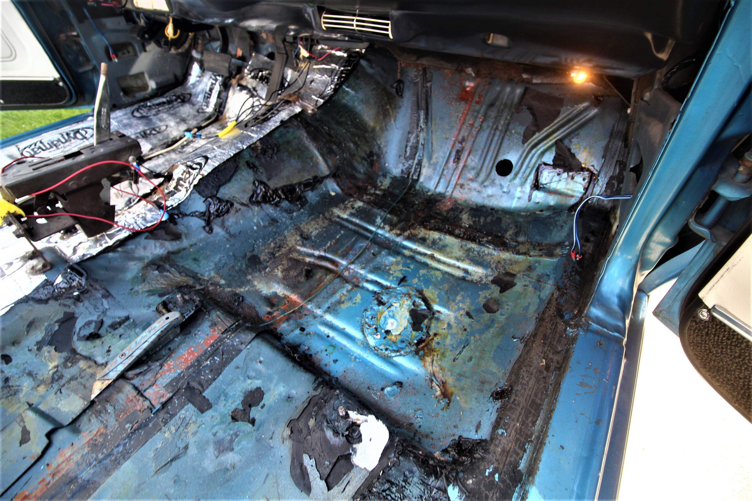

Well guys, I torn into Lucy with a tad bit of vengence today. The boy help me immensely too. I got the back seat and front passenger seat out last fall. Today, I got all the front seat belts out, the driver's seat, the fire extinguisher, the console. I had to loosen the shifter long enough to get the carpet out from underneath it. I bagged and tagged all the screws and small parts like I always do. Finally up came the carpet. It was still damp! WTF?

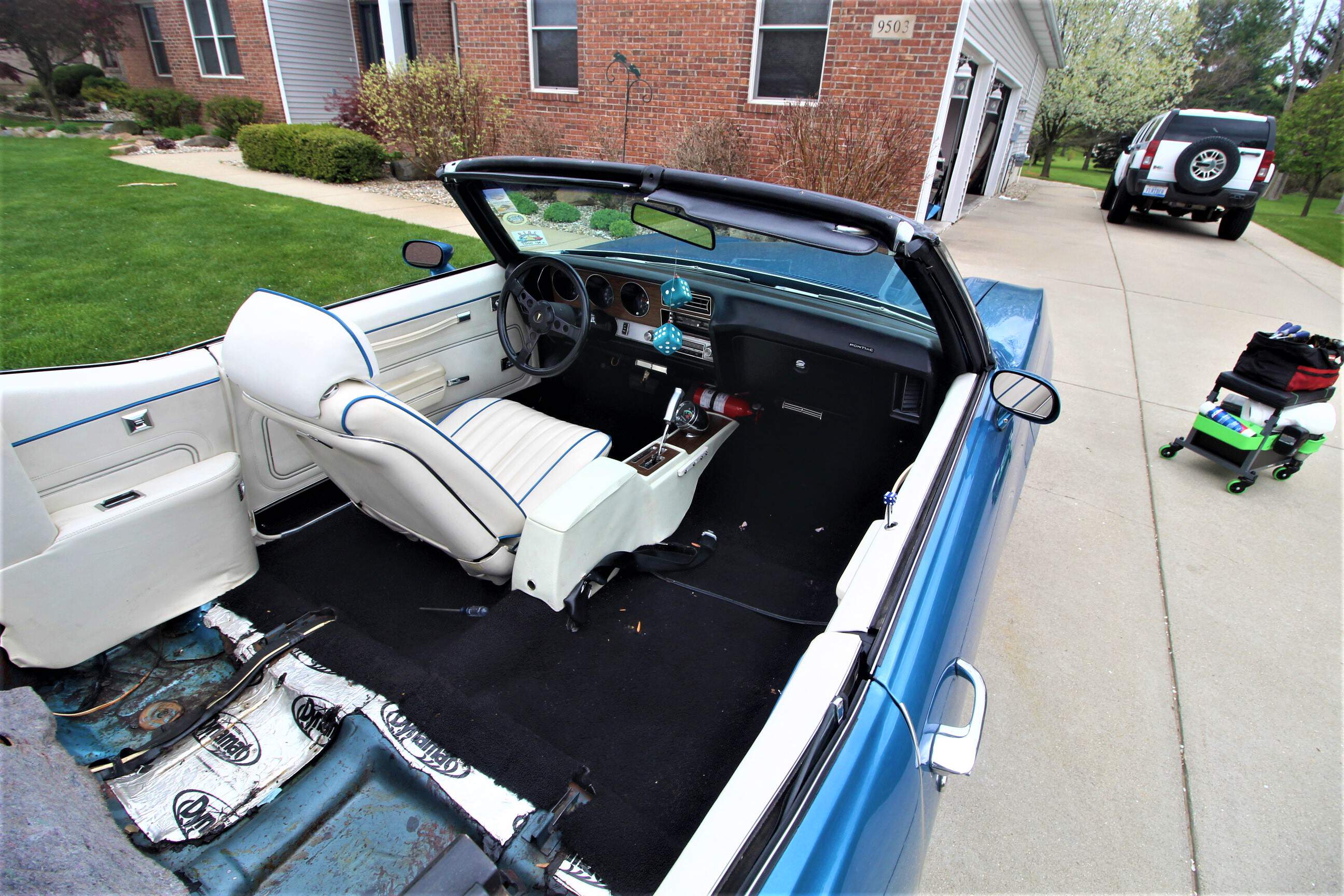

Here is how I started the day:
Next out came the carpet.

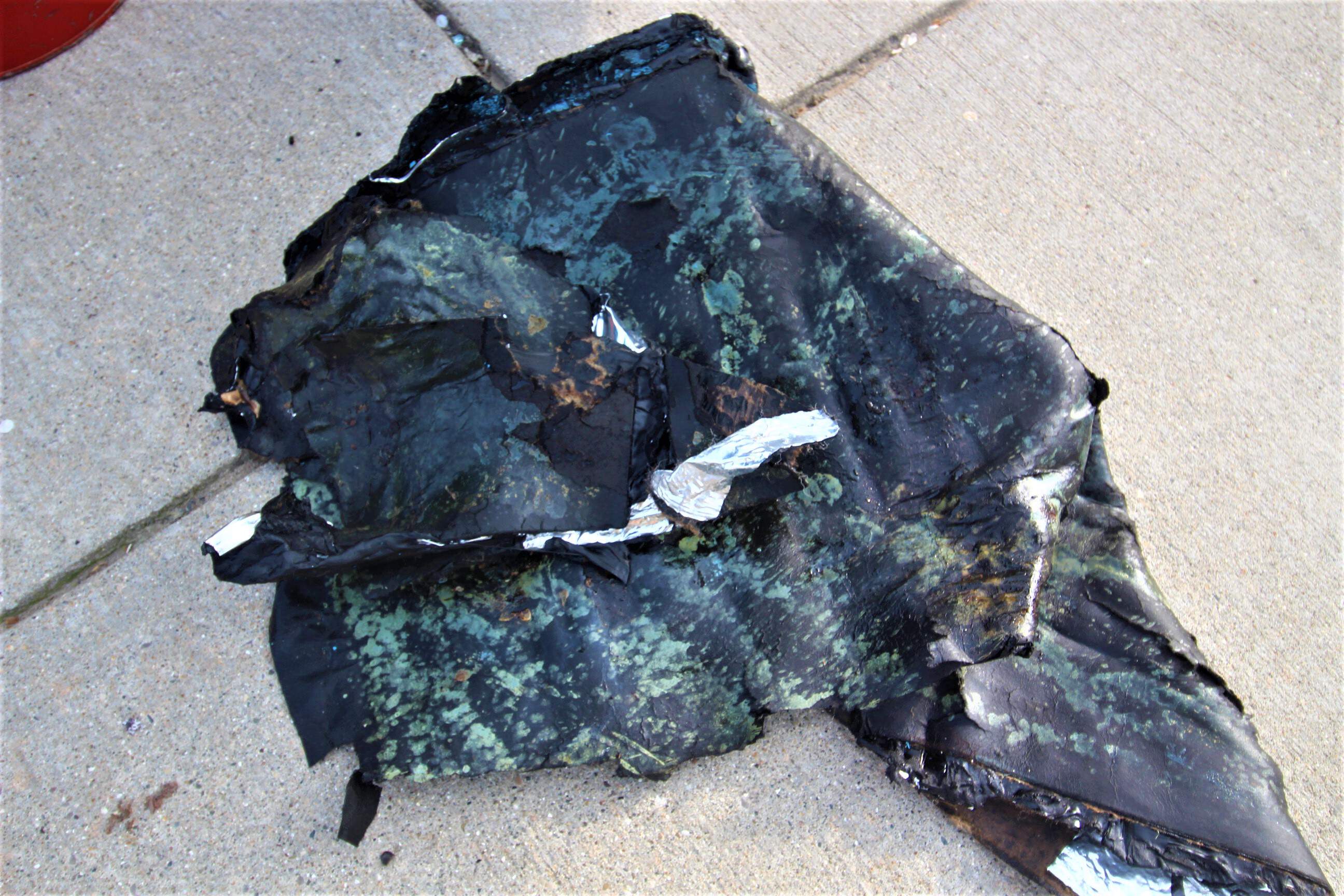

I found a mixture of transmission fluid (used for the convertible top and I've had a leak for awhile now) and antifreeze in the passenger side foot wells. This was not going well.

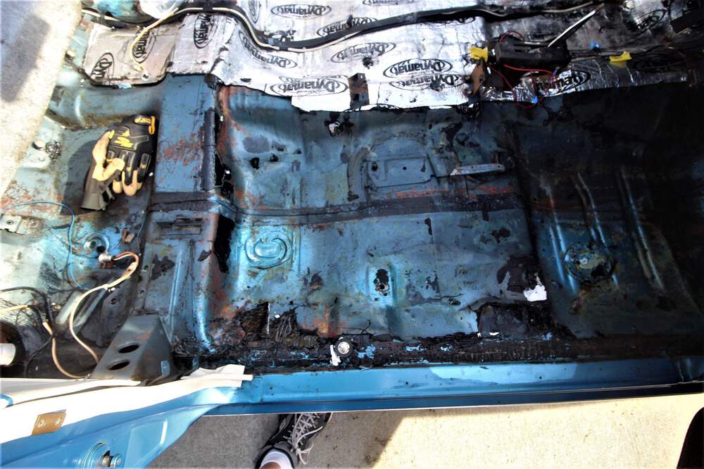

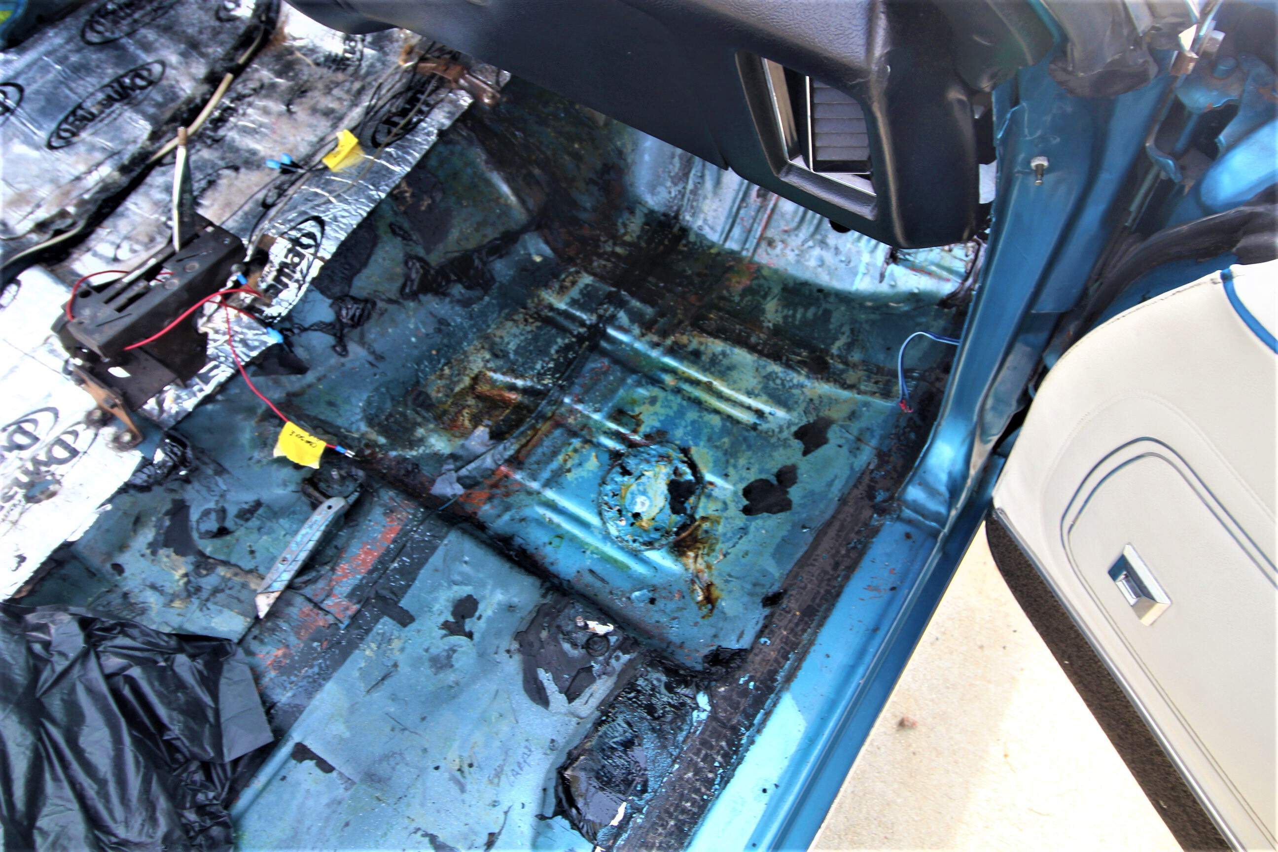

Jacob and I decided to cut out the Dynomat on the passenger side to see what shape the floor board was in. All the videos you see of this stuff are of installation. Putting it down is easy. No one ever shows you what a bitch it is to remove. I was lucky that most of the rubberized backing didn't turn to tar (some of it did but that is another story for another day). You need to wear gloves removing this stuff (as I found out the hard way). The aluminum/tin foil backing can cut you like a bad paper cut! I have the cut up hands to prove it.

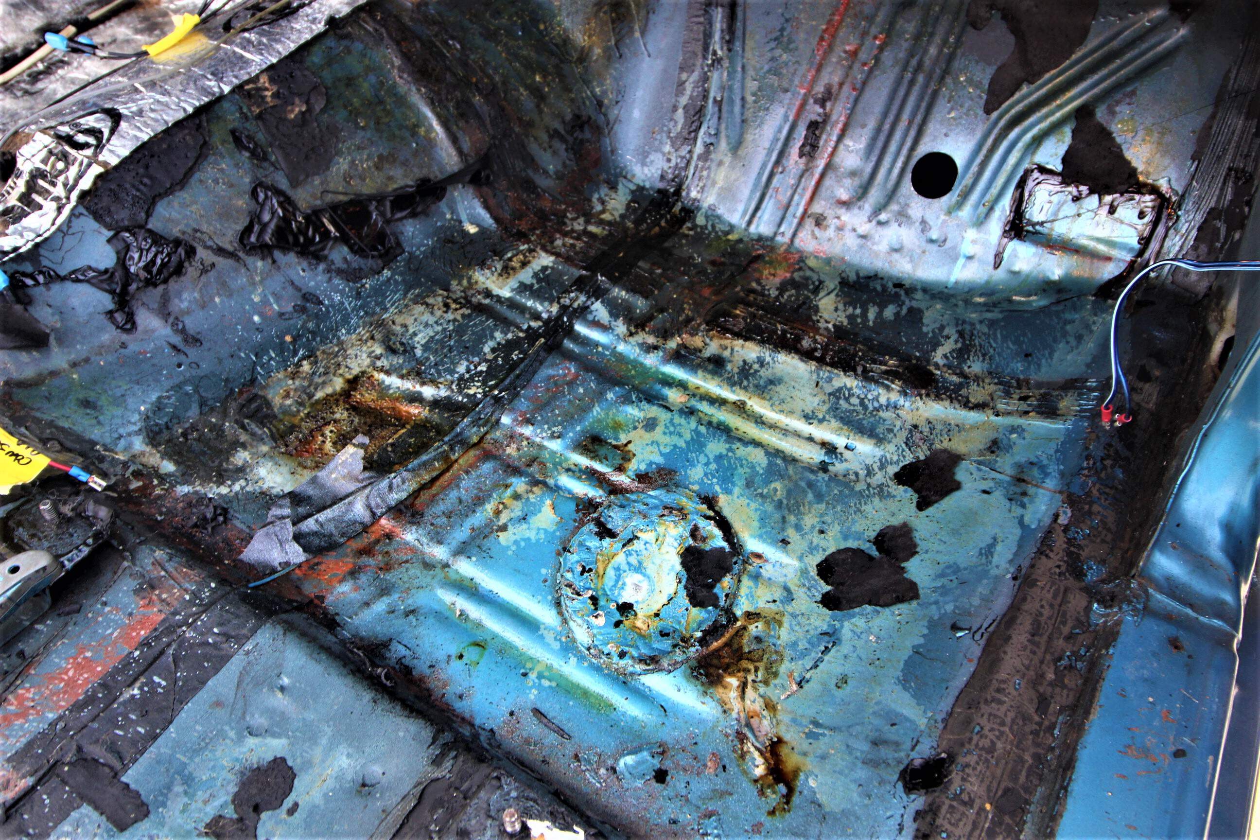

So this is what I found under the Dynomat.
Nasty green stuff under the Dynomat. Oh boy.....
These floor boards are nasty.
This was not looking good. I suspect that the heater core was shot and leaking. Only one way to tell. I put the driver's seat back in the car, bolted it down, grabbed the shifter knob and went for a test drive. The video tells it all.

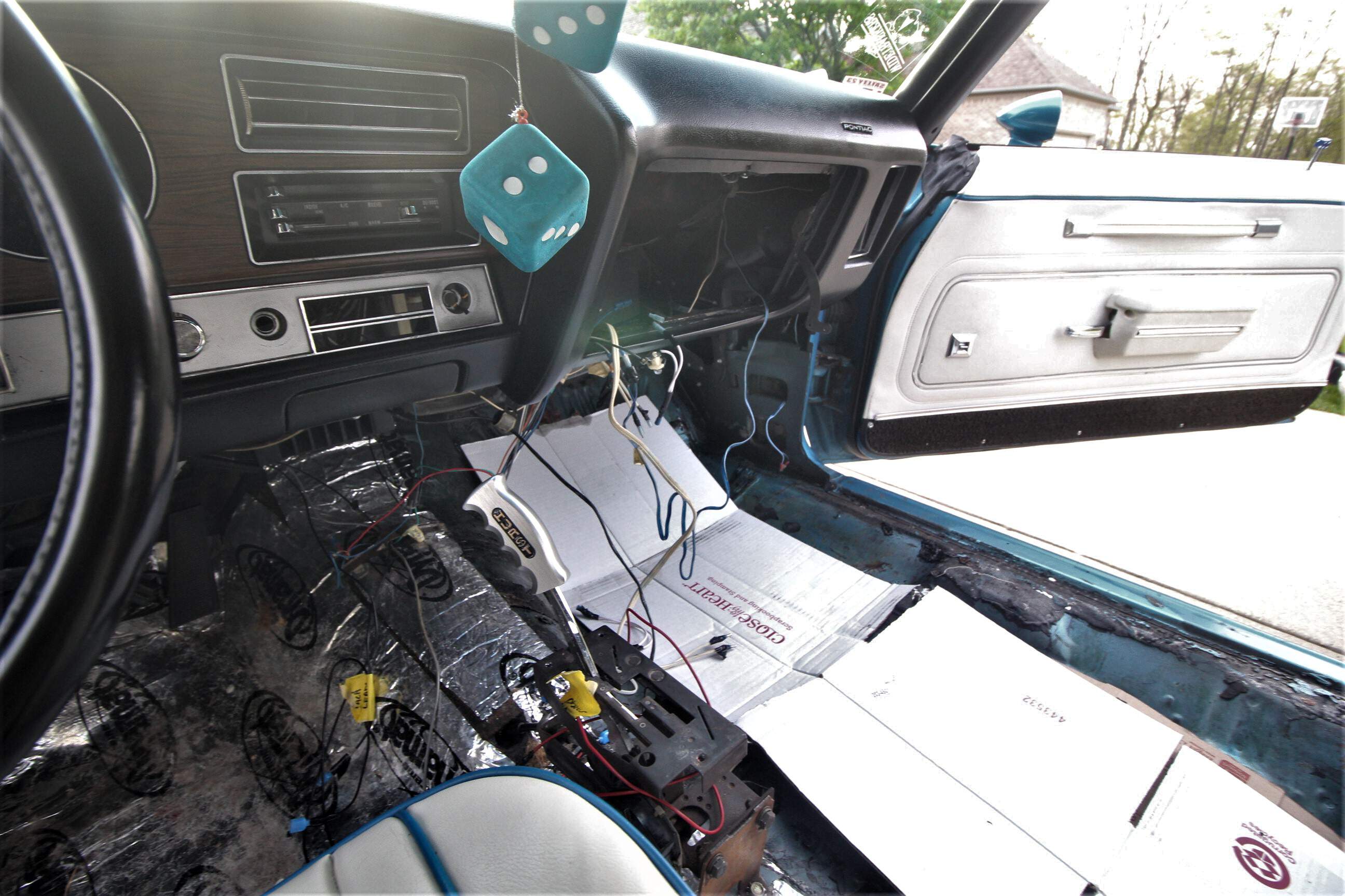

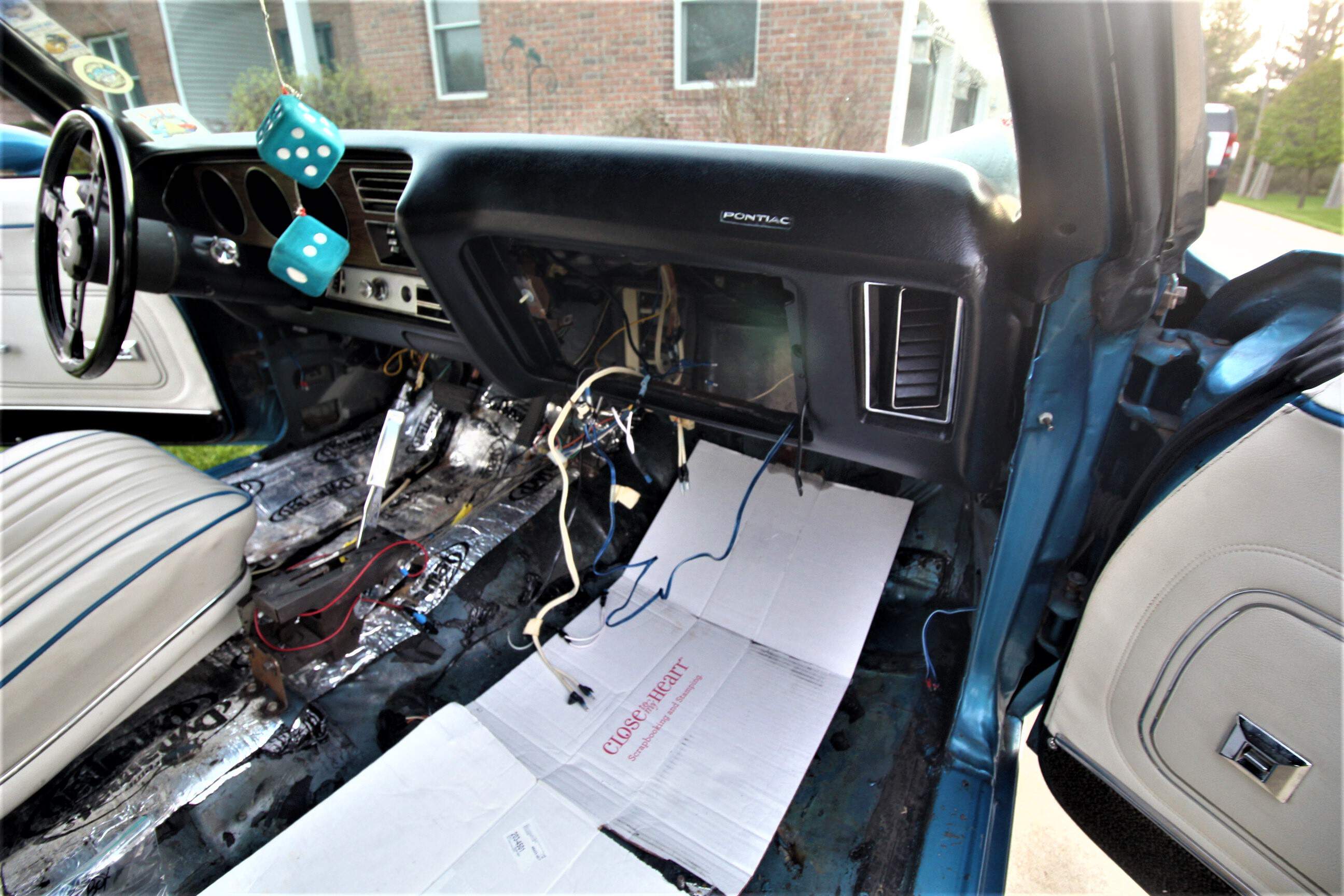

Since the sun was setting, Jacob and I removed the AC ducting, the glove box door, glove box, CD changer (it was mounted in the glovebox), and radio. Now there's decent access to firewall and heater core cover. More of the dash may have to come off. I'm going to consult my shop manual later and see. I think we got a good start on disassembly. I just wish I didn't need to do this. Rats.
All the wires you see hanging out of the glove box are speaker wires. I have dual 6x9s in back, kick panel speakers and a dual speaker under the dash. So it is a crap load of speaker wires.
I plan to replace the radio at this point with something bluetooth compatible/hands free and allow me to play music from my iPhone. Right now Custom Autosound and Retrosound look to have to interesting units but Retrosound seems a little more pricey. It is not clearly to me why yet.

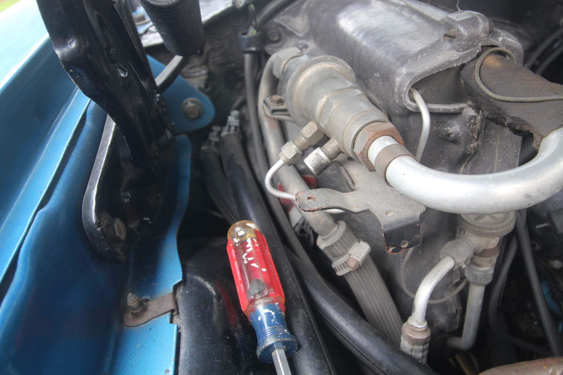

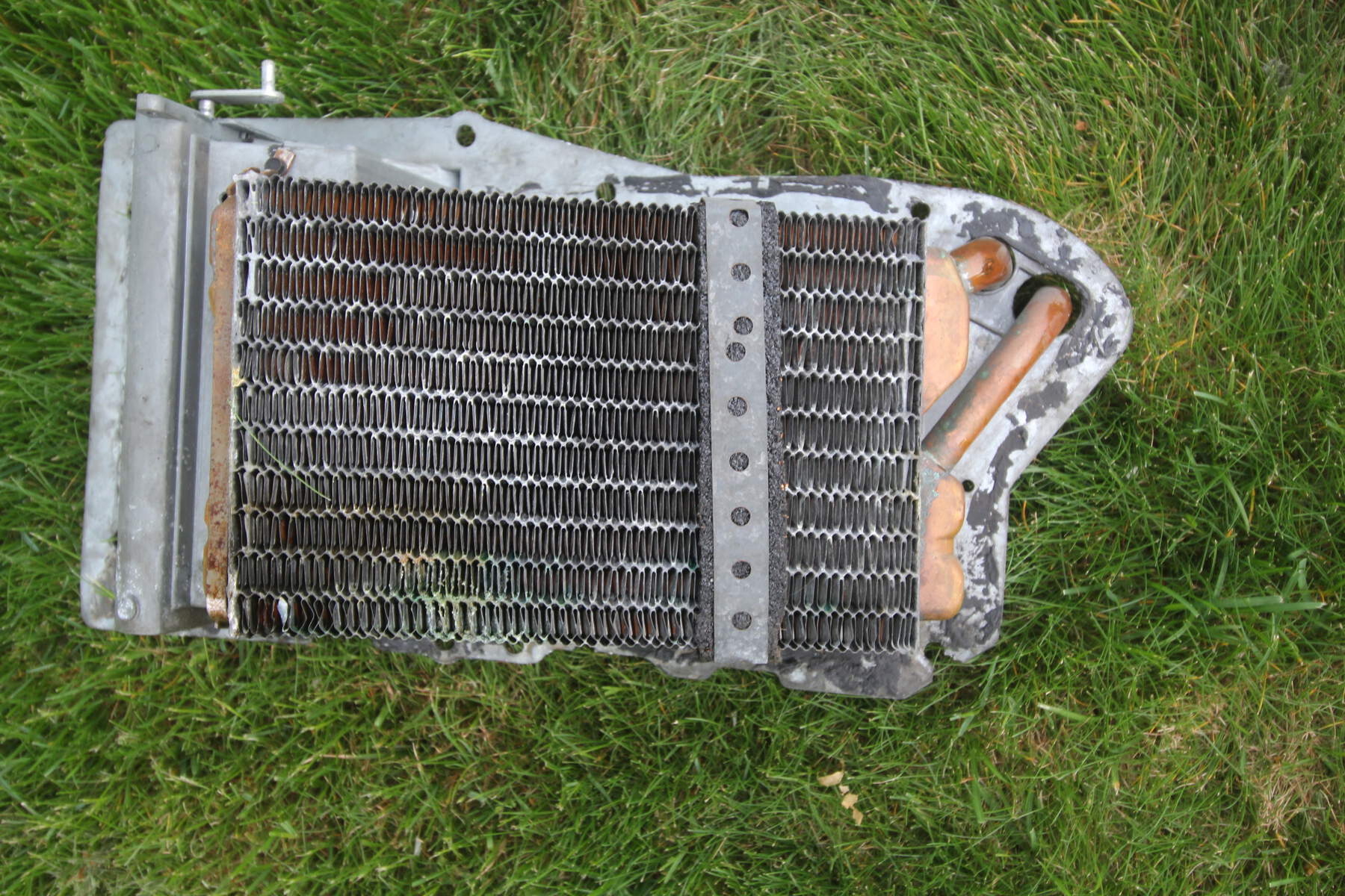

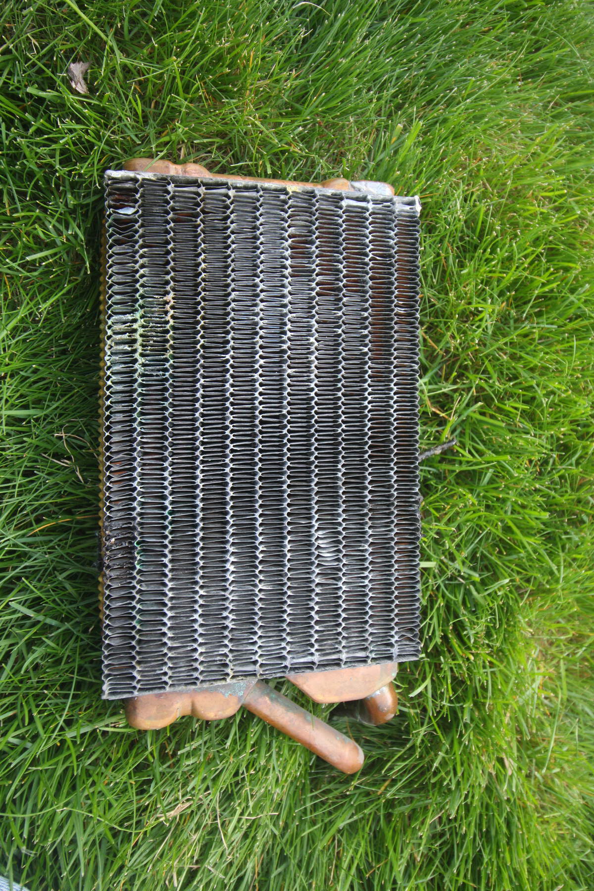

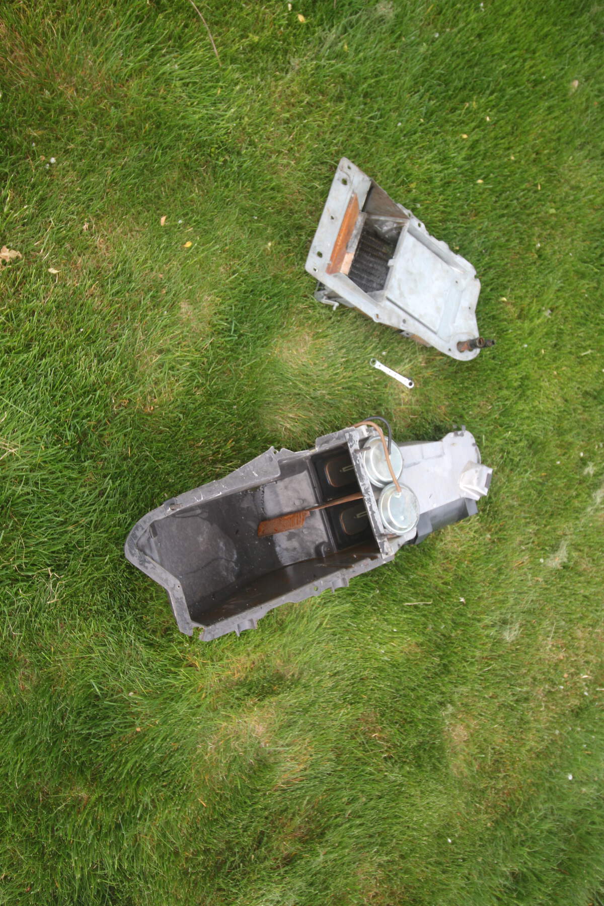

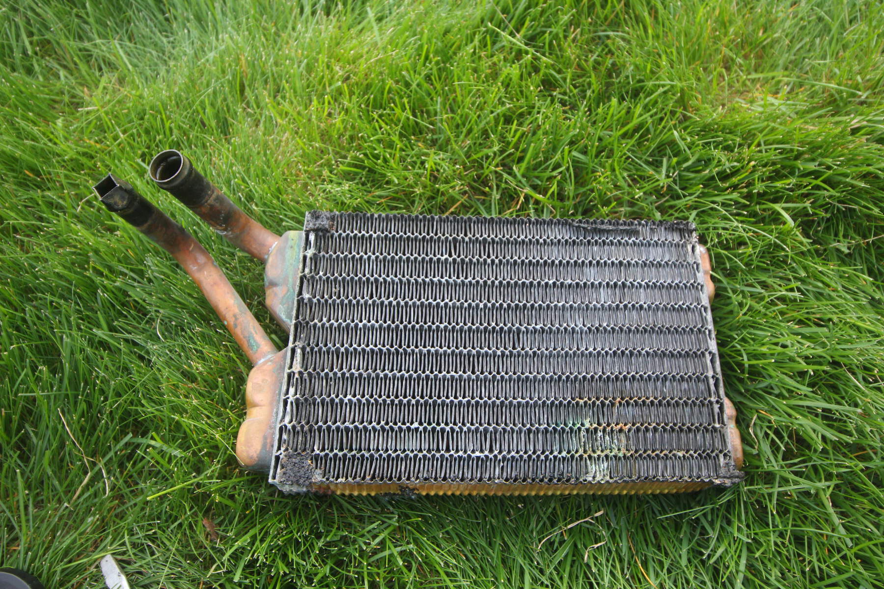

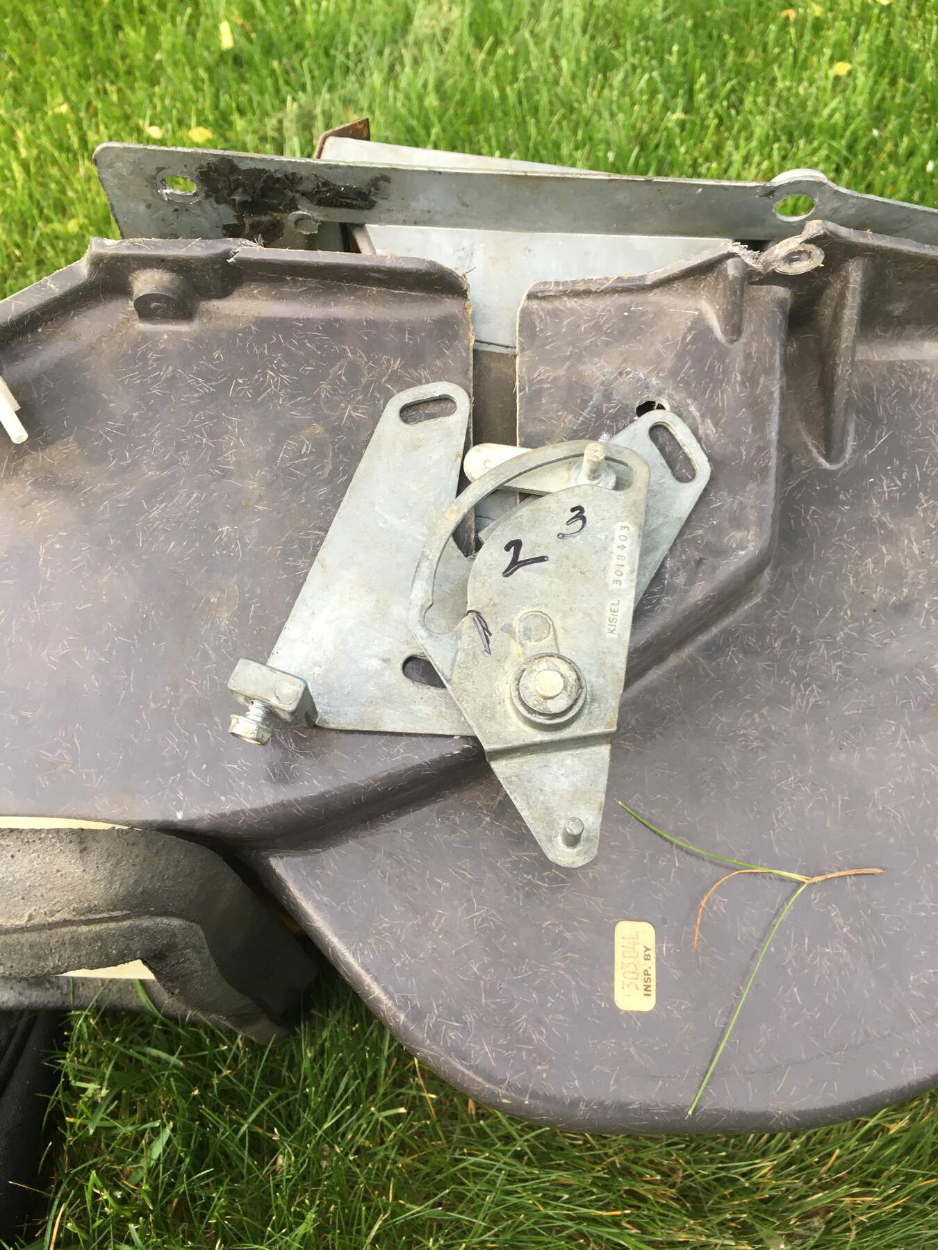

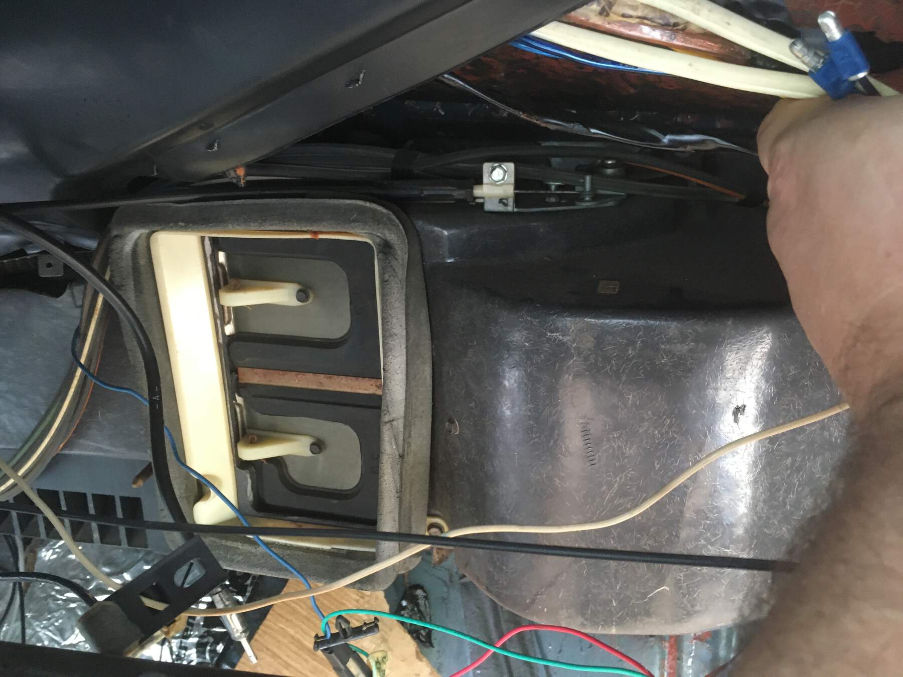

Well I worked on Lucy again today. First thing I did was disconnect the hoses going to and from the heater core. Wouldn't you know that they are different input and output hoses. Input from the cylinder heat to the heater core is 3/8" and output to the water pump is 5/16".  The output hose was absolute bear to get loose. I ended up cutting it at the firewall/nozzle. I then disconnected the entire input hose from the firewall and cylinder head and routed the output hose to the cylinder - as Kiwi suggested. This simple swap took almost 45 minutes fighting with those two damn hoses.
Nice and snug trying to get your hand in between the hood, the AC cover, and on the hoses. Greeeeaaaat piece of engineering.
The AC / heater core unit from under the dash. Surprising only three nuts and one screw hold this sucker to the firewall.
The shop manual tells you to mark three cable positions when removing the cable that goes to the dash so you can re-align it later.
IMG_4935.MOV
Welll - the damn thing is out. I didn't even have to remove the fender or the inner fender.
Could they have made this any more f*cking complicated? I spent over an hour trying to figure out how to remove the heater core from the box. Nothing in the shop manual about it. I am on the verge of breaking the fiberglass housing! You know that bracket that I marked with the 3 alignment settings, turns out it's three mount screws secures the heater core to the housing shell, so that how thing on top has to come. Sonofa....
Yes, this mofo is apart!  Happy dance time!

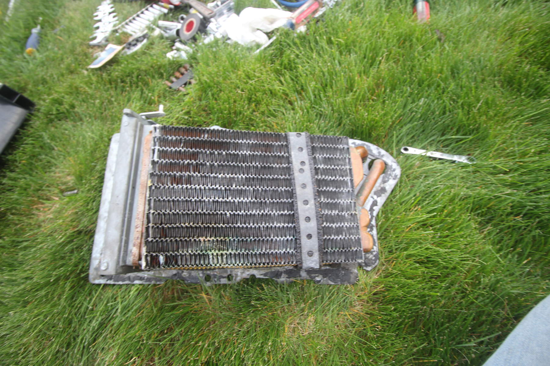

Here is what the heater core looks like.......
Now the most interesting thing to me was.....this was NOT an original Harrison Radiator unit! There is no name on this thing at all. This means the heater core has been replaced before! Now I am thinking I should seriously overall the HVAC system on this car since I have it torn apart this far.
The AC has never worked on this car since I bought it over 25 years - but hey it's a convertible - who needs air? You need AC in bumper-to-bumper traffic on I-75 waiting out accident with 95+ degree heat and rain outside CIncinnati with 6 more hours to go. Not often, but when your family is in the car....and you don't have air - you are a walking dead man. Just saying.....
Since this is not original, I think I will just purchase a new core rather than have it rebuilt. If it rains Sunday or Tuesday, I might be making a road trip to National Parts Depot.

i wonder why the different pipe sizes to the core????
to reduce flow rate and allow for more heat absorption ????
Well done frosty! those hoses are really good at welding them selves to the metal connections and remember what you told me about old fuel hoses?
 i recon same applies to heater hoses too!! replace the lot.
good on you for doing this job your self, if you had a shop do it they would charge you a arm and a leg to do just what you went through :cheers:
AND you will know exactly what you have fitted.
i also agree, if you had a original core in hand to take it and have it rebuilt but since its an after market one, just replace it full stop :bacon:
Replacing the hoses is probably not a bad idea. My only reluctance in replacing the output hose to the water pump. It means I have the added hassle of having to drain the radiator and the water pump and the opportunity to make a bigger mess of the driveway. I ended up putting almost a gallon of antifreeze into Lucy last night after I was done. I knew I was low (obviously) but not that low.
Your theory on the different hose sizes are as good as any I can think of.
Today is suppose to be nice, so I think I will drag out the Roadmonster, exercise her, and work in it some more. Monday is a holiday, so I will do my parts run on Tuesday since it is suppose to rain then.
