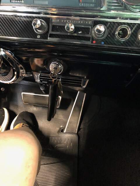

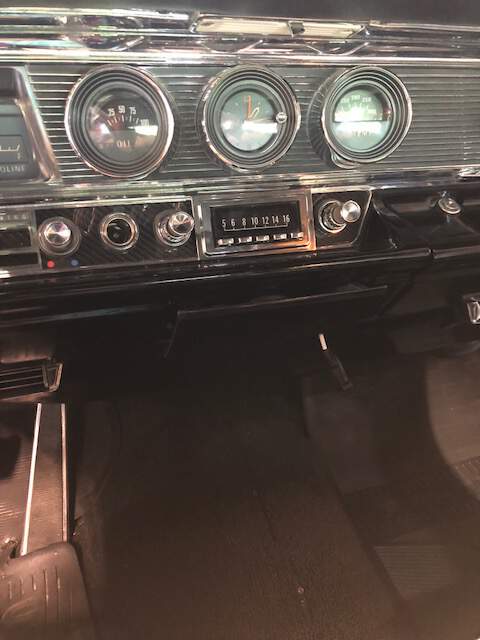

Know how you feel laying on back for 6 hours ! I finally got my A/C working and everything is good! But a pain in the ass all the same. I used the original 64 air ducts that attach under the dash to keep the stock look! If interested I'll show and tell how! Last thing to do is get the column shift linkage
adjusted. Have an aftermarket column with lokar shift rod and trans mount neutral safety switch. That seems to work just fine just need to fine tune, but body flex makes it a little harder.
Added pictures of under dash a/c took out the upper a/c w/ clock and put in rally gauges, then took lower panel and split in half and then took my Dremel cut off
wheel, and air cut-off wheel and trimmed the inside webbing to make room for duct work. Glued plastic air ducts to the back of original vent grills ( grills still operational and can be removed ) had to take the glove box liner and narrow the depth of it! Couldn't use stock light so fabricated a smaller light.
Edited by wdl182
added pictures

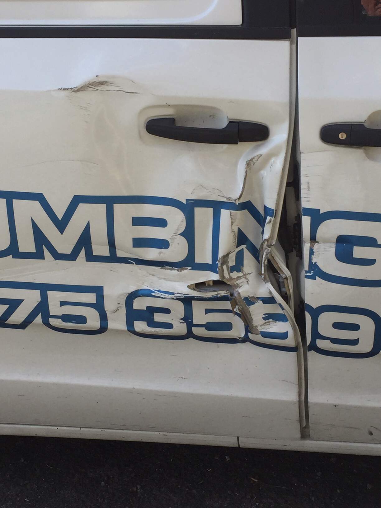

What did you do on your car today Kiwi??? i bent my work van, a gas bottle delivery truck backed into me!😞
Took out my drivers door and side sliding door:stars:

Wow! That’s some decent damage! How fast was the idiot going? Sorry to hear you have to deal with that too
he was going quiet slow but fast enough for me to not get out of the way!😔

It was driving me mad that i could not use the side door this week, so i got the portapower out and gave the side sliding door a little 3/4 push forward and and a couple of very special... lets say recalibatration adjustments !!!!🙄
 And now i can use the very bent side door, i am so bloody flat out @ work i need this van to be working!:o

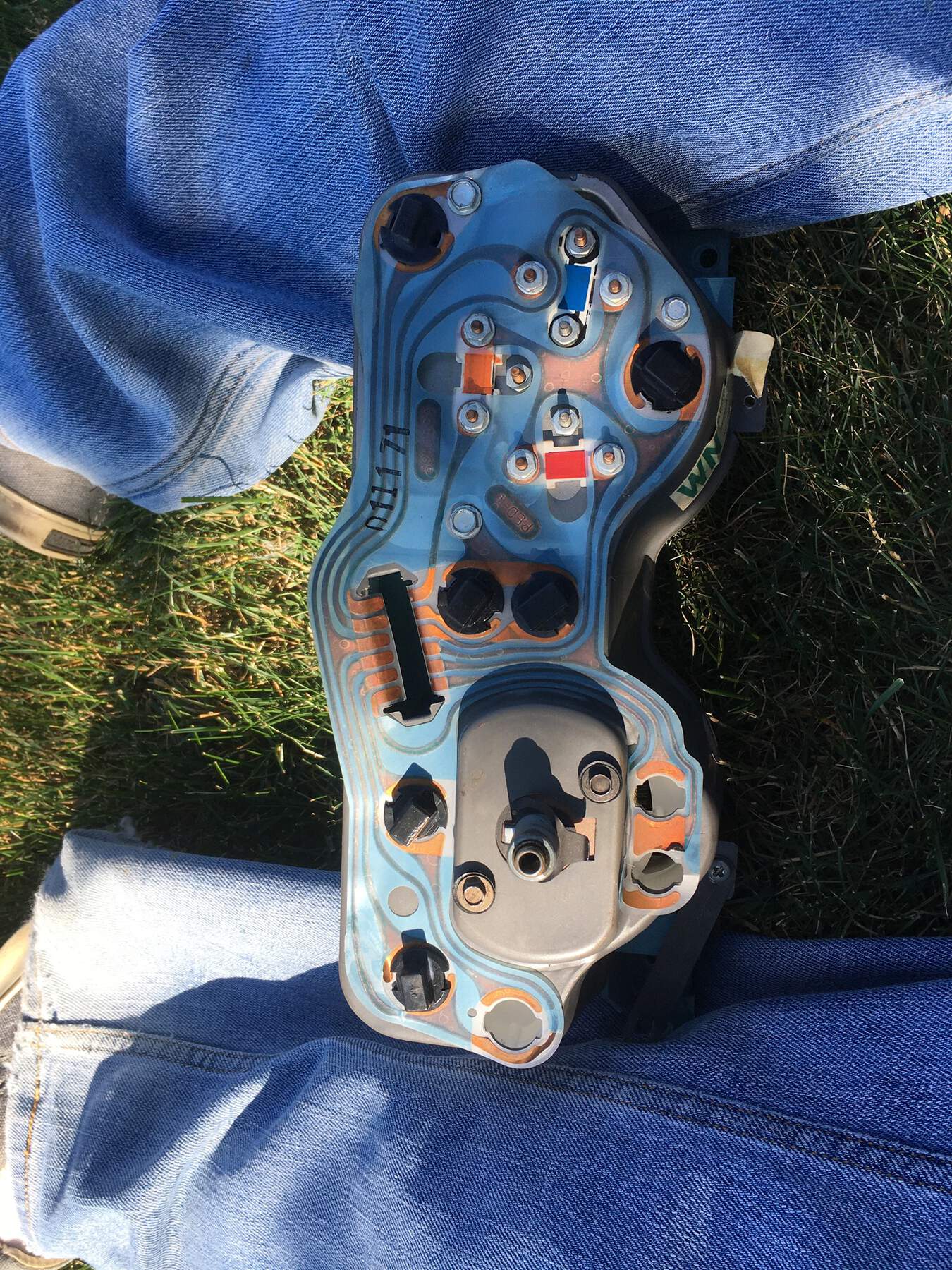

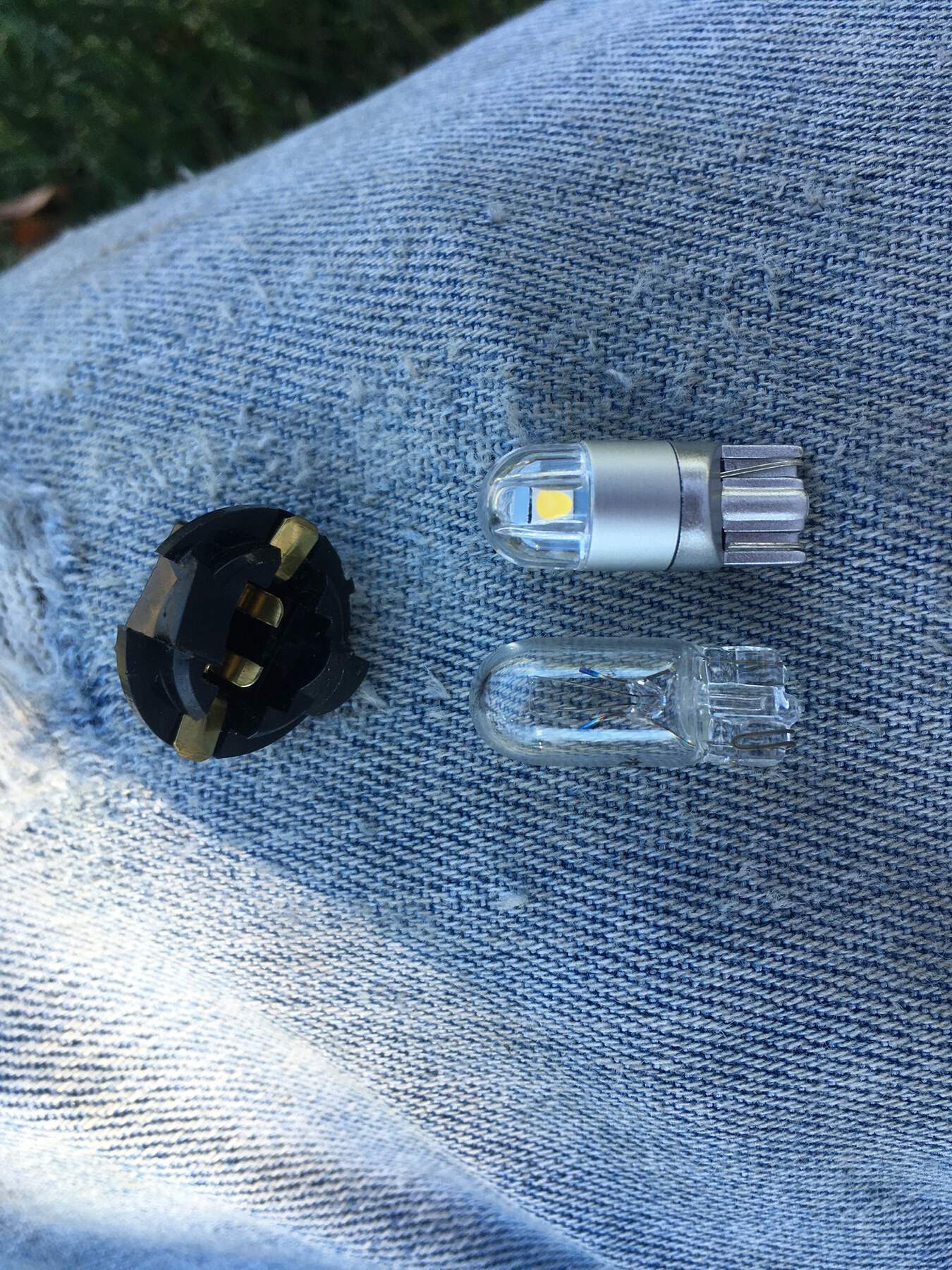

Then I got the bright idea to remove the dash and pull the instrument cluster so I could replace my weak 194 bulbs with LEDS. I ran out of daylight before I could get the headlight switch or power top switches back in. I clearly screwed up the ground strap(s) along the way since none the gages work or cluster lights come on. More fun for another day.
The damn heater core is in, for good I hope.
Who’s bright idea was this? Oh yeah! Mine!
LEDs replacing the stock 194s.
Wrestled the cluster out.

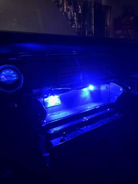

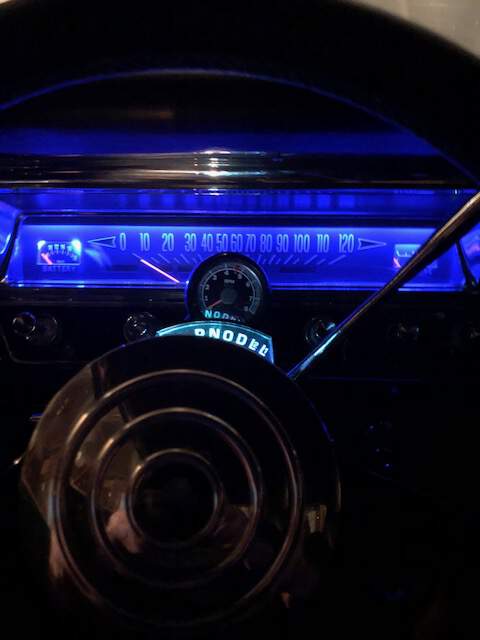

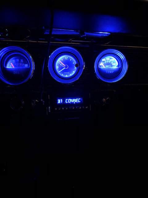

Hey I used Blue LED lights in my dash, gauges,and glove box! I'll post a pic in a couple of days when I have everything back together !!
Wayne
Edited by wdl182
Pictures added
