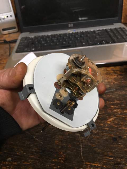

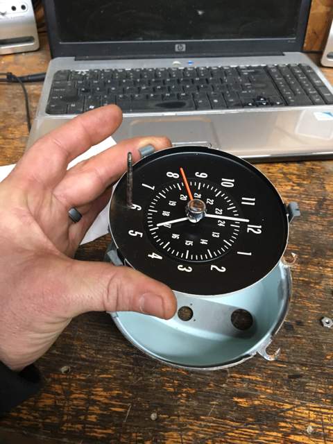

In thinking more about this,I'm afraid i will miss the "Pop tic tic tic tic tic...Pop tic tic tic" Its a old guy thing i guess. Anyways i took it all apart and cleaned it with a dry graphite lube.its been keeping time for 2hrs now. I'll post a 24hr update. or close to that as i hope im not up tomorrow night at 1:45 am LOL
You might want to give a week update too. These things are suppose to have a self-winder that draws a small amount of battery current to wind the clock periodically.

indianmanjoe, I see your reply that you got the info from me thru PY. cool. You might want to consider sending that rally clock off to get the quartz conversion done while you already have it out. My 68 that I used to own had the non quartz and I found myself resetting the time everytime I got in the car. The quartz action greatly improves time accuracy. ALSO anyone looking for these clocks a reminder that the 1968 models will have a blued face instead of a black face like all of the other years. All black gauges and one blur gauge is a no no. lol. Nice looking clock Joe.

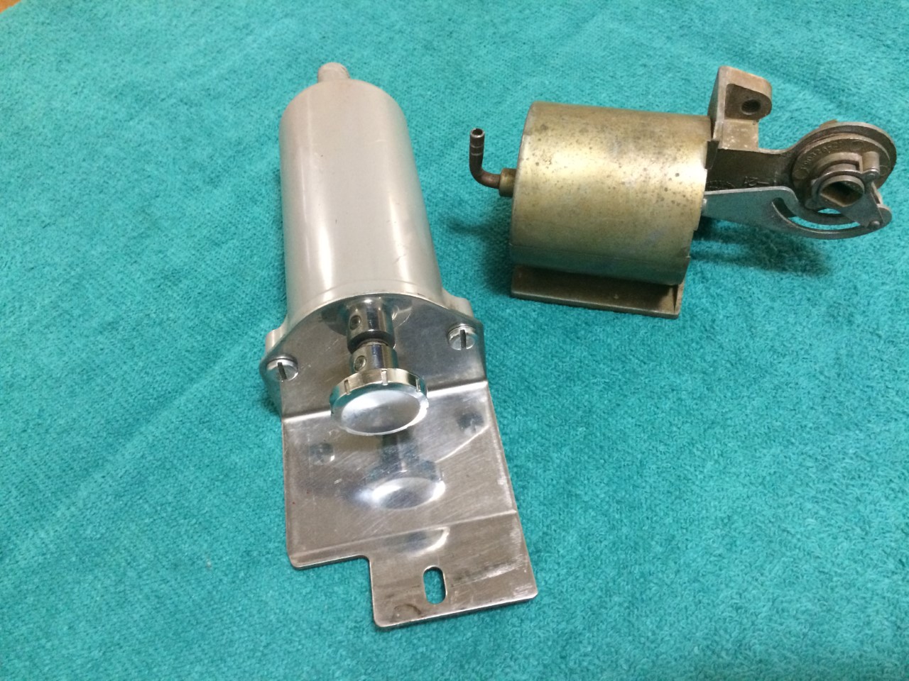

Vacuum trunk release! Awesome! I love installing factory options. Had i not been 5 yrs old when my car was born i would've checked all the boxes!
360 i am torn about the quartz update. My clock is about 10 mins slow after 3 days. But i know i'll miss the movement of the factory one. I can pull the dash pretty fast as i have done it quite a few times adding stuff lol I did find the correct way to adjust the time mechanism.i'll post a pic..
Joe what if you bought a used correct spare and had it converted to quartz movement? JUSTA a thought. It's also more time and money....but.....
The hoarder in me says YES! but i'm tired of looking at stuff i dont need..LOL

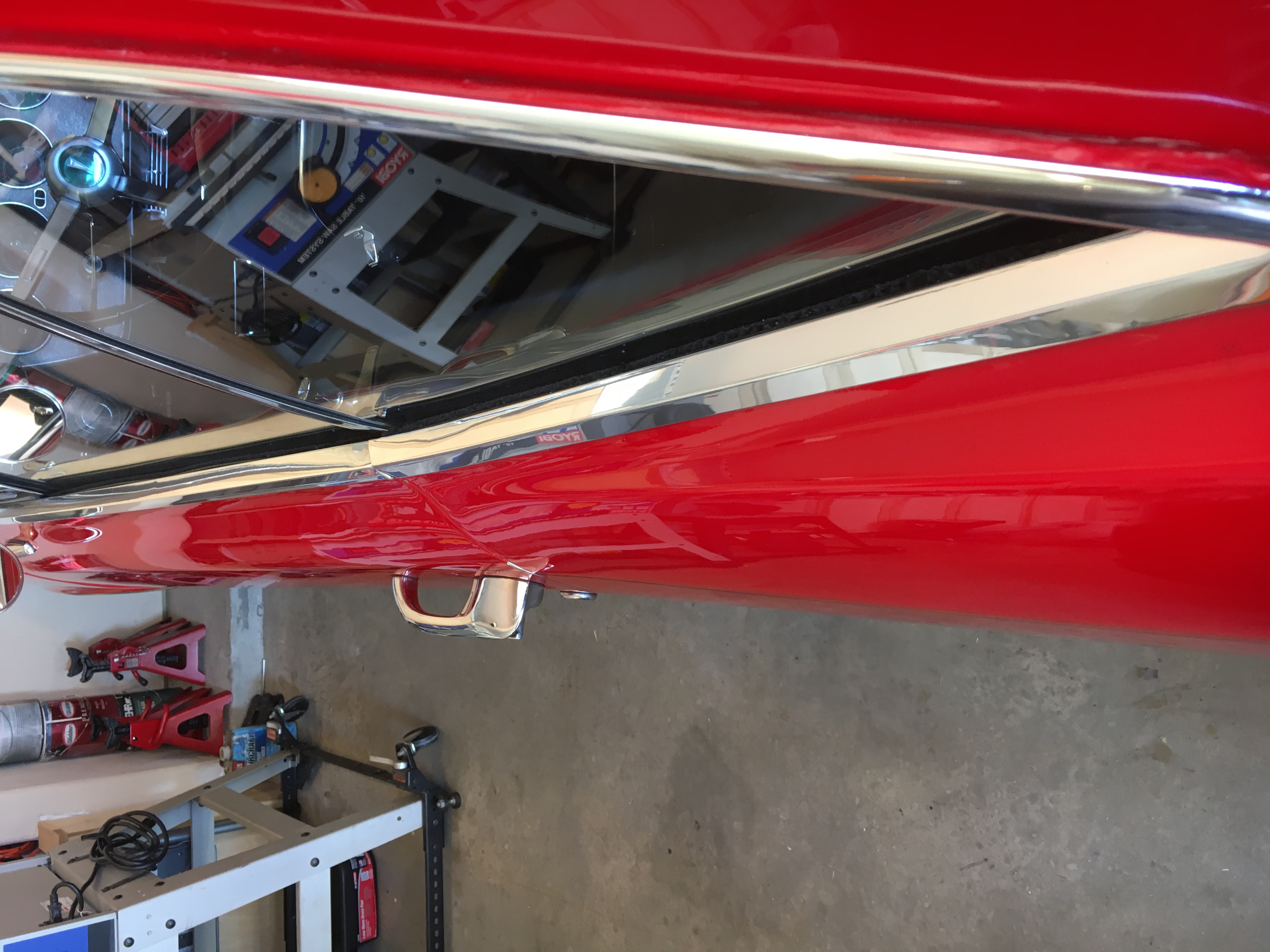

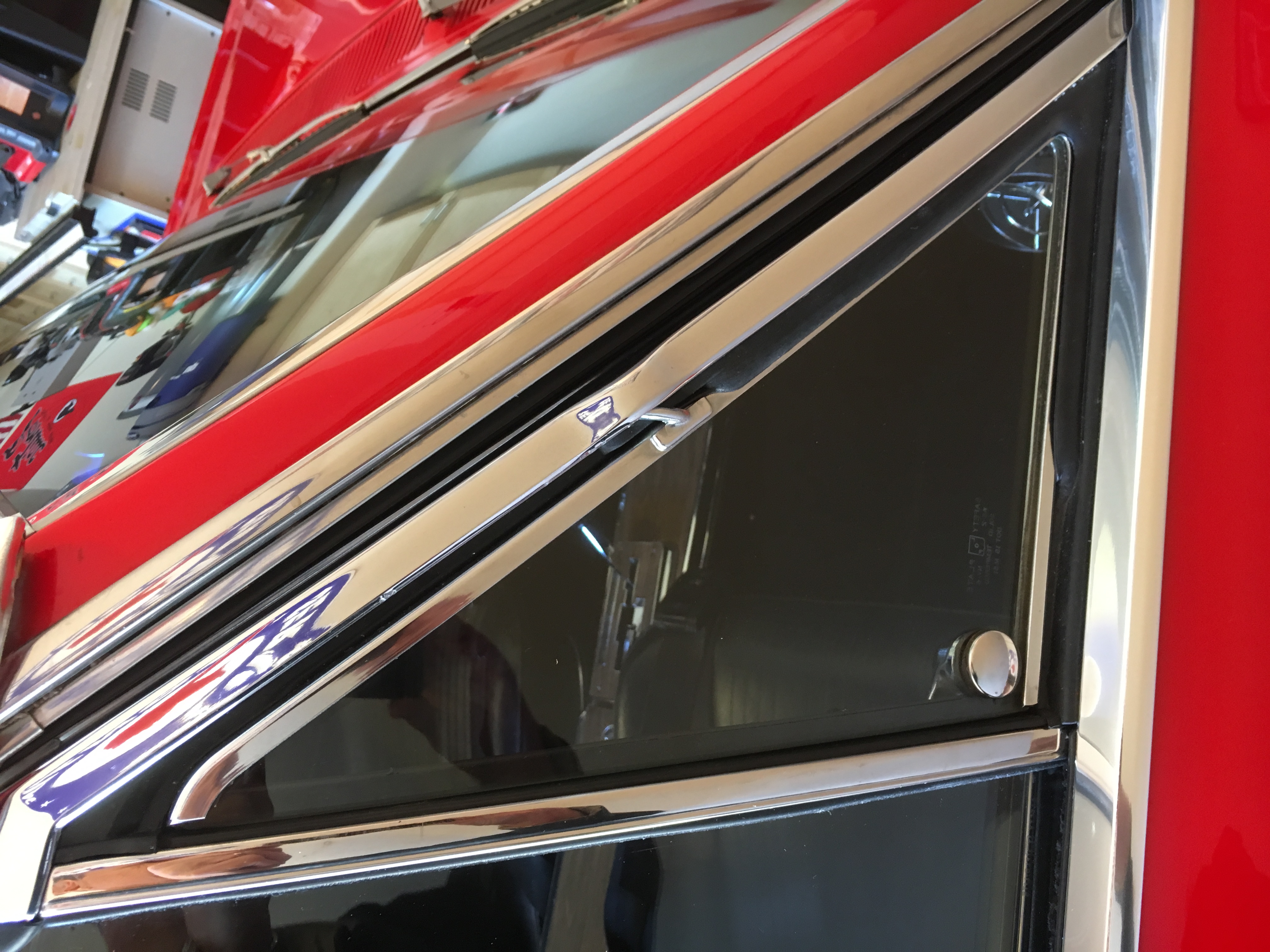

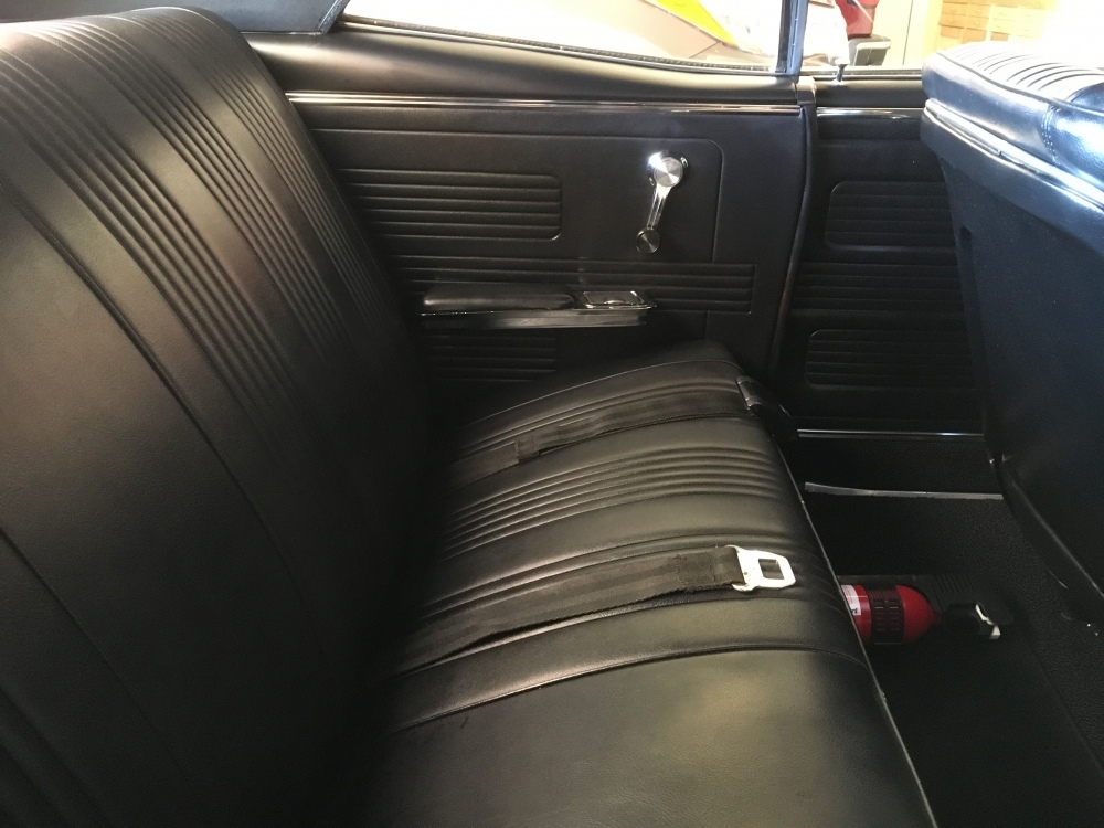

Over the past few weeks I have been replacing the chrome (really anodized aluminum) on the top edge of the door and rear quarters. At least that was the plan, but it led to the following as well.
Removed both vent windows and refurbished with new rubber and sash channels. Polished all of the stainless steel parts of the vent windows.
Replaced all of the seals/felts around the front door and rear windows.
Replaced the gaskets around the door handles/locks.
Replaced the door locks with a matching ignition switch cylinder.
Repainted the top of the doors and rear quarters (interior).
Had the pulldown cloth on rear seat cushion repaired due to rotten cloth. The upholstery guy assured me the seat covers are original as I was told.
Lubricated all of the window regulator/channels.
Adjusted all of the windows for better seal.
Resealed the door/quarter panel water shields with 3M caulk strips.
Replaced the rear quarter trim panels that were warped due to moisture sometime in the car's history.
So my weekend project turned into a month long project and the budget exceeded by about three times, but very pleased with the results, and all things that needed to be done.

If you are worried about the hoarding aspect, Buy another, send out for conversion or buy one converted, swap them and then sell the first one and recoup some of your money. AND not be a hoarder. I like hanging on to that kind of stuff as it is getting scarce. I bought an extra power trunk release just because.
If your not OCD as I am, then let it ride and just correct the time once you get to the car show.

We love pictures... about time for some new ones, Rick! :PICS:
I heard Rick was posting new pics?  Hope i didnt hear wrong and its really Nude pics..
Here are a few pictures of the finished project. Sorry can't seem to get them rotated correctly.
