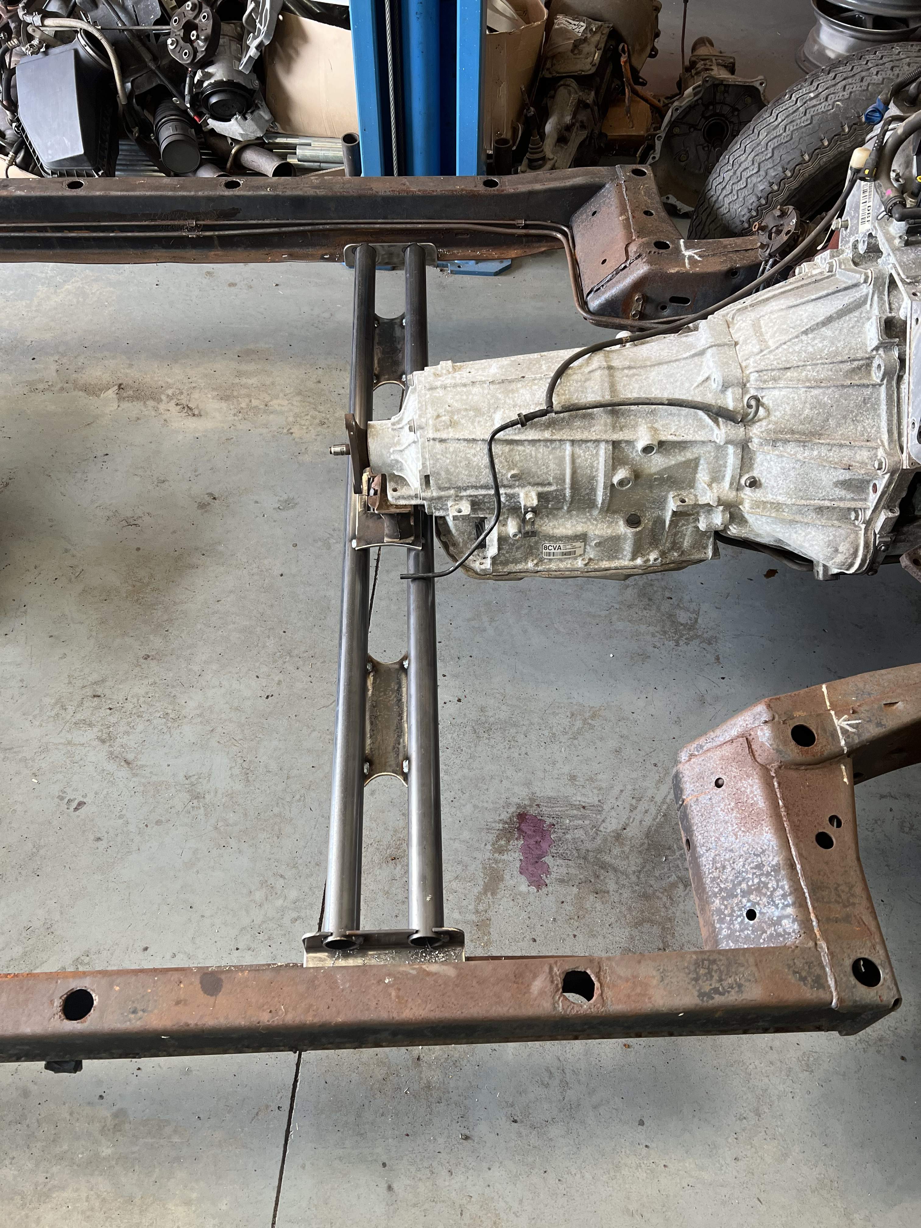

justA pondering how I want the trans member to look 👀

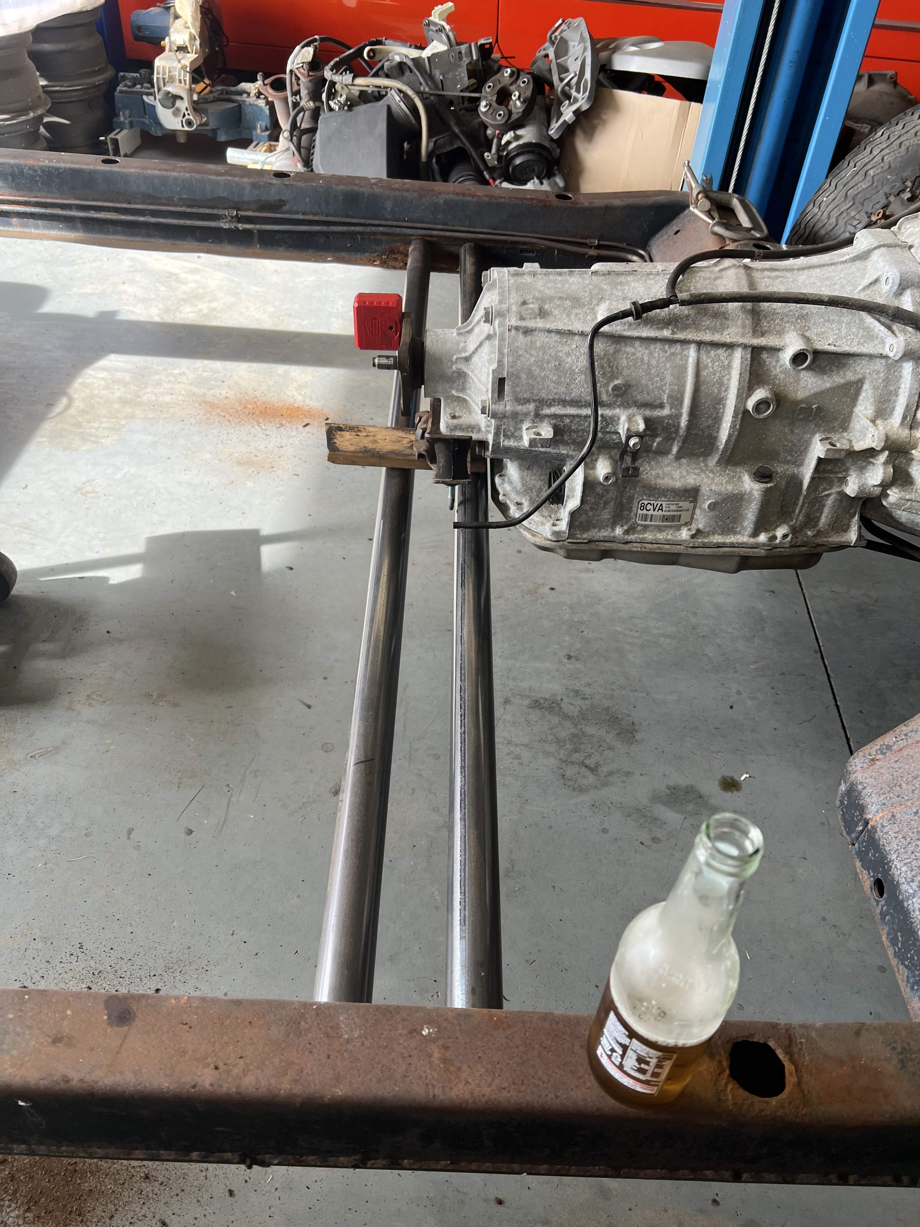

I am using some 42 mm thick tube and I will make some end plates to bolt to the frame and a  section of 5mm plate in the middle for the factory trans mount to bolt too …
might add some pretty infills too … frosty ? Fitzy ? Past me a beer !!!

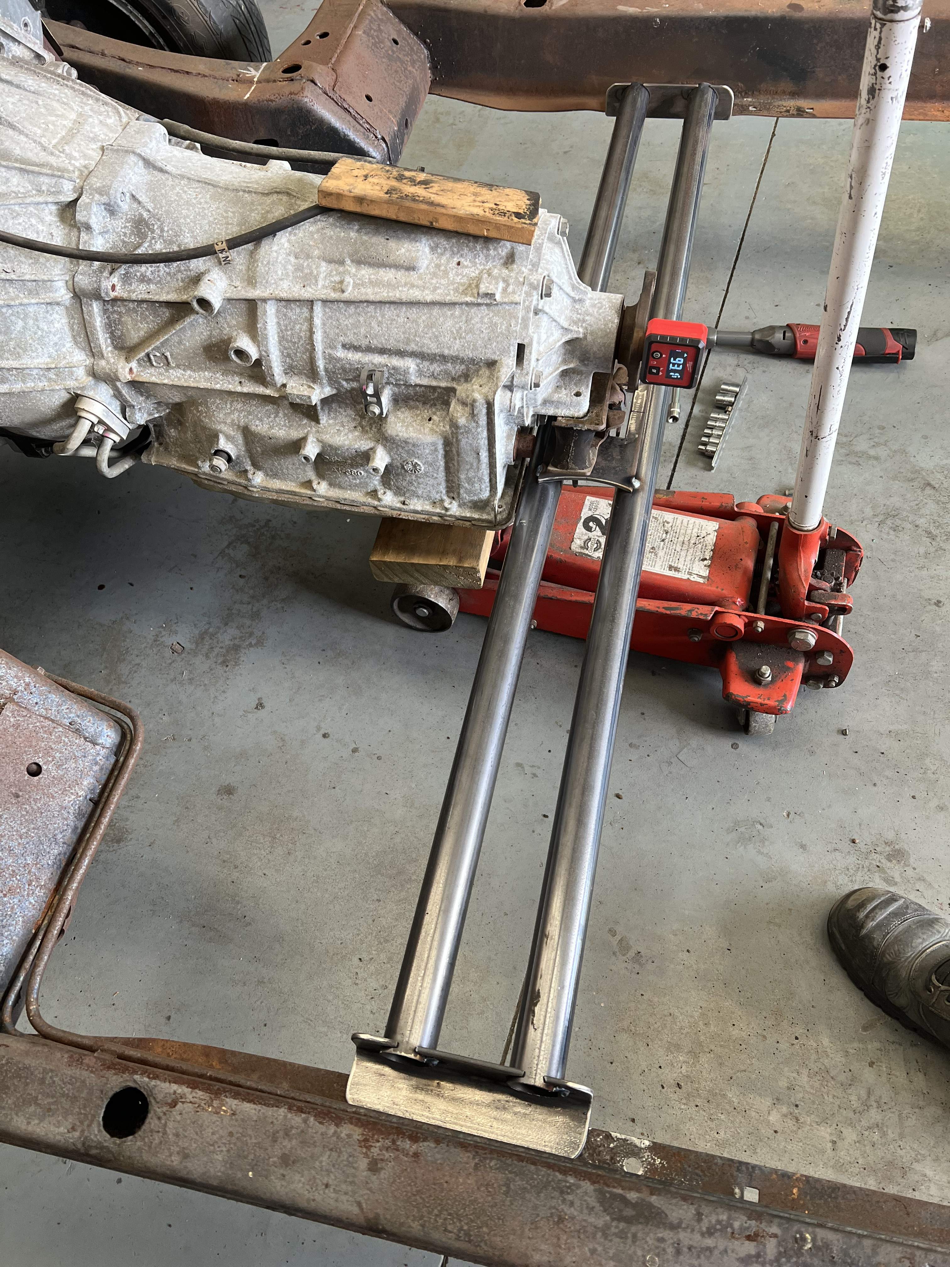

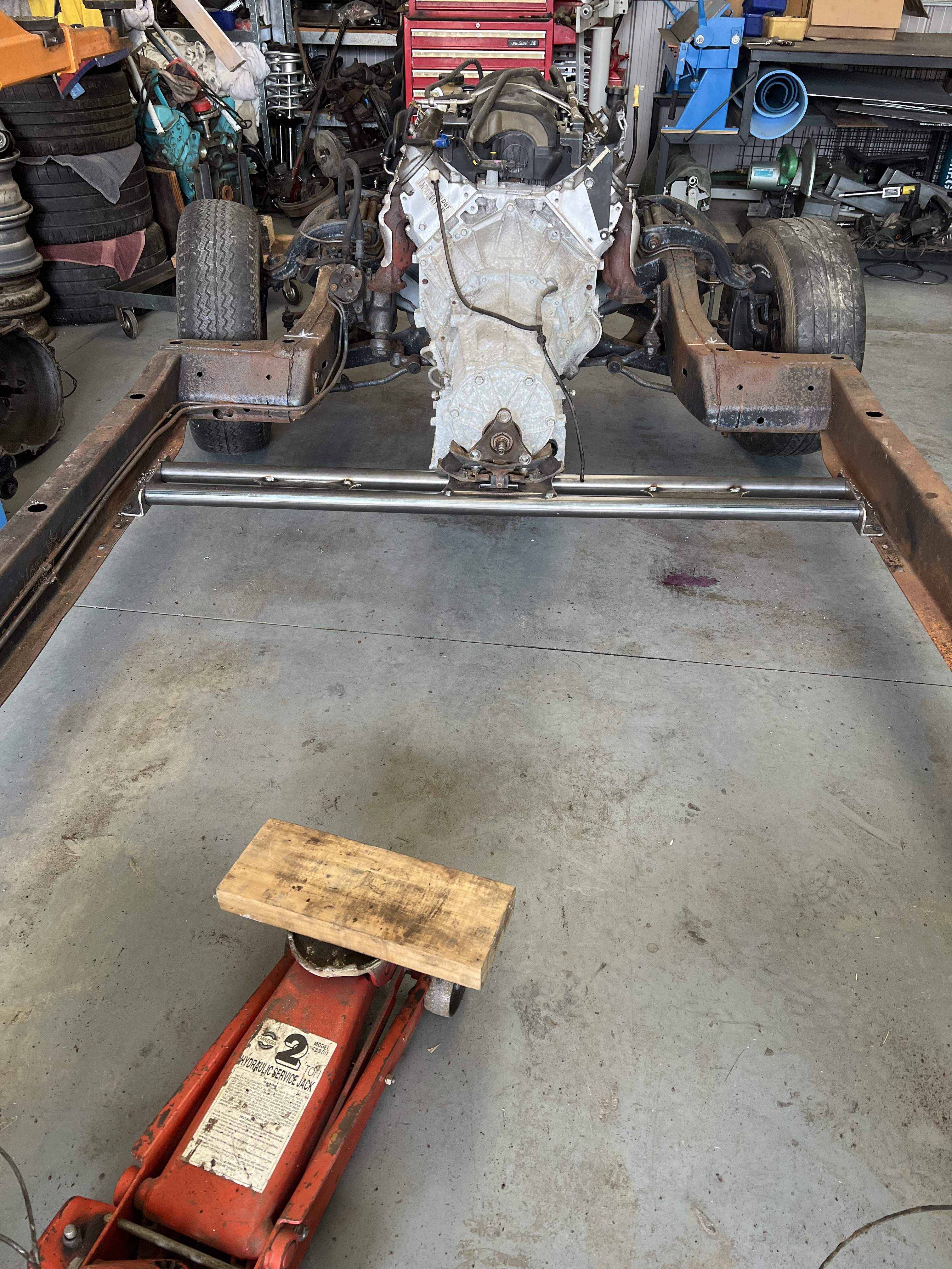

I managed to get another few hours on the trans mount this sunday,double checked my angle at 3 degrees and set to making mounts plate, ends to bolt to the frame rail JustA like the factory one , and some plate in between.
and got it all tacked, i will need to fully weld it next weekend.

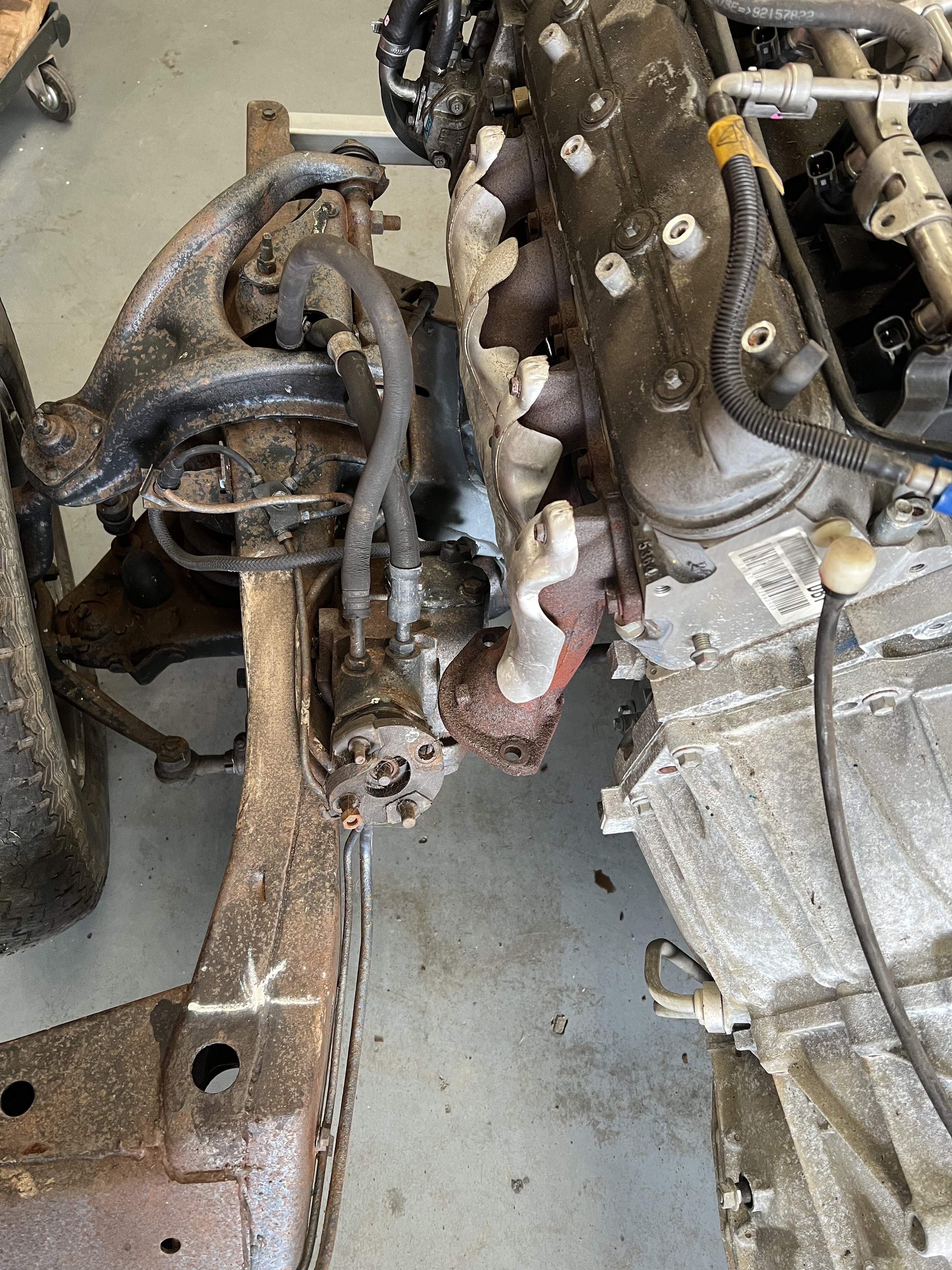

The drivers side factory manifold is too close to the steering box, which means a change to headers is on the cards
Ls parts are easy to find and I bought some full length headers that should work … fingers crossed ! As it is not like u can go to a speed shop and ask for ls headers for 63 safari :rofl:

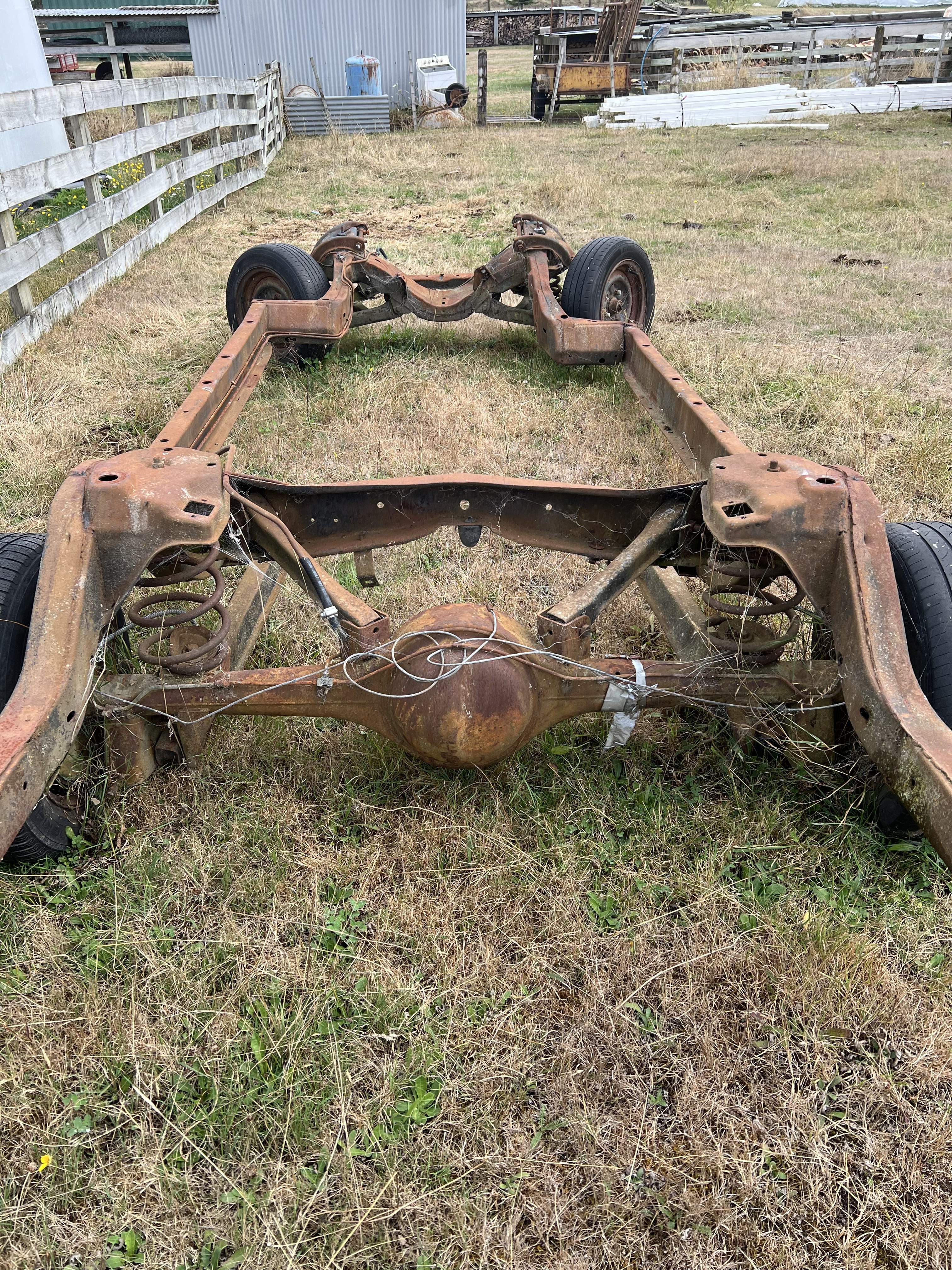

Justa, after i weld this suport up, i have to deal with that wrongway angle of that 12 bolt diff, it will need, new mounts on the top made and welding on, and to be rebuilt as well and it has no drums or backing plates, so it going to need everything.... i am of 2 minds !!! out in the paddock sitting under that bent 64 frame is a perfectly good Ponti diff.... only issue there is i will need to have the axle pattern redrilled to 4.75 chev to match the fronts, which some one had already done... only thing stopping me from justA swaping it is, future parts avaliblity if i break it !
the gearing of the ponti diff will be fine for a street cruiser but the big question .... will it last ?
on the plus side, all the mounts are factory and i would not have to dick with them !!!
what do you think ?

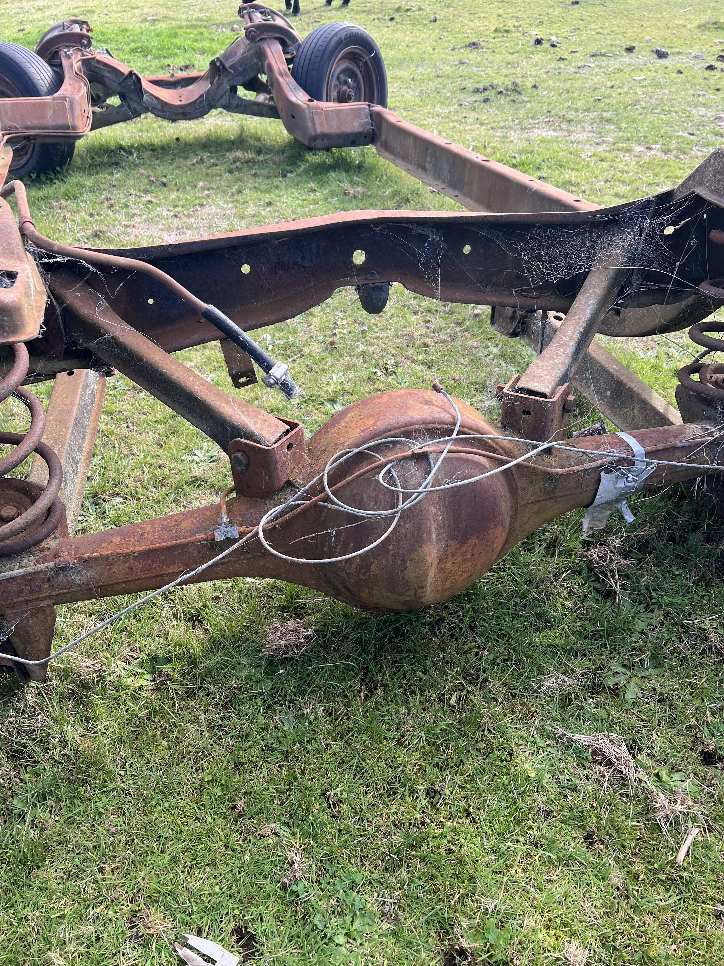

This is the spare diff , it came under the 64 bonni I used the frame from
what I do know it will bolt straight into a 63 … so frosty are you saying it’s as good if not better than a 12 bolt ?
what I like is that it hasn’t been messed with . All the mounts are intacted and stock … so my angles will be perfect … no having to muck around with repairing like on the Chevy unit

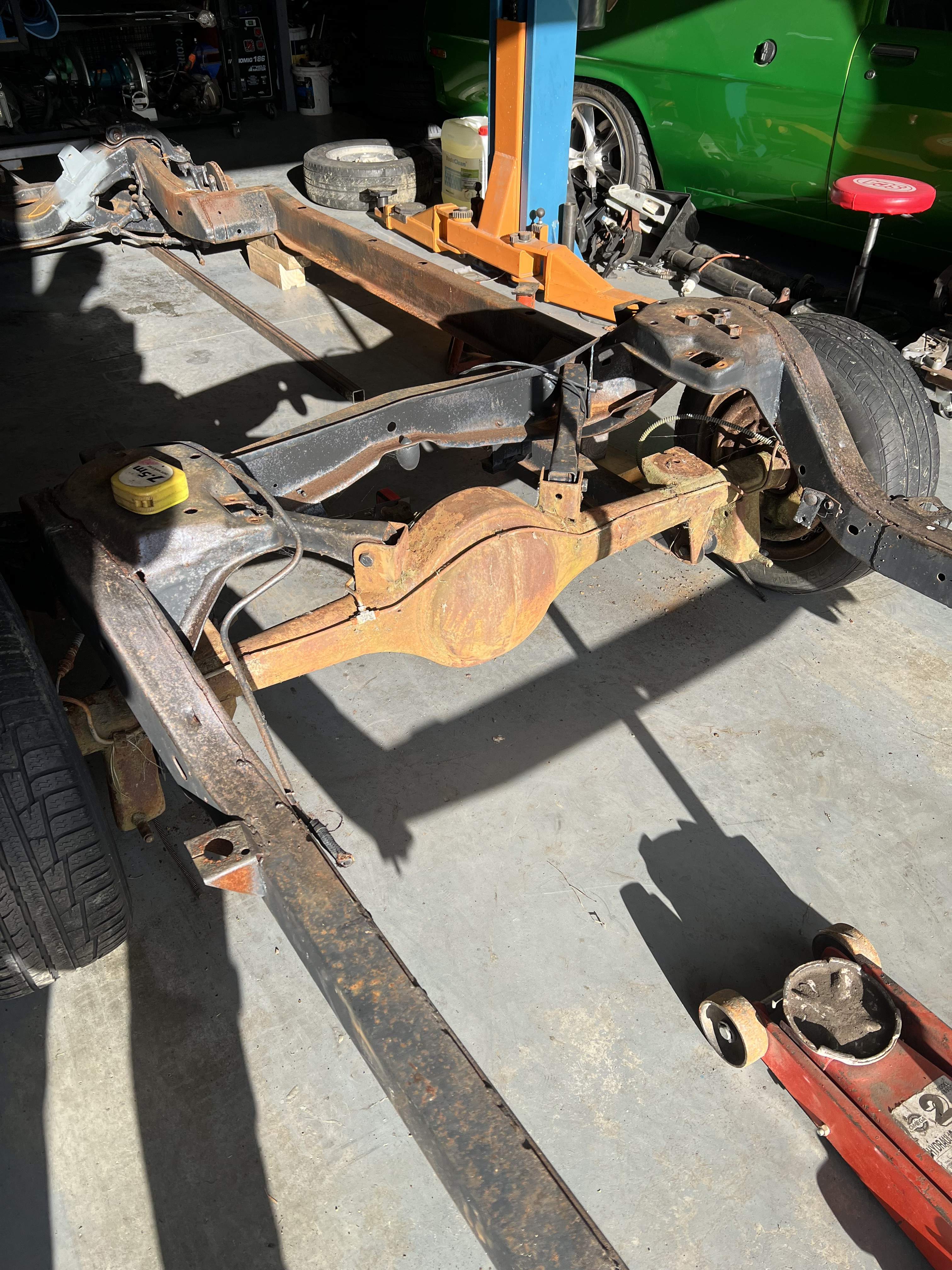

i finally get another weekend where i can move forward on the chassis !!!!

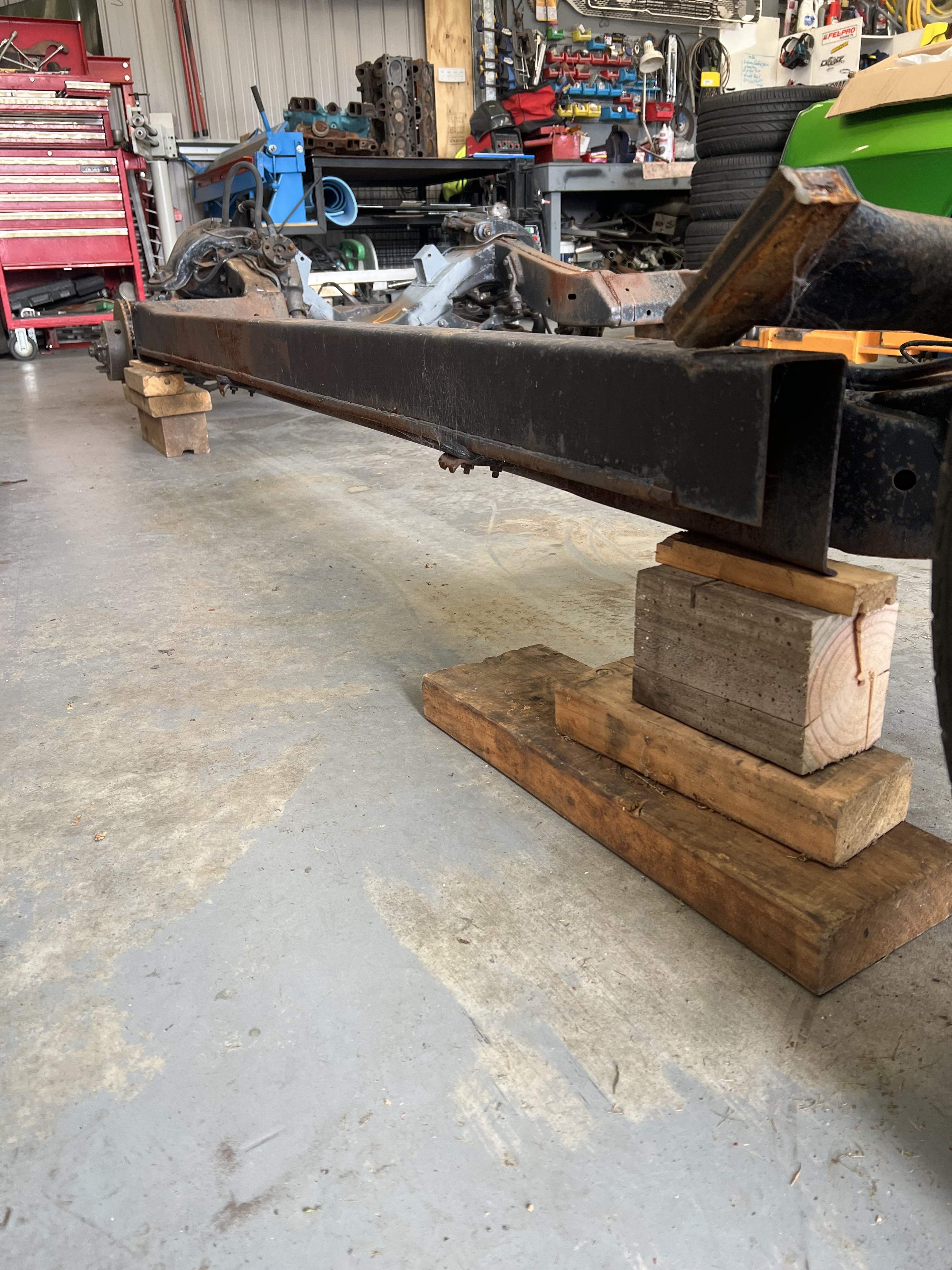

First job was to bring the 64 into the garage and measure her ride height…

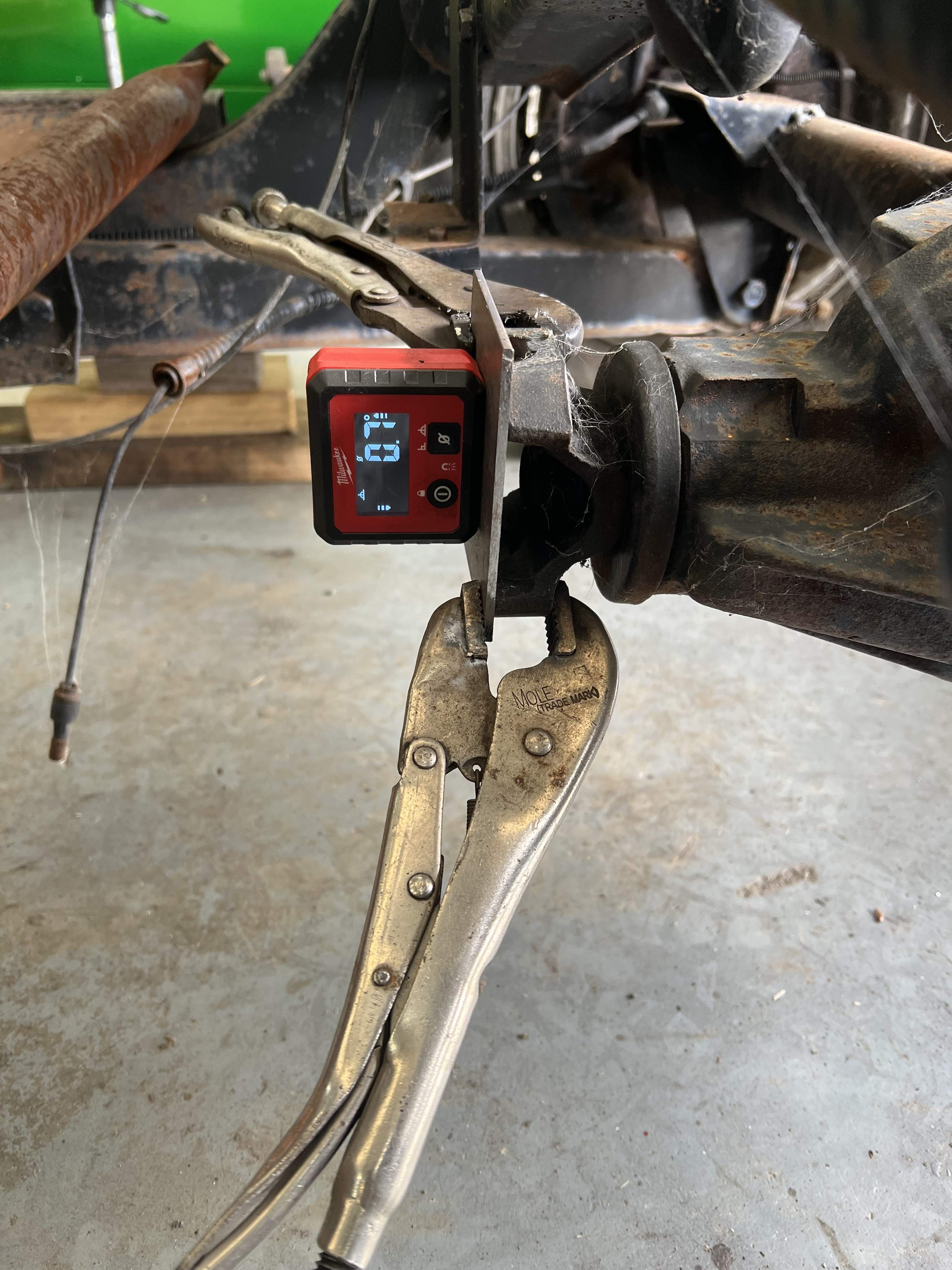

I want to set the ride height on the 63 frame since they are are the same, and can check the pinion angle of the diff ….
the 64 sits justA where I want the 63 to sit height wise ..
200mm front and rear to the bottom of the frame rails, as you can see, i have set the frame on my floor at the ride height i want ..

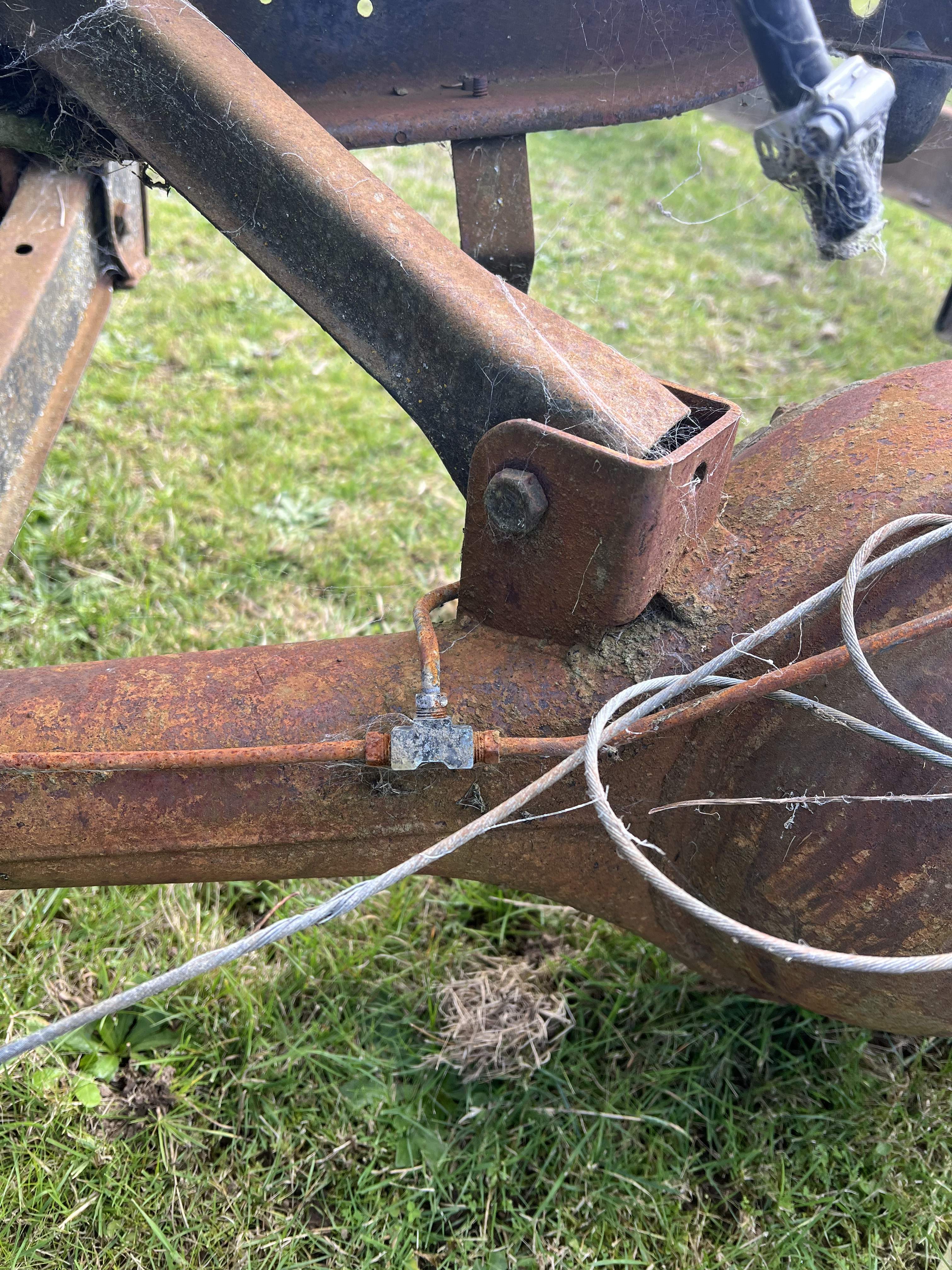

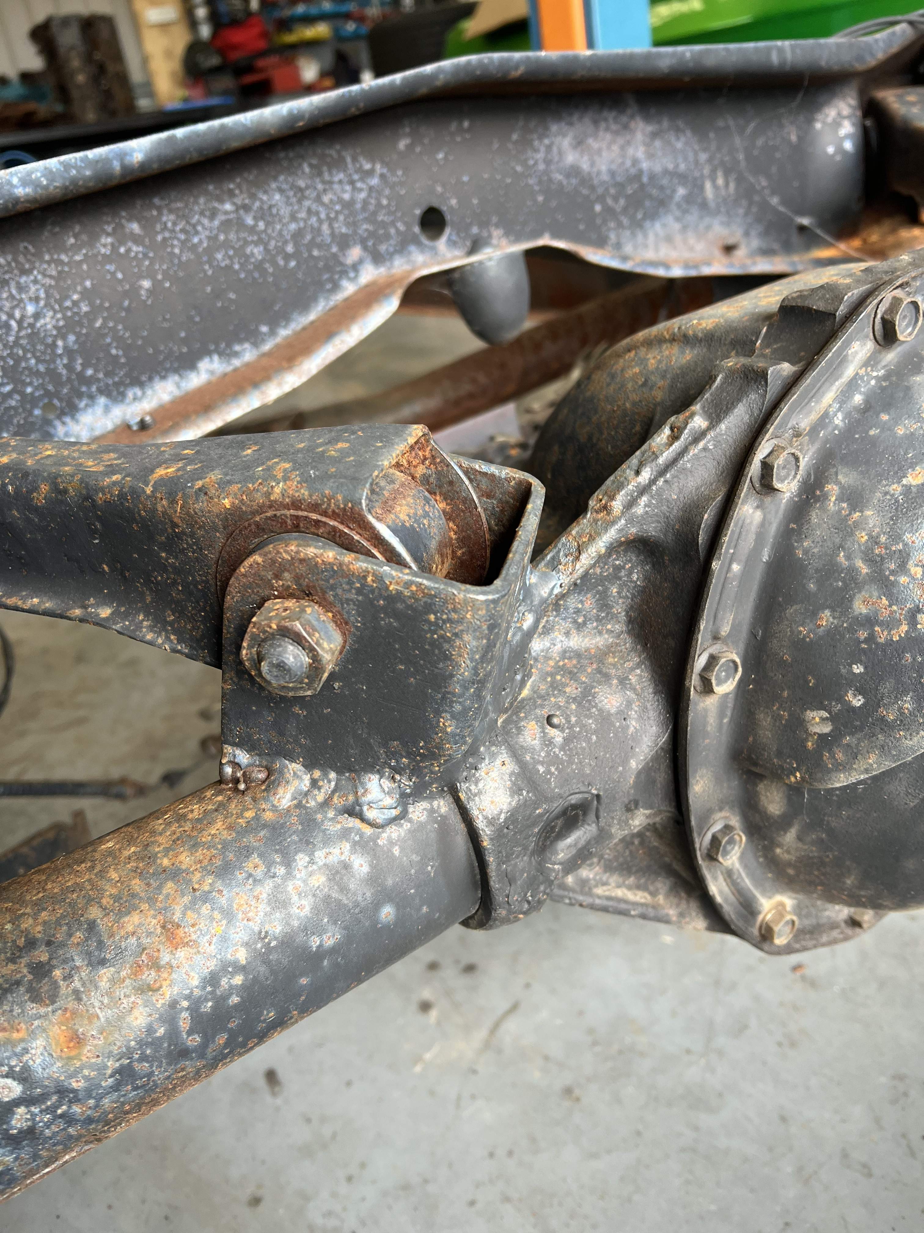

I was so not happy with the 12 bolt that the previous owner had installed ..  pinion angle was only one issue !!
The welds where soooo not flash and when i checked the spring bases, they too are welded in wonky postions ..... time to make a call on this diff !

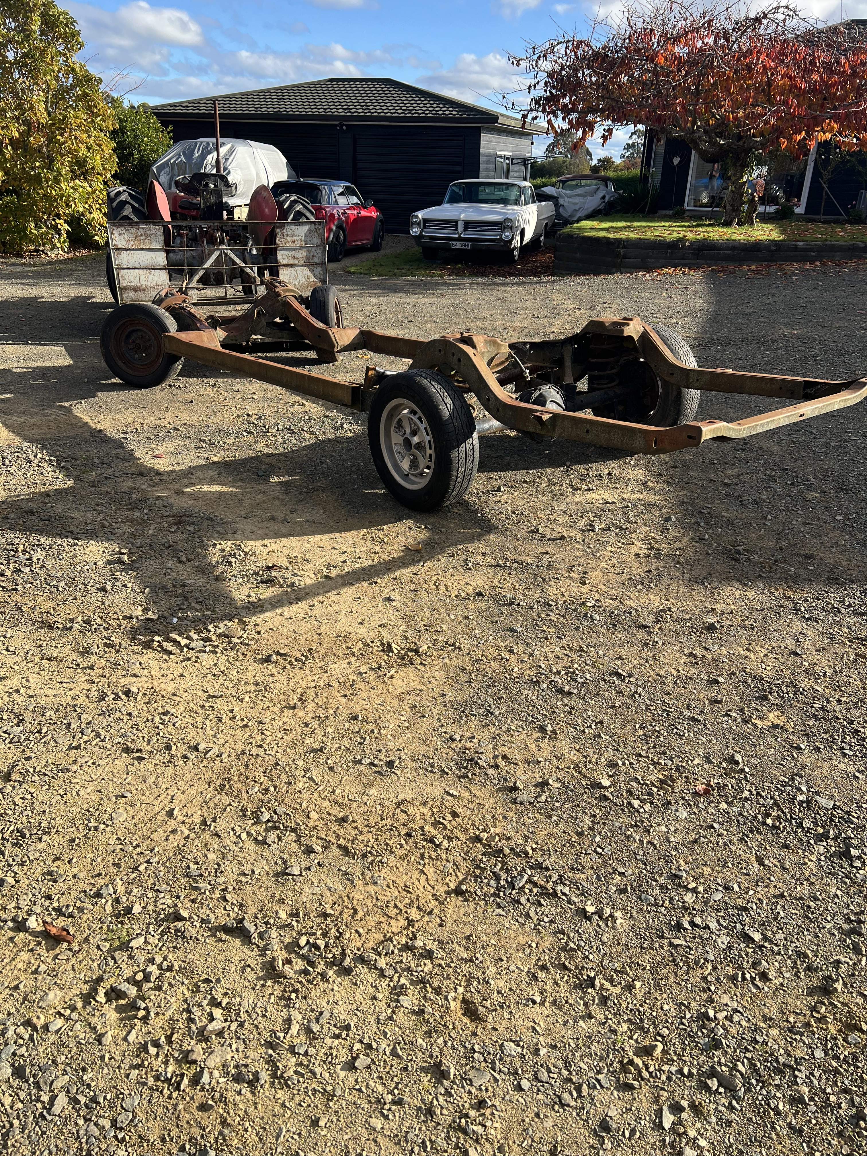

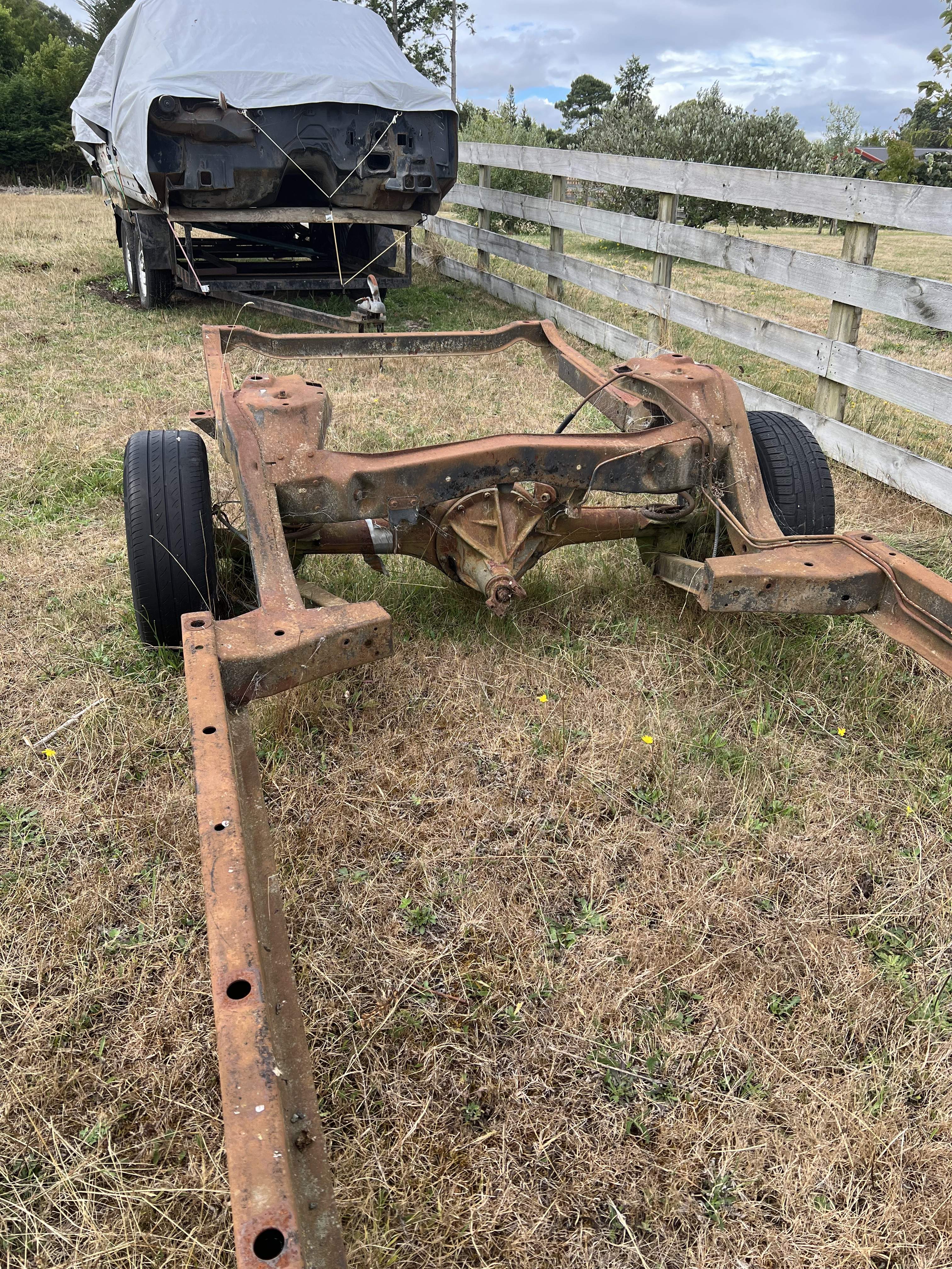

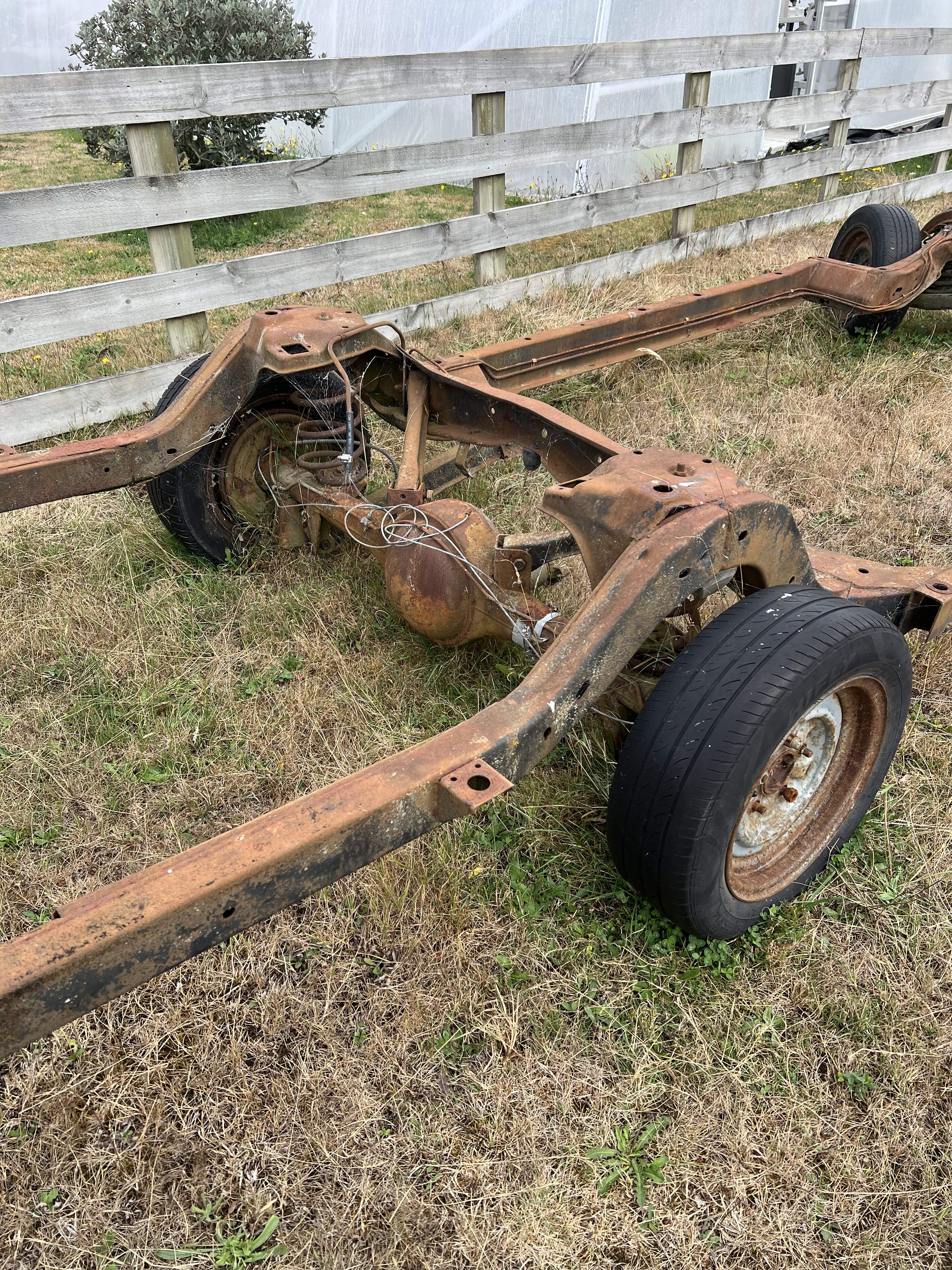

Out in the paddock is the frame from my donor 64 2 door hard top that has a perfect factory 9.3 inch .. all factory, all geomerty is stock ......

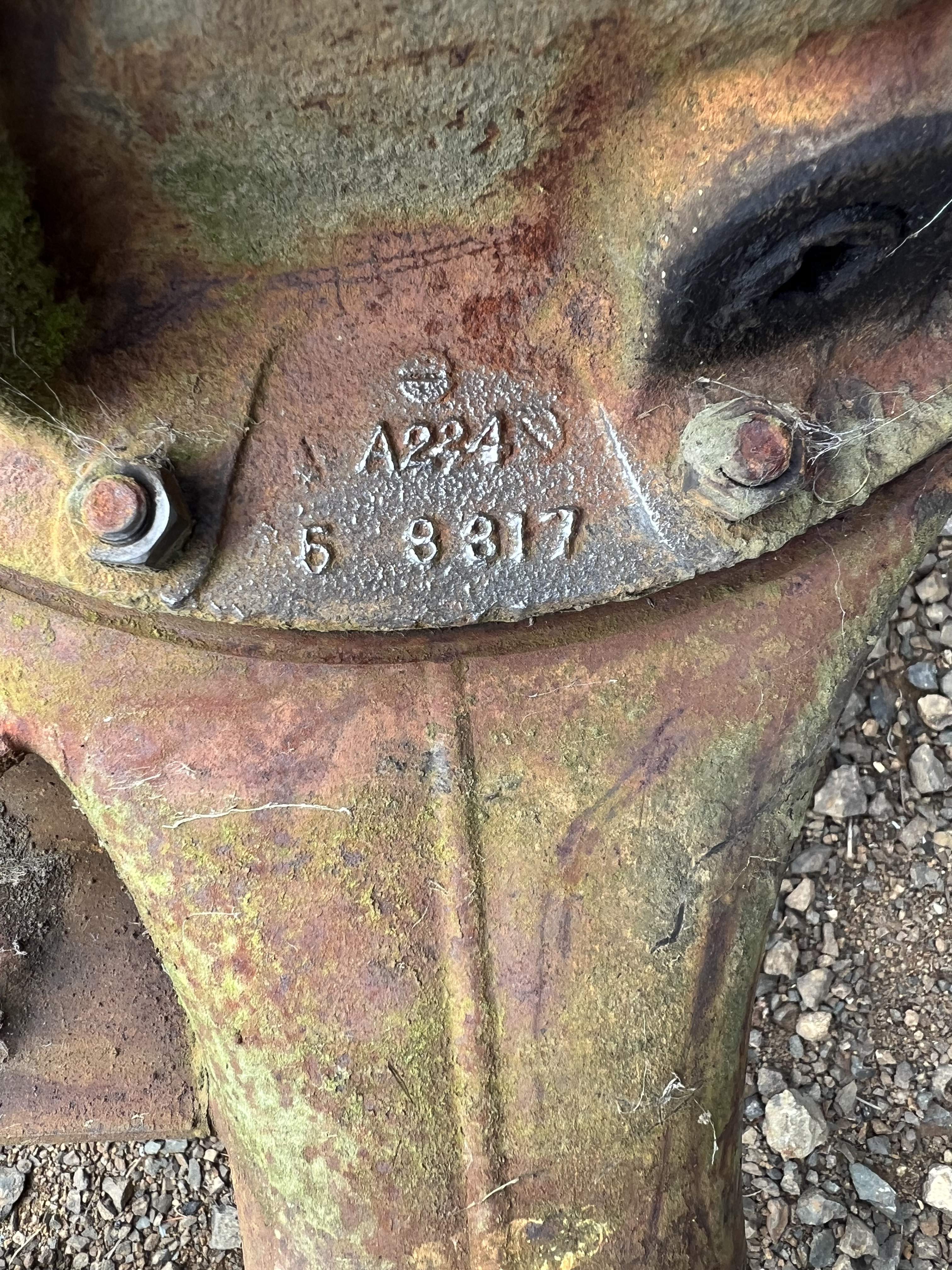

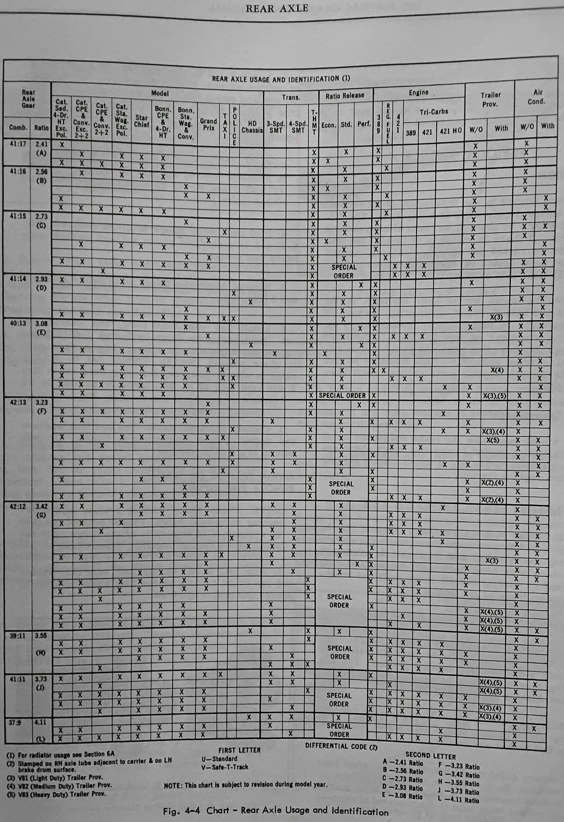

frosty ! what can you make of these codes ? 2.9 to 1 single wheeler ?

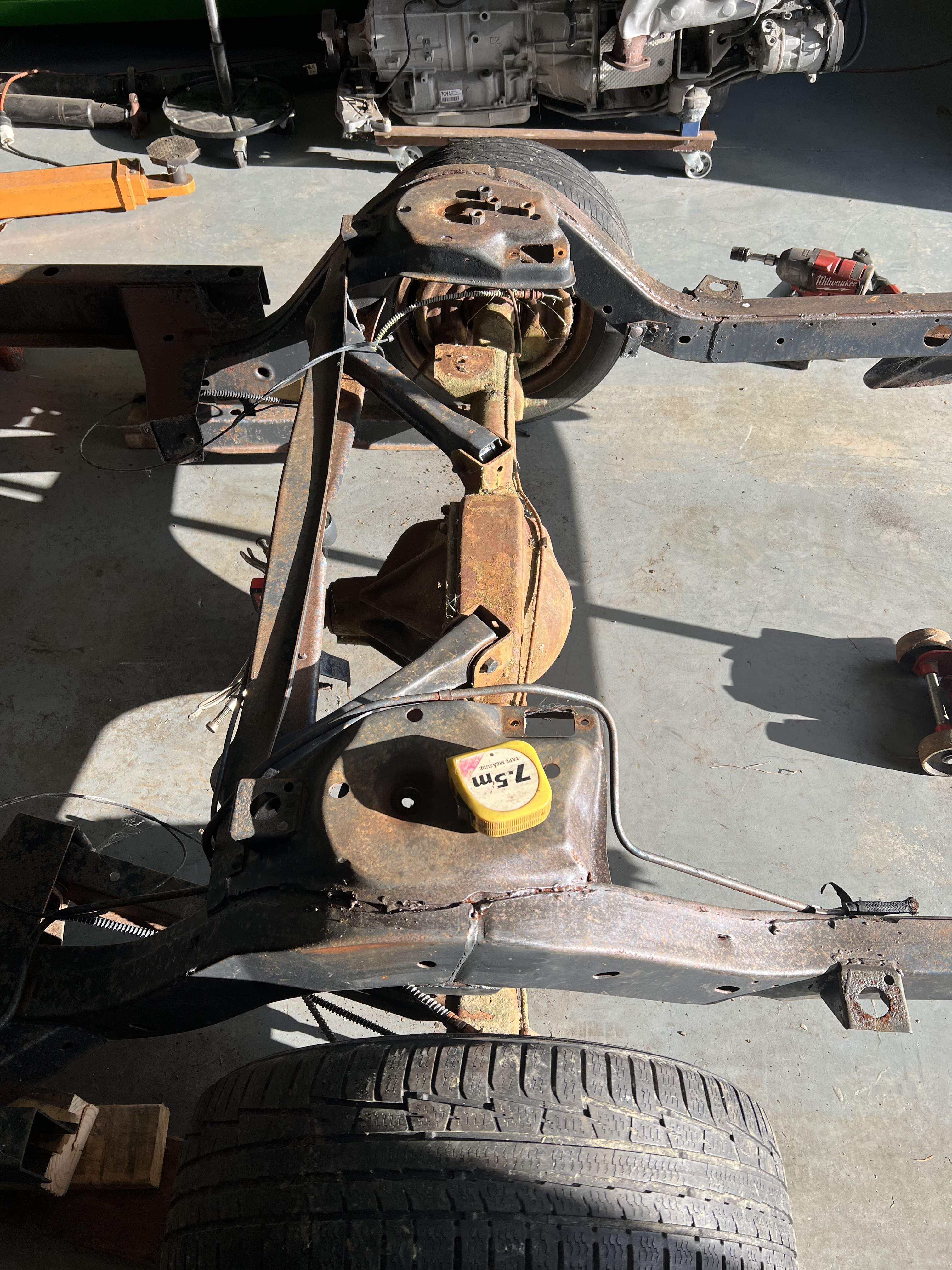

so the call was made and i installed the 64 diff under the 63, frame ... it went in perfect ......
and i stuck the 12 bolt chev diff into the bent frame, it did not go in easy, which reiterated that the mounts where not any where near perfect !!!, regardless of the condition of either diff, i am going to do a complete rebuild of the one i use, which now is going to be the factory one, guys any suggestions on sorces of parts ?
i want to up grade to a disc brake set up too, the 9.3 is missing too many parts to go stock
The diff type & ratio codes on my car are stamped into the top of the RH axle housing - it's a really light stamping and I had to wirebrush surface rust & dirt away to find it. Mine says UC: U is an open wheeler and C is 2.73.
Anyway, your work is really impressive .I think you made the right call using 64 diff. As Justa said - the old frame is sitting there for parts, so use them.
