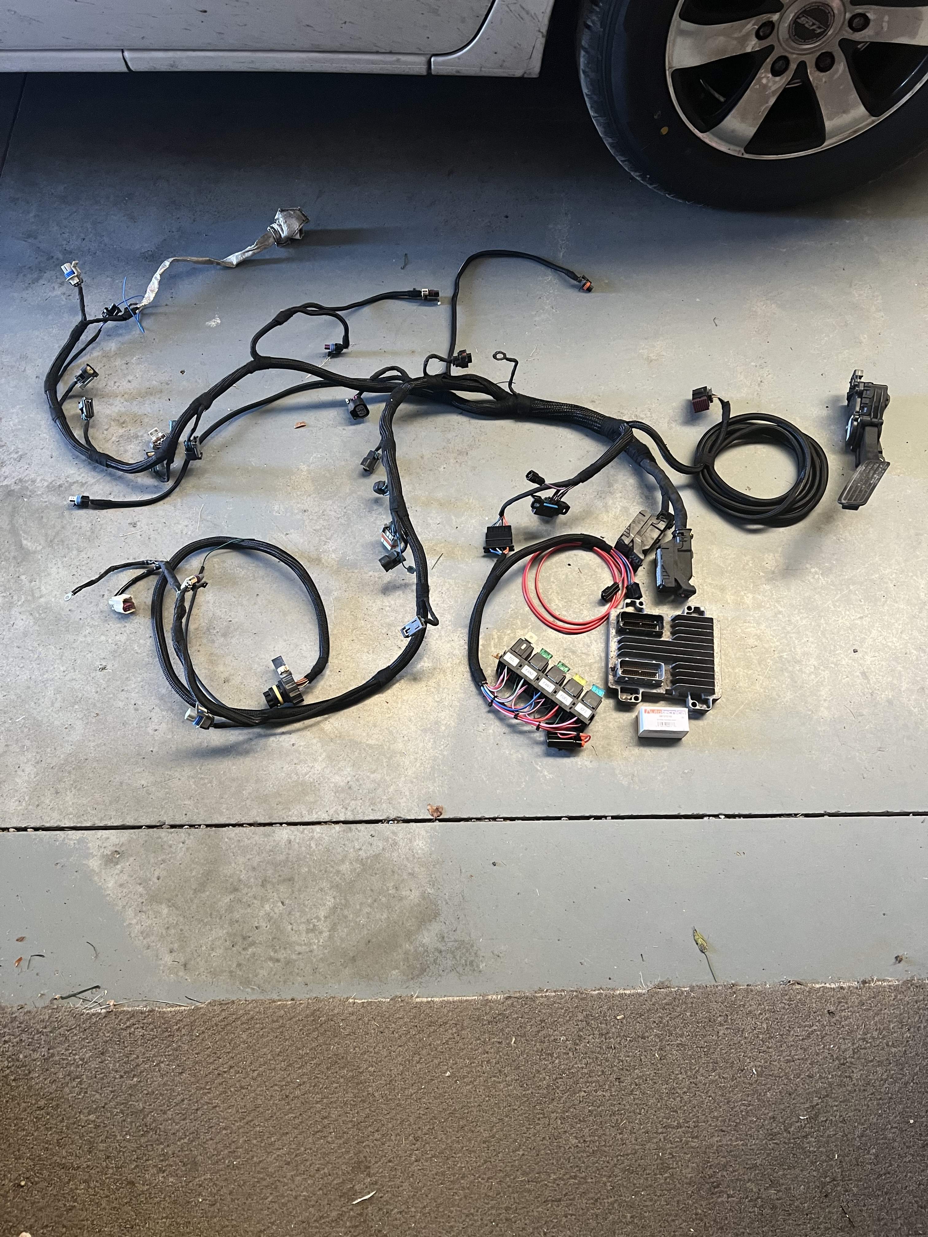

progress today ! the engine loom arrived from my sparky for the l98 and 6l80e :cheers:
I had my sparky cover the loom in braid sheathing
it has extra wires for oil and temp gauges along with Speedo signal wire and is a simple 4 wire hook up now , 2 fan wiring too.
Extra length on the gas pedal for left hand installation , intake air sensor that deletes the maf sensors
and a up grade tune in the ecu

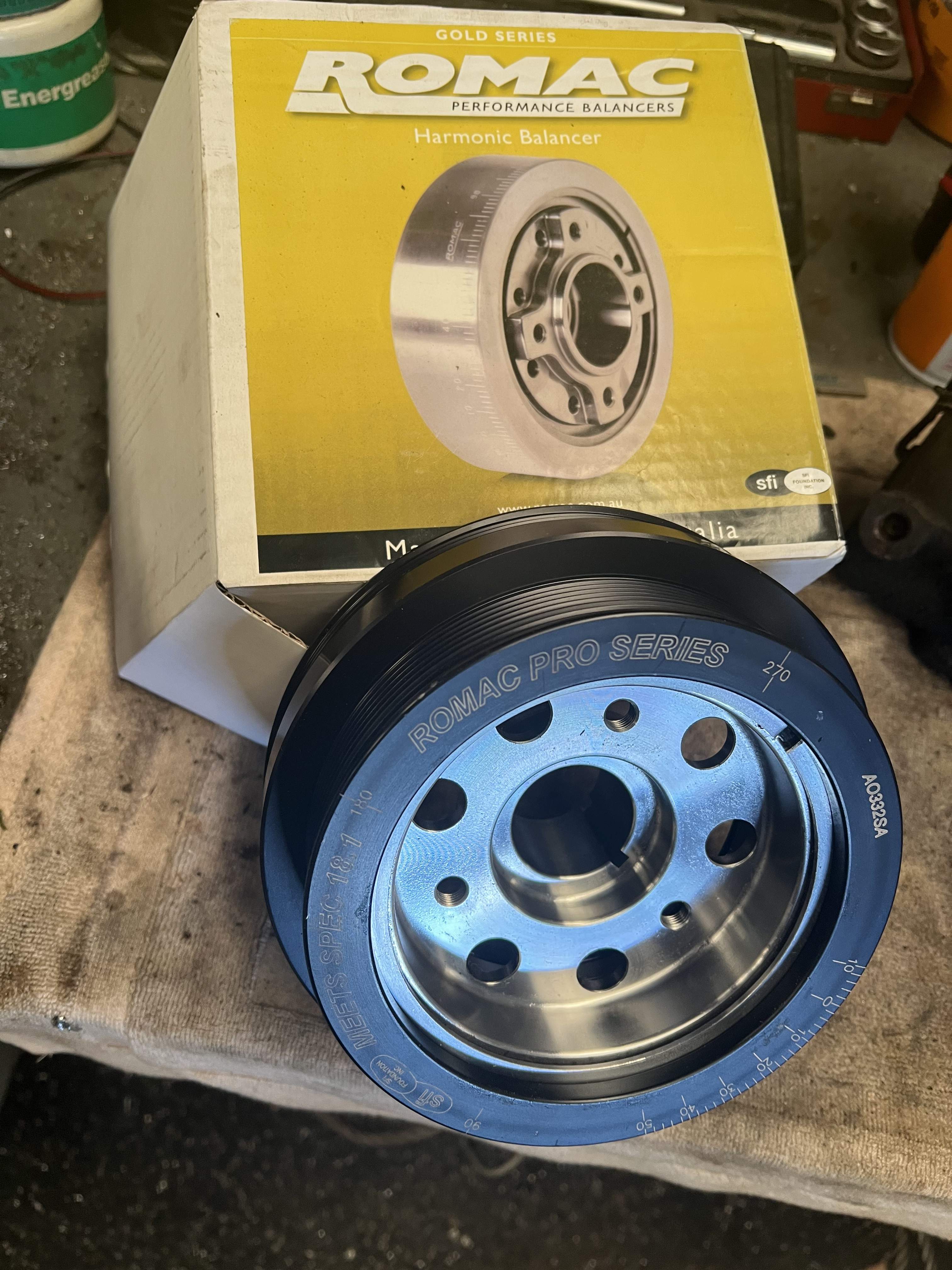

Also I am upgrading the balancer to a 25 % under driven unit for more power

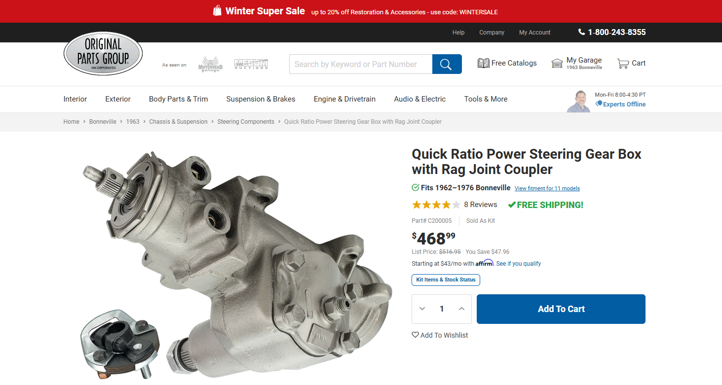

While studying up on 68 gto parts i have thought about if there is a quick ratio steering box that would bolt into the 63 .
has anyone done this too their b body ?

hmm I might call my steering guy
Pg hydralucs in Auckland can upgrade the factory box to quick ratio and add better road feel to it also 👍
so that’s the path I will be taking for the 63 ! They will rebuild the pump at the same time and supply brand new hoses

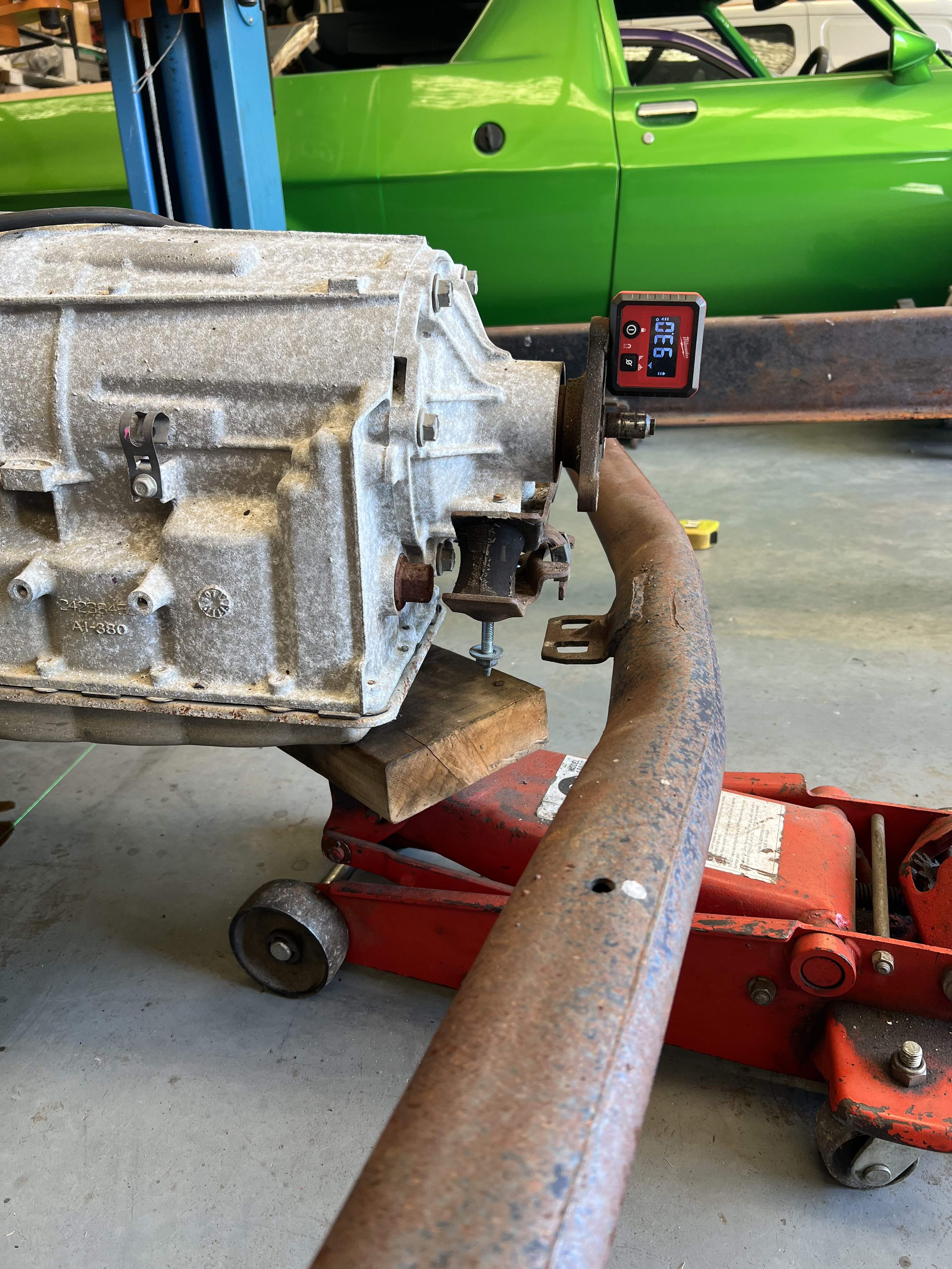

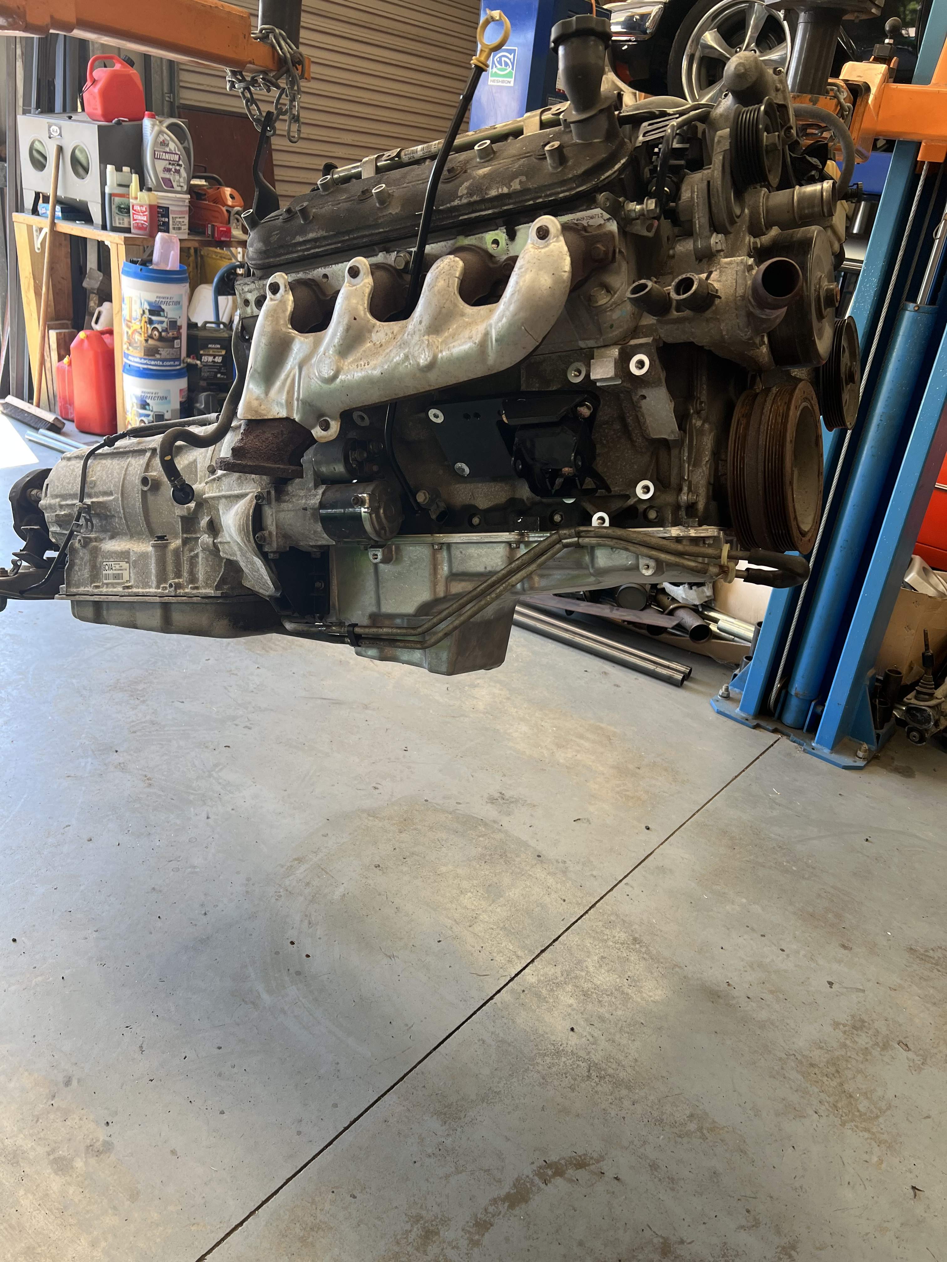

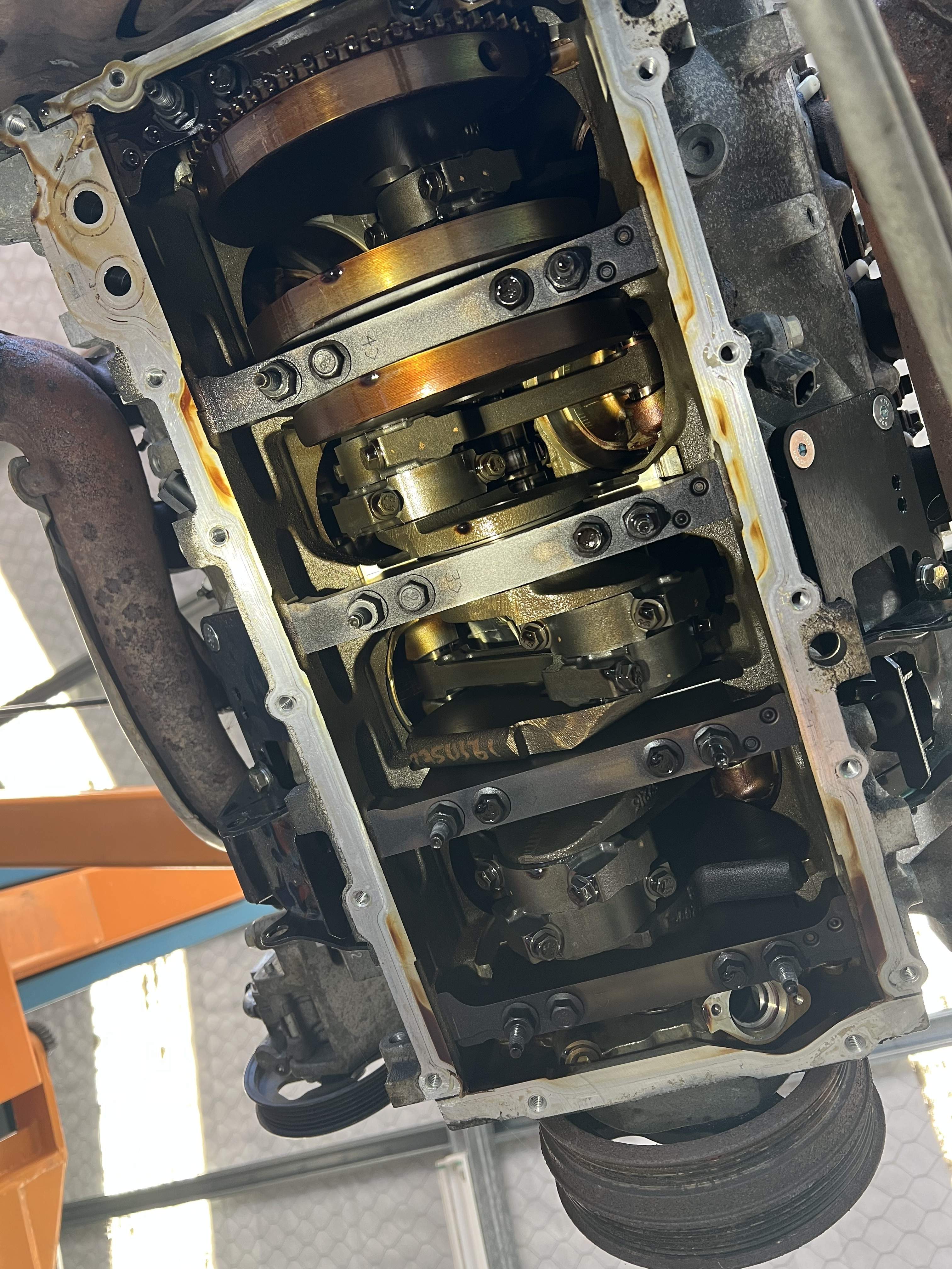

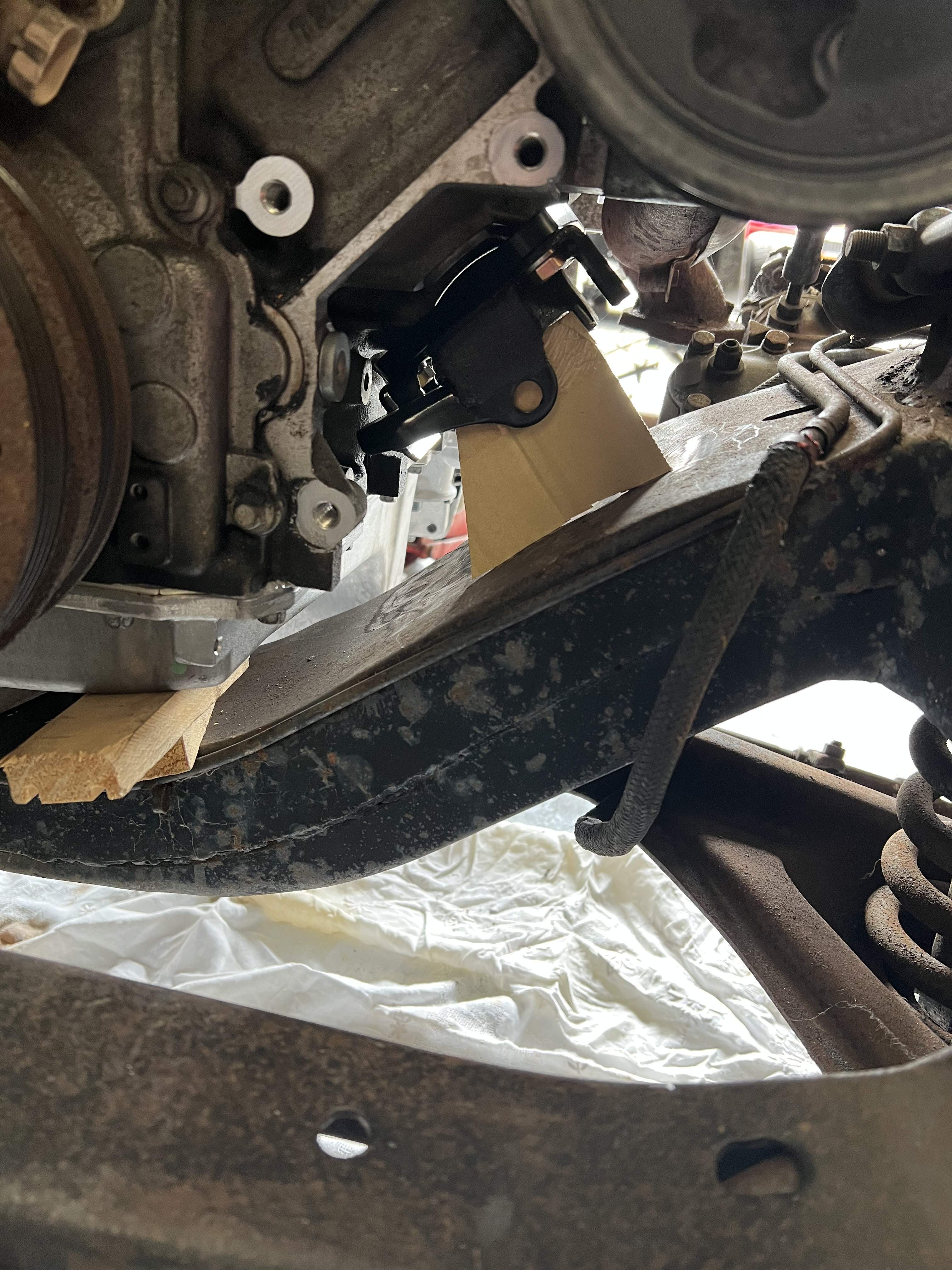

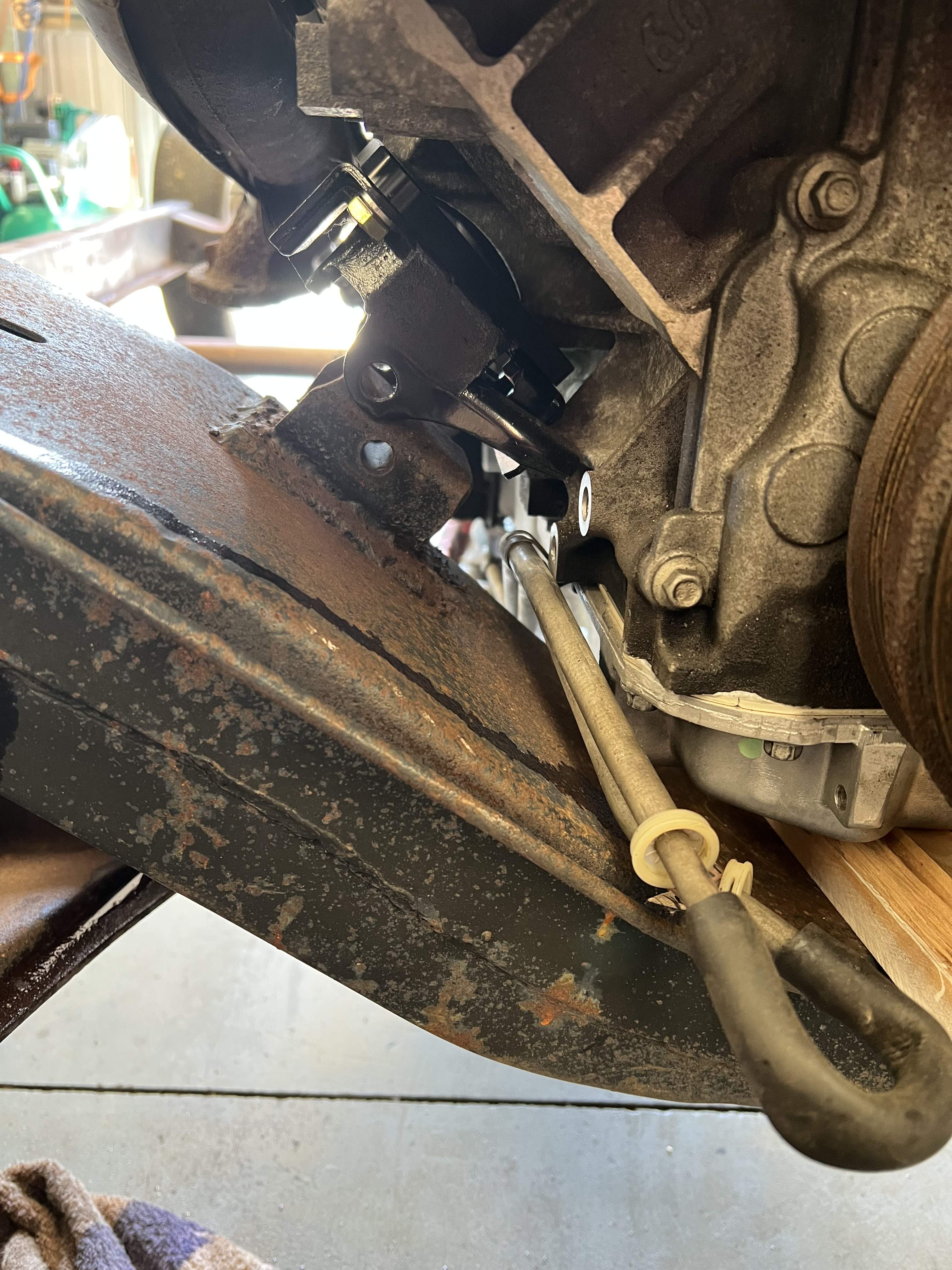

I made a start on installing the L98 engine today

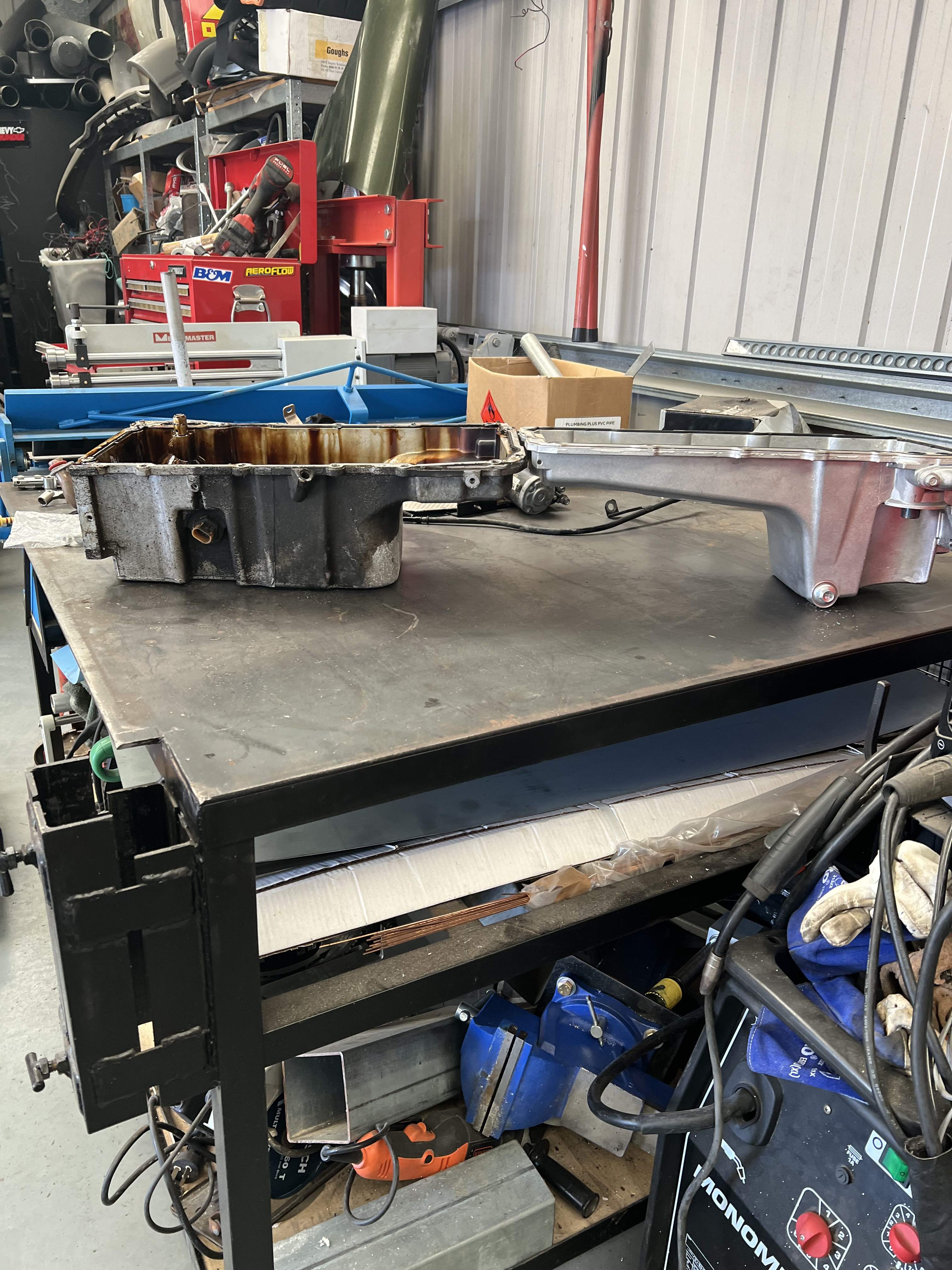

first was to get the sump swapped over , this  came out of a Holden , state side it would be a g8 2009 l98 with 6l80 trans …

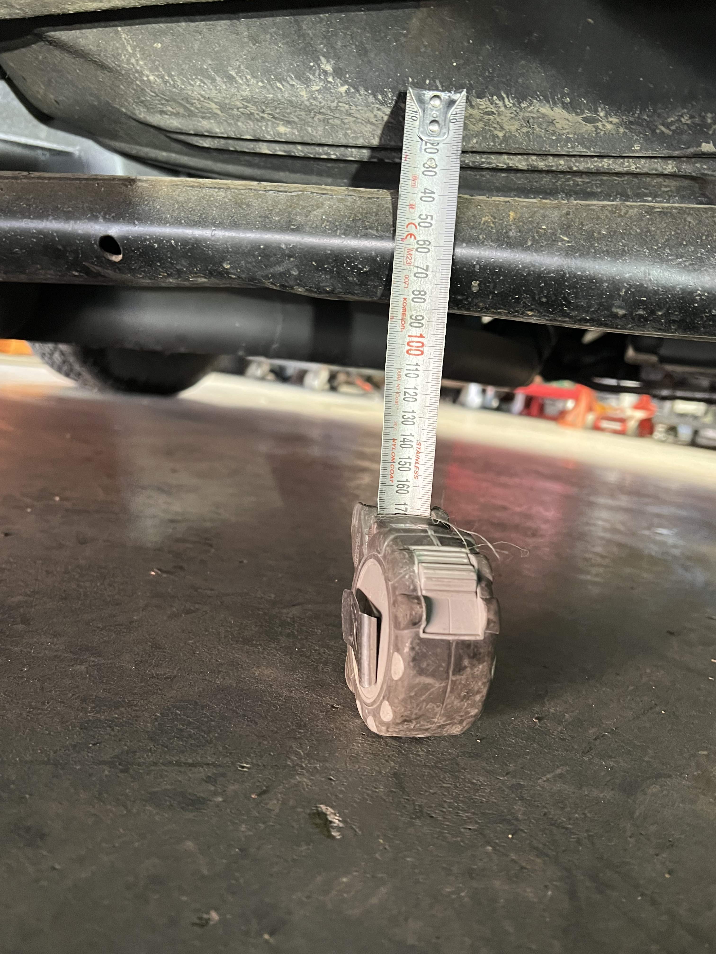

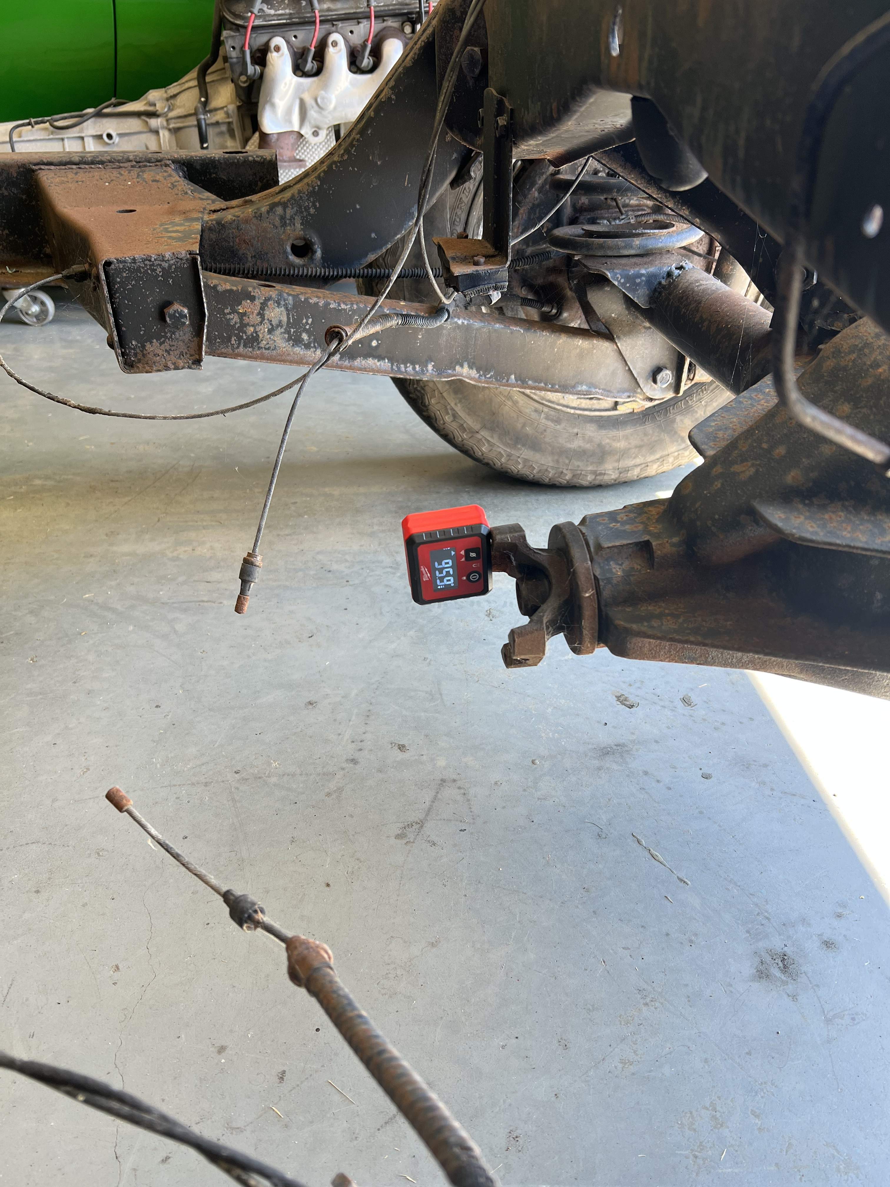

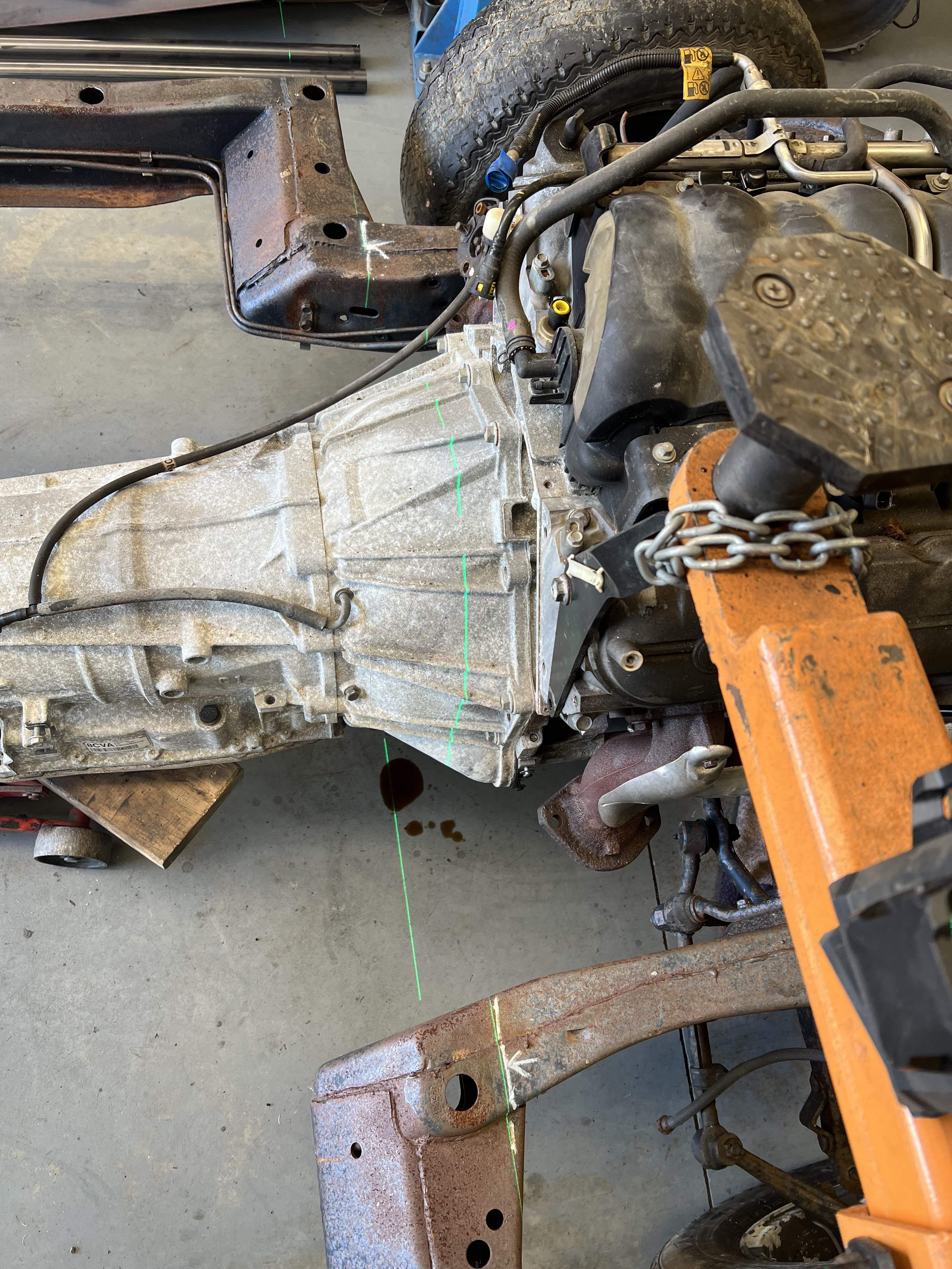

but first things first . I used the 64 to get a chassis angle and to see how much room I have for the trans cross member …
64 has 1 degree in the frame rail …
Then a measure under side shows not a lot of room above the factory cross member … all to be noted when making parts for the 63 …

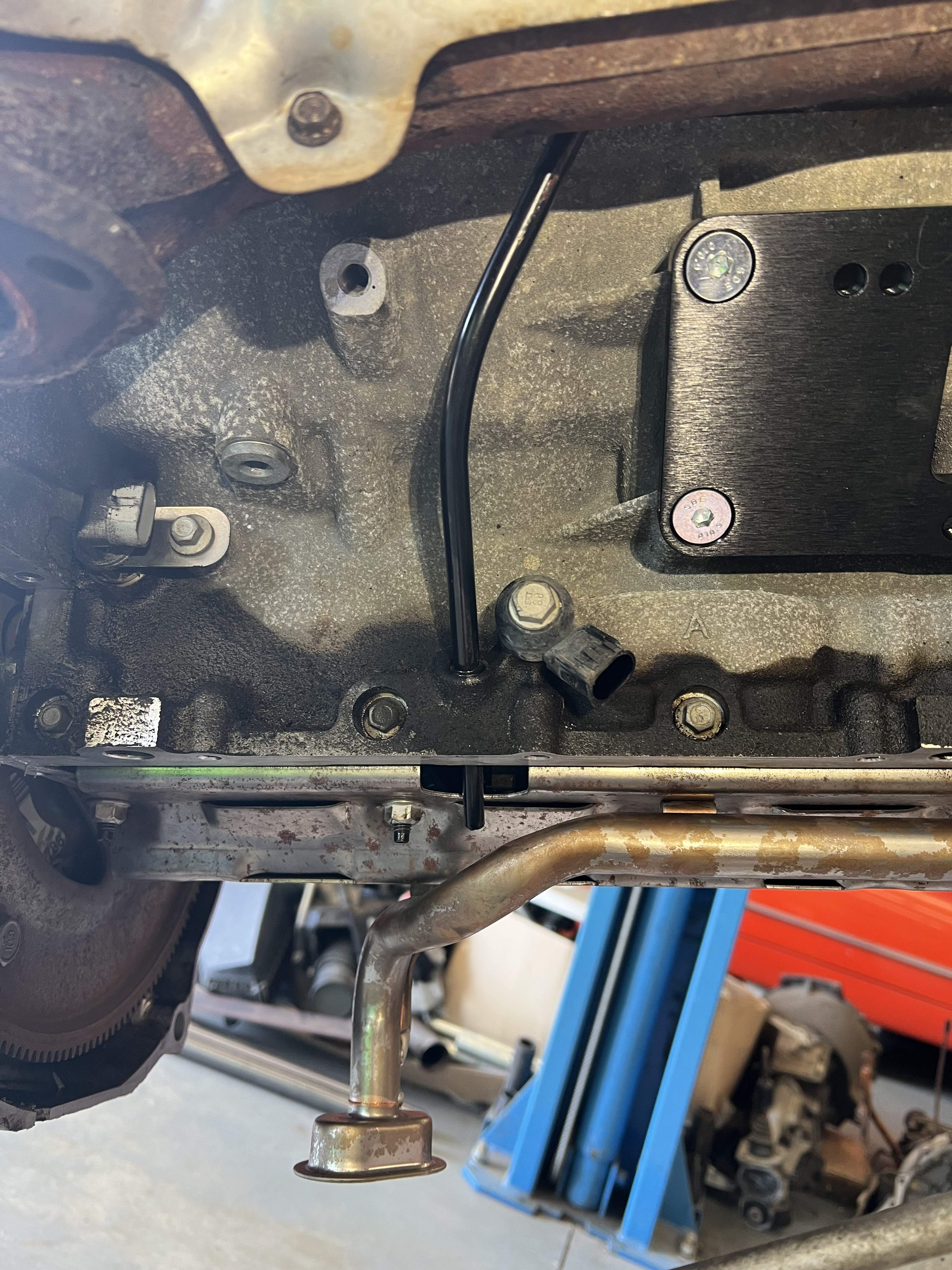

so off with the great big sump that  sooo won’t fit the 63 and on with the way smaller version
The Holden sump had the dip stick coming up out of the sump , the new sump came with everything needed including a new pick up bolts and dipstick that passes down through the block into the smaller sump ,,, there is a plugged hole on the passenger side that you need to drive out the plug from underside … BEFORE FITTING THE NEW SUMP !
which of course I didn’t , so I got 2 goes at fitting the new sump 🤪

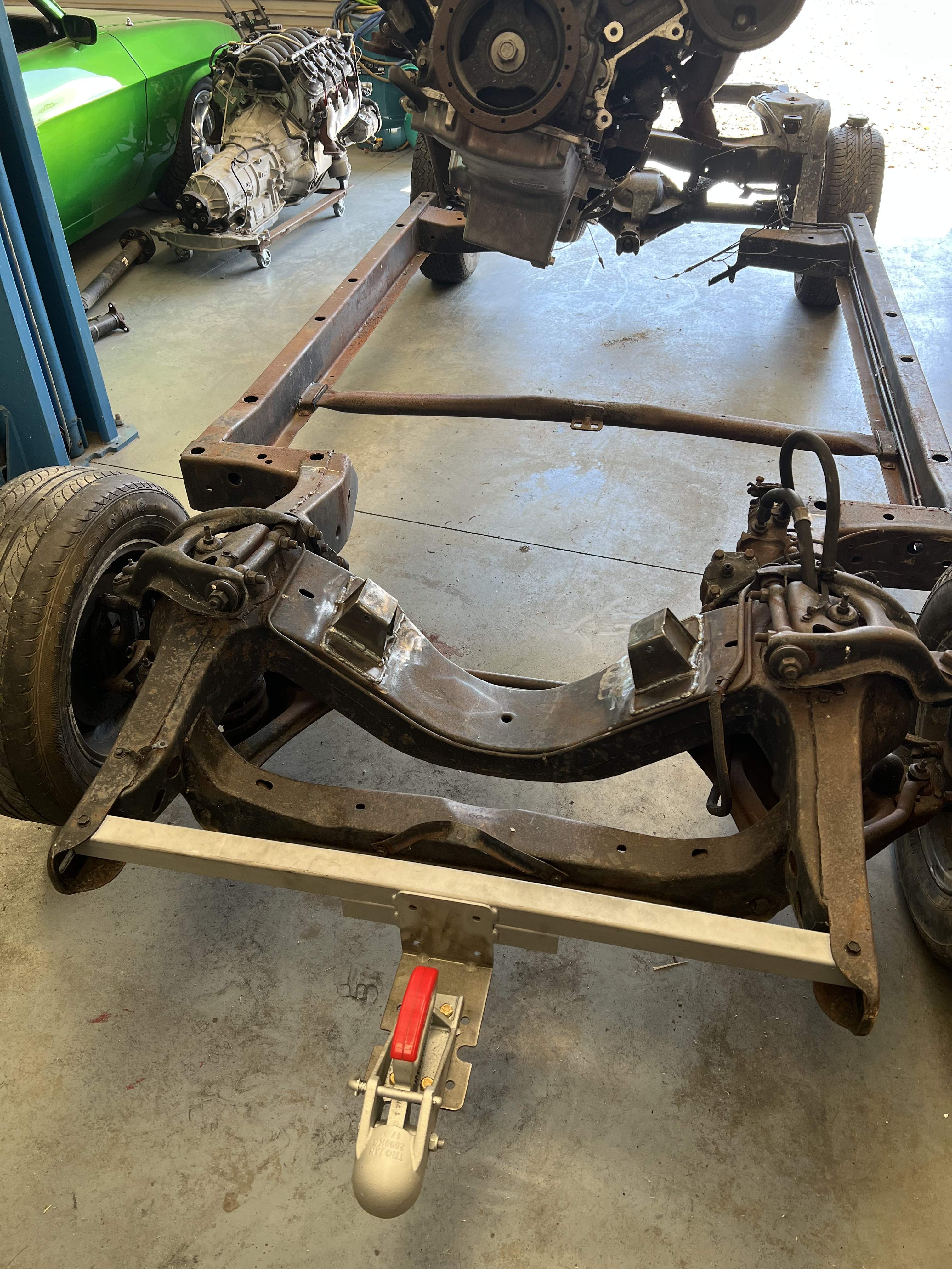

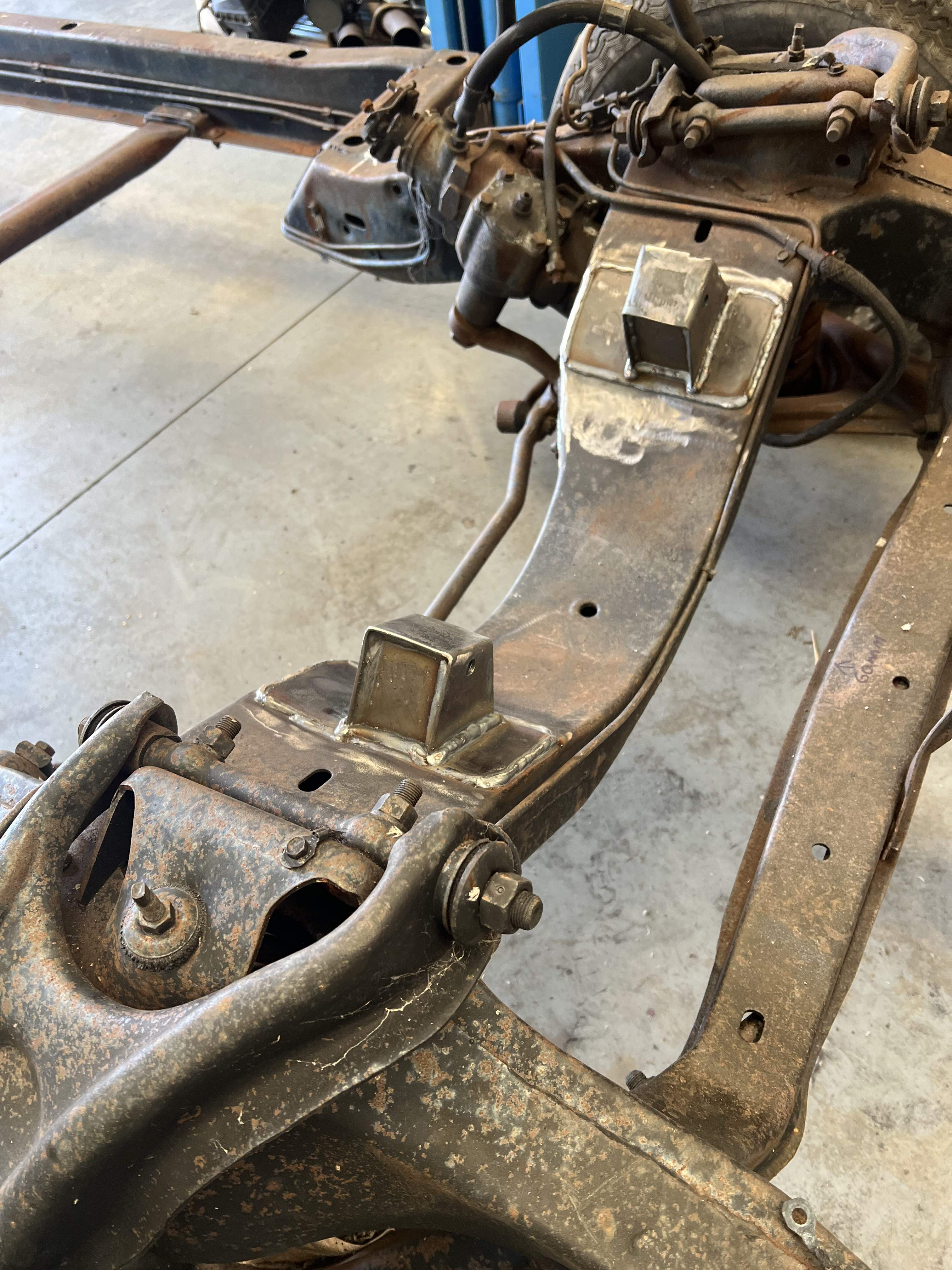

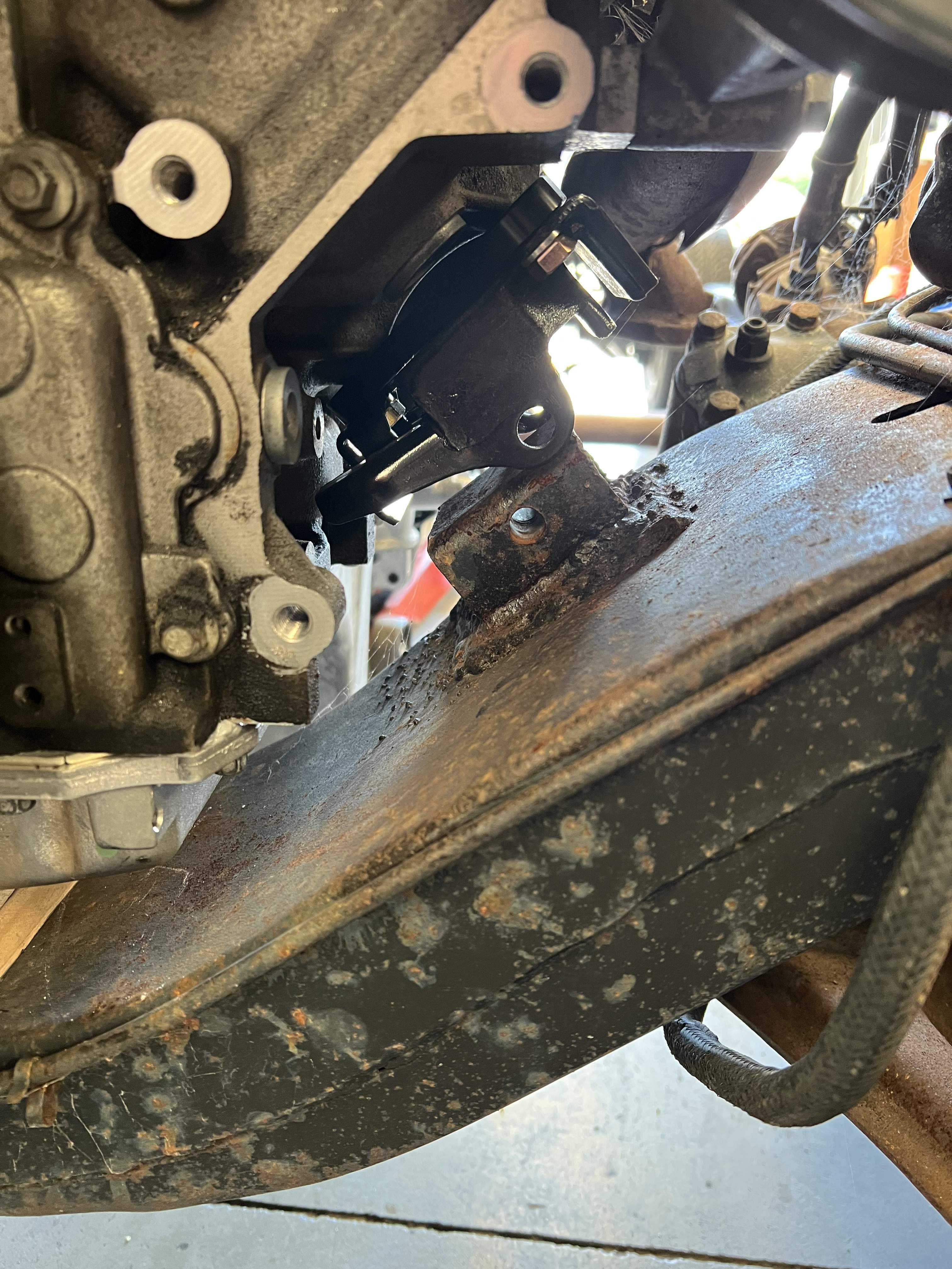

Next was to see if my Ls to Chev adaptor mounts would line up to what was already on the 63 frame ,,, this wagon used to have a big block Chev in it ,,,
check out the pictures , no way was it going to line up ! To short and too far back

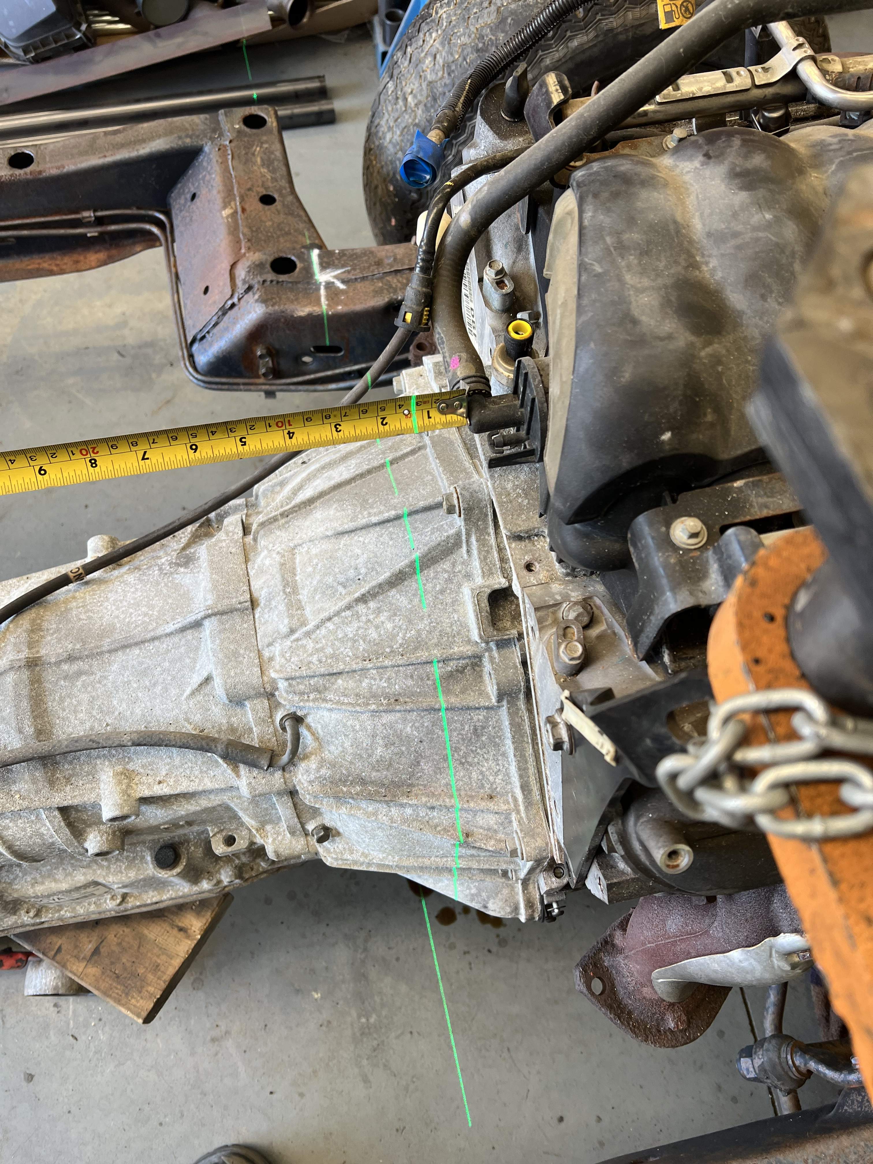

Using my lazer and a digital level I could see where my fire wall was going to lay in respect to the motor . Before removing the body from the chassis I marked the fire wall location on the frame

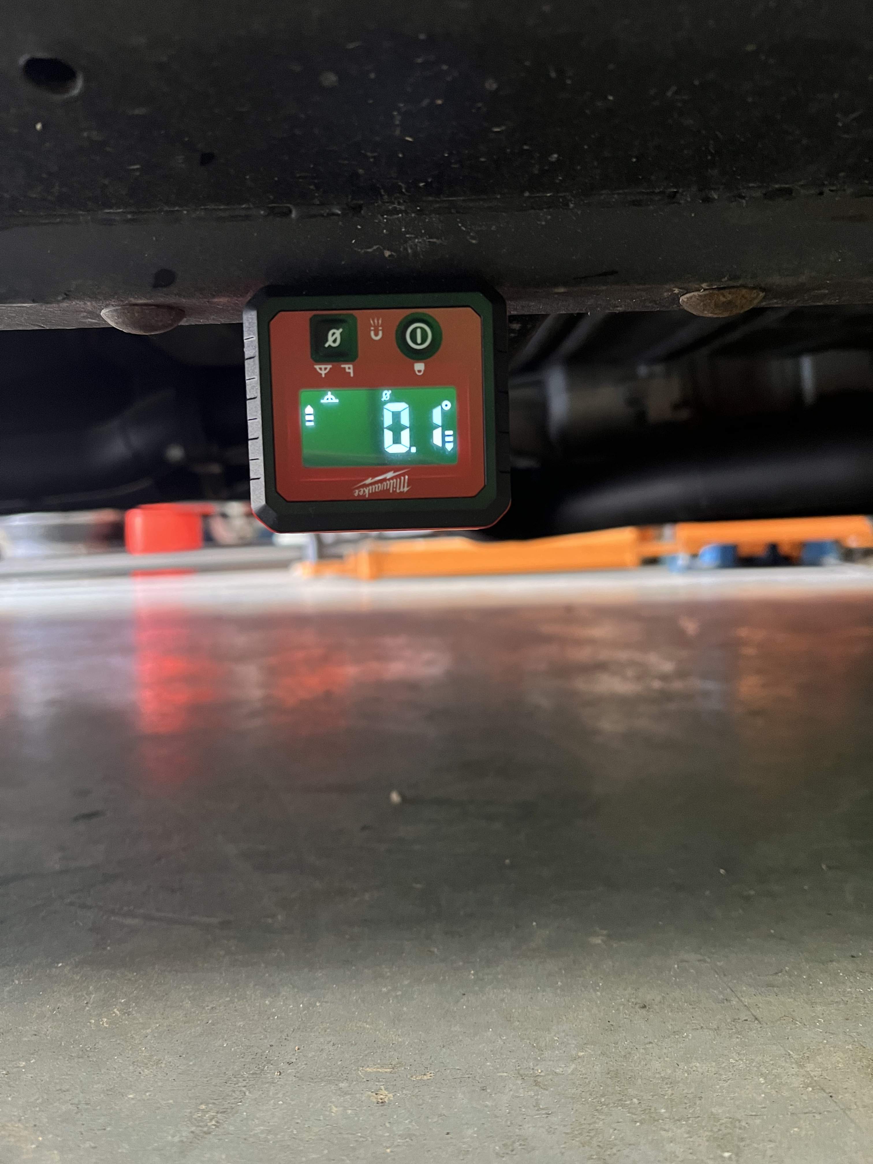

And the Milwaukee level on the tail shaft to get my 3 degrees
While I had the level out I put it on the 12 bolt diff , and it’s sooo wrong !!! 6 degrees facing down !!! Which means I will need to completely redo the rear axle mounts !!!
they look to be badly made , and I am not happy with the mounts . So that will be in my list after the motor is mounted

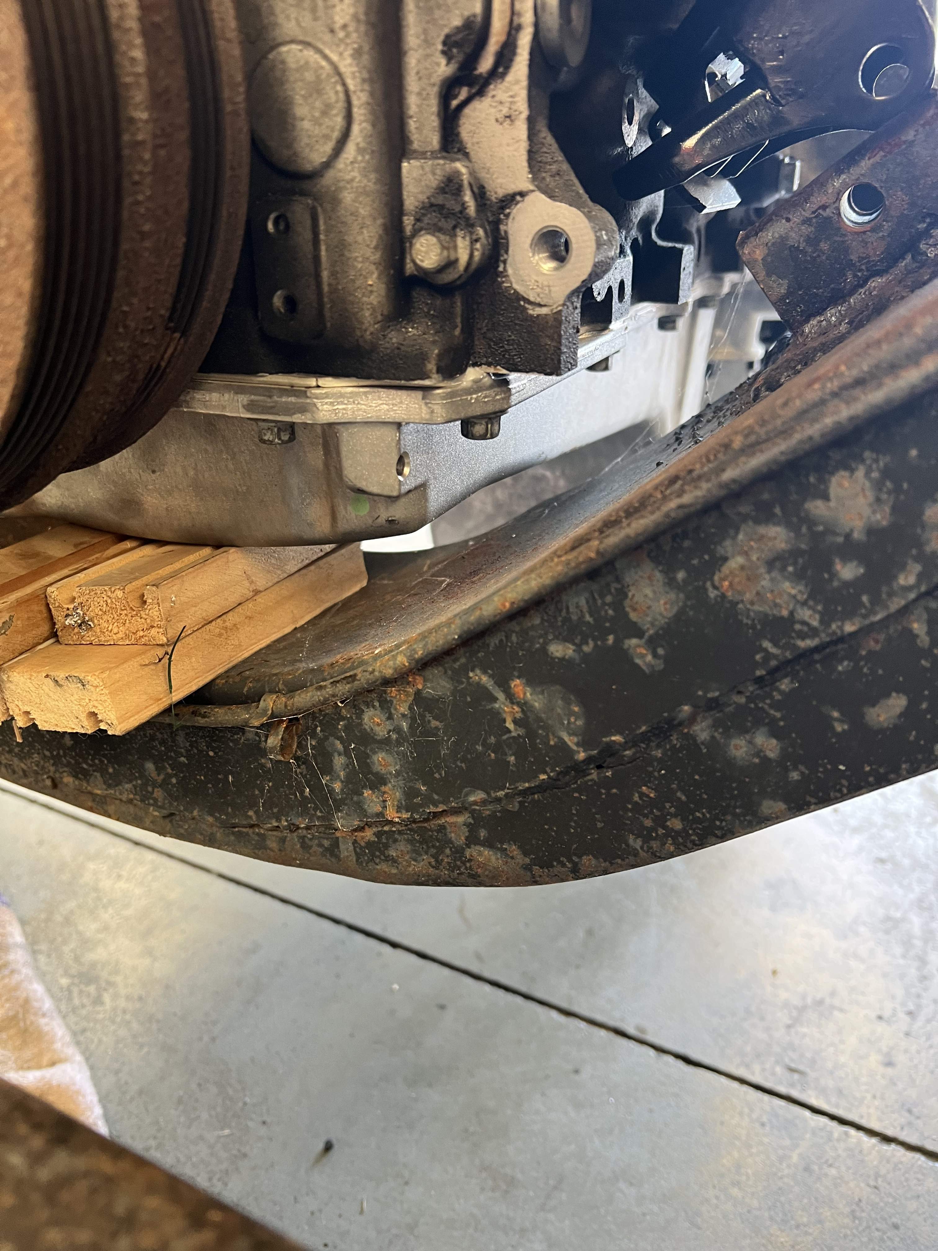

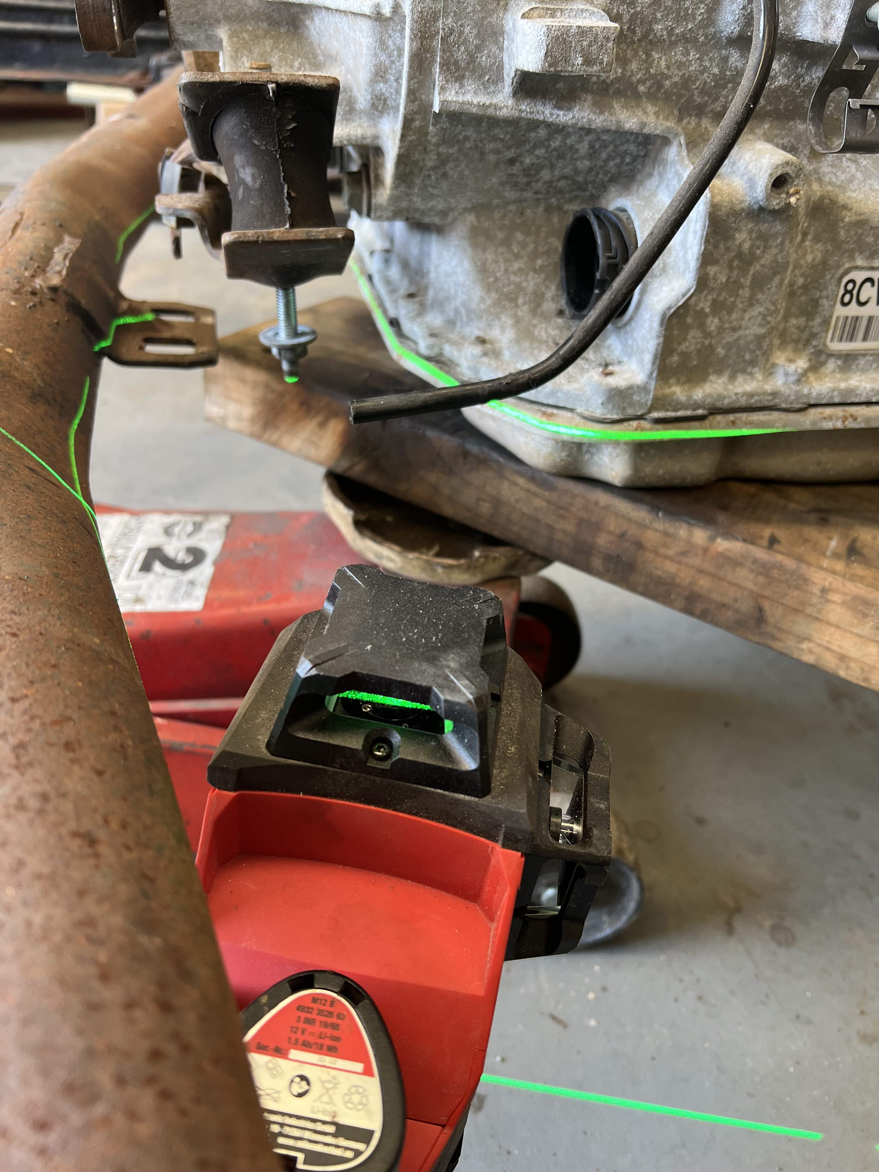

With the motor set where I want it at 3 degrees I utilised the lazer again to give me a in site to the trans ground clearance
the green line showing in the trans sump corresponds to the bottom line of the frame rails , which means I have it set justA right , 30mm hanging down from the rail line , I went and compared this to my factory trans in the 64 and she’s exactly that amount too .

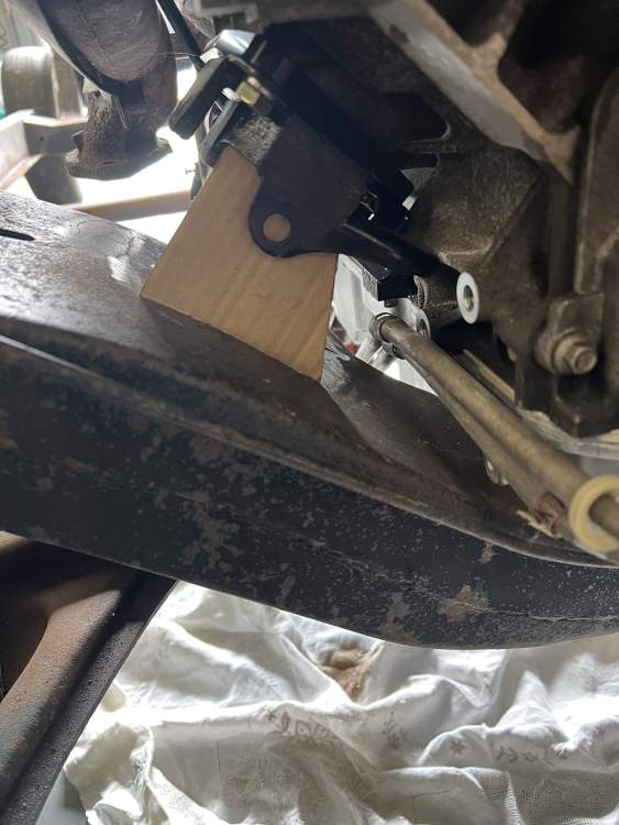

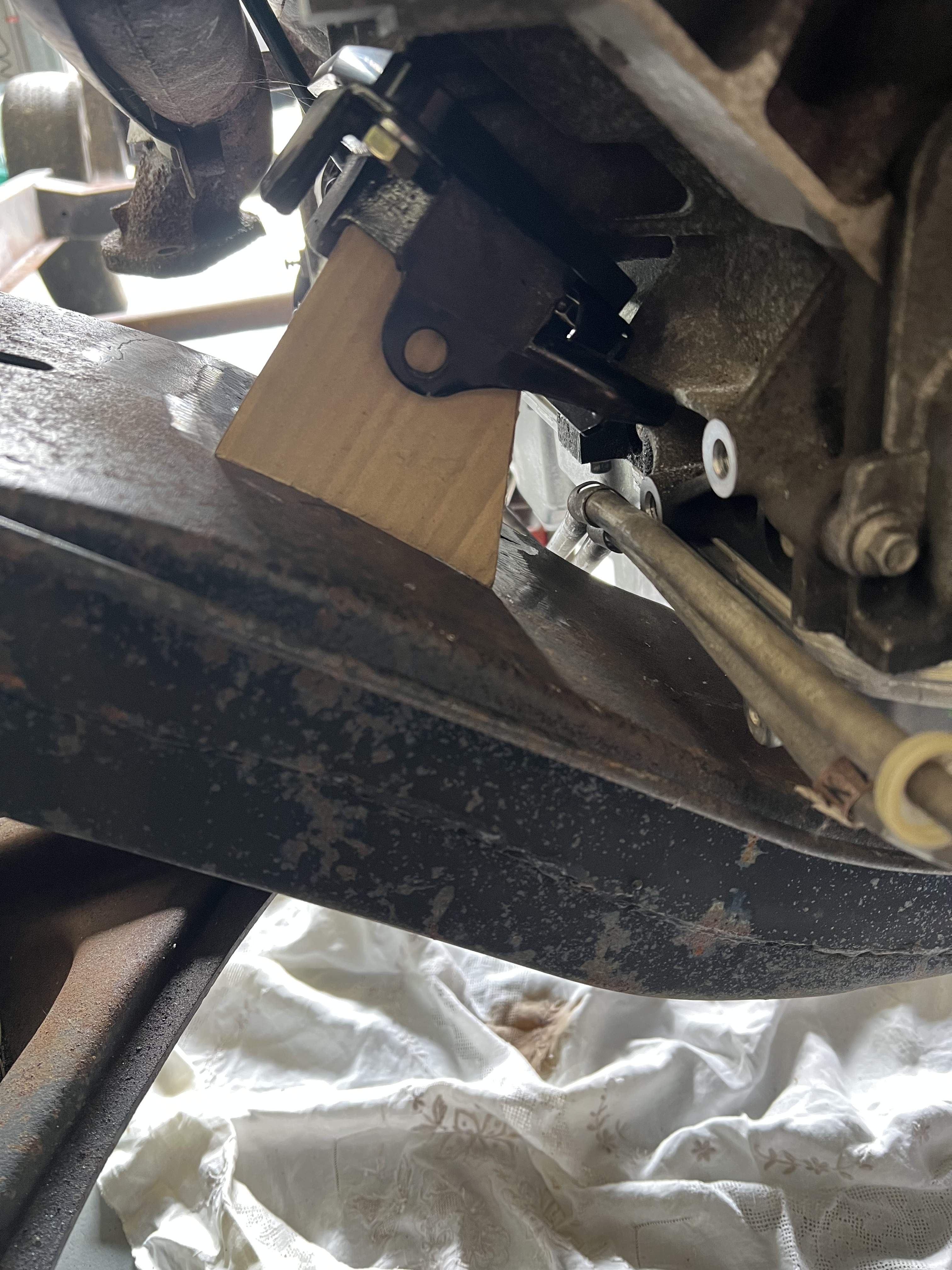

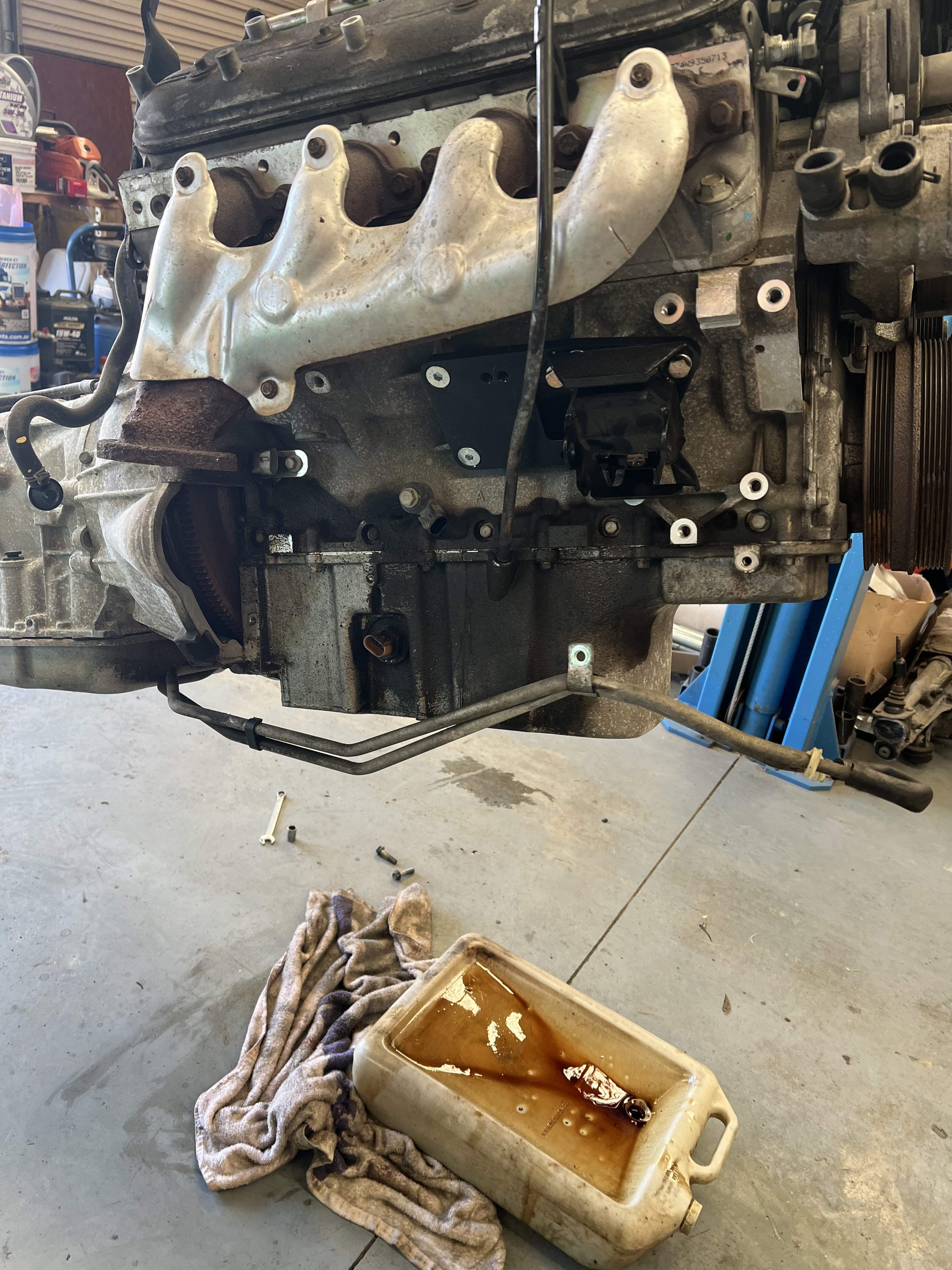

So motor back out and off with the nasty looking mounts !!!
then
motor back into the right location , And just finished the day with making cardboard templates, and thinking about how I want the mounts to look 👀
beer o clock o feel !!!

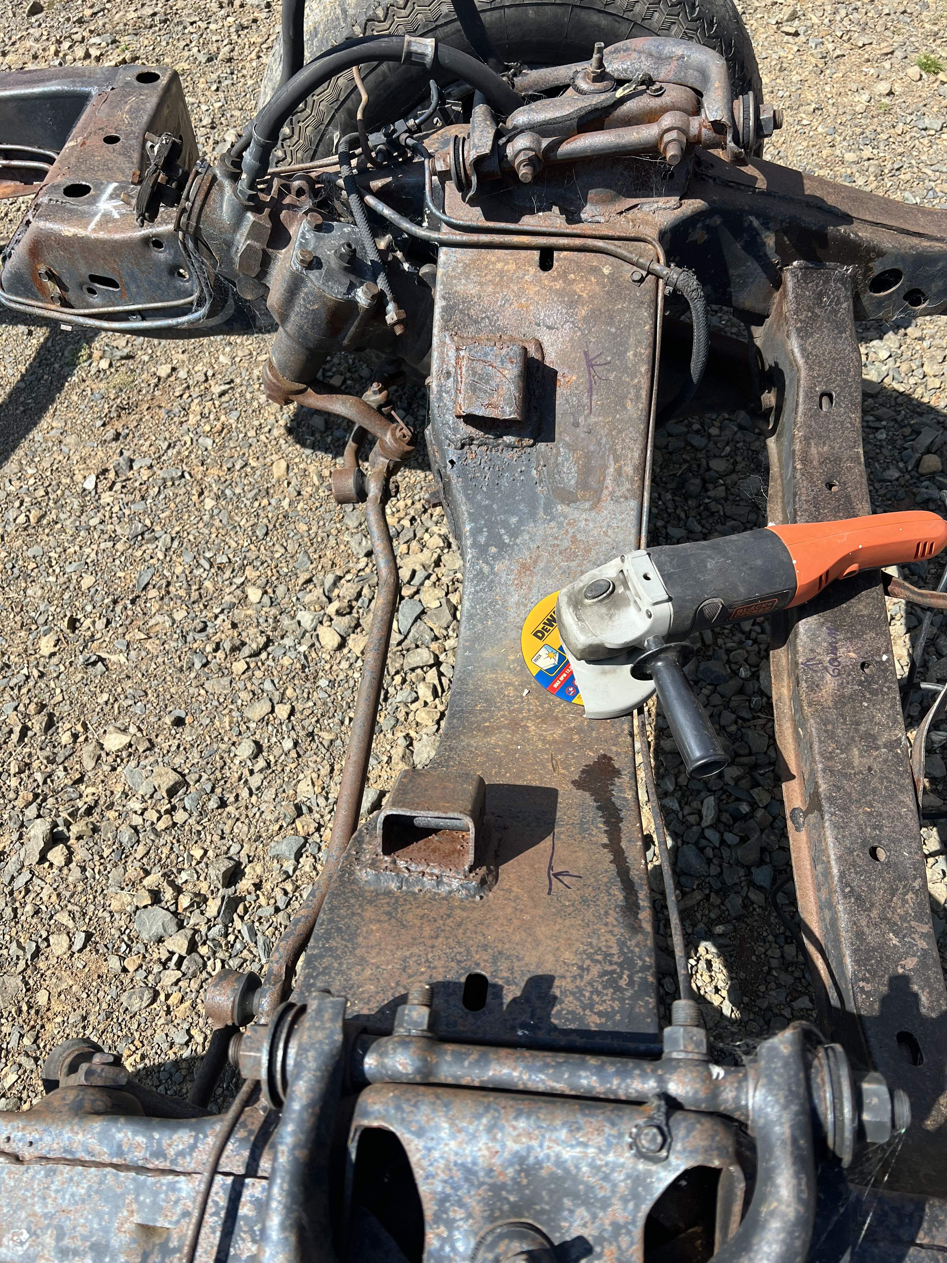

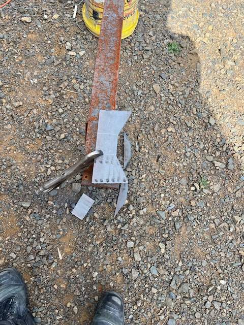

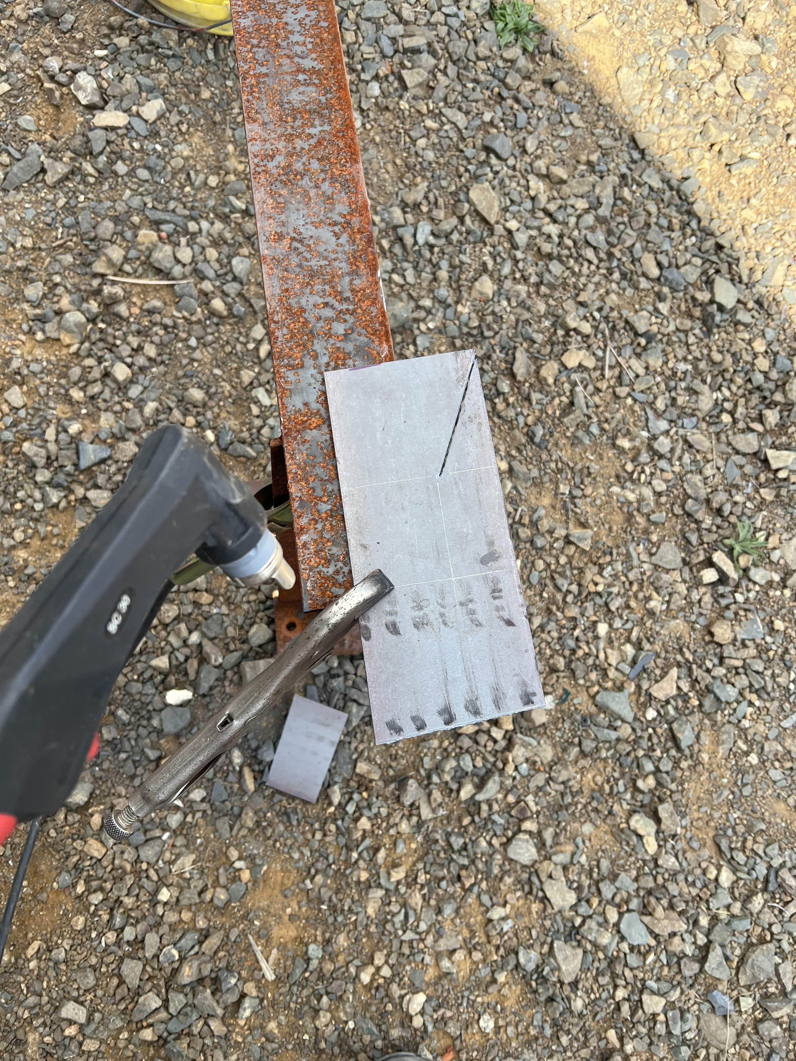

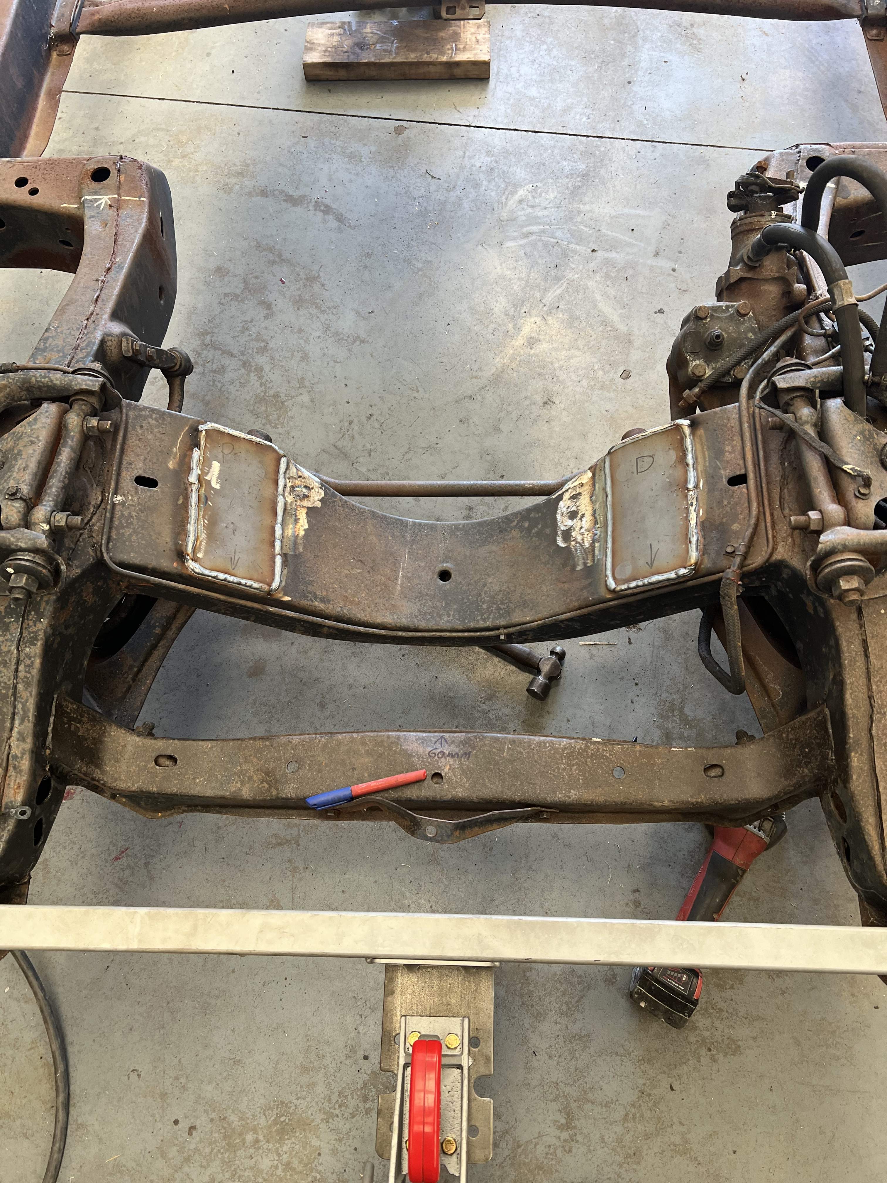

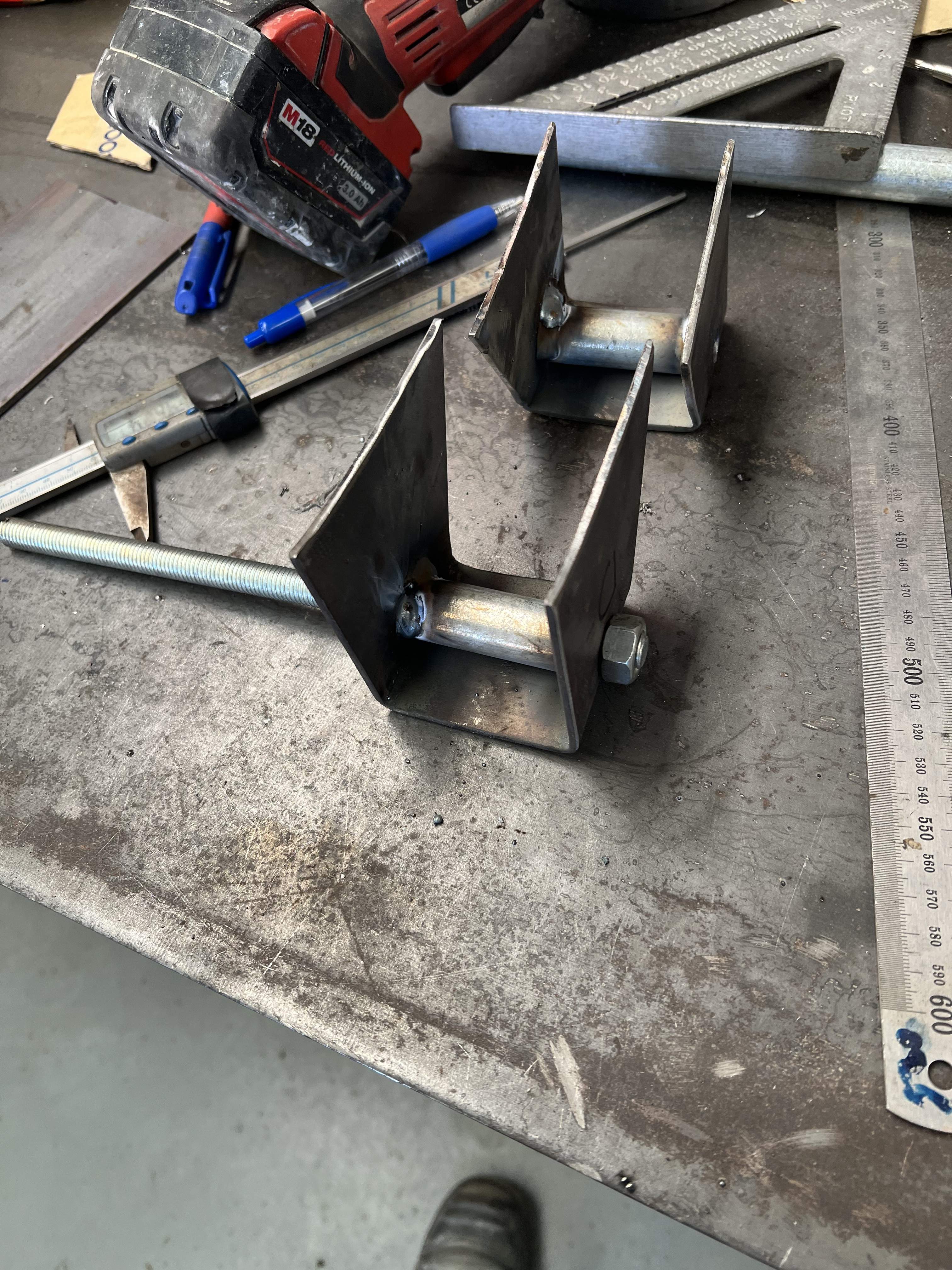

I so love my plasma cutter !!! So quick , clean , and easy !!!
cut , clean and fold....
crush tubes
base plates ... this cross member was all over the show ! bends and dents and some one musta used a gas axe on it as there was 2 blow holes that i had to patch !!
i had made a tow coupling while i am draging the frame in and out of the shed .. makes it easy to drag around with the tractor ... till she able to run by here self !!
and done .
a coat of primer and thats it till next weekend when i make the trans mount.
 The plan is to get all this engine combo sorted and i can blow the frame apart sand blast it and paint it.

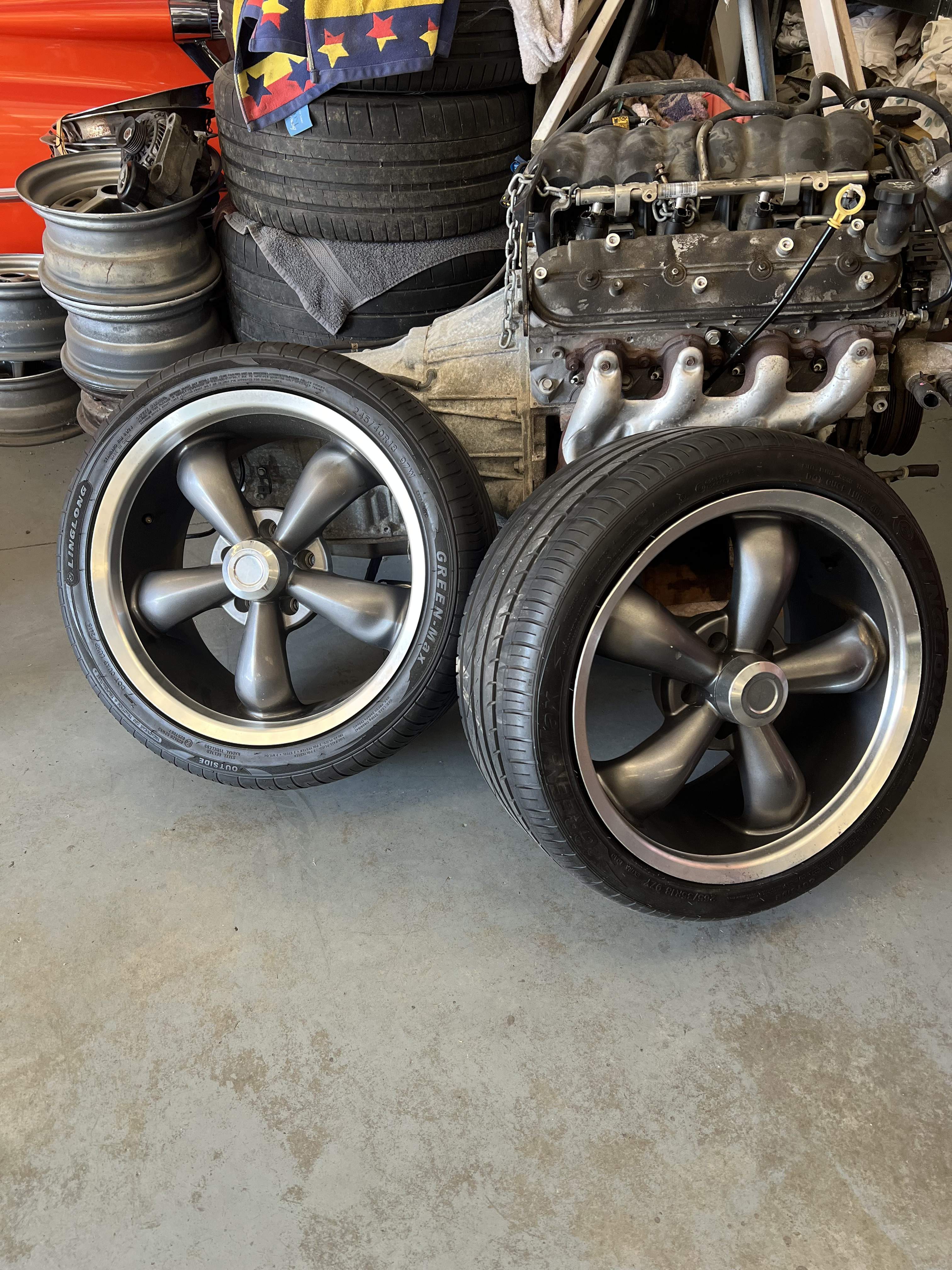

 i scored some better hold up wheels than the dumb jag ones the wagon came with ….
