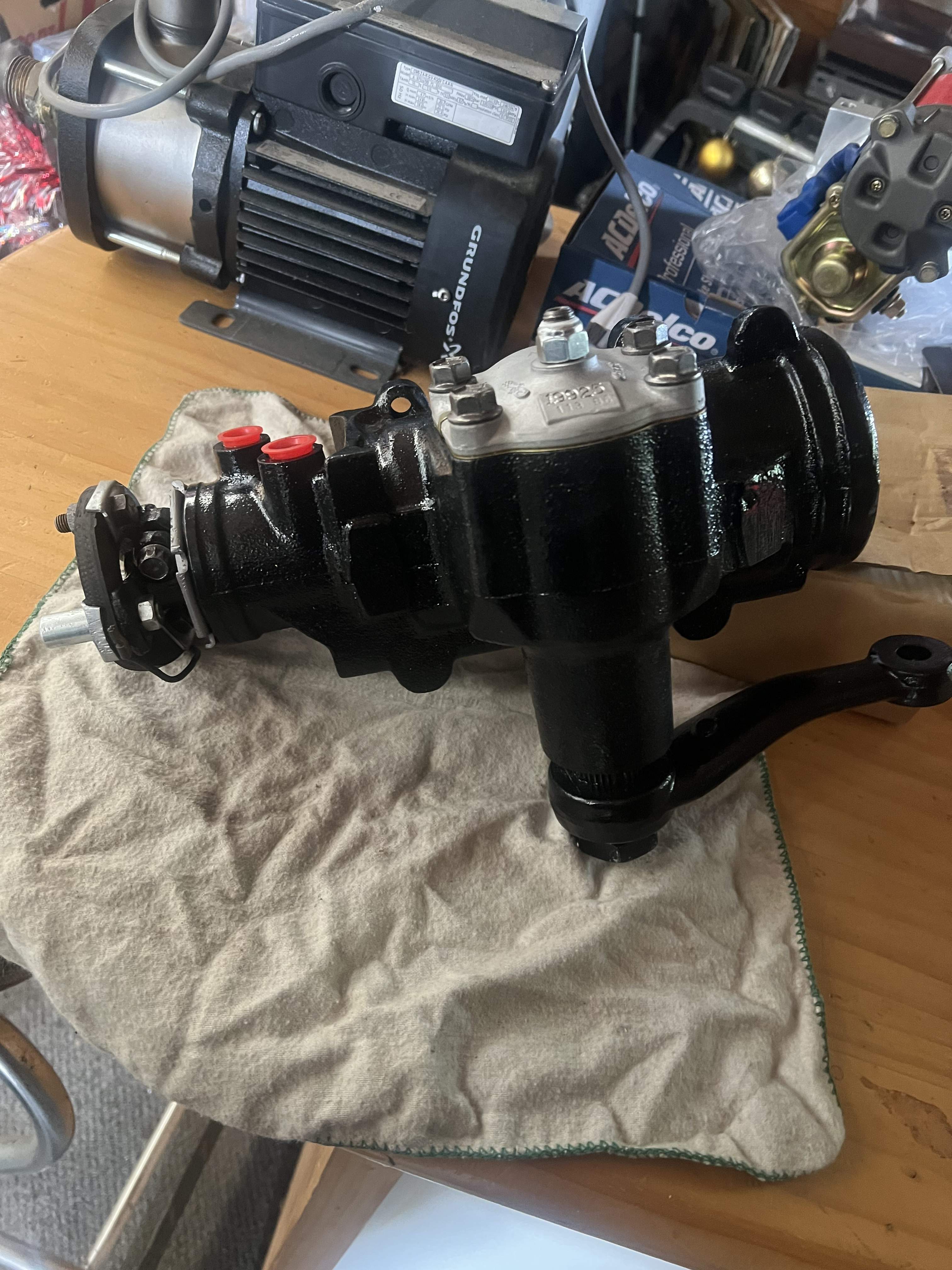

I picked up the rebuilt drag link and the rebuilt steering box sporting new 12.7:1 ratio and a higher pressure valve to give the steering more road feel !
They even installed a new rag joint !
Big thank you to pg hydraulics in Auckland 🙏🙏
You will love the road feel with that 12.7 ratio and the heftier force of that internal torsion bar. I have that on my El Camino and Catalina and would never go back to a stock, original steering gear box. This upgrade has the lowest price and best "Smiles Per Mile" quotient of anything we can do to these cars.
Rick
I agree, one of the 1st things I do to my old cars is install a quicker ratio steering box, and adjust the front end caster to be as positive as possible. It is usually less than +1.0 degree, but the difference with the cars tracking straight compared to -2 degree or more is remarkable. Then I add a large of a front sway bar as economically feasible. But anything bigger than 1" will work great. Add a set of good radial tires, and I am usually happy with the results.

i did the upgrade to my 72 camaro years ago rick, and what a differance ! it was a totally different car after that !
I will note that set up of the caster when it gets an alignment Jeffcheers

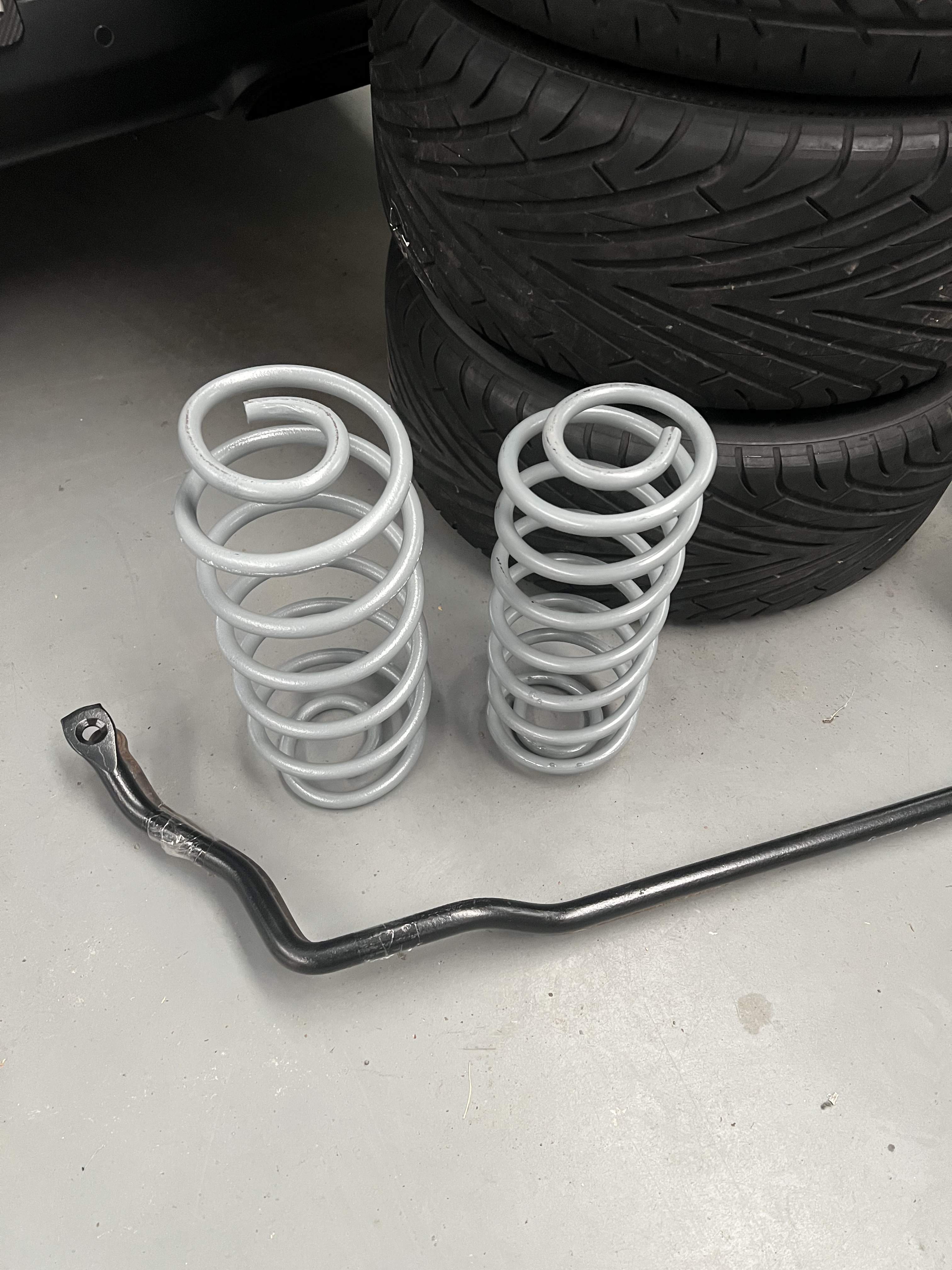

I dropped my springs off at the spring shop today and the guy noted that my rear springs were different sizes !
As in the gauge of the steel
I am wtf !
But then I thought about it … on the wagon the fuel tank is tucked up inside the drivers side rear quarter … is it possible that the factory did this to allow for the extra weight on the drivers side ????
Does anyone know if this is correct ?
Weight distribution and torque play into the suspension. Recall that Hemi and 440 Mopar B and E bodies got one more leaf spring on the driver side vs the passenger side because of the torque of the engine. Similarly different spring material/spring rates for cars that were or were not air conditioned impacted the front suspension because of the combine weight (or lack there of) of the heater core, condenser, dryer, compressor, etc.. SO I think it is very reasonable to assume that if a gas tank favors one side vs another, then the suspension would be beefed up to accommodate it.
makes sense aye

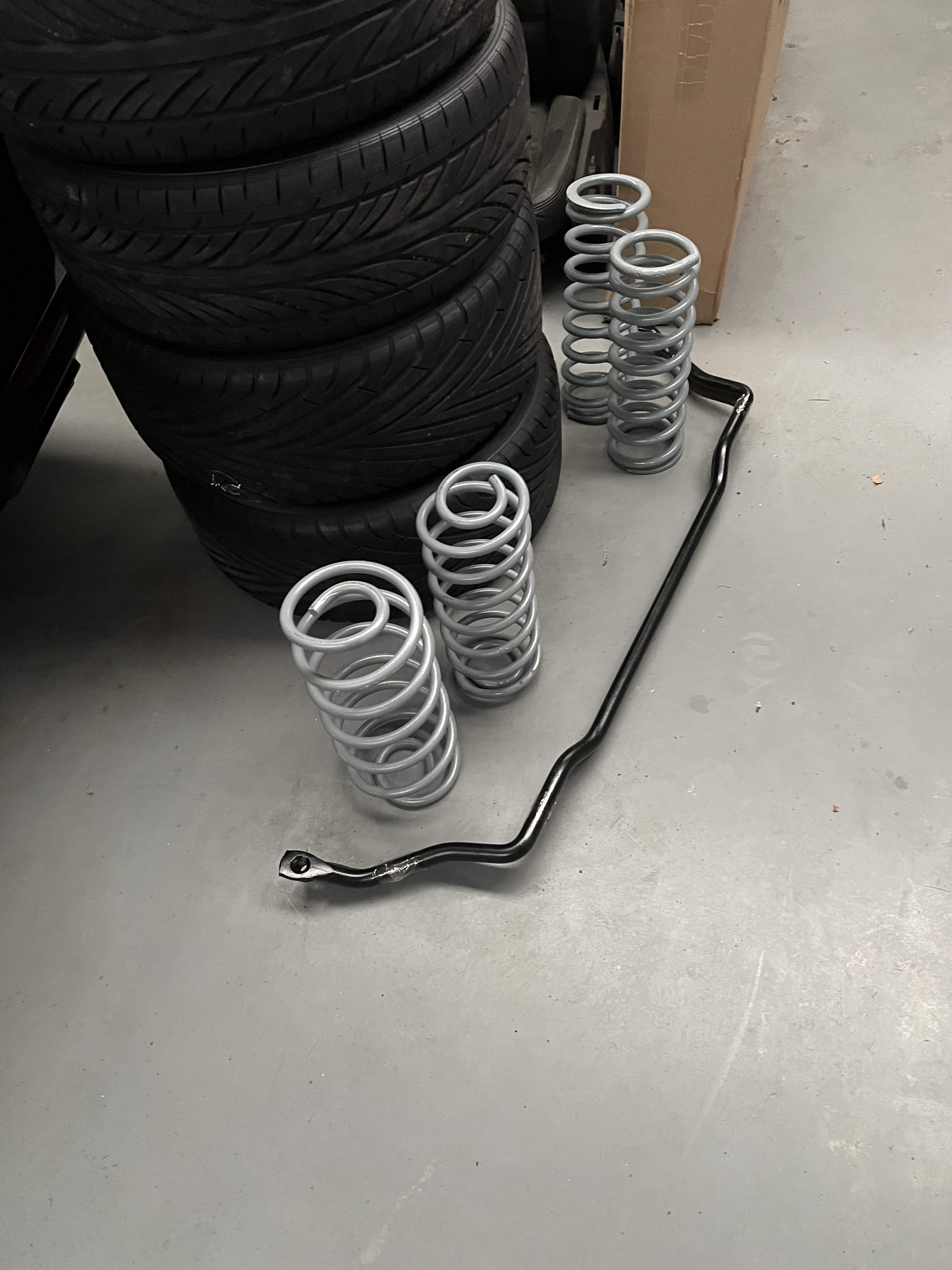

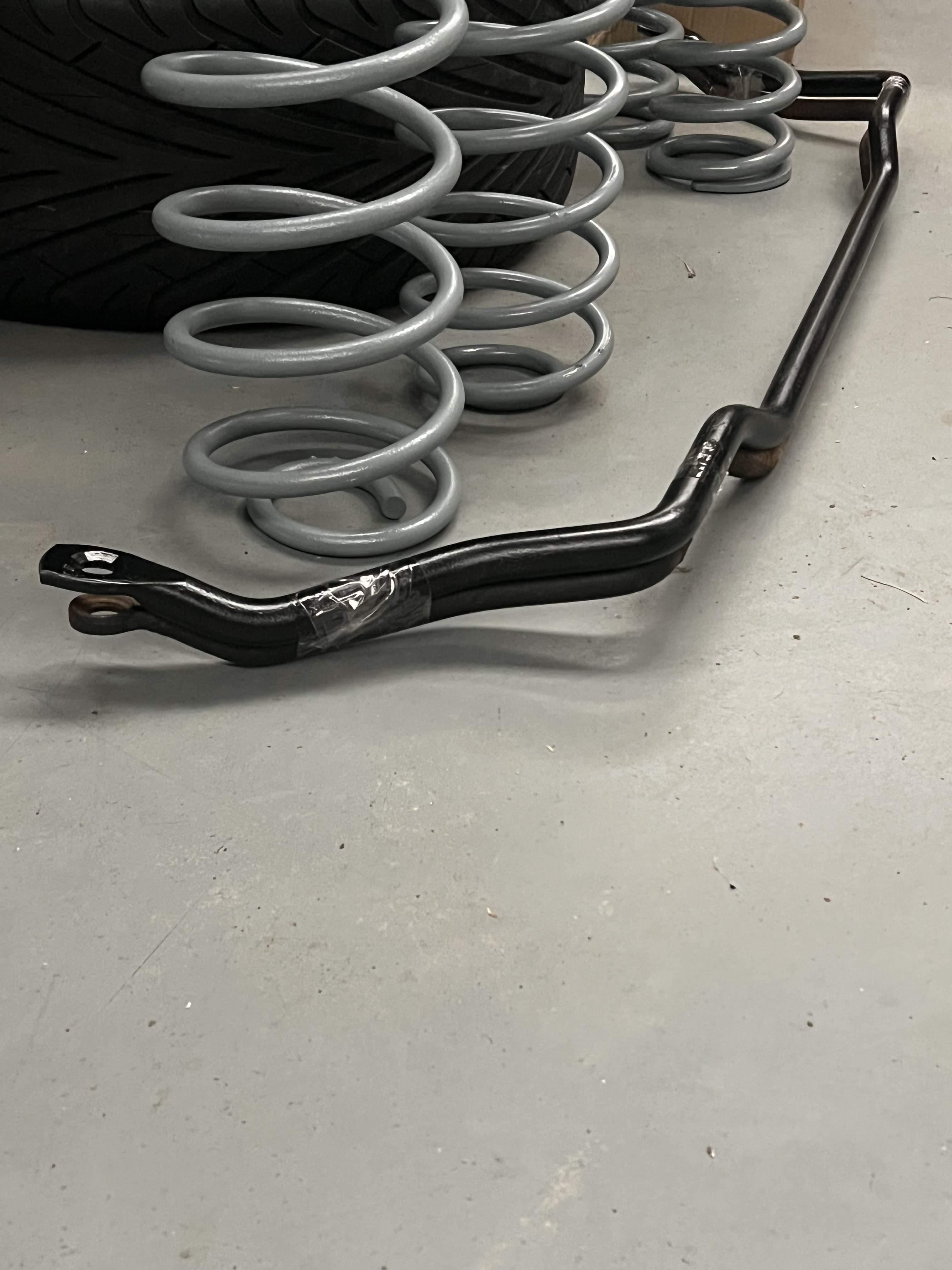

Springs and sway bar are here today !
The new inch bar will certainly make the wagon behave wayy better on the road …i have had my spring shop copy the factory 3/4 inch one
The factory springs have been reset 32mm lower
I am still concerned about the different rear springs! They are different diameters and the bigger spring is the same thickness and diameter as my 64 springs … it’s like the other one is wrongway !
Where can I find specs for factory springs for a 63 bonni wagon ???????

Kiwi- I would probably reach out to Eaton Detroit Spring or MOOG.
Ah good idea ! Thank you mate cheers

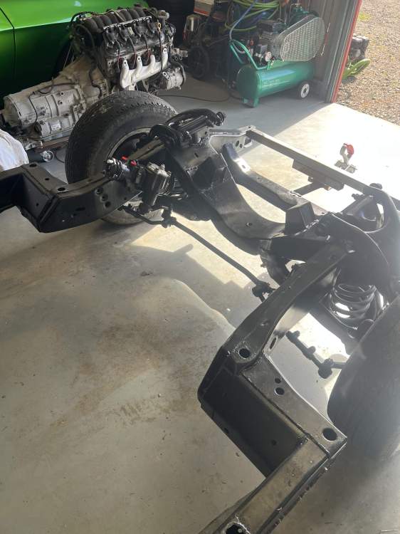

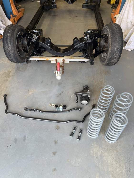

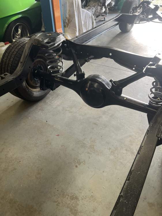

I have all these parts sitting waiting to go in , so I made a start ,,, reset springs , 25mm sway bar , rebuilt steering box with is 12.1 ratio
It took the best part of the day JustA to get these parts back in !
