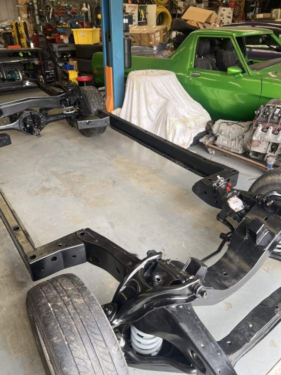

1963 bonneville Safari rebuild

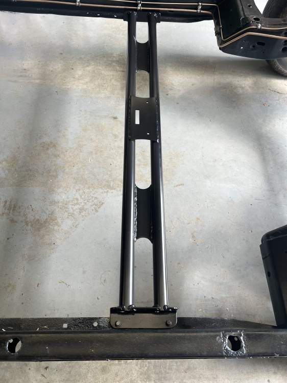

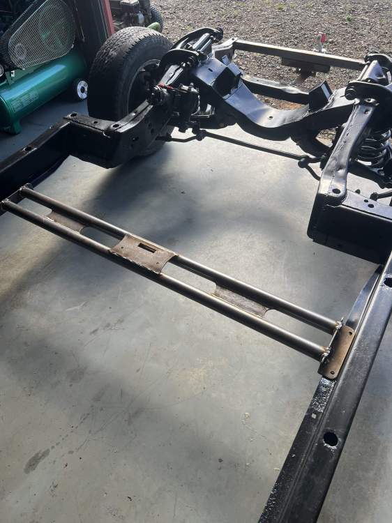

I also got my trans cross member I made , all welded . As my next mission is to show the new engine and trans mounts to the certifier ….
Here in nz , all modifications have to be certified … so I am onto the process early

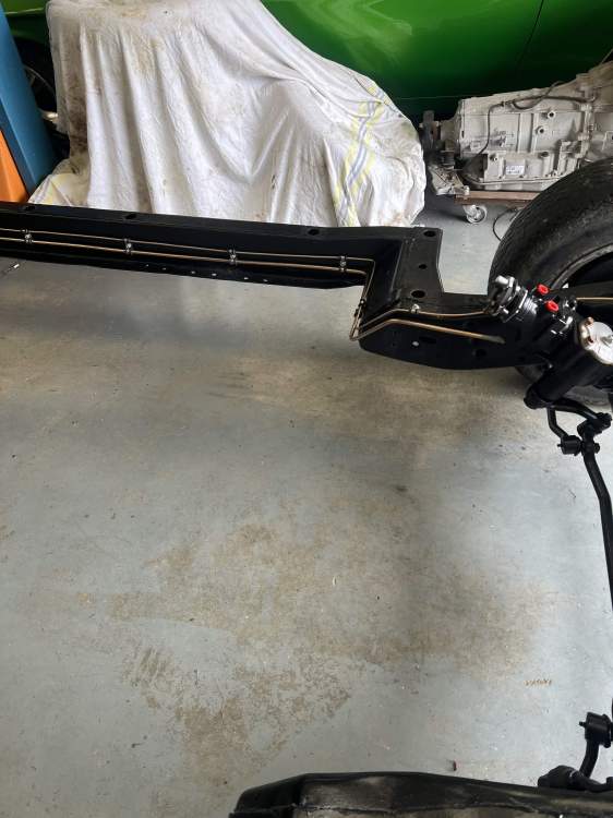

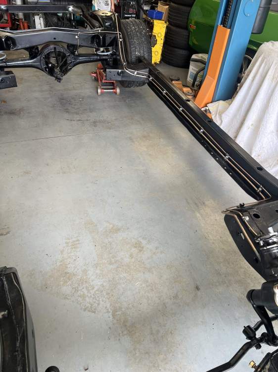

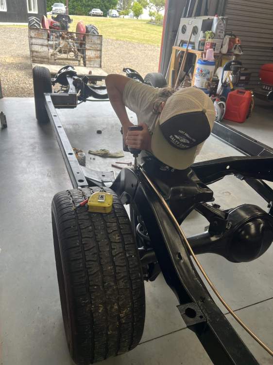

Brake and fuel line day !!!
And the cool part is I can take a look under the 64 to copy the location of both the 3/8 fuel line and the 3/16 brake line down the frame rail and over around the diff 👍
And unlike when I plumbed the 64 original lines , which are 1/4 , the 3/16 will give better pedal feel , less pedal travel and will be easier to route 👍
And all in Nicopp 🍻
My grandson enjoyed helping 🥰
And main fuel line and brake lines from the diff done ✅
on the front i am going to leave extra 3/16 brake line to go up to the master cylinder, but the 3/8 will have a joiner block and i will make a line to go vertically up the fire wall, as the point of entry for the efi on the l98 engine is on the drives bank, top back corner which will sit nicely next to the brake booster....( that s story in its self ! )
on the inside of the rear driverside rail i plan to mount the corvette pressure regulator/ filter, as my tank is up inside the rear quarter.

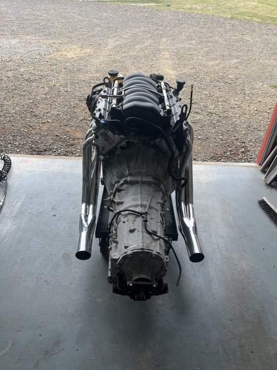

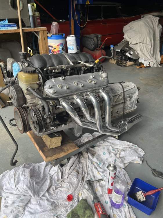

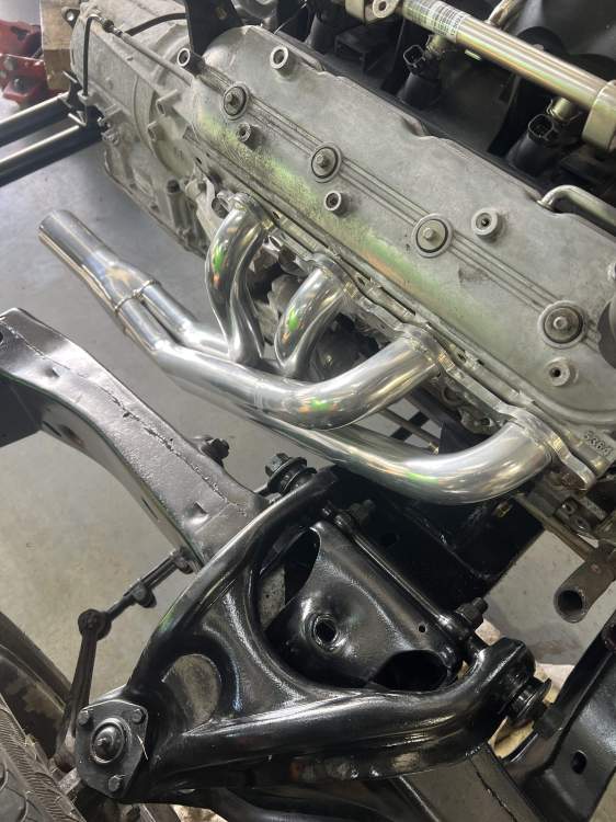

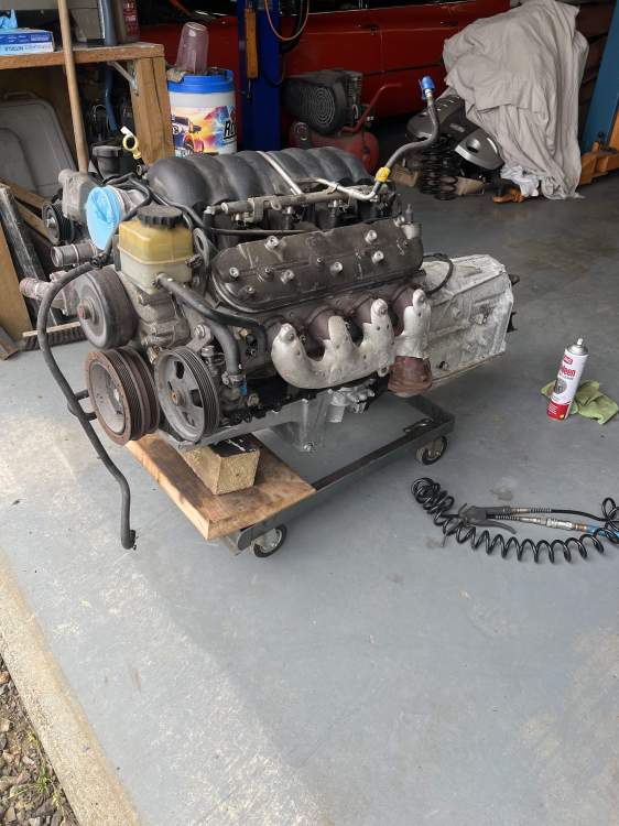

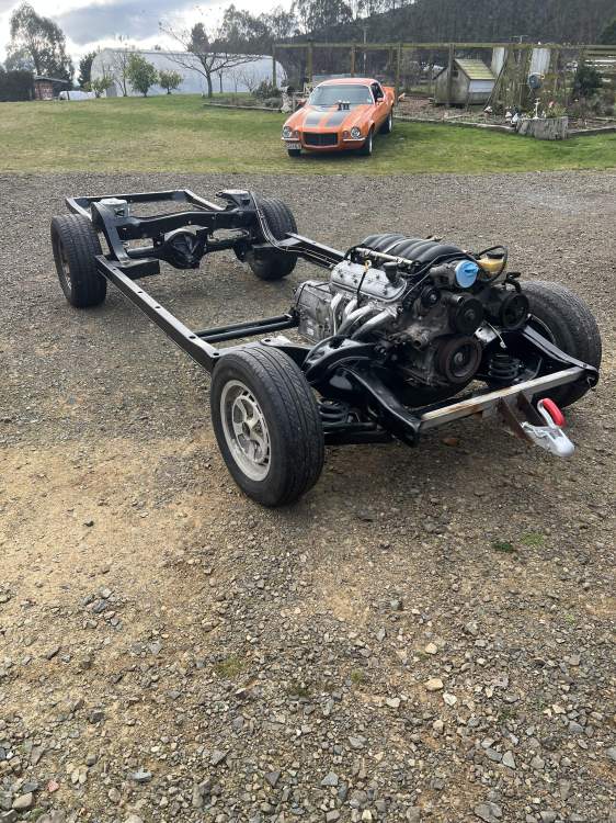

Cleaned the l98 and tried the headers on … looking way fast !!!!
I am still ummming and urrrring if I should do a cam upgrade while it’s on the floor !
Justa little update, i have a certifier on board now and today he signed off on my engine and trans mounts and siad next he wants to see the tunnel and where i am going to cut it to allow clearance for the 6l80e trans.... woop wooop that means next is engine in frame !!! perminately !!cheers

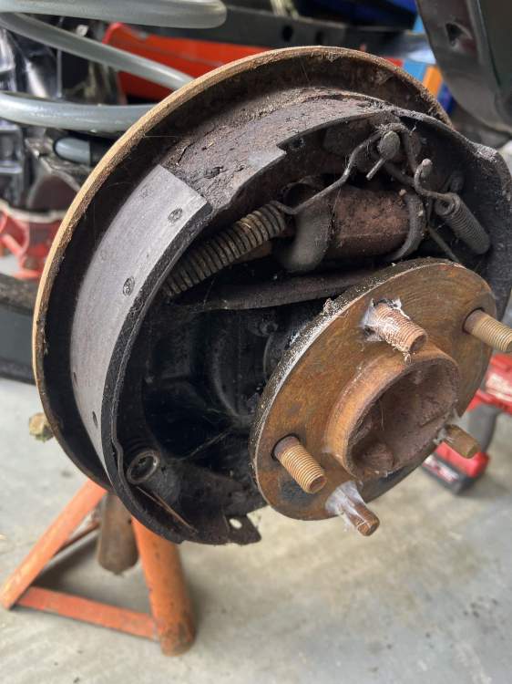

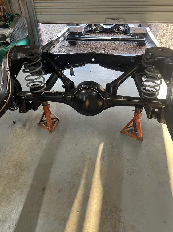

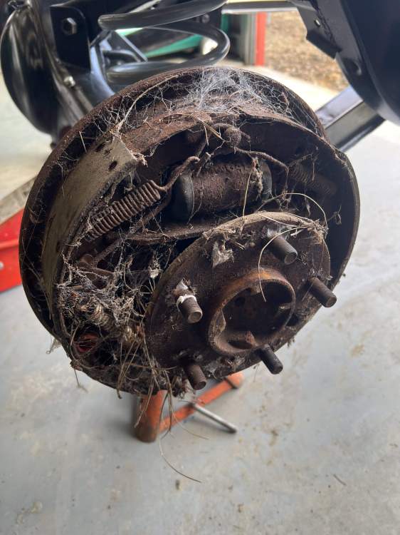

Today i managed to get a few hours on the 63,

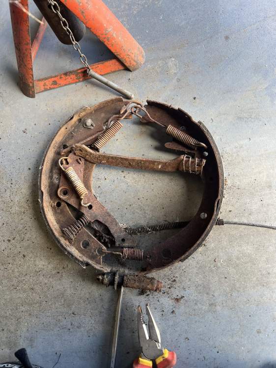

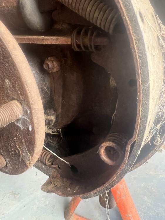

All the crusty brake system came off

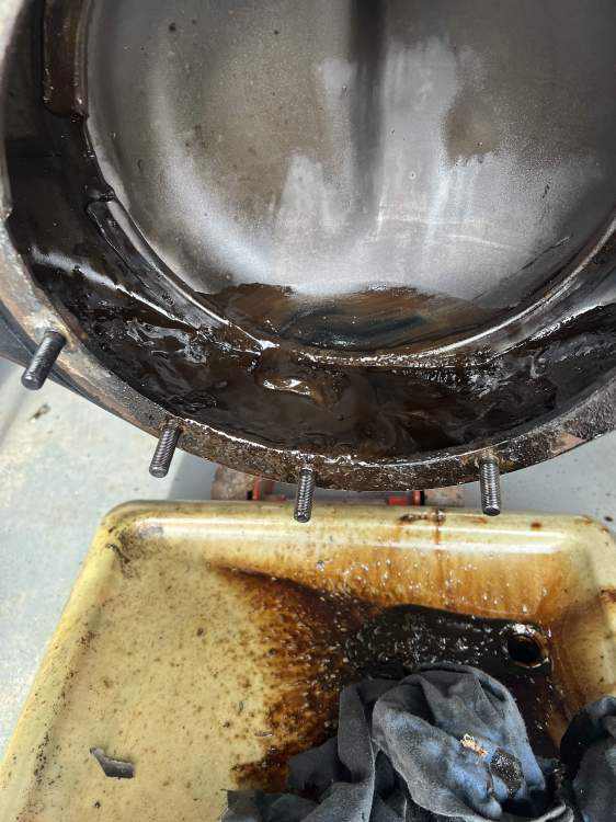

pulled head and removed all the mud !!!
Inspected the gears …. Crown wheel is pretty average !!! So are the spider gears !!!
But that’s a issue I will deal with latter
New axle bearings and seals
What i want to do is run the wagon with these gears and see if they suit the new ls engine/trans combo. then i can choose a new set of gears and a posi setup.

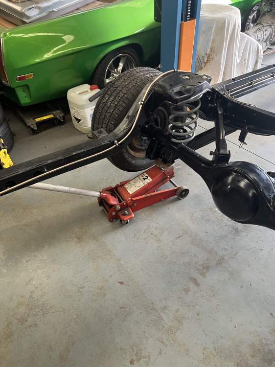

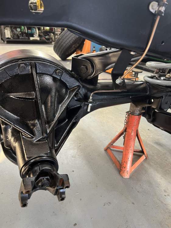

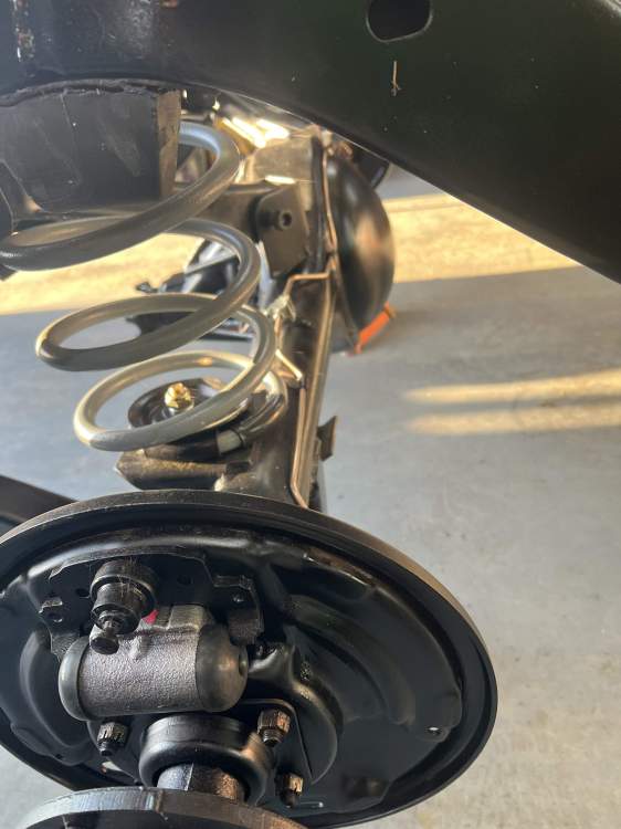

Managed to get a afternoon on the 63 and fitted the rear slave cylinders and piped the diff.
i added extra welded on clamps, as its a requirement here in nz that all brake lines be ancored at no more than 300mm centres. and the factory doesnt ancor the tee to the housing, so i have fitted a backet to the new tee, so everything is nice and strong cheers
The hose between the diff and body will be made once i have a ride height with the body back on.
i finnaly found replacement drums, so they are ordered and we are near ready to finally install the engine and trans.

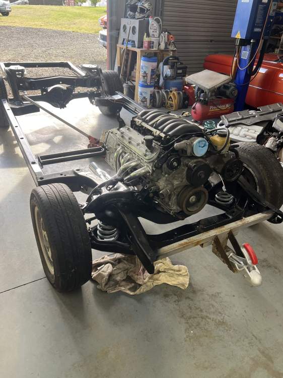

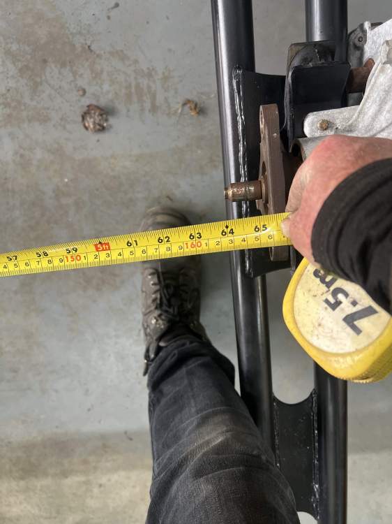

I have managed to get another day on the 63 !!! today the engine went in permanently !!

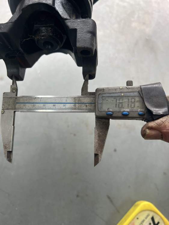

And that gave me the opertunity to measure the drive shaft i need made. with this none- yoke type trans i have to have a telescopic/slip drive shaft. i have my mate in Rotorua advance steel engineering who makes all my drive shafts https://www.advancesteelengineering.co.nz/

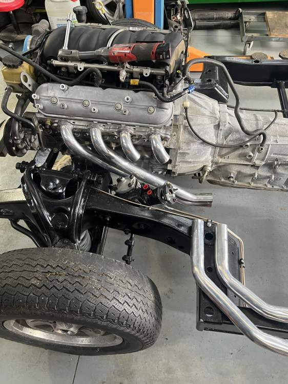

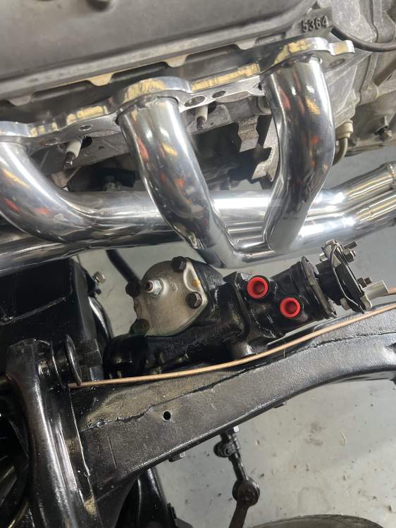

Next was, what i thought would be a simple bolt up !!!! NOT headers that " fit" ...... yeah right !! the passenger side was close but i still had to modify them justA little ...
driverside as you can see , was never going to fit past the steering box !

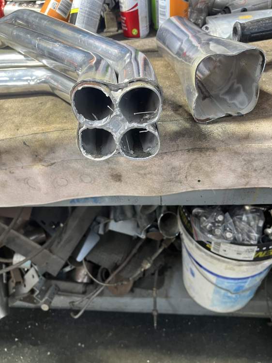

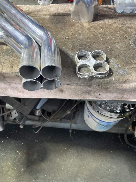

So, i chopped them ! and was not impressed with the bird crap welding !
This is a great example of the nasty products we have to contended with in the aftermarket !
While these headers will work, they certainly will not flow to their best !, Thanks China !!!!!
I am sure my 8 year old grand son can mig weld better than that !
Hence i removed the droppings !!!! and started again ....
This is where i had to stop ! i need a metre of 44mm tube and a couple of 45 degree bends, and its sunday ! no shops are open!!!
What Series of front drive shaft slip yoke have you decided on? The Series 1350 is bulky but has the most length of spline engagement.
Rick
