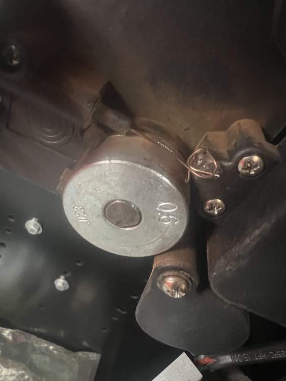

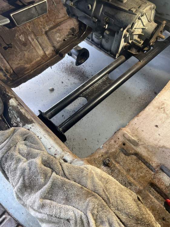

    I made a start on installing the L98 engine today  first was to get the sump swapped over , this  came out of a Holden , state side it would be a g8 2009 l98 with 6l80 trans … but first thin
  • 64 kiwi boni
    64 kiwi boni
    So motor back out and off with the nasty looking mounts !!! then motor back into the right location , And just finished the day with making cardboard templates, and thinking about how I want
  • 64 kiwi boni
    64 kiwi boni
    The Holden sump had the dip stick coming up out of the sump , the new sump came with everything needed including a new pick up bolts and dipstick that passes down through the block into the smaller su

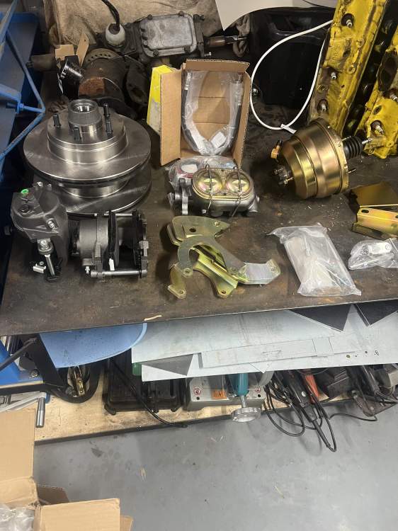

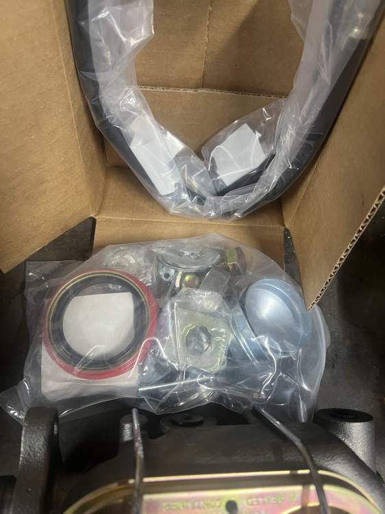

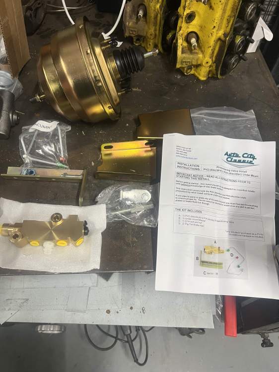

The disc brake conversion kit I bought in January has arrived !!!! Finally !!!!
I am very impressed with the quality of this kit ! i choose the disc/drum kit and i cant fault this whole kit !!! it has everyting i will need to assemble onto the stub axles !!! the brackets look nice and strong with good quality welds and the pcd is correct for my at 127mm !!!
this is a major step foward for the build !
big thank you to chris from auto city classics !!! i will be buying a gas tank next cheers
Are you sitting down ? ........pop_corn

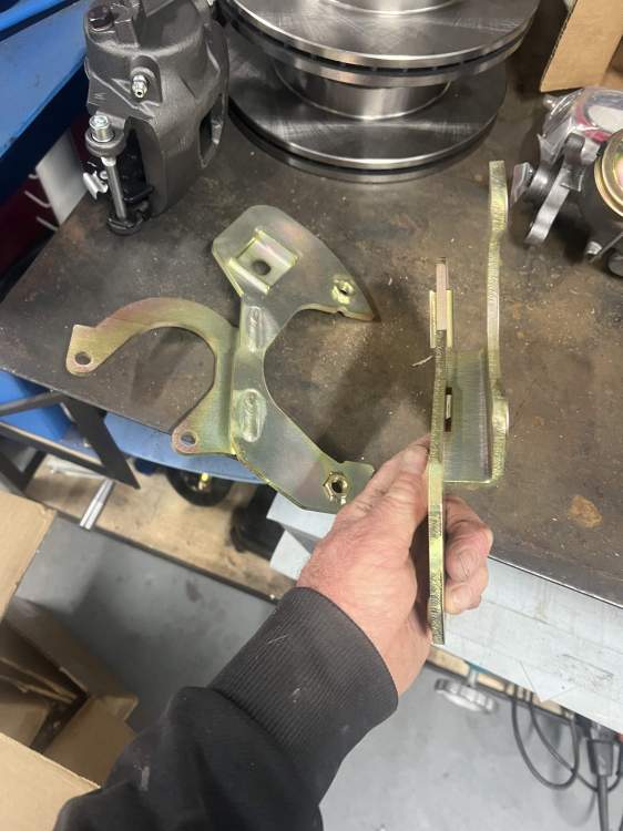

I have to get my certfier to sign off on these caliper brackets and i took them to him this morning...... i will be adding what happens to my brake thread, as well as here on my 63 thread. it will be a great referance for anyone in future who wants to disc brake a 59-64 b body girl
The certifier saw a couple of issues that i completly agree with and i will enlighten you all once we let him do his thing.
The goal here is not only to get all my upgrades done to the 63, but also make sure its safe !!!, as you all know there is a mountain of aftermarket gear out there that you can simply hit buy now and wack it on your car ..... BUT is it safe ? is it made to last ?? will it kill you or your family ????
watch this space !

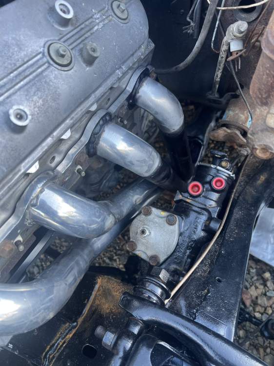

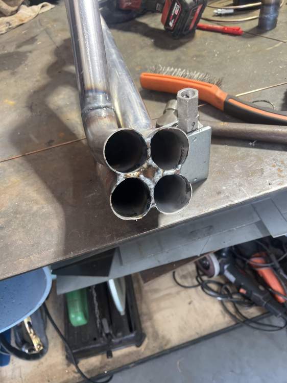

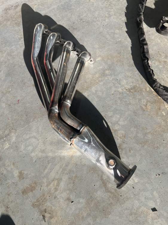

Mean time i have headers to weld up and i need the practice tig welding and if i am lucky i will get a whole day on the car before the boss has me doing chores!!! .... and frosty knows why i am bending for the boss !!!!cheers cheers guys its friday night in Taupo nz and its beer oclock !!!
After baby sitting my grandie this morning !
I managed to get a few hours welding completed .. headers finished including o2 sensor bungs and header flanges

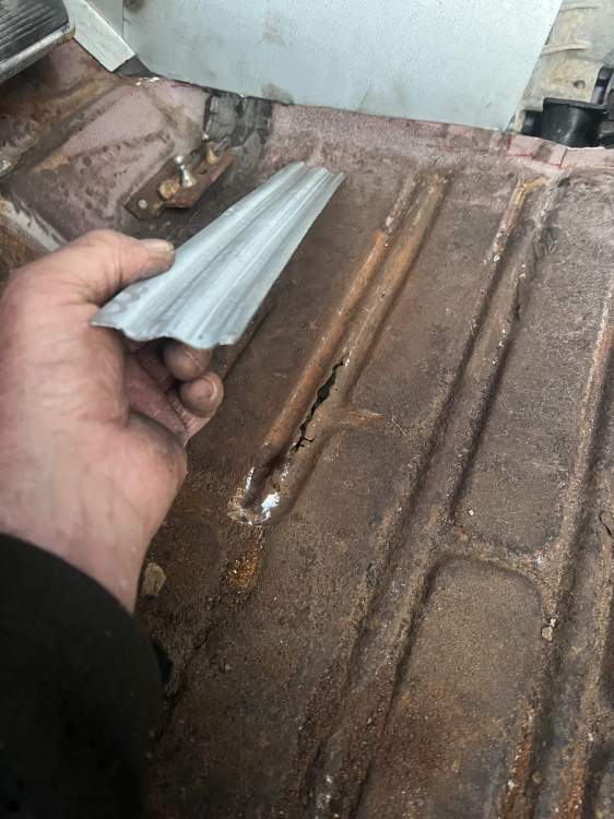

And justA enough time to fab up a section of floor that needs replacing
Is that the old 16 to 1 steering gear box? There are better, more modern gear boxes. A GM Saginaw power steering gear box out of a 1993-98 Jeep Grand Cherokee would likely fit very nicely in the same spot. Same outer mold line in the casting, probably the same Pitman arm spline count, probably the same bolt holes. A Dorman part number 31011 rag joint fits perfectly.
For the hoses - use adapter connectors or the Jeep low pressure hose for the return line. For the high pressure side, I had a new hose professionally made for less than $60.00 USD.
For all of this, you get a modern vehicle 12.7 to 1 steering ratio and a 35-40 pound torsion bar hydraulic valve for a very good road feel. No floaty cotton balls steering feel anymore.
And inexpensive, too. The smiles per mile per dollar cost of this upgrade is unmatched.

Busy busy man. Lookin good, nice work!

Hi Rick, looks can be deceiving !!! that is the factory box full of 12.5-1 cogs and upgraded torsion valve for that camaro like road feel !!!
i had the box fully rebuilt by pg hydralics in Auckland,,, big thank you to Phill Game for another fantasic job cheers

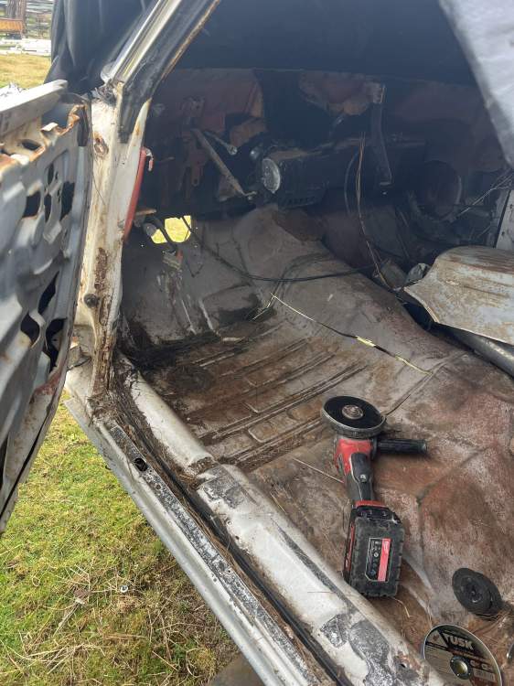

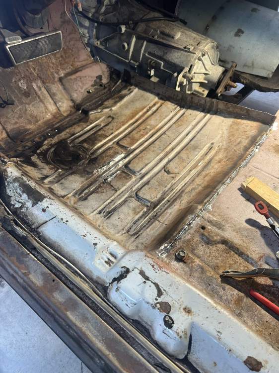

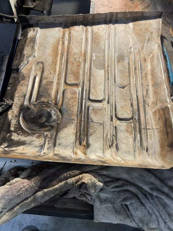

Another productive weekend ,,,, freezing cold but the angle grinder and mig kept me warm !!!

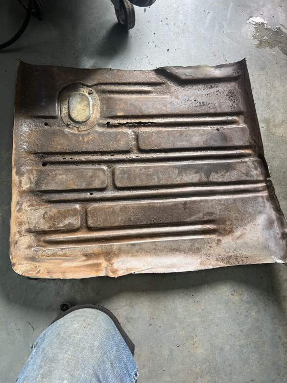

after making a small section to do a patch in the drivers floor, i wire buffed the while section and found more than i expected !!!
so i chopped the lot out !

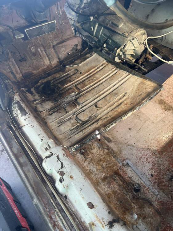

And sorry to say it …. And I really didn’t want to do it but !!!! I removed the super tidy floor from my spare 2 door hard top !
It had a few little pin holes which i welded up, but it was wayyyy better than the safaris floor
mint as again !!!cheers

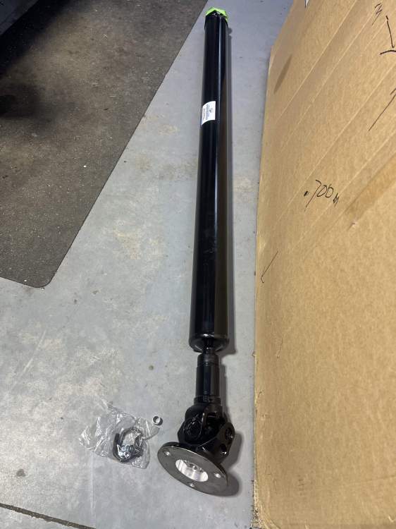

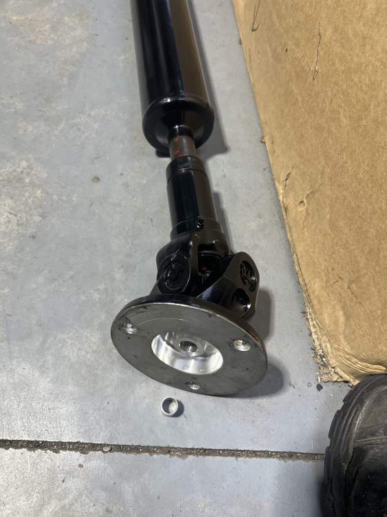

My driveshaft was ready to pick up
it starts off the back of the 6l80e trans with a sonnax tr-6060 1350 adaptor, to a slip spline, to a 3 inch tube to a 3r series rear uni and new 1310 u bolts, which will bolt to my 9.3 factory diff yokebacon

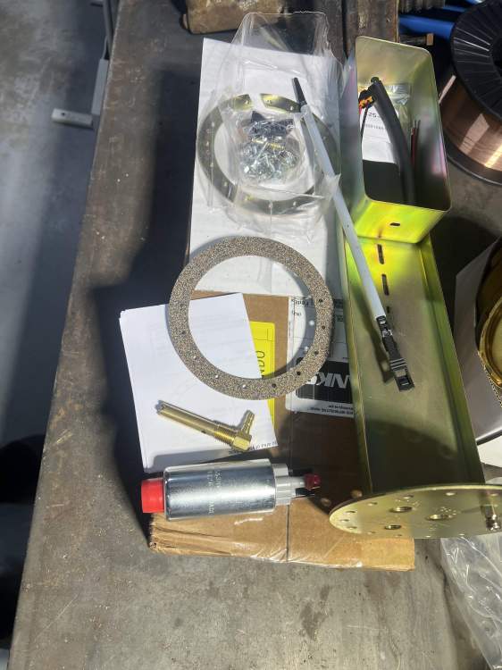

And my tanks Inc pa4 efi pump kit arrived
This will be modifided to suit the new wagon tank when it arrives from auto city classics..
oh and you can see the fancy little right angle fitting , thats a rollover valve that acts as the main vent as well. cheers
Looking good. Those fuel pumps don't like to be operated dry - gasoline acts as both a lubricant and a coolant for the pump. The lower limit for me is a quarter of a tank of fuel and I learned this the hard way with my El Camino as me, my shoulders, two feet, my spine and three arms on a hard concrete floor struggled to get a sloshy, tippy fuel tank out more than once.
Rick
Rick
Rick i am going to use this kit and extend it to reach the bottom of the inner rear quarter mounted 19 gal tank, i cant find any info on line about anyone doing a in tank solution for the safari tanks, so i am going to document how i do it. cheers
i justA need to find a shipping co that doesnt want a arm and a leg to get a big tin can in a box to me here in NZ !

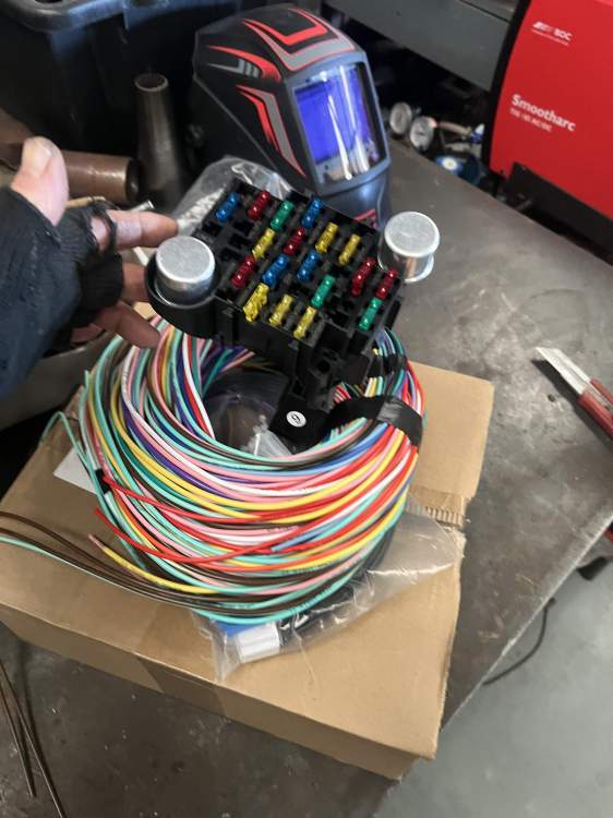

More parts arrived today, i have bought a universal 21 circut wire loom and a nice relay box to rewire the whole wagon
What i like about these looms is that they are id every part of their length with what circuit they are ! so any where in the future you can see whats what !!!
When i get closer to installing the looms i will show how i break down each section , and i like to use a label maker and name very thing! , its sooooo much easier , because we dont do this every day and i you come back to it after a week or two and know exactly whats what !!!! every important, or you will waste soo many hours getting your head around it again ! trust me ! been there done that !!
i will be adding extra looms to this as the safari has a power rear window and electric fans for the rad, plus i will justa draw my wiring diagram, to make sure i dont forget any thing !!! i used one of these 21 circuit looms for my last build and forgot to add the electric fan feed ! which then justa takes more time that this dumb arse should have known better !!! lol

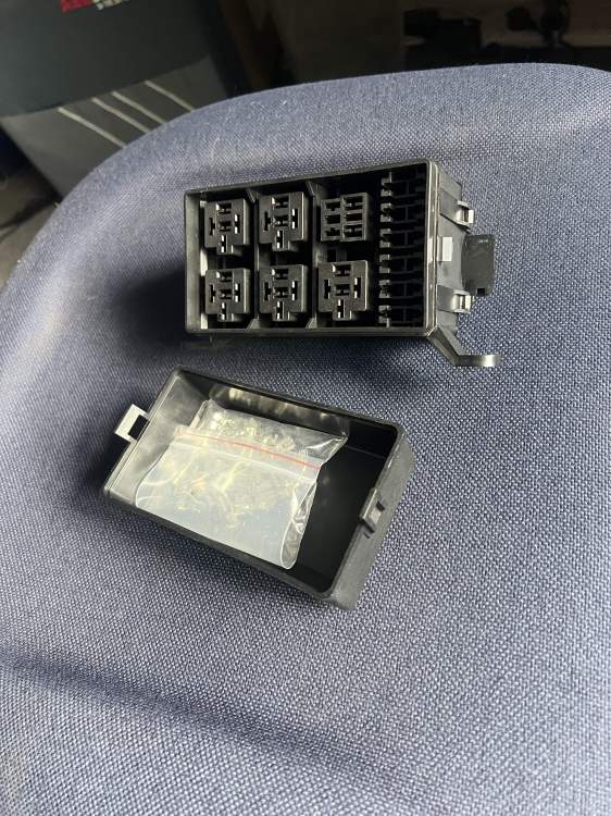

My reason for the relay box is i am going to take all the current load away from the ignition, headlight, heater motor, wiper motor, stereo amp, usb port and horn switches that all take load that they are really not designed for ! all switching for high current loads will go through this, including radiator fans and that power window on the safari tailgate !
Things like dash lights, flashers,park/ backing lights and interior lighting dont need too.
I did the same thing bro. 21 circuit from Painless. It was far from painless, but it wasn't bad. I did have to repin and reuse a couple of connecters that I couldn't find new. I also had to make a couple of short harnesses to add power windows and the lights and stuff for the console. Looking forward to watching bro.
