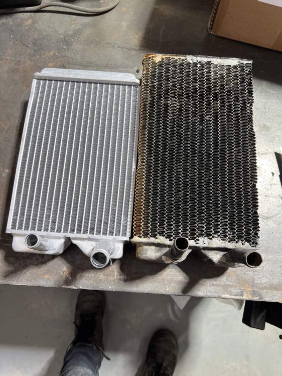

Hopefully, the smaller core is the more modern aluminum design. Maybe the efficiency will make up for the lack of surface area.
yes it is ! so it should work fine,

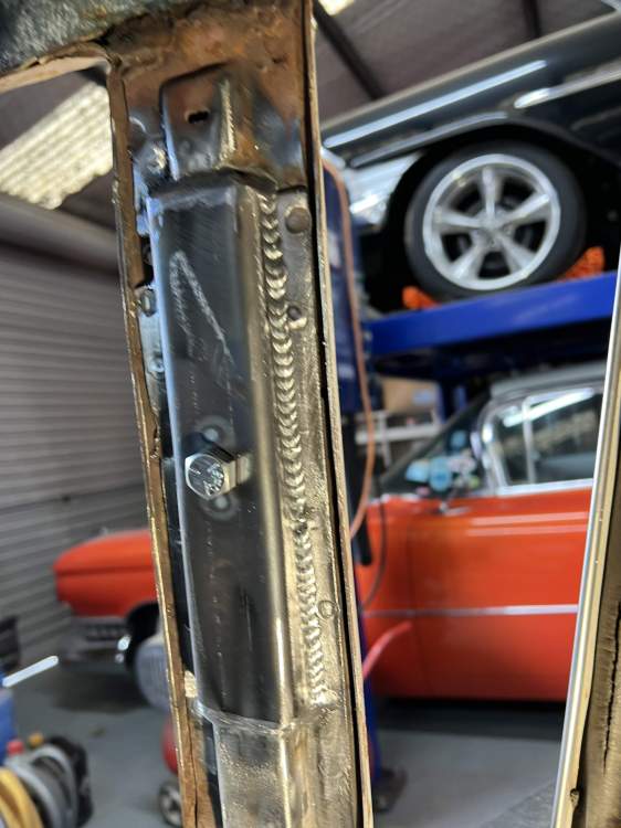

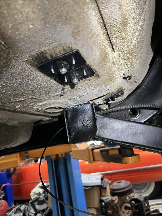

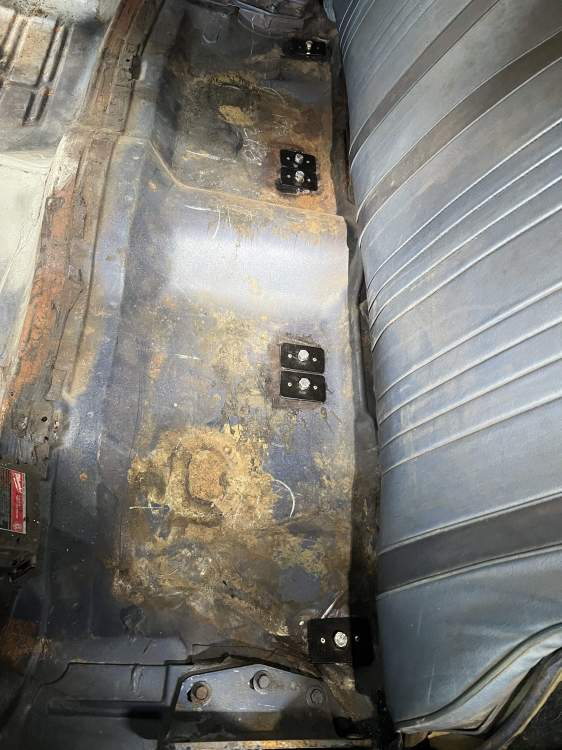

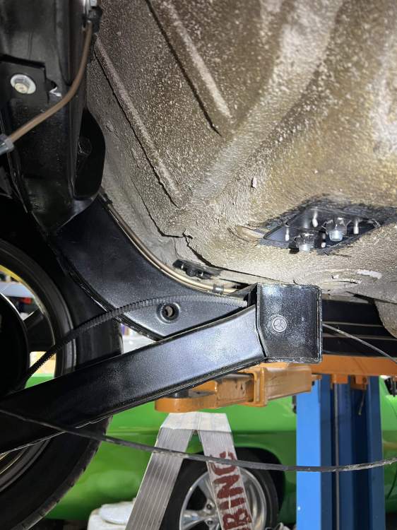

More progress today
B pillar seat belt ancor points welded in
Along with floor anchor points
All as per lvvta specs

2 hours ago, mtrunz said:
Nice. Are you adding shoulder harness belts in the front as well?
Yes Mick, the certfier has said that i must, however in the back seat the c pillar is too far back, so its only getting lap belts..... for the grand kids !

Gotta love rock auto !!!
The heater core is here and the tubes are in the correct location for my firewall holes !!! I justA need to modify the mounting and the flash ali unit will work fantastic !!! And only $100 usd

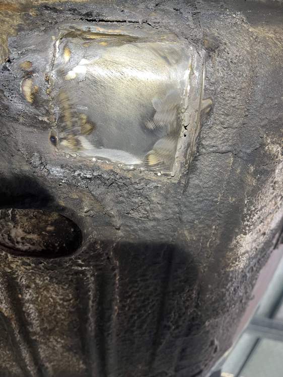

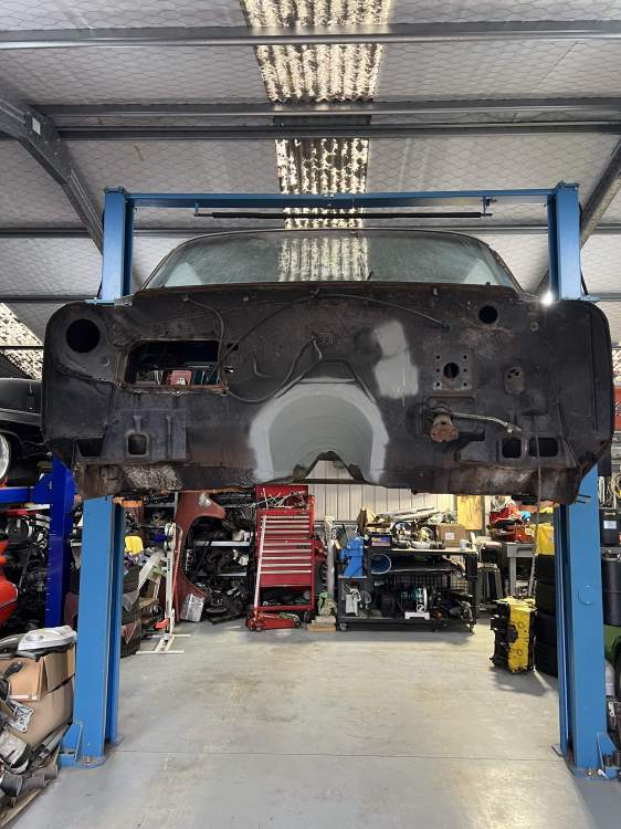

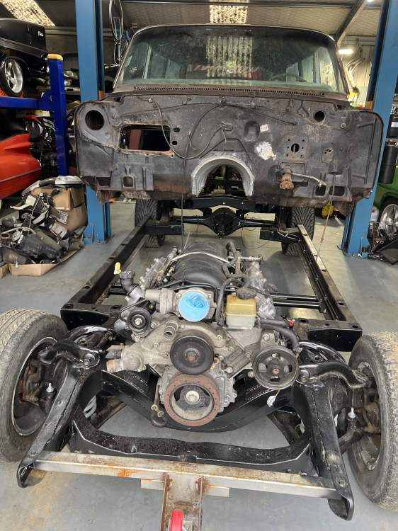

I managed another super productive day !
Body off the chassis so I could weld the underside of the new tunnel . And rust patch 3 more spots .
Popped the old screen out so I could repair both A pillars
And water blast the whole undercarage
And that’s it for the next few weeks
Next is fire wall prep and paint
And to be able to paint I need it above 10c !!! Which it hasn’t for the last few months !!! But it’s spring and I can get prepped !
In the mean time I have a heater box to repair and match to the new smaller heater core . Wiper motor to make work 🍺🍺🍺
