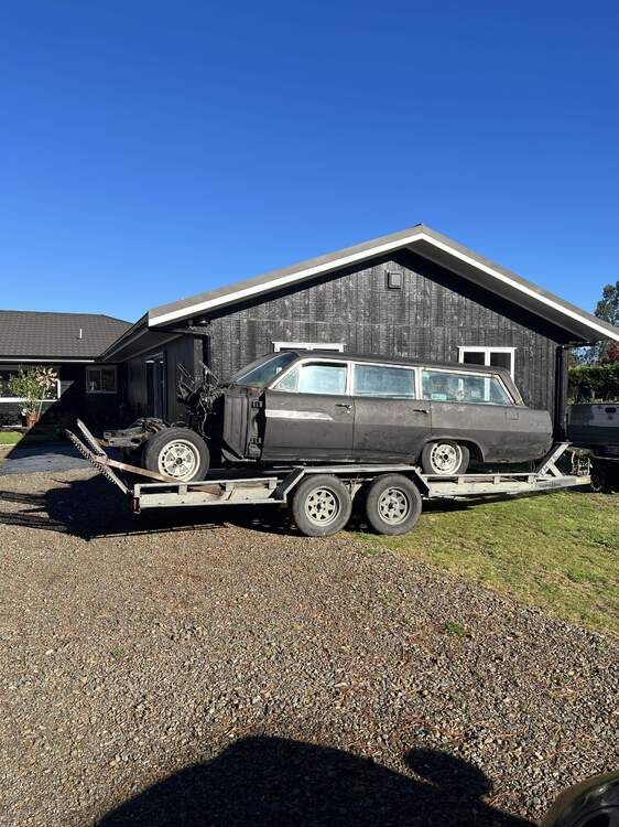

Yesterday , I picked up a 1963 bonneville safari wagon ..
it has a interesting history, and my intention is to rebuild it along side my 57 .. this wagon will be a fairly stock rebuild like my 64 was . But we may go with a different motor trans combo ! :dancingpontiac:
history wise . This wagon was a government car in American Samoa… it was shipped to New Zealand for repairs in the early 70s and never went back !!!
Story has it that it spent a period of its life in Rotorua in the 80s and then was parked up … it did have a 396 big block in it at that time.

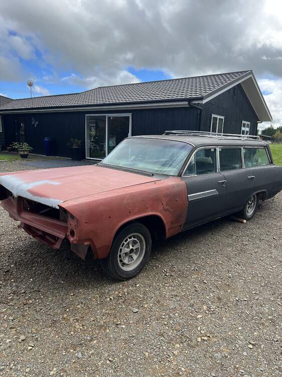

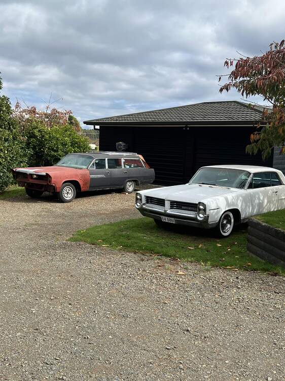

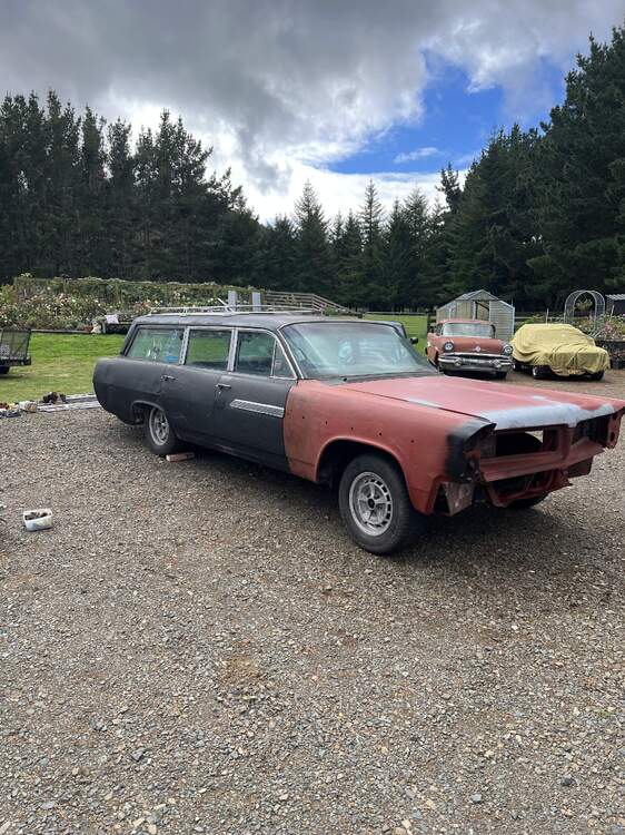

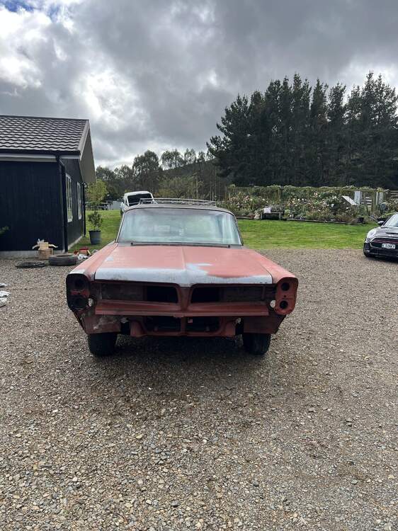

here is some pics of her today .
And I couldn’t help myself
I had to fit the front sheet metal …..

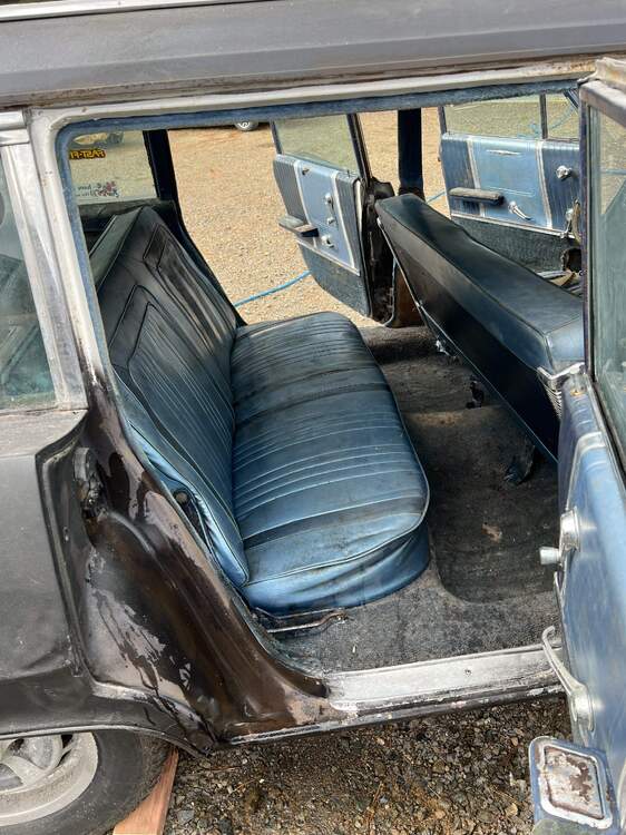

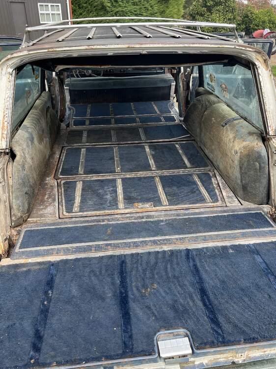

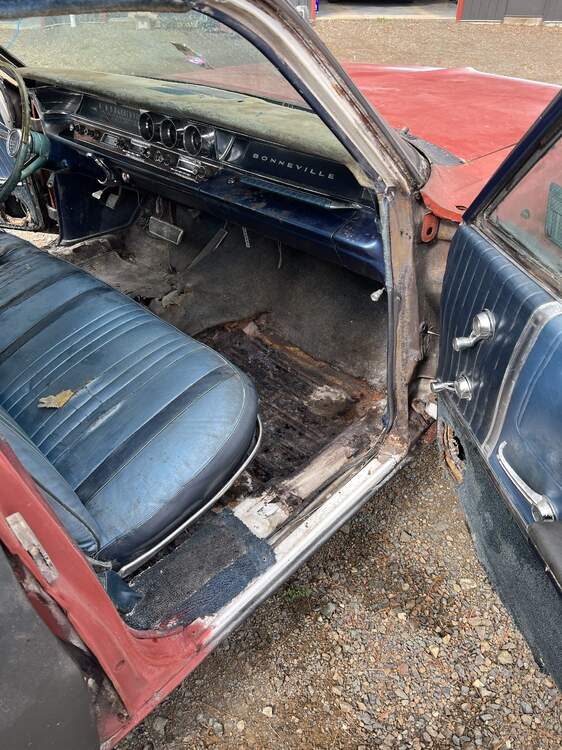

Factory colour is blue . And it used to have  a very flash blue interior … today I had to scrub the dirt off it just to tell it was still blue !!!

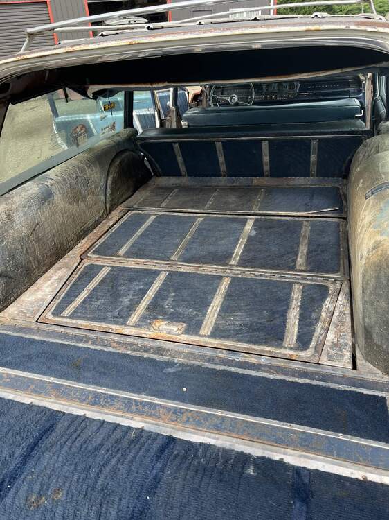

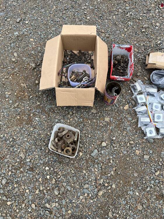

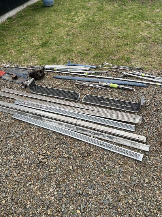

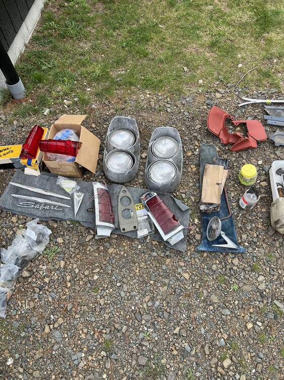

It came with very much everything needed to put her back together

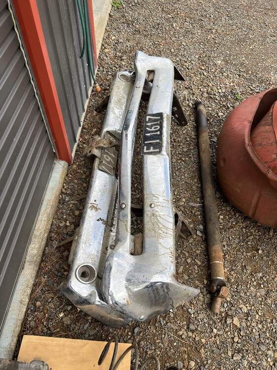

Both bumpers are dirty but straight and the chrome is good 👍

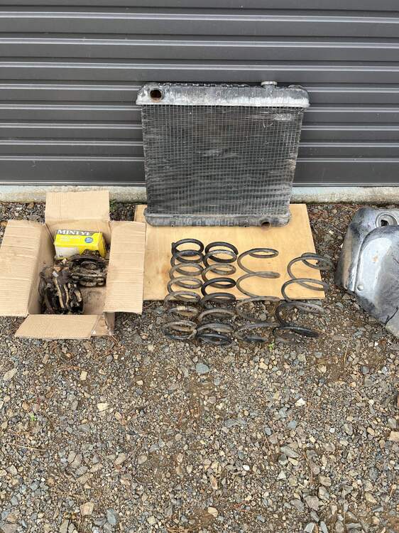

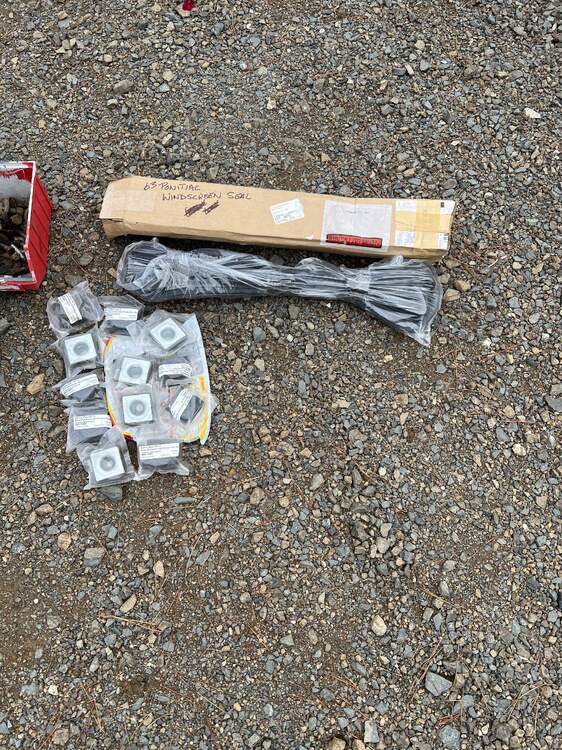

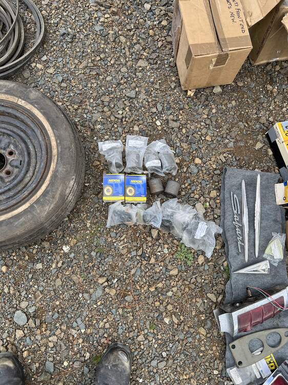

And there was even some brand new parts … tail light lenses , a full set of body mount rubbers
a new screen rubber
and front end bushings and ball joints

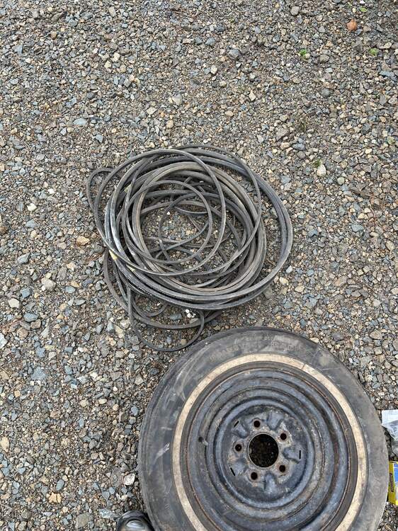

and for some  reason there was this pile of fan belts in there too !!:rofl:

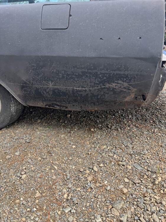

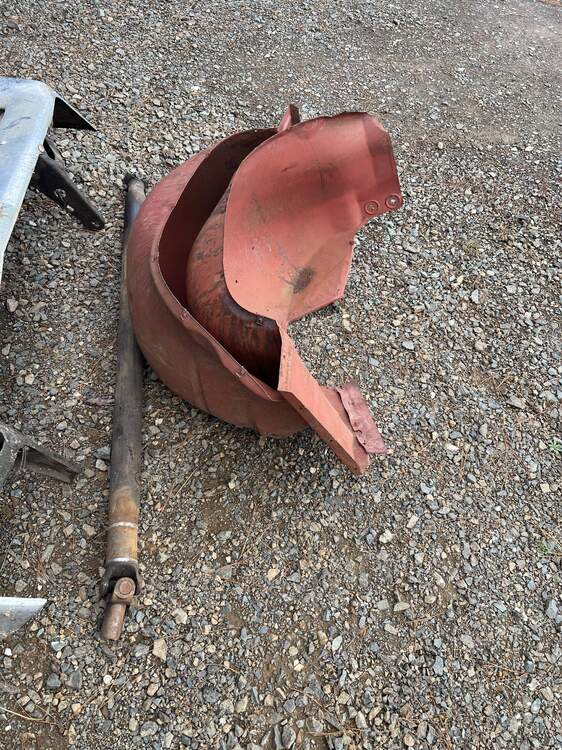

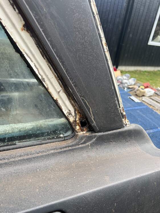

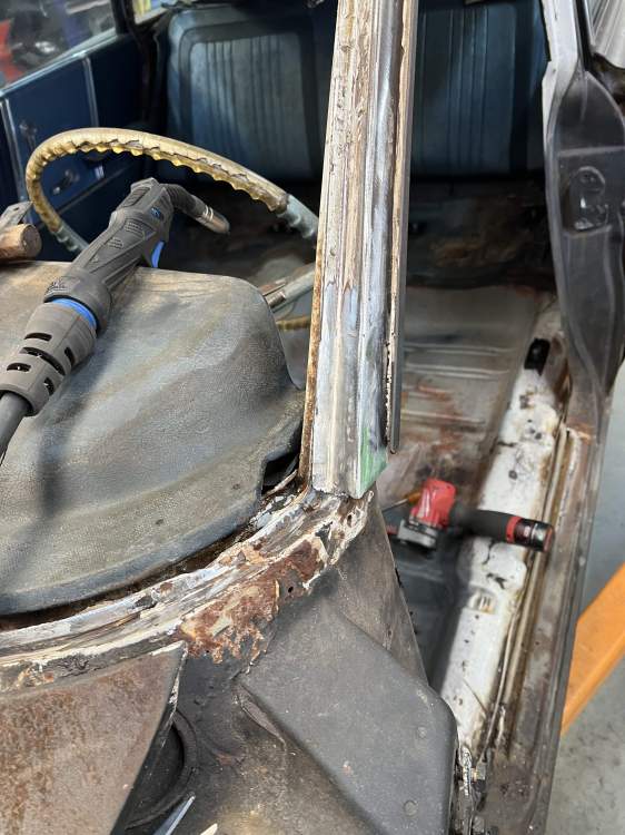

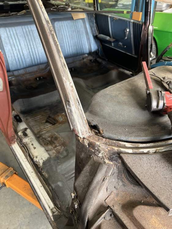

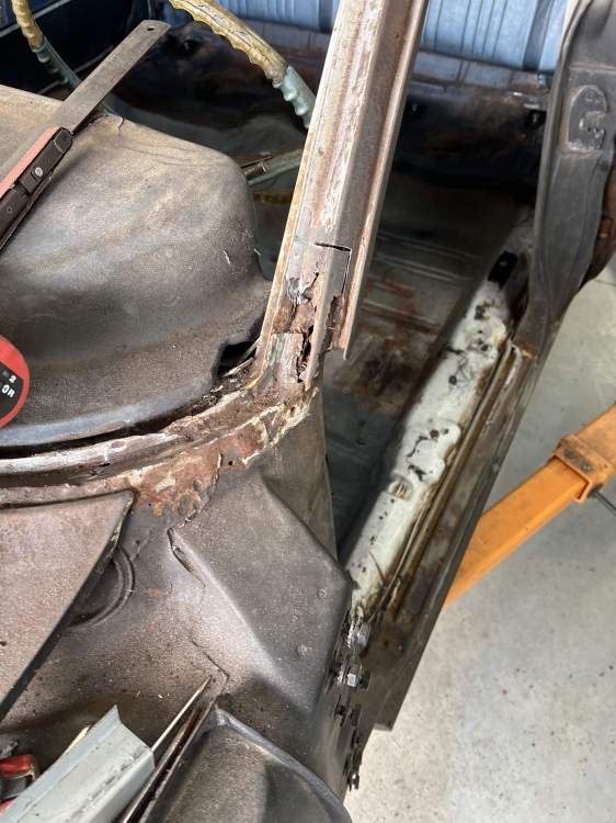

The floors are good but there is 5 areas that need some  love on the body work department … here’s two of them
The whole body has been Soda blasted and so has the chassis
so there no hiding anything !!!

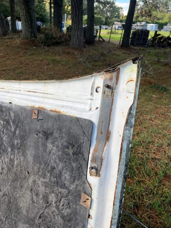

thankfully I just happen to have a bent   64 hood with justA the clips I needed to mount it onto the hinges !!! :dancingpontiac:

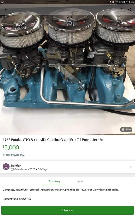

Whoops! I forgot: someone on Gumtree has a fully restored TriPower set up ready to bolt on and enjoy. I said "this Kiwi bloke I know has plenty of money, he'll buy it," and then I saw the price. Ba-bow.
owch !!! thats wayyyyy to much !!! last tri power i bidded on went for $2500 and that was 500 over what i thought it was worth !!!
