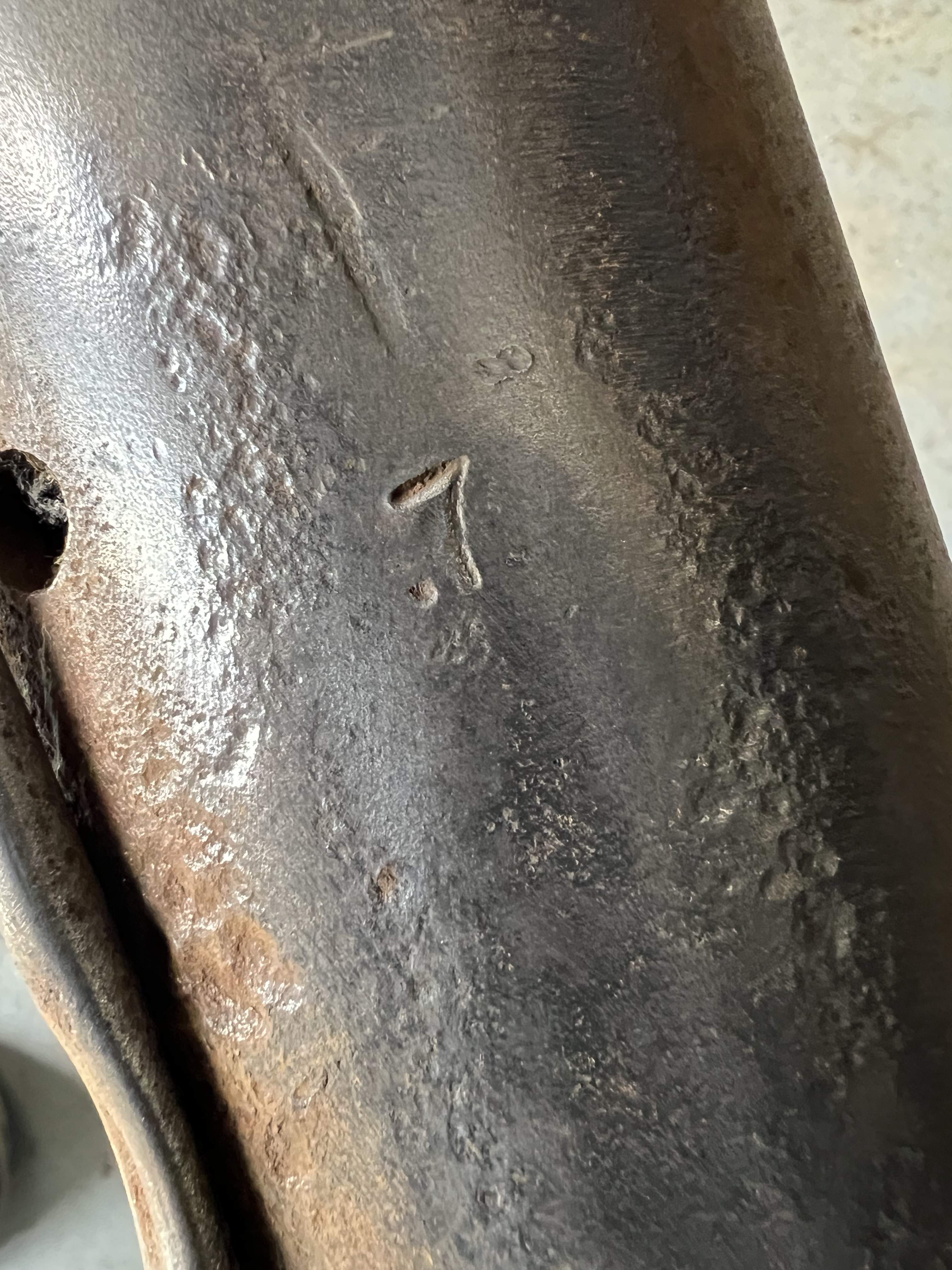

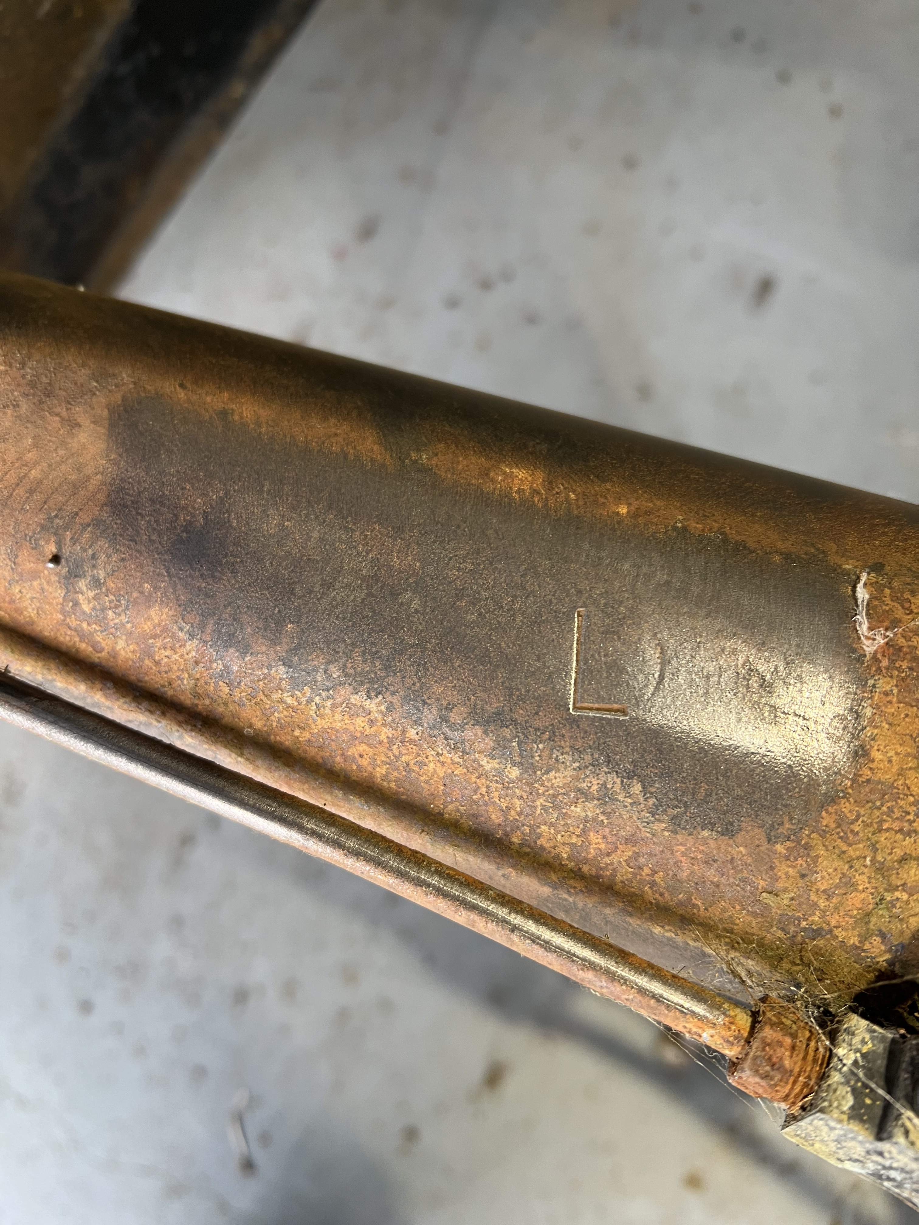

Kiwi - The top code A224 is the casting date - January 22, 1964.
The. 6. 8817 code doesn’t match anything I have looked at thus far. It maybe a foundry code but it’s not matching up to anything I am looking at. Are there any other casting numbers or codes elsewhere on the diff or axle tubes?
i am out there now frosty, i will have a look on the axle tubes like Fitzy suggested 👍
The only markings i found was a big L on driverside tube and a 7 on the passenger side tube, so i went ahead and just spin the wheel and worked out its a 3.6ish ratio about half way between 3.5 and 3.75IMG_6295.jpeg

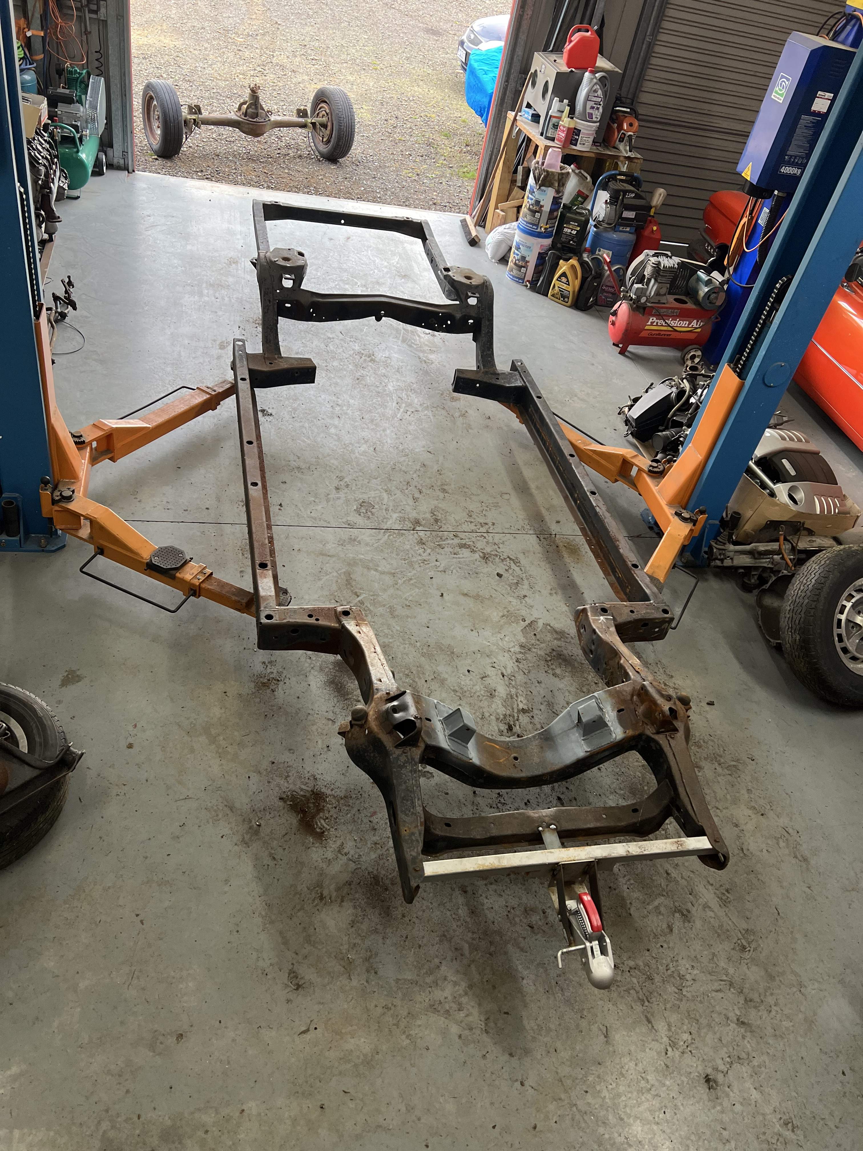

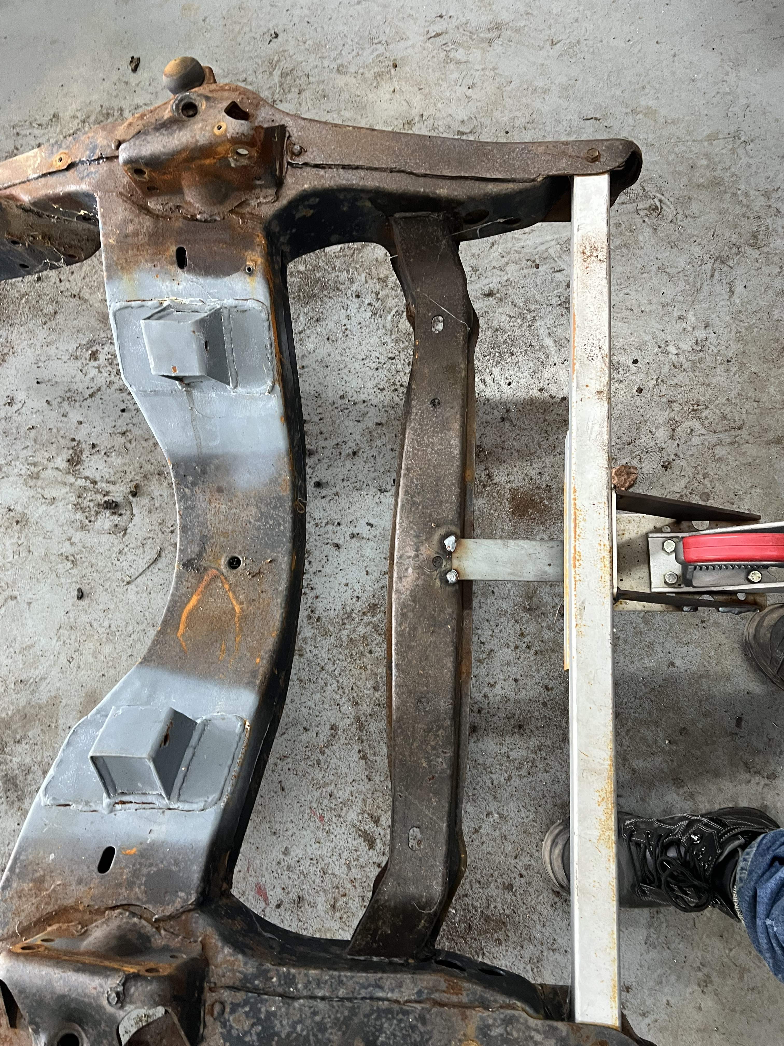

very productive day today, the complete frame stripped

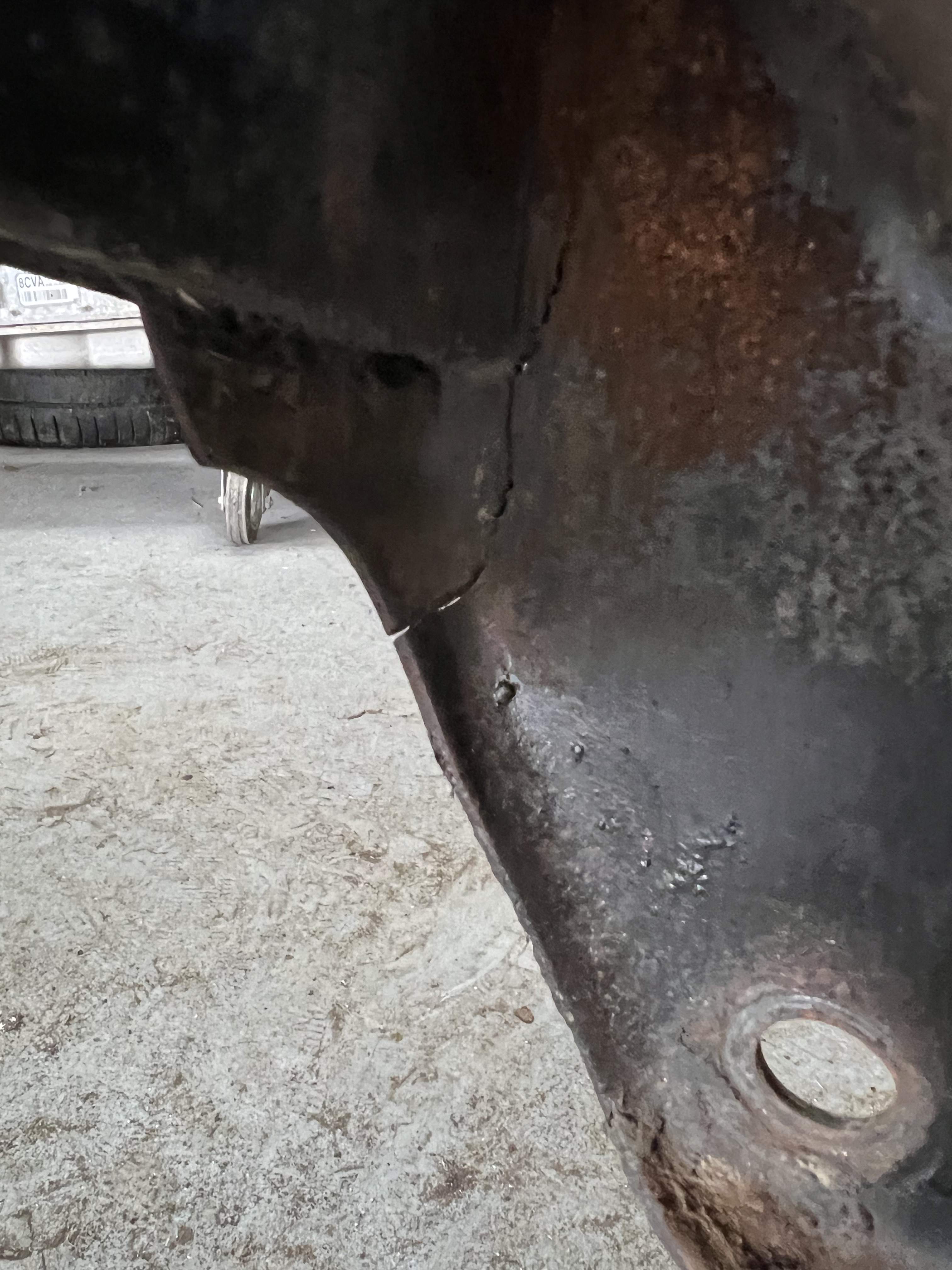

and like any of us at at 62, a few cracks and blemishes to fix :rofl:, this one in the front crossmeber that holds the lower control arm and sway bar

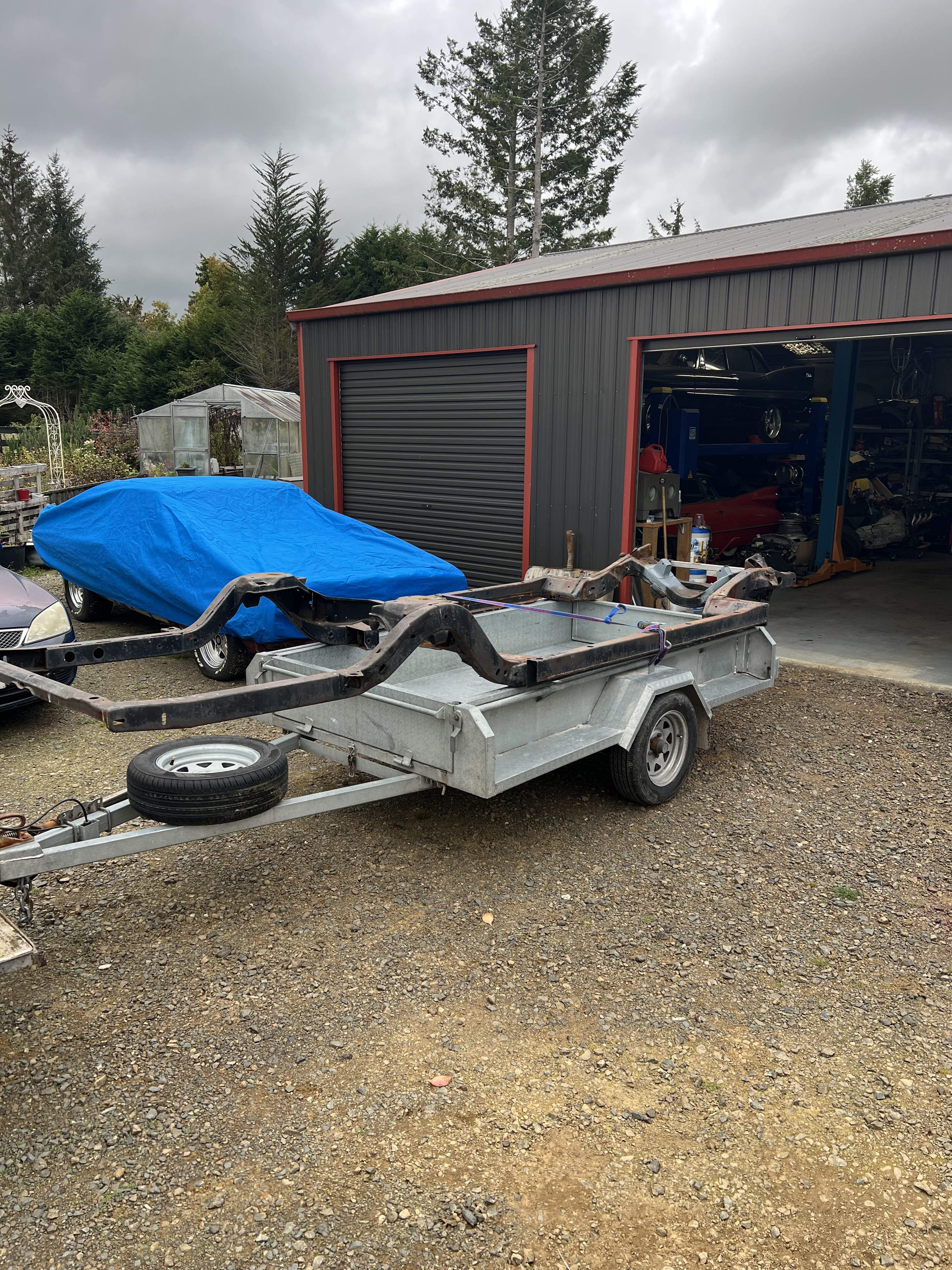

And finally the 63 is complete !!!!:rofl: shes offically a trailer queen!!!:rofl:

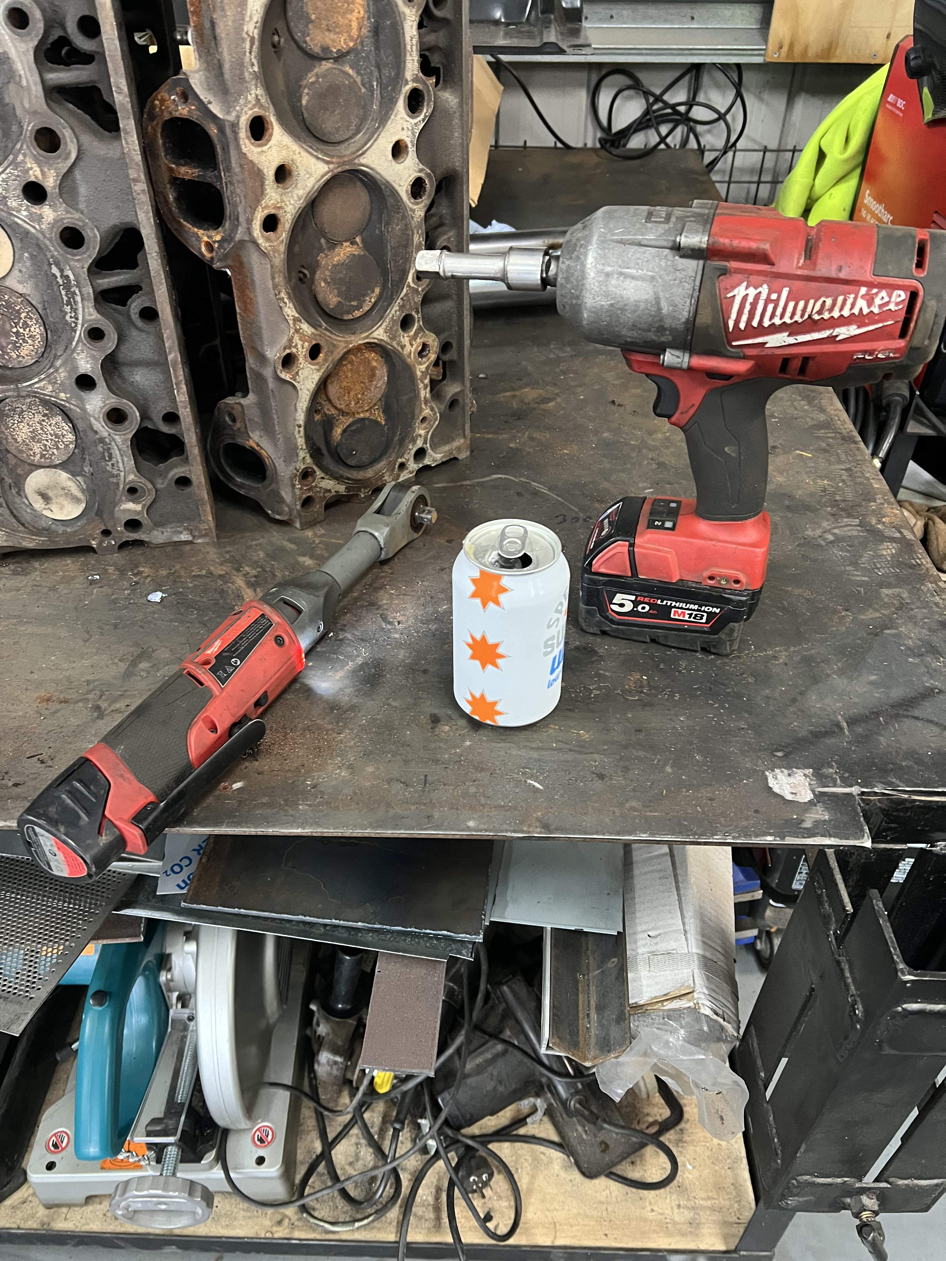

i would thank my team, mil and waukee
and my sponsor speights summit ultra :rofl: with out these tools it would be a much longer harder job stripping down the frame ready for prep  and paint ... which starts next weekend ....fingers crossed the boss doesnt have me lined up to build, paint, renovate, anything else !!!!!:stars:
