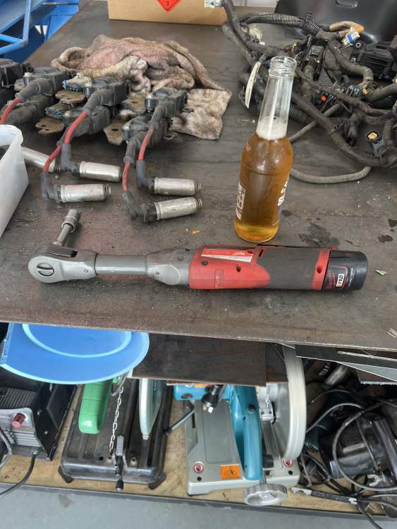

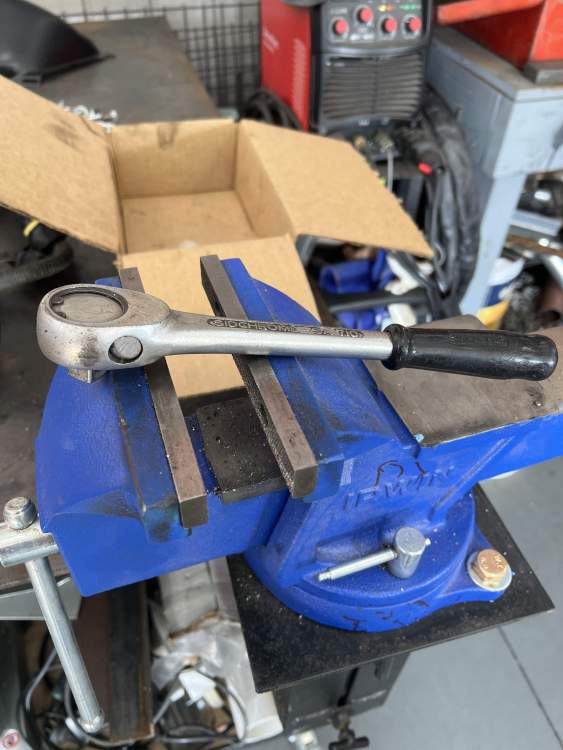

you haven’t got a Milwaukee 3/8 have you !!!
it’s the best tooth brush ever !!! 😜😜😜😜😜
Bout damn time! Tell the boss no more "crap" jobs till after the engine mockup is done! Then post picks of the mockup and both black eyes :rofl:
I can't afford Milwaukee so I gots a Ryobi one. They are brilliant.

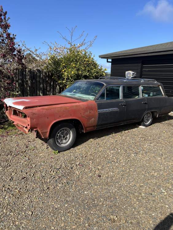

This is the bosses wagon
so she’s excited about me getting on with it …. I can’t let on that , I love this shit !!!
building is my favourite !!
You know that’s the Prius of ratchets aye :rofl:

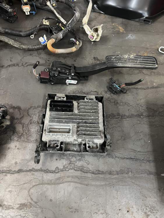

Don't forget to grab the drive-by-wire electronic throttle pedal and its Throttle Actuator Control module, if equipped.  I have also not seen the PCM, BCM or TCM in any of your pictures - plus their harnesses - grab all three.  I presume its an E38 PCM and HP Tuners should easily support making that work for you.
A 6L80E.  Wow!! Definitely grab the transmission cooler radiator thing for it plus the hoses.   See what the Holden uses for a transmission crossmember and take it from the donor - it could be handy later.
Rick
Rick
yip grabbed all that Rick 👍
my sparky will unlock the ecu, remove the vats and put a tune in it and its a simple 4 wire loom to hook up.

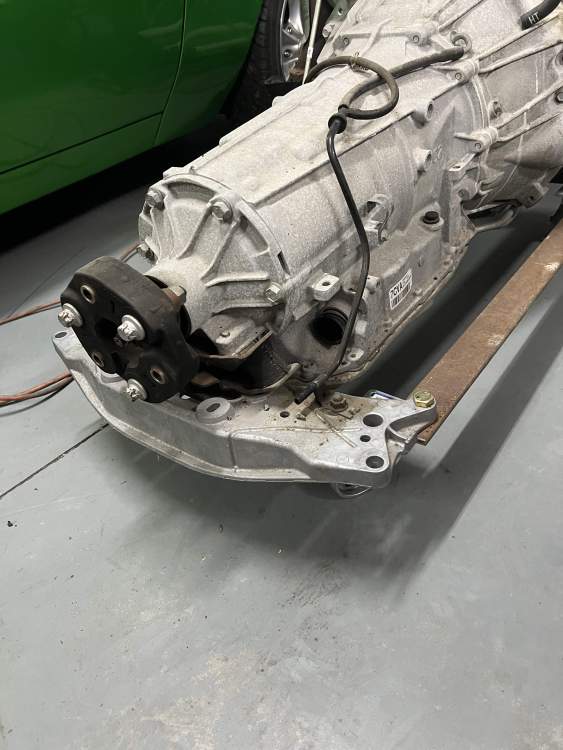

I grabbed the trans cross member as I recon I can make it work
these 6L80e trans are wayyy taller so i will be fabricating up a whole new tunnel i expect
but i do like the idea of 6 forward cogs for a cruiser :cheers:

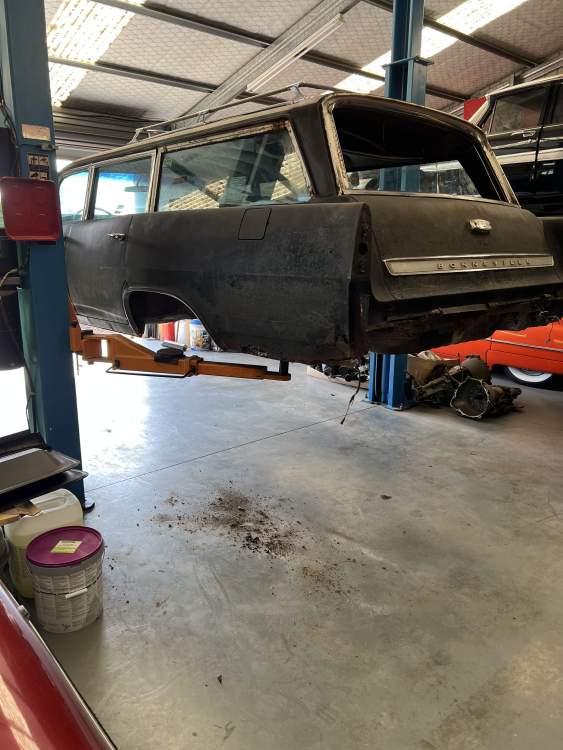

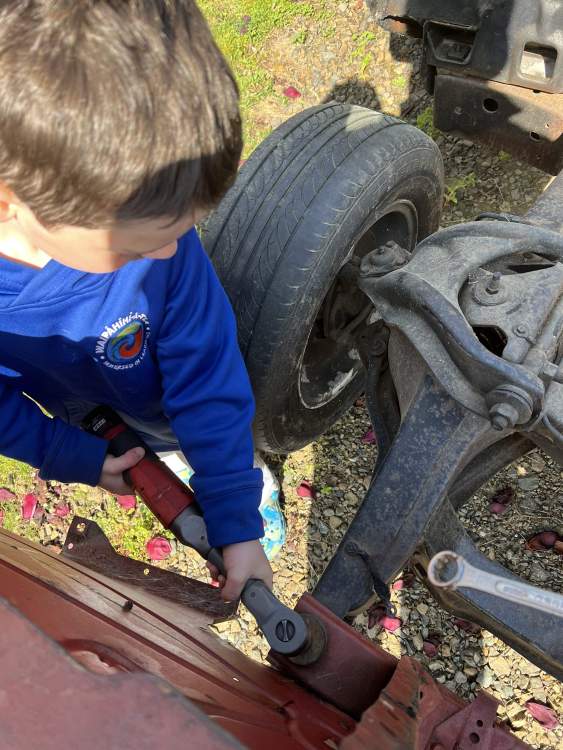

we have 2 of our grandies for the whole weekend !!! so i put them to good use !!!!

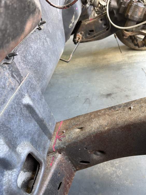

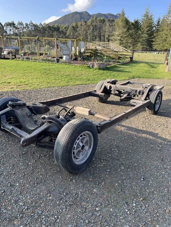

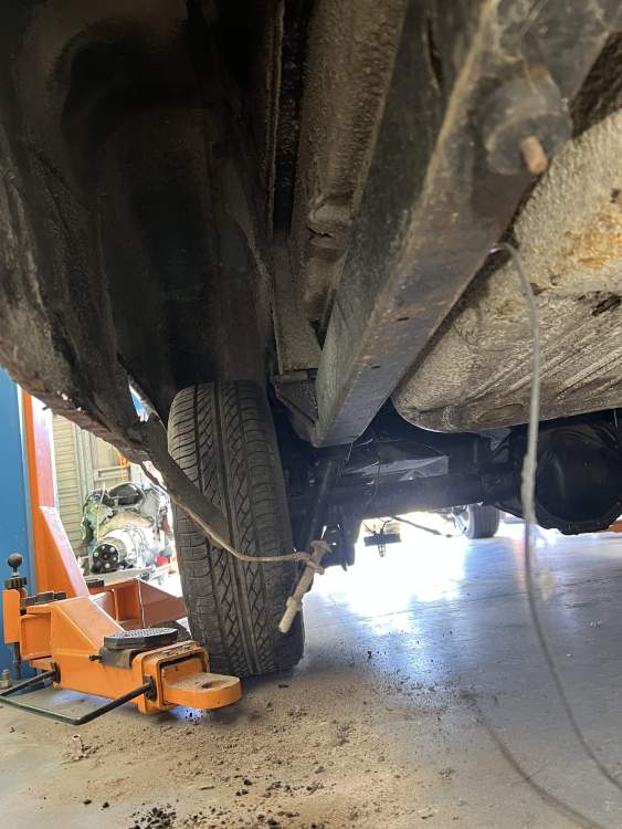

today is chassis out day !!!!
and my 6 year old grandy likes using my Milwaukee ratchet !!!

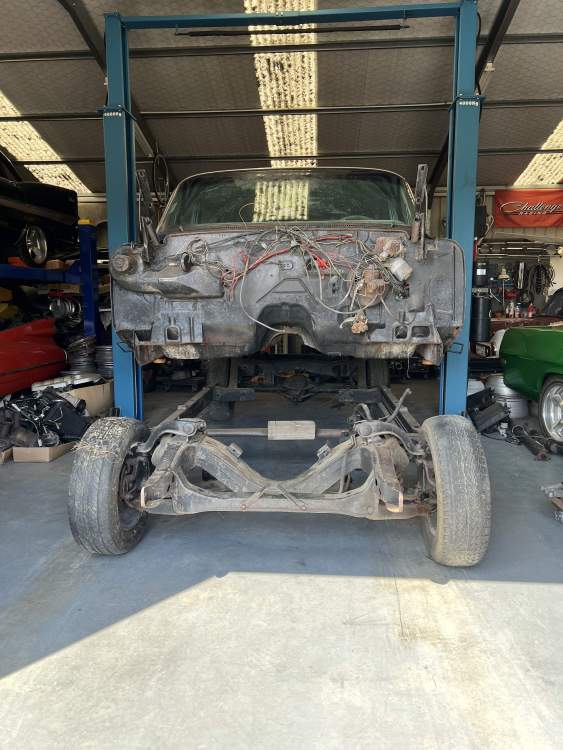

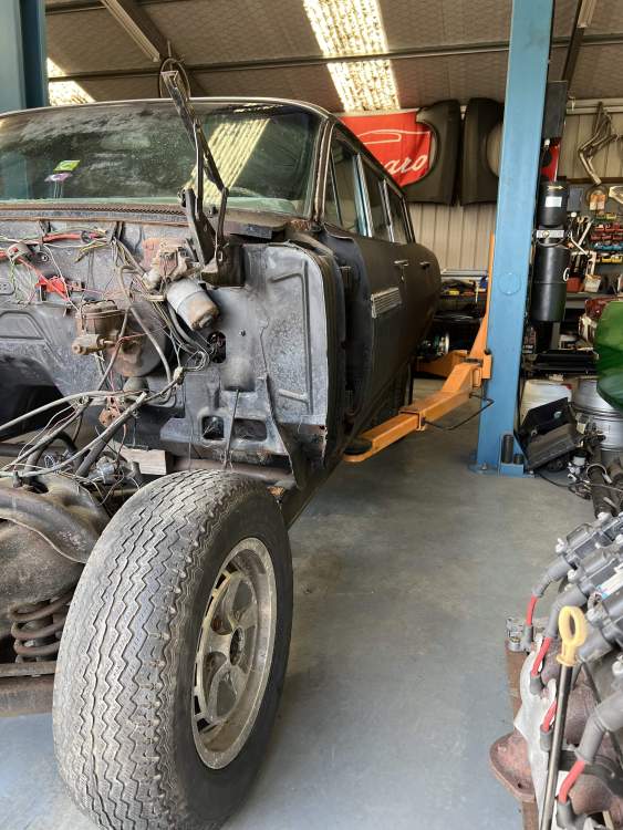

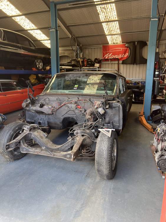

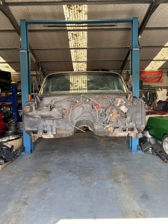

We got the wagon in the garage and prepped for the lift
Including marking the fire wall on the chassis
Come on guys !!!!
can you all give me a lift !!! Fitzy Frosty Joe JustA  Two lane  Andy Rick Del Paul !!!
Don’t mind the site foreman !!!!:rofl:

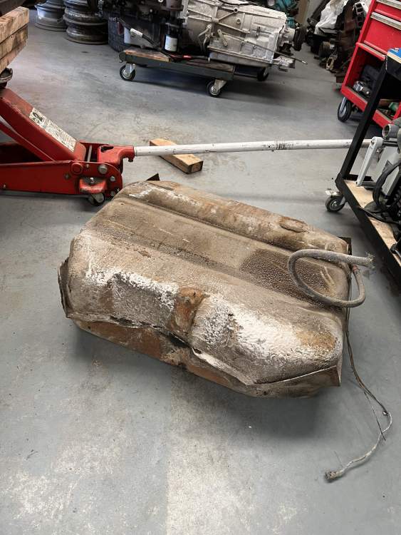

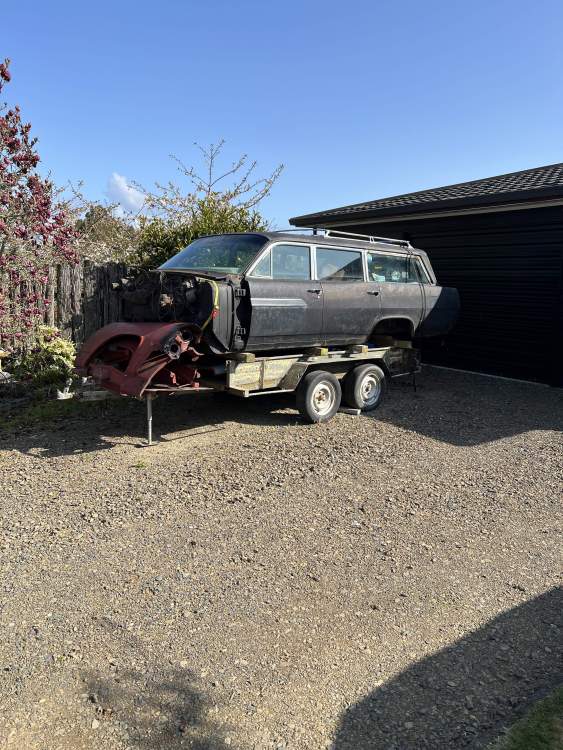

Had to pull the gas tank justA find a place to lift from !!!
And we are out
And the body is on a old trailer I bought justA for this job !
Hell yeah bro, looks like you earned a beer today! :cheers:

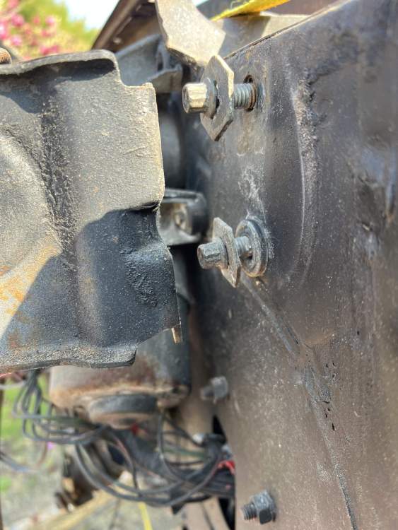

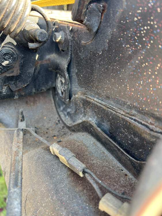

Hay wrongway
you know how you had issues with your bonnet ?
take a look at these pics i took  today !!!!
as soon as i saw the 5mm spacer under the bottom plate of the bonnet hinge , i thought of you !!!!!
Did your hinges have that spacer ??????

15 hours ago, 64 kiwi boni said:
Child labor is illegal over here in the states. Guess not over in Kiwi land 😛 :lol:
Good to get them enjoying it early! Well done!
Does it count that we feed and watered them ? :rofl:
My grand son loves hands on work ... like his dad, i am simply training him for his first pontiac bulid , when he fits a hydrogen ice into his 68 gto when he gets the loan to buy the shell, works on it for the next  30 years and gets it complide for driving on the road :rofl:
I did have a washer/spacer on that bolt. I found that the threads in that hole were messed up and the bolt wouldn't go in all the way. After running a tap through the hole, it threaded in justa fine.
