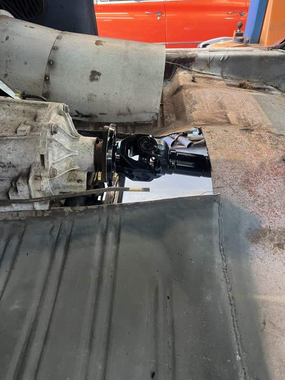

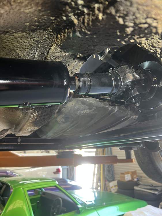

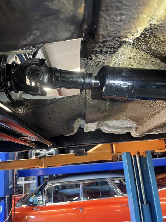

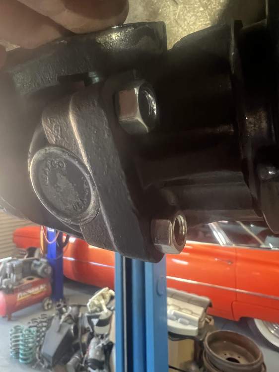

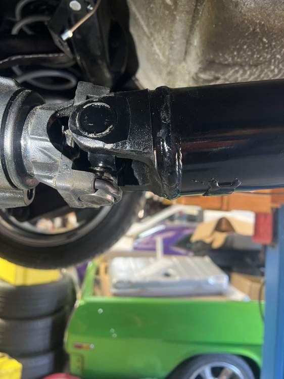

I installed the drive shaft today, to see what modifications I needed to do to the floor …

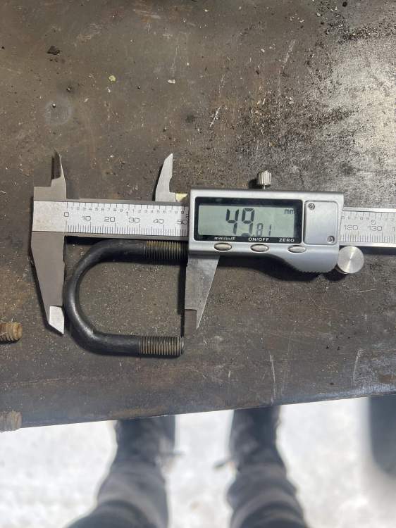

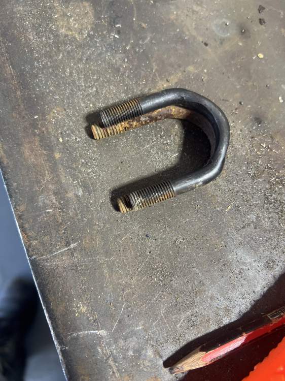

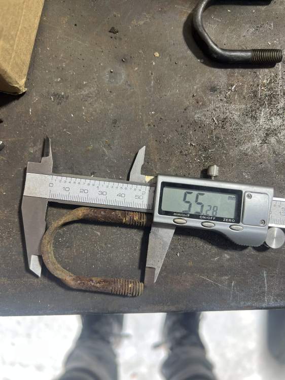

It was a perfect fit, how ever the u bolts that Brett supplied where 6mm too short !
I will get into him tomorrow

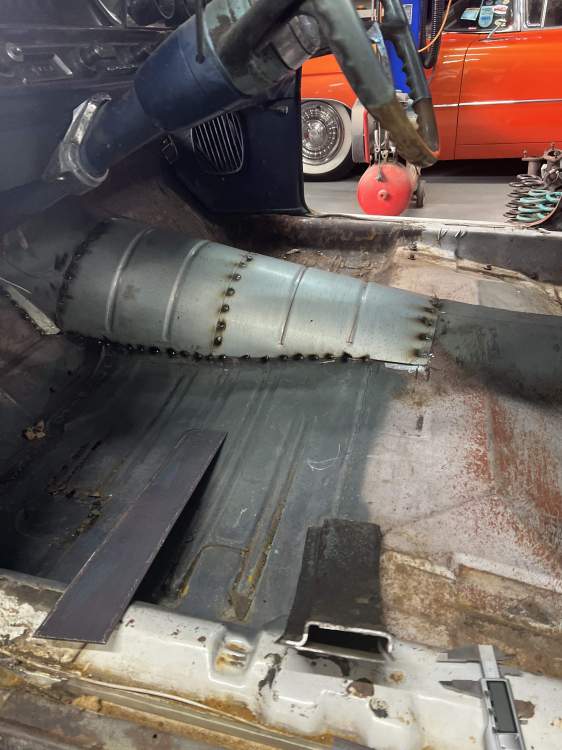

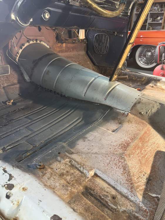

I then spent the rest of the day opening up the tunnel , and completly forgot about taking pics !

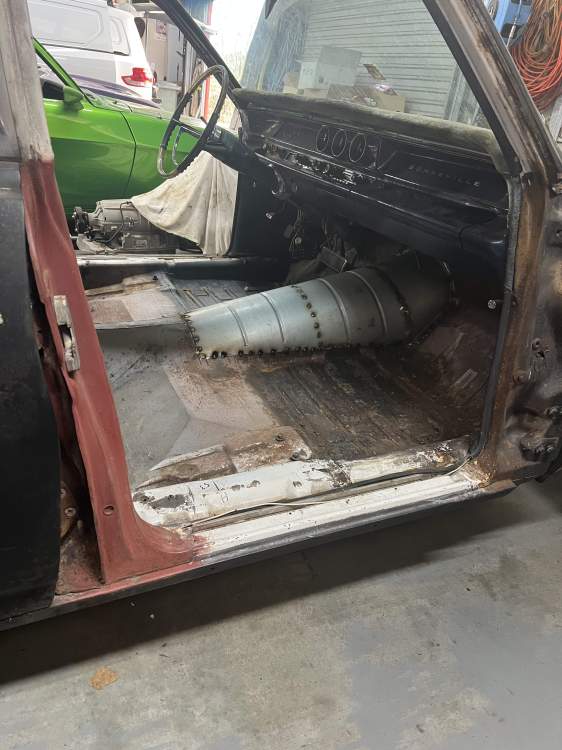

A little bit more progress this weekend ,,,,,,
It reminds me of my GTO when I decided to drop a 4L80e into her. The original console would never fit afterwards so we had to fabricate one. If you plan on a keeping the bench seat, it'll be a lot easier.
Nice job!

i am so enjoying the sheet metal work ! its fun !

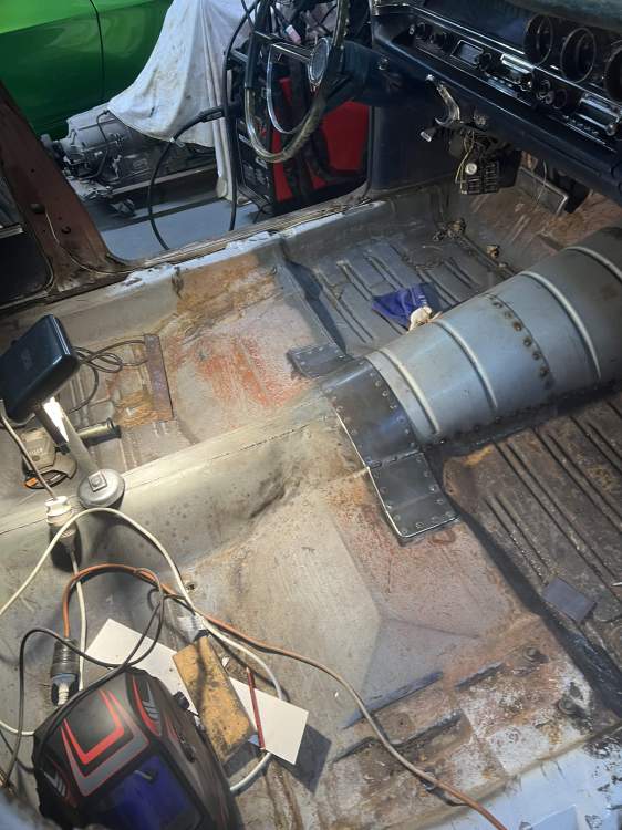

A little more progress this weekend
Making the replacement brace over the new floor pan section .
Nice looking work Kiwi!
Alot of time consuming work there. Nice job.

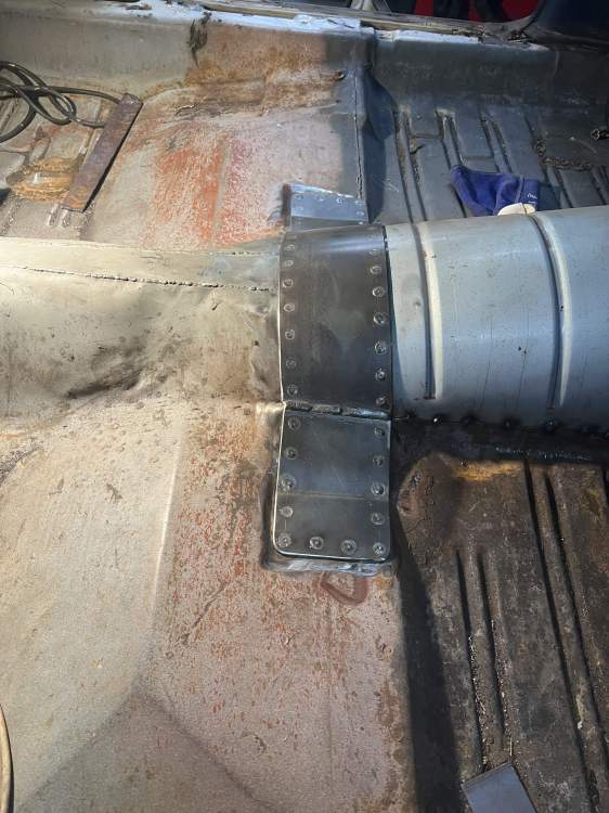

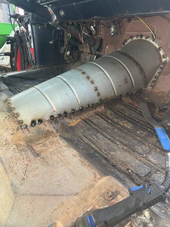

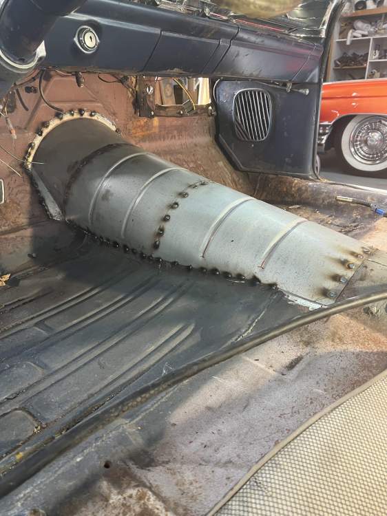

More progress this weekend !!!

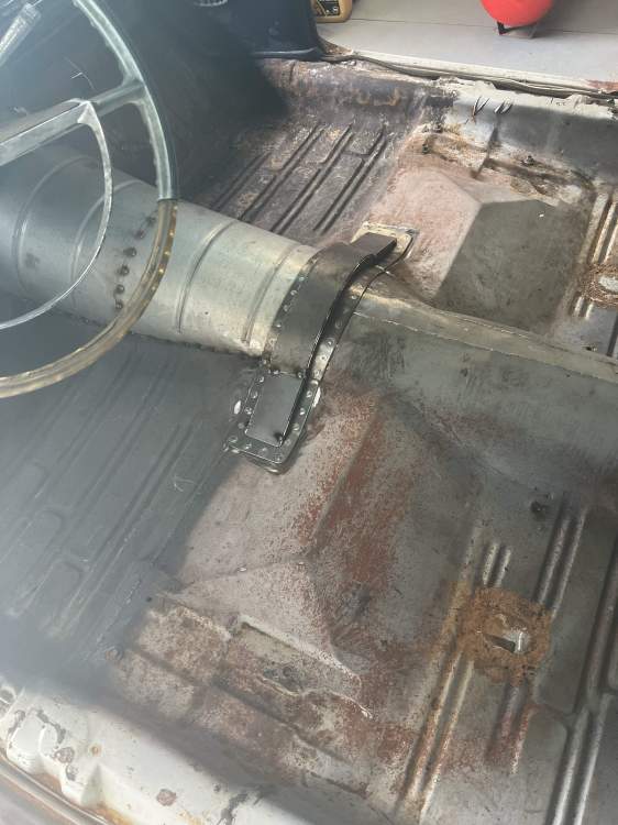

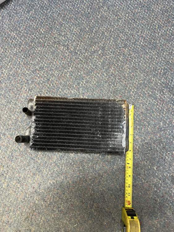

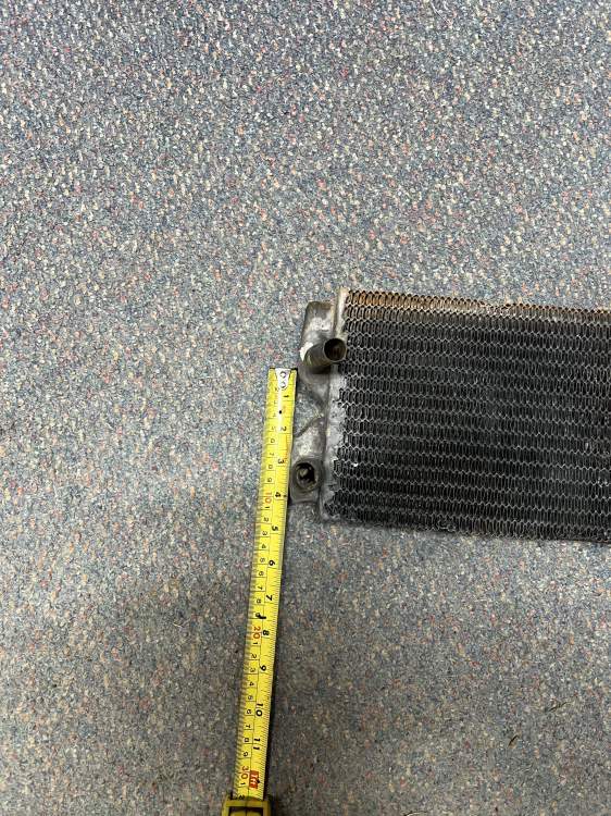

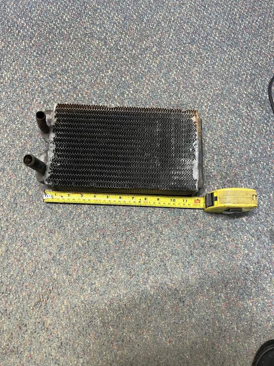

Any one have a source for heater cores for a 63 bonniville ? Ames only list them for A body’s
Presumably, you absolutely need a new heater core? Would a rebuildable core from a used vehicle be OK?
Rick
Have you looked in the Classic Industries or OPGI B-body catalogs for the same core used in early 60's Chevy Impala, Bel Air and Biscayne model vehicles? Buick or Oldsmobile possibly. Some Biscayne sheet metal went into my Catalina.
The "Hollander Interchange Manual" for 1962, 63 or 1964 could be a big help to tell you what other vehicles used that heater core by part number. That core could also be used in Ford, Dodge, Chrysler or other vehicles.
Rick
I am with B52 on this one. Harrison Radiator was the GM division that made the HVAC and radiator systems for GM back in the day. I would hope that the heater cores were interchangeable between sister division body platforms.
Rick
yes Rick its looking really old like me! hence going with a whole new one, i could de- solder the tanks myself but they are 60 plus years old and brass !! soooo not worth mucking with . go all new, so hot water doesnt spew on the bosses feet !!!and i dont loose the browny points !!! roflcheers
Try Year One. They used to carry some big car parts.
Checked all the biggie's, Nada. Found almost all start at 1968 that they can get. Found another place called brassworks.net that can build a 63-68 new one for ya. price. ??? But they include 1968 so I'm assuming a 68 will work for anyplace you can order one. Anyplace there that re-cores for ya?
