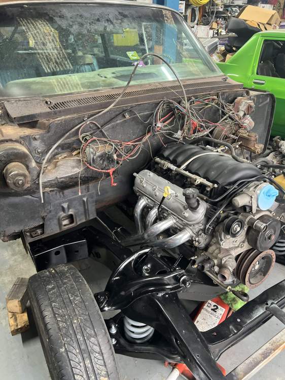

    I made a start on installing the L98 engine today  first was to get the sump swapped over , this  came out of a Holden , state side it would be a g8 2009 l98 with 6l80 trans … but first thin
  • 64 kiwi boni
    64 kiwi boni

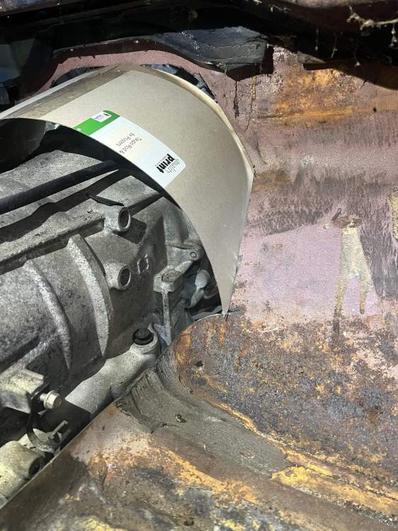

    So motor back out and off with the nasty looking mounts !!! then motor back into the right location , And just finished the day with making cardboard templates, and thinking about how I want
  • 64 kiwi boni
    64 kiwi boni
    The Holden sump had the dip stick coming up out of the sump , the new sump came with everything needed including a new pick up bolts and dipstick that passes down through the block into the smaller su

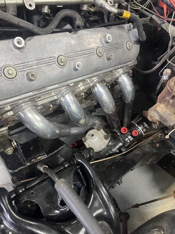

I didn’t expect the clearance issues with the headers !
But easy to fix !

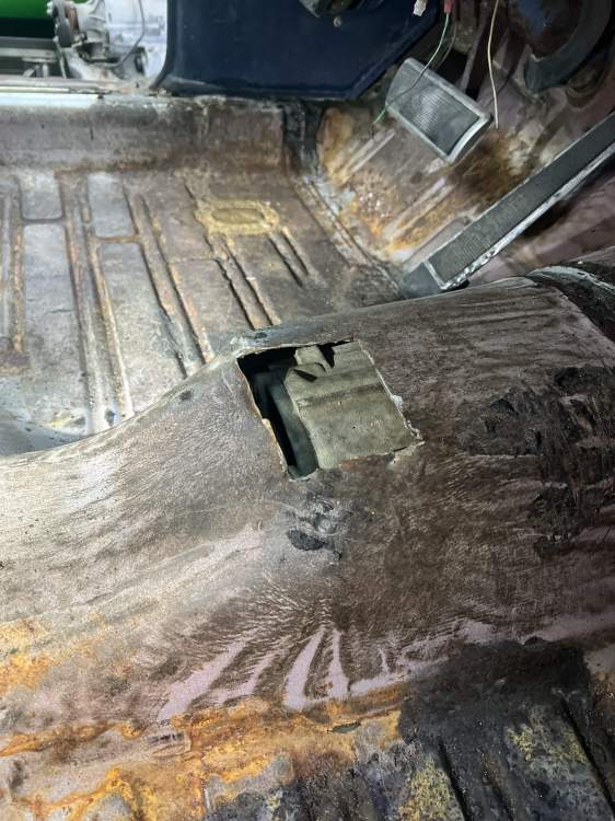

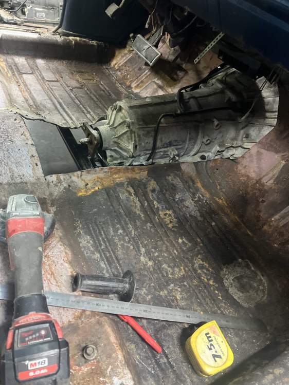

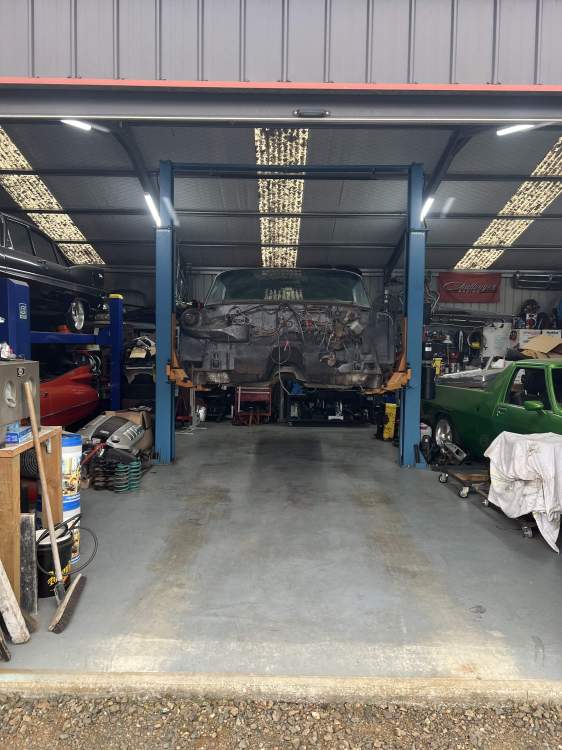

i made a start on the tunnel chop today....
body in on the lift and out with the seats and carpets, the floors are in very good condition , i only found one small spot of rust that i will need to cut out ....
so far so good !
and i found some history of its life in Rotorua !!!!

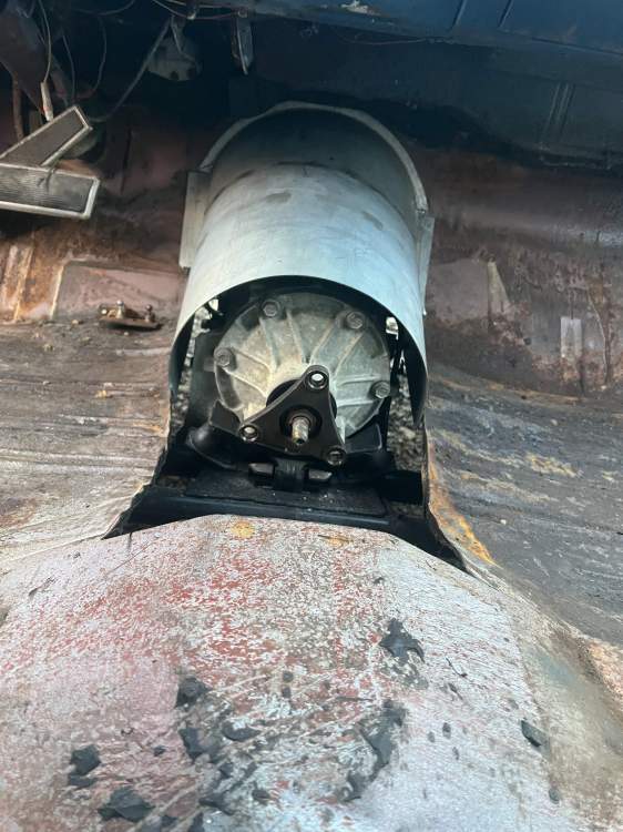

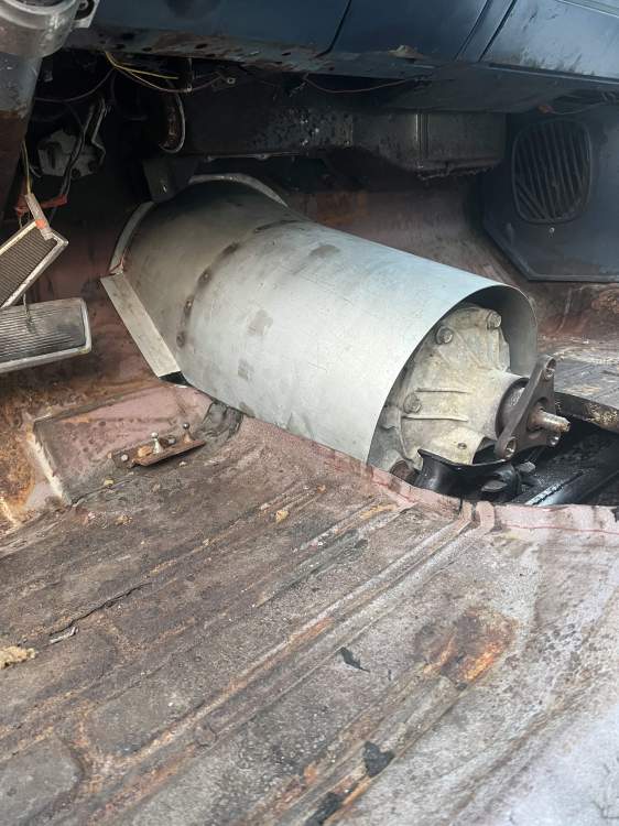

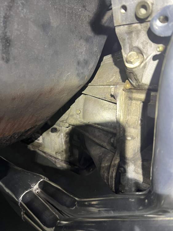

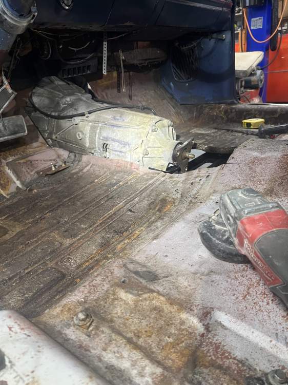

really close, but i know that a 6l80e is not going to fit in a 63 tunnel !
i got within 45mm of the body mounts ...
and then i chopped !!!

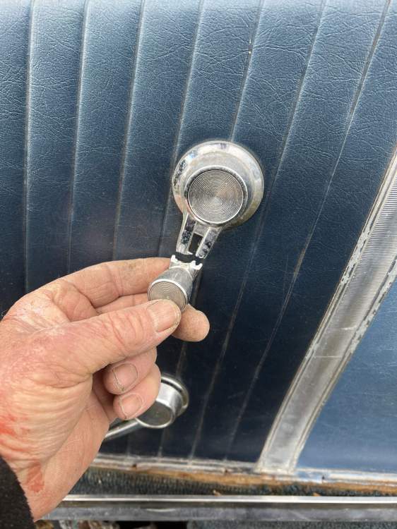

I had removed the front doors JustA to make life easier while working on the floor
But I managed to snap a window winder when I unbolted the hinges !!!!
Which gutted me !
63 sedan doors are heavy !!!!
Great to see you're progress! You know I've been waiting to watch this build.
Wrongway , do you have any spares i could buy of you ? its the quarter window one !

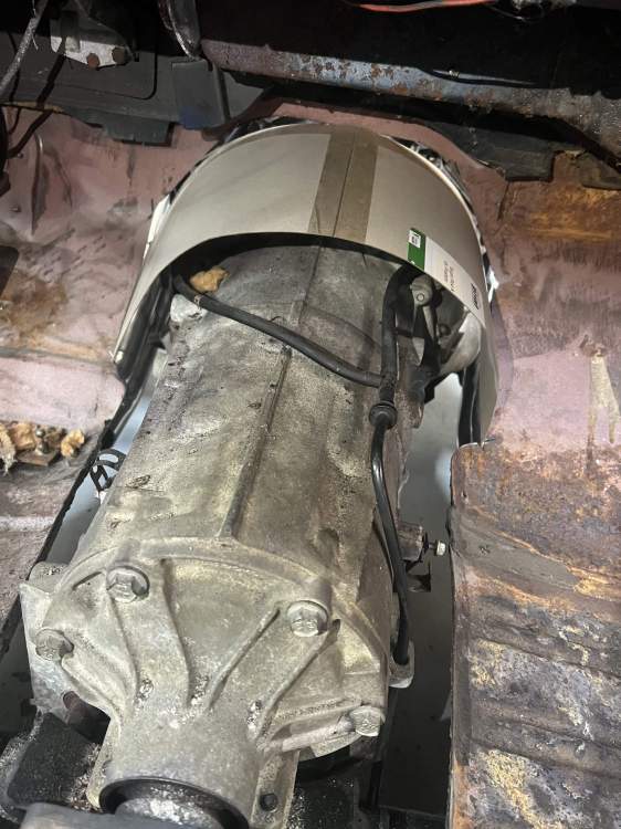

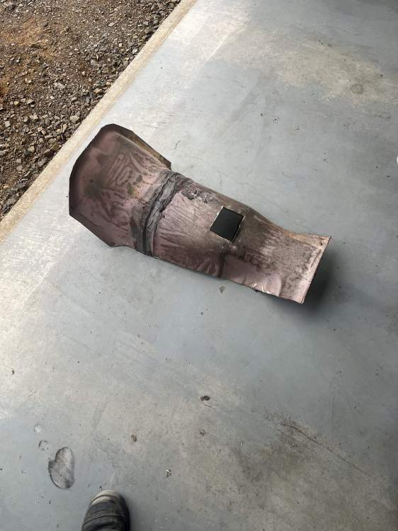

I made a template for the first stage of the new tunnel
Then made it in 1.2mm sheet metal.

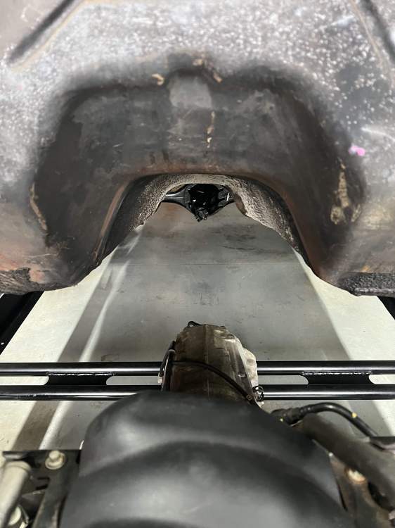

i am stopping here until i get my custom drive shaft and can see what else i need to cut/modify
i can see that the first floor support cross member is going to be too close !!!
This is where i will need to bring in my certfier to "tell me" what i can and cant do ...
watch this space !!!
The drive shaft its self will be a first for me ! i have never had a 6l80e trans ! all my other drive shafts have been what i think as normal slip yoke shafts, ! this one as you can see needs a telescopic shaft, i have a live axle and a fixed point rear output shaft ... i have had a price and pulled the trigger on it ...lets justa say, its not cheap...rofl

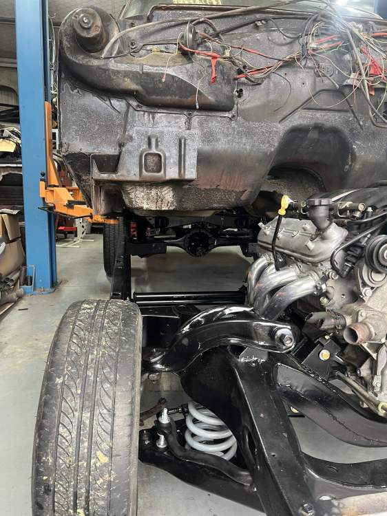

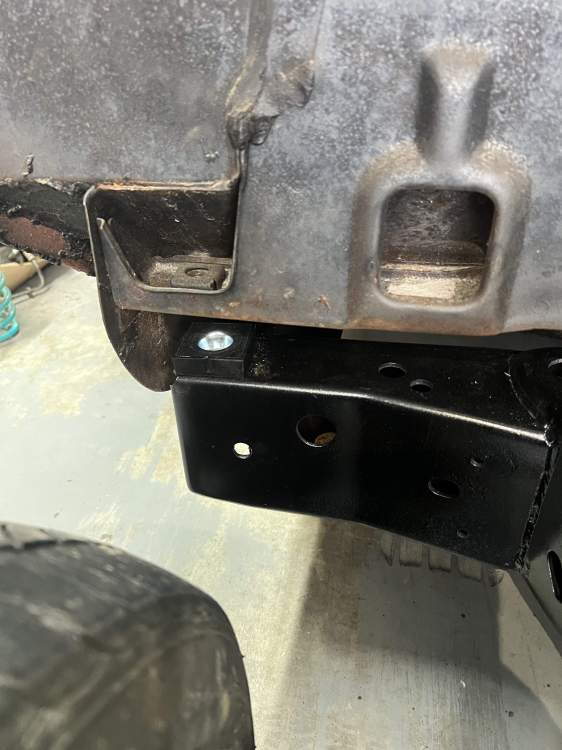

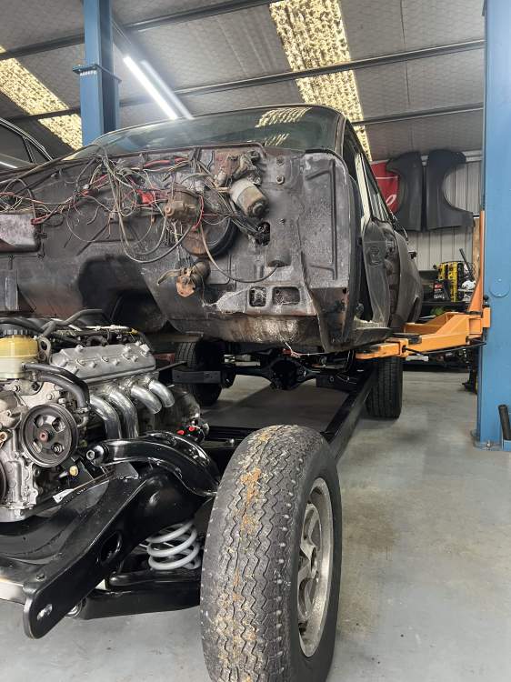

i have encountered a few cans of worms that i will need to deal with.... like ride height ...in the rear is tooo low... like 100mm too low ! and i will need to think about using a lokar cable trans shifter kit, and a speedo drive unit.
But the girls back on her frame ! thats progress !

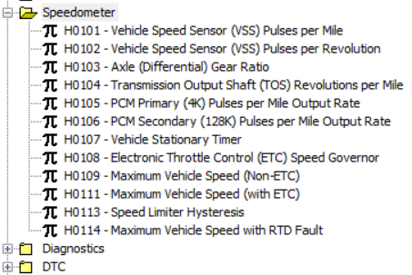

If the tune inside your PCM / TCM operating system is correct - transmission type, rear differential gear ratio and tire height - any speed calibration adjustments will either be unnecessary or very minor. These items and a few other very exotic and esoteric vehicle operating system things (pulses per mile and pulses per revolution - "H101 thru H106") must be set up by whoever is doing your PCM and TCM tuning. Otherwise, the speed at the instrument cluster will be incorrect and the speeds at which your transmission shifts gears will also be undesirable.
Rick

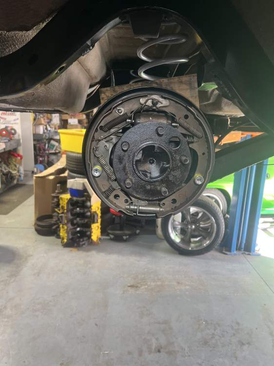

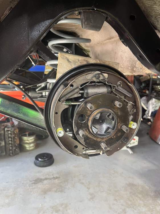

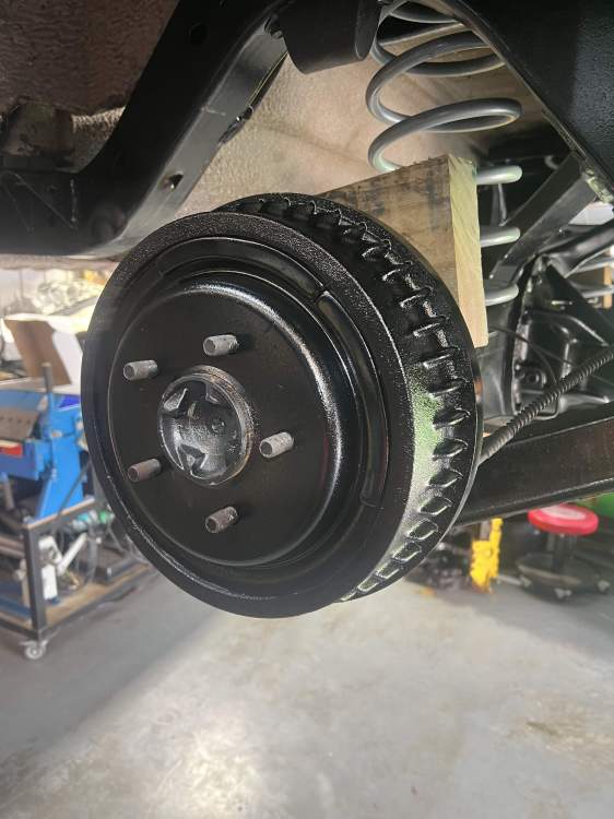

so excited !!! my brake shoes are made and custom shaped to my brand new heavy duty drums !!!
i can now assemble the rear brake set up !!! woop woop ! happy spongebob squarepants GIF
I have had a very productive day,
all my new brake parts installed including modified hand brake cables, my brand new hd drums and lots of new and cleaned up little parts in each rear drum !

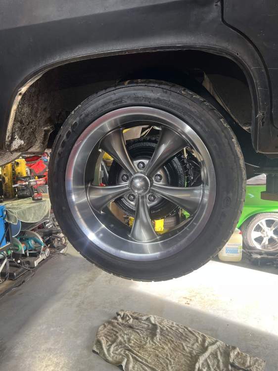

the Ridlers ... 255x18 look good and fit under the wagon nicely !!!
and i even had time to mock up the header alterations. which i am wayyy happy with
