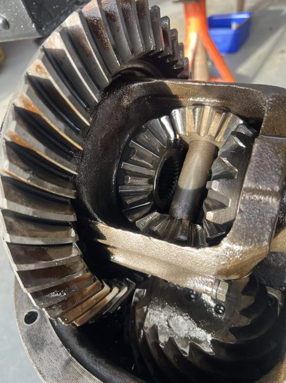

    I made a start on installing the L98 engine today  first was to get the sump swapped over , this  came out of a Holden , state side it would be a g8 2009 l98 with 6l80 trans … but first thin
  • 64 kiwi boni
    64 kiwi boni
    So motor back out and off with the nasty looking mounts !!! then motor back into the right location , And just finished the day with making cardboard templates, and thinking about how I want
  • 64 kiwi boni
    64 kiwi boni
    The Holden sump had the dip stick coming up out of the sump , the new sump came with everything needed including a new pick up bolts and dipstick that passes down through the block into the smaller su

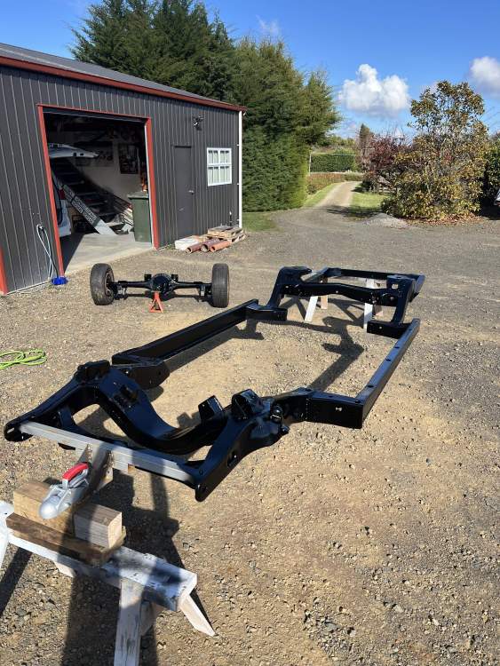

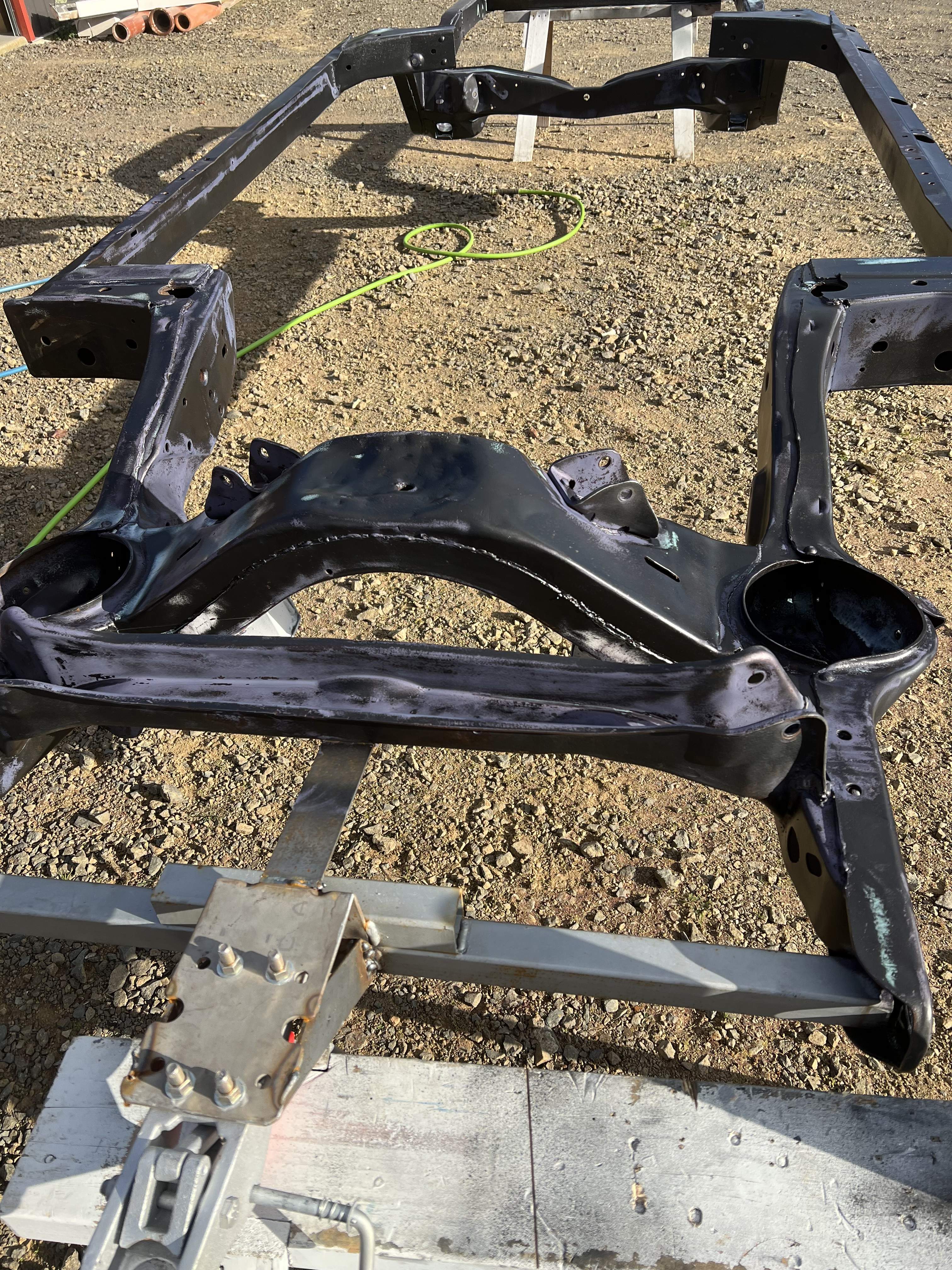

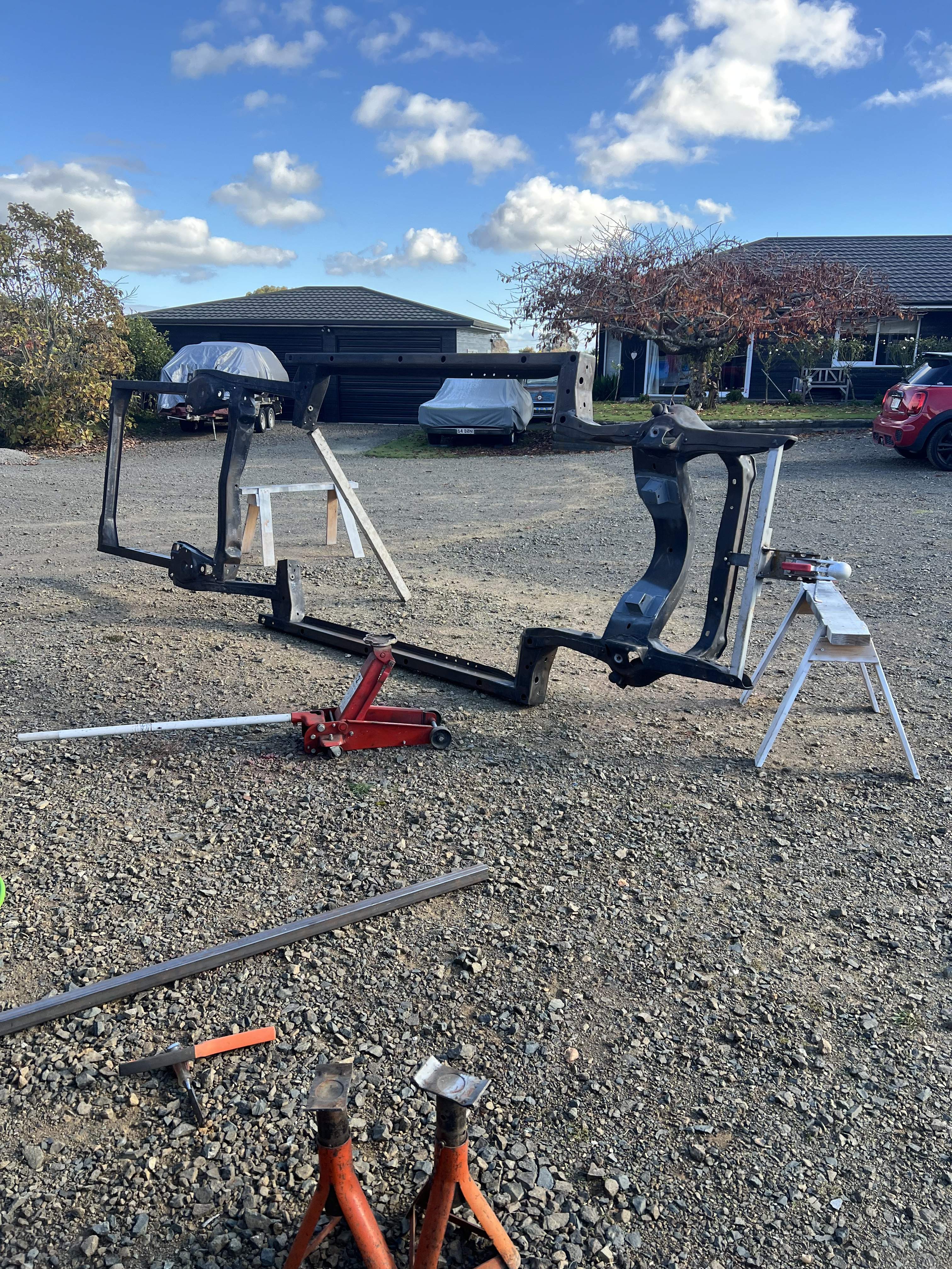

Its saturday !! and its prep and paint time ... suns out  !!! IMG_6338.thumb.jpeg.8703c41539cb41d5914b76cef56fe37e.jpeg

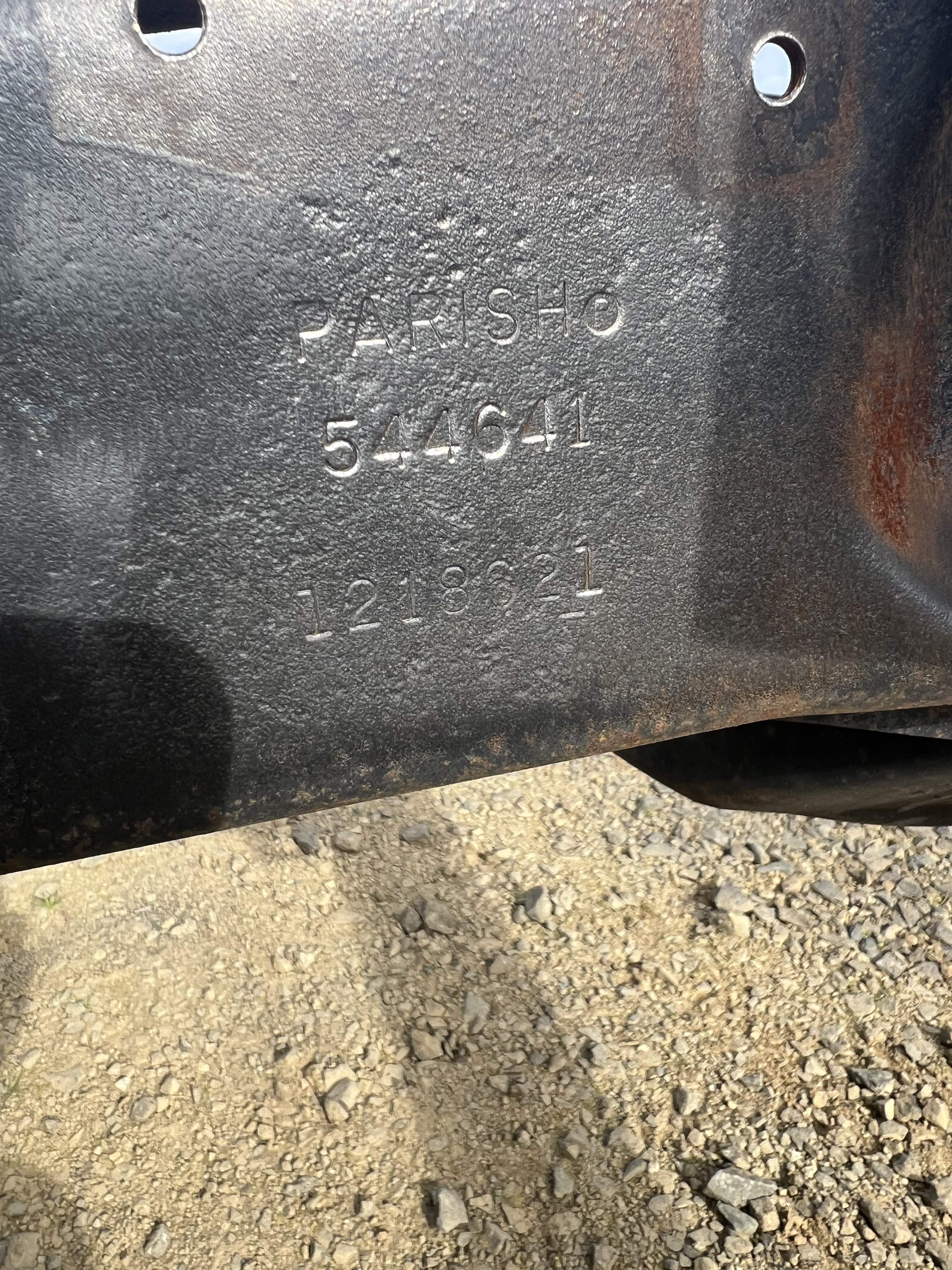

i found the frame number which is so cool ! when i did the 64 bonni frame back a couple or 5 years ago i could not find a single stamping ... looks like i have myself a paris ho :rofl:

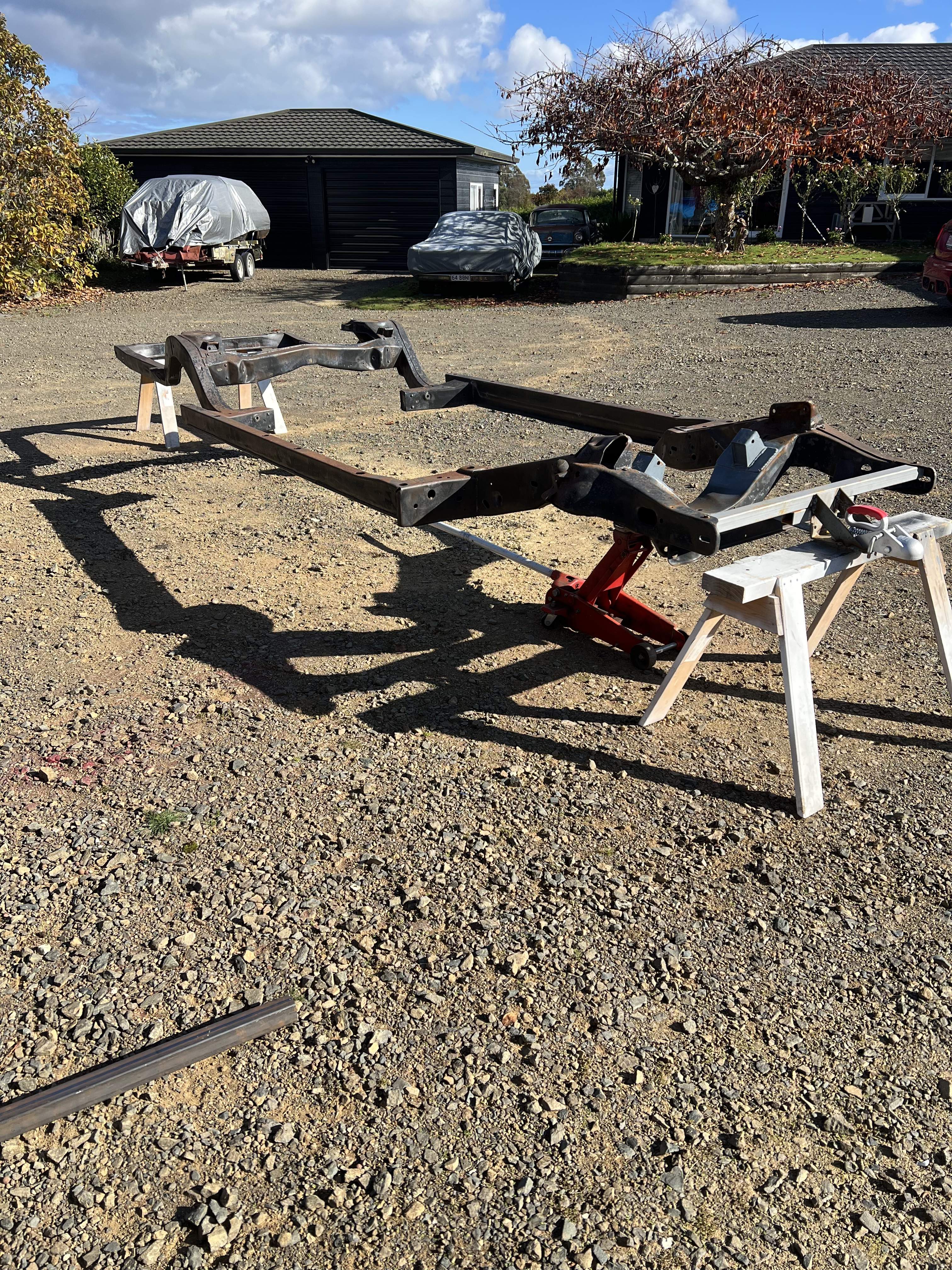

After i stopped laughing about the stamping ! i got to and wire wheeled the whole frame , all the hard spots got sand blasted with my toy sand blaster, and a bucket of garnet , which was a good test for my new 16cfm compressor
last frame i justA sent it to a sand blasting co and handed over a $1000 .
this time i got down and dirty and i recon its going to cost me about $300 for paint and blast materials ......
i got the whole frame clean and a coat of crc rust converter on , it kills rust and drys to a hard black  primer that is perfect for a enamal chassis black paint
 the crc rust converter is a weird spray on water based treatment that leaves a plumb crazy / black finish

While I must admit I find Paris ho funny as hell, that is not it.
I believe what you are seeing is PARISH and either the “at” or copyright symbol. Your frame was made by a GM vendor named Parish Pressed Steel Company. They made frames for many GM lines back in the day. They were located in Reading Pennsylvania. They made US soldier’s M1 helmets for WWII as well.
The frame was made on 12/18/1962 on first shift.

Thank you frosty 🙏
great info :cheers:

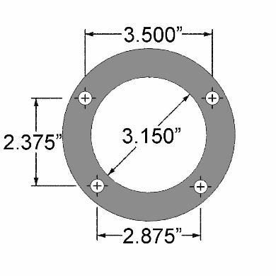

This is the 9.3 pontiac axle housing bolt pattern, i need to find a s10 page some where on the net to justA confirm they are the same

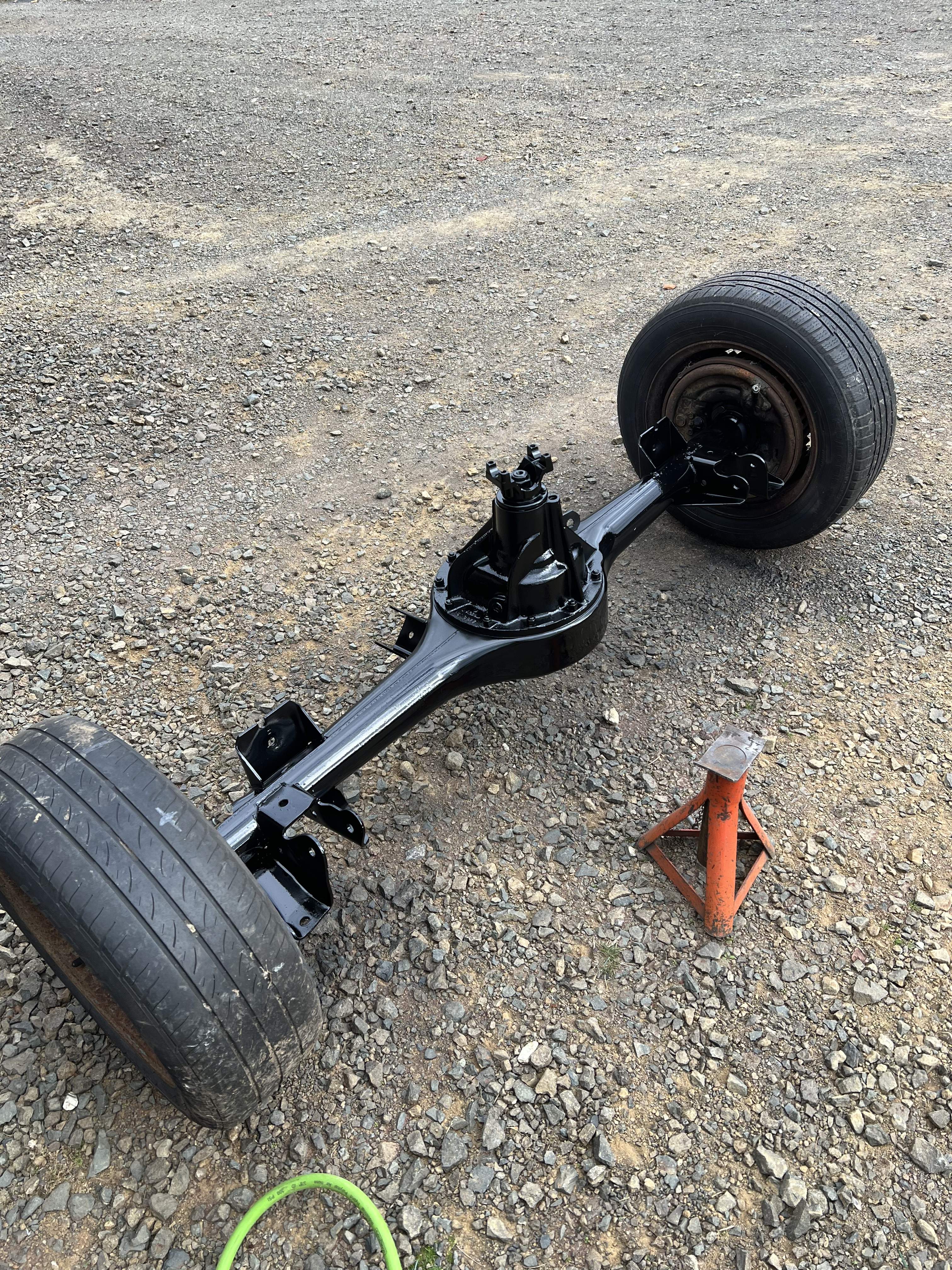

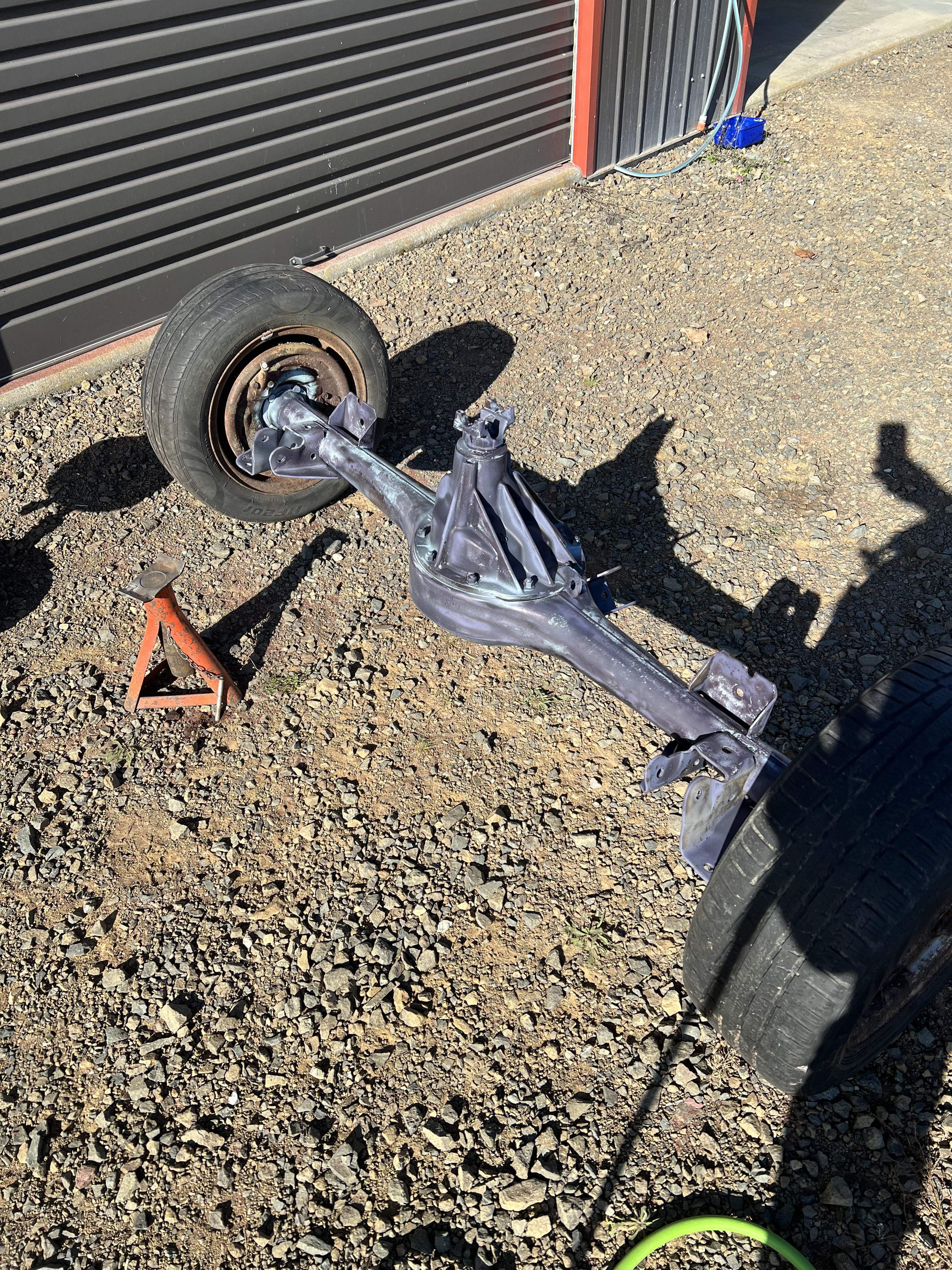

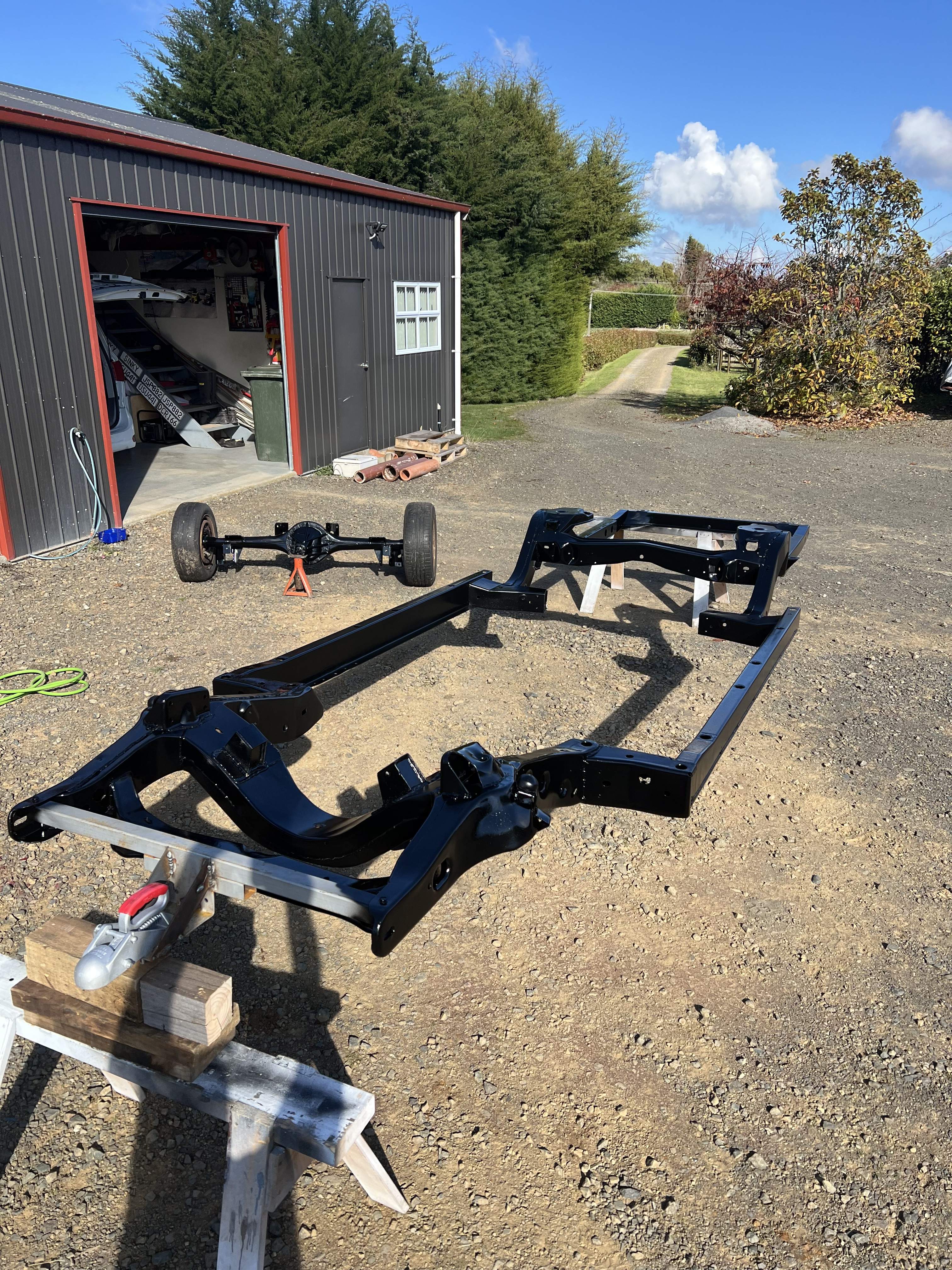

Then paint !!
Along with the frame

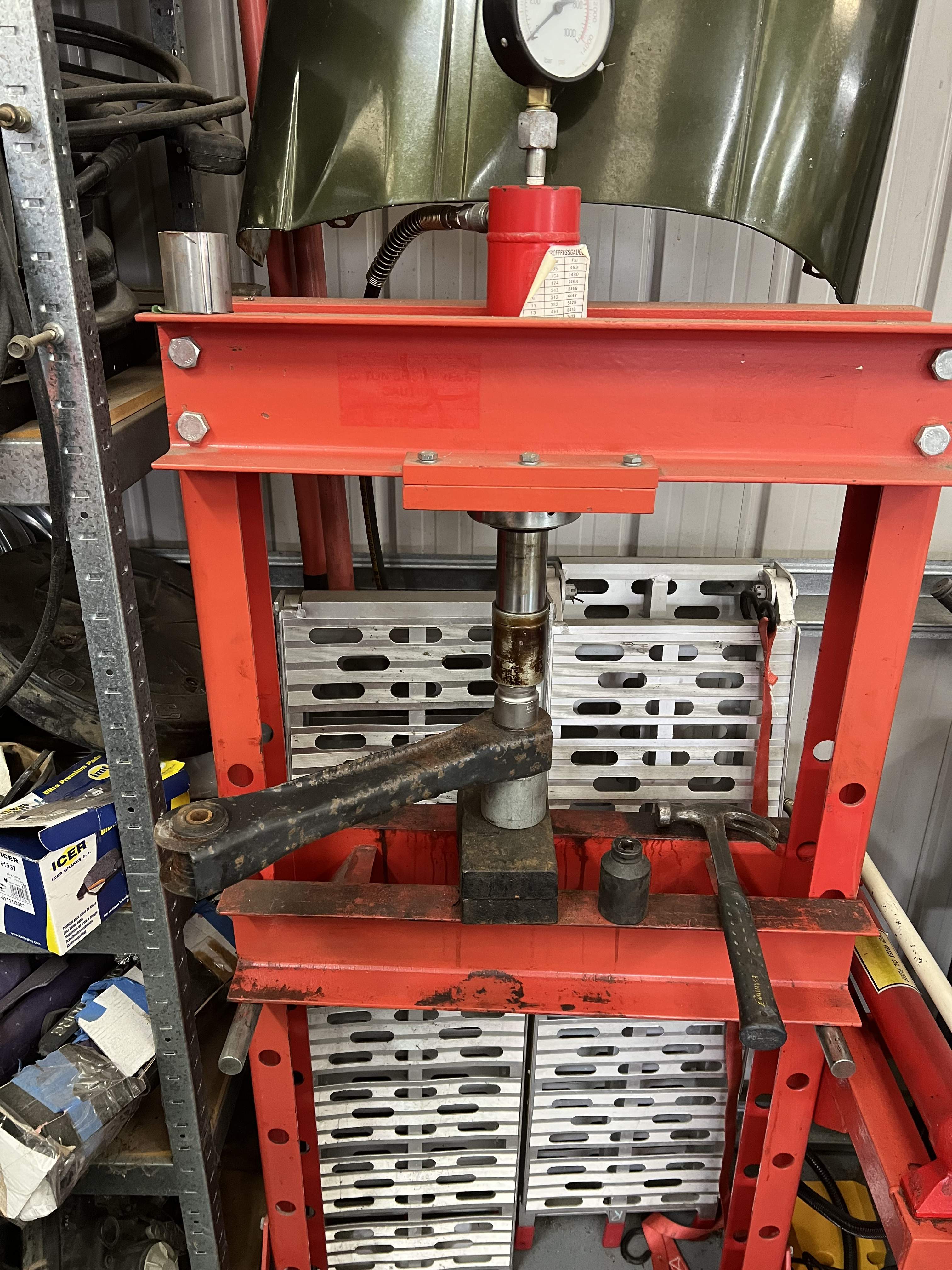

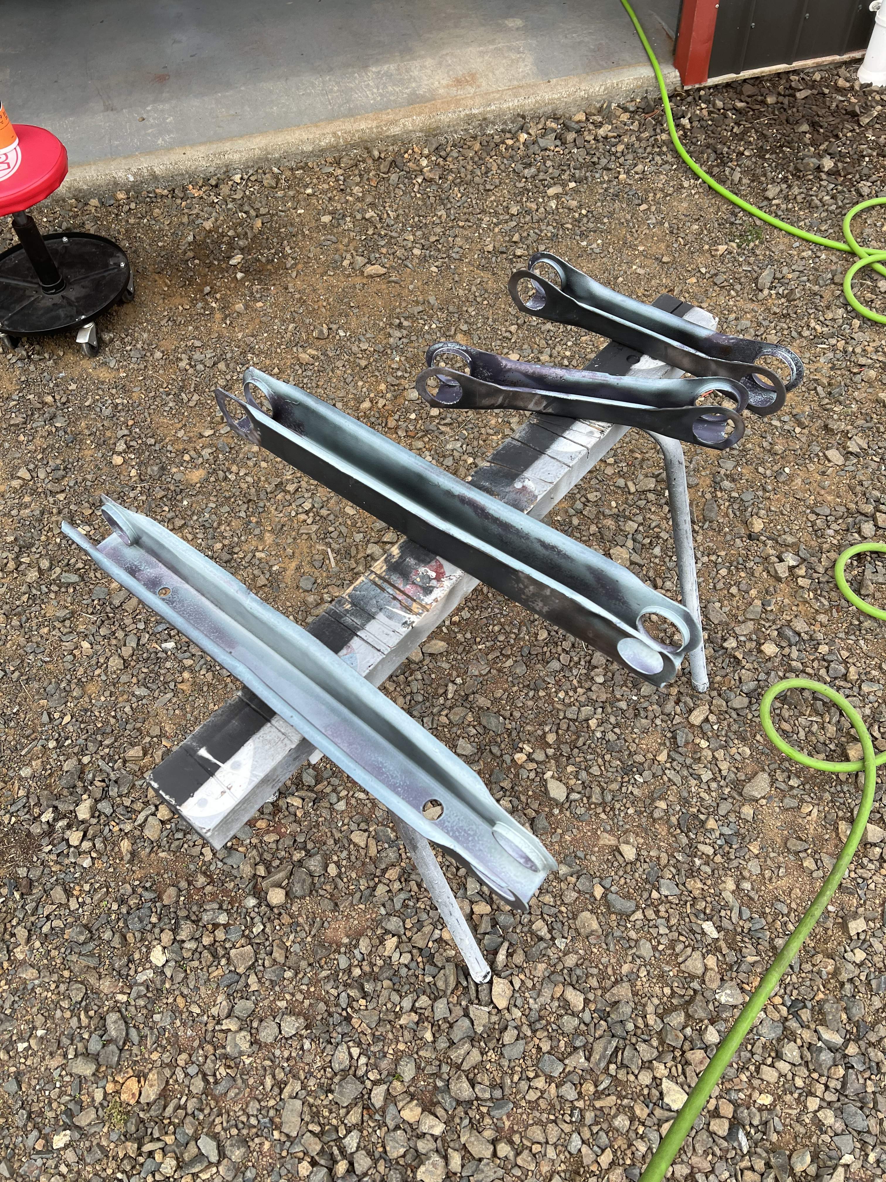

Then let it dry and work on the trailing arms , press out the bushings
And rust treat
I will paint them after I press in the new bushes

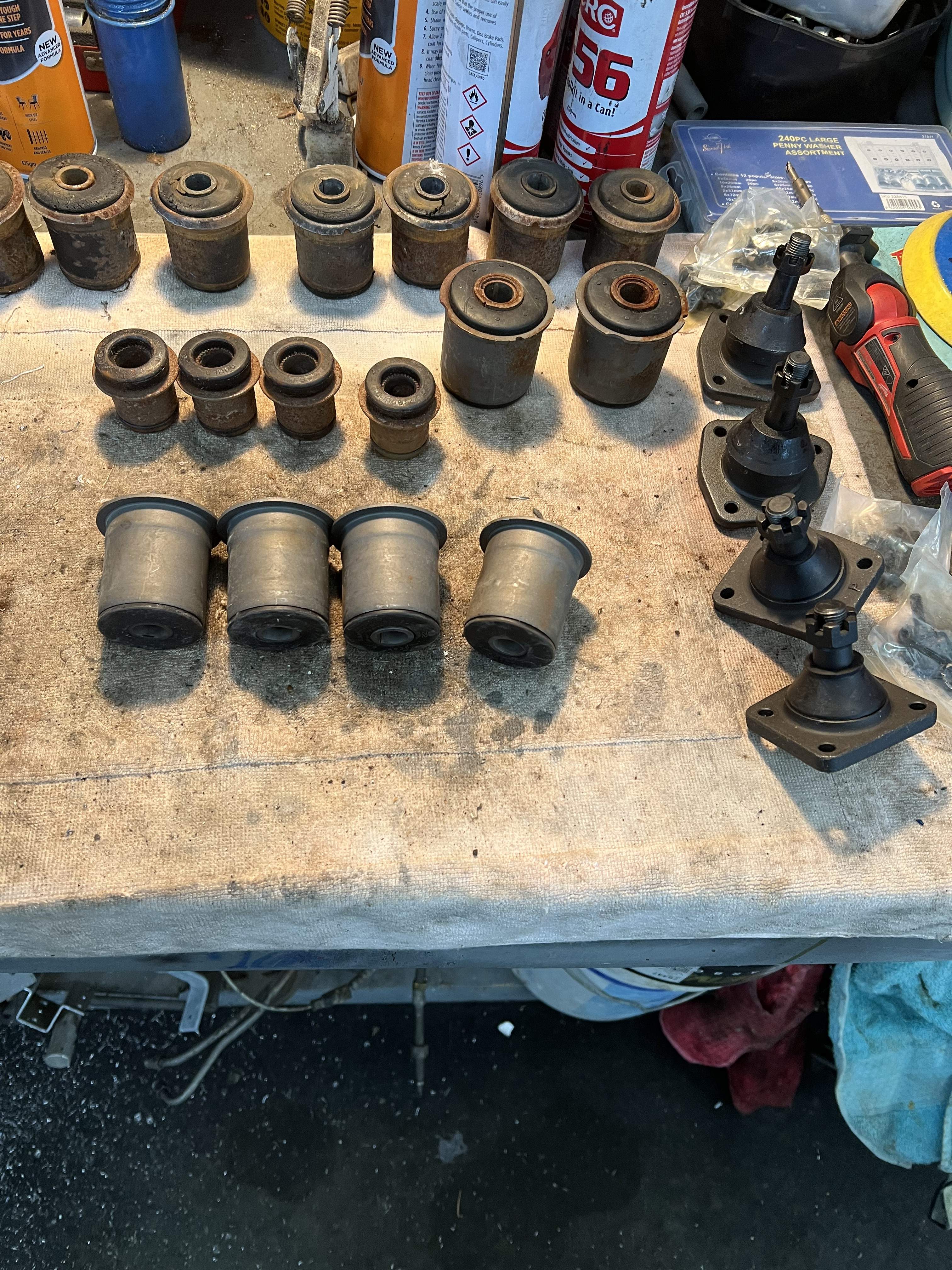

But I see I am 4 bushes short !!!
Next  mission ! Who has the best deal on bushes !!! It’s not the cost of them !
it’s the freight !!?

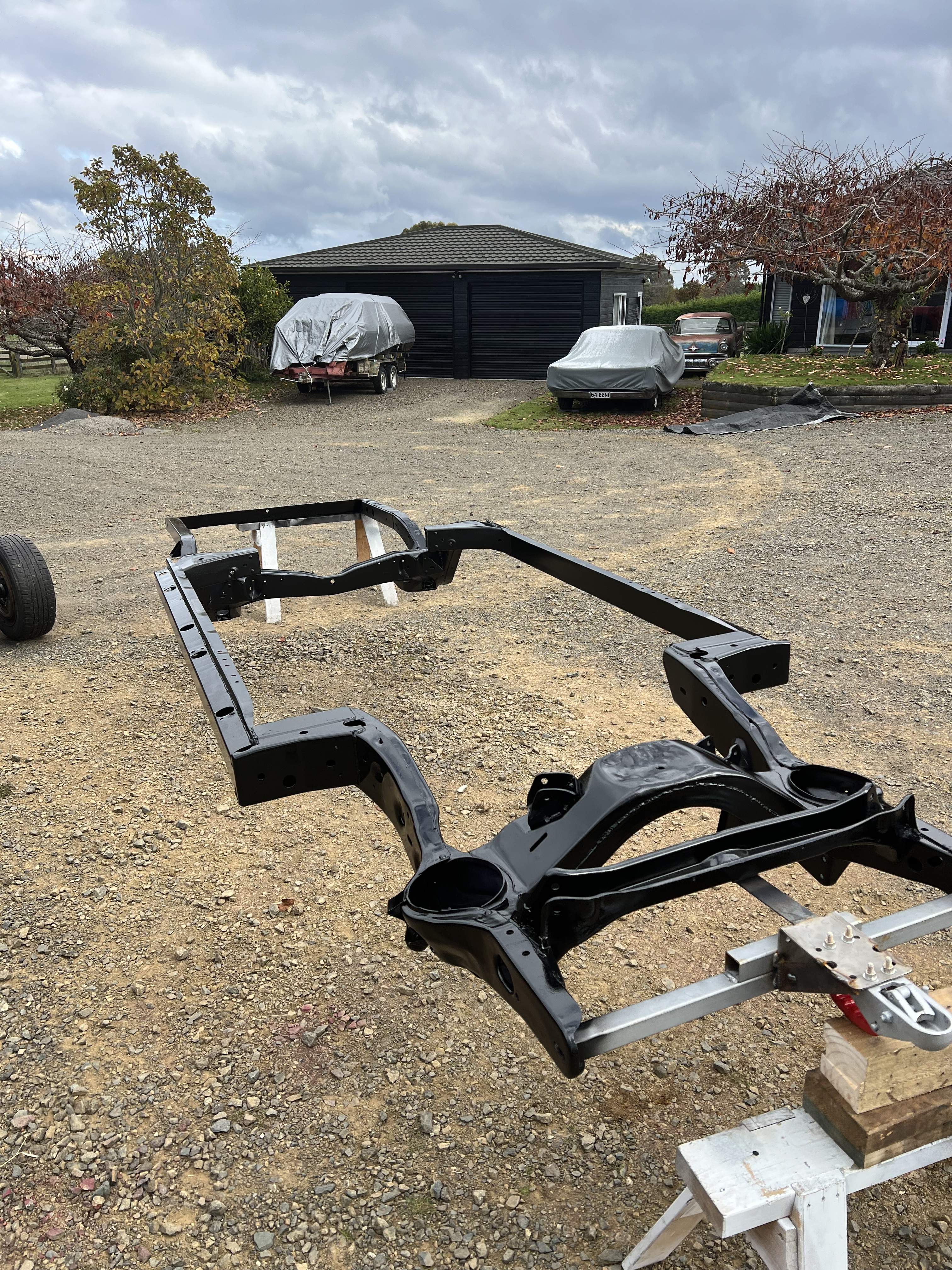

thank you 🙏, I spent all day yesterday and today buffing , sand blasting and generally getting dirty 😜
but it has come up really nice . Better than the 64 frame I recon !
Cant beat enamel paint !!! &nbsp
