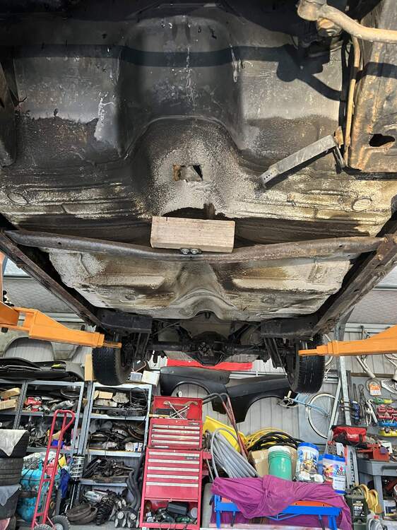

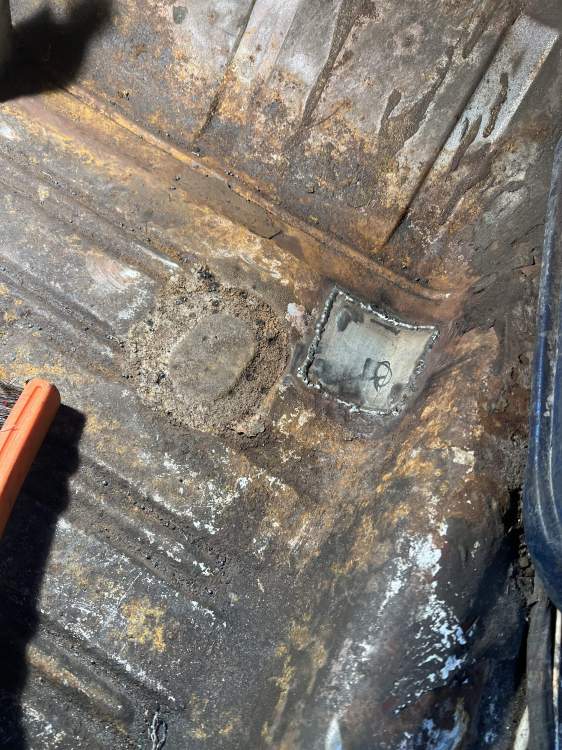

Saturday here in nz is like every other day for months now !!! Rain rain rain . But thankfully it stoped justA long enough to drag the safari into the hoist and get my first real look underside …

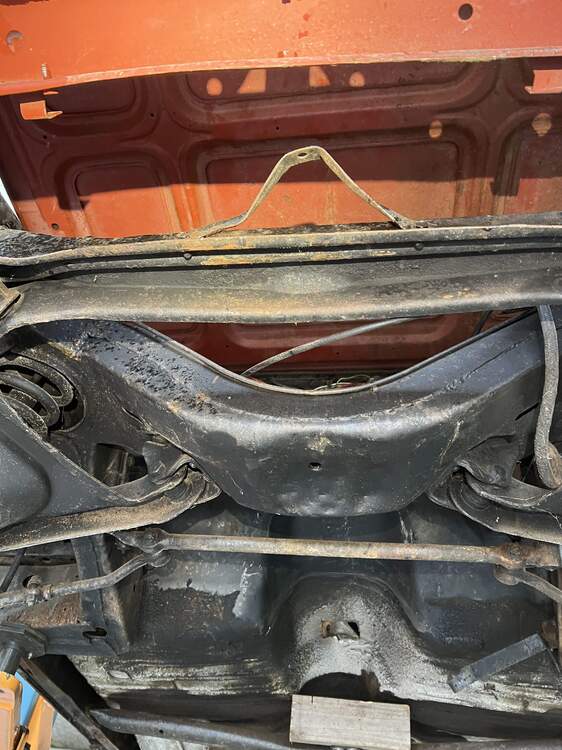

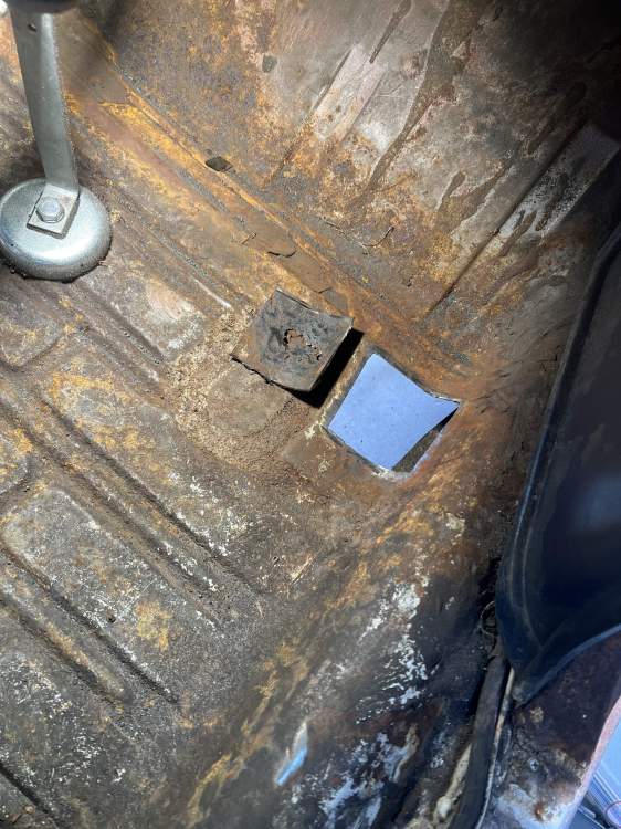

Floors are clean and rust free. So are the sills 👍

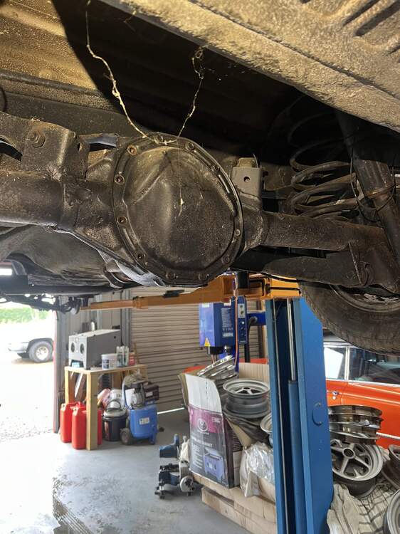

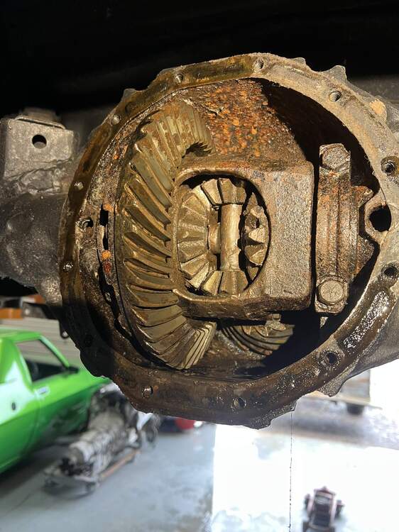

the diff has been replaced with a 12 bolt and I spun 1 wheel and the other turned the same way !!! I am thinking … wtf ? Limited slip or welded spiders ????
so I had to have a look !!!
No oil in there but someone had plastered anti seize over everything …..
This is the stuff I need to decided on what to do with … clearly the 12 bolt needs a refresh , it has no drums, or any of the brake components …. And I am thinking … do I do a refresh of the whole thing, buy a disc adaption kit ….. or !! Sitting out in the paddock is my whole spare 64 diff from the doner car used in my 64 rebuild ?
yes , both are strong units but which one do I blow money on ? This is still a budget build … and I have the boss to answer to for cash flow . :rofl:
the Pontiac diff will bolt straight in …
it will need drums resurfacing new slave cylinders and shoes . But the pumpkin is in good order and won’t need touching yet !
Having said that . 12 bolt stuff is readily available here and shouldn’t  be to expensive, and certainly would future proof any change of gears that I may or may not need to do when sorting the ls and trans combo ……:dancingpontiac:

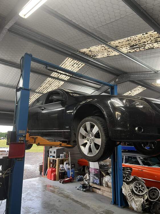

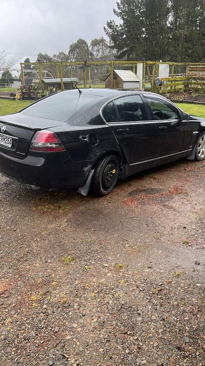

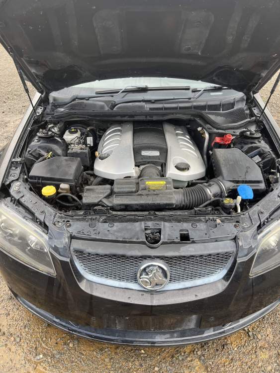

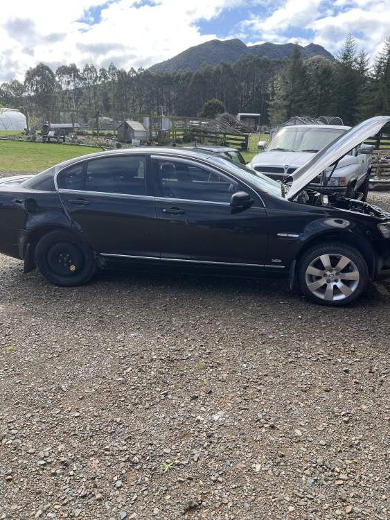

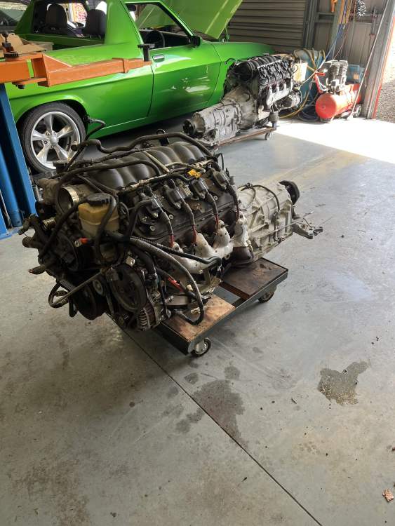

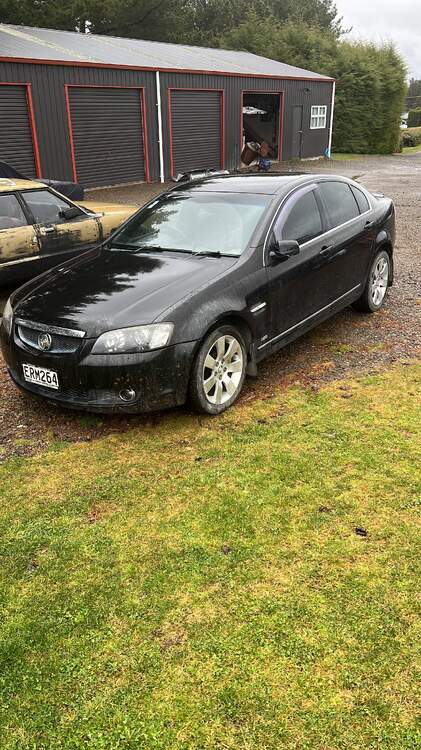

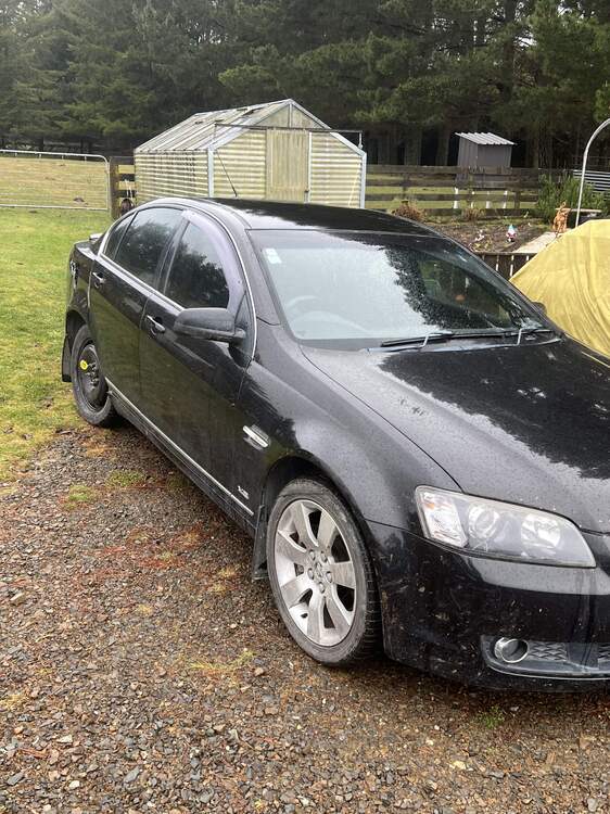

i have bought a donor car for its motor and trans to go into the 63!!!:cheers:its a 2008 ve holden calais with the ls2 L98 6.0 litre engine 6L80e 6 speed auto trans
its done 108000kms that about 60k miles
think this is the same as your guys G8 ?

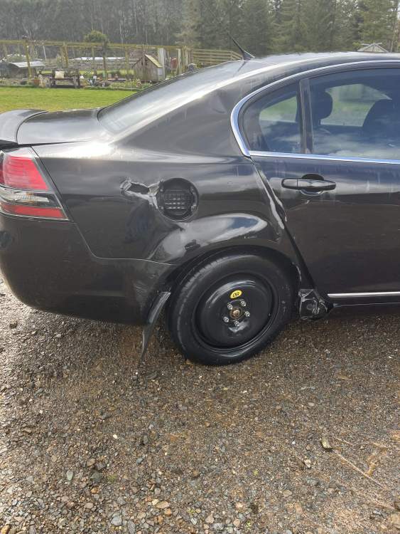

justA has a little scratch by the gas cap !!!!:rofl:

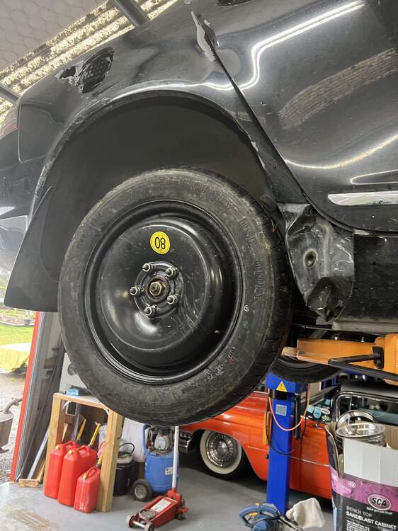

so i put it on the hoist and pushed the rear suspension back so it could at  least steer in sort of a straight line ! :rofl:
you can see the damage in front of the tire, this was enough for it to be a write off.. win for me!!:cheers:

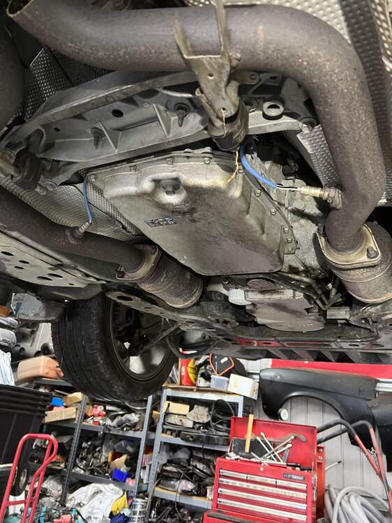

this car has the 6L80e auto trans !!! 6 cogs woop woop ... and yes, i will need to modify the trans tunnel in the 63 as it will not fit ! these transmissions are wayyyy taller
 This was a very cheap score and will make a perfect engine and box to go into the wagon ! plus all the little extras that you get to rip off it, battery, tires, fans radiator seats,brake master cylinder and booster

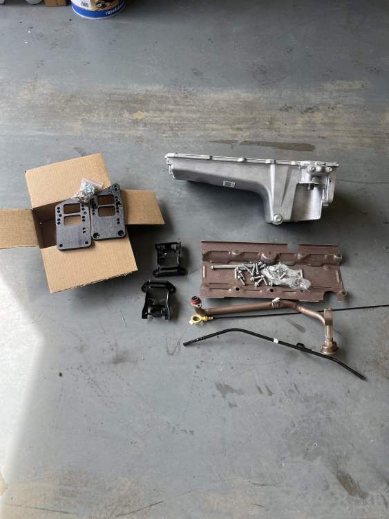

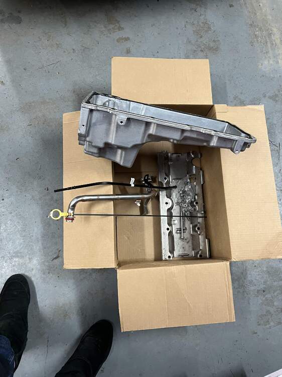

my ls rear sump kit …..the little labels on the dip stick and pick up  state... "made in canada with imported parts" :dancingpontiac:thank god for that !!! i thought they came from china :rofl:

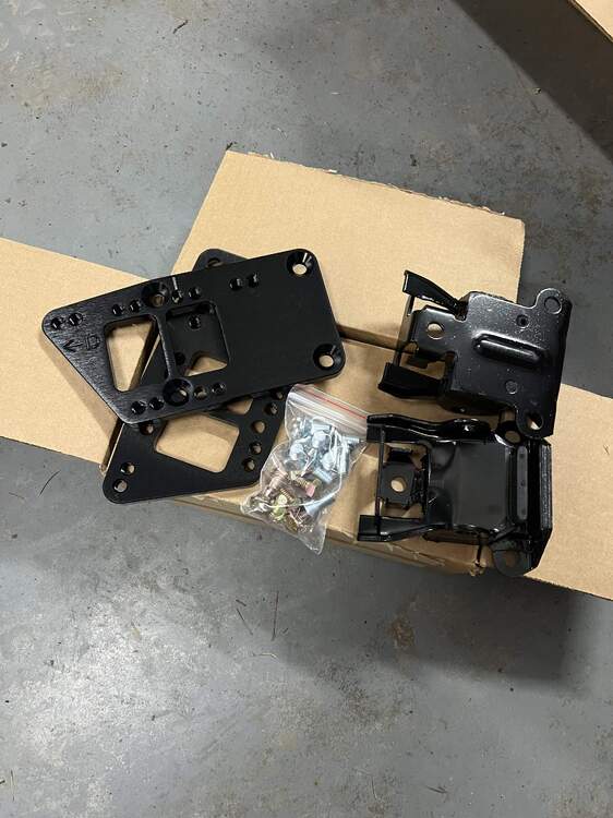

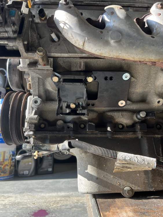

And engine mounts … which includes an adjustable ls to Chev plate then stock Chevy engine mounts … someone had already made mounts on the crossmember in the 63 as she used to have a big block in there 👍
for anyone reading this and thinking of using a LS into a widetracker, you are going to have to buy these parts , justA starter! i am sure i am going to find i need more parts, and since this is my first LS into a car, its gona be fun ! i am sure nothing will fit or work, but i am sure the end result will make for a wayyy better cruiser :dancingpontiac:
i do know i am going to have to find a alternator bracket kit to relocate it up from under to the passenger side... have not found a kit yet, and really if i dont.... i will make a bracket.

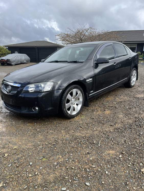

After a long break doing assorts of other crap ! I am finally finding time to get back to real work !!!

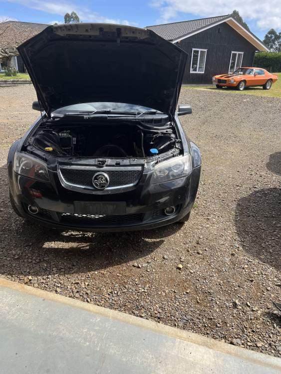

A while back I bought this ve Holden Calais … you could call it a G8 Pontiac
it has a ls2 l98 engine and 6l80e trans

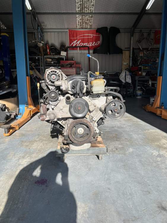

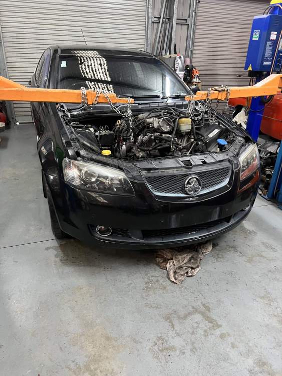

Today I got to and started pulling the engine and trans out ,,,,, this will be the new power Train for the 63 :dancingpontiac:
It has done 67000 miles and a great swap for the wagon !
it was a write off thanks to this little scratch !!!!
And I got it nearly out before we had guest turn up !!!!!!
Guests...friends...just nuisances most of the time, until you need their help. I like your idea of using the hoist as an engine crane.

Worked a treat mate :cheers:
I didn’t mind the guest , was time to stop and have a beer any who 😜
now one dead Holden for sale on trade me. With a dollar reserve ….. after I rob a few more parts that maybe handy !!!

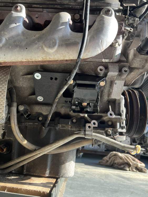

In preparation, I bought a rear sump kit and engine mount adaption kit , the 63 already has side mounts welded in as it had a Chev big block in it …
This sump should clear the cross member in the Ponti

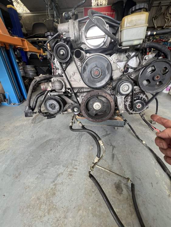

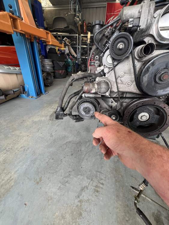

The next issue will be to relocate the alternator from drivers side low to passenger side high
Anyone reading this that has done this swap ?????? Let me know what kit you used :dancingpontiac:

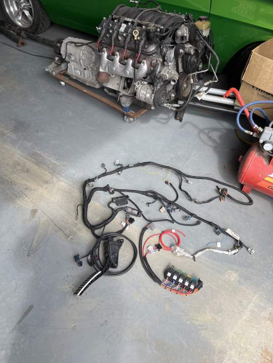

So for today I need to remove the engine loom and send it to my mate in Hamilton to make it look like this one that he did for me of the 57’s engine

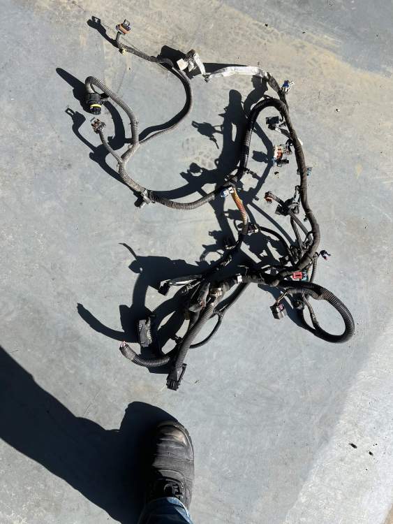

Off with the stock messy loom!!!

With air con pump off and alternator sitting where I think it needs to mount , I think  the motor will fit into the 63 frame !
Couldn’t help myself I had to fit the mount adaptors and wish full thinking it has 4 options I went for engine fully back ! Let’s see if that dream works with fire wall clearance !!!! :rofl:
