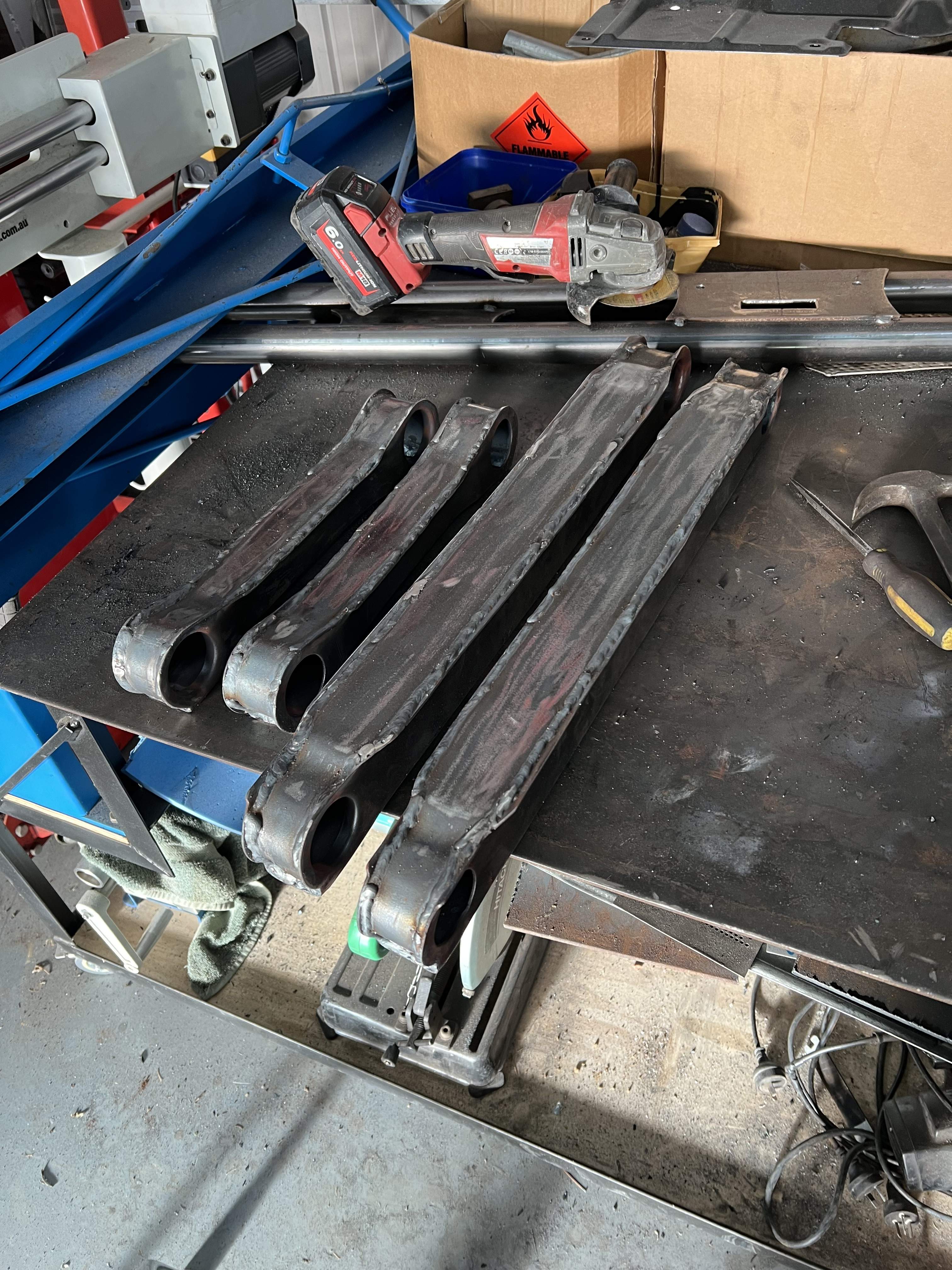

Do you plan to run a rear sway bar? Then you definitely want to do this to the lower arms.
I would box the uppers as well to get the torsional ,strength for handling purposes.

You know what Frosty , i watched about 5 mins of this guy and said to myself .... nooooooooooo ! :rofl:

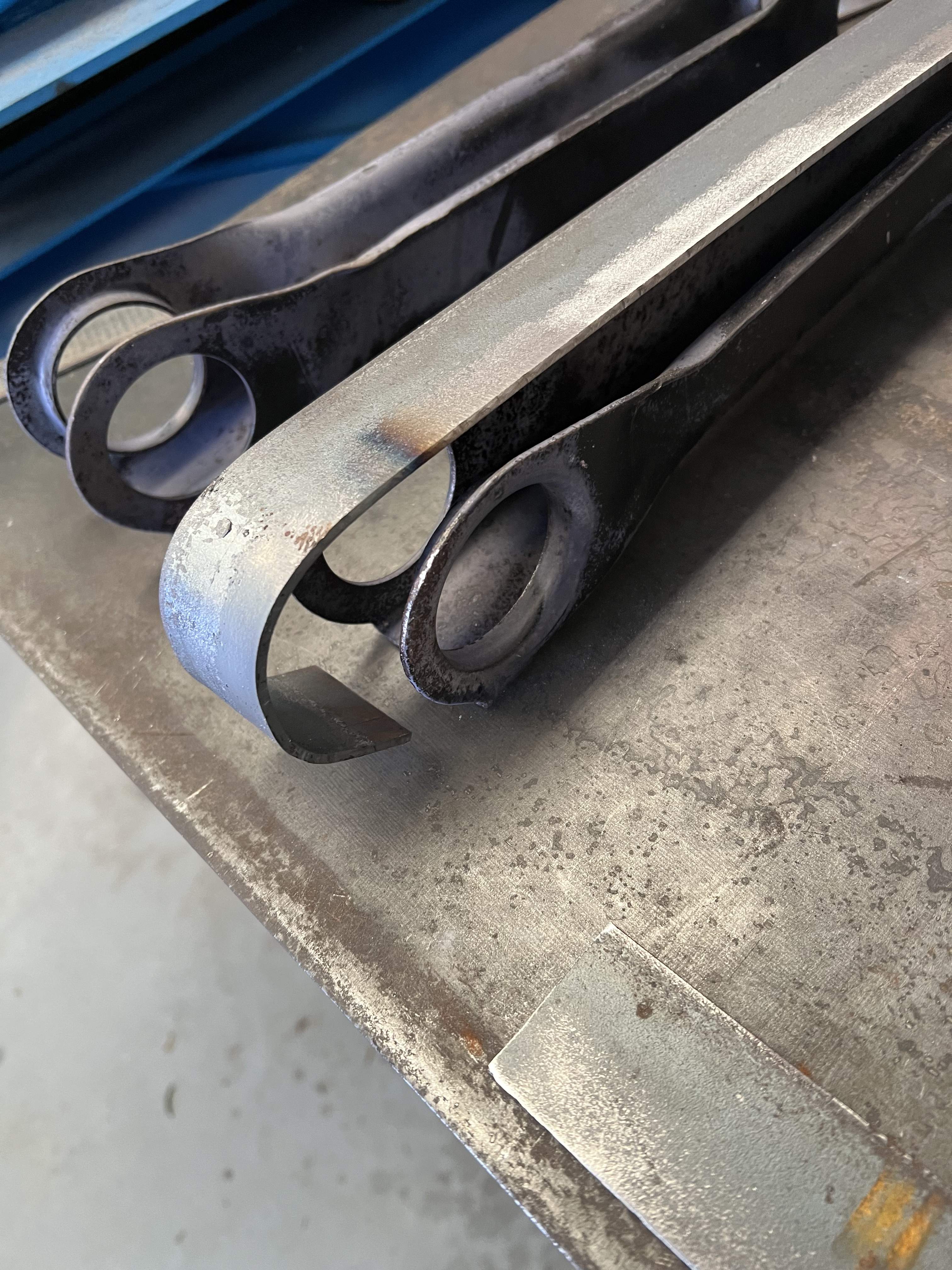

after you suggested boxing the arms to me , i thought about where do the arms need extra strenght ? middle , yeah
But i think each end around the bushing is the more important part.
as you can see these arms dont have  alot of meat around the bushing,
yes its a poor mans fix, a tube with bushes on each end will always be stronger than a box.
soo i do like your idea, i will box them , but ... i will do it kiwi style :naughty:
Glad you suggested it before i painted them that pretty black i did on the frame and diff :cheers: never even though about it !

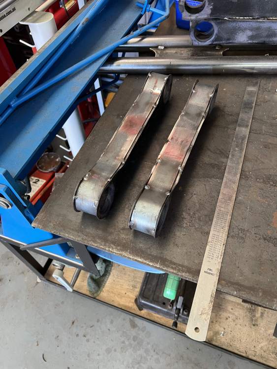

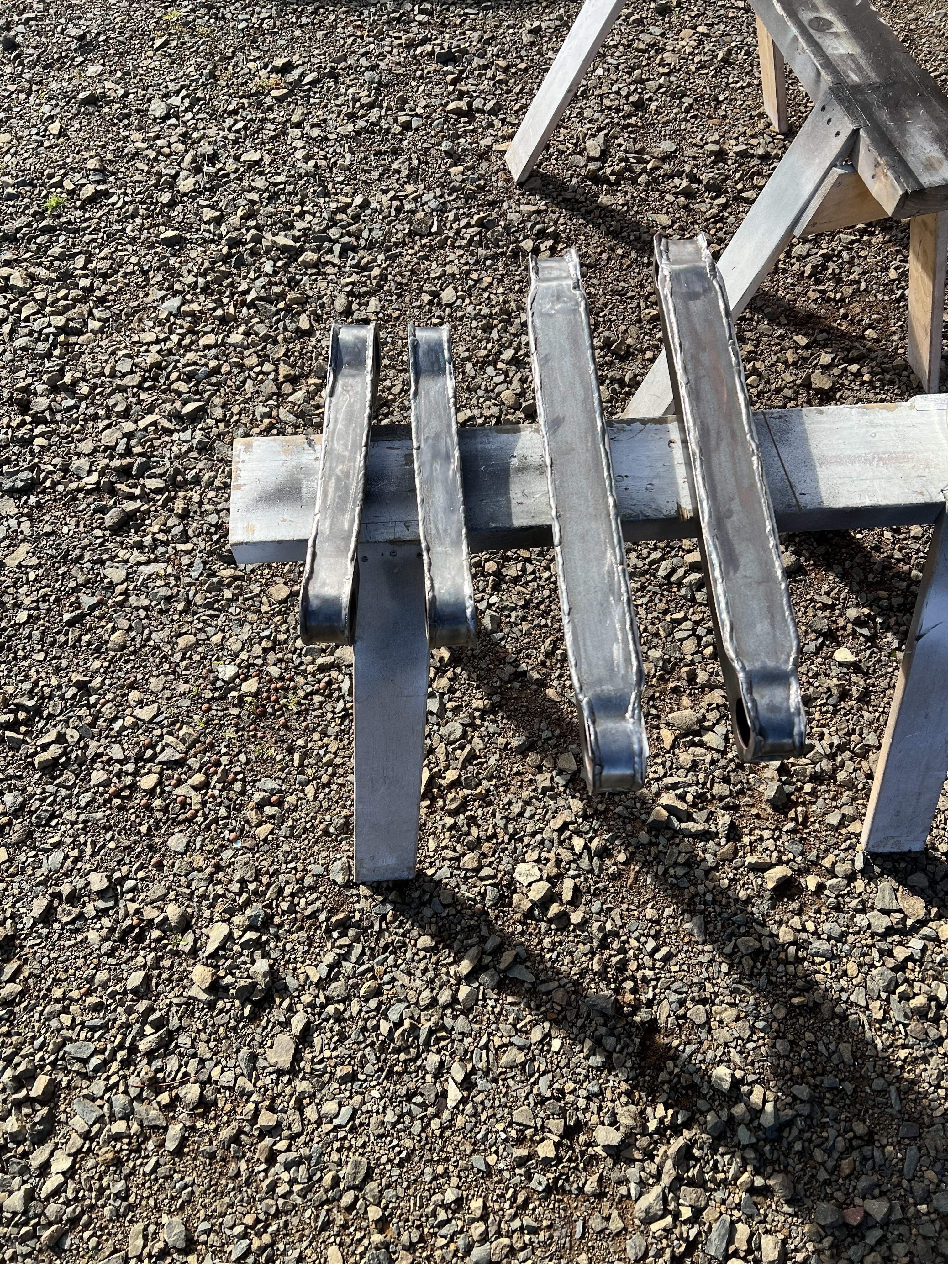

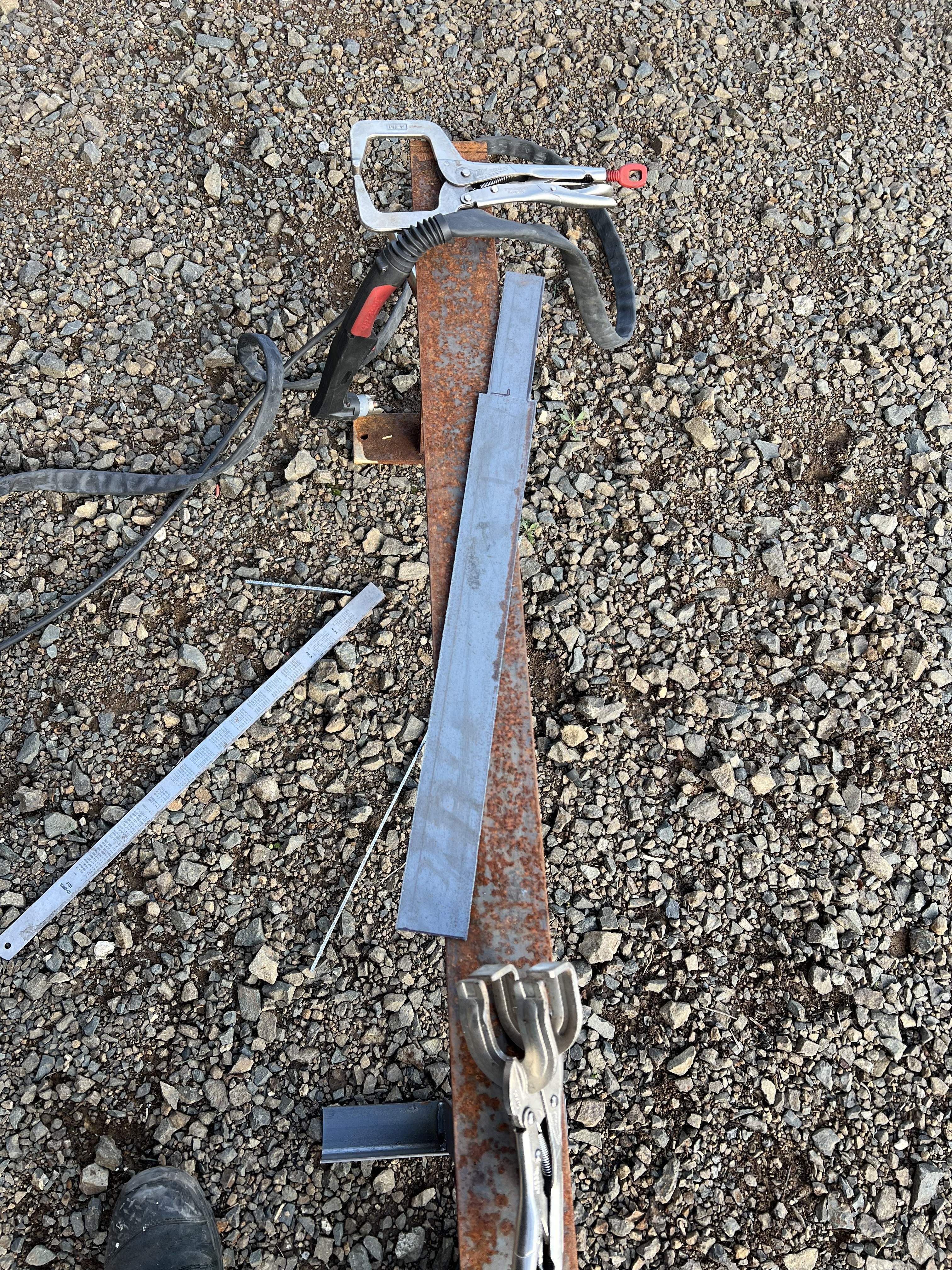

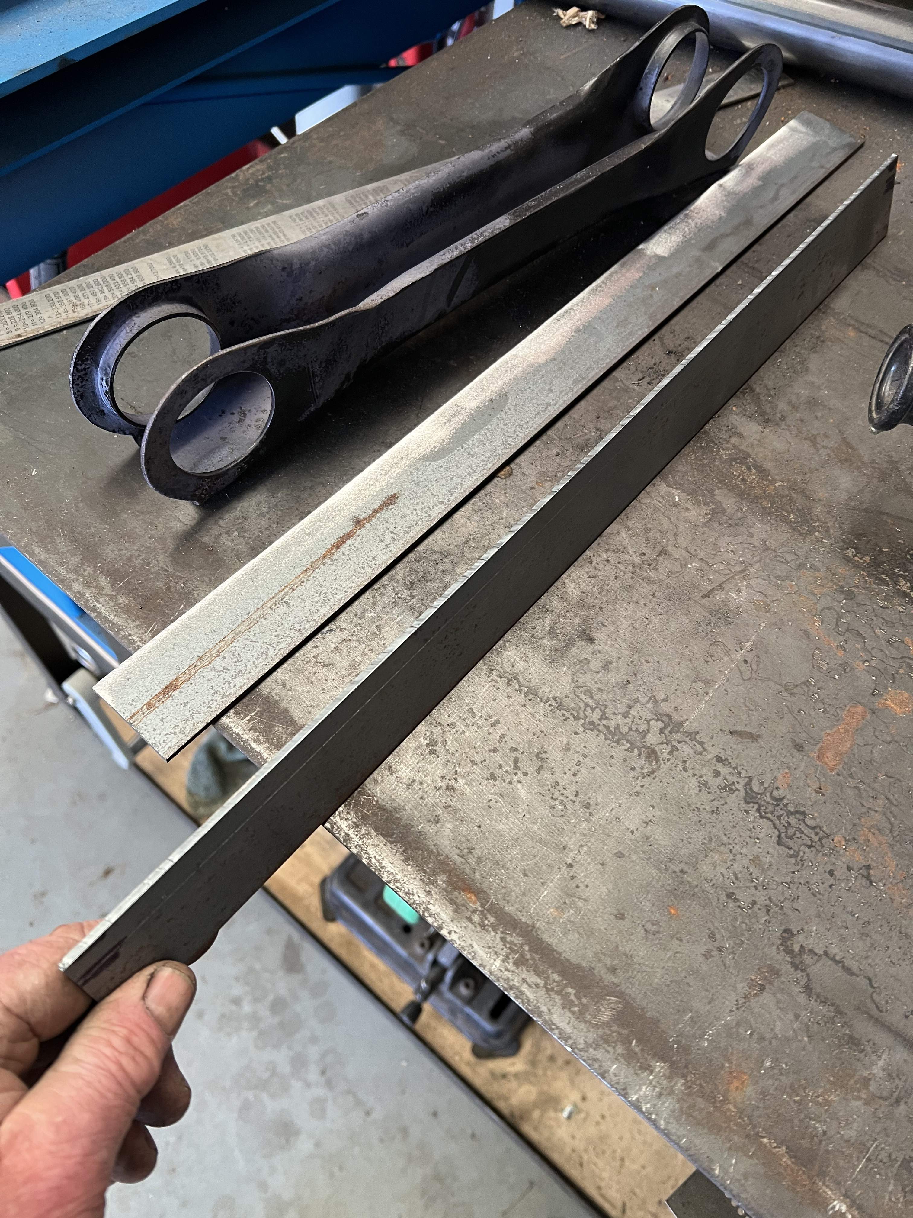

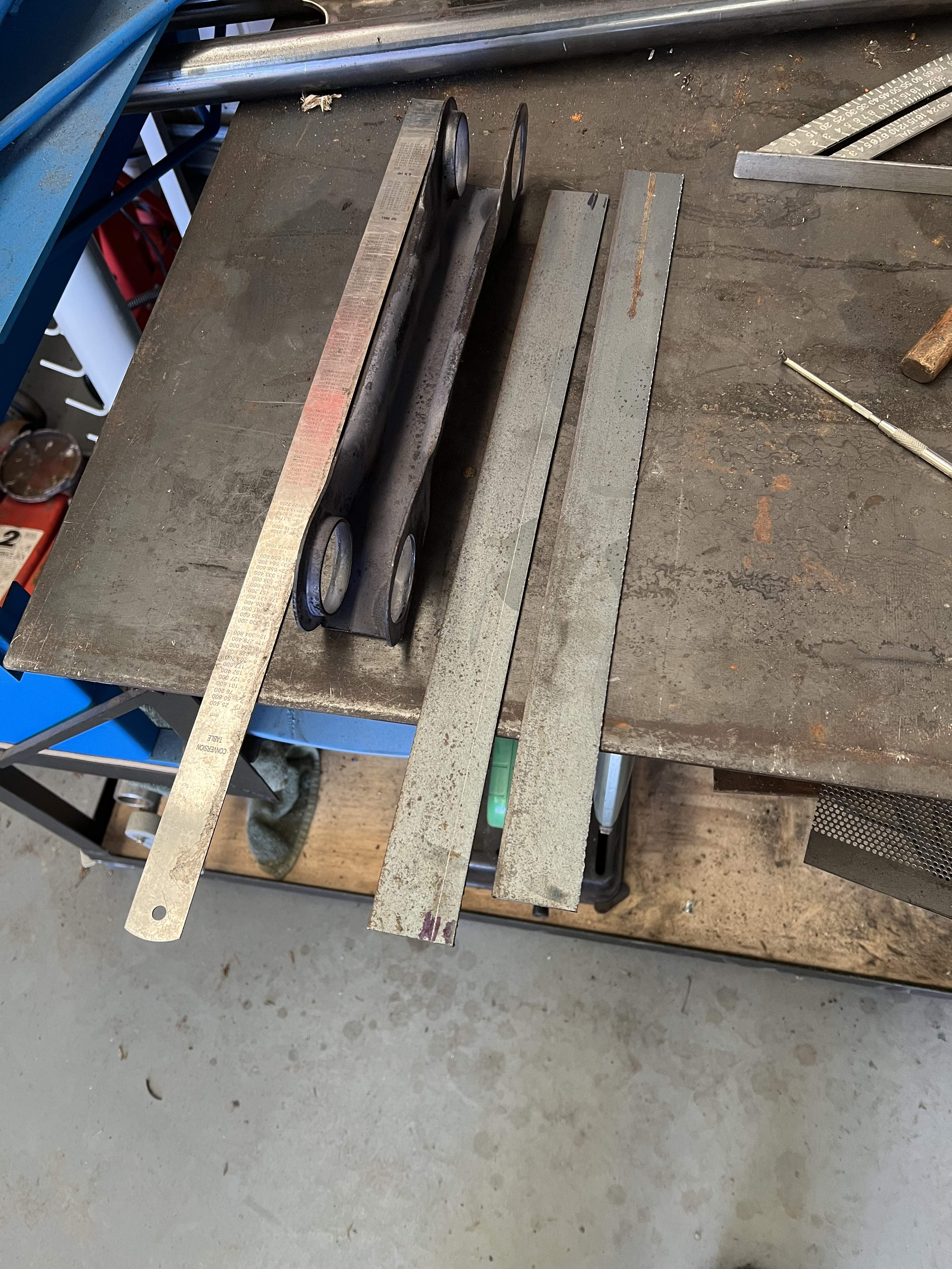

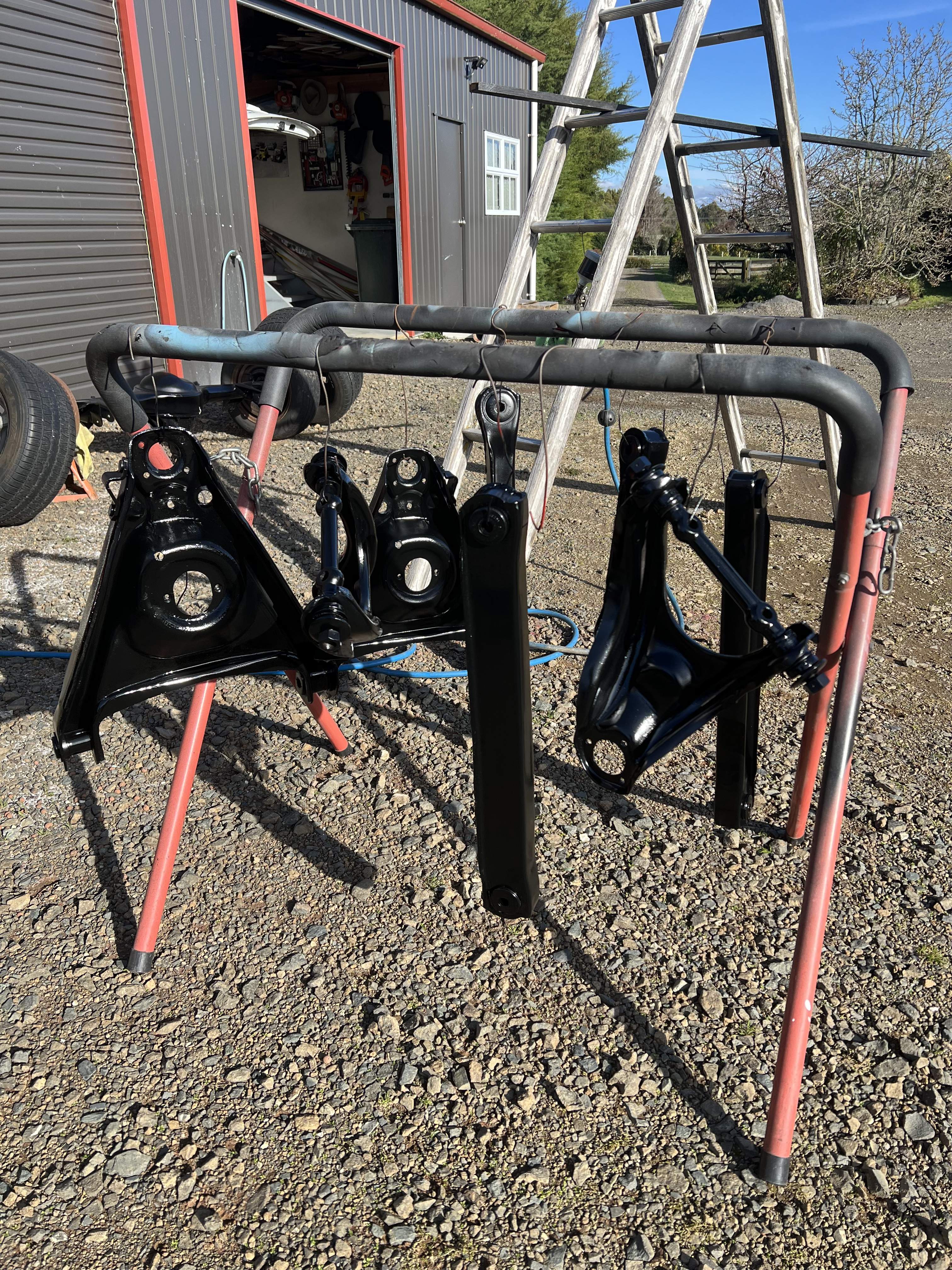

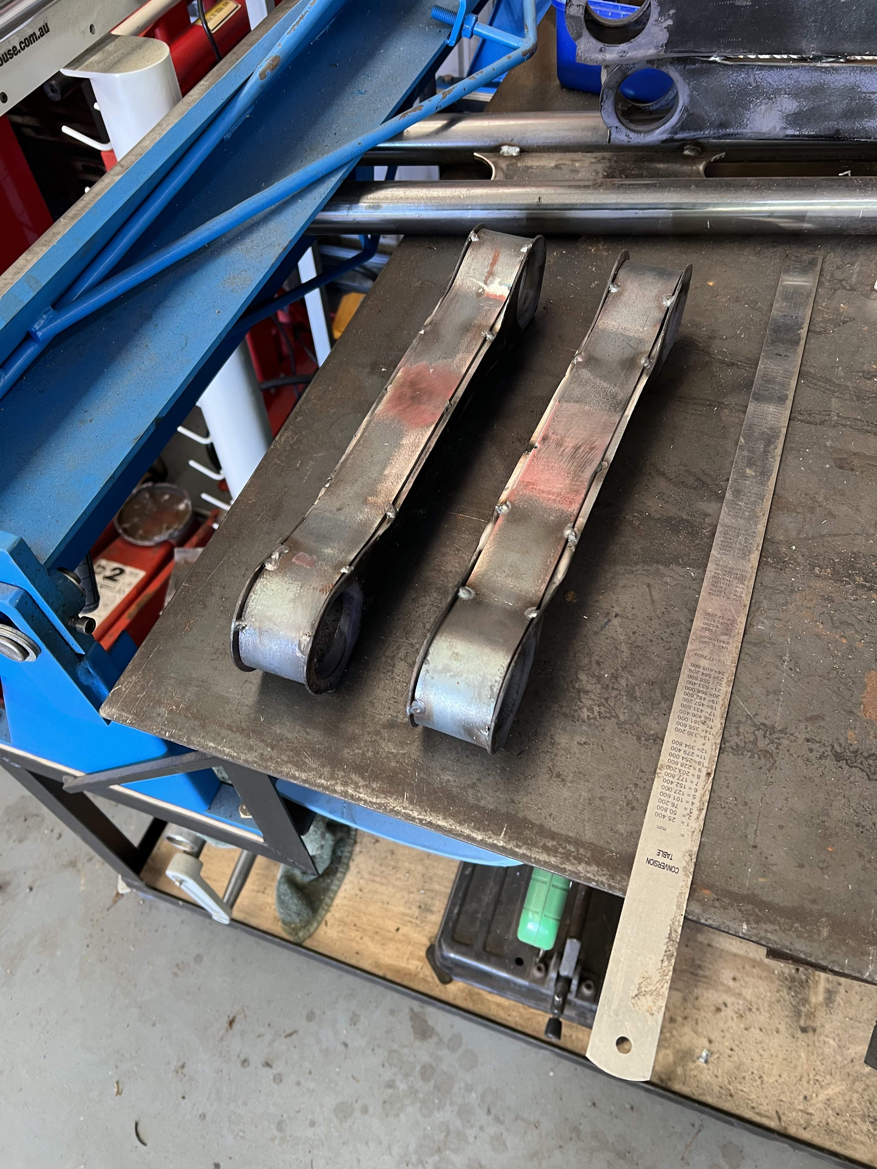

Boxes the four rear trailing arms … thanks frosty ! I really had  not thought about it
but having the ls engine will certainly push things around so boxing them will help …
my 2 favourite tools … my plasma for nice clean cuts ….

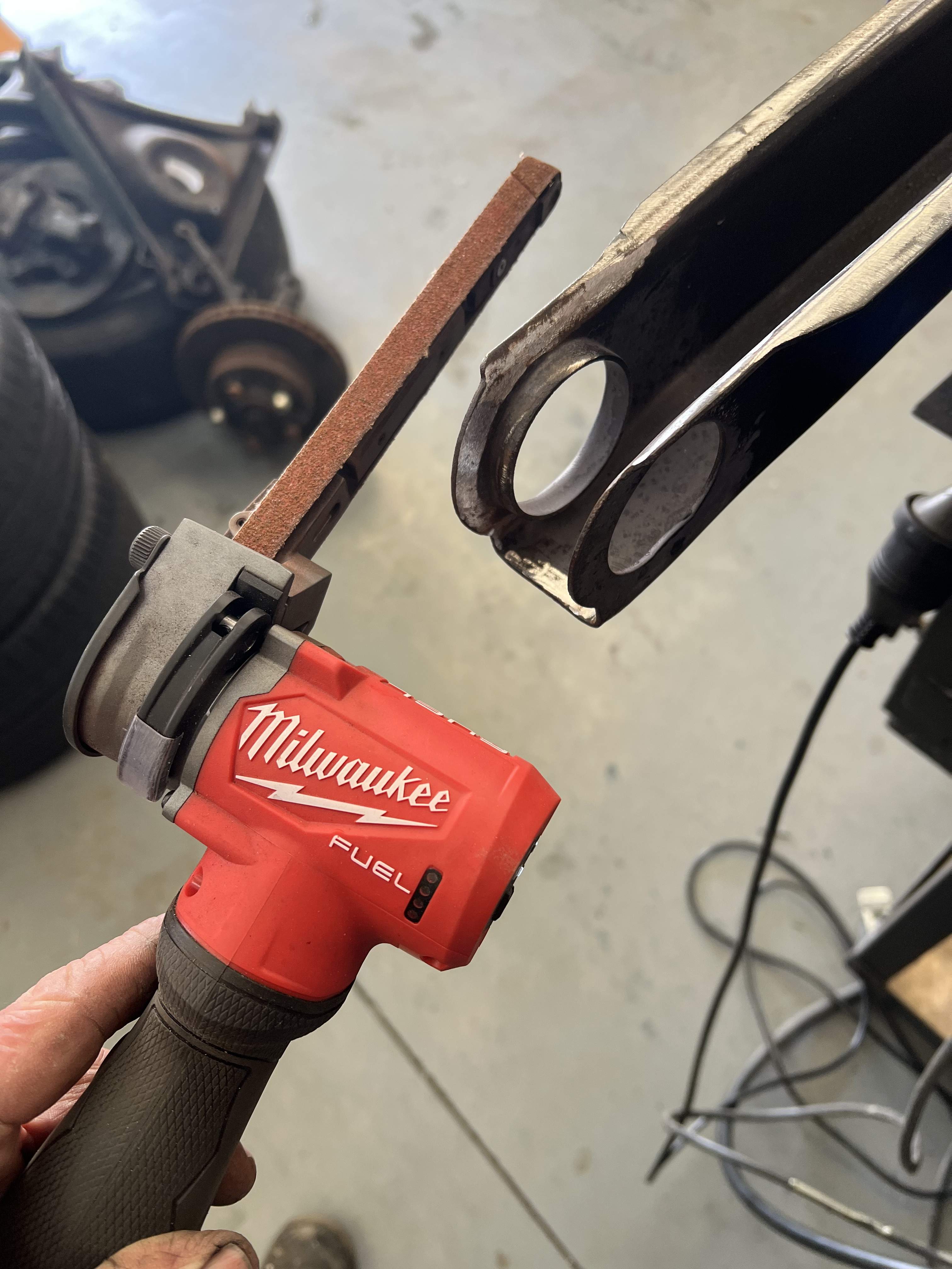

and the new addition to my red team ! The Milwaukee detail sander !!! Worth its weight in gold!
3mm flat stock cut with the plasma to fit
then shaped so they fully incase the arms
Tacked them fully welded

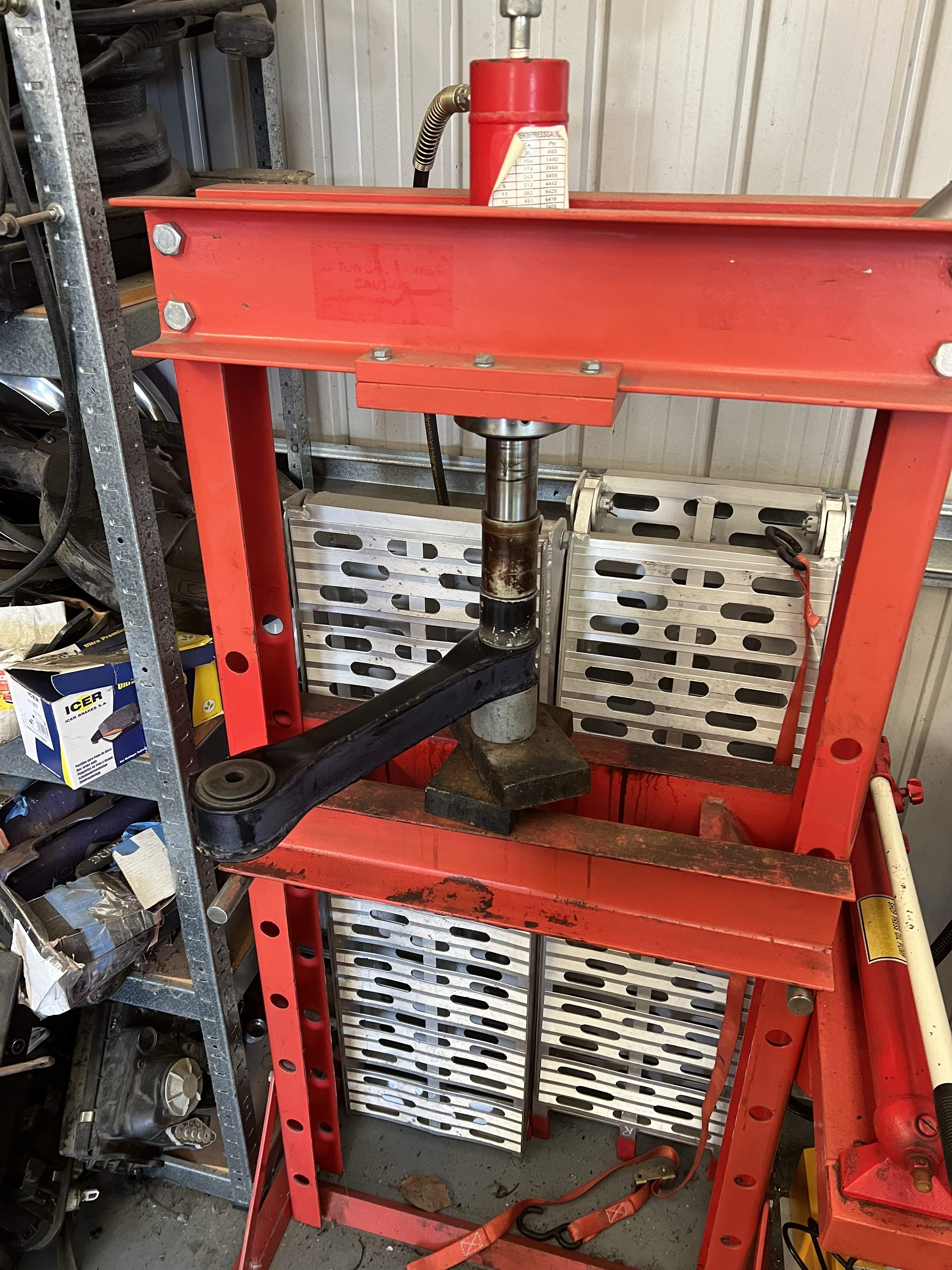

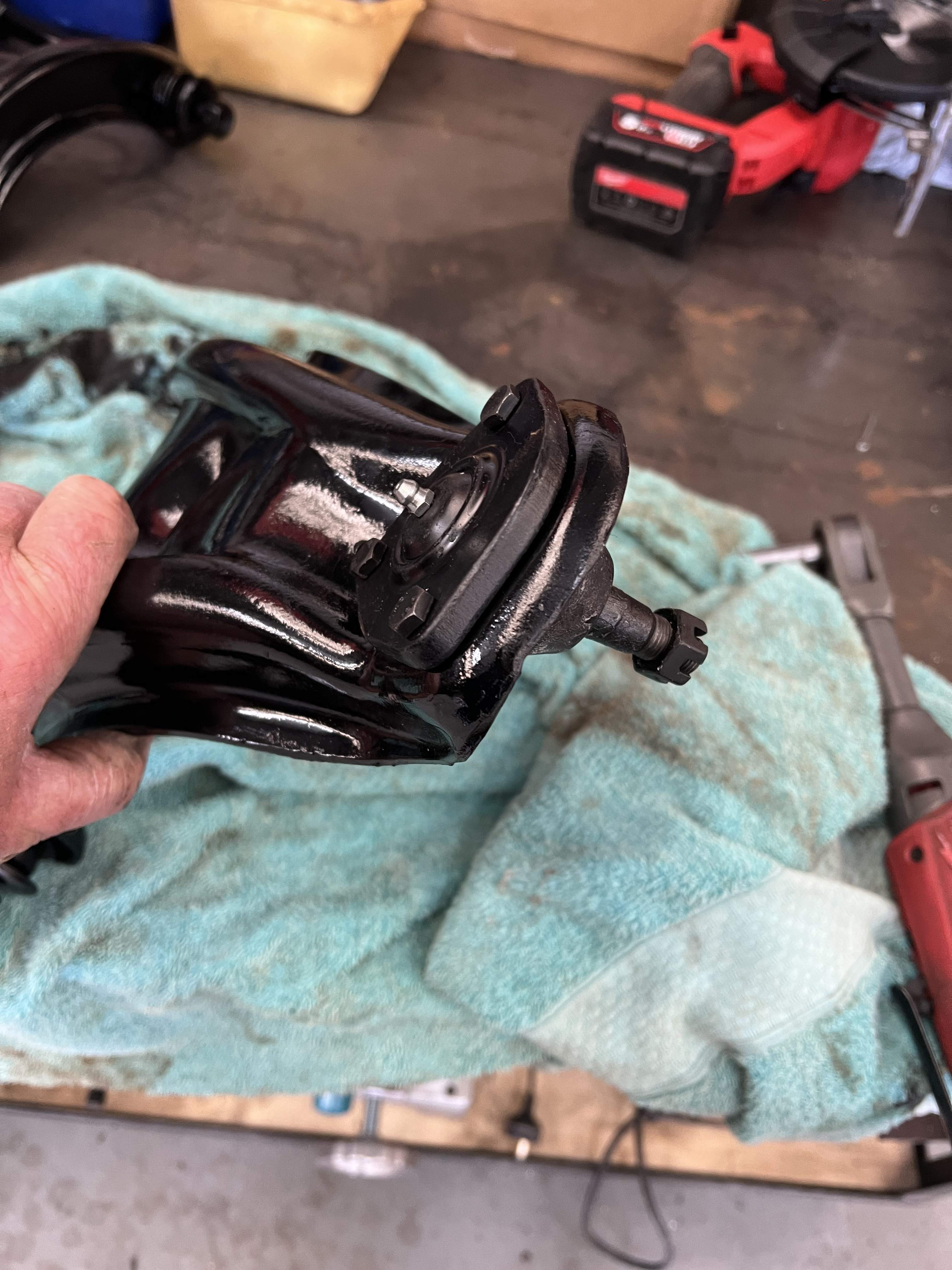

Cleaned up the front control arms
press ed in all new bushings
And painted the lot
But not without a stuff  up !!!

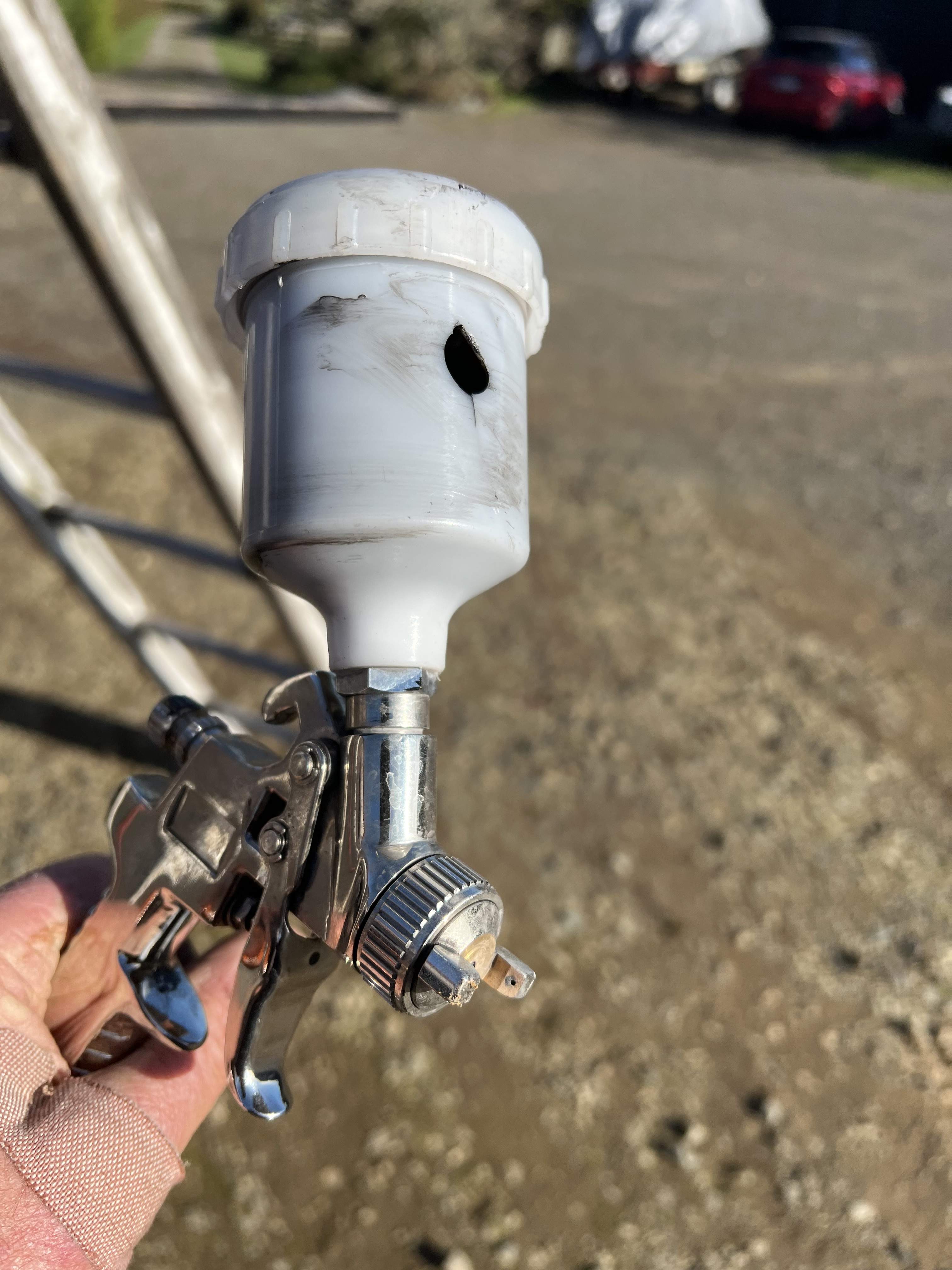

I have this fantastic little gravity spray gun with a really nice spray pattern that I have owned for a few years now and while painting out side today I dropped the bloody thing !!!
It landed in such a way a stone punched a hole clean through the side !!!
my firsts words where 🤬followed by wtf do I do ???? I had only justA started top coat !!! So I taped the cup up and kept going !!!
I cant find a replacement cup for this gun so I am thinking like justA !!!! J b weld the sucker !!!
And painted the lot
Never seen em boxed like that that before, NICE JOB!

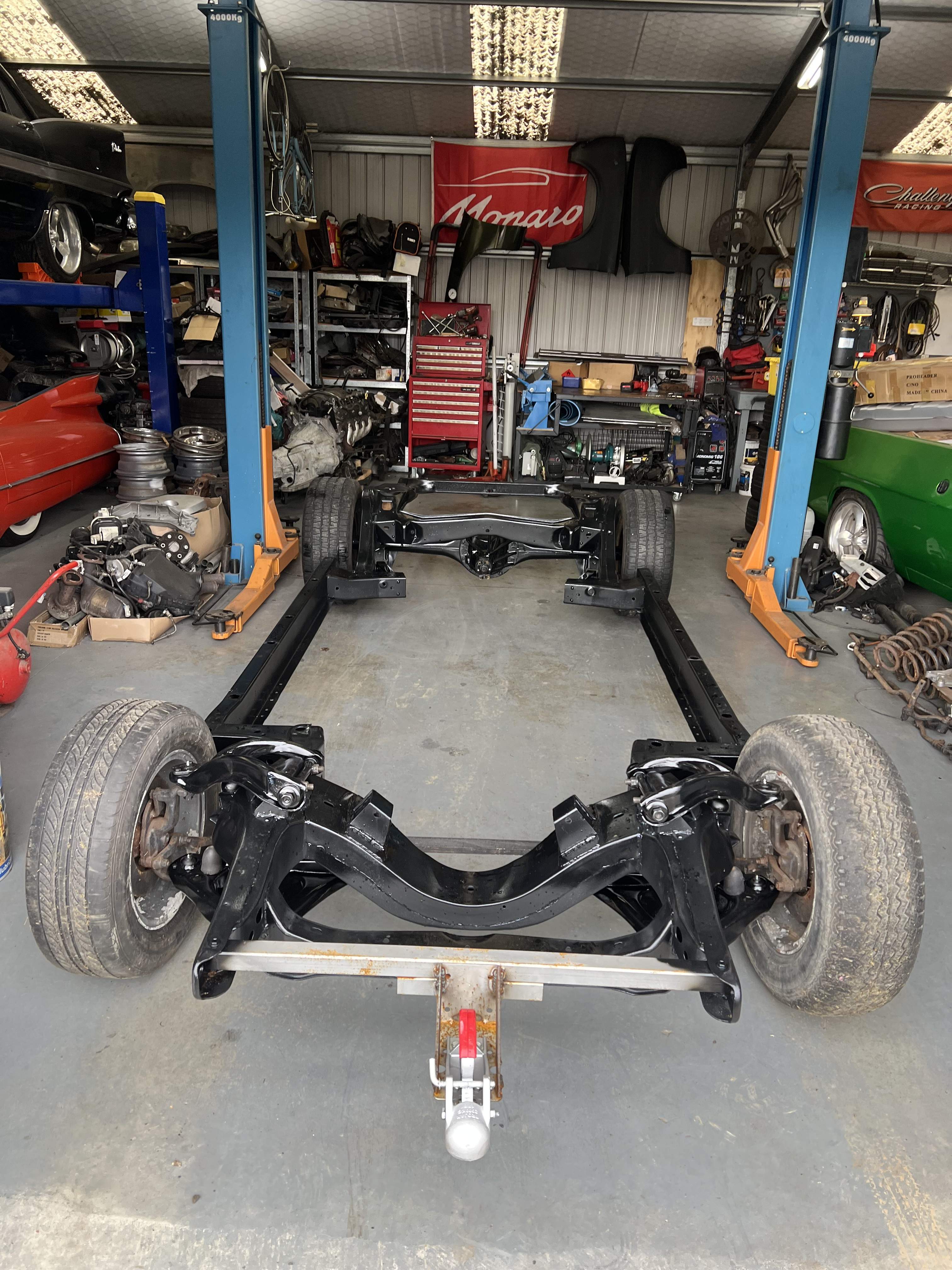

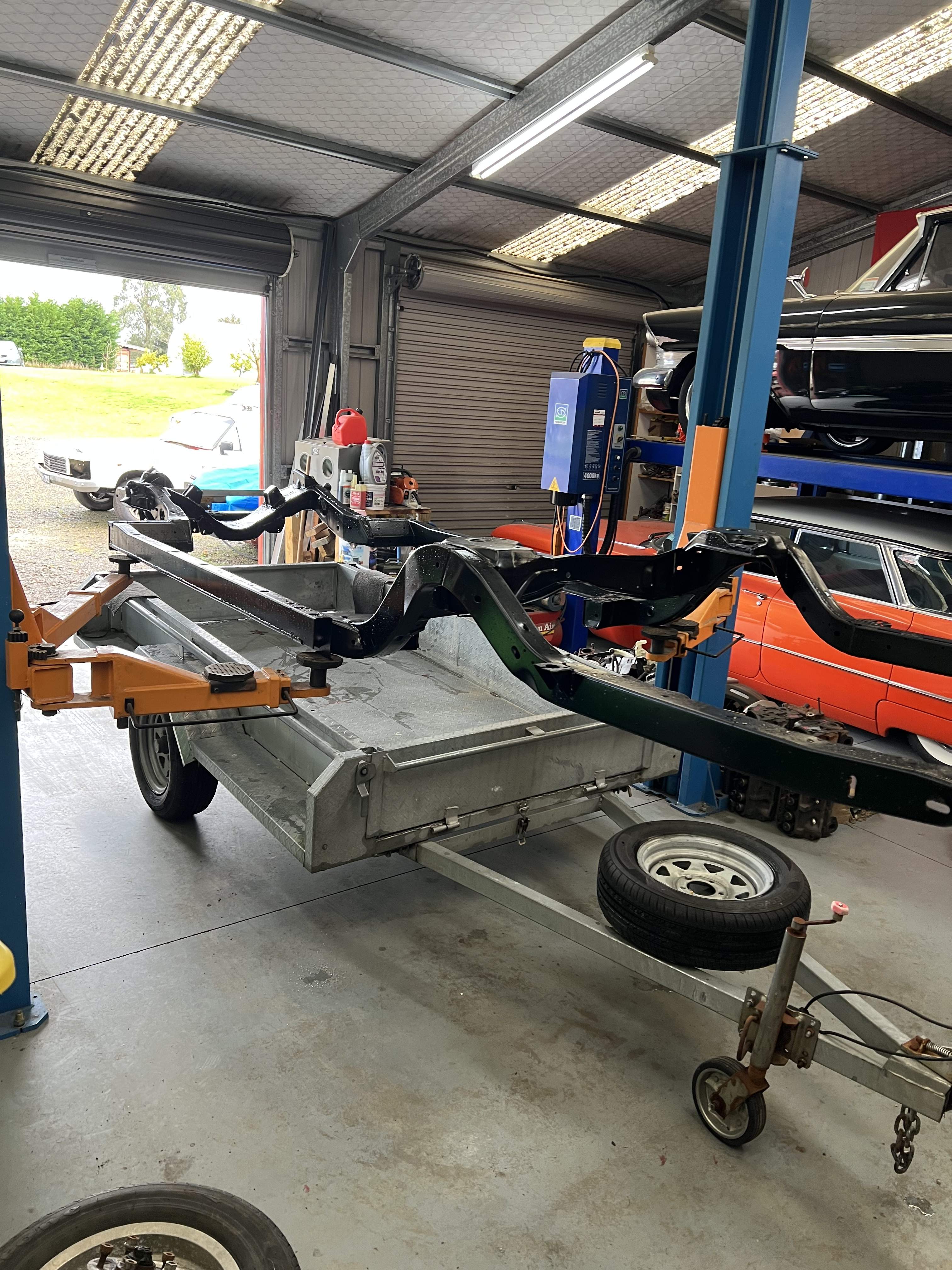

This is my last weekend on the 63 for a little while ( watch for a reason why soon ! )

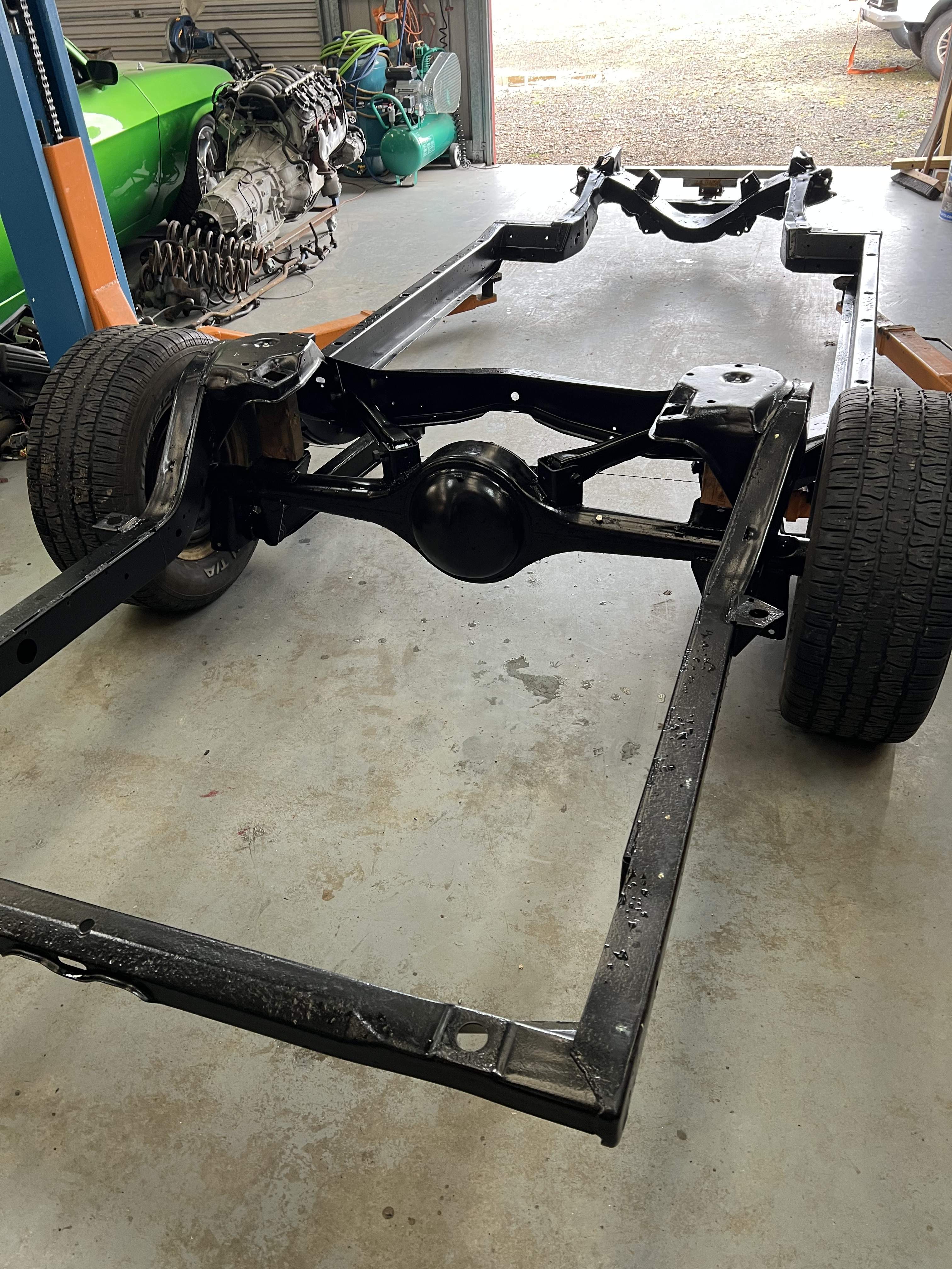

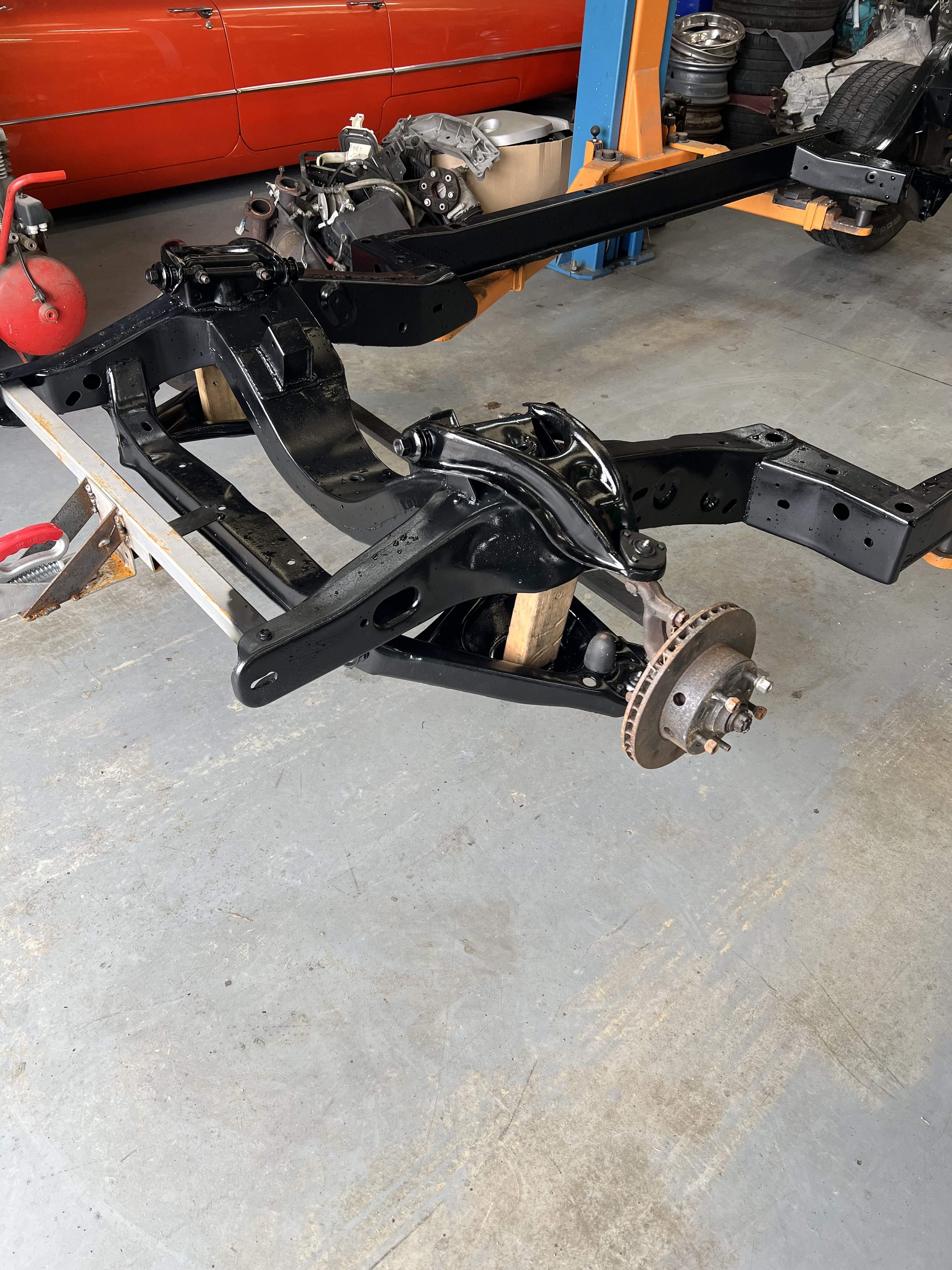

so i wanted to get her on her wheels !!!
frame in and onto the hoist .......... you will note that the bfg's that are holding up the rear are off my 72 camaro... they are 20 years old... not a crack or blemish , but i decided it was safer to replace them... the old black round things are now justA hold up tires now ....... why does that feel like my life ? ...... yeah yah fitzy... i should have smoked them!!!
rolled the diff in under and hooked up
new ball joints in to match with all the new bushings
front end parts justA loosly installed so i could get wheels back on . the sutb axles need to be striped down and ready for the brake upgrade which i am going to get from auto city, but thats a couple of months away. and i have heaps i can do before then, all the plumbing needs to be made and installed for the brakes and fuel.
shes a roller !!!

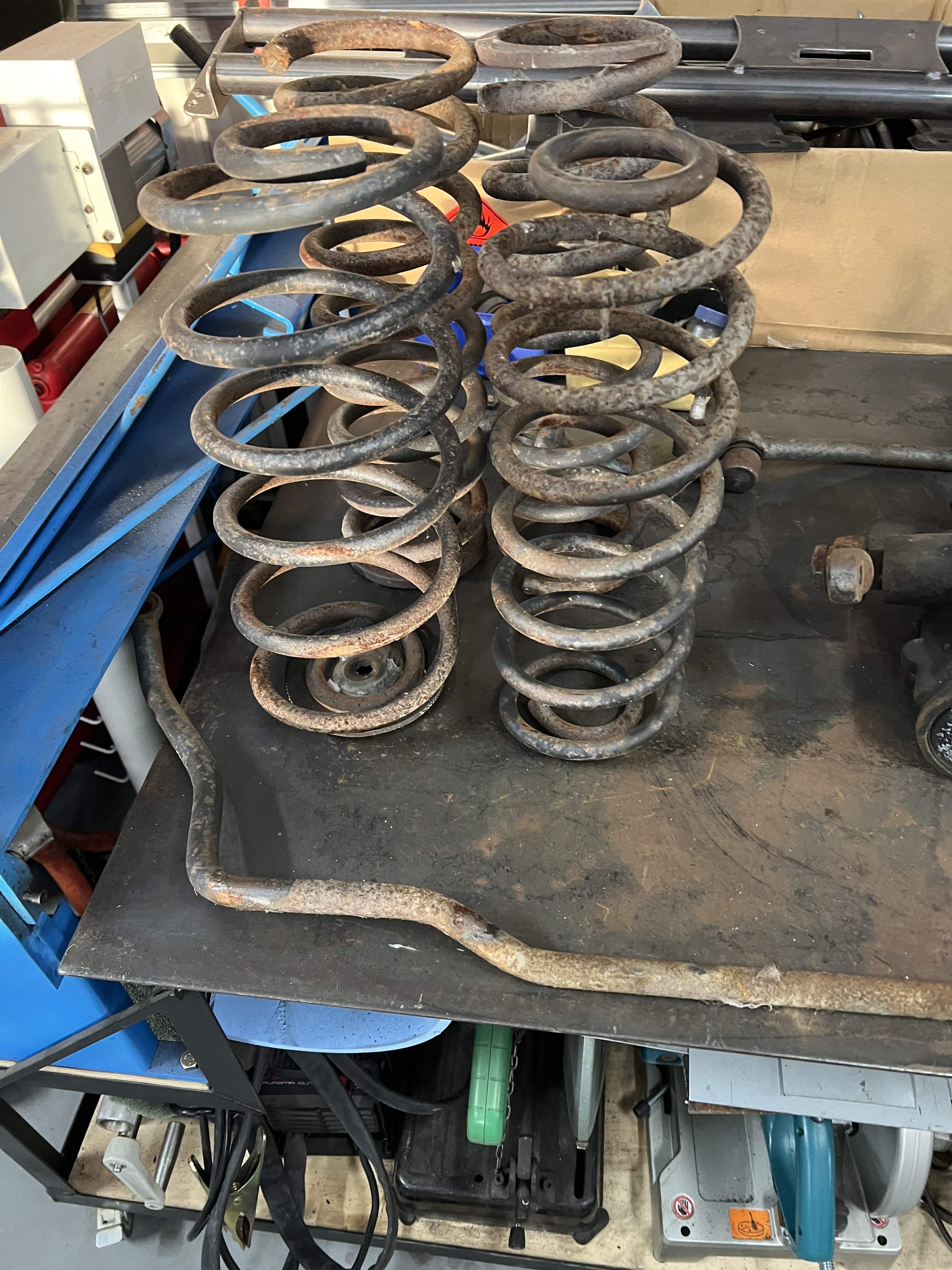

Springs will head to archers auto spring shop in Rotorua to be retempered and set 30mm lower
The front sway bar will also go to the archers auto spring shop to be used as a pattern to make a 25mm version like I did on my 64 bonni ( currently only 20mm -3/4 )
And this will justA make the whole car that much tighter in the corners 🍻

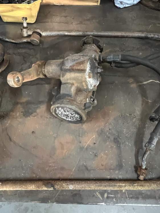

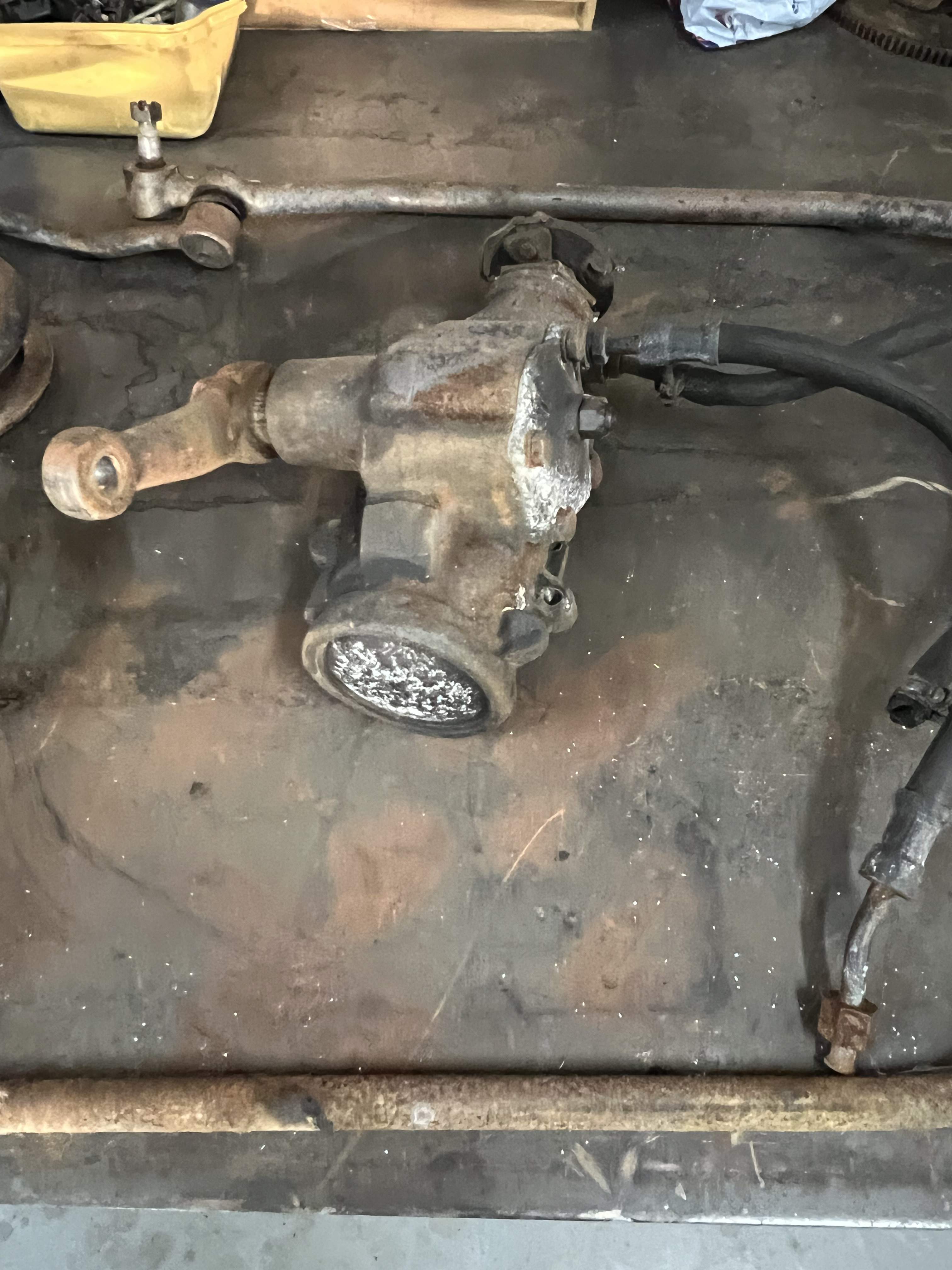

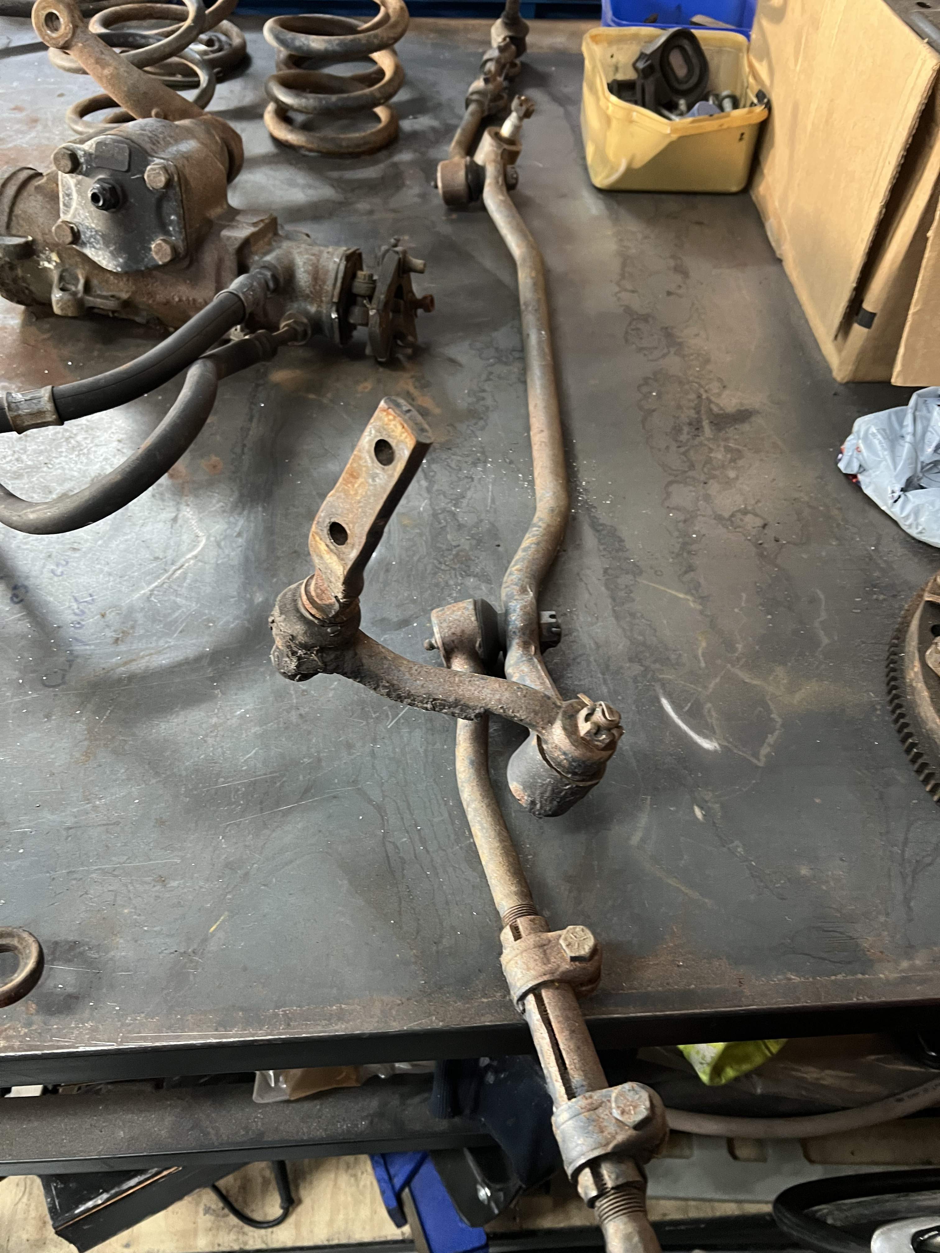

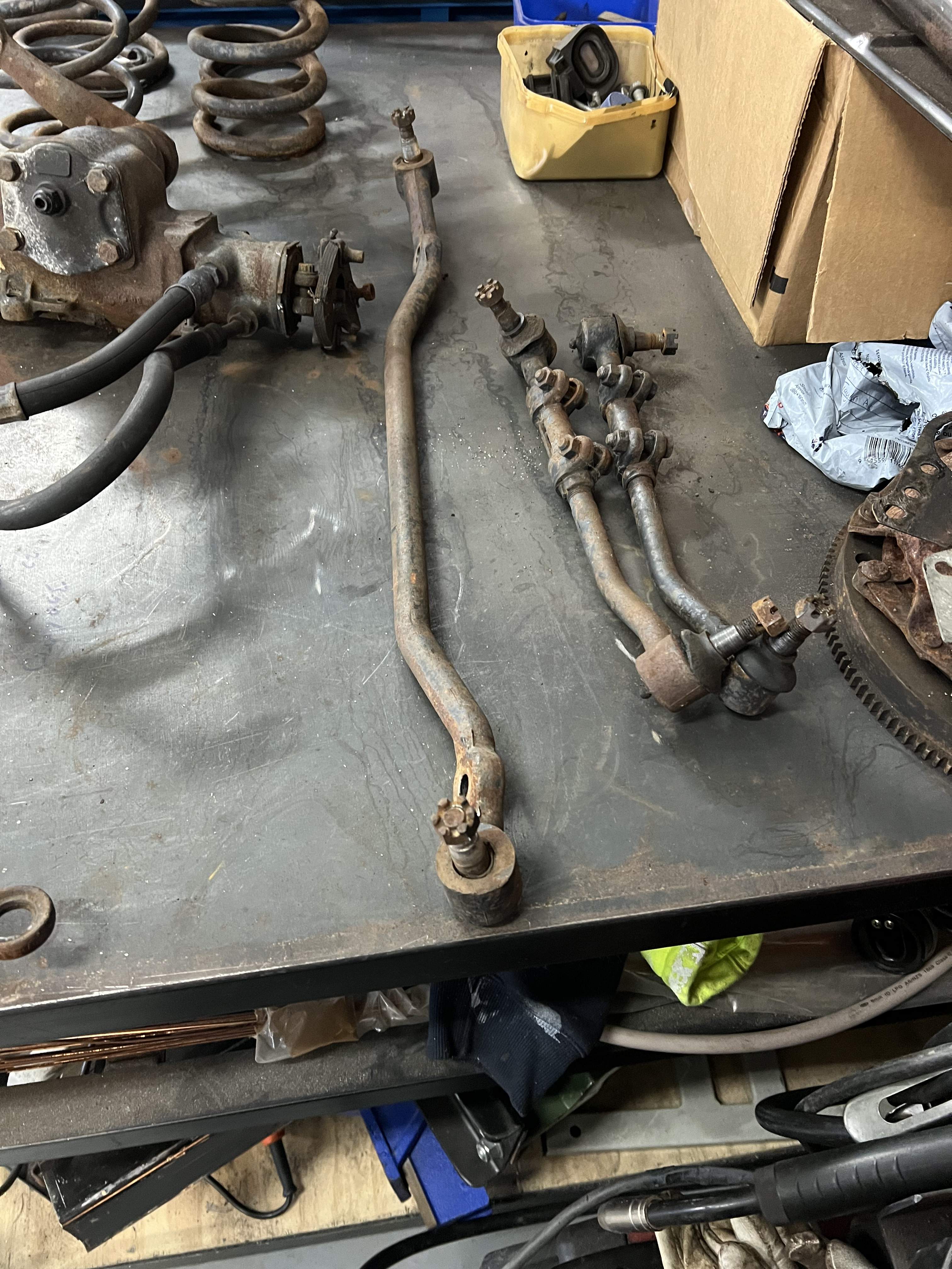

The Saginaw will be sent to pg hydraulics in Auckland as they will be doing a upgrade to the ratio and a rebuild, nothing worse than steering a ship when you can go to a awayyy quicker ratio !... but no change out of a k to do this work ... i feel it will change the whole feel of the car in a good way :)
The tie rod ends are all in good condition
But the 2 ball joints on the drag link need a birthday
So they will go to Bricon engineering in Auckland and be rebuilt !!! These guys are brilliant!! And they can rebuild any ball joint !!! Way cheaper than buying new ! And as I found some vendors want crazy money for steering components!!!
Had a 27mm one made for my '61 Bonneville, & it has made a lot of difference to both cornering and high speed stabilty👍
i figured i was pushing at 25 mm Paul with my factory saddles and bushings i had ... but yes !!! bigger is better !!!!

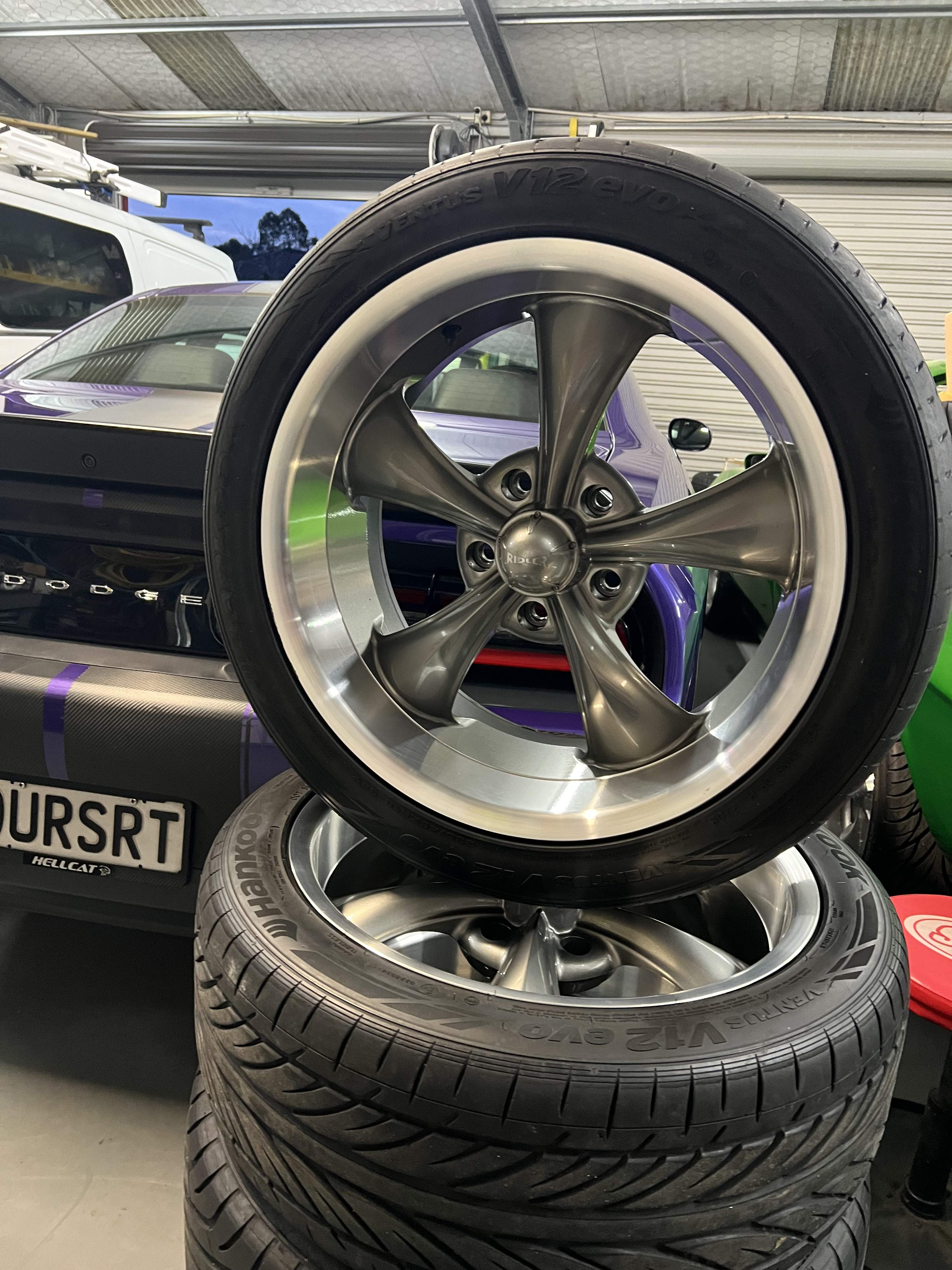

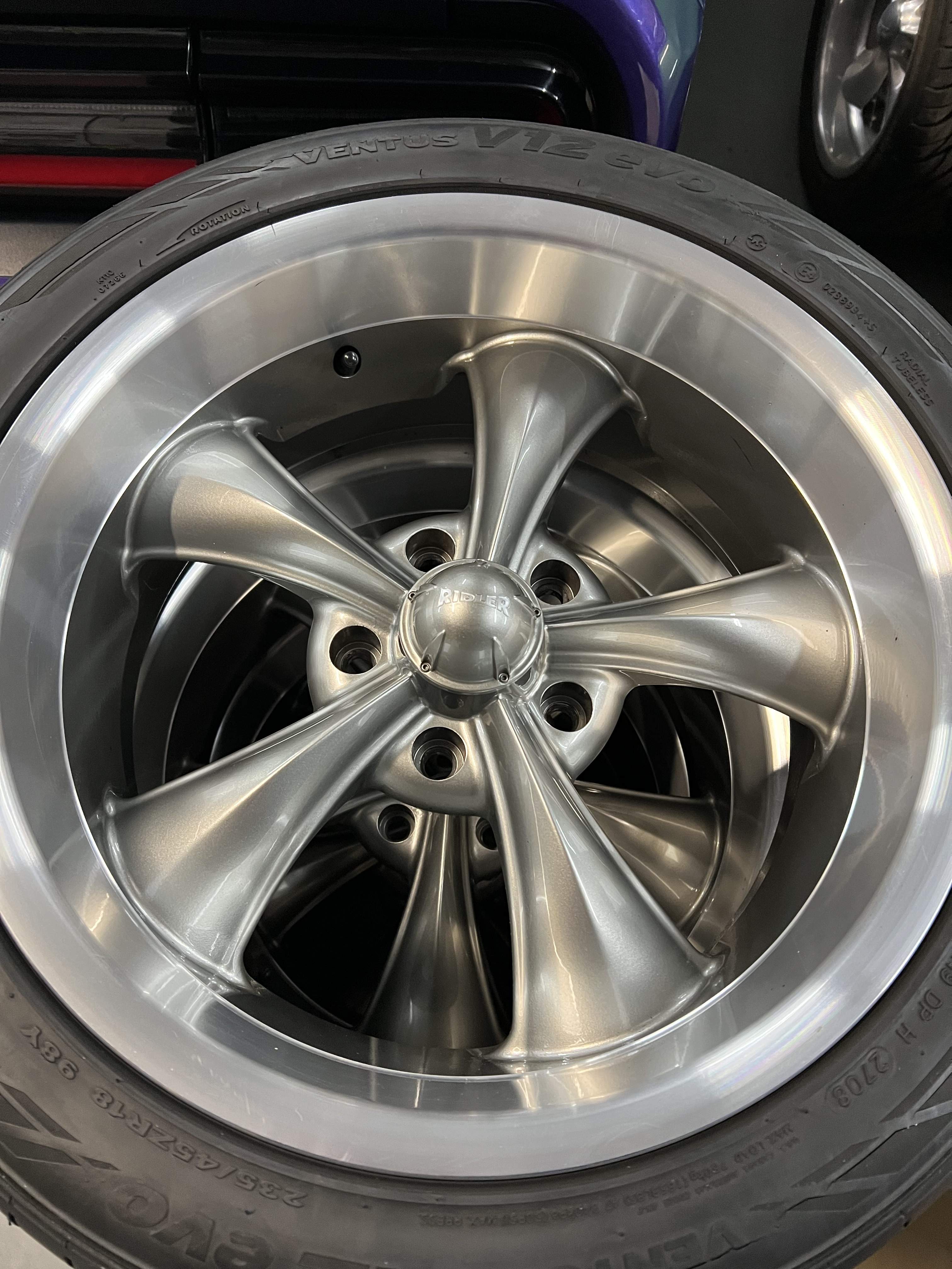

i scored a set of ridler 695 today !!! i hope they fit as they are a sexy wheel ! pcd is 127mm but its how they fit room wise that i wont know till i try them on the frame !!
Awesome score Kiwi.
They are gorgeous! Hope they fit 🤞🏼
me tooooooooo !!! i didnt pay very much for them, so that helps !!!

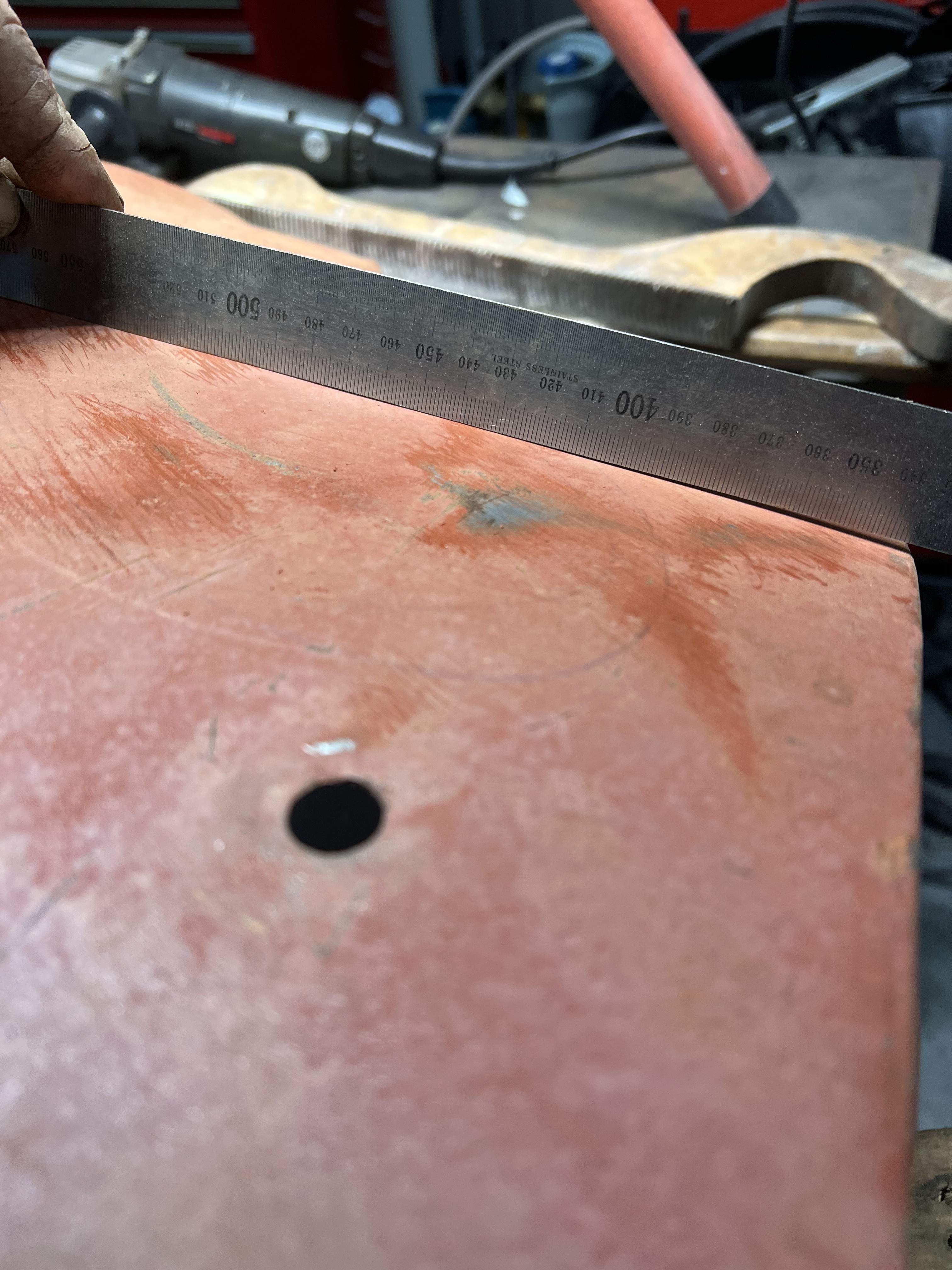

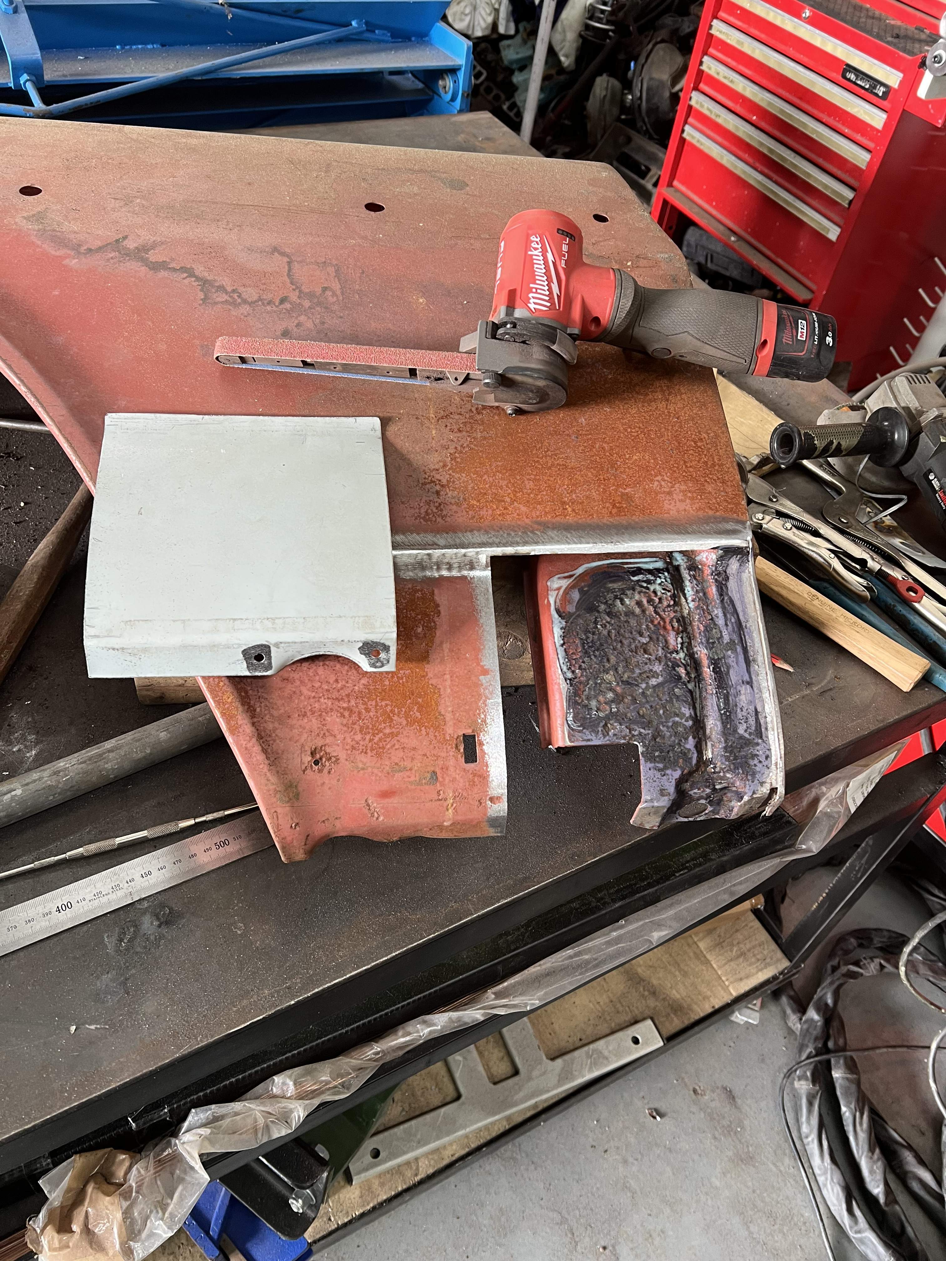

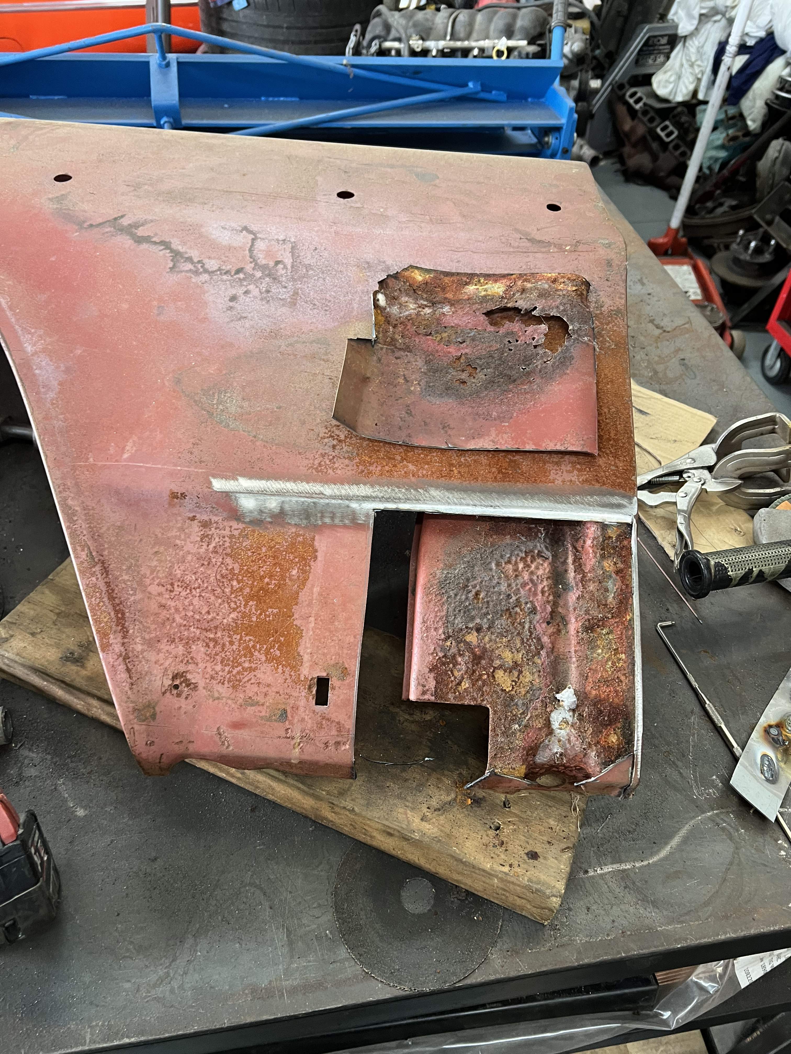

its the last weekend of winter and spring is here next week !...its raining and frezzing cold here down under !!!

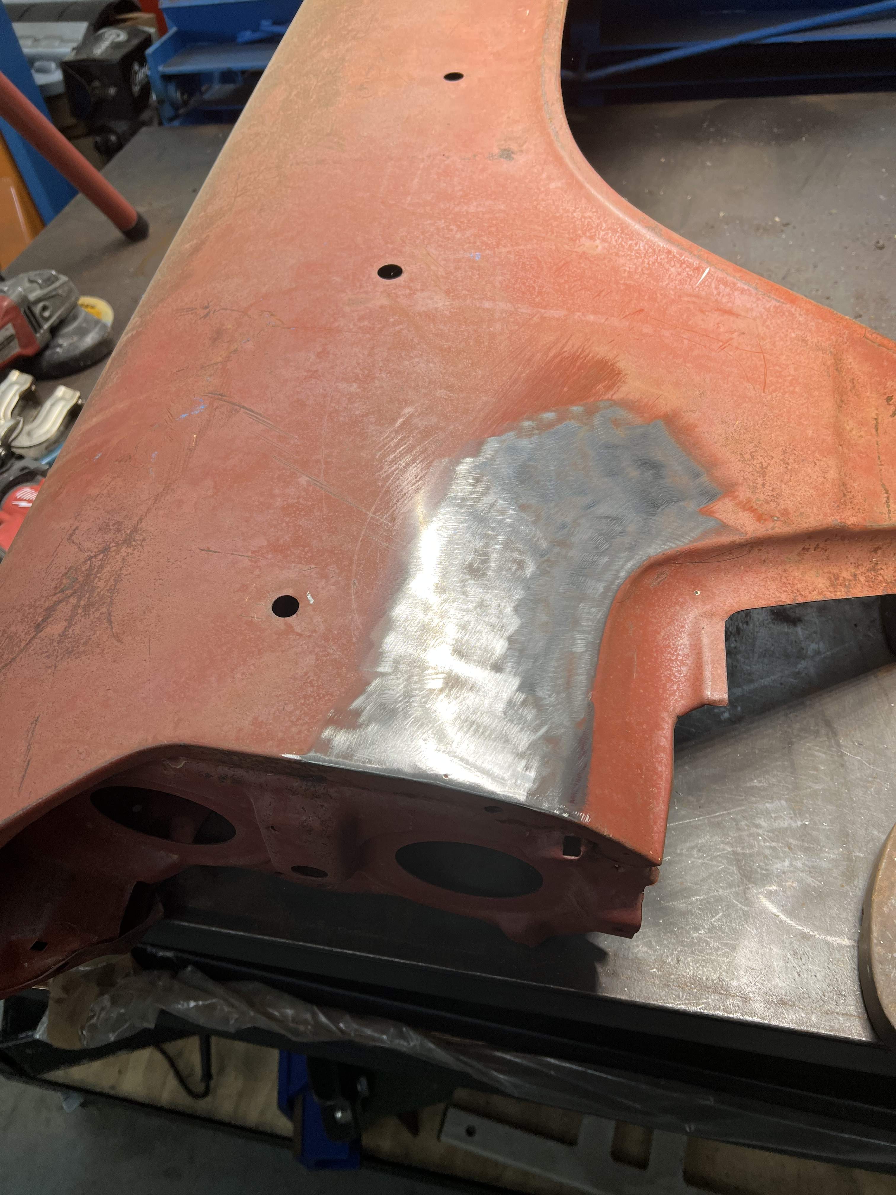

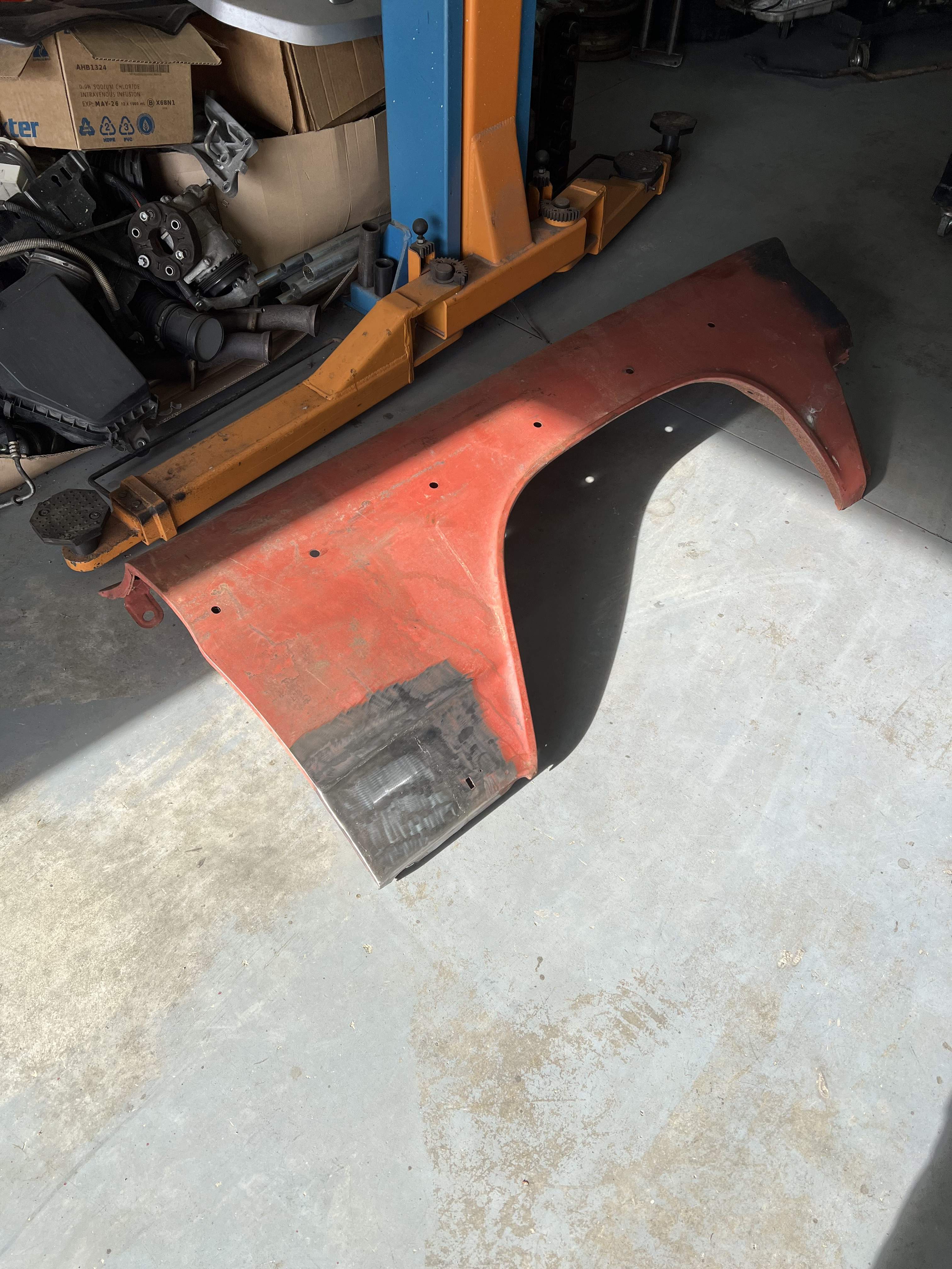

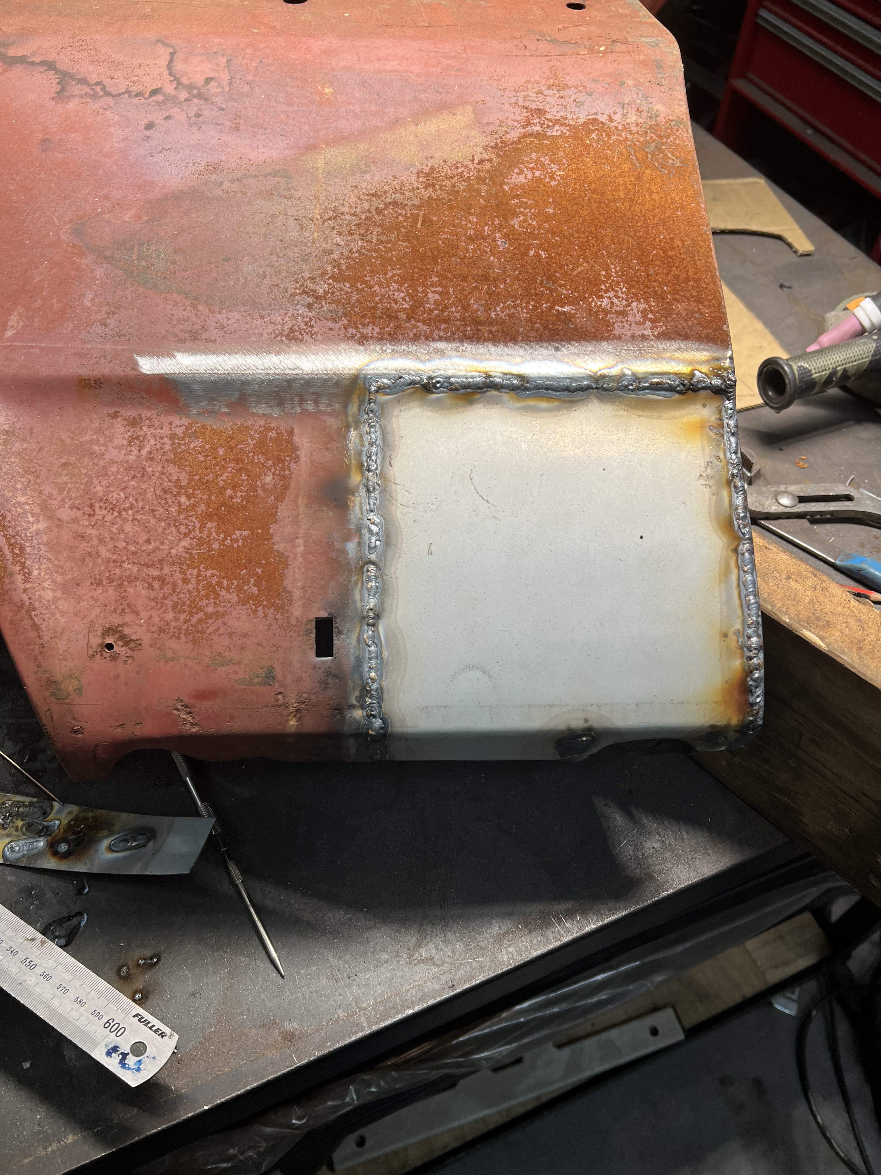

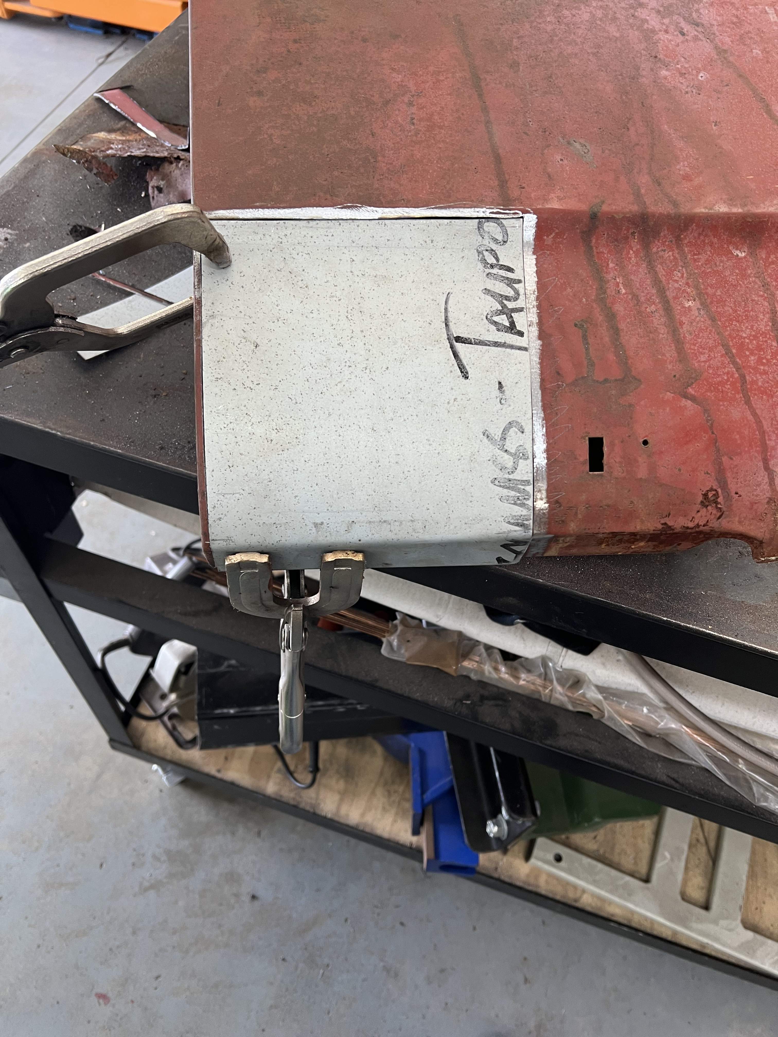

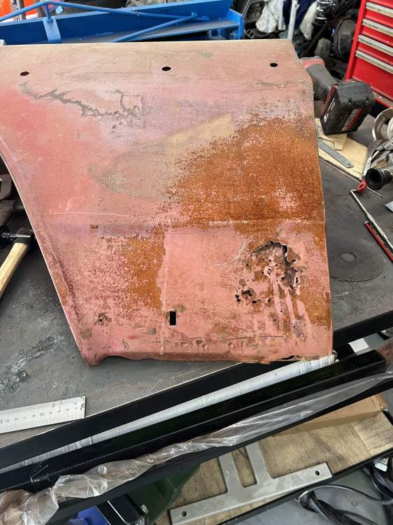

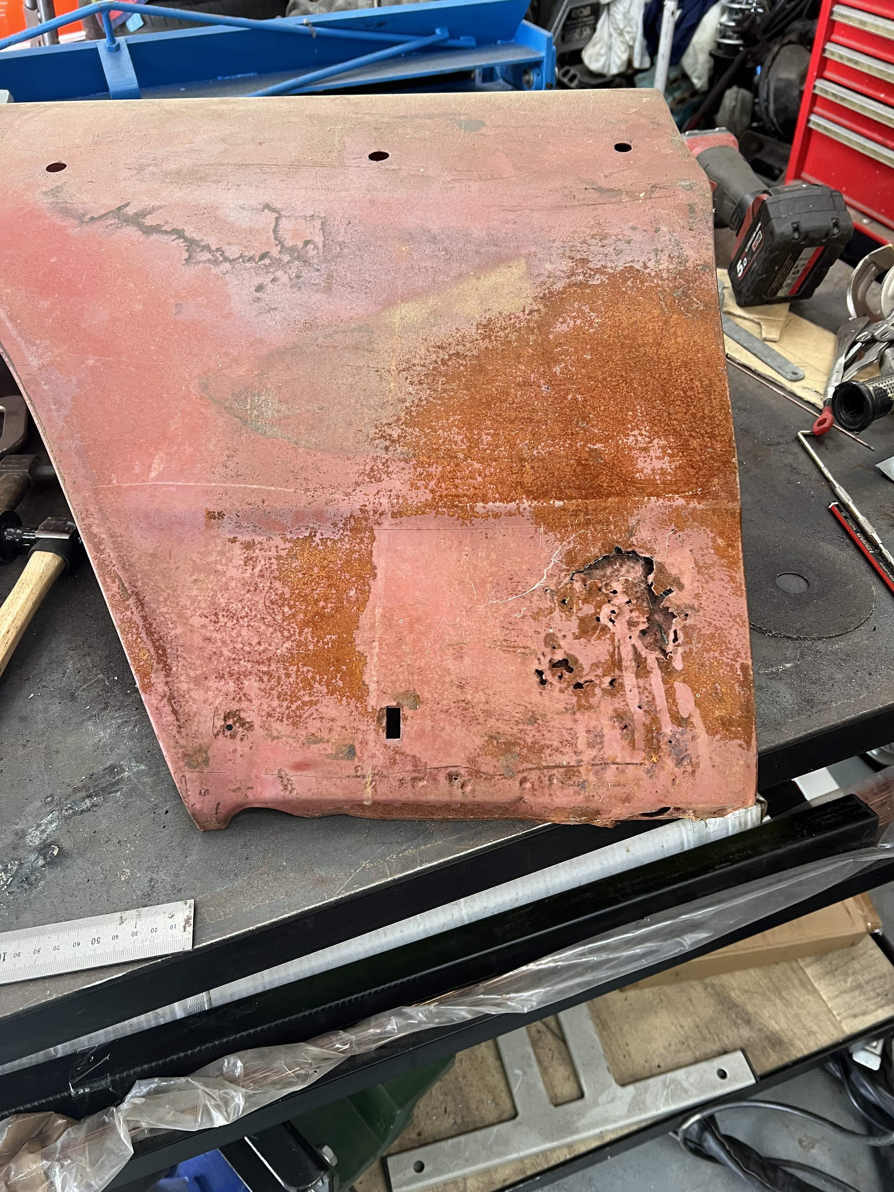

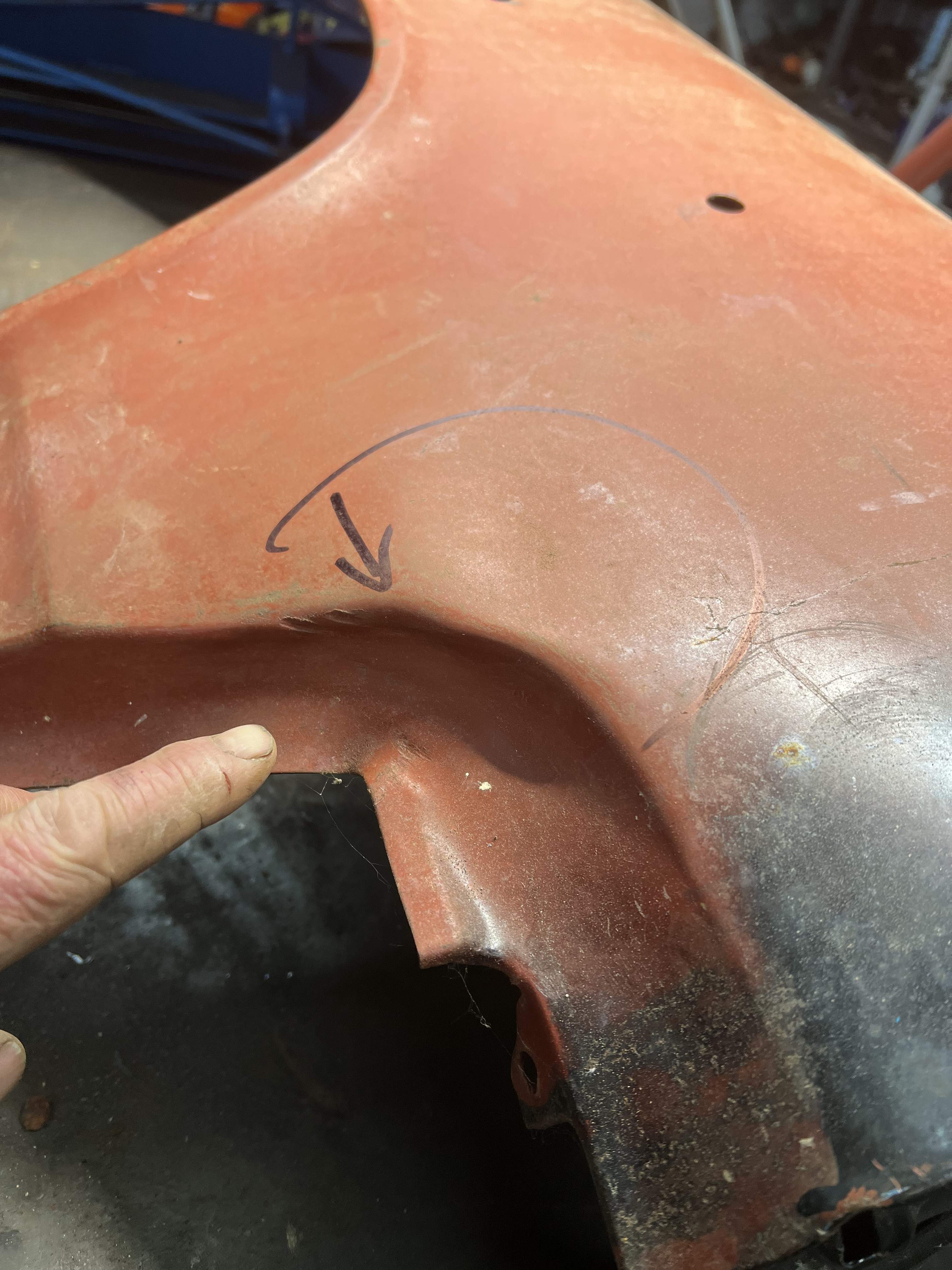

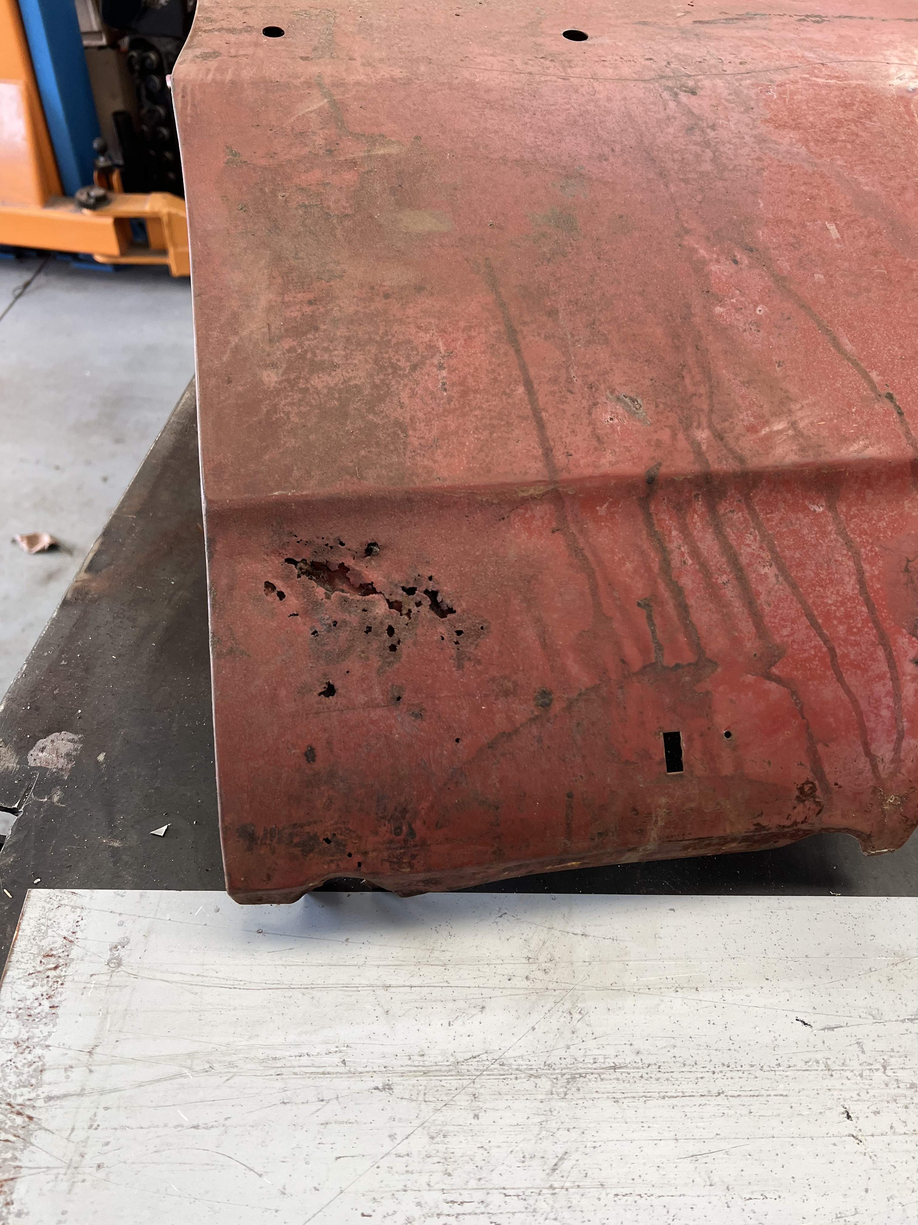

what better way to keep warm than to get into some panelbeating and using a nice warm welder !! tig and mig for me !

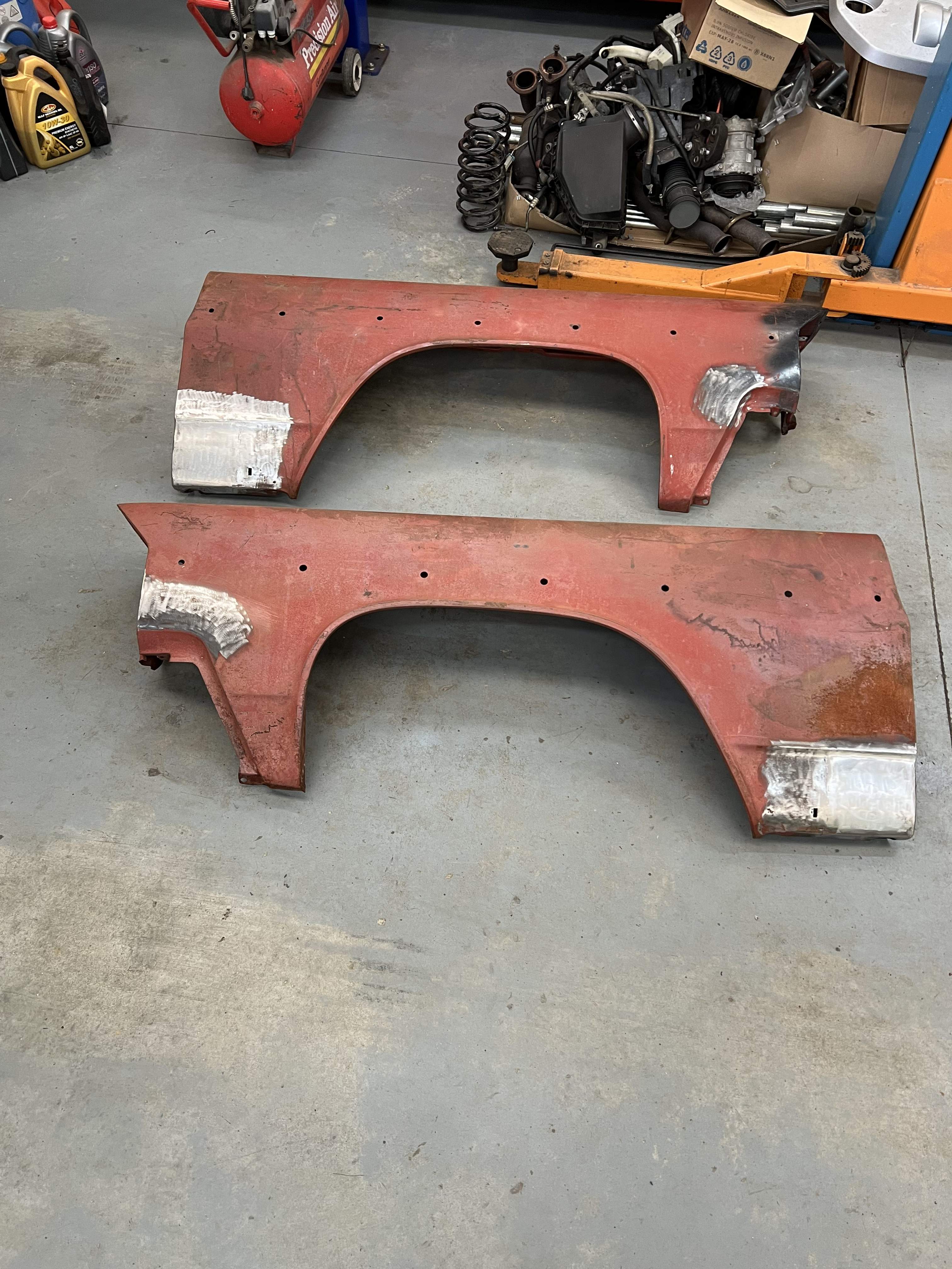

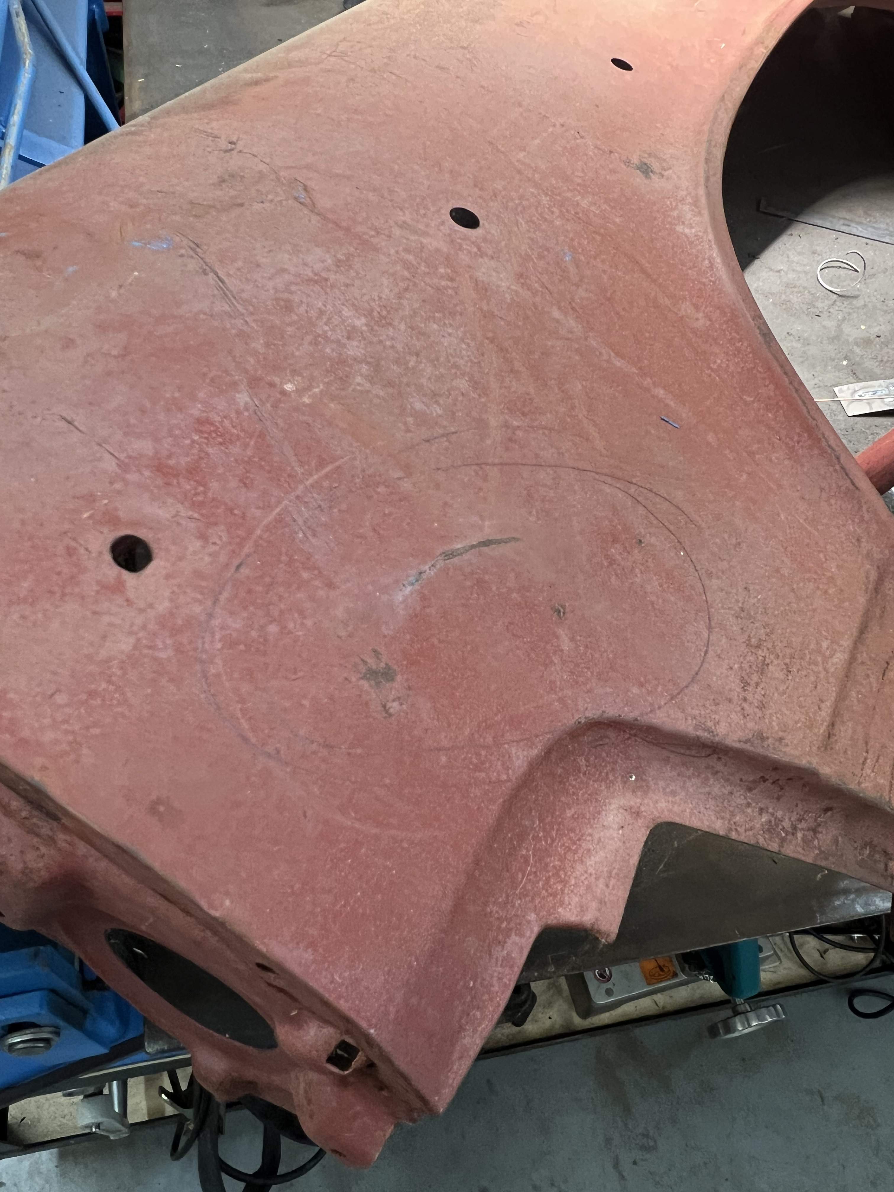

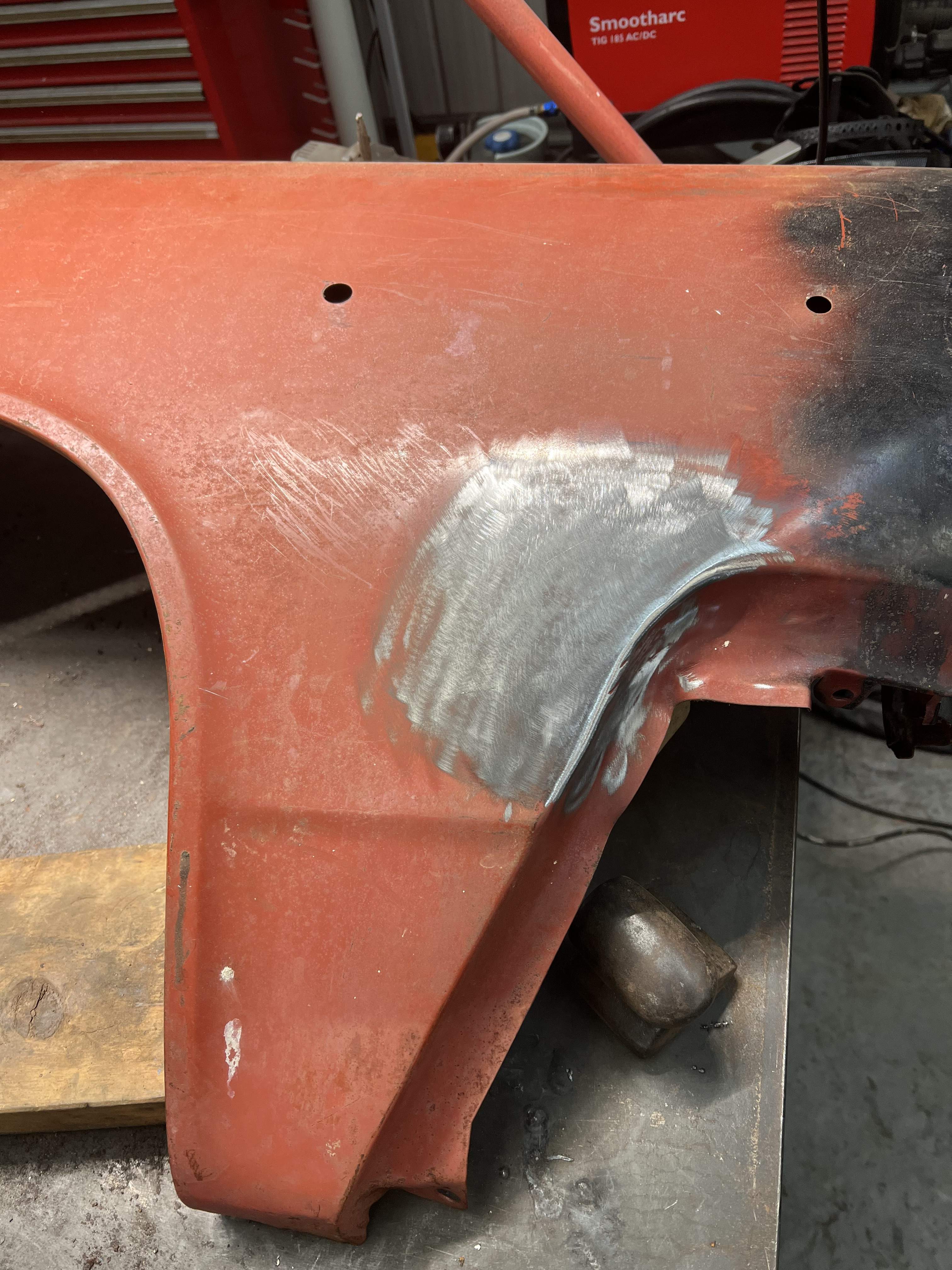

first job rust in the passenger side fender ....

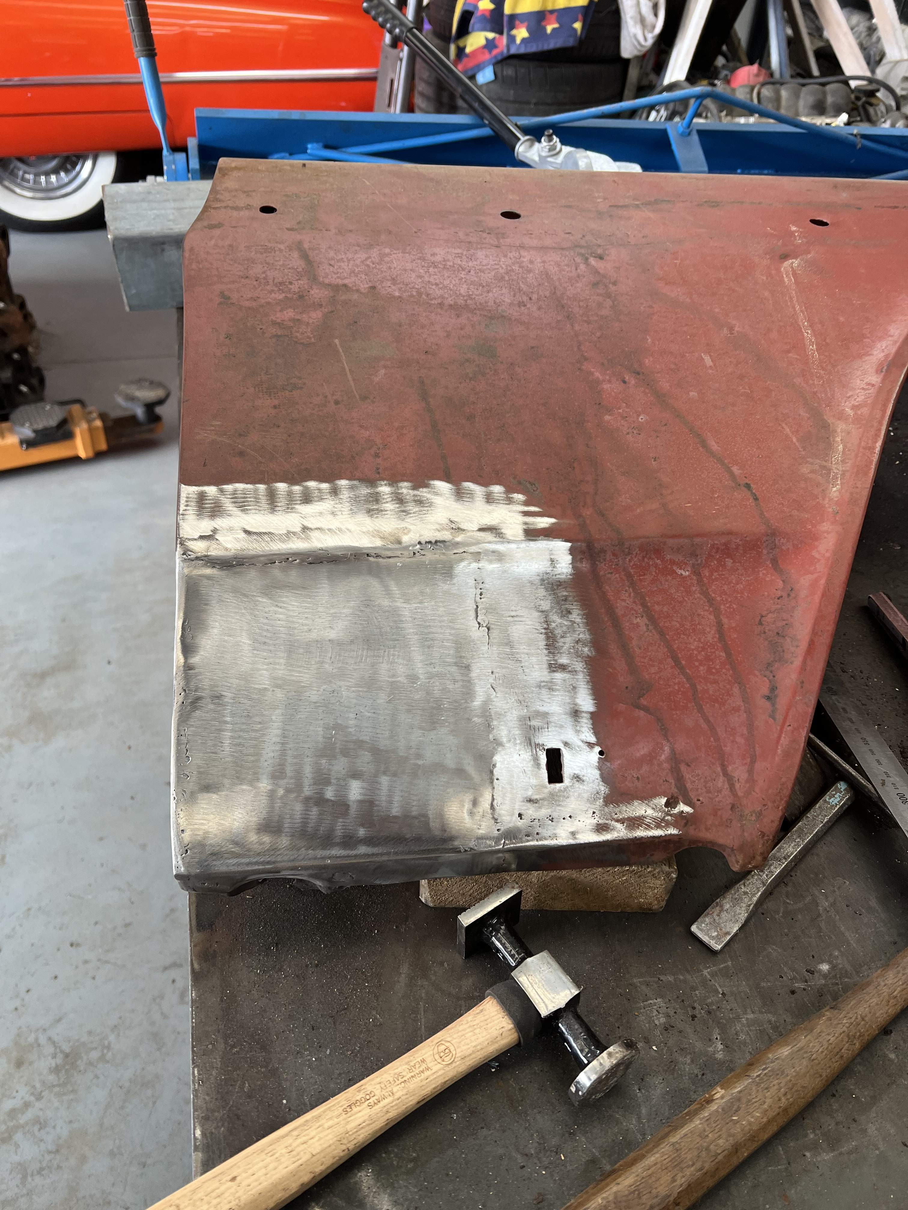

chopped out and new section in ...
welded and looking good

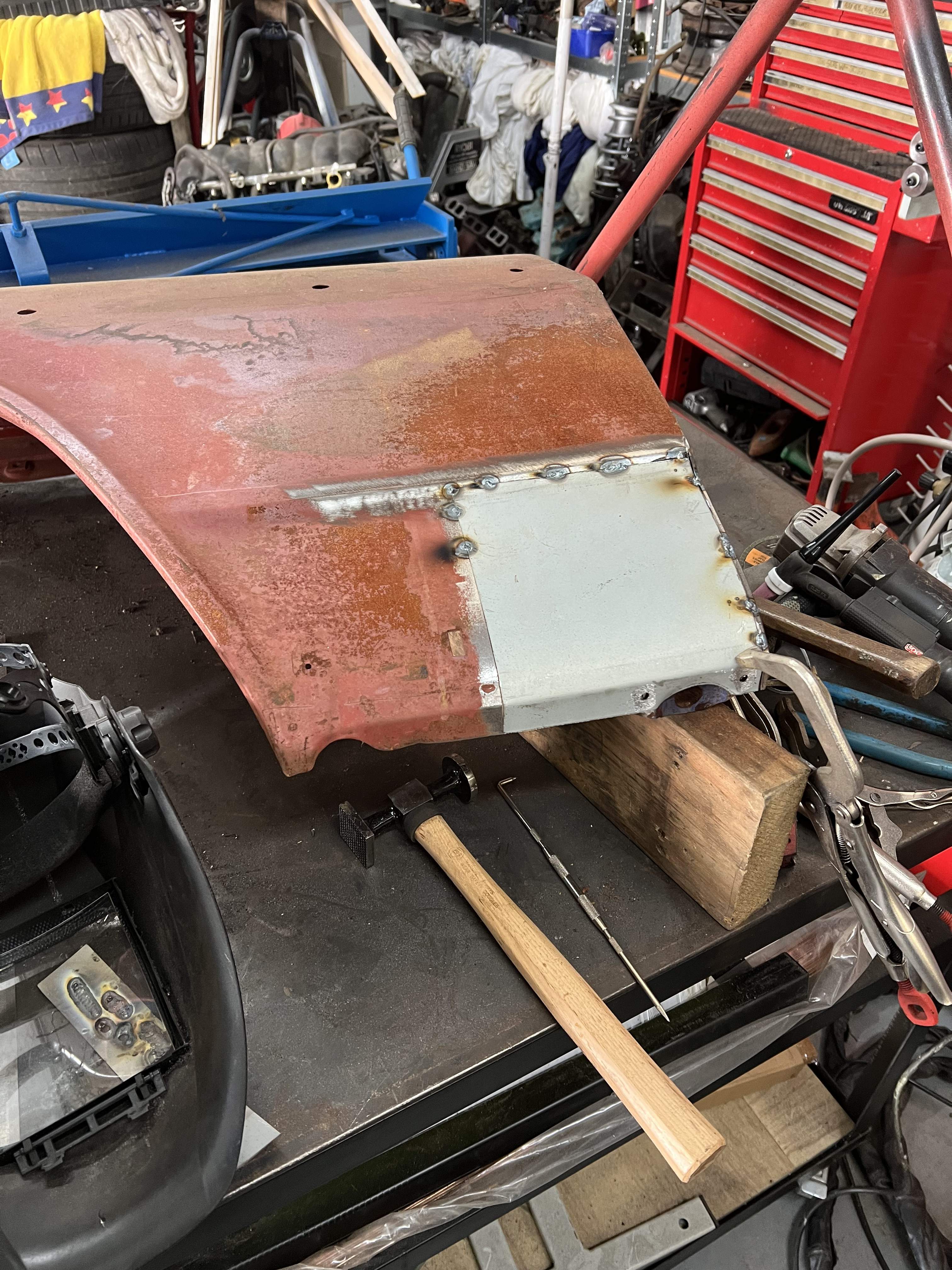

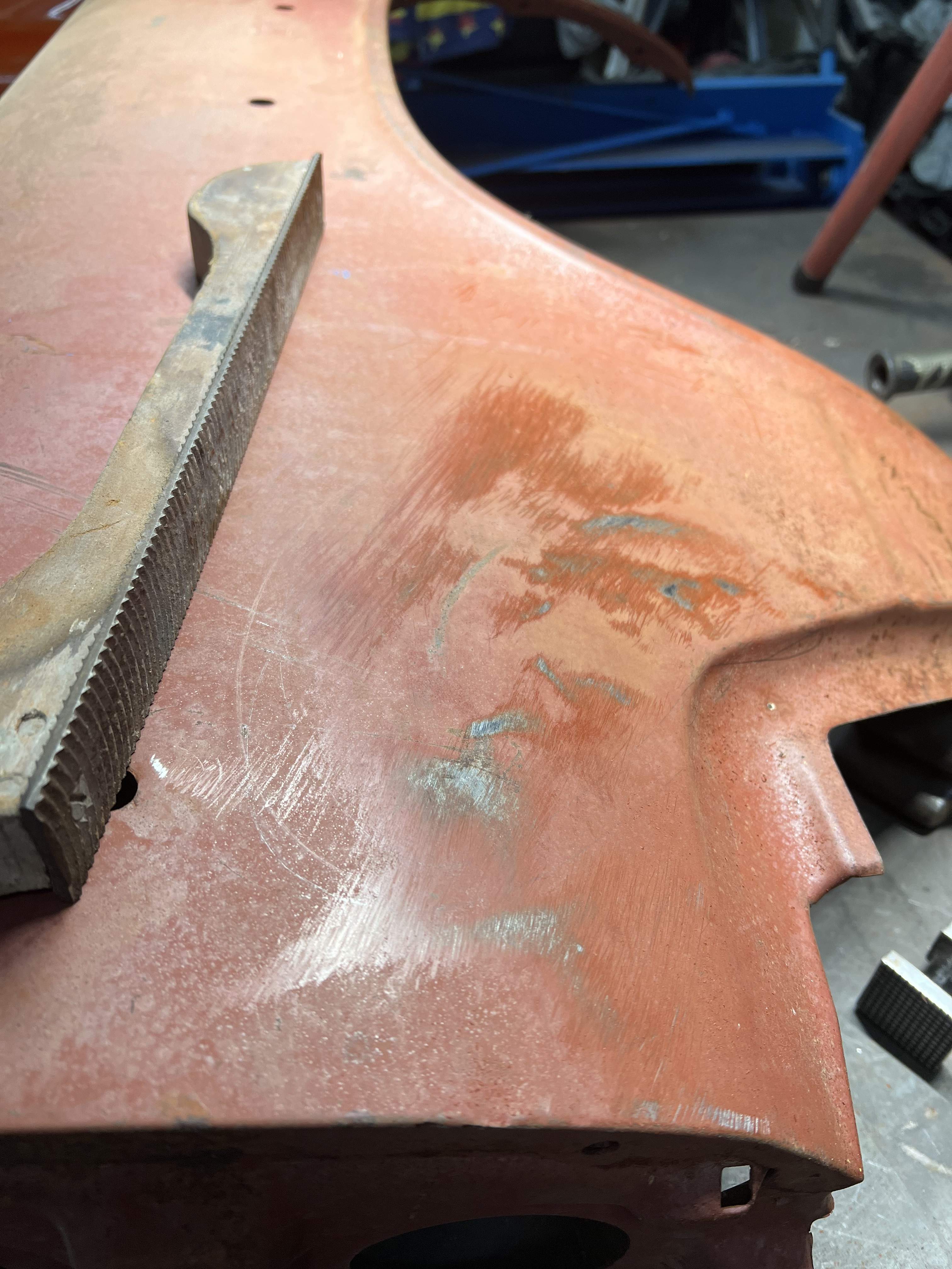

next was driverside and the same section of rust, the inner section was still ok , justA the outer needed surgery
my new best friend !!!! the milwaukee sander is a super cool tool to help get these jobs done easy as !!!

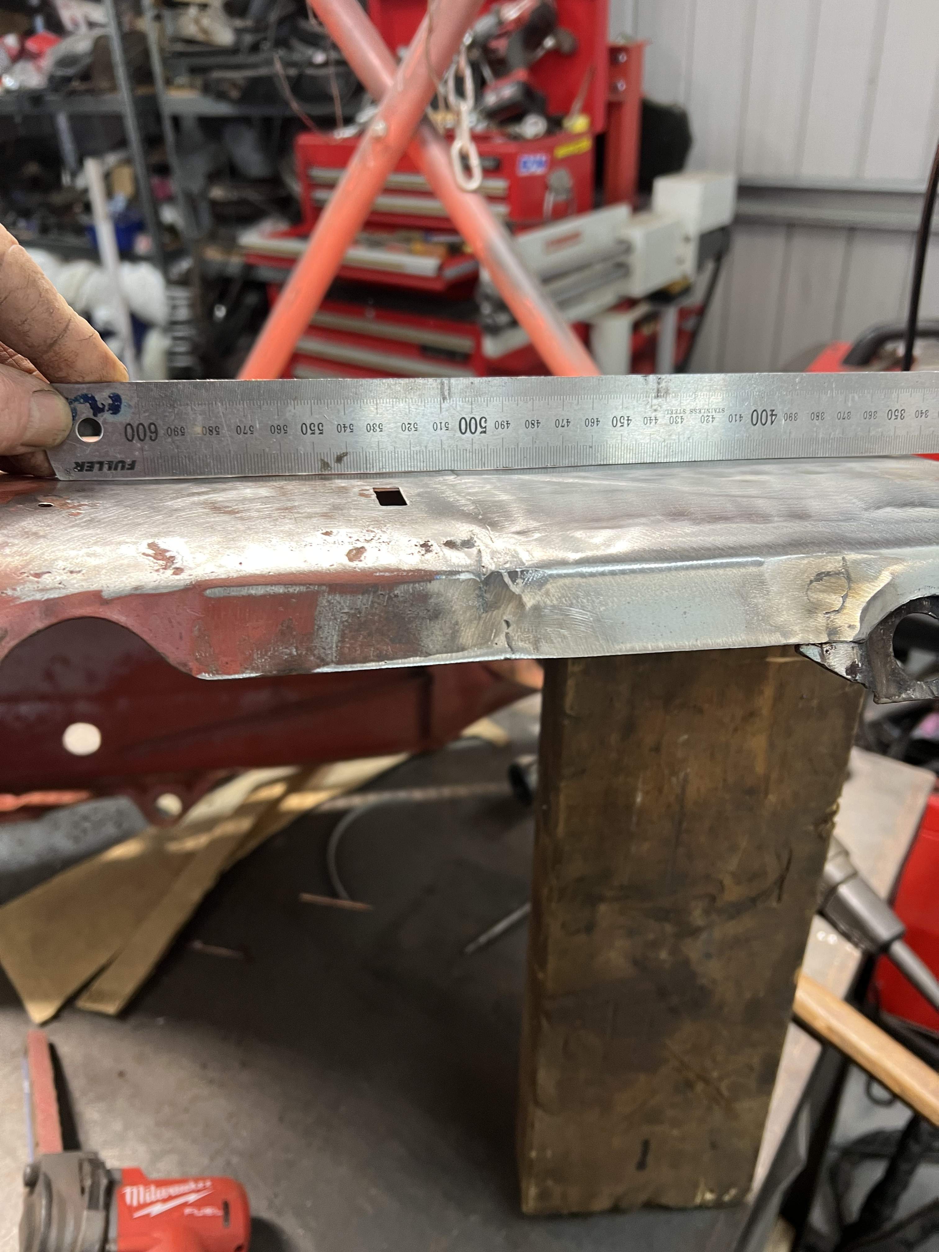

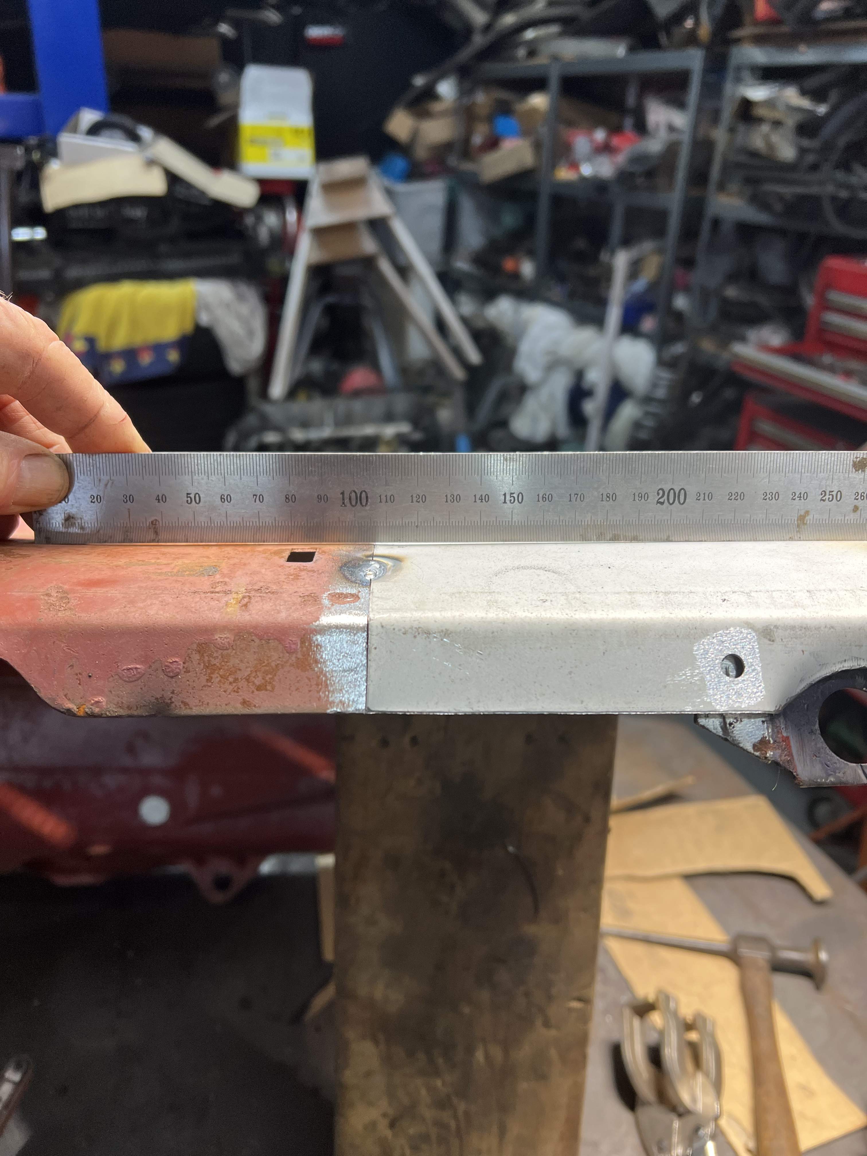

The trick is to tack then check... you make less work for your self by ensuring everything is straight and true.
i am using my tig welder as it uses the same mild steel filler rod as the metal you are working with , which inturn means its malable after you weld and you can shape the panel.
Dont use mig, it is a hi tensile weld which you can not shape after welding.
i so enjoy doing this stuff , my welds are not perfect , but i get good penitration and thats all any one would ever want !!!!ohehehe
each fender had dents that needed dressing
this is where a body file helps to show you the high and low spots
another thing i love about our old girls is the fact its very mallable steel !
this curve was easy as to put back to straight with bugger all effort !
both fenders done and ready for paint prep with less than 1mm of filler required.cheers

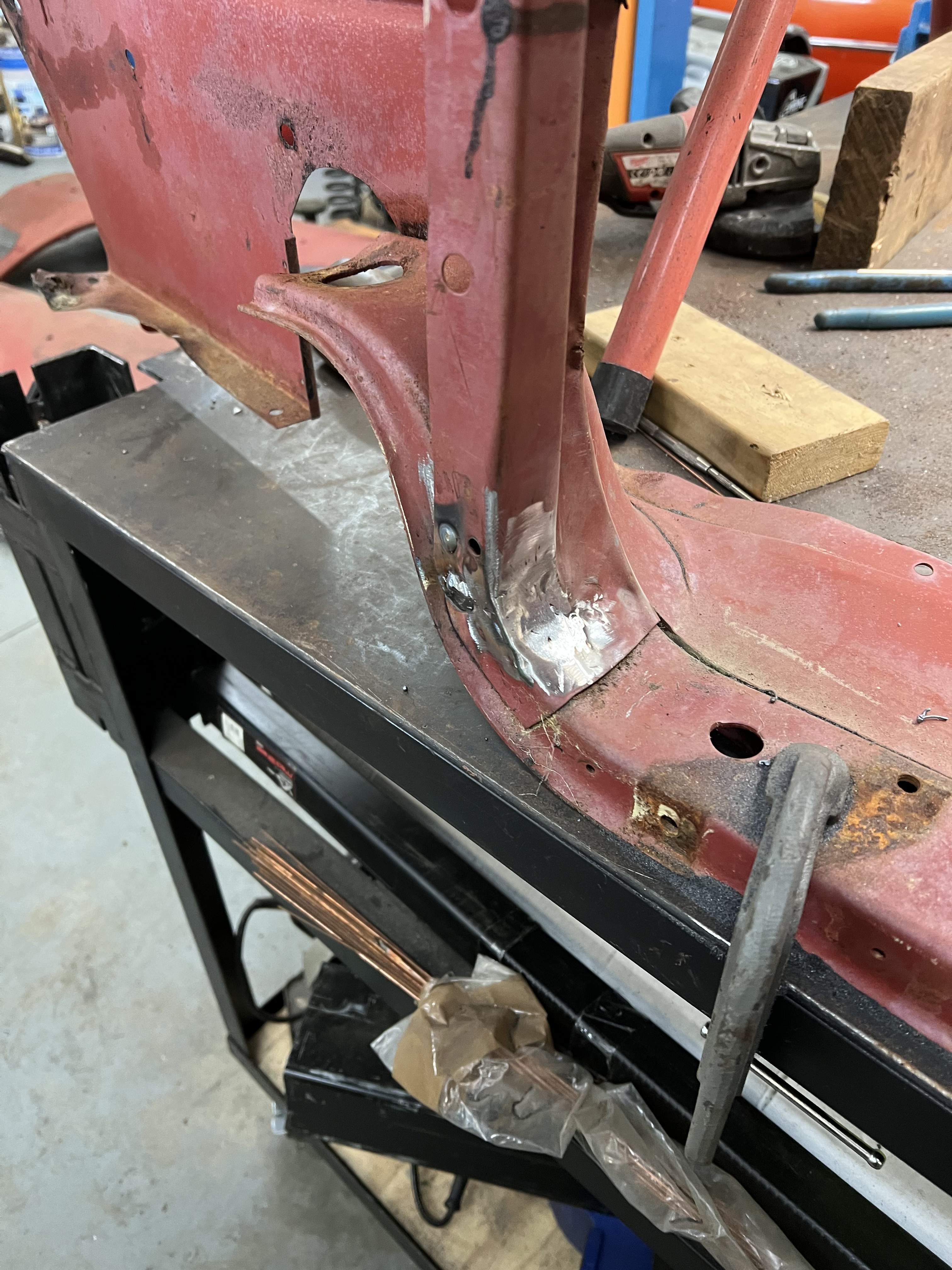

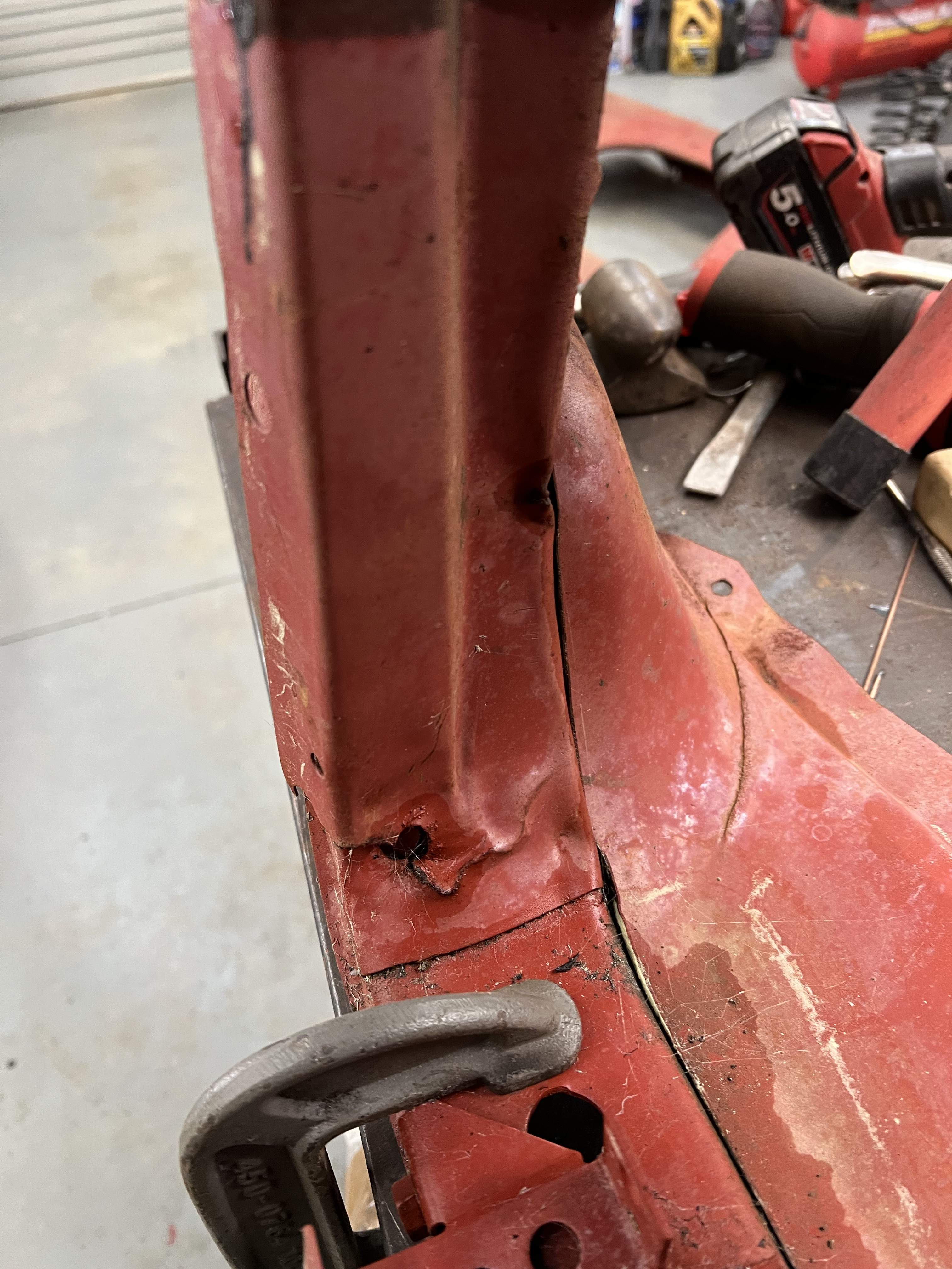

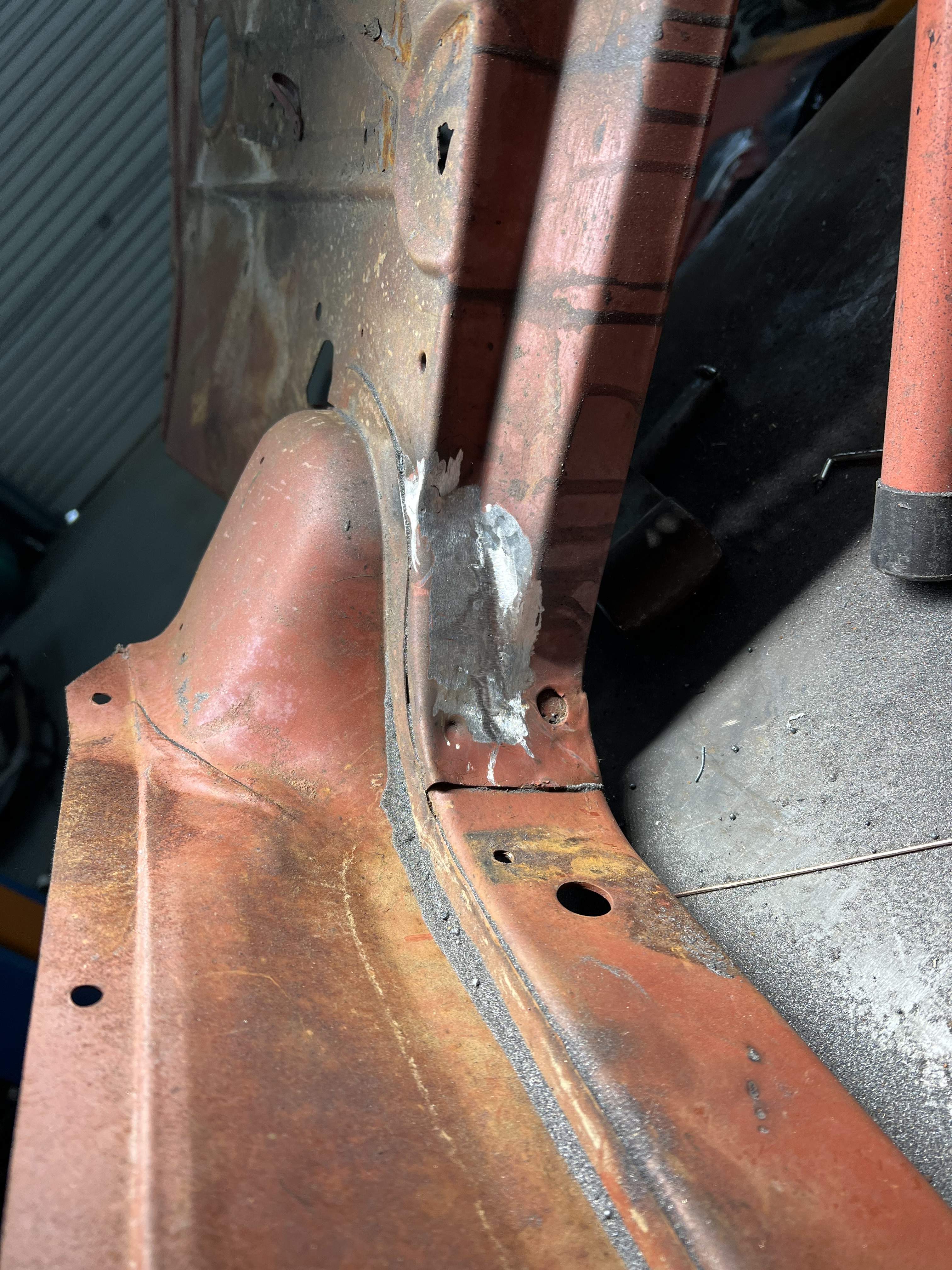

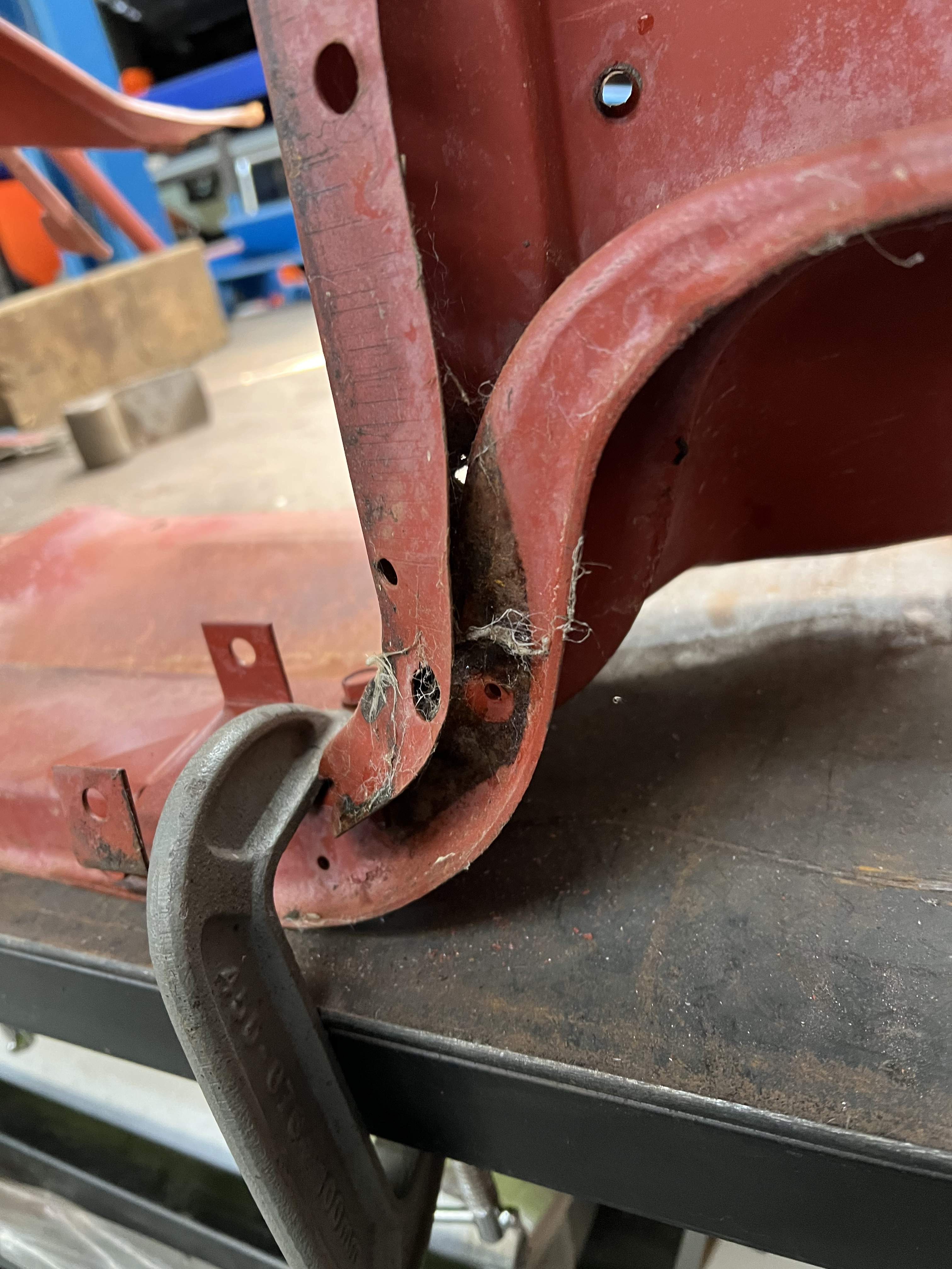

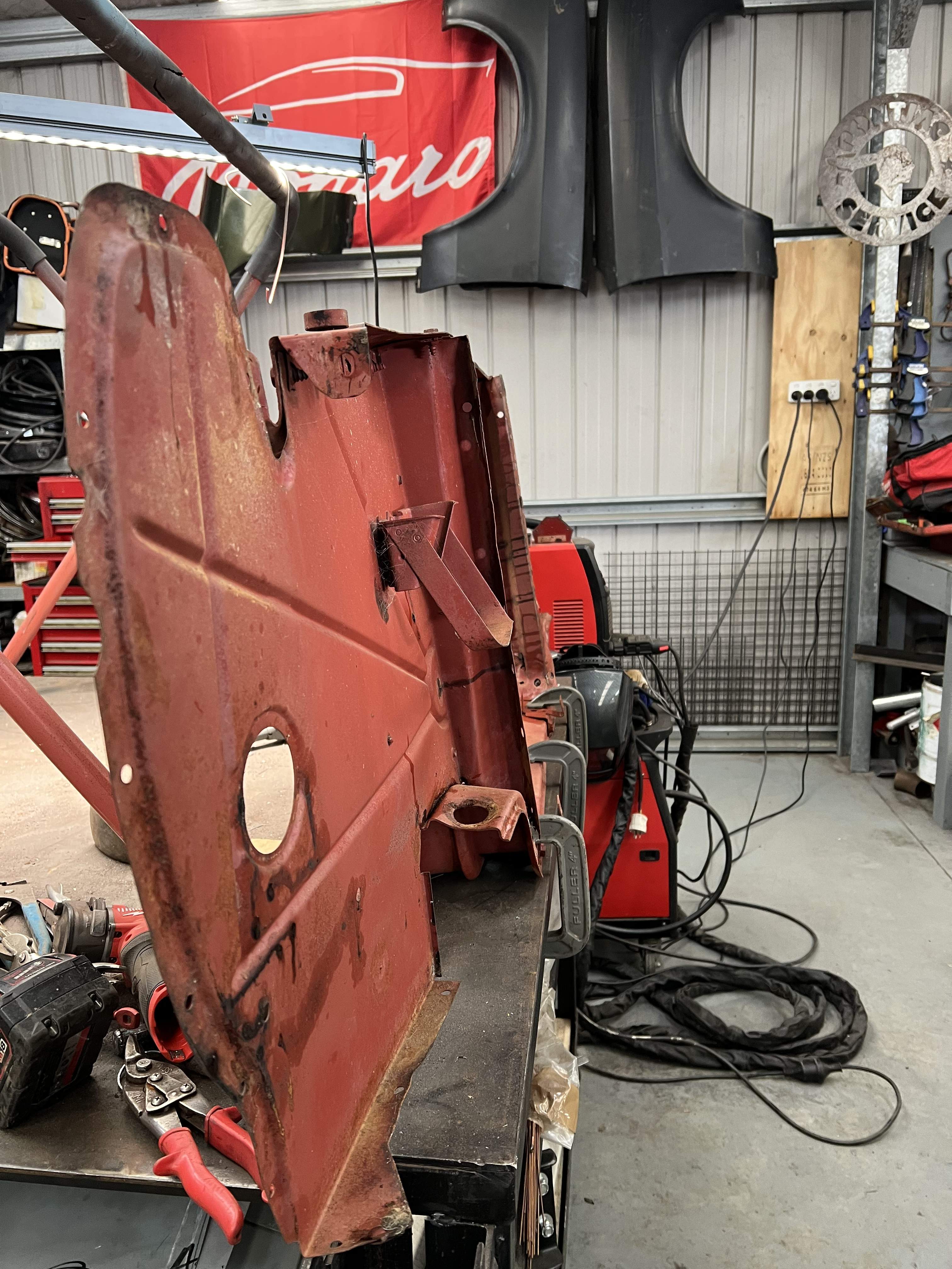

next was the radiator support member , that was bent and had a litle bit of rot..
with any good panel job , you use what tools you need.... and if they dont work .... get bigger tools !!!
