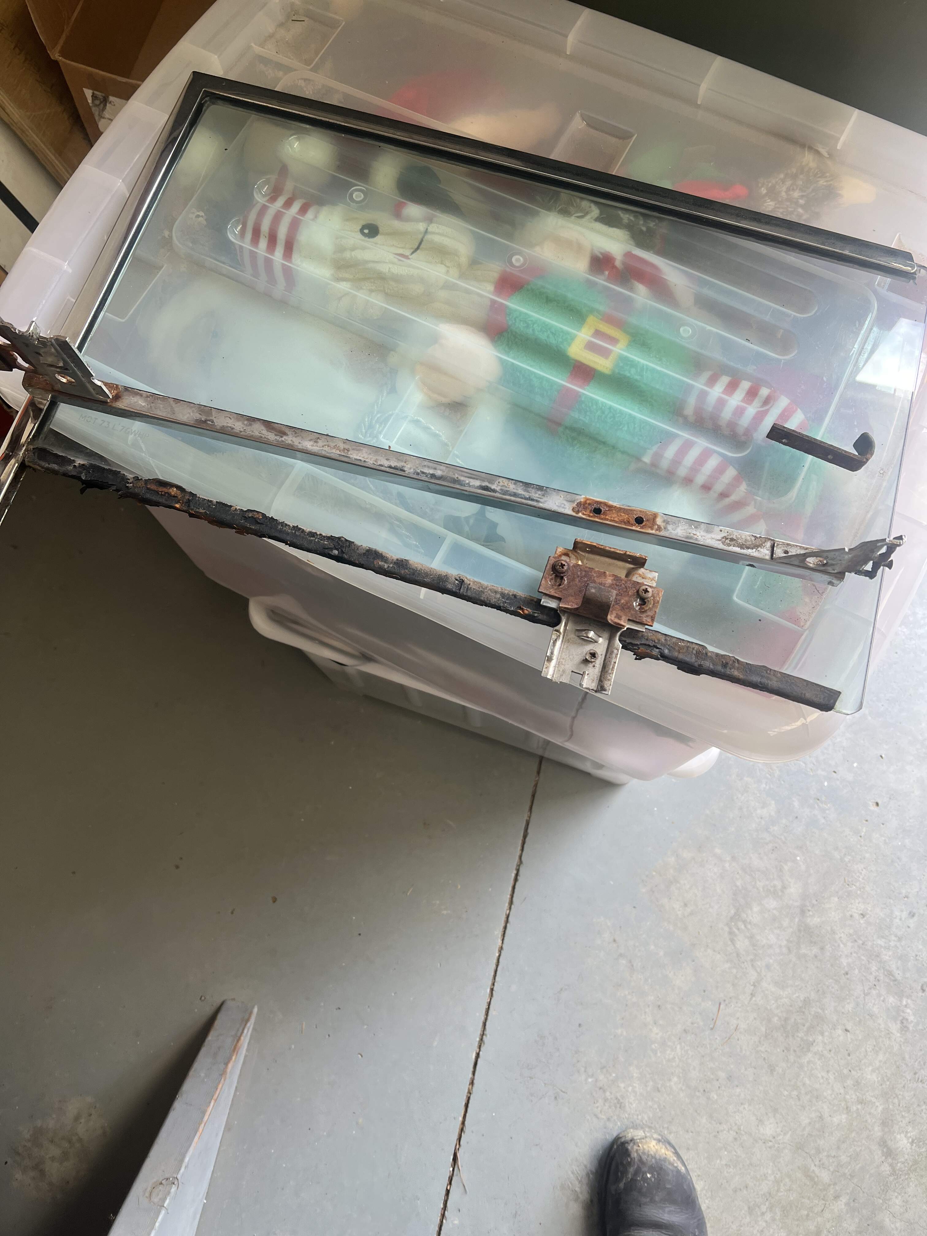

As we where leaving the park that we did our little show and shine in, the boss flicked the switch on her window.........
Not good! the window did something weird. i said " stop" !!!
Dont  touch that switch i told the boss... she said why?.... the window is on a funny angle...bad, something has broken in the door !
When i got home i pulled the door trim to find the bracket had broken
i have pulled the chrome c section off the bottom of the glass and mig welded the bracket back on 👍
the 63 year old spot welds on the power window mount bracket had broken.
It was a easy fix, but i was worried it would stuff up the chrome on that "c" section that holds the bottom of the glass..
 i think it came out ok, and the chrome is intact!:dancingpontiac:
i will take the repaired frame and glass to my glazer mate and he can fit the channel back onto the glass.
Nice fix. One day, I started to wind the window down on an old Holden and the glass let go and dropped to the bottom of the door, smashing instantly. Yours might have done the same, except on the way up! Old cars. Can't get enough of this shit!
Had the same thing happen to my drivers door window. The beauty of mig welders is that the heat is concentrated to a small area which helps to save the chrome.
one of the bad things about classics is that the steel is not nearly as corrosion resistant as the newer blends. But I still plan on driving my 63 to the end.
Glad your episode had a happy ending.

Dwight , I was so pleased I didn’t bugger up the chrome when I mig it !!
and your dead right ! This is one part of our cars that Rots out as the water sits in the channel !
Love my old cars mate !!
I can fix them ! Unlike the new stuff !!!
