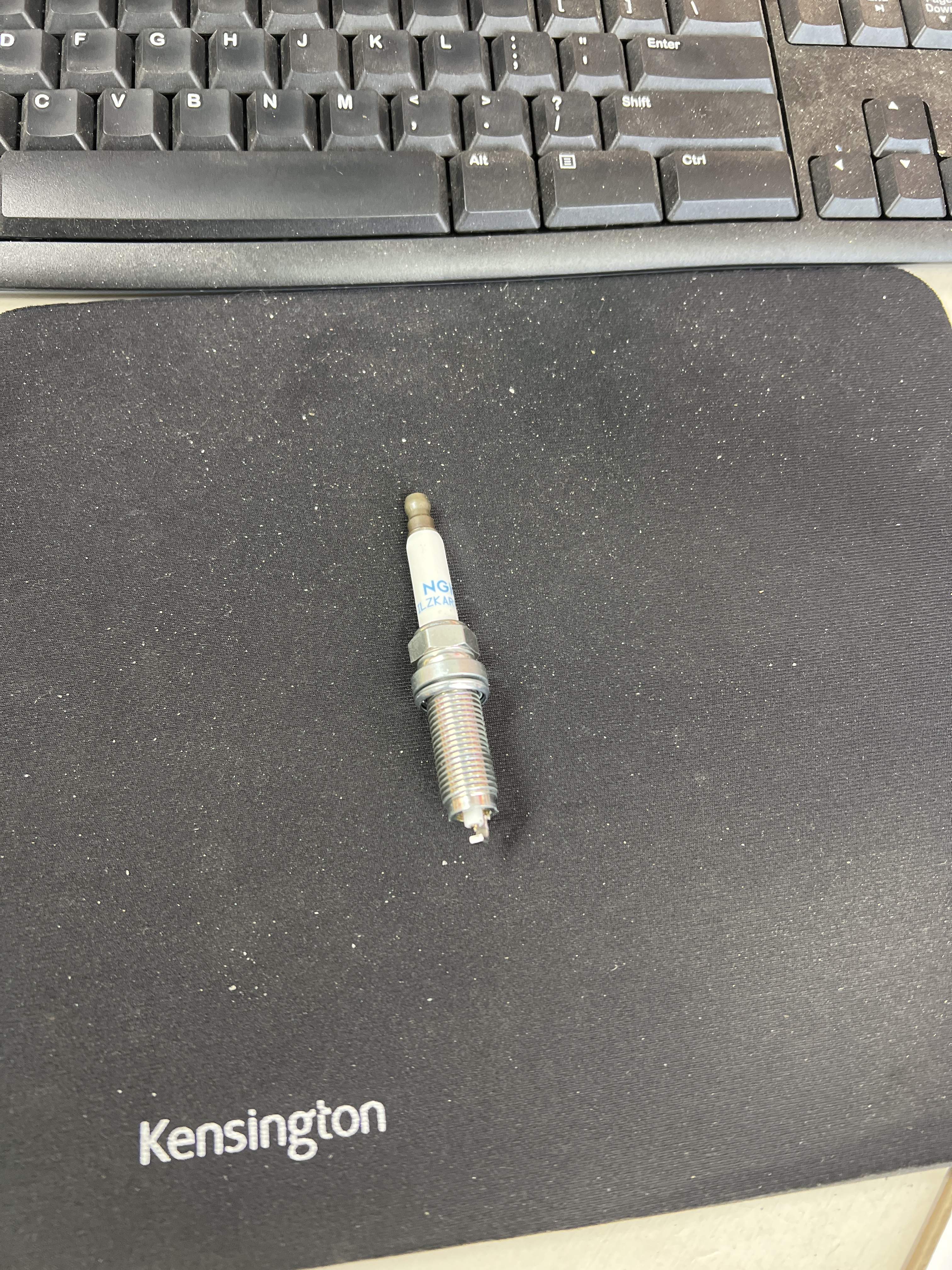

Kiwi, need some info. What is the thread size of the spark plug or at least the number of the plug? Second, can you measure the i.d. diameter of the tube that broke off using one of the other plugs. Finally can you see the top of the broken tube that's in the spark plug hole? Does it stick above the hole, below the hole or even with it? I have a thought that may be an easier fix!
last indian,
its a ngk ilzkar8g8 part number 95112 iridium and its m12 x 1.25mm 26.5mm long with a 14mm hex....
its long tiny plug !!! i measured the inside diameter at 7mm,
and it is located right in the bottom of the threaded head, i dont think it even got 2 turns up before it separated, i suspect debris on the end has stopped it undoing.
i was able to screw the plug back in, its firing and the motor hasnt thrown a miss fire code ! so its clearly in the bottom and close enough to the hook to throw a spark !!!IMG_7560.jpeg
did i mention this is a vw engine ?

Kiwi, Easy outs typically work on broken threaded parts that snap off & there is nothing to get a hold of, but are not frozen or galled. When they are frozen or galled using an easyout can increase the diametrical squeeze on the threads making it more difficult. So assuming yours is frozen or galled the easyout might only complicate matters.
So the 7mm inside diameter of the broken sleeve is a perfect size for threading a left hand 8mm x 1mm tap. There are a variety of tap wrenches that should allow you to get down to the hole with the tap.
The 12mm thread has a .472 outside diameter. A 8mm x 1mm tap has a tap drill size of 7mm & a 8mm tap or bolt has a .315 outside diameter. By using a left hand tap, once threaded you would then install a threaded shaft with a shoulder. In this way it won't unthread as you try to remove the sleeve. Additionally before you try to remove the sleeve I would recommend that besides any penetrating oil, that you use a hammer on the threaded shaft to shock the sleeve. This often breaks any bond between the two frozen parts.
You might see if your machinist friend can make you a shaft from a grade 8 bolt. It would have a shoulder diameter anywhere from .450 to .400 with a 8mm x 1mm left hand thread on the end. The shoulder will lockup on your now 8mm x 1mm threaded broken sleeve. Then the top portion would have a 12mm x 1.25mm thread for a double jam nut or preferably you could have a hex cut at the top for a socket.

That is the best answer !!! instead of the easyout pushing outwards making the thread even tighter to get out, a thread inside will want to pull upwards !!! .
ok so if i thread a left hand 8mm x 1mm, the shouldered thread i use what grade steel do you think it should be made of ? or do i leave that up to my mate the machinist ?

Kiwi, determine what overall length you need, including the amount of 8mm thread to go into the sleeve. Using a 12mm grade 8 bolt should work well for what you need. Your machinist mate can easily cut that material with carbide tooling. There are several ways this could be made. This is just one. You could simply use a bolt as is & just modify the bottom threaded portion of the bolt. In this case just turn the 12mm threads & shank down to about .400 & by a length you'll need to determine, but will include the length of the 8mm x 1mm thread you'll need as well. Then your friend will need to turn down the appropriate amount in length & diameter for the 8mm x 1mm threads. He could also just drill & tap the end of the bolt for an 8mm x 1mm left hand thread & install a grade 8 long Allen set screw.

i fixed the spark plug issue !!!!!rofl
justa cost 40k to fix rofl
Awesome mate! Wondering which is the biggest tool used here! Kiwi or his boss’ wallet!
