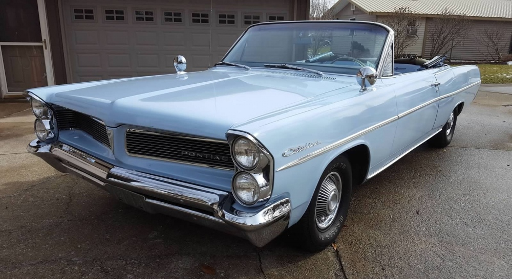

justA had to put an old picture so i could apreciate what a cool car you have Dwight !
Dwight .

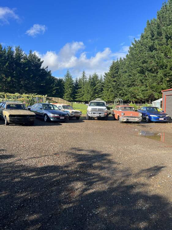

The boss made me move my “ heaps of shit “ off the lawn in preparation of the up and coming wedding of our daughter here at home !
I simple don’t see one pos in this picture !
do you guys ?????
