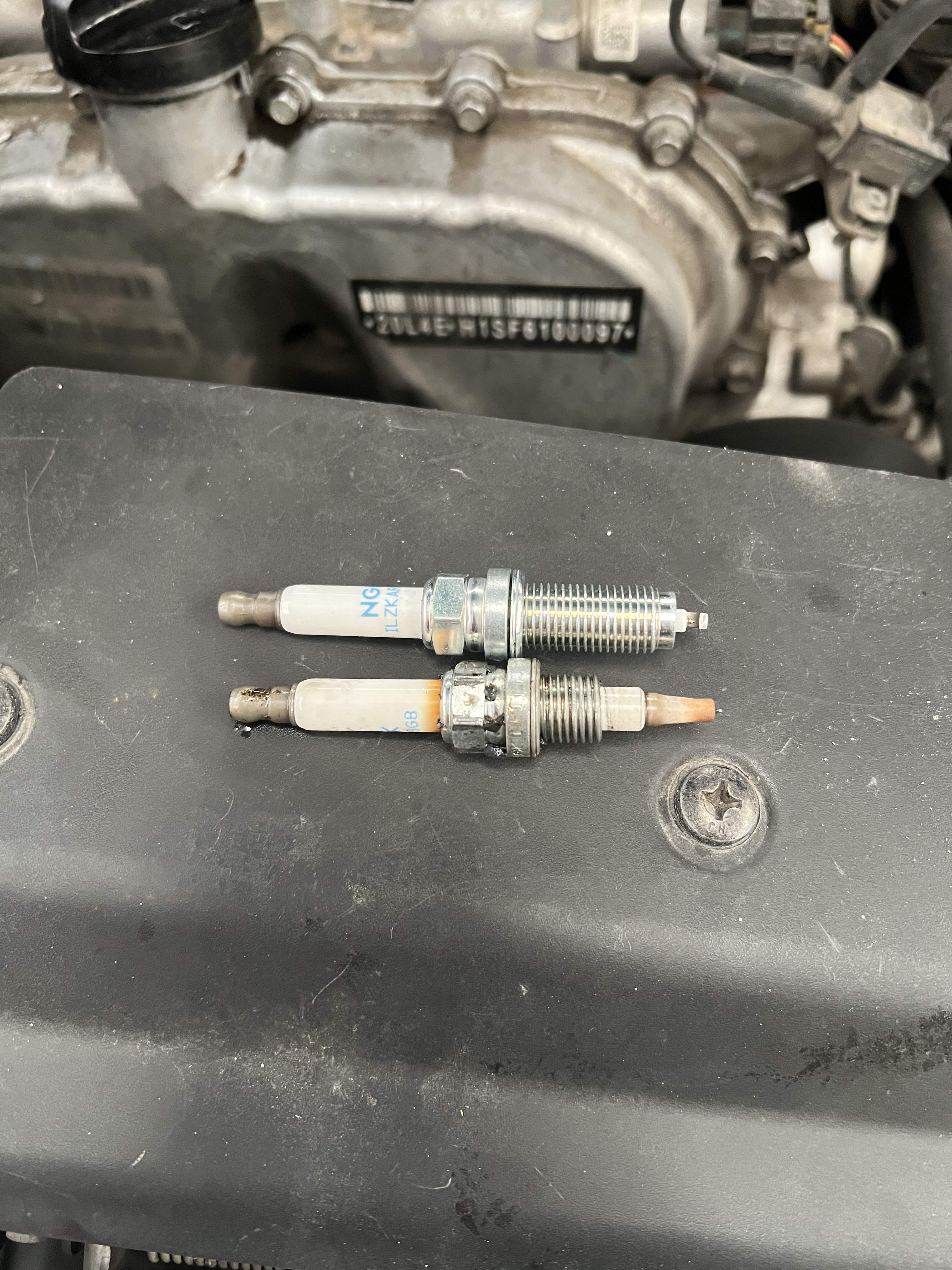

Yesterday I did the 300k service on my work van . It’s a 2015 Ldv g10 2 litre turbo petrol.. and part of the service was to change the plugs …
Well all went fine till number 3 plug … that sucker was tight , so I put everything back together and ran up the motor to normal temperature , then stripped it down and tried to remove the plug , it was still tight …
I added crc 556 and left it ,,, came back and I could move the plug back and forth a small amount … but it was getting tighter as I tried to remove it ..
So ,,,,, back together again and took the thing for a drive and got it really warmed up ….
Pulled it apart again and tried that plug … gently gently it moved then ……. Loose … my heart droppped clean out of my chest and flopped on the garage floor !!!!!!!! 🤬🤬🤬🤬🤬🤬🤬🤬🤬🤬🤬🤬🤬🤬
Half the plug came out !!!!
I now have a major job on my hands and I need this van this week for work !!!!

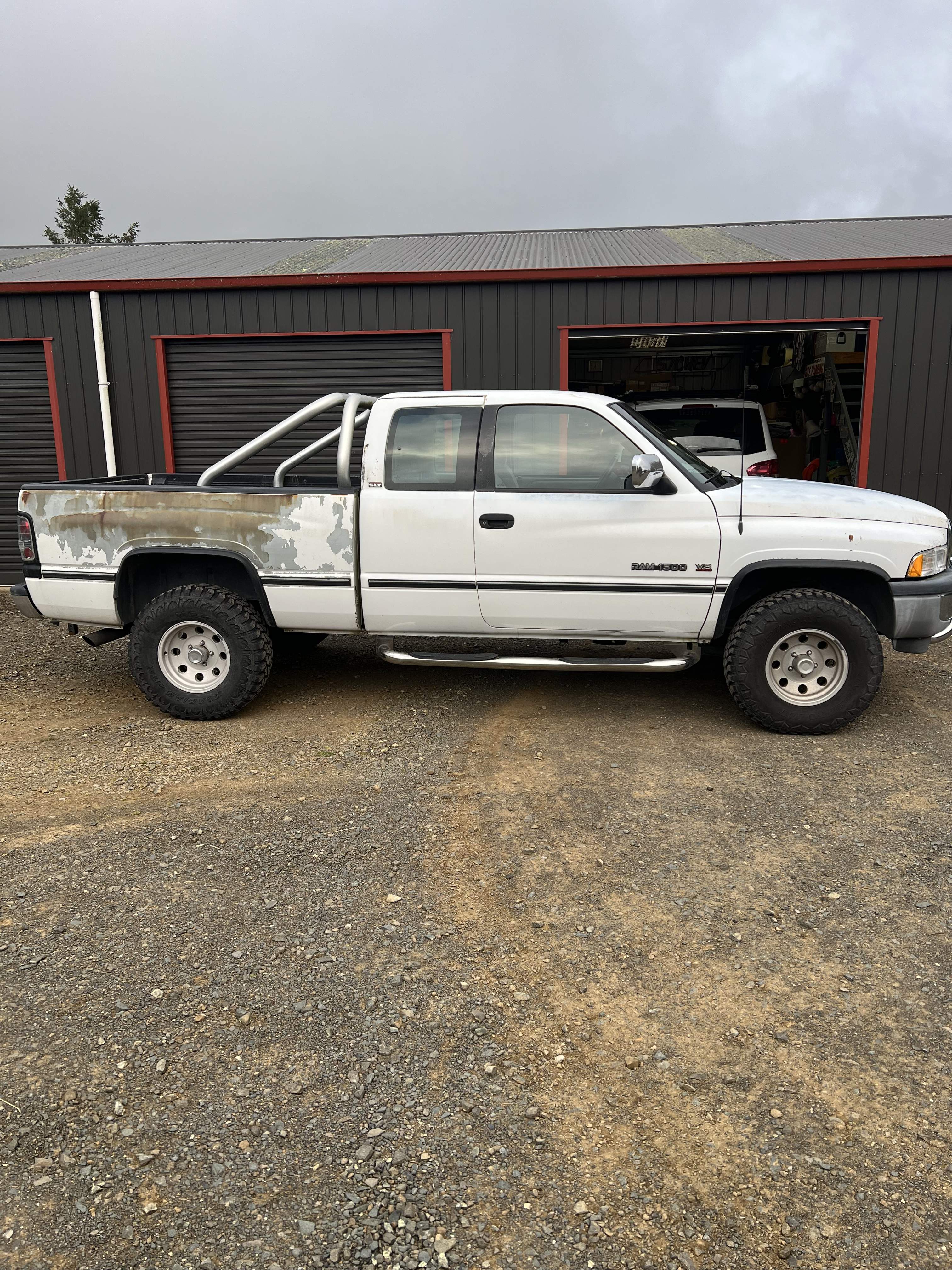

I am using my ram for a temporary work truck …

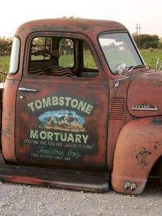

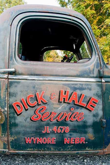

What I would like and you all can give me your thoughts … I want to come up with a cool old school signage to get out in the door of the ram …
Any ideas ?????
Hello Chris,
Please forgive me for these, I could not help myself. Hopefully, you have somebody in your family in the mortuary affairs business, forensic pathology or is a plumber. People really should set tough limits and constraints for me.
Rick
Number 2 above would be very appropriate for your business Chris.
poo GIF

Did you try an easy out? Looks like you wouldn't even have to drill out the center as the pic of the plug shows.
easier said than done mate, the plug hole is near 5 inches done between the cams and the motor is tucked under the screen so there is ony 5 odd inches above number 3 wich makes it very hard to get anyting down there. and it will be tight... very very tight.
i may still have a go at removing it, but not till i have new wheels to keep the busness going. fingers crossed i can get a new one sorted this week. its not fun working with out a complete kit !
Bad news my friend! Can you see the the spark plug hole clearly? If so & recognizing that the van is scrape anyway unless it's fixed. Rotate the engine so that piston is all the way down. Than take a hacksaw blade, thin it in height so it fits in the hole size of the broken spark plug. Shorten it in length as much as you can, but still have enough to hold on to. Saw the sleeve till it almost splits. Now take a awl or screw driver or whatever you can break the sleeve & curl the sleeve inward like opening a old style can with a key. Now using small needle nose plyers, the kind like they use circuit boards & continue turning the piece till you can pull it out. Retap the hole, if it works.

OK, one last thought! If you have a right angle drill, long enough drills, steady hands & a long enough tap. You could try this. Again lower the piston all the way down. Measure, on the existing spark plug the minor thread diameter. Whatever it is take a drill that is about .050 under that diameter, I.E. .025 on a side. First pour a little stoddard solvent in the plug hole. Now drill out the center of the broken sleeve. Now use a drill that will remove another. 015 total or a drill diameter that will leave about .010 total material inches hole without hitting the treads. Know use the tap to retap the hole. To clean out the debris pour more stoddard into the hole, rotate the engine to move the piston to TDC. Leave it there. Use a suction bulb to suck out all that you can & repeat once.
All that said, if you plan to dump the van anyway, than I wouldn't bother! Way to much work!

Judging from the pic, it's the threaded sleeve that broke, it's already Hollow. When you drive in the EasyOut or bolt extractor, it is set to bite in reverse. No worries of it going down the rabbit hole, and should back right out. No mess, no debris. Biggest prob I've ever had using them (EasyOut) or extractor, is drilling the pilot hole without messing up the threads. Sounds like the correct size extractor would be too short. Weld a correct size bolt to the end to add extension (as needed) it would already have the head to drop a socket on. Only going from what I can see in the pic, have no idea what your motor looks like. No pressure knowing your gonna junk it, worth a shot and bonus points if it works!!!my2cents
Edited by JUSTA6
https://www.bing.com/videos/riverview/relatedvideo?q=easy+out+bolt+extractor&&mid=AECD82E420A03CD5B5B1AECD82E420A03CD5B5B1&mcid=099F903AC5734750A8EAB2FFF65DA54E&FORM=VAMGZC
I would drop a torch head down the hole N heat it good, then let the tool go to work for ya.
