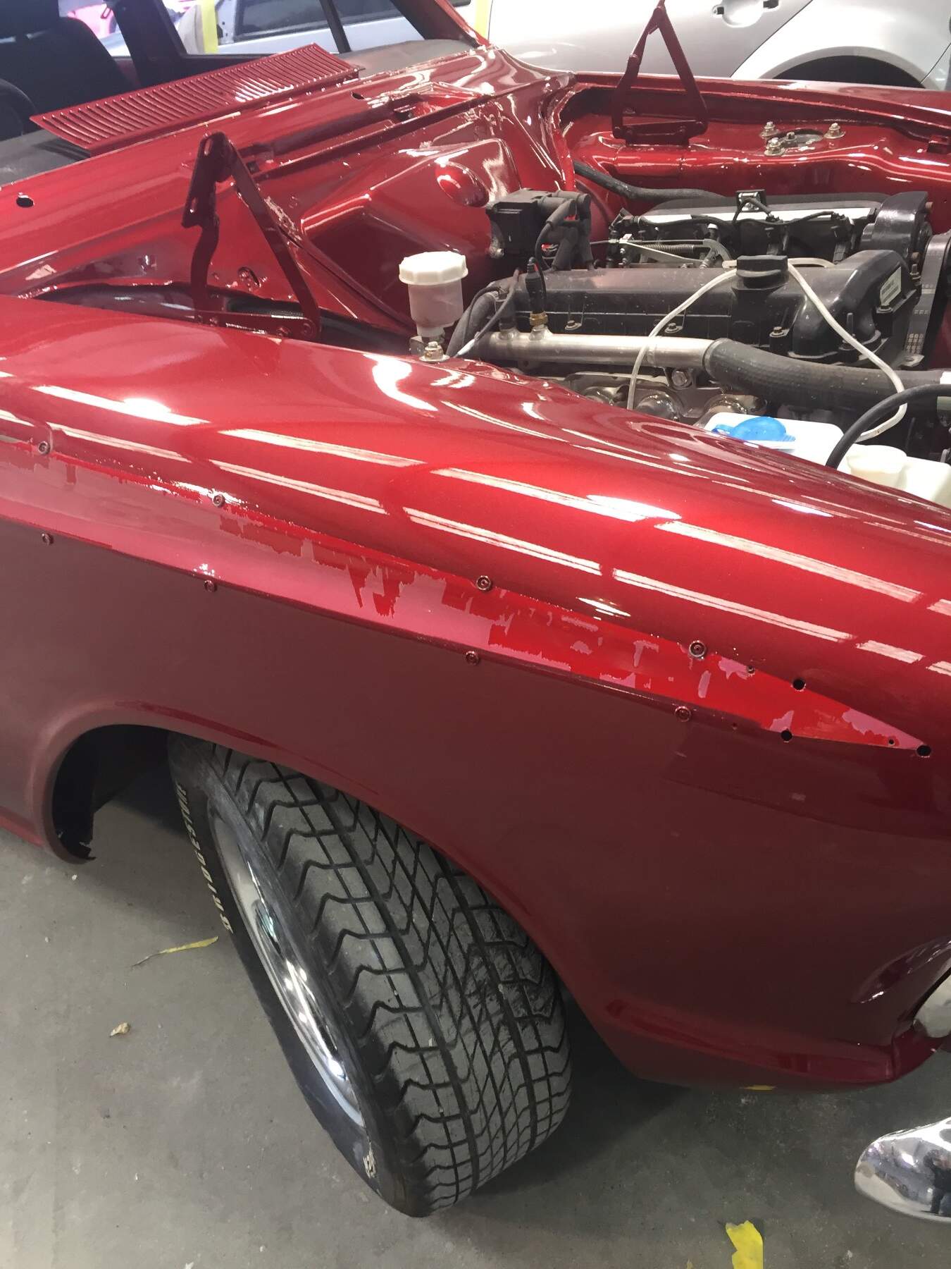

So i have the little cortina at the panel beaters getting the bent hood fixed and they called me, as they  had a issue..
They masked off the pink infill and repainted the dark red, and went to remove the masking and .....oh bugger moment . all the pink came off!!!! hahaha
now they have to repaint the infill... so i got to pick a boy colour... much to the boss's dislike !!! :rofl:
i will post a pic of the new paint !!

What i spotted was the pink had been sprayed over the top of clear coat... most likely a acrylic, and the clear coat has lifted... good old POS  ppg/ici dulux i bet !!!
Millions of nz and ozy cars had this clear coat back in the 90's and for the last 20 years its been pealing off !!

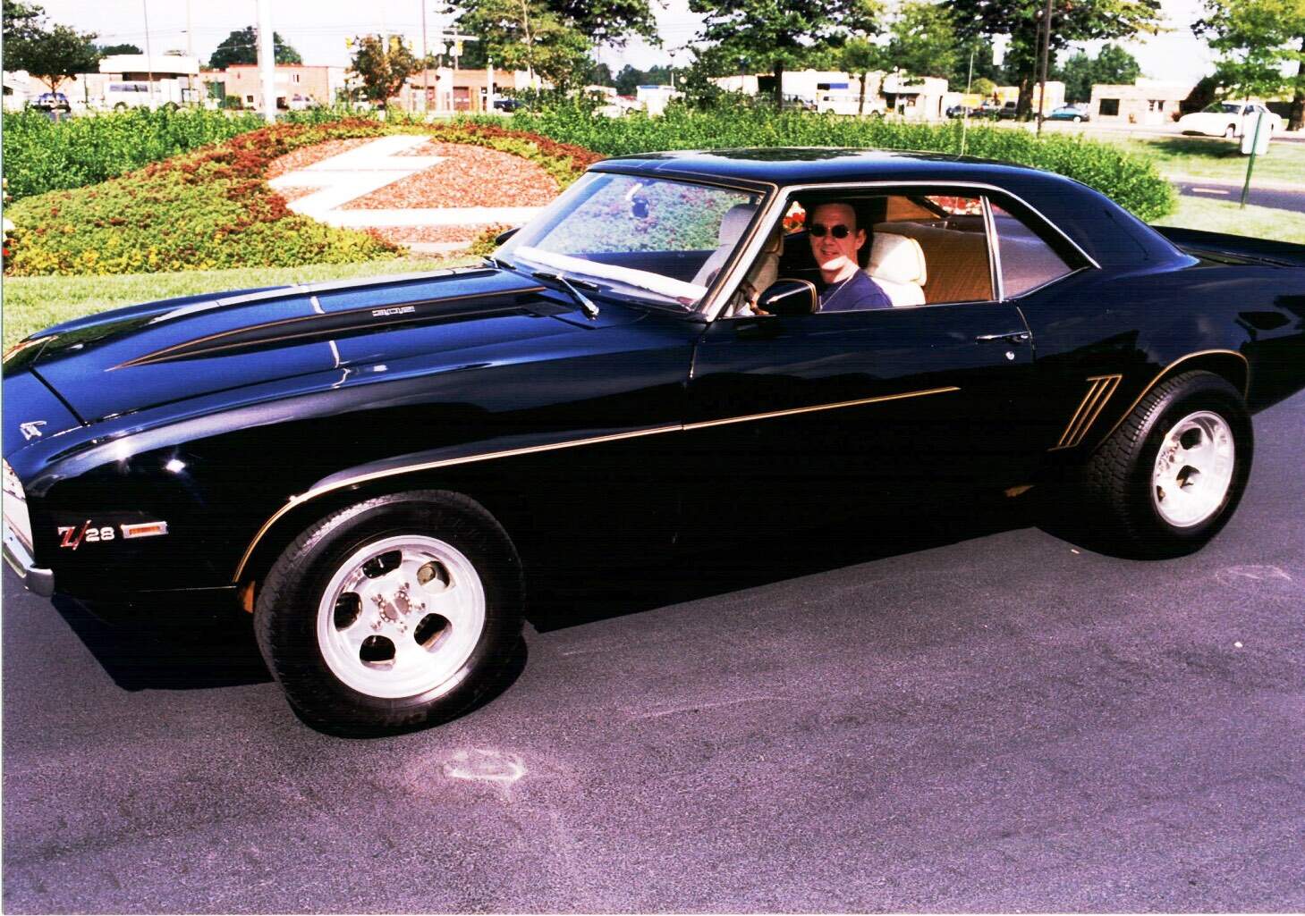

My “69” Z was black lacquer, no clear of any kind, but I used a gallon and a half of paint which means it was about 3 gallons thinned. Wet sanded and buffed out! But when I wet sanded it in 1975 nobody was using anything finer than 600. I used 400 than 600 than 1000 than 1500 because I knew from the type of work I did that was how you achieved a very flat surface. More often than not most people who saw the car and knew paint thought it had clear lacquer on it.
not the best picture to show a finish, but no digital in those days!

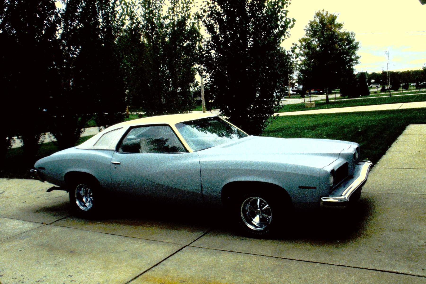

This was the last car I painted in lacquer. My '73 Lemans Sport Coupe in 1979 when I was 19 years old. I spent the entire summer sanding, bonding, priming, and painting this car. I finished painting it in early September. I put 7 coats of lacquer poly blue on, followed by 5 layers of clear. Two weeks after I buffed it out, some mofo at college keyed my car (both sides, along the hood and trunk too) while in the student parking garage. Of course there were no security cameras in the student garage but there were in the faculty garage. Bastiches! So I had to re-do the car the following summer!
