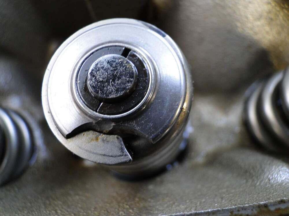

Update on the Pontiac. The lunati retainers were for an 11/32 valve stem so I found some Pac retainers also chromoly that fit. Got the right head back together and started reassembly and when I pulled the left cover to replace the retainers, this was waiting for me. Needless to say my decision to replace all the retainers was warranted. I plan to send all the retainers back to Comp and see if I get a response.

I am no metallurgist, but that sure looks like metal fatigue or metal sheer to me. So could this be improperly mixed or cast metal?
It is a metallurgy issue. For reasons I cannot even begin to understand a lot of manufacturers are going to tool steel. The one that shattered gives a better view, with the exception of the center hub I did not find a piece bigger than a quarter inch square. The lesson here is if you are going to be replacing springs and retainers make damn sure that the retainers are not tool steel because regardless of what they say about how good it is, tool steel is brittle. PAC still makes springs and chromoly  retainers for almost anything.
I wonder how many people there are out there sitting on a similar hand grenade?

In the case of valve spring retainers I just asked the manufacturer or looked on their website. Ruben over at Valley Head Service told me that a lot of manufacturers are going to tool steel and I cannot imagine why. So if the industry is swinging in that direction I can only say be very cautious. If for some reason you need retainers for something check the PAC website. They have a good reputation and seem to have springs and retainers for almost everything and mine are listed as chromoly.
