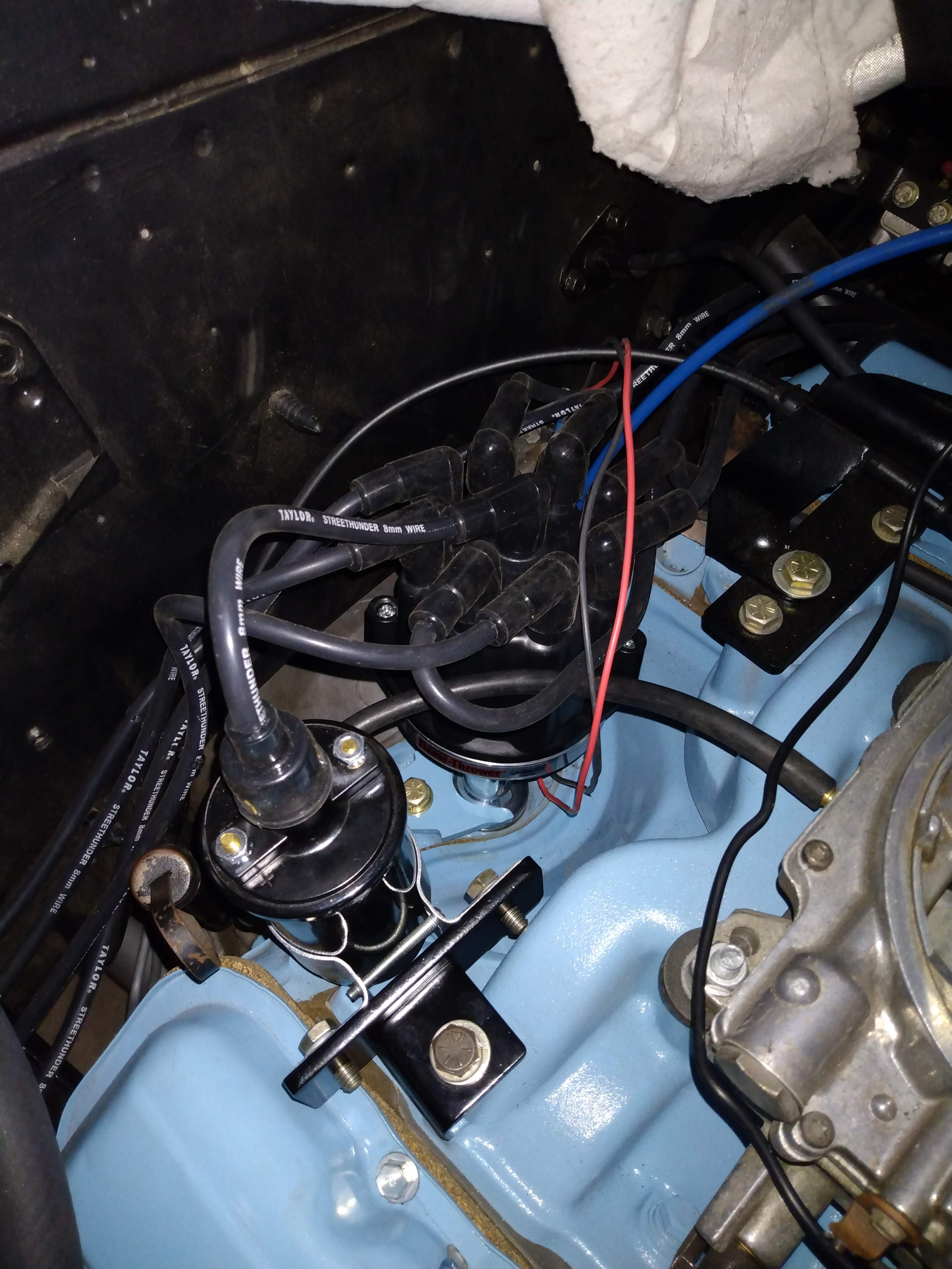

Finally got the distributor so i headed over to my buddy over the weekend and ran it on the test bench and it was right on out of the box.
Got it installed today and hopefully start up this coming weekend, not quite happy with the routing of the wires so may have to work on that later on a bit.

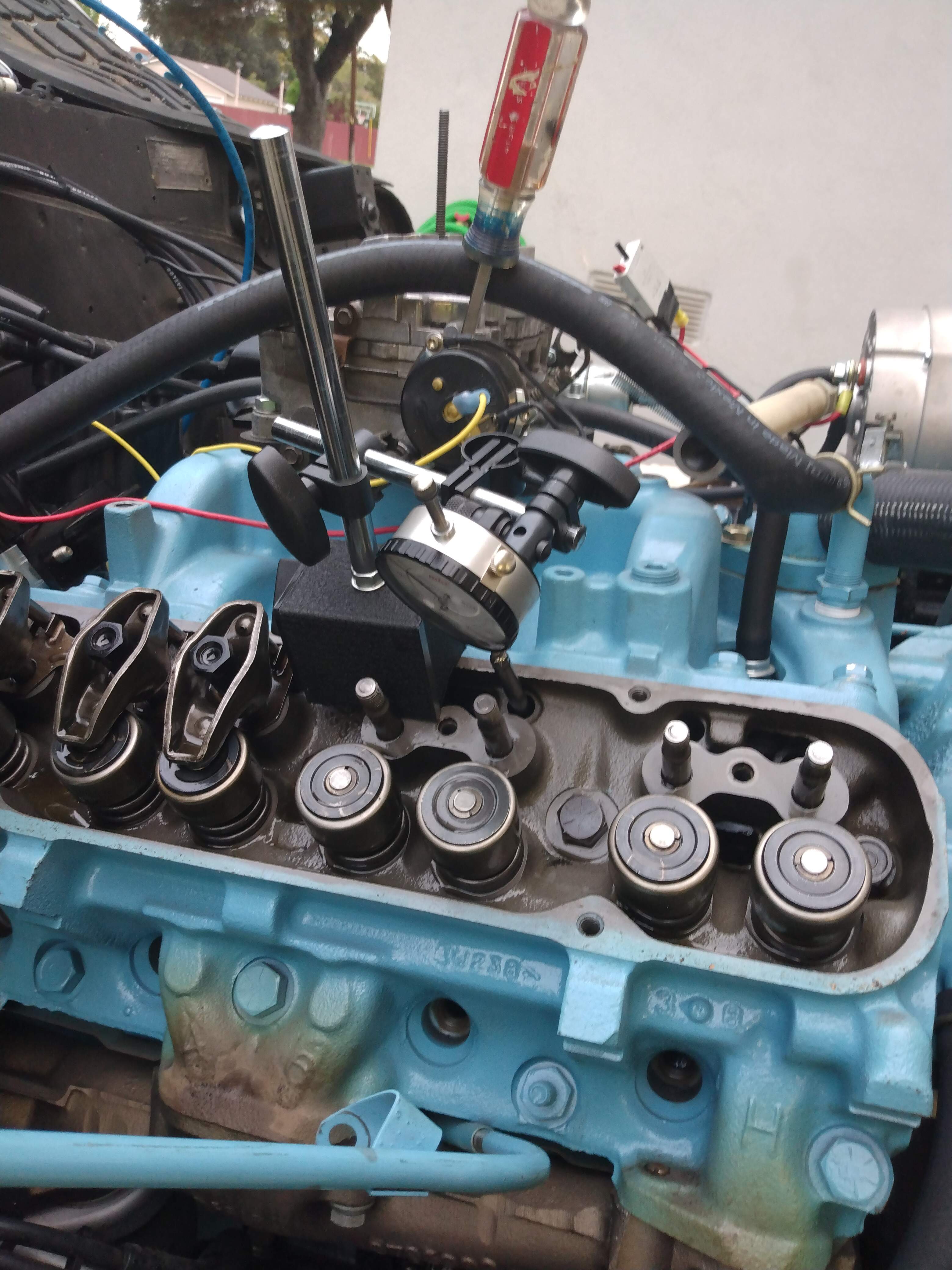

I know,yes that's just it how do you know what the problem is? Thought i did everything right primed the oil and gas, it started almost right away had good oil pressure and kept the rpm up for 30 min.
I'm having a buddy check the valve springs to see what the pressure is ( they are regular stock) should not be to much, i emailed comp cams and got the specs what they want it to be with this cam so we'll see what they are.
I might remove the inner spring during break in of the cam the next time and maybe use break-in oil instead, according to comp cams to much detergent in the oil is not good during break in.
Yes all good thoughts but why just 2
the cam guys should be able to tell you why .
also just check. Valve spring height when in location on the valve

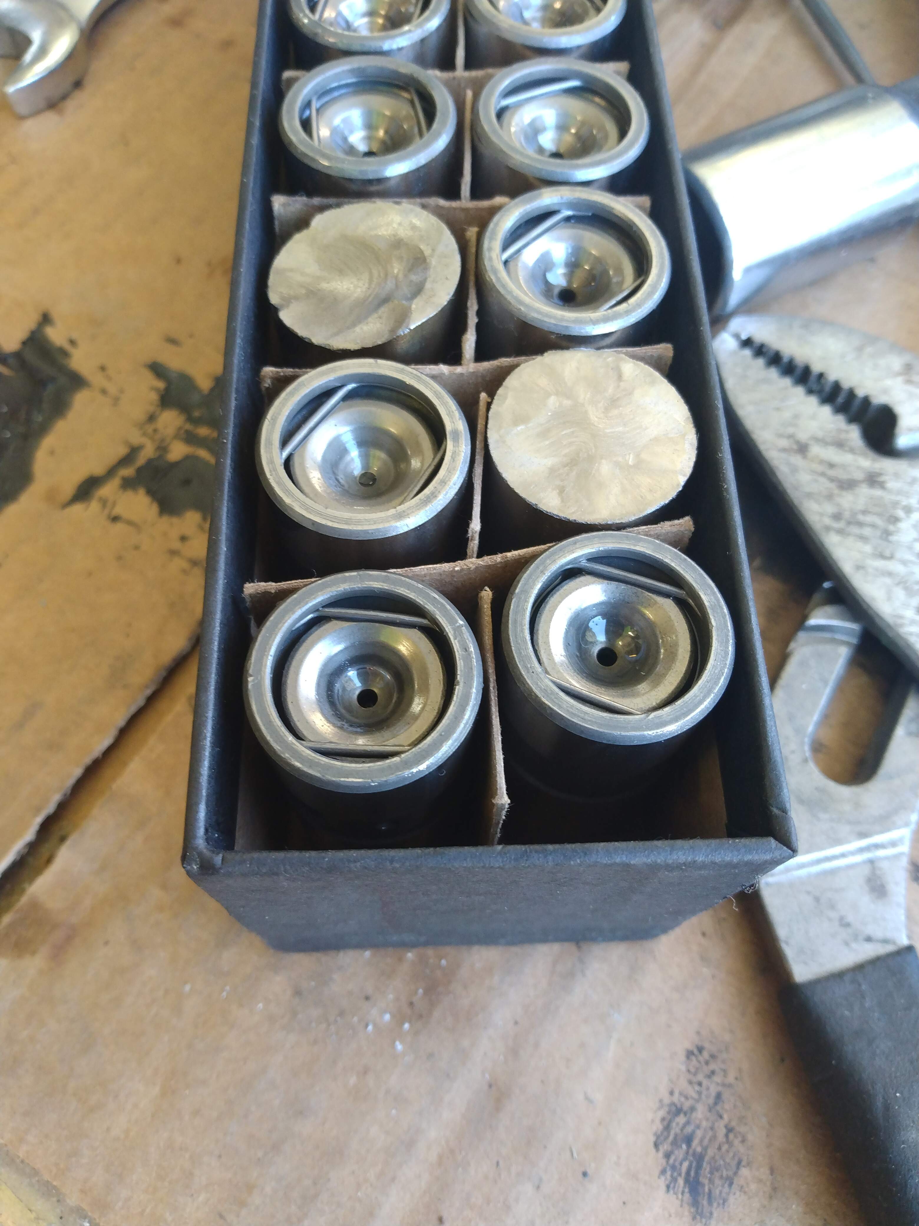

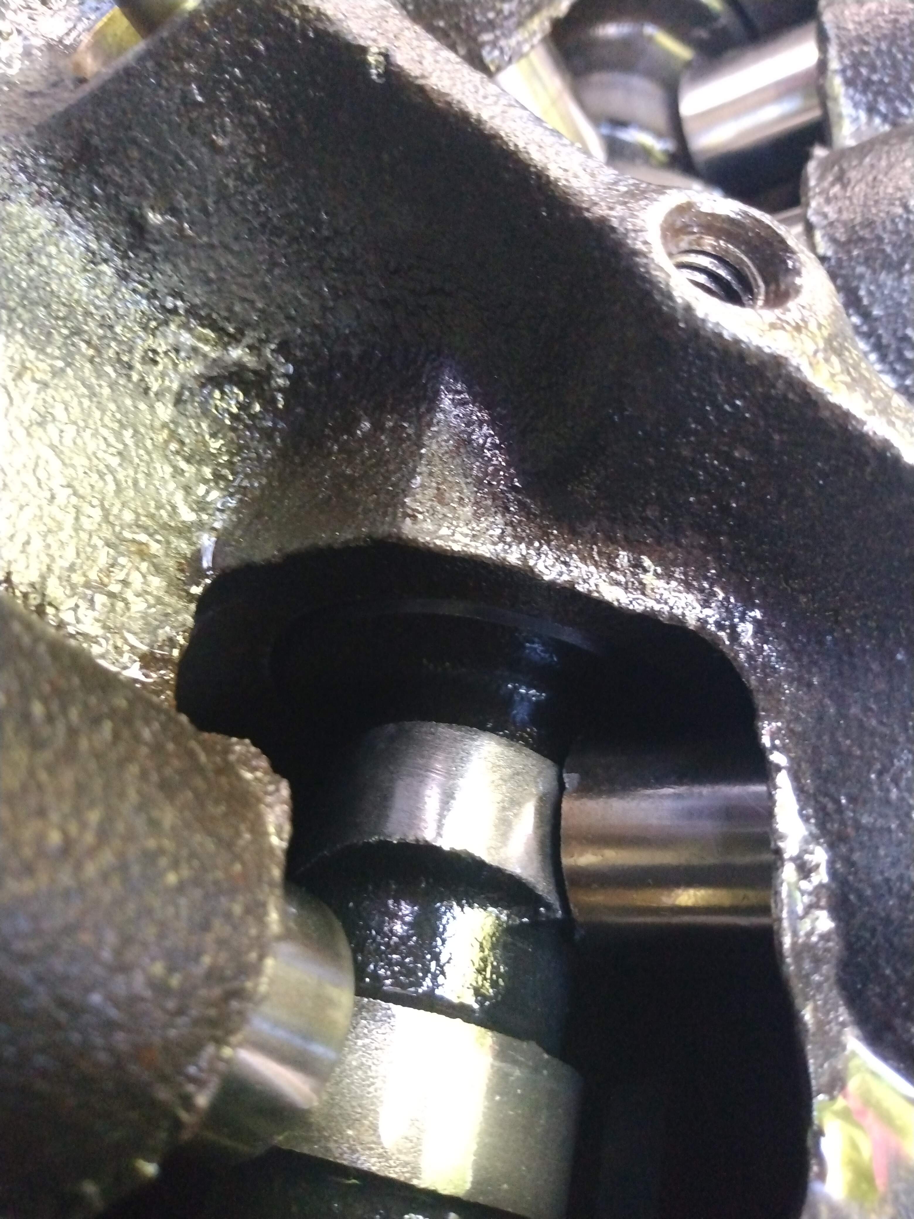

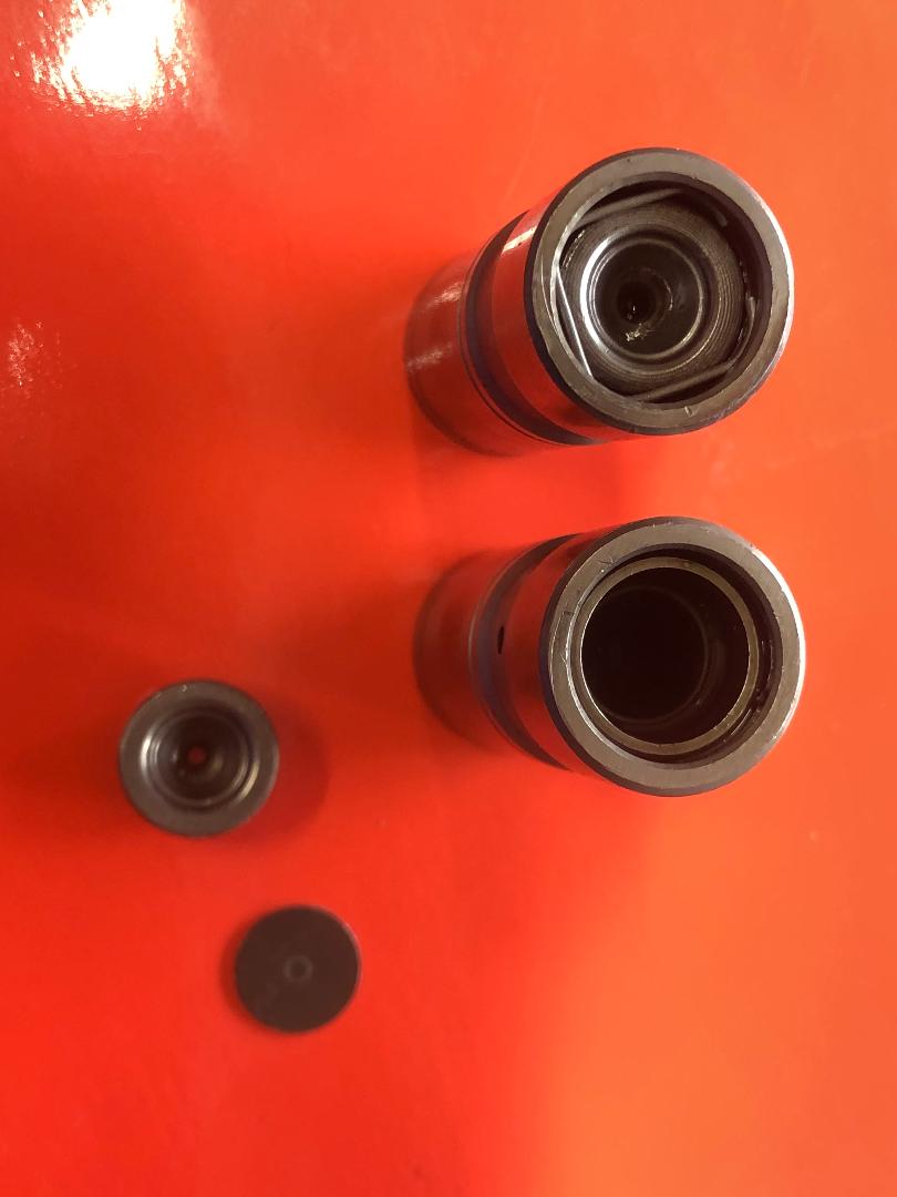

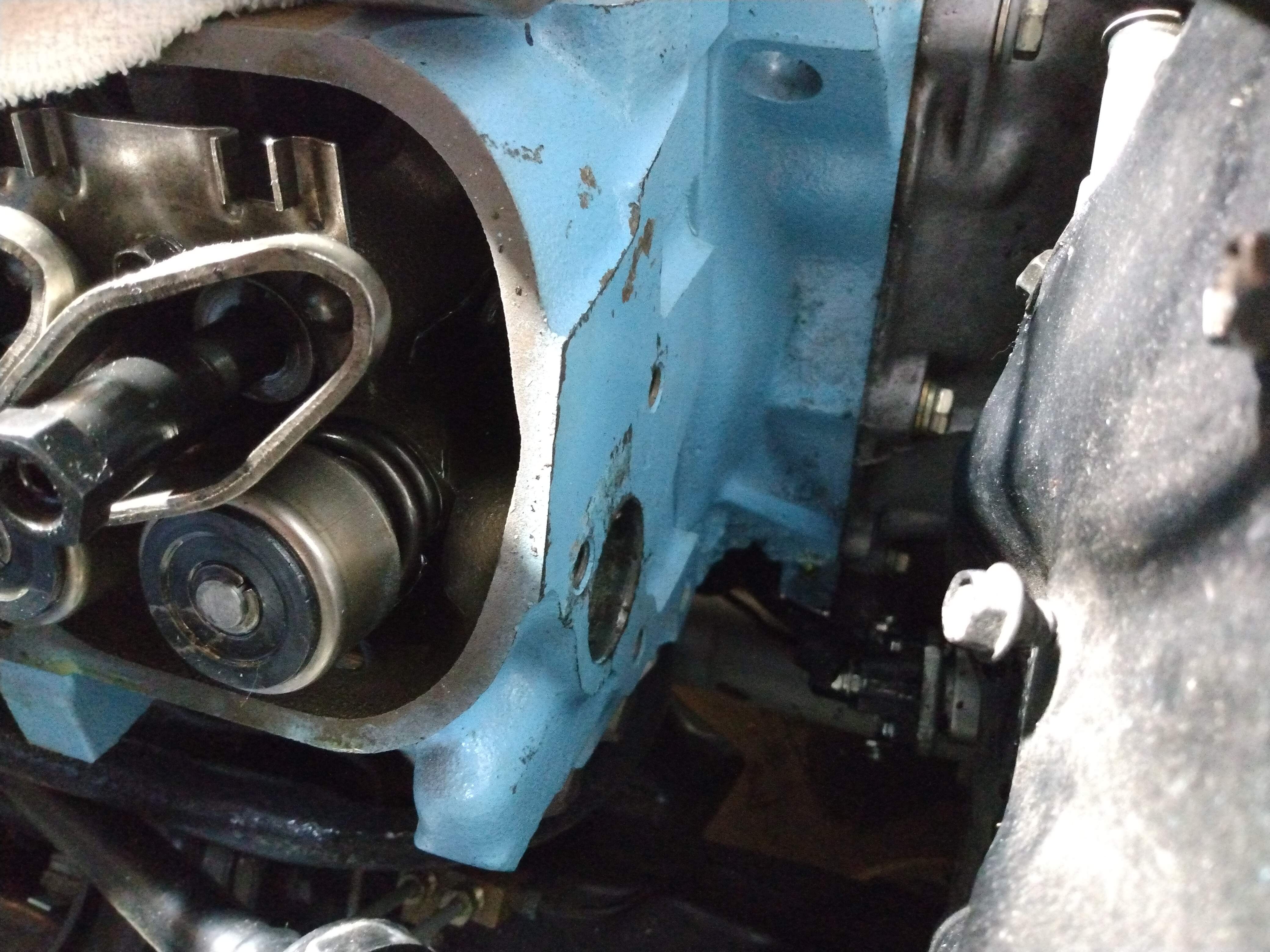

Did the lifters slide in and out of the bore easily?  Your lifters are constantly rotating.  From the pic's you have shown, those were NOT.  To dig in that far into the face and chip the edges of the lifter.  How does that even happen???  Noticed the chip in the pic with lifter still on the cam.  Did you send these pic's to Comp Cam?  Would like to hear what they have to say.  Sorry bud.
Thank you.
Yes the lifters had no problem turning or going in when i installed them or even afterwards.
Taking those two out i had to take the cam out and sliding down so i didn't damage the lifter bore.
You are right about not rotating, they must have gotten damaged right away and could not turn. Looking down in the lifter bore they are nicely offset like they are supposed to be.
Haven't sent any pics but the whole cam is going back, i doubt I'll get any answers back , yes it would be interesting to hear their take on it.

Yes that's the mystery, valv spring height should be ok, they are all pretty much the same and it's nice stock valves and heads.
Got going to have my buddy check the spring pressure.

Hey Andy, what did you torque your rocker arms down to? It probably has nothing to do with anything but when I put my engine together the tech at comp told me that since I was going pretty close to stock to torque the rockers to factory specs. HE told he that Pontiacs had no valve lash and to tighten then to 20lb. He was way wrong bro. Some of the guys may remember this from my post. I started up for break in and heard a ticking sound. When I opened her up I found 2 broken lifters. I figured it was something I had done. I put her back together with new lifters and torqued back to 20lb. This time on start up I broke all but 2 of the valves the engine. Pissed I called comp to ask for their suggestions and was told that I had gotten bad info from a "new" tech. The valves should have been set at 0 lash plus 1/2 a turn. Not sure if any of this helps or not bud, but good luck and keep us posted bro.

The 20lbs must reefer to the stock none adjustable valve train i assume? but when it is adjustable 1/2" to 1 turn past zero lash is usually normal and since mine is now adjustable with poly lock nuts that is what i did.

I don't know if this will help or not, but when I started my rebuilt engine it was 'clacky.' I figured that even though I had soaked all the lifters prior to their fitment they still might need time to pump up. I sat there and did the 2000rpm thing for 30 mins or so, then dumped the oil. I rechecked all rocker arm torques and they were all correct. I snugged them down an extra 5 ft lb (from memory, they should be 25 - 30?) and it still sounded clacky, but not as much. Anyway, as time passed they settled down and there's now just the lightest ticking sound - not enough to worry about. My point is that my stock lifters appeared to have needed some time to pump up fully for whatever reason. As far as oil went, I just used regular mineral oil from an auto parts supplier.
It would seem that not all aftermarket parts are reliably made - it's almost a given that you'll get some duds, especially in a pack of 16 lifters. As an example, one of the Ames supplied AC Delco spark plugs I bought as part of a kit - the insulator cracked on the spot whilst I gently handled it. Aftermarket fuel pumps are also apparently notoriously fickle when it comes to quality control. Good luck.

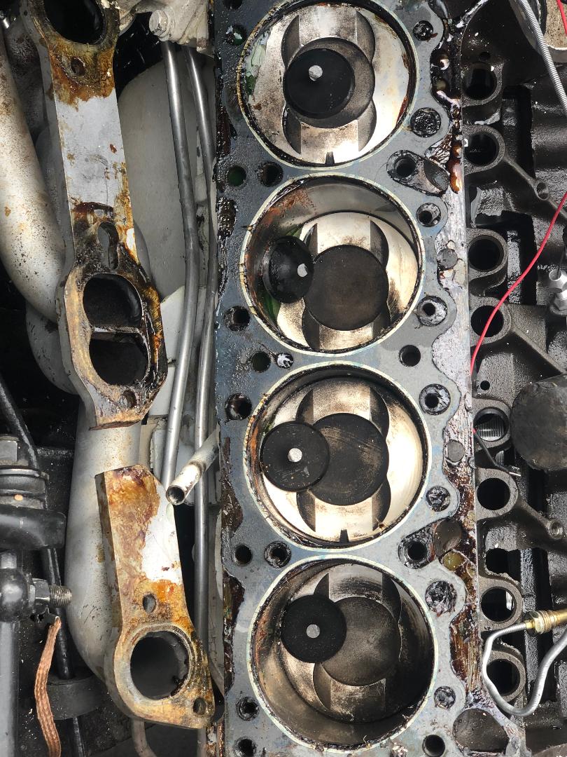

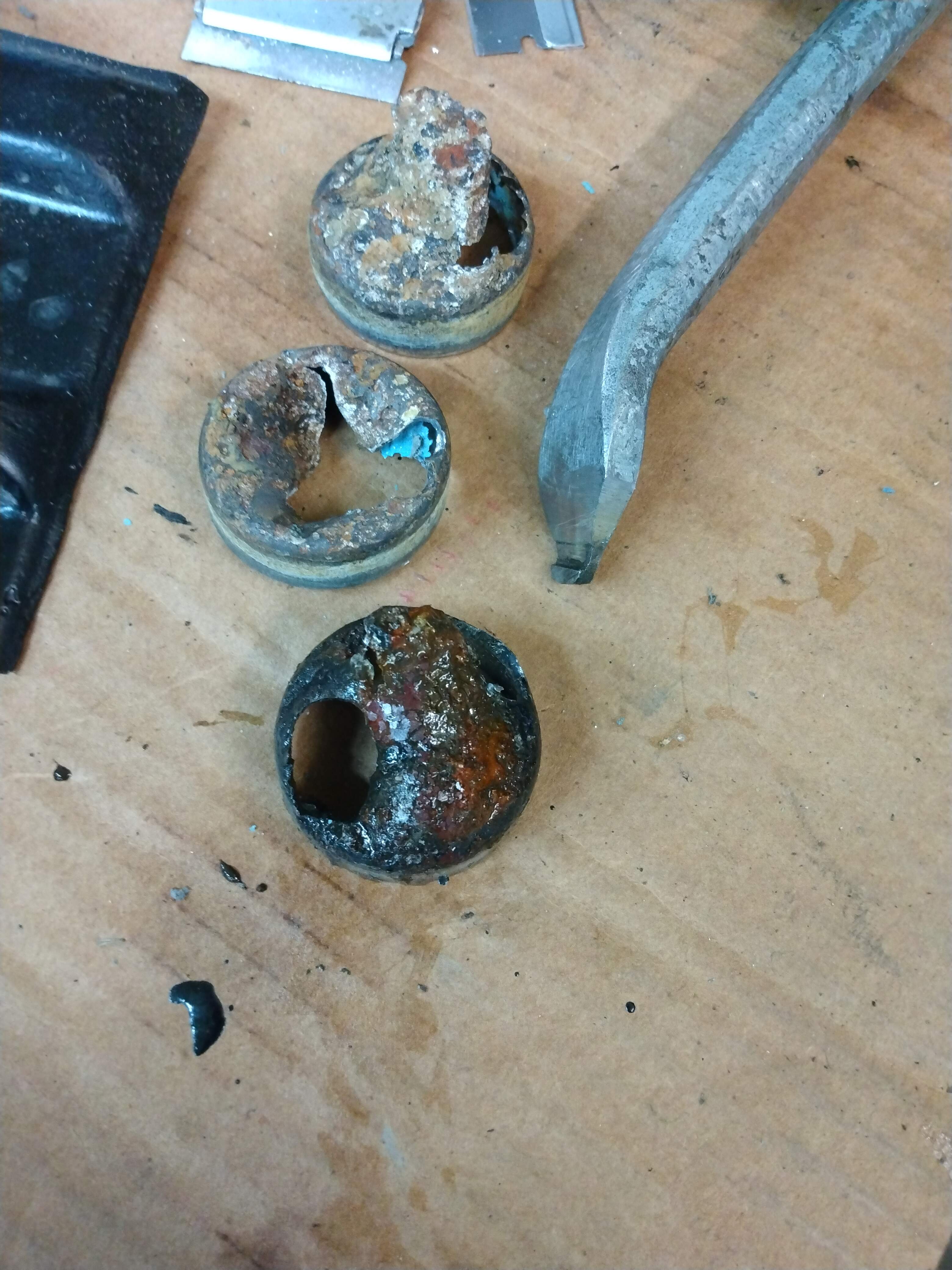

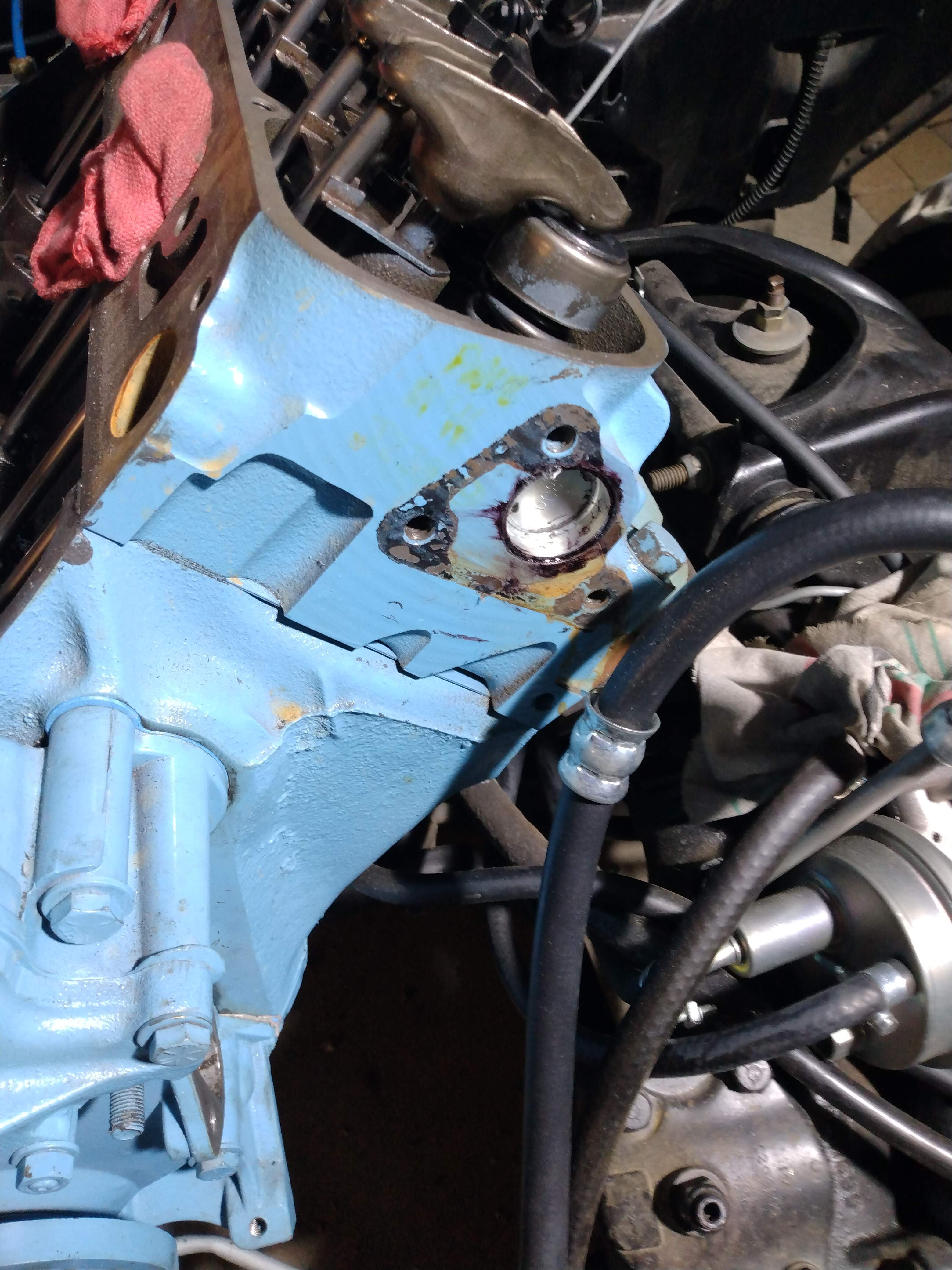

Finally got all the parts and started to put it back together but first i decided to replace the freeze plugs in the end of the heads, had one leak right away first time I started it, don't know why i don't think about that when the heads where off since i did the other ones.
The one in the back on the driver's side was interesting to get out it took a couple of nights but i got it
