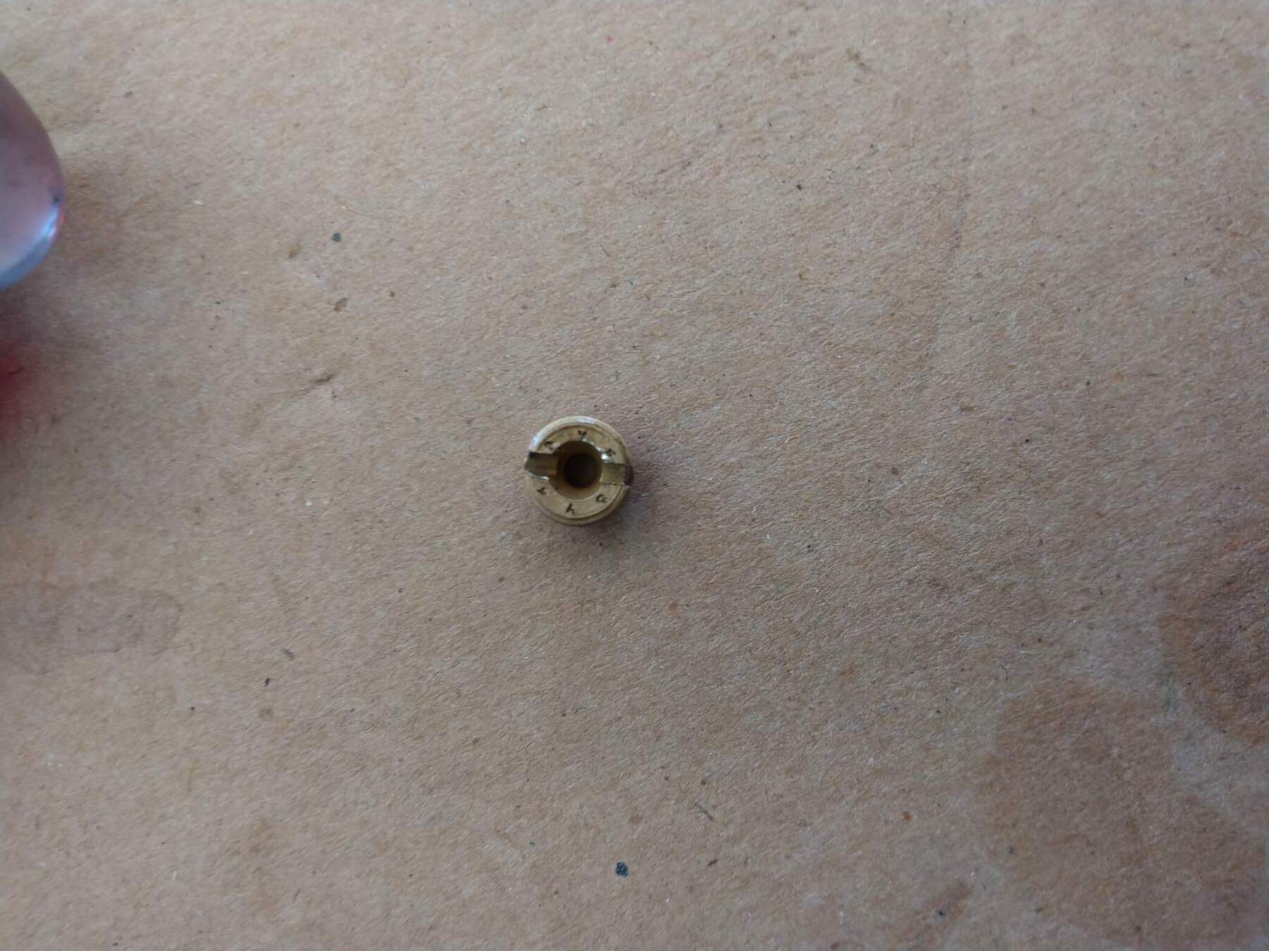

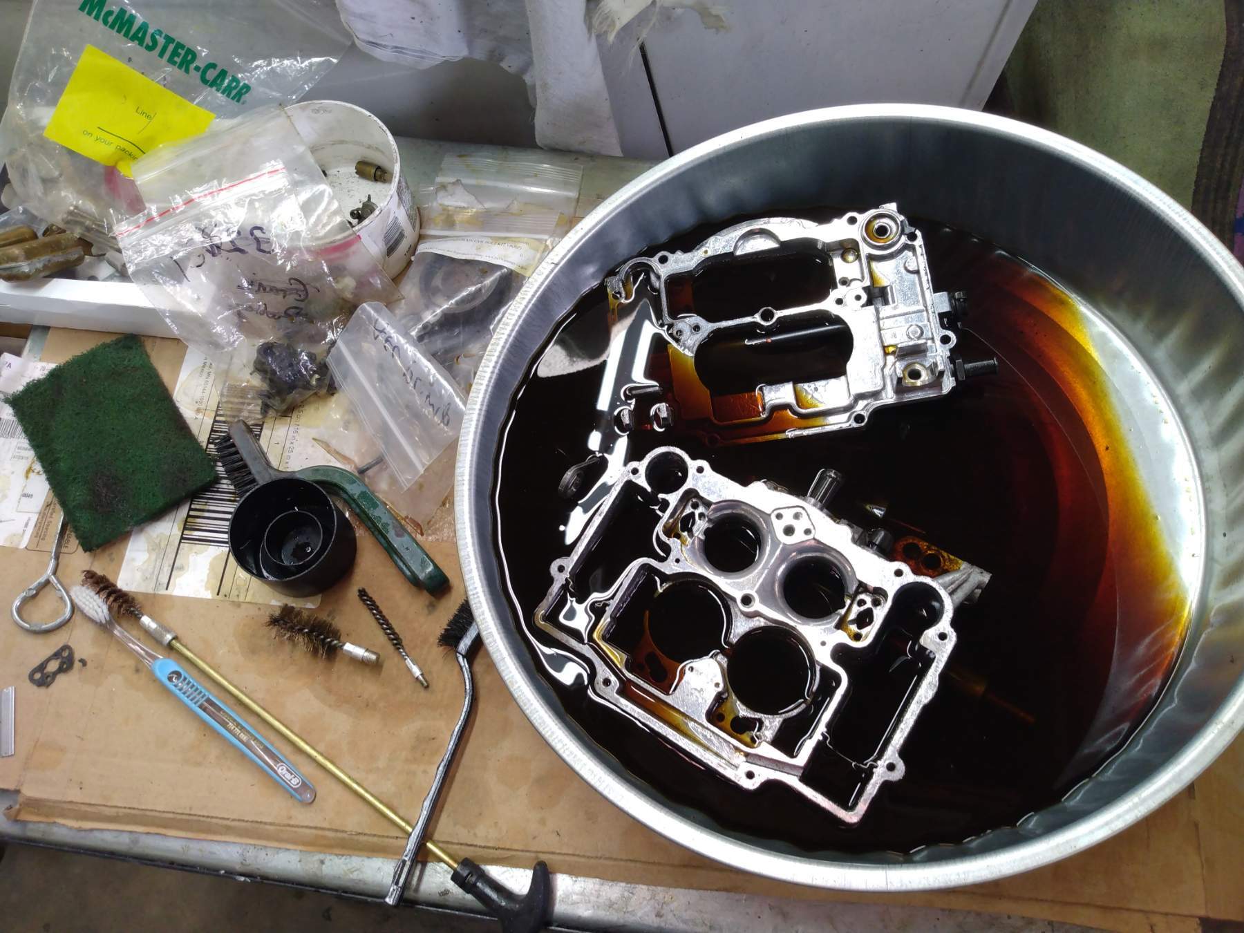

Started to put the Edelbrock carb back together after cleaning and figured i would record the size of the jets for primary and secondary do i know later if need be.
But how the you know what do you read the damned numbers on those? Goggled it and it doesn't help much because the numbers are soo SMALL.
36 minutes ago, 64 kiwi boni said:
i use my cell phone to take a picture and then blow it up Andy!!
I guess i need a better phone 😅 cause i still can't make out what it says.

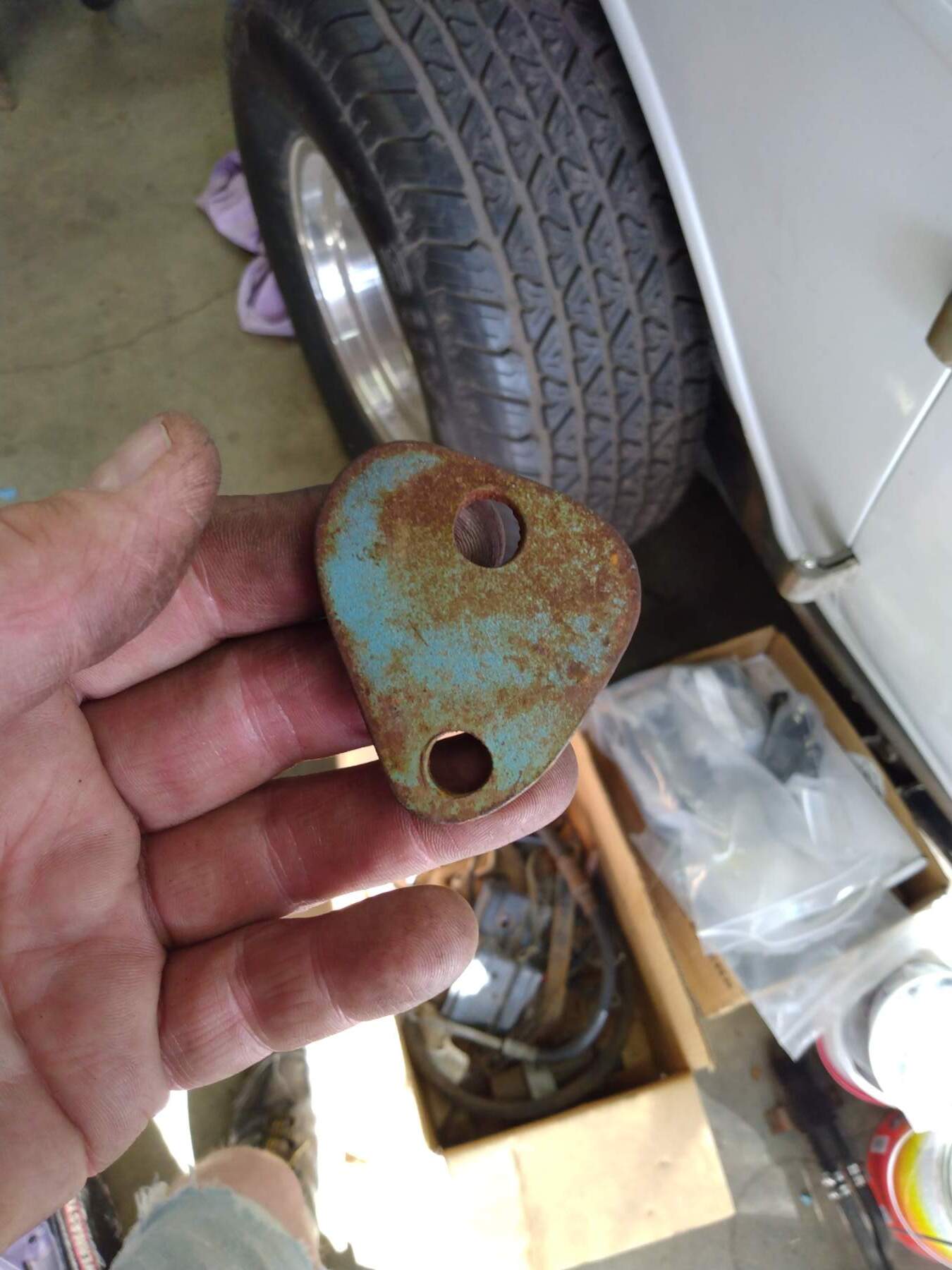

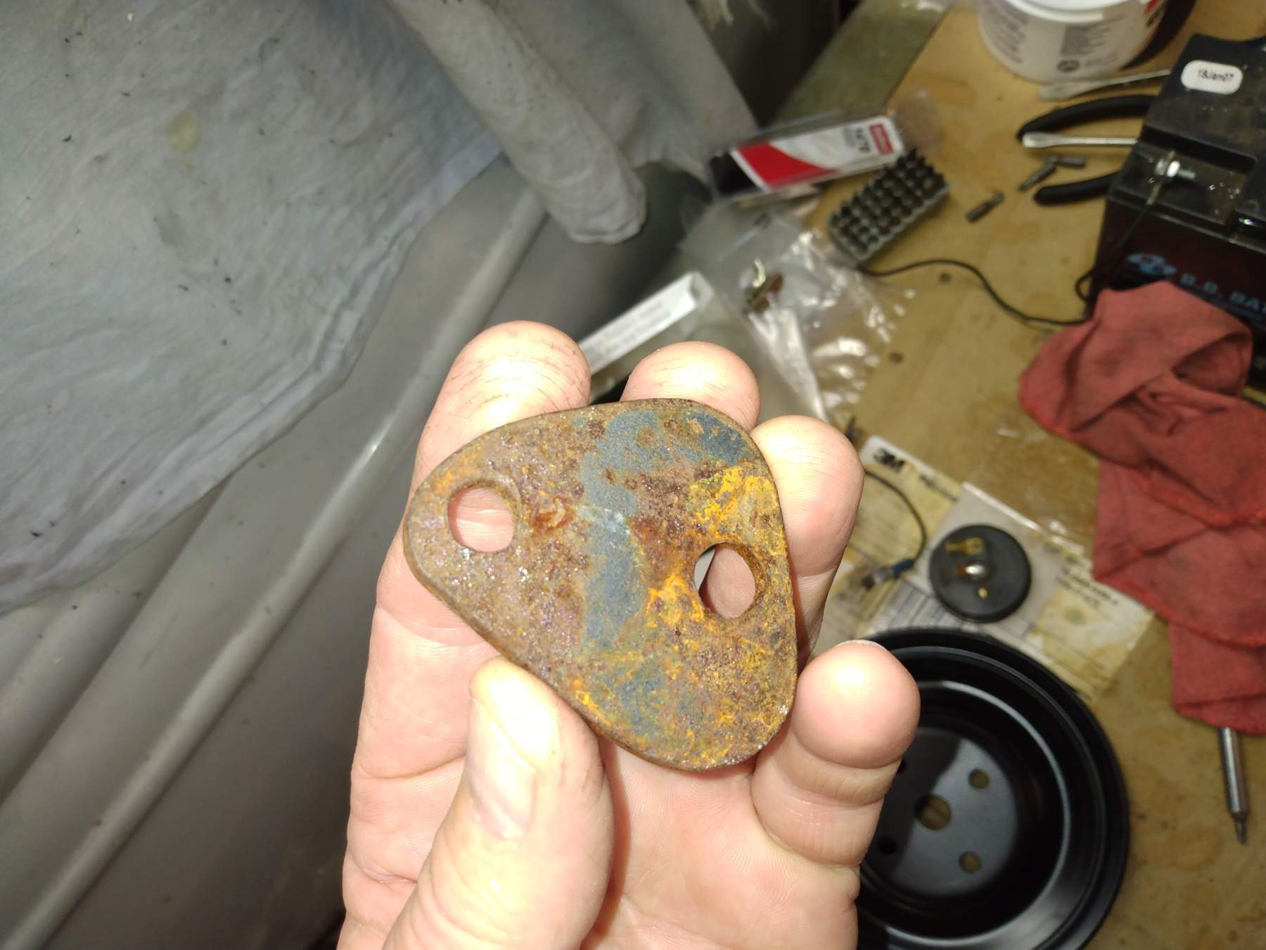

Ok smart people, found this one in one of the boxes of parts that came with the car.
What is it for? Did i forget to put it on?
Looks like the Mechanical fuel pump blockoff plate.
It does but the bolt holes don't line up with that.
No mate it’s bolts are wrong
Andy does the other side look like its had a gasket on it ?
i am thinking it is a intake manifold blank plate
No gasket, looks like it was part of a bracket or something, what got me was the fact that it has engine color. Here is the backside.
hmmm, thats a tricky one mate, must have been a custom bracket for something on the engine !
Could be the carb choke block off plate?
It'sa book mark.  So your Chiltons don't keep flippin shut.
Yeah, for now it might just have to go back in to the box where I found it 😄
Then it's a paper weight.

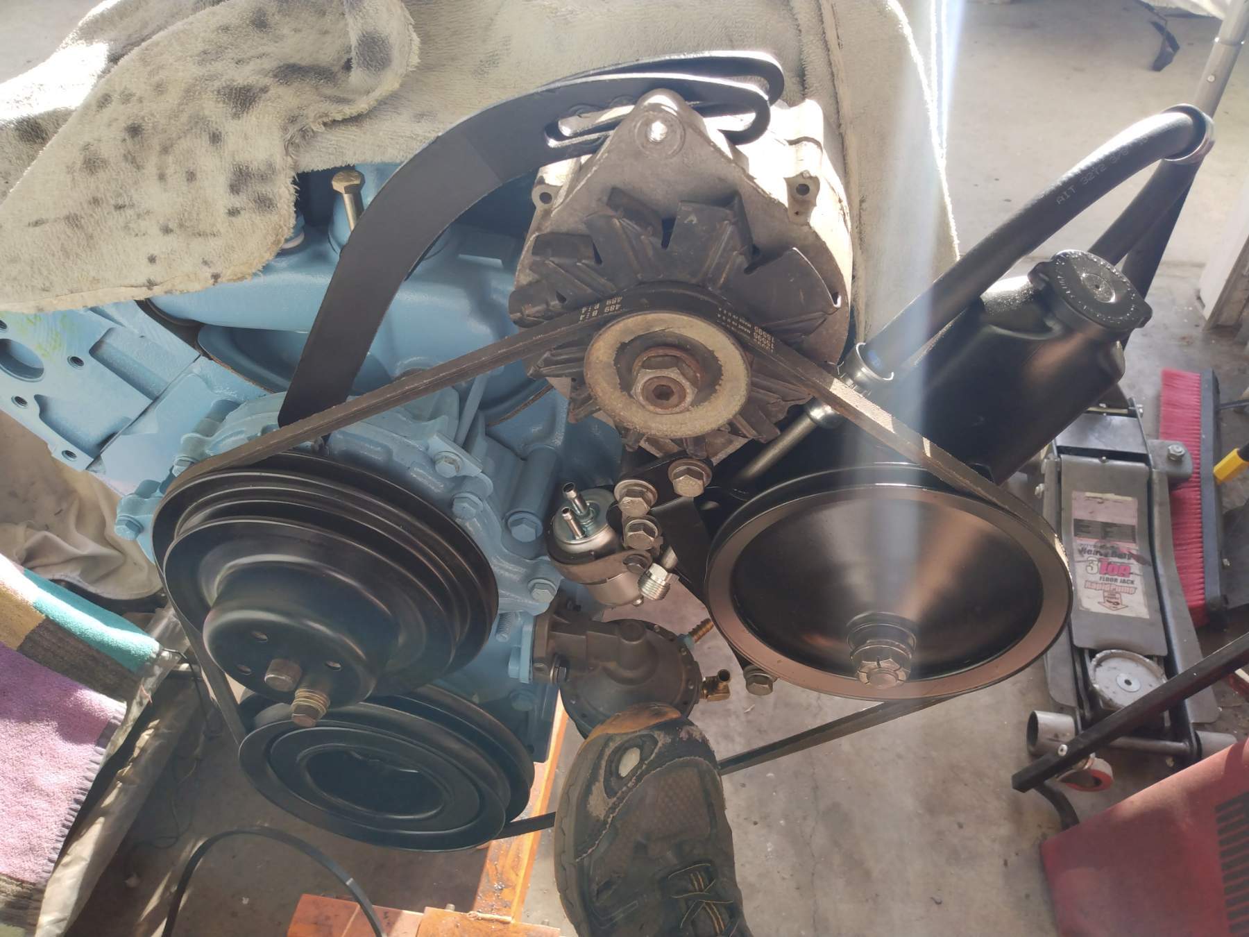

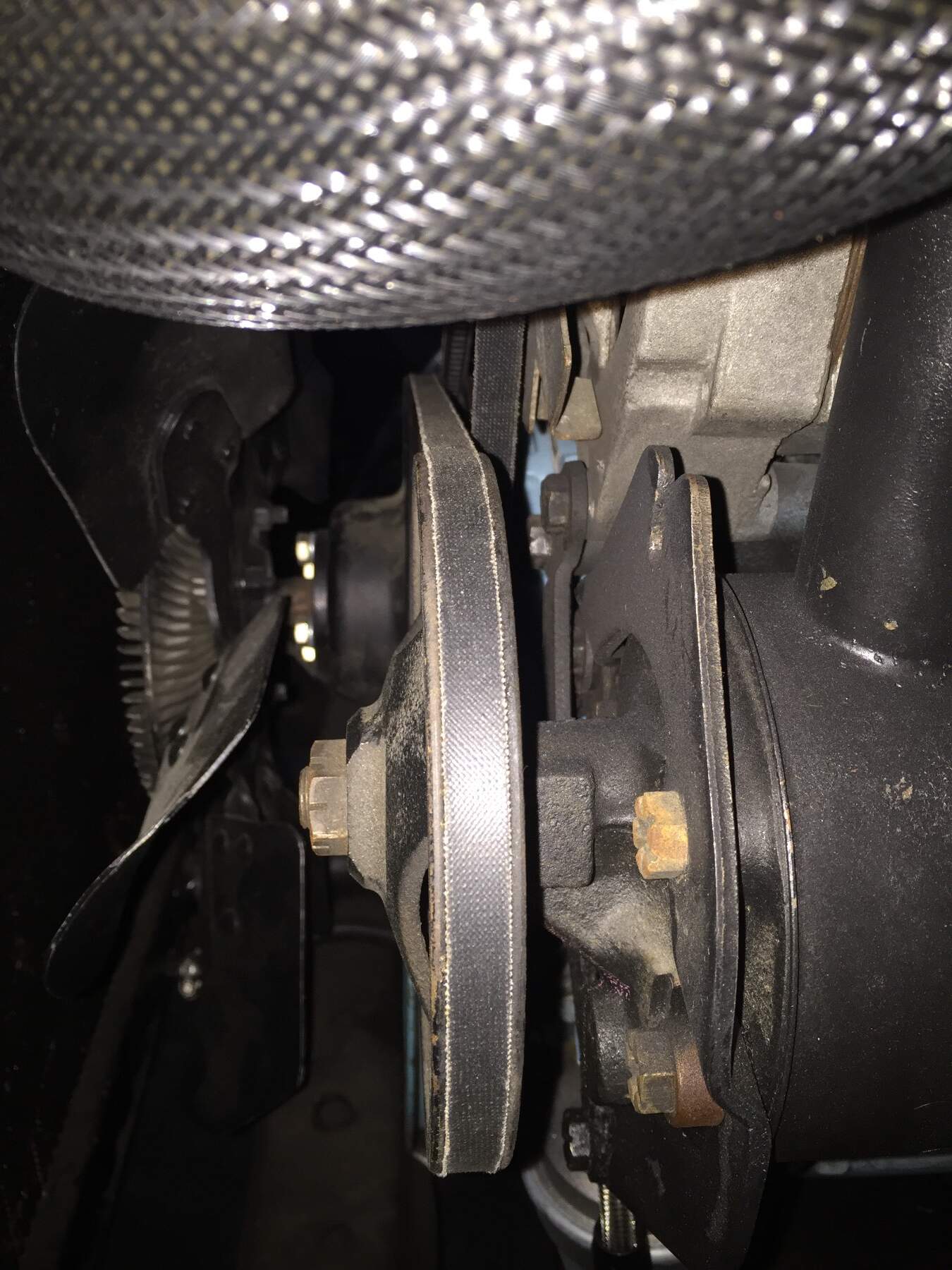

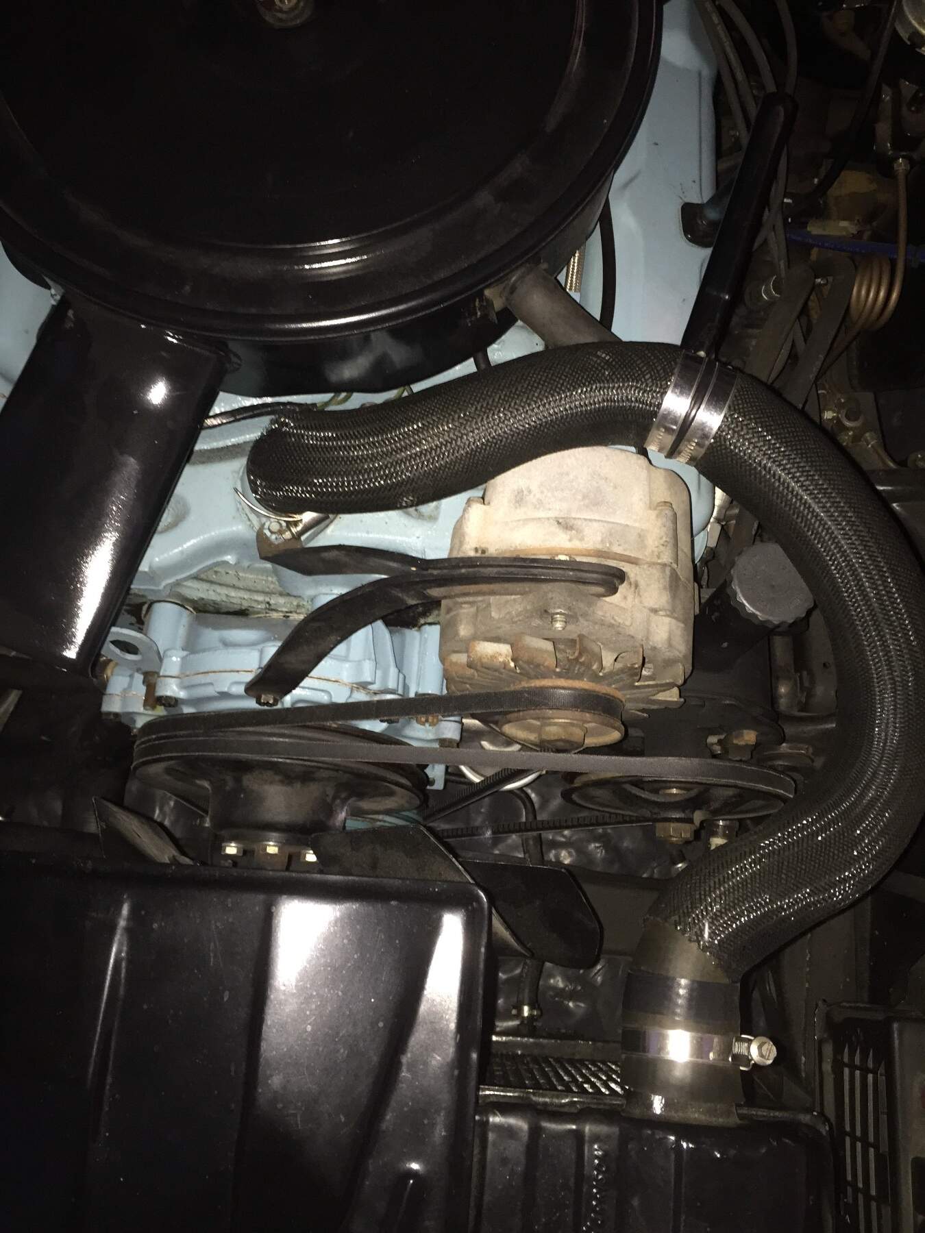

 Got the alternator and ps pump mocked up an realize that there's only one belt driving the alternator and ps pump, the alternator don't have very much wrap, is it going to slip? Especially if I install a higher amp alternator.

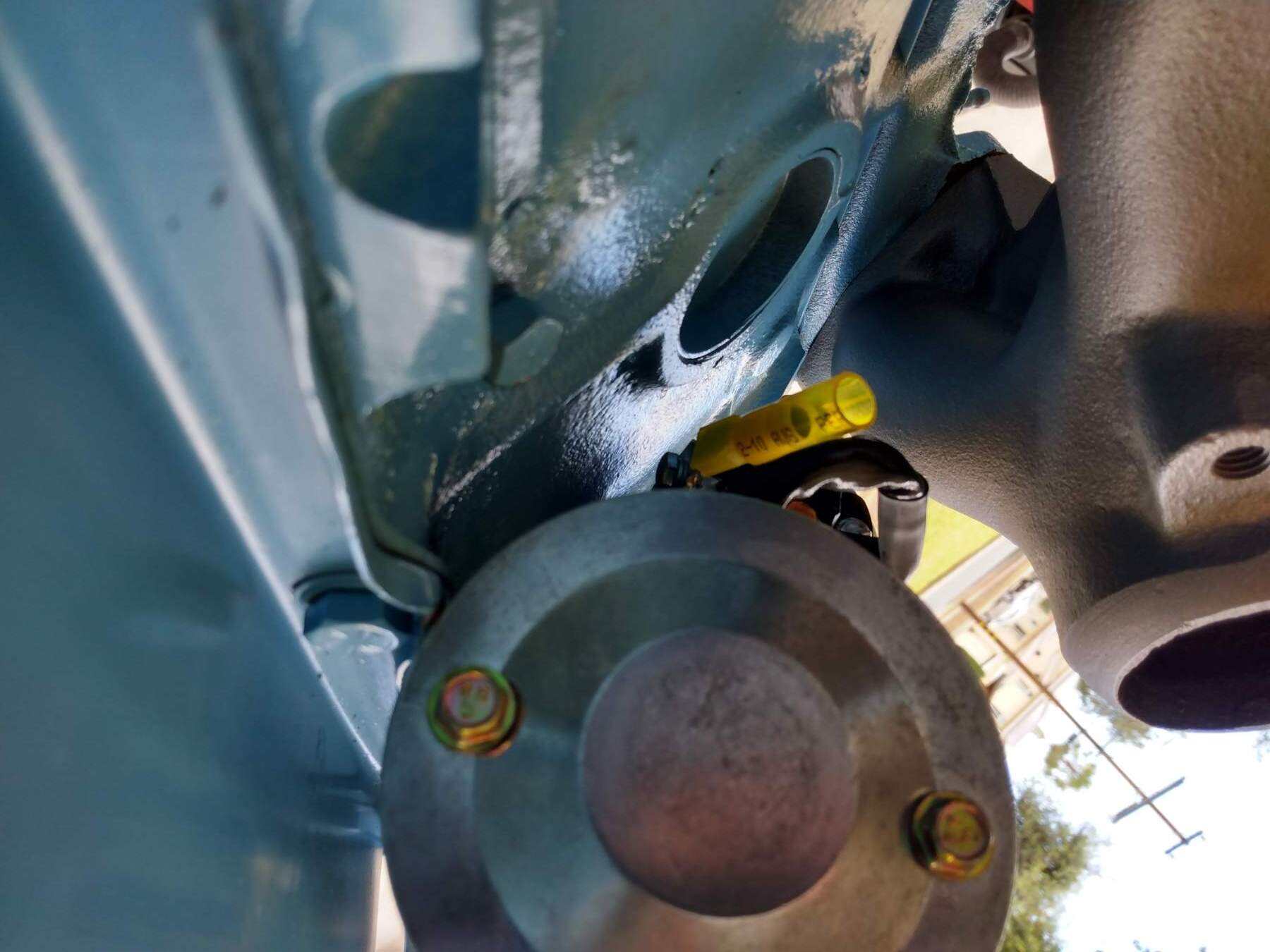

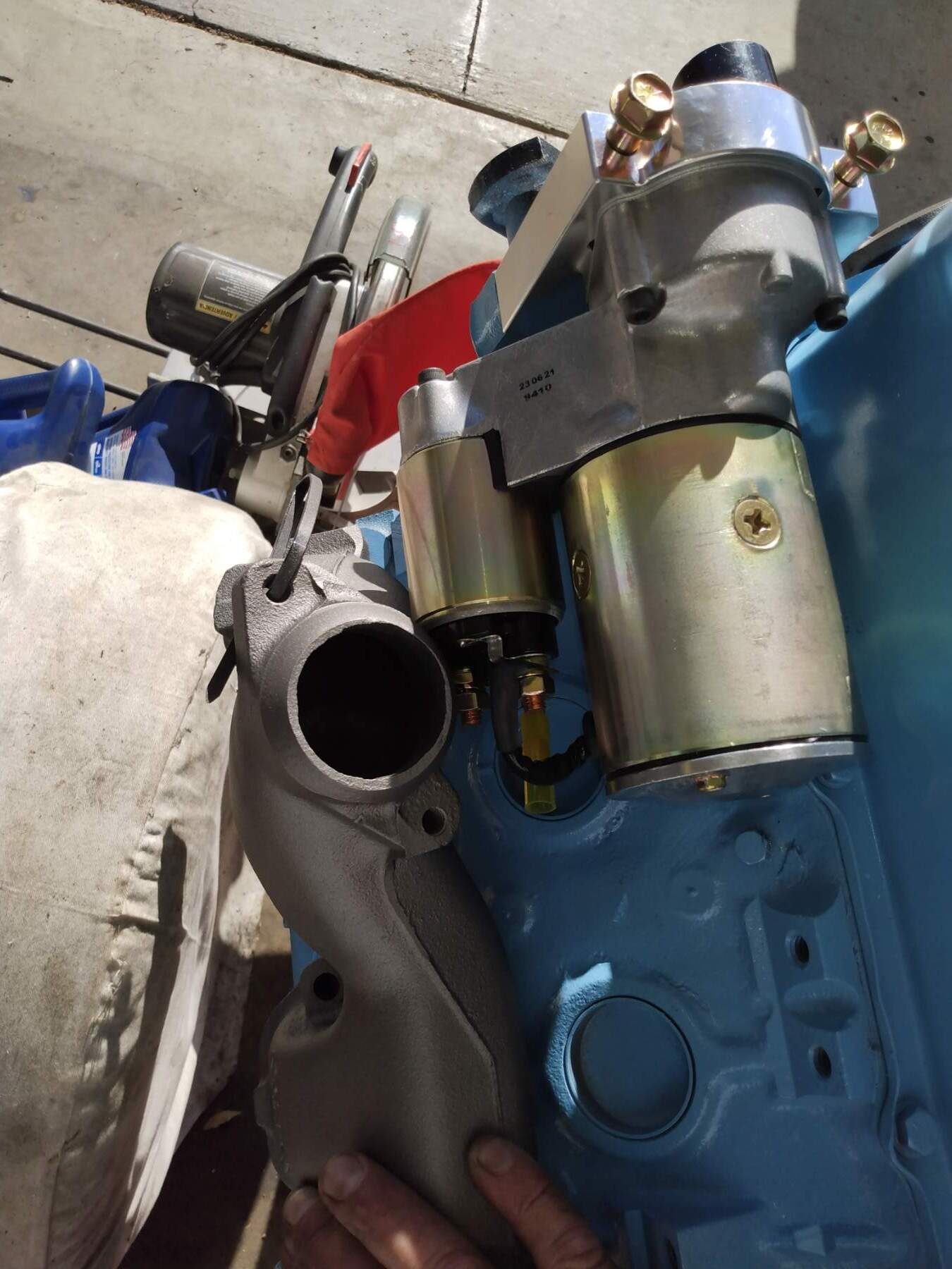

Tested the power master starter i got from my buddy but it doesn't work.
It can only be clocked in two different positions and in one the solenoid hits the manifold and in the other the housing hits the pan rail.
So what mini starters are you guys using that don't cost a small fortune?
That belt will slip mate, you need the twin pulleys and a separate belt on each 👍
i cant help with the stater as i use a nz built roadrunner one and it mounts to my bell housing
https://www.roadrunner-starters.com/collections/automotive/products/rs123
and i could clock it to any position, which is the key !!👍
What's wrong with the factory starter? I installed an El Cheapo remanufactured unit that I found for $30 and it turns my very tight engine over effortlessly - I can barely turn the engine with a socket and cheater bar on the crankshaft pulley nut myself.

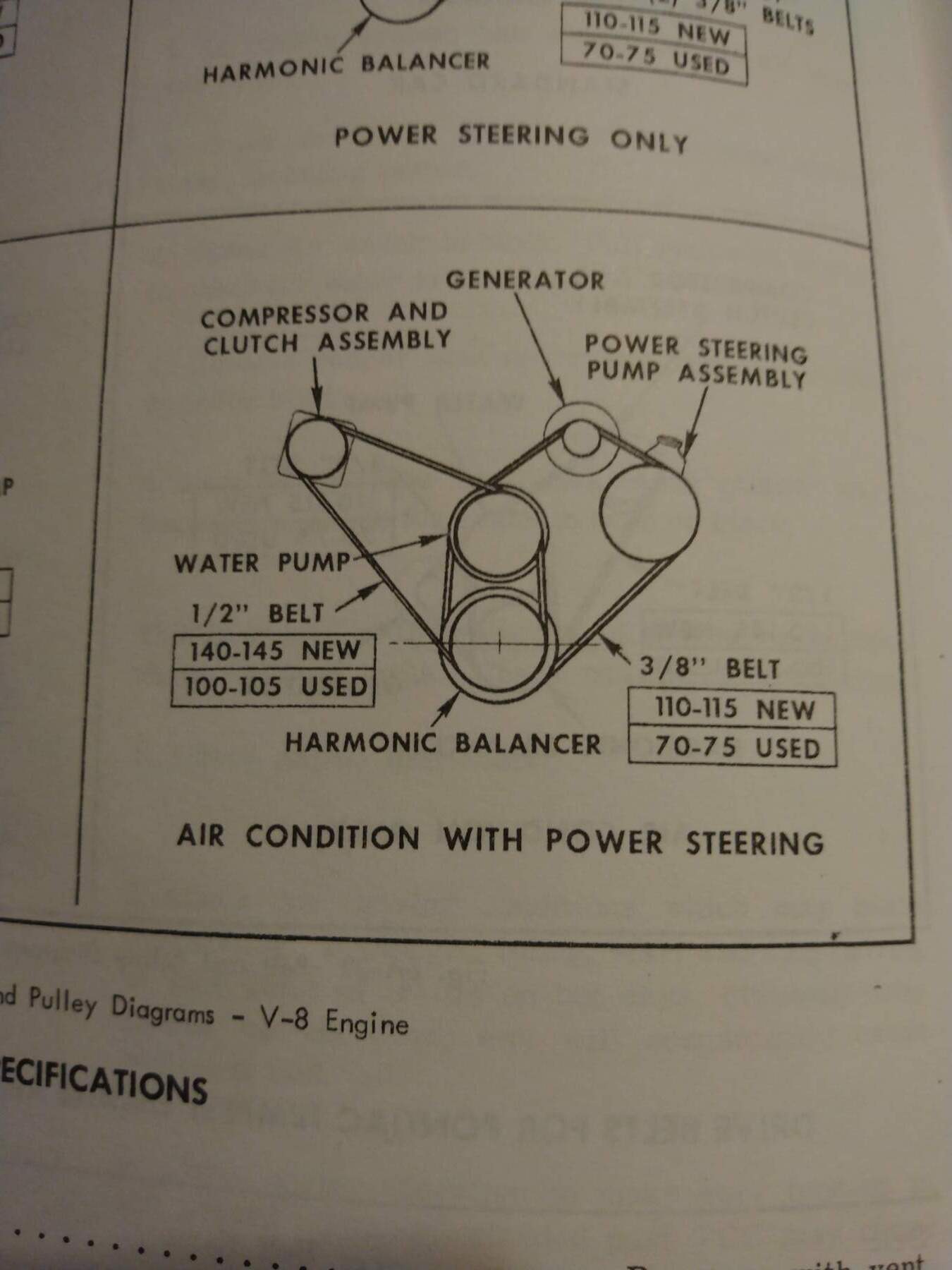

Apparently this is the factory setup on a ac car in 64 and 65, there was supposedly a different set up earlier that year.
I'm going to give it a try and see how it goes, apparently it's important that you use the right belt.

I think I have figured out what starter to get, power master 9510.
I was going to use the factory starter but that didn't workout so i figured this is the time to upgrade.

Andy, you may be aware of this but I converted my fullsize GP from power to manual steering. The steering effort, even at standstill is minimal. Sure, it takes 58 turns of the wheel to get around a corner but the factory power set up isn't much different. I wanted an engine bay that was full of engine and nothing else, hence the deviation. Just a consideration for you if you wanted to circumvent the whole power steering thing.

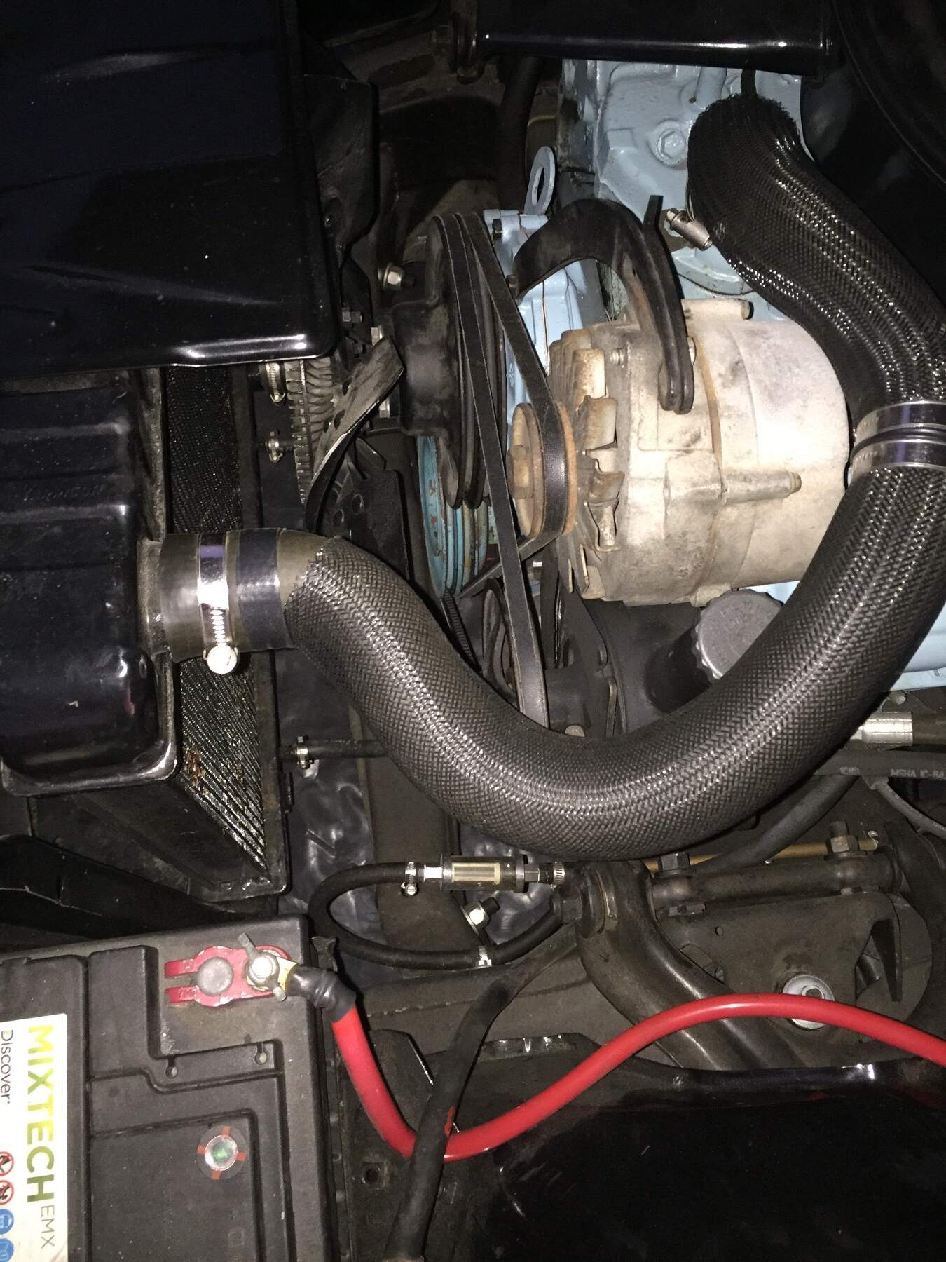

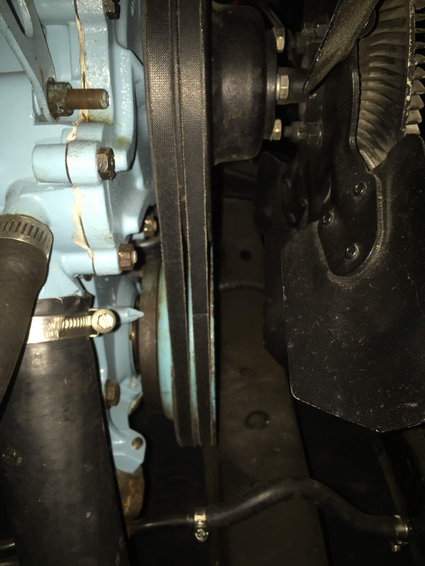

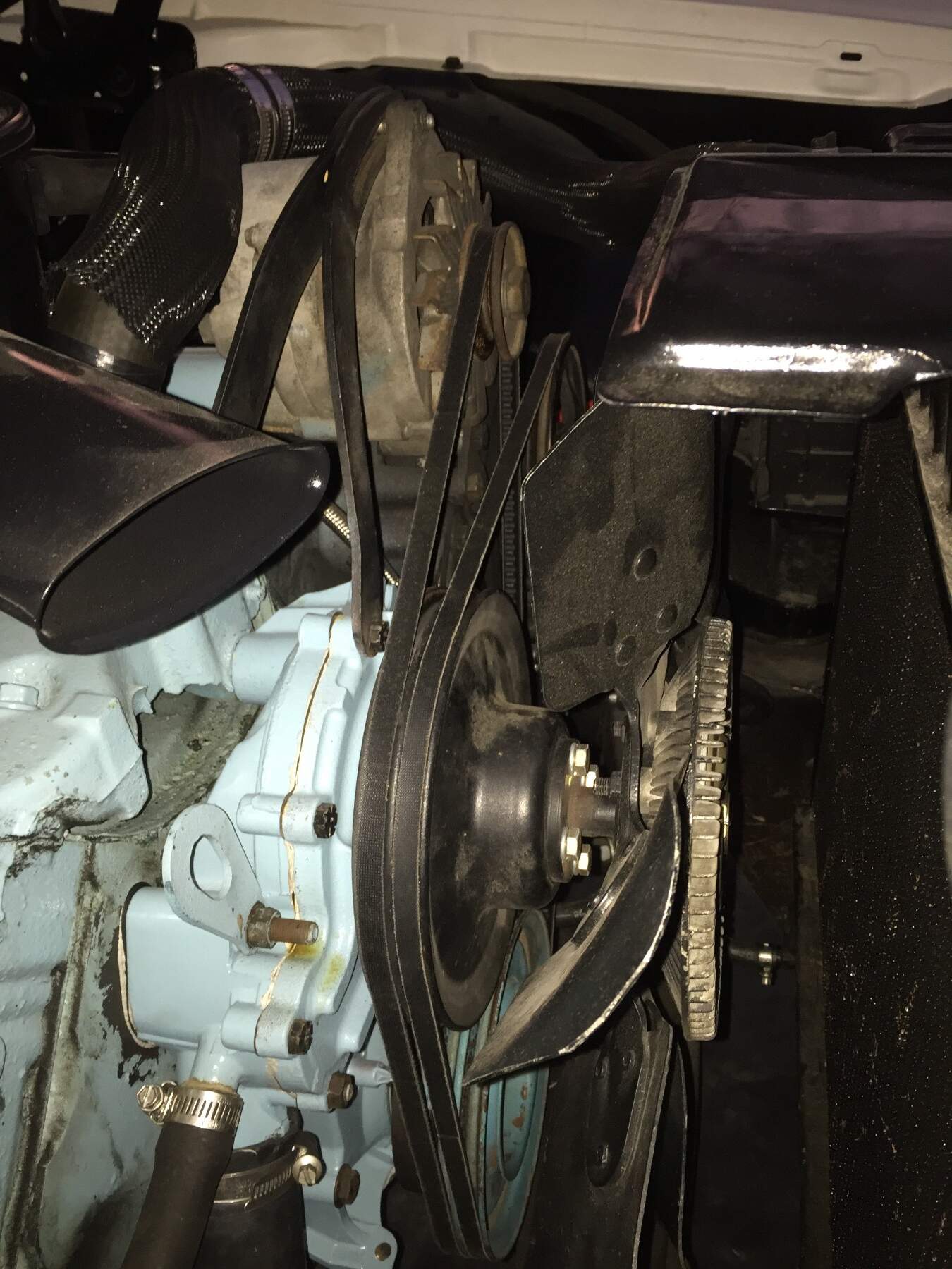

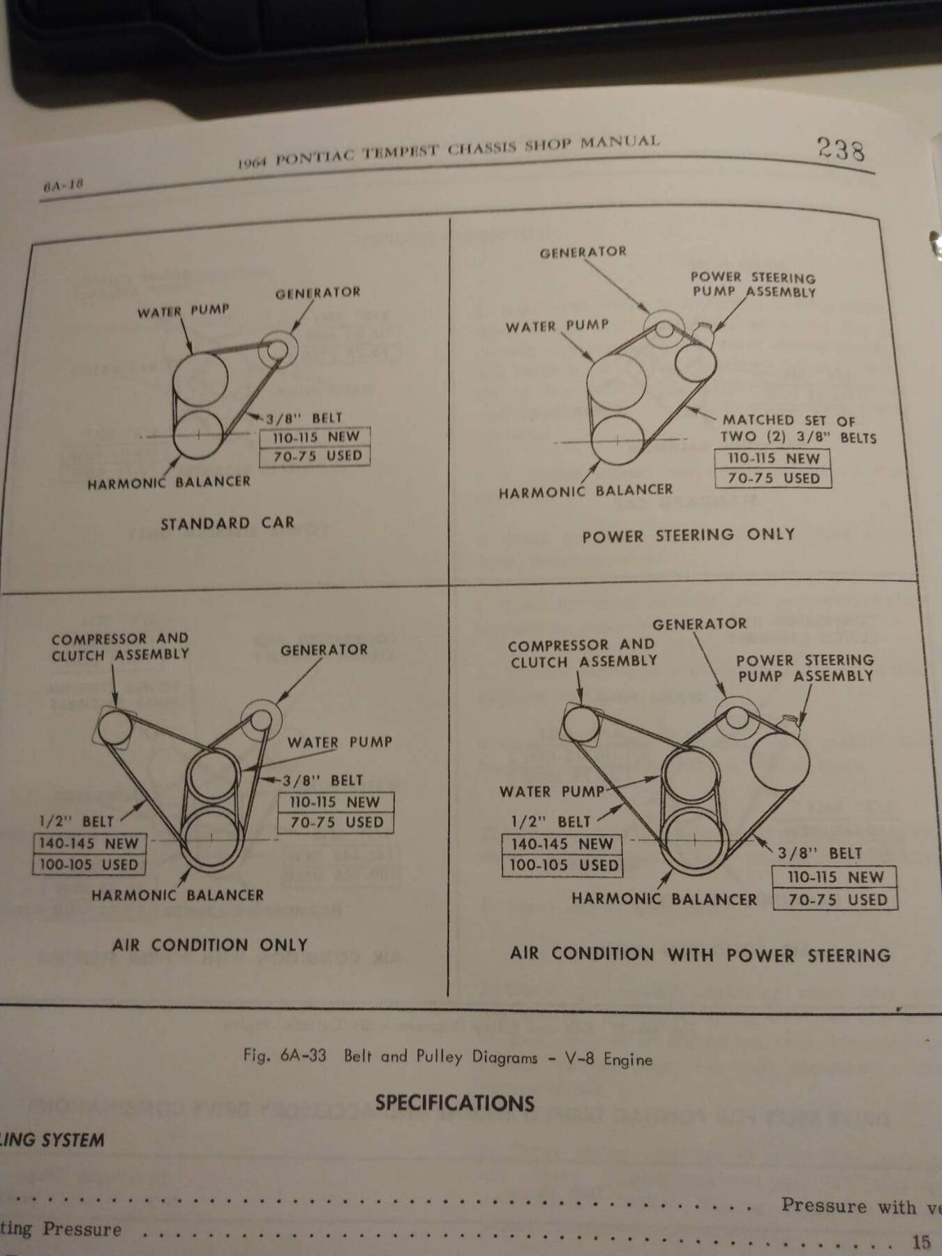

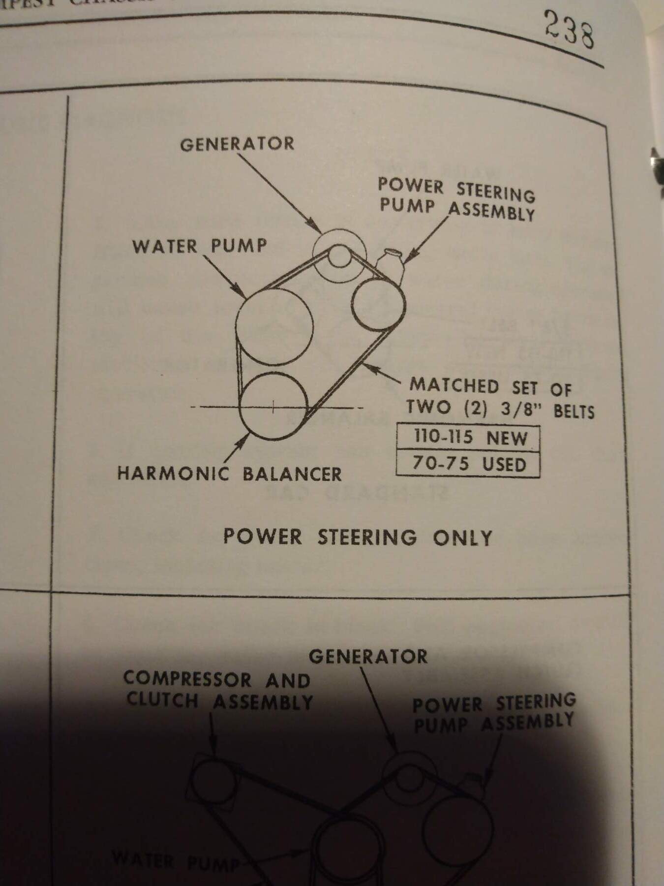

Andy , I will post some pictures of my 2 belt system when I get home from work 👍
justA so you have and idea of what I think is a factory set up 🍻
The first one is what i believe you are talking about and the second is what mine is, and all different setups that year.
