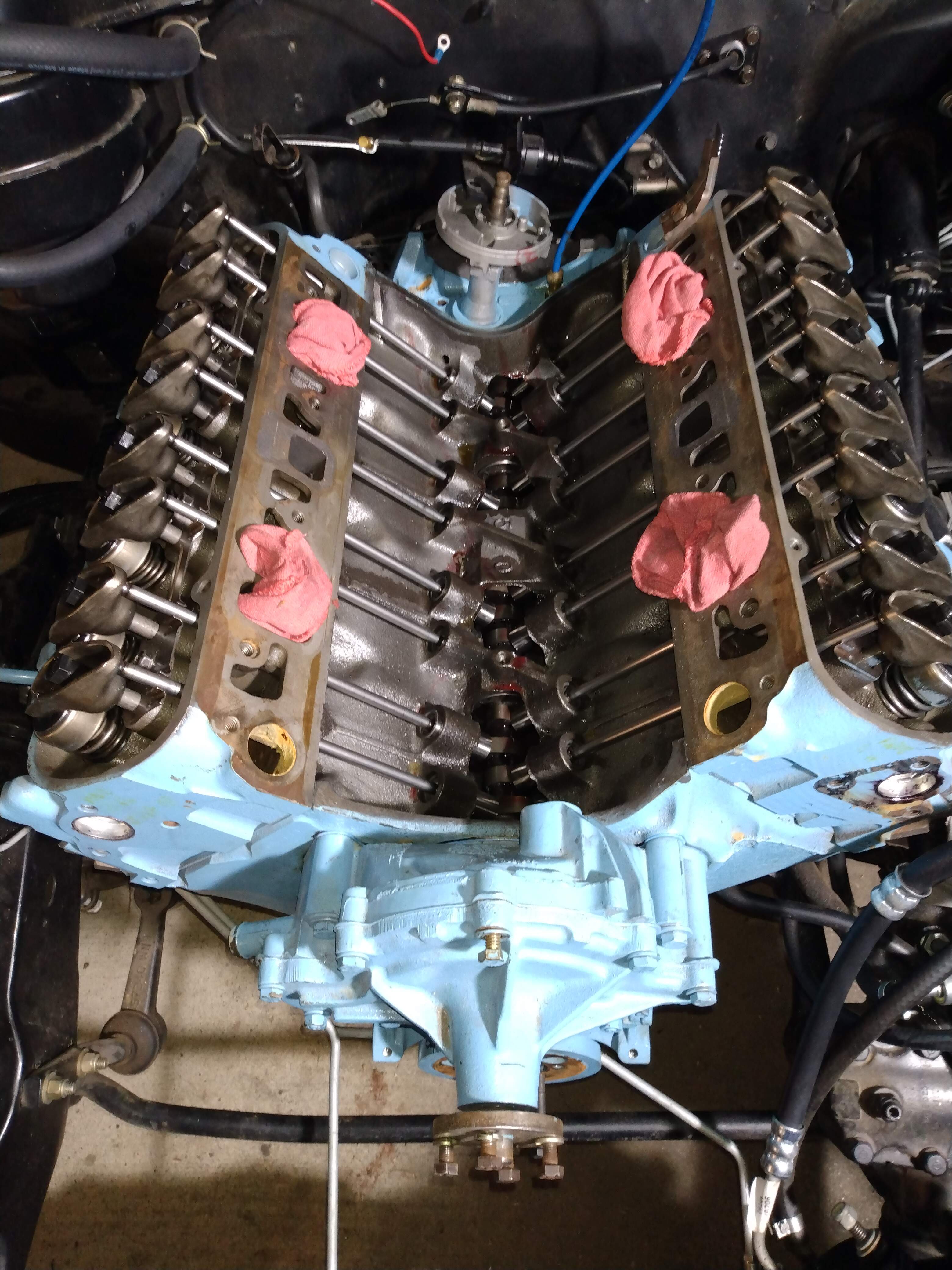

Got the cam installed and i decided to get a new roller timing gear set also, i cranked the engine over and verified that the lifters rotate and that was all good, it's almost back together and hopefully I'll have time to start it up this weekend.

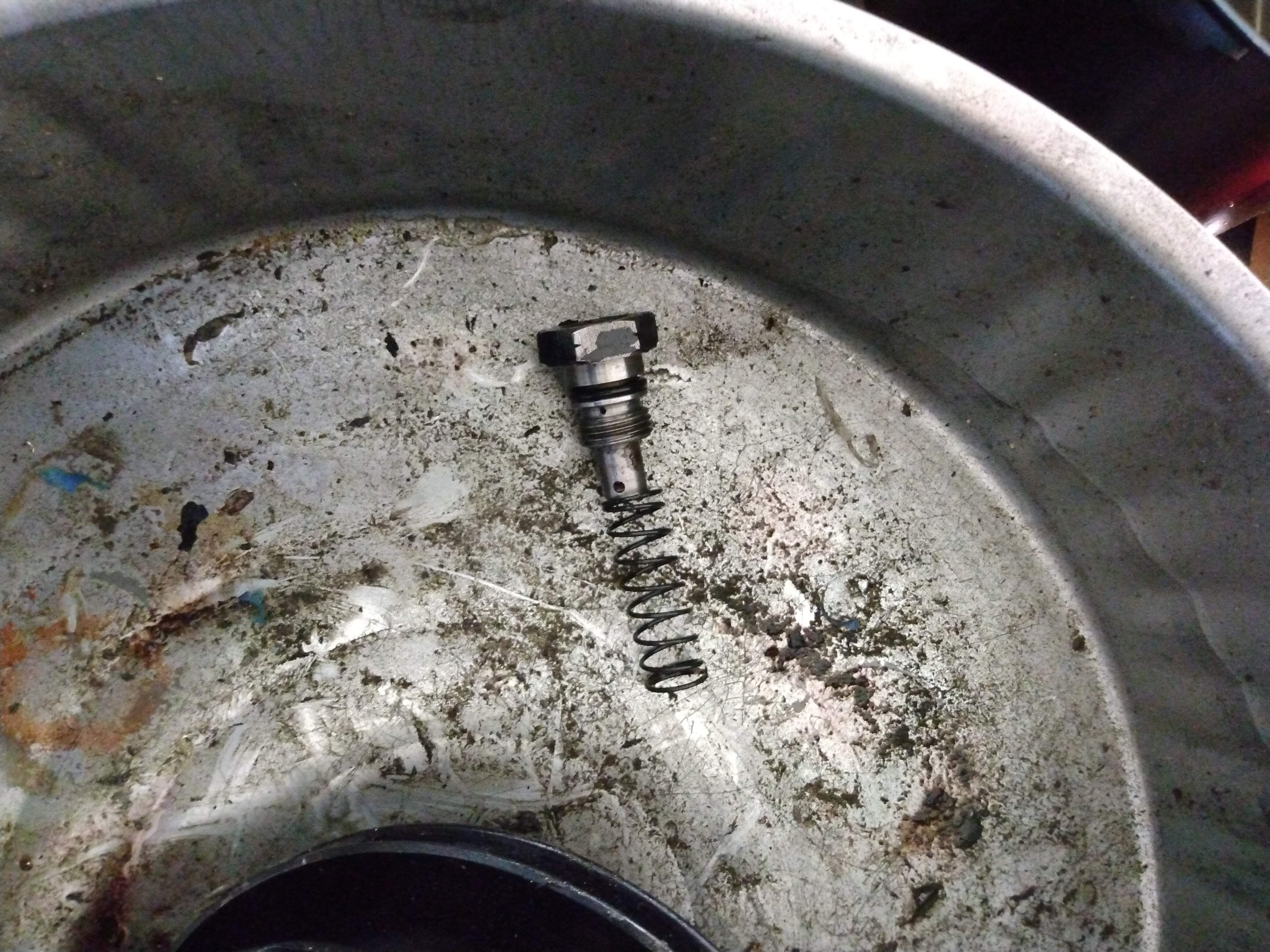

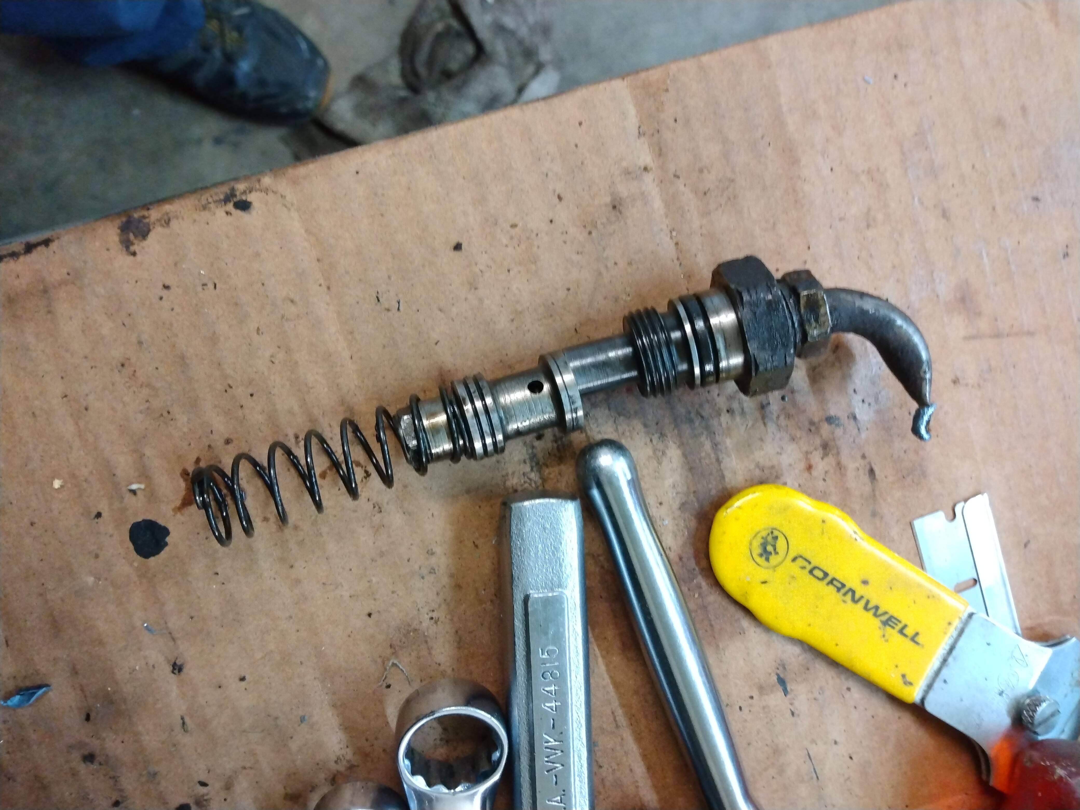

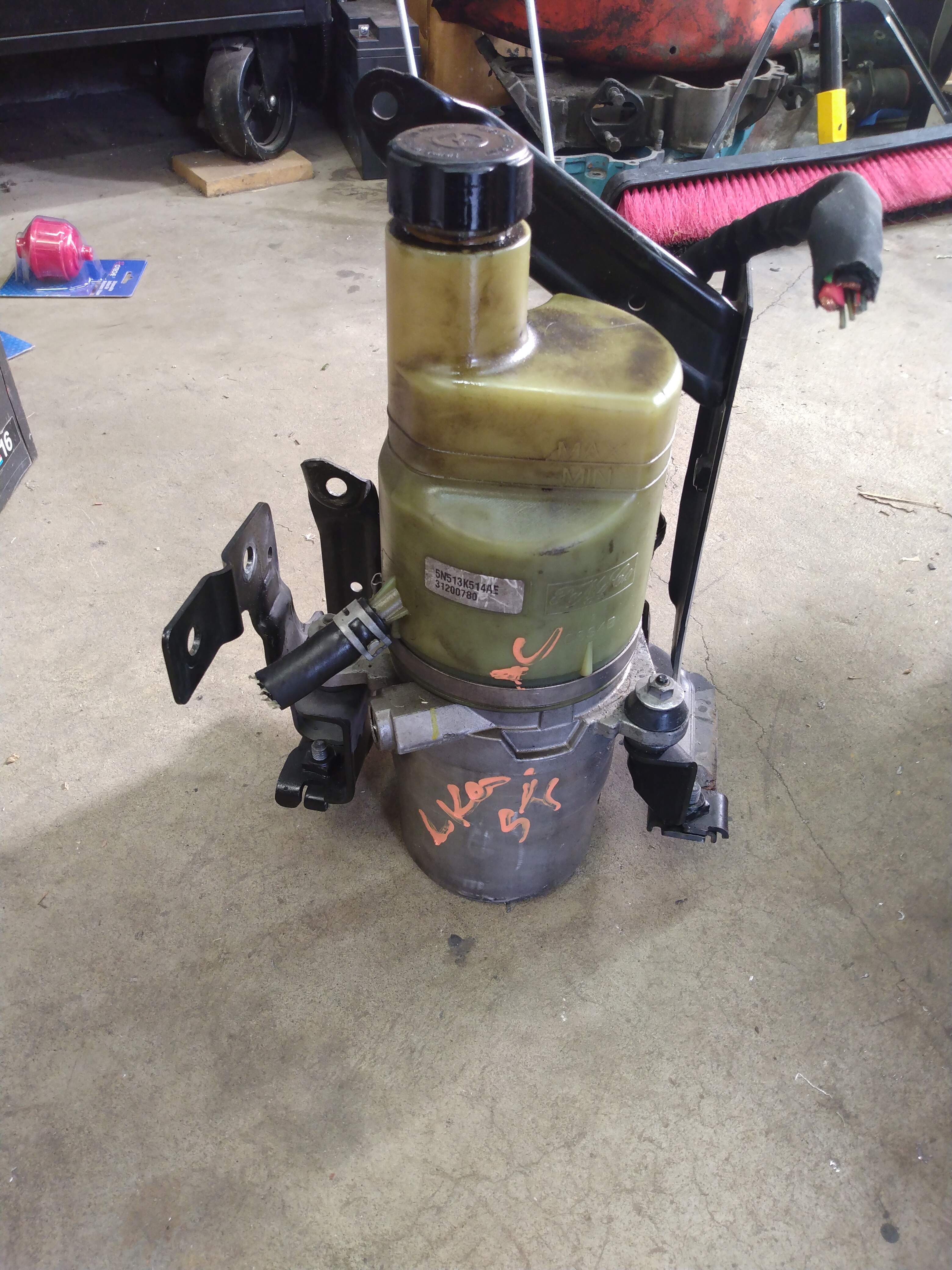

When i started it the first time the ps pump didn't work so i pulled it apart and i think the valve under the outlet is missing, have another old pump and it has the valve but that one won't fit in the Pontiac pump, the hole is not as deep and has som kind of fitting screwed in to the bottom so I'm not sure what is supposed to be in the Pontiac pump.
But i have a plan i will replace the belt driven pump with a electric one that will also help with the belt wrap on the alternator which is pretty bad on the stock setup on this car.
A friend of mine has installed a handful of these pumps and it works great, went to pick your part and removed one from a Volvo S40 . the plan is to install it behind the battery under the fender we will see how that works out later on.
This is what the pump looks like.

now thats a cool idea as the electric motor will provide a constant pressure unlike a belt drive one.. as we all know at idle, belt drive will be not as flash !
 i look forward to pics of how your hook it up :cheers:

Got it running yesterday,so far so good.
With the new fan clutch it was staying right at 180-190 and it was right around 80 in the sun on the driveway, when that thing comes on it is pulling a lot of air.
Removed the p/s pump and found a shorter belt now the wrap around the alternator is ok but the belt was still slipping on the water pump pulley when the fan came on, i think the belt is to wide and sit too high in the grove, i have another one coming, hopefully it works better.

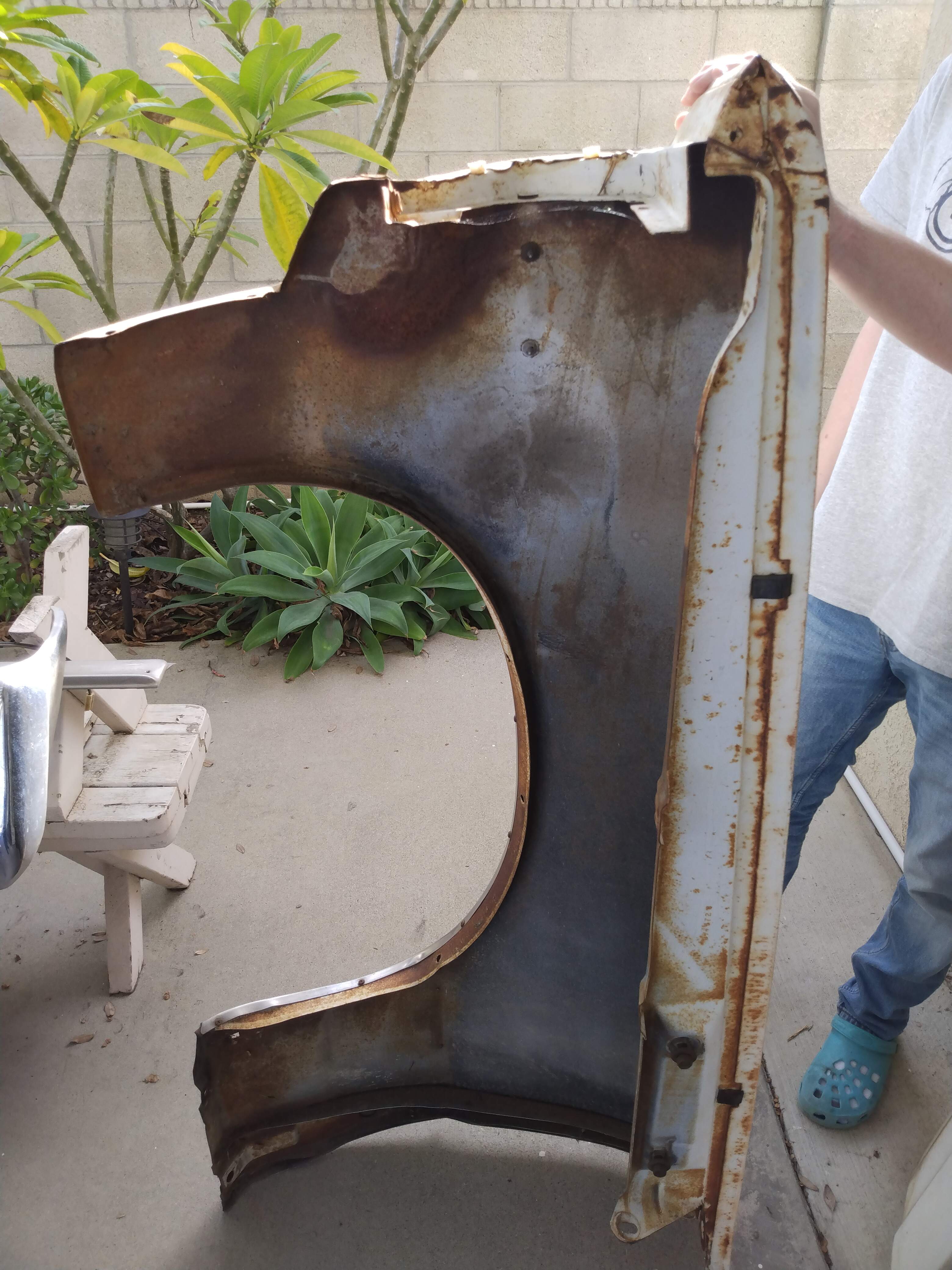

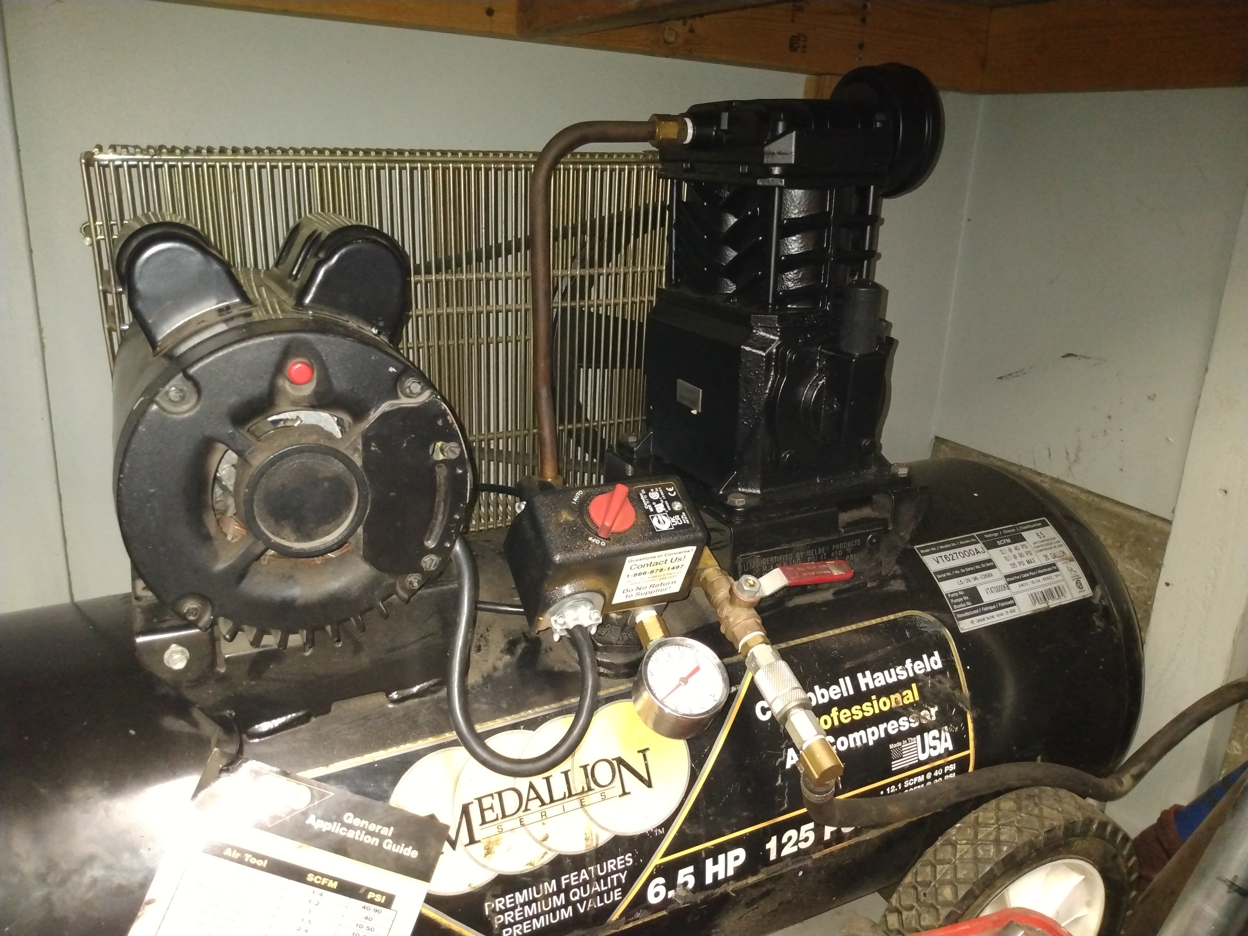

Almost time to start working on the front sheet metal , I'm not painting the car at this time but should probably try to clean up the inside of the fenders and hood, got some surface rust and could need a coat of chassis paint, my biggest problem is that my compressor died and I need to get a new pump, probably at the beginning of next year.

Got a new pump for the compressor because they don't have any spare parts for my old one so back in business but it has been raining pretty bad for the last couple of days and since i have to be out on the driveway I'll have to wait,is supposed to be better this weekend.

I'll have to figure out what and how much to do with the outside of the car, it's not getting painted for now but maybe I can clean it up and make it look a little bit better, I'm no body guy so any Ideas?
rust kill and rattle can primmer Andy ! thats what my bonni features for now :cheers:

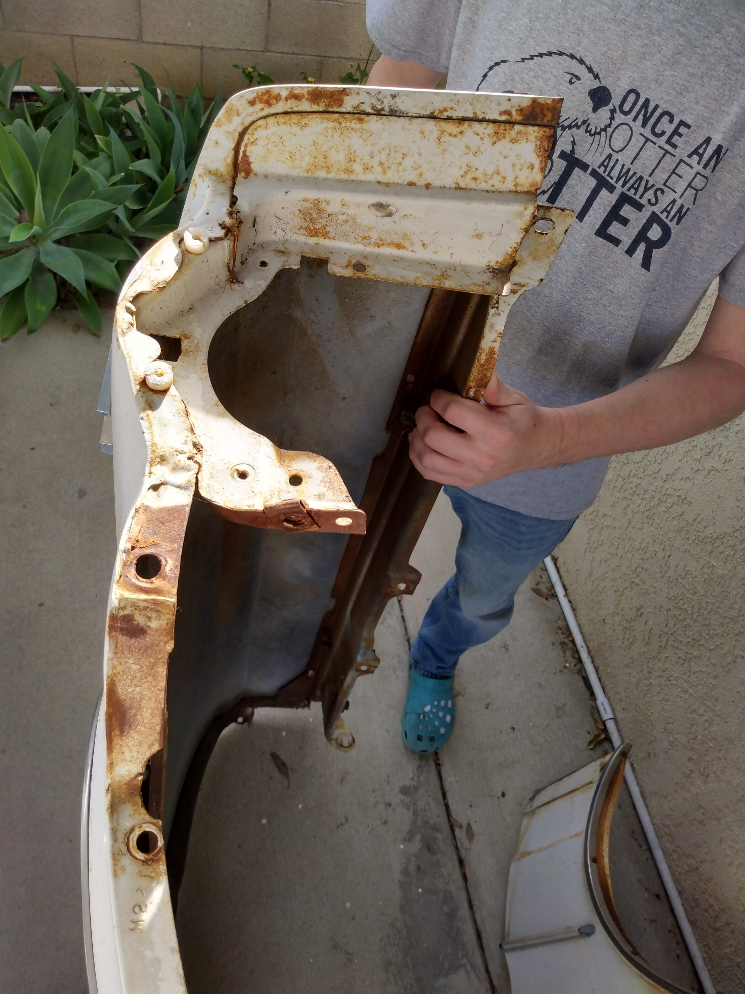

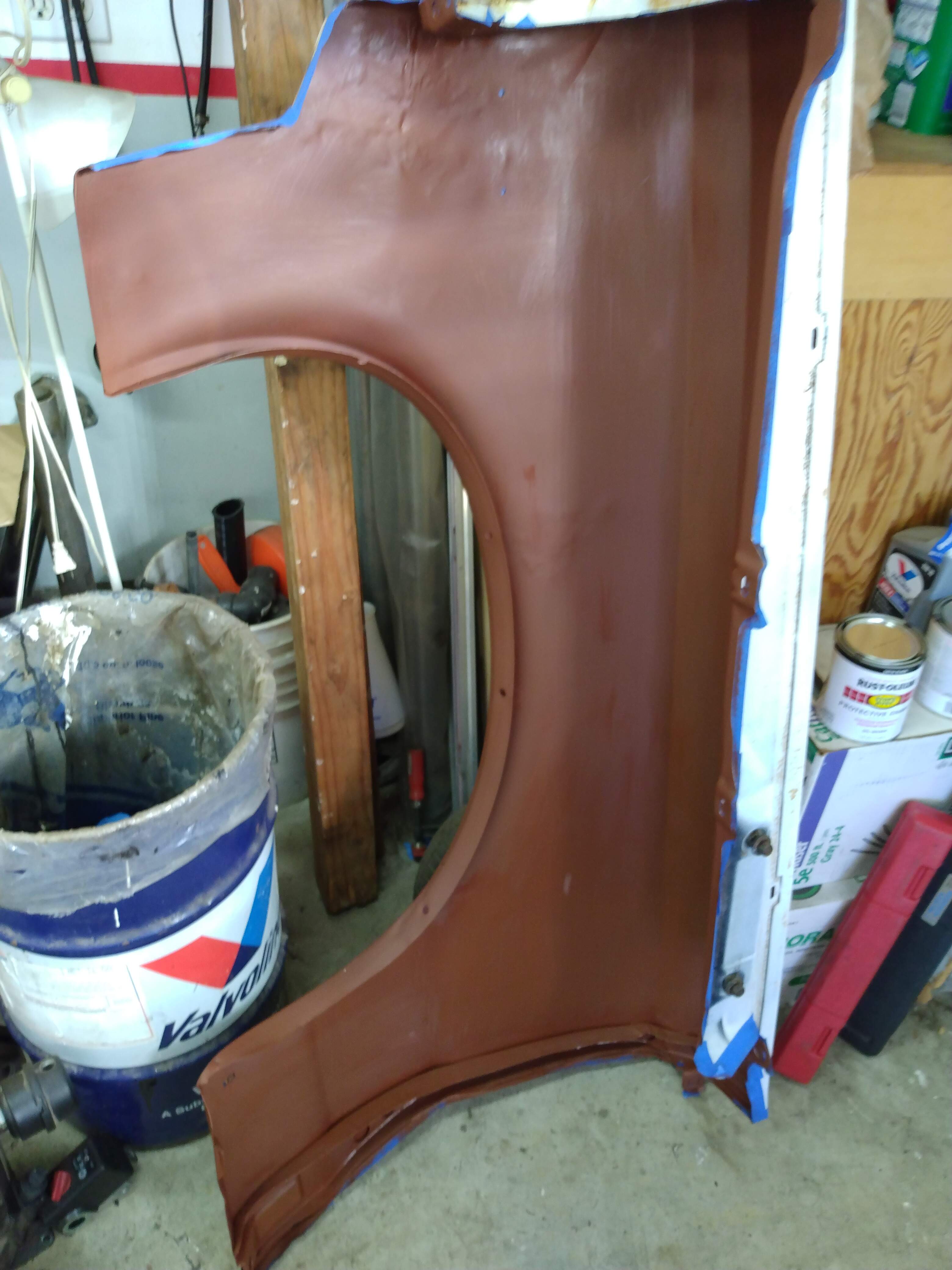

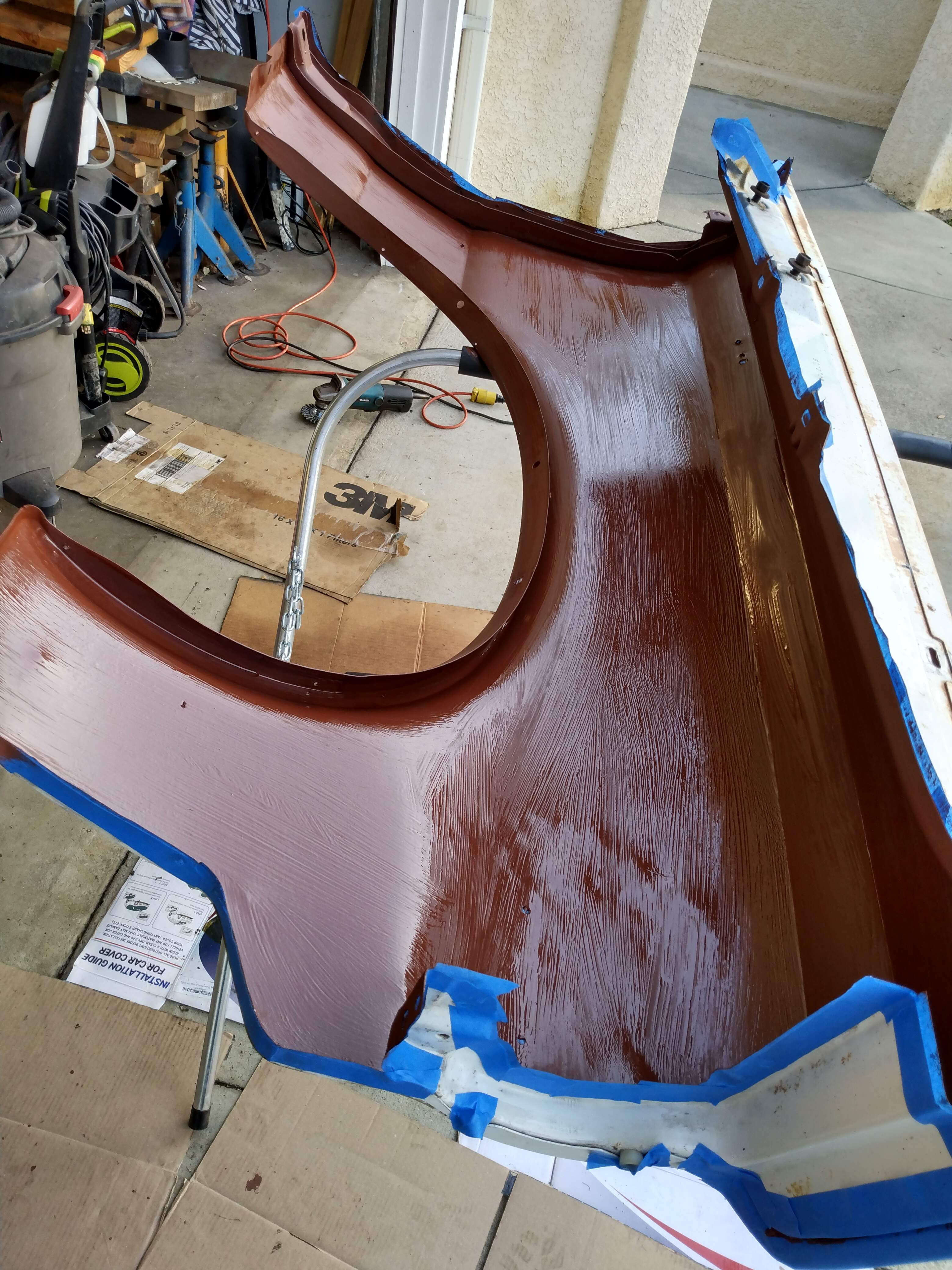

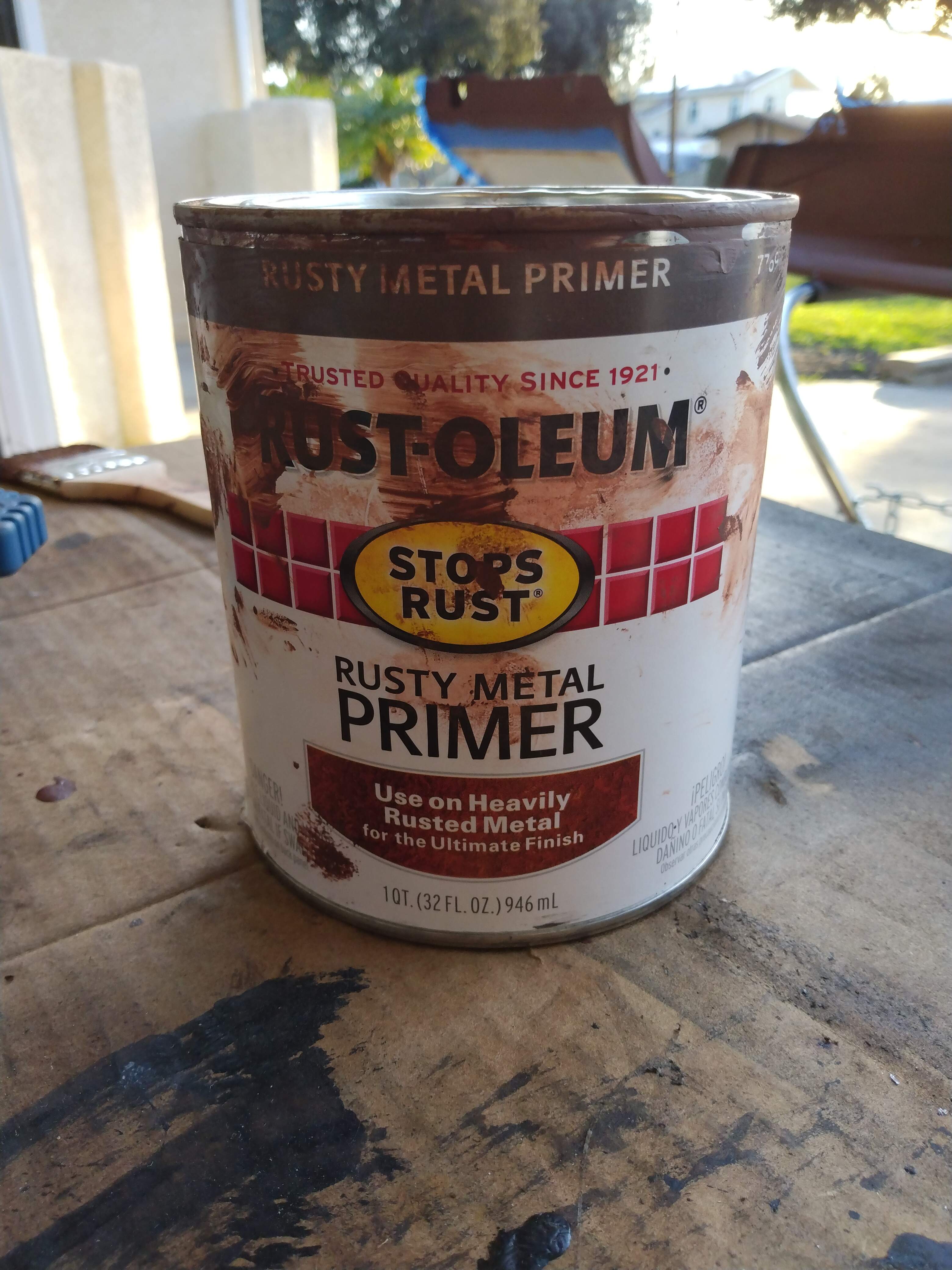

Wire brushed the inside of the fenders and at least got them primered.
Found this oil based primer, i was surprised that you could still buy it with all the regulations.  Fired the engine up a few times over the weekend and it sounds pretty good, got the narrower belt installed an it definitely works better,

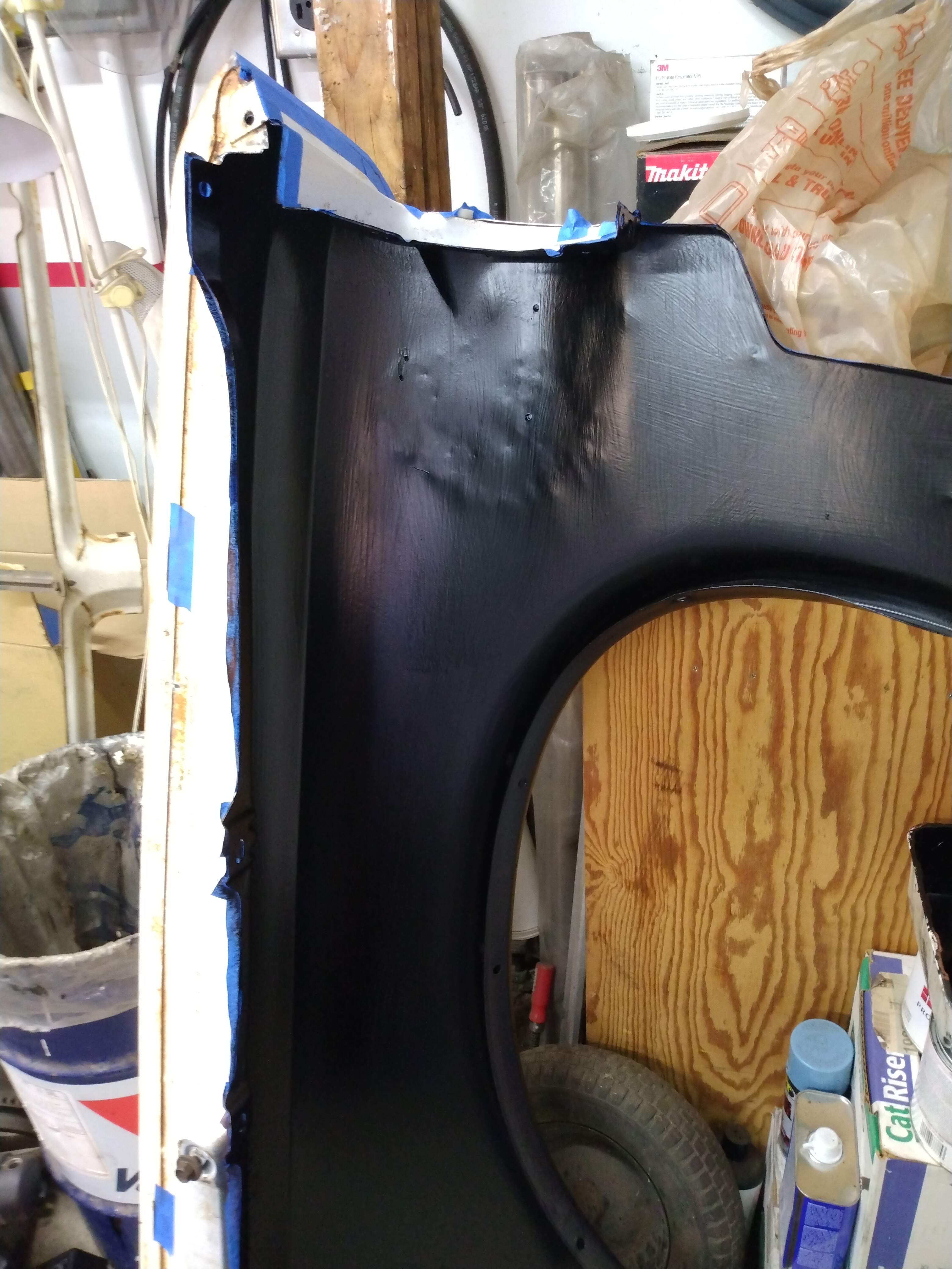

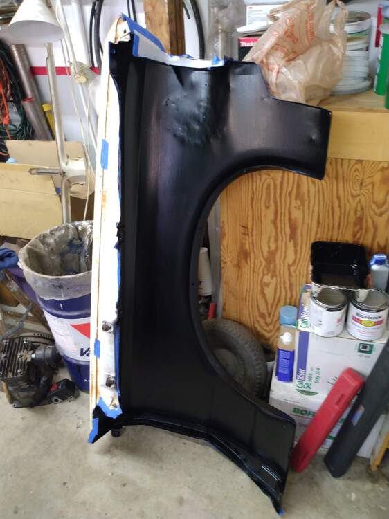

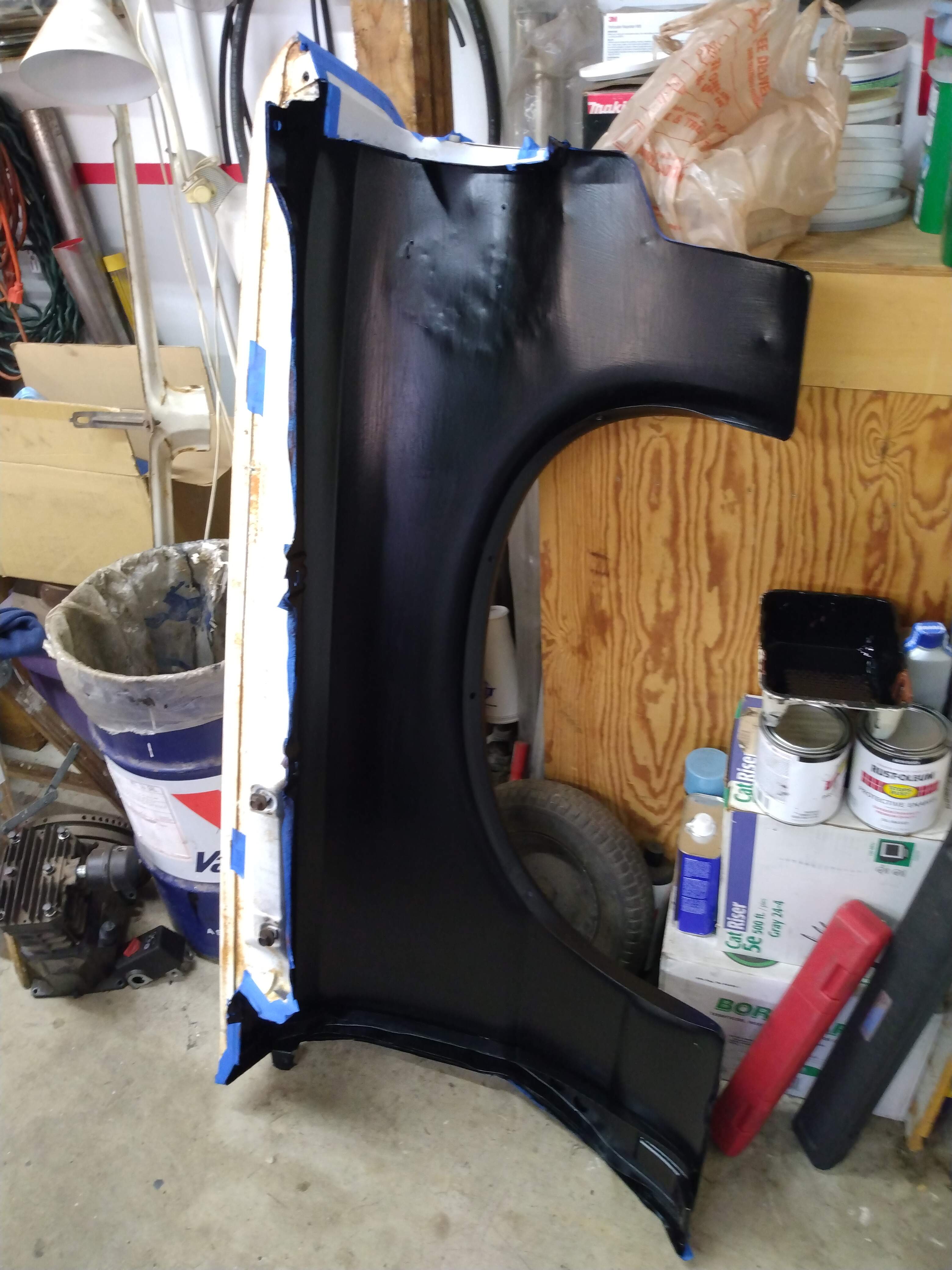

Got a little bit of time today, first coat of black on the fenders.
You can really see the crappy body work on the inside when they got painted  but we we will have to deal with that another day.
Cool part about the dent Andy, is that you can fix that no problem!, these cars have really nice steel to work with.:cheers:

Yeah no kidding, my wife's car was hit in a parking lot and it's a 2000 something and what a thin can.

yeah !! good luck trying to smooth modern steel!!!:rofl:
last week my boss got rear ended by a land rover and its a mini ! they justA pull parts off and stick new bits back on ! they dont even bother trying to smooth panels out.
thats why is wayyyy more fun with our old girls !!! we can fix em :cheers::dancingpontiac:

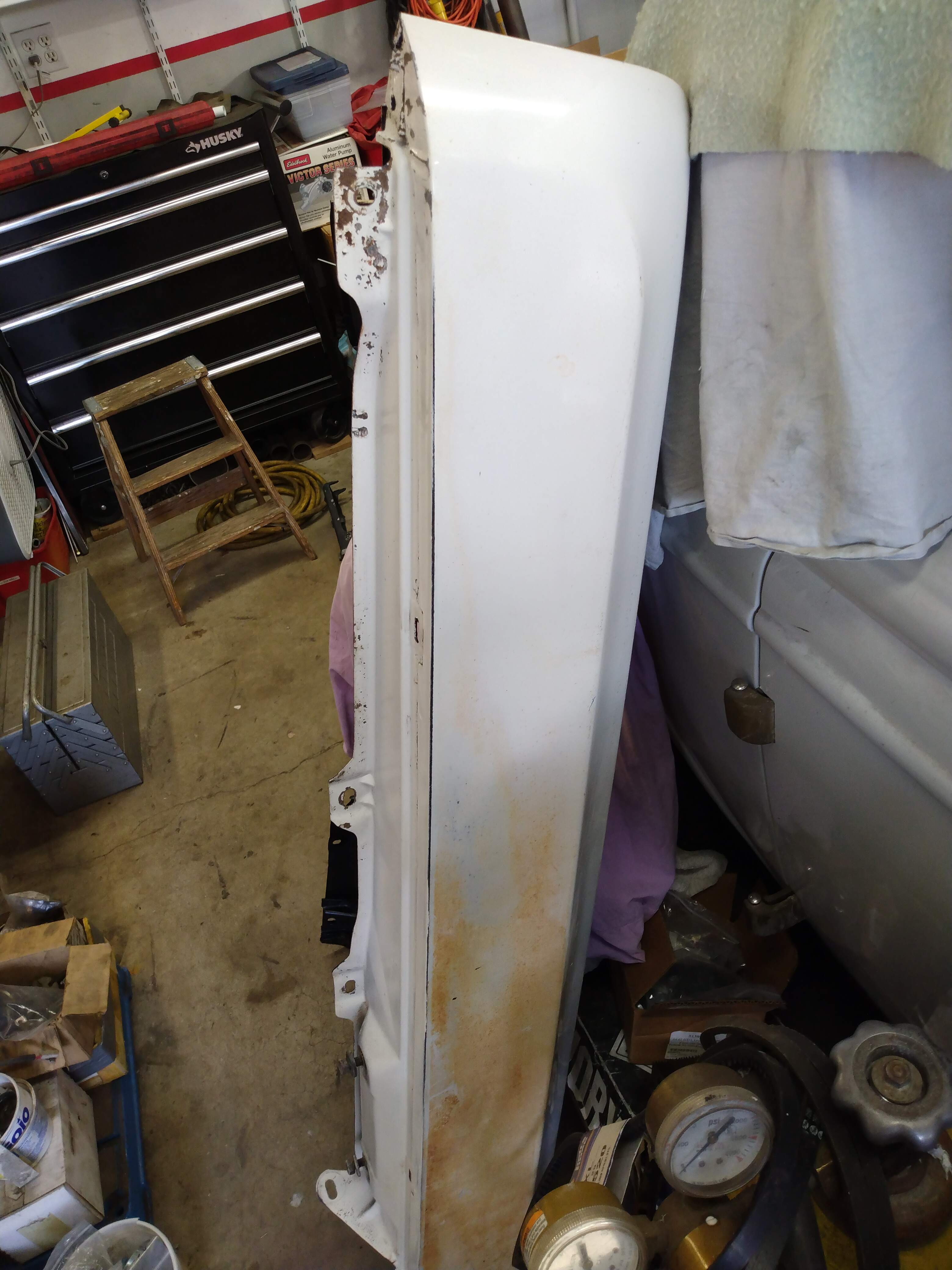

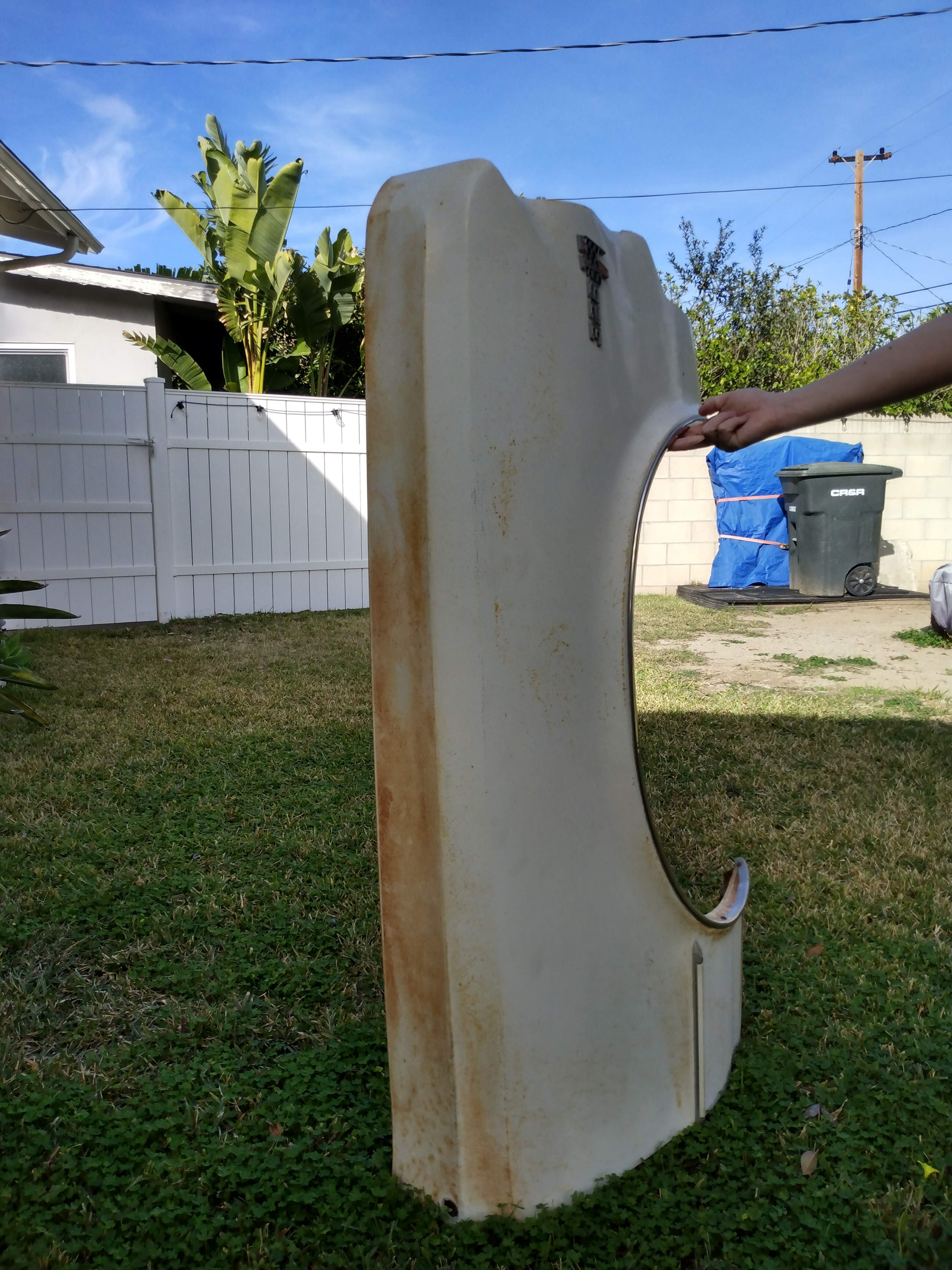

Did a little test on the front fender to so see if I could clean up the paint a bit.
Looks good Andy, big difference bro.
I'm hearing you, Andy. The paint was so bad on my GP that one day I experimented and sanded it thru various grades of wet & dry and the result was nothing less than amazing. It still wears it's newly refurbished original paint to this day. Admittedly, it needs a paint job and that will happen later this year, but it's much much better than it was.

That's kinda where I'm at, i got this Rust-Oleum white that a painter friend of mine is going to help me tweak so it gets closer to my white so i can use it for touch up, we'll see how that goes since I'm not much of a painter/ body guy 😄
