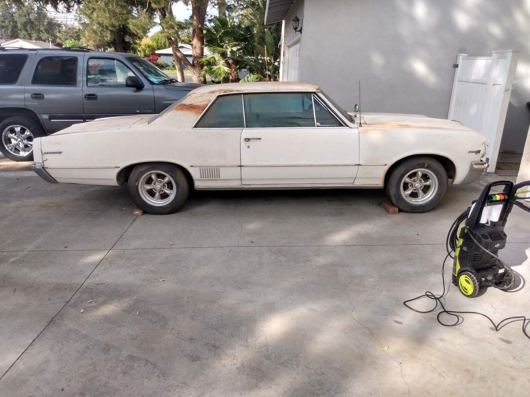

So i figured i start a tread about the progress on our car and start adding as we go.

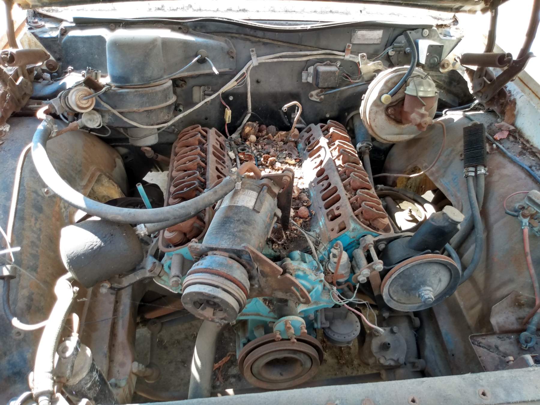

We bought this 64 LeMans from a coworker that had it sitting in his backyard for 20 years, his dad bought it from the original owner.
The engine was rebuilt 20years ago, newer started and sat with out intake or spark plugs.
When i initially looked at the car i thought it was to rough and needed to much work but the more i thought about it i just could not let it slip away.

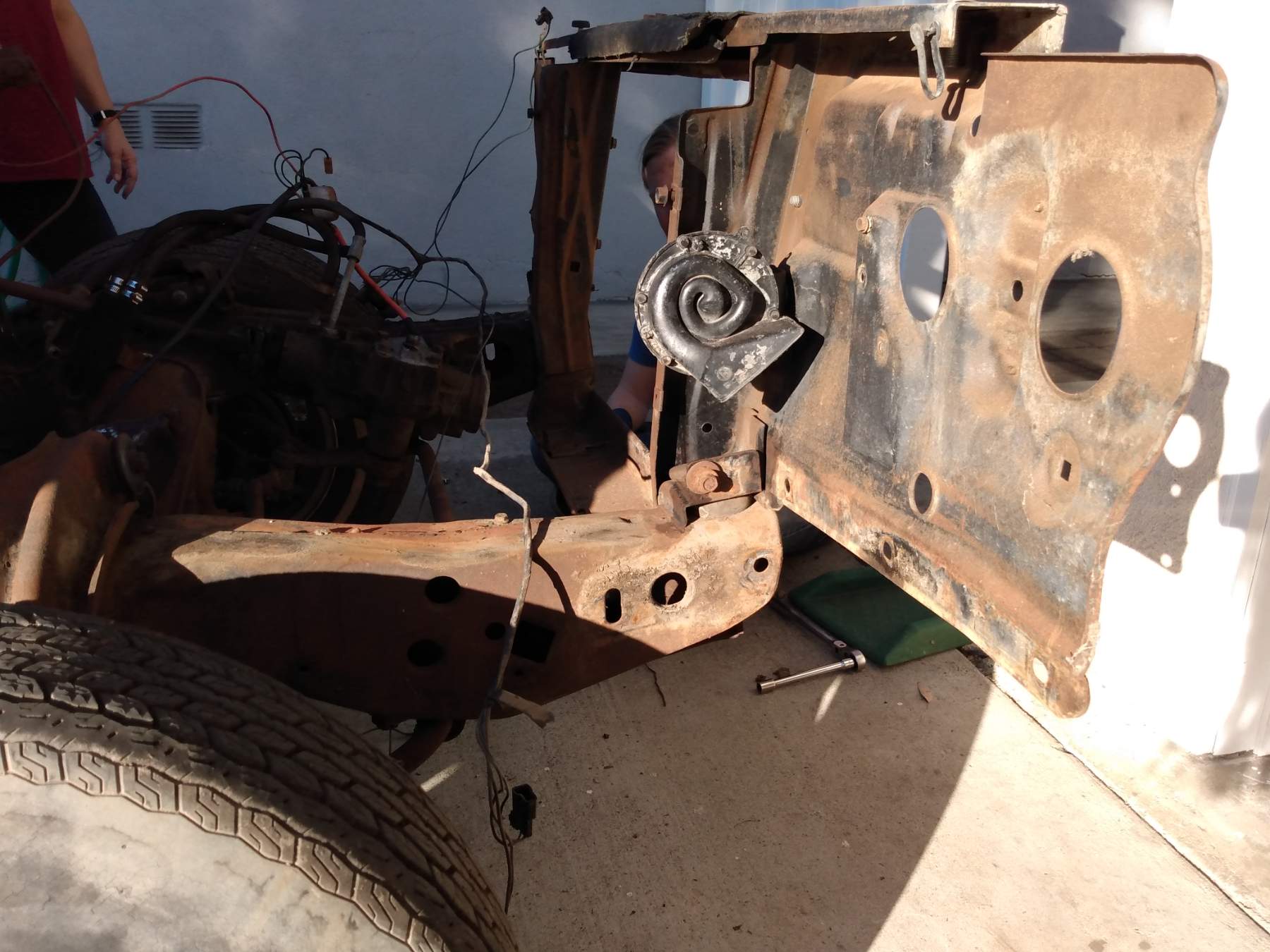

Hopefully it will be a nice driver i will post some more pictures when I get a chance.we have torn it down quite a bit by now.

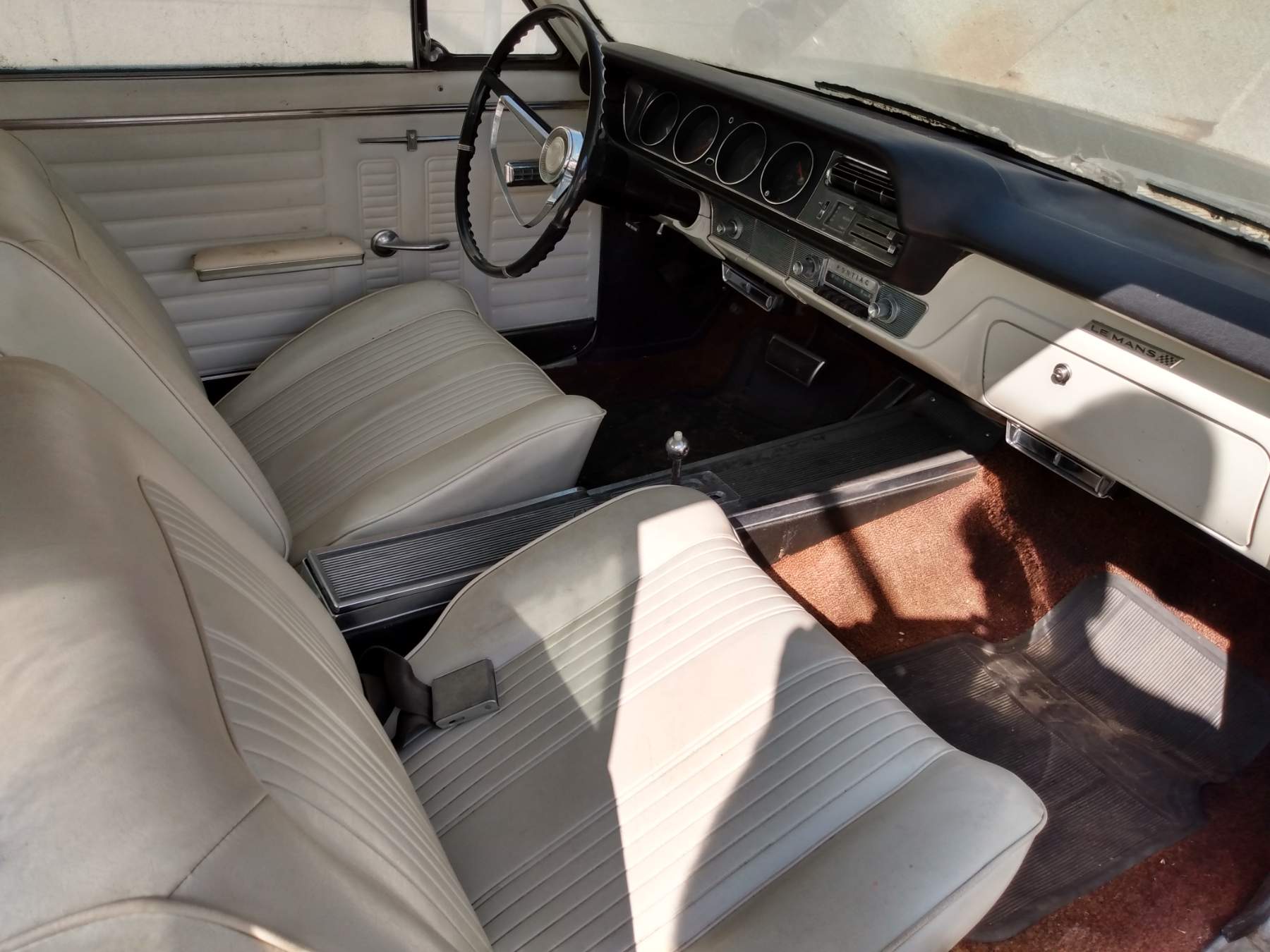

whats the body like?, the interior looks pretty tidy👍

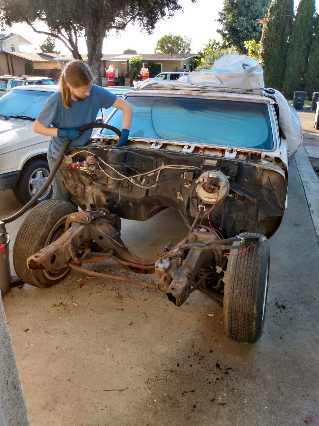

A couple of more pictures today.

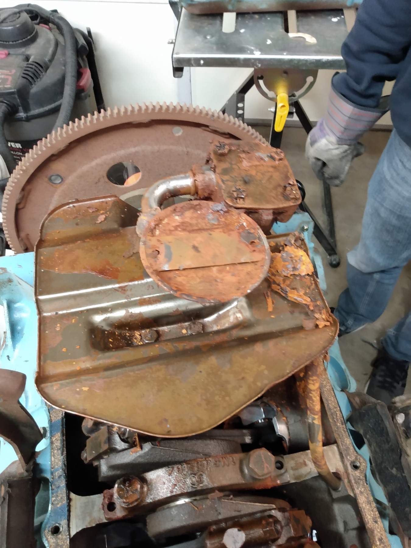

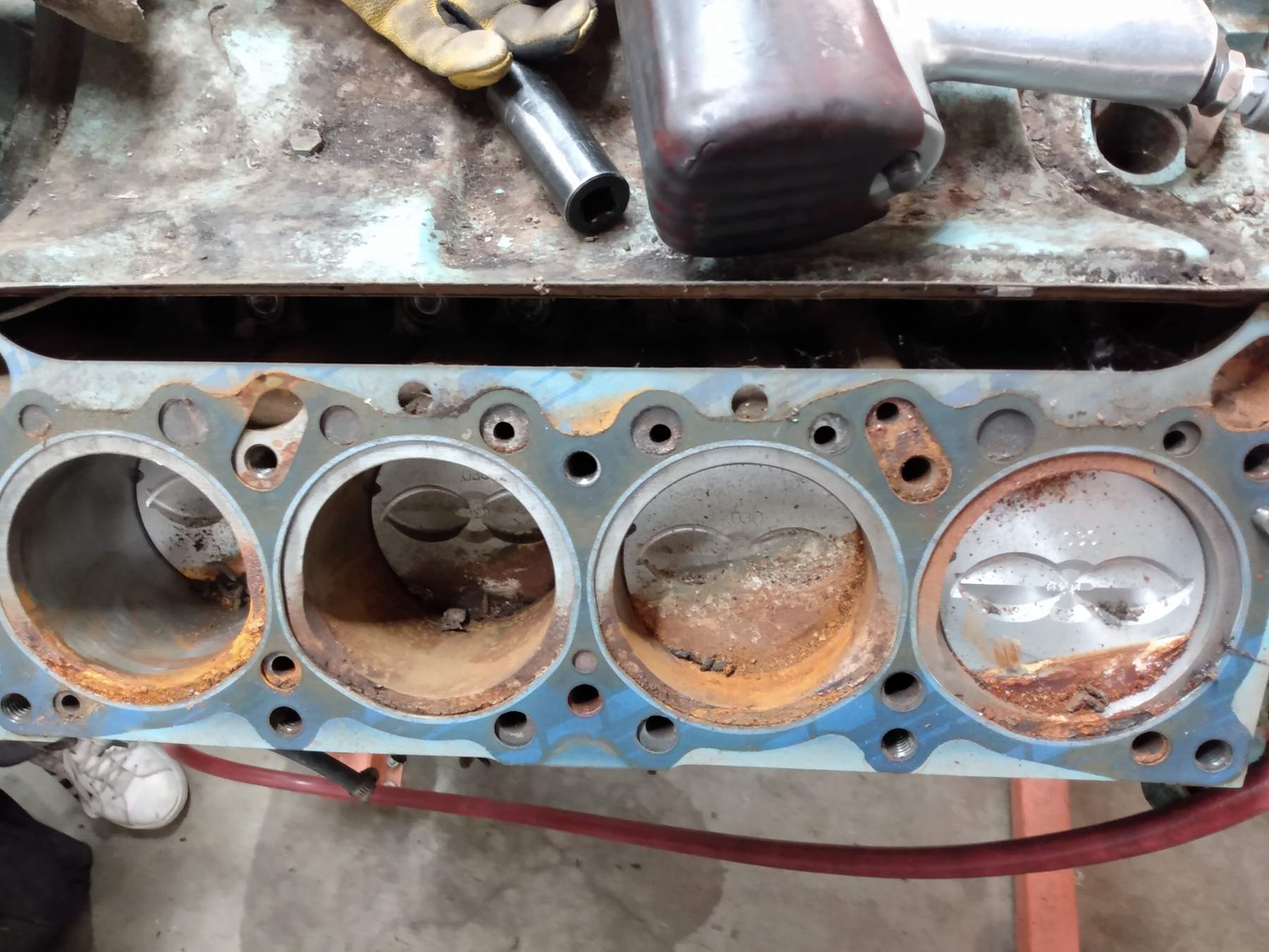

We started by pulling the engine and trans, put it up in the engine stand and pulled the heads and pan, OMG a total loss, everything way rusty, barley got the pistons out of it and they where brand new when parked.
A coworker overheard that i was looking for an engine and told me he had a leftover 350 with th350 trans takeout engine for free, just come and pick it up so i did.

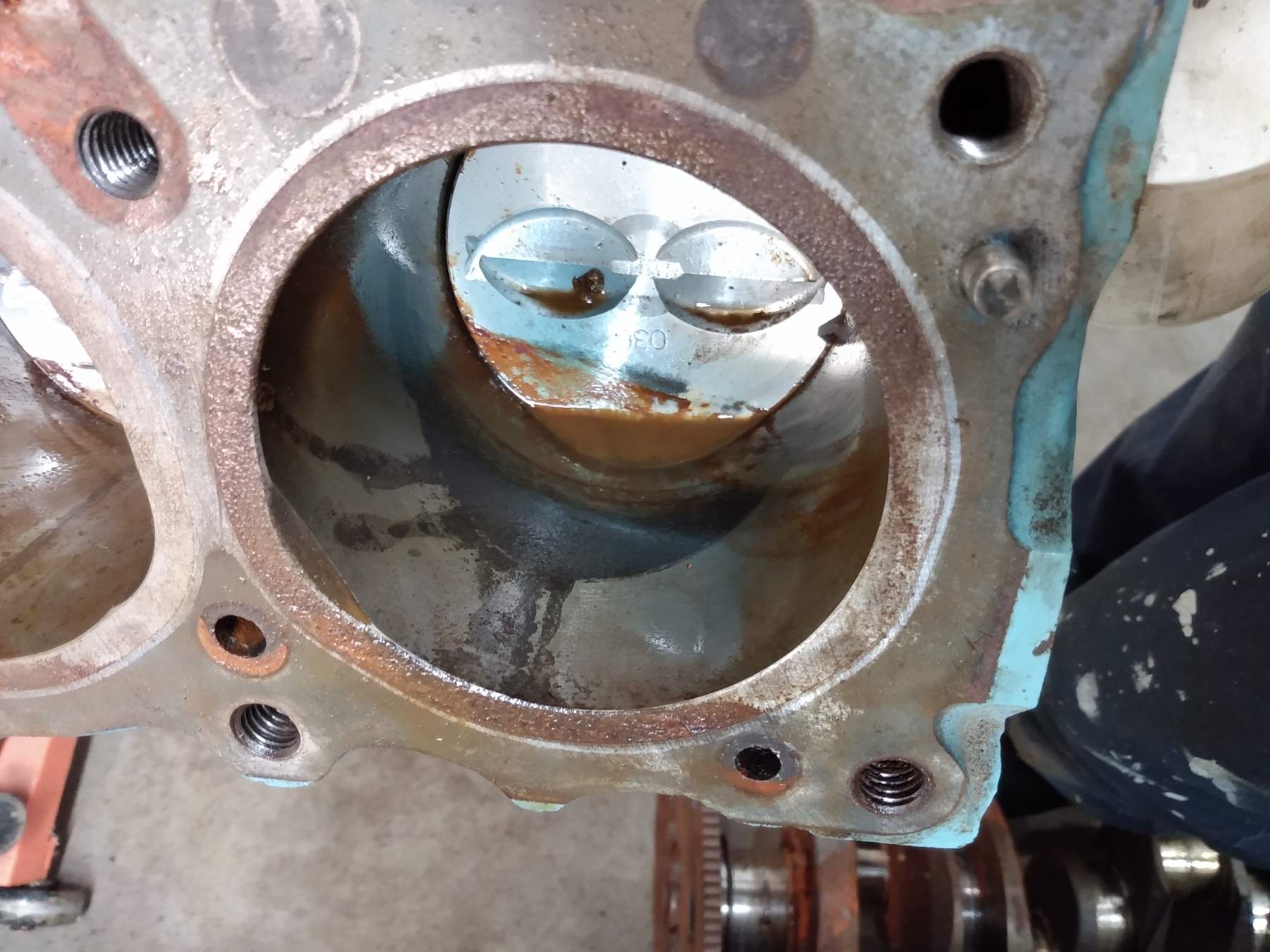

Got the engine home pulled it apart and it is looking like it was a cheap auto parts store engine, it was 030 over, crank 020 020 and the heads where a mess, one replaced seat, had both positive style seals and also o rings on top,used the wrong valve looks, they where to long and covered the second grove from the top on the valves, the one that is supposed to hold the o ring and they are about 90cc so very low compression.
Block of to machine shop and one cyl needed a sleeve and they bored it to 040, crank got polished other wise OK, bought some other heads in the mid 70's cc range to get the compression up a bit.
going to tap the front oil galley plug holes this weekend if i get time then cleanup time and put back together.

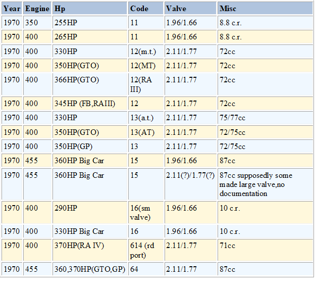

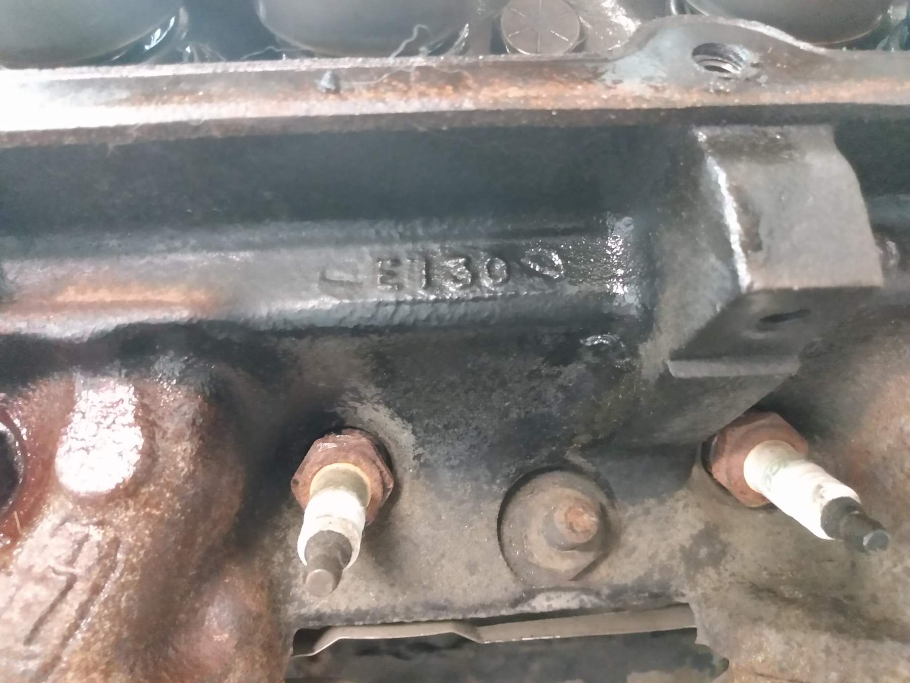

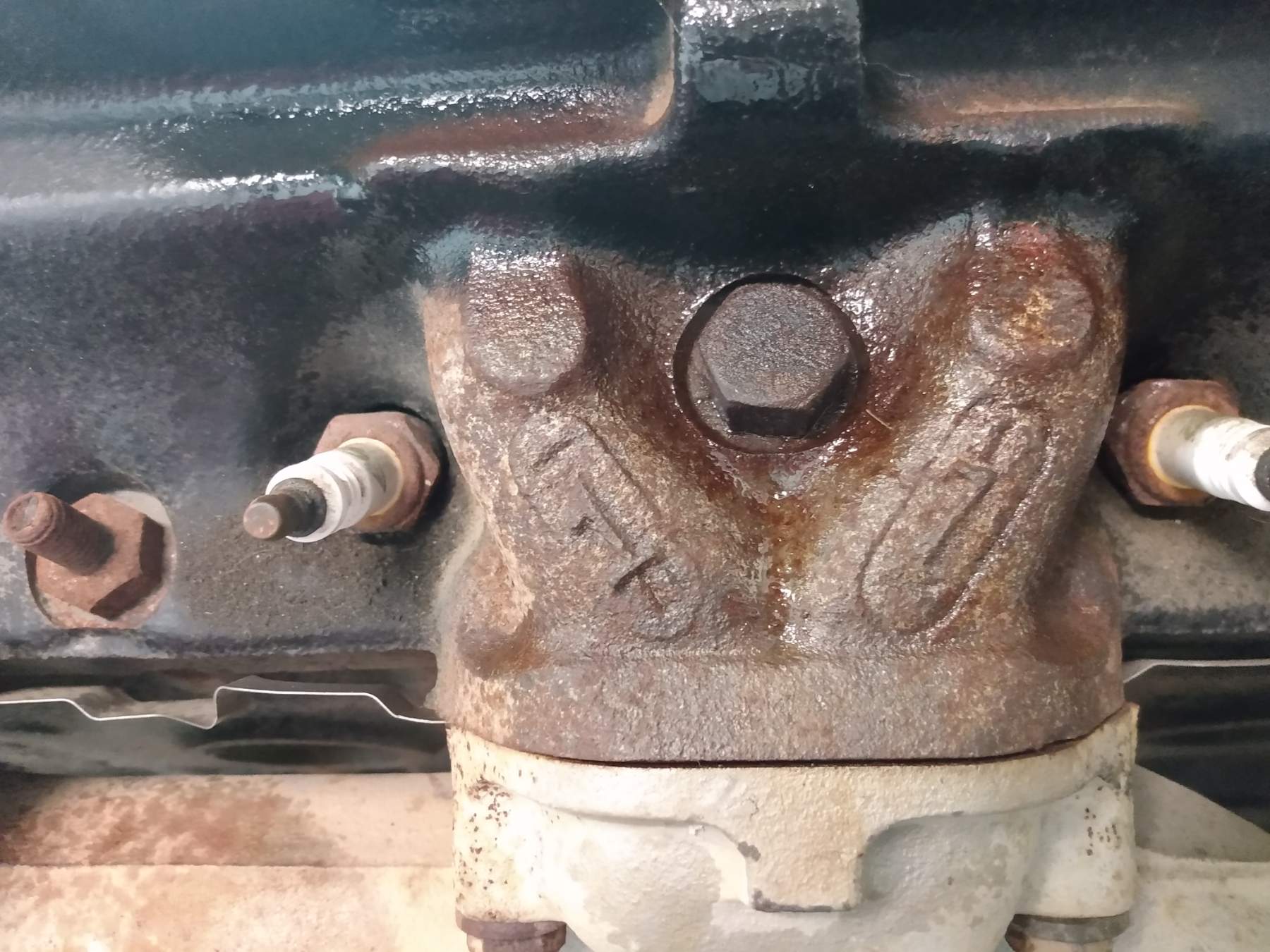

The two last pictures are from the heads that came on the 350, any body got any idea what they are? could not make any sense of it, look like NO17 and casting date probably 1970 and the chamber size are almost 90cc?  Any ideas? not that it really matters, just curious.
More another day when i get a chance
Hmmmm....interesting. A #17 head is definitely for a 350 engine - just from 1968.
Here are all the heads from 1970.

Frosty. And it's listed as 9.2 compression no way with high 80s cc
Frosty. A lot of the things you mentioned are in progress and other will come later, please keep the ideas coming.

While I would agree with you, a lot of this material is based on published Pontiac material of the day. So like horsepower rating of the day, 330 HP was probably more 360-380 in some cases. So take compression ratios with some grain of salt.

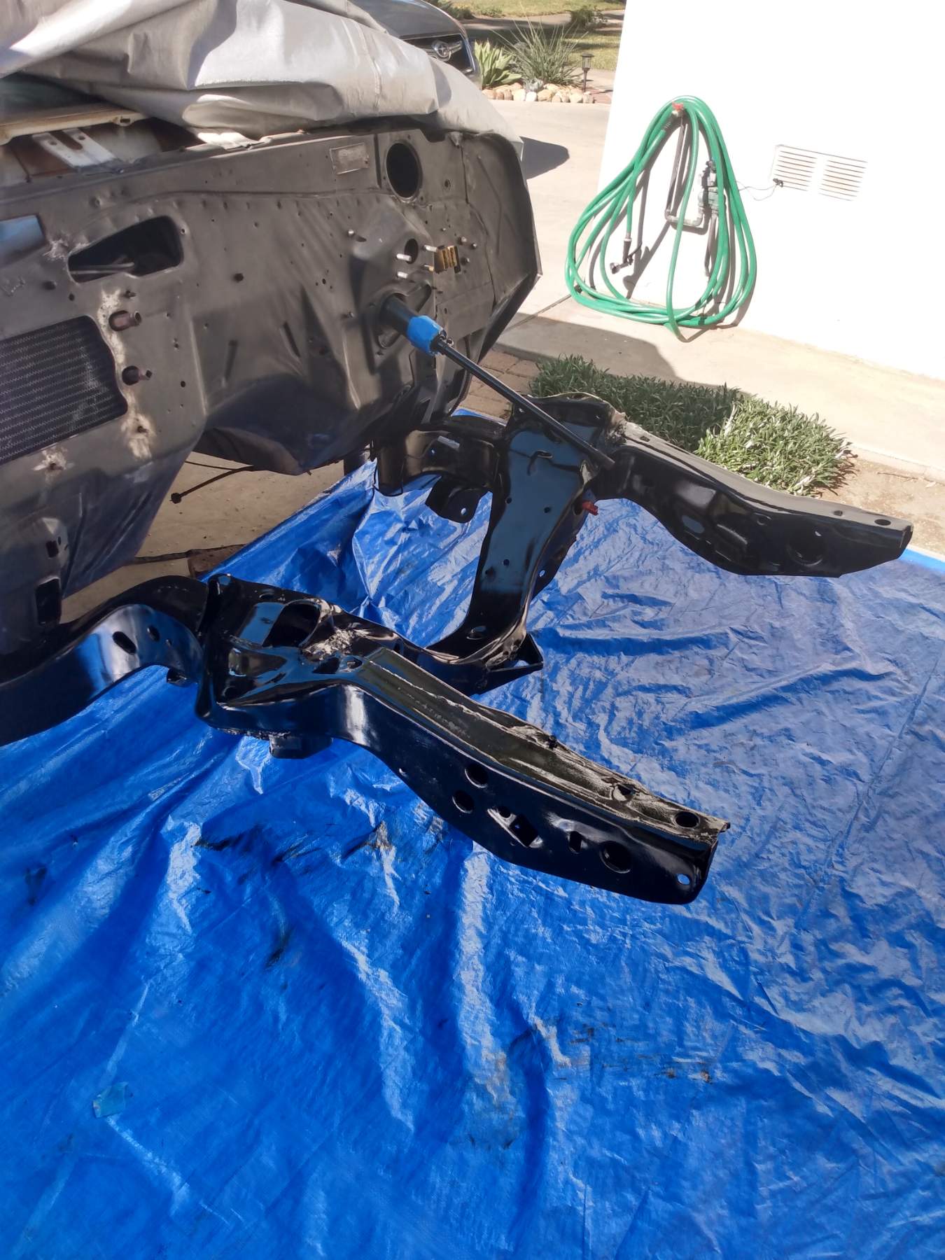

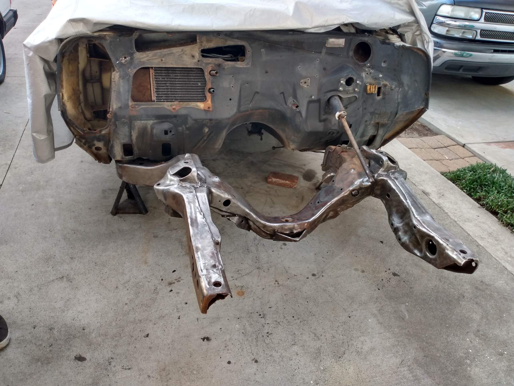

A couple more pics, this is kind of where it is right now got most of the front suspension painted, cleaned and blasted the spindles and the control arms, installed new bushings and ball joints. it will also get all new steering linkages and body bushings eventually but they are on back order until April 😒 A lot of surface rust but no holes, only had to cut one lower bolt off for a fender everything else just unbolted with some lube. Nice with a CA car.

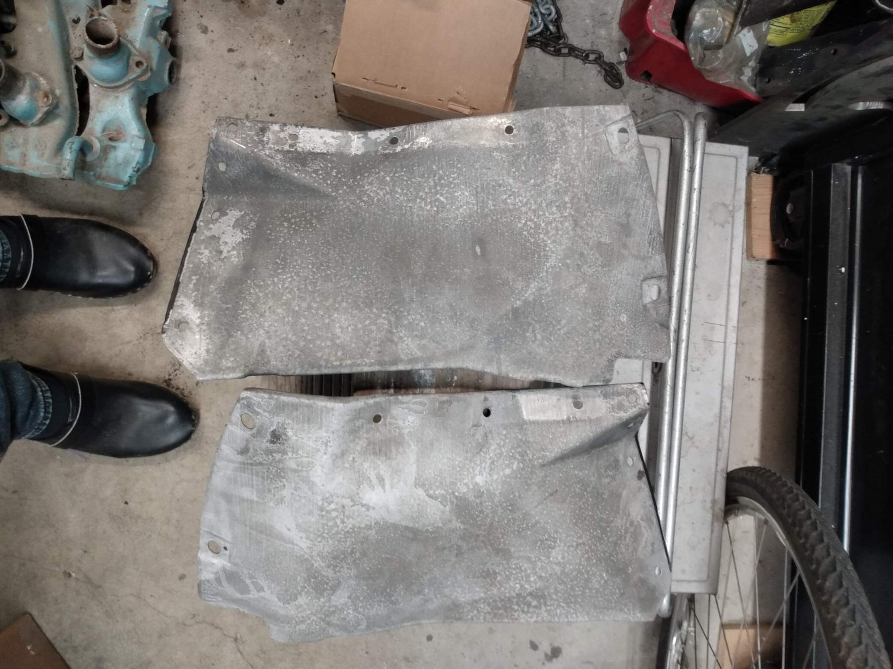

Made a tub with water and citric acid and dipped a few parts and it works great. some stuff i brought to work and ran them in the big machine washing machine and some got bead blasted, i think i will have the inner fenders and core support powder coated that way i don't have to deal with those.

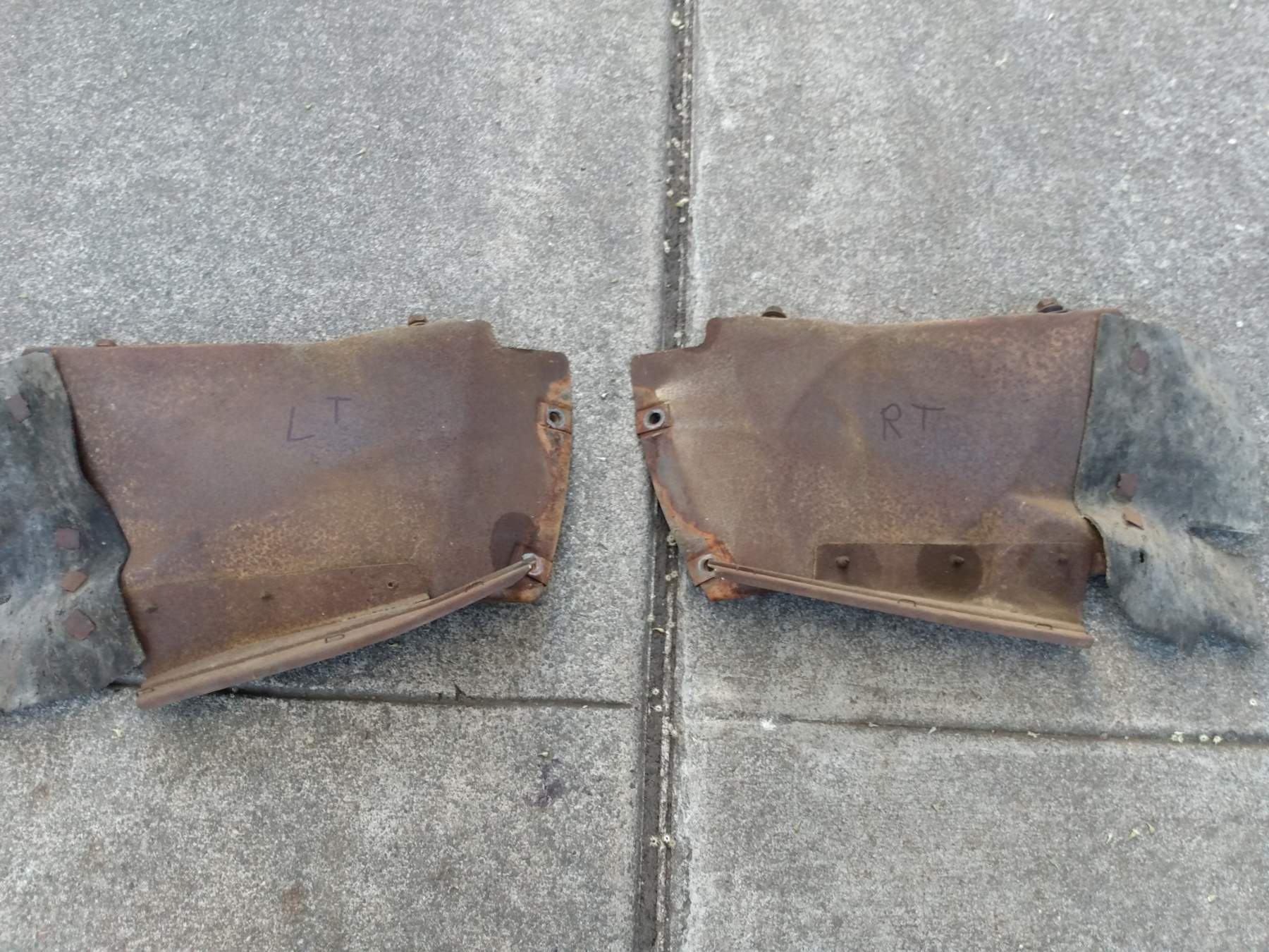

After removing the evaporator and heater fan housing on the firewall i realized that the heater box on the inside is sandwiched with the pieces that i removed and the firewall so now is the time to remove the inside heater box also to replace all the seals and make sure everything works, after removing the inside heater box we found some small rust holes in the floor on the passenger side but nothing else inside the car except for some surface rust around where the heater box was mounted so i started sanding it down and we will have to see if i can just weld the holes in the floor or if i have to cut some pieces out and replace.
Going to put disc brakes on the front,Had a long discussion with a friend of mine that builds cars for a living for a car collector and has tried a lot of the kits out there through the years oh yea he is pretty opinionated also 😁 after a lot of back and fort i found a kit at ABS power brake here in Orange CA that bolts right up to my stock spindles and uses calipers from a late 80s Cadillac and i am going to run manual brakes, got a brake master from a 72 Vega with a 3/4" bore and this is also something my friend had tried before so we will have to see how that works on this one. According to him he gets almost the same pedal effort with this as with a booster.
I am still fighting with the rear "hidden" oil galley plug that doesn't want to come out might have to take the block back up to the machine shop, would really like to get this one out so i can clean it properly before i put it back together.

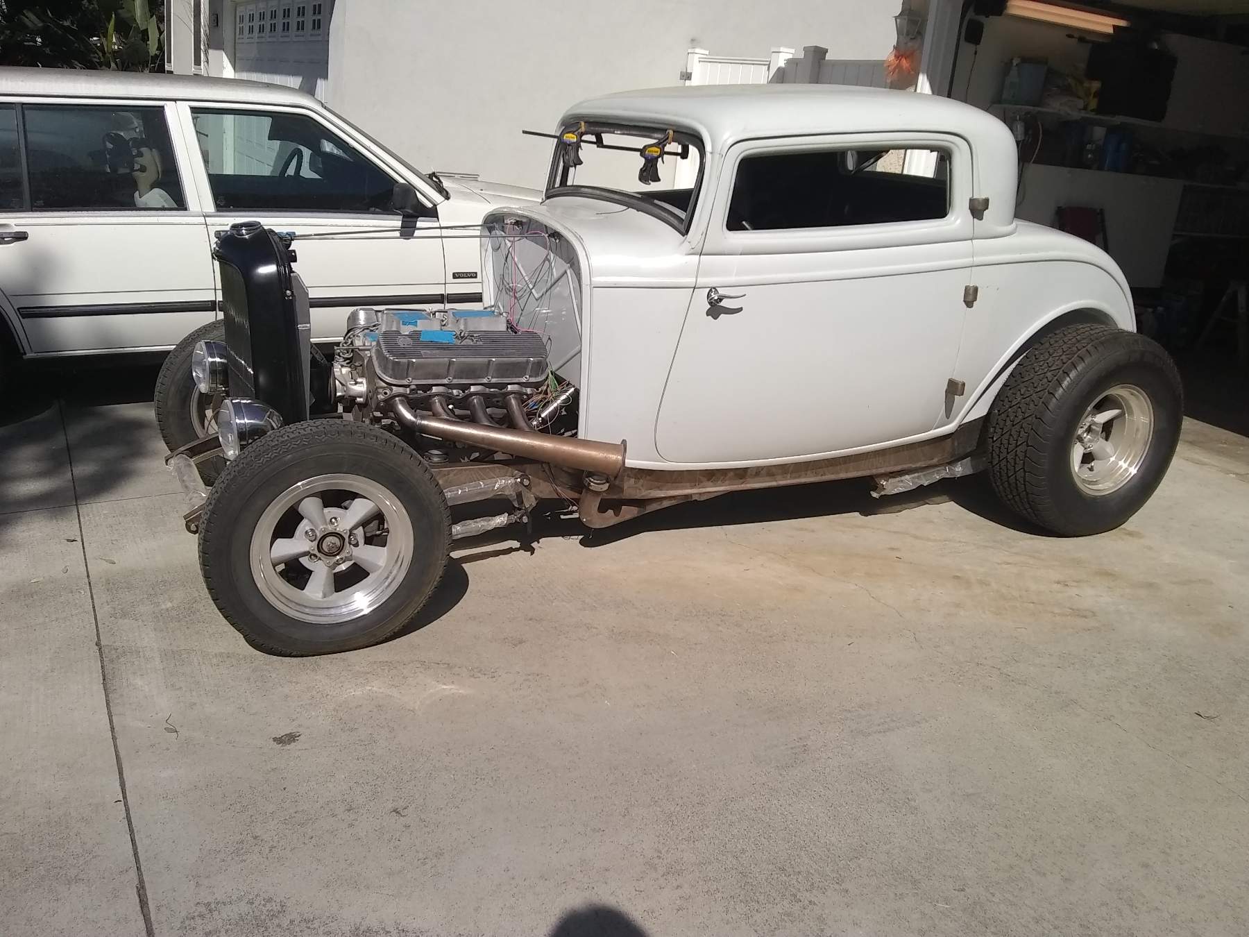

There is parts everywhere, running out of space my garage i kind of small and my 32 is in there too.

Not finished a Pontiac got in the way😁
Super nice Andy, you have done a bloody great job,she is a 33? with those doors
and you have built her your self???
i love rat power toys, i ran a 454 in my 56 chevy  👍makes for a really fun car!!!, you will never have traction! hehehe:cheers:
i know the feeling about the car that gets in the road! i had my 64 pop up and i justA had to buy it, and since then i have been addicted to getting it on the road.
 Before the bonni came into my life, i was building this girl, she a hq holden 1972 but without the 186 engine, i am running  a fully balances and blue printed small block 400.with a whole bunch of goodies internally👍

You guys have all these really cool Holdens that never shoved up here in the US, what is a 186 engine? straight 4?
Mine is a 32 with a 489ci and tko 5spd, you got it will have no traction, so what😁 that is why the kids probably should not take it out so the Pontiac will work better.
Well Andy i justA learnt something! your 32 is the only body in 1932 that got the suicide doors being the Deluxe 3 window!! i thought all 32 had front hinged doors!  very cool mate 👍

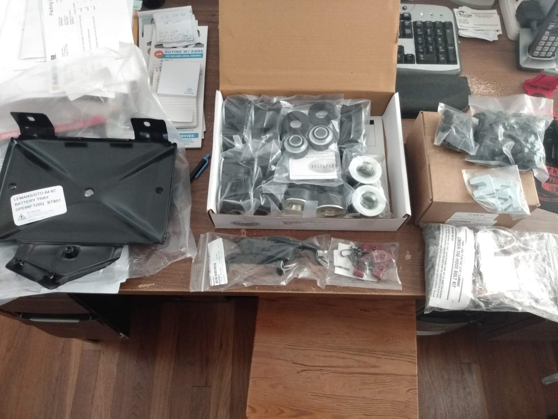

Shopping trip today down to OPGI , the body bushings came earlier than expected.
Wow, glad I'm not that close to OPG.  Do they rent rooms too?  :willy_nilly: Nice haul.
