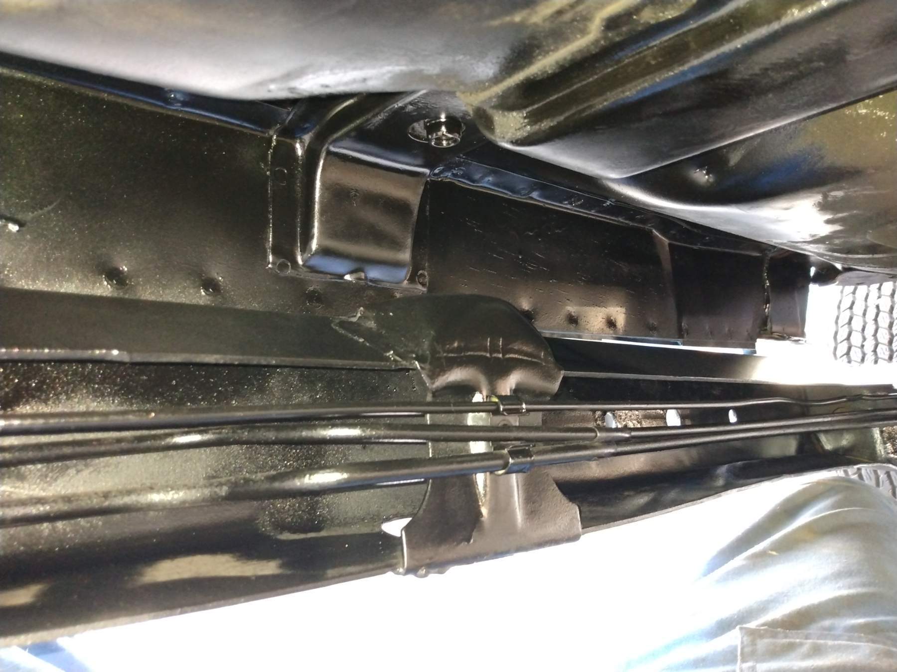

  • So i finally found some pictures of how the trans cooler lines are supposed to run an it's apparently on the outside of the manifold so i made some lines pretty close to that, had to make one splice o

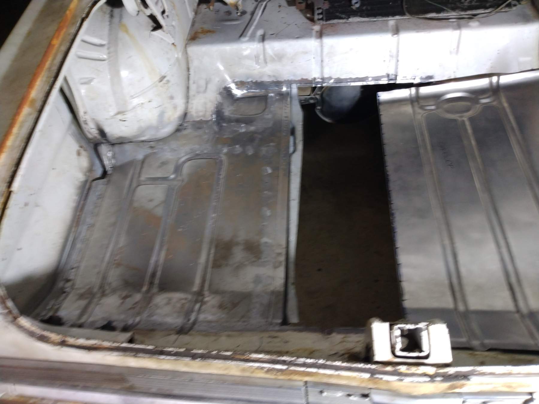

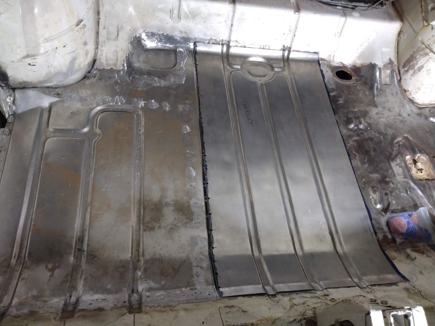

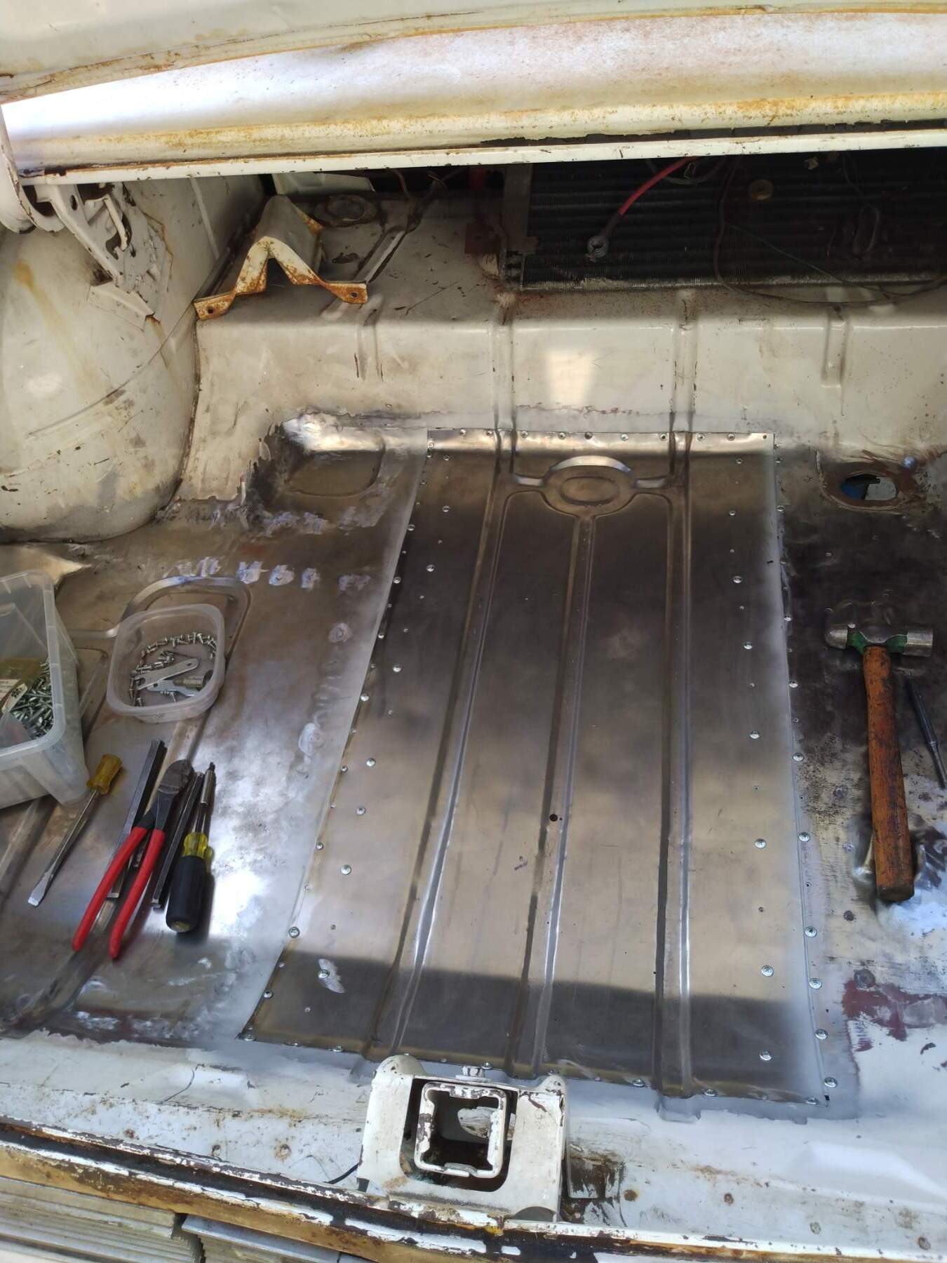

Left trunk floor panel done, took a long time to make it fit they way I wanted, on to the center panel.
Used weld through primer and I think i put it on to thick did not want to weld real nice but turned out ok after some grinding.
looks good mate :cheers:
Welding new to old is always going to be fun, at the end of the day you know its good.👍
and thats all that matters. because your driving her down the road and know its right.
i really enjoy sheet metal work... if something doesn't fit you get to bash it into want you want it to be !!!
 and if that doesn't work! you start again !
that might sound kind of metaphorical :rofl::cheers::stars::rofl:
the center panel fitted and screwed down, I'll fire up the welder tomorrow if I have time.

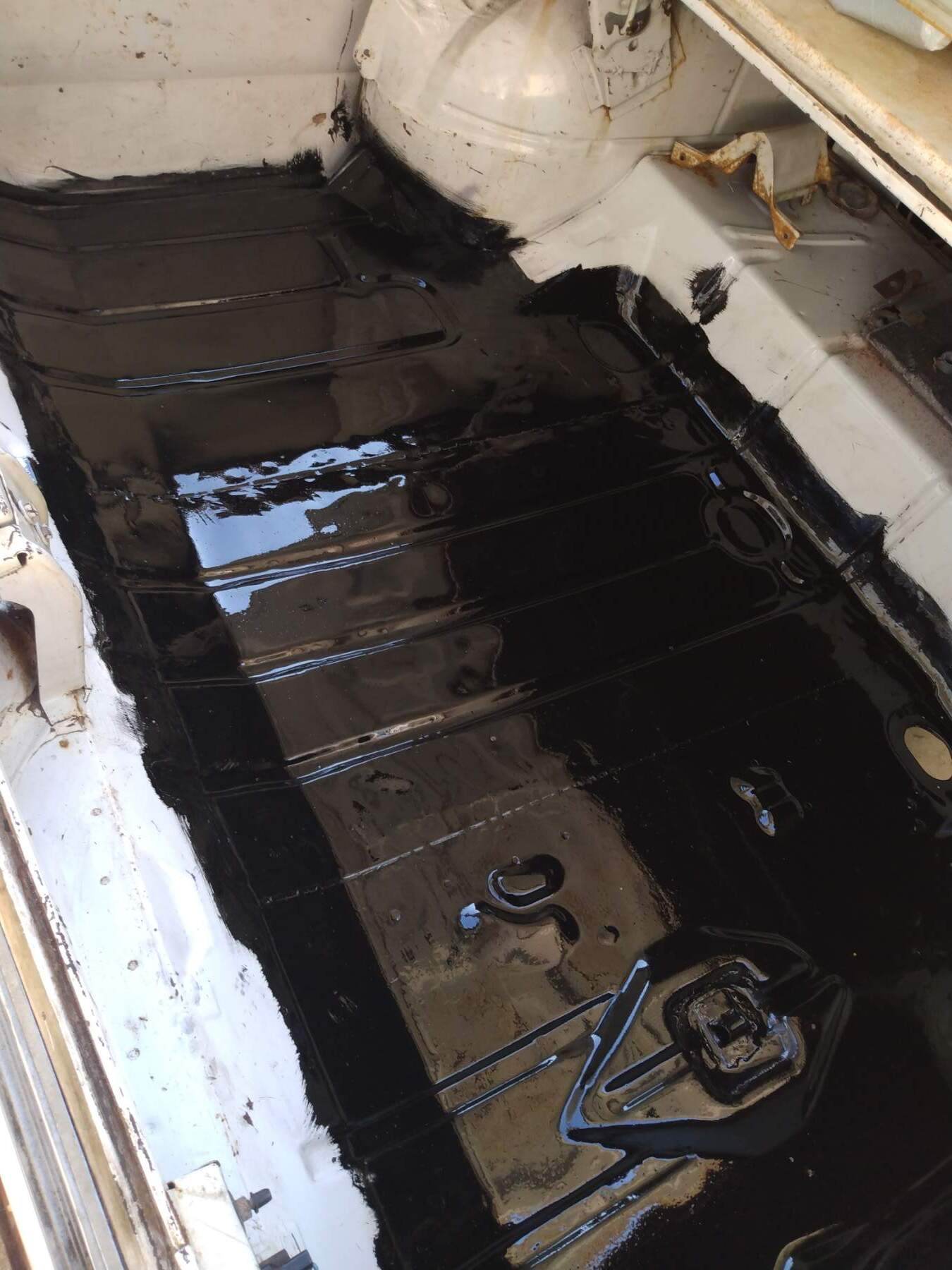

Trunk is almost done just need to put on some seamsealer in a couple of places and one more coat of paint.

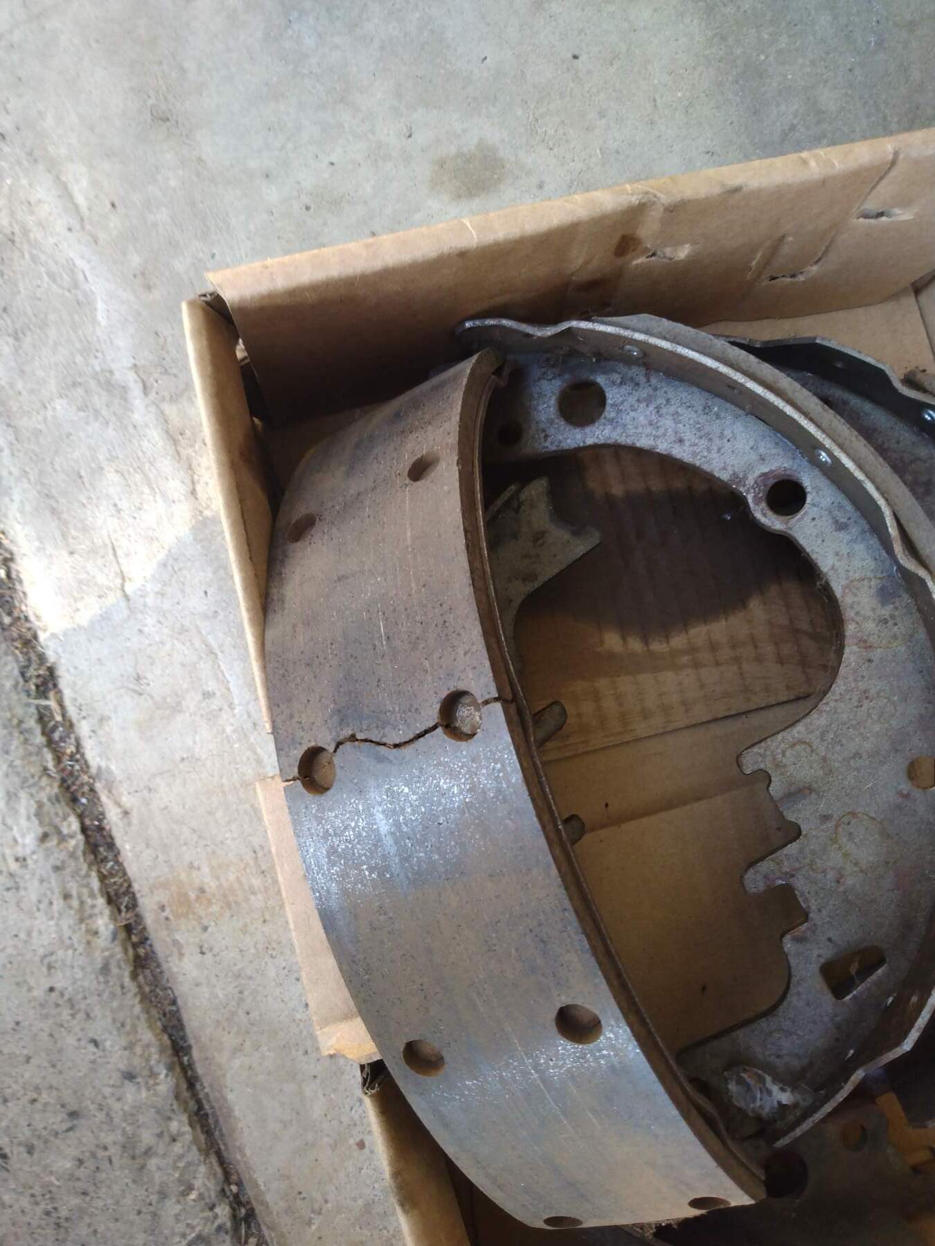

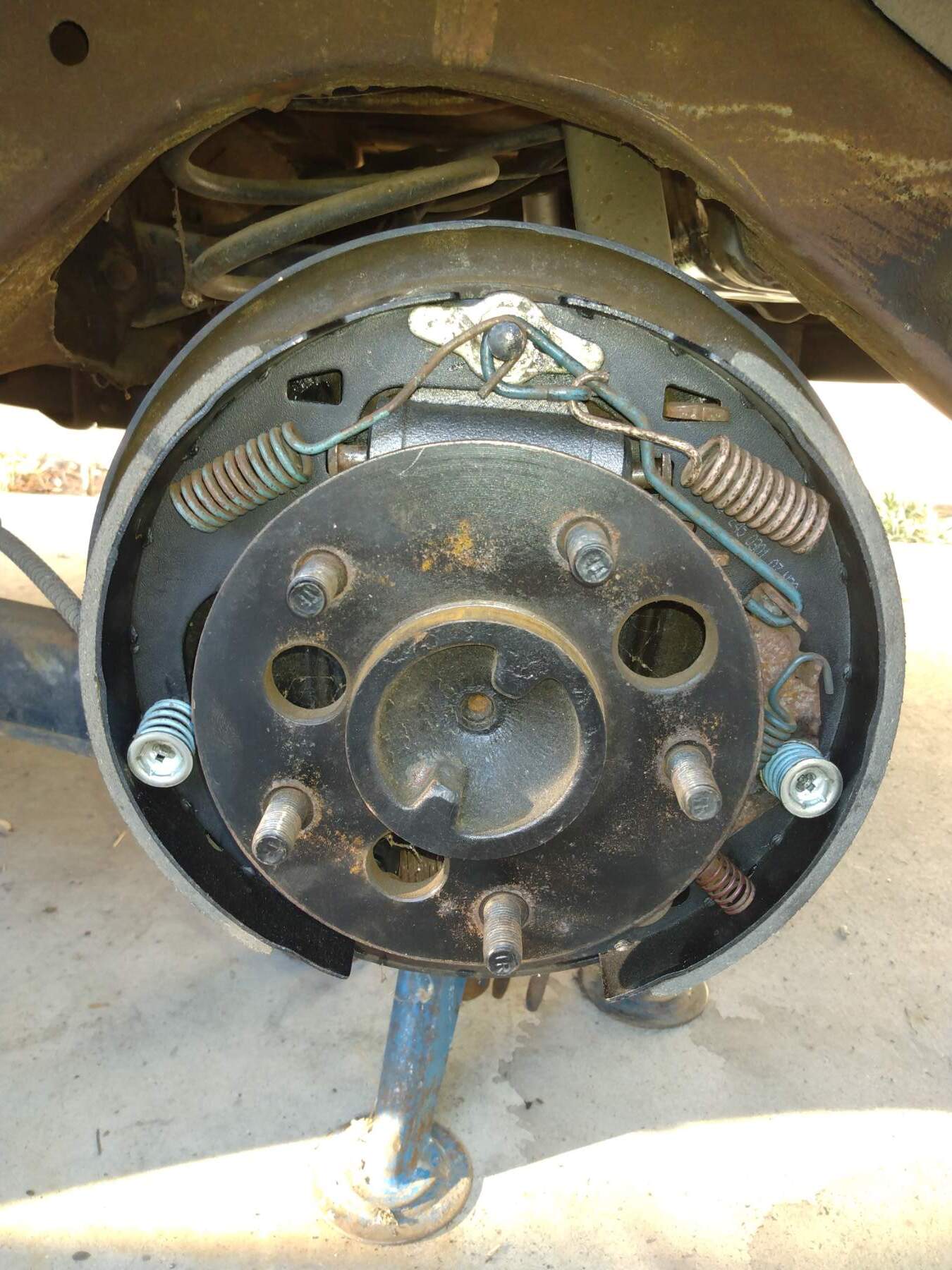

Wasn't going to change the rear brake shoes but one was cracked.
Believe we have had this discussion before, the short lining in the front but the new ones are both the same but one is thicker.
Asked the interwebs and apparently this is not uncommon, thicker lining in the rear supposedly,. Anyone run in to this?

i am about to take my brake linings to my brake guy Andy i will ask him :cheers:

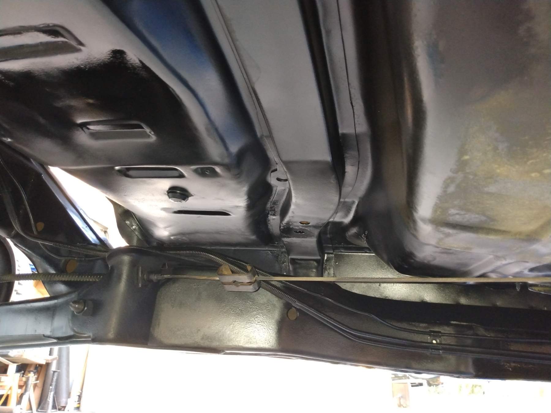

Have been working on the under side of the car wire brushing everything as much as possible, removed the body to frame bushings on one side and lifted the body up as much as possible to get in with the air tools, ill see if i can gets some pics during next weekend.
Sprayed the areas that has been wire brushed with Eastwood rust converter and let it sit for a week to completely dry and then sprayed with chassis black, have the back end done and more than half of the left side, hopefully i get time to finish at least the left side next weekend.

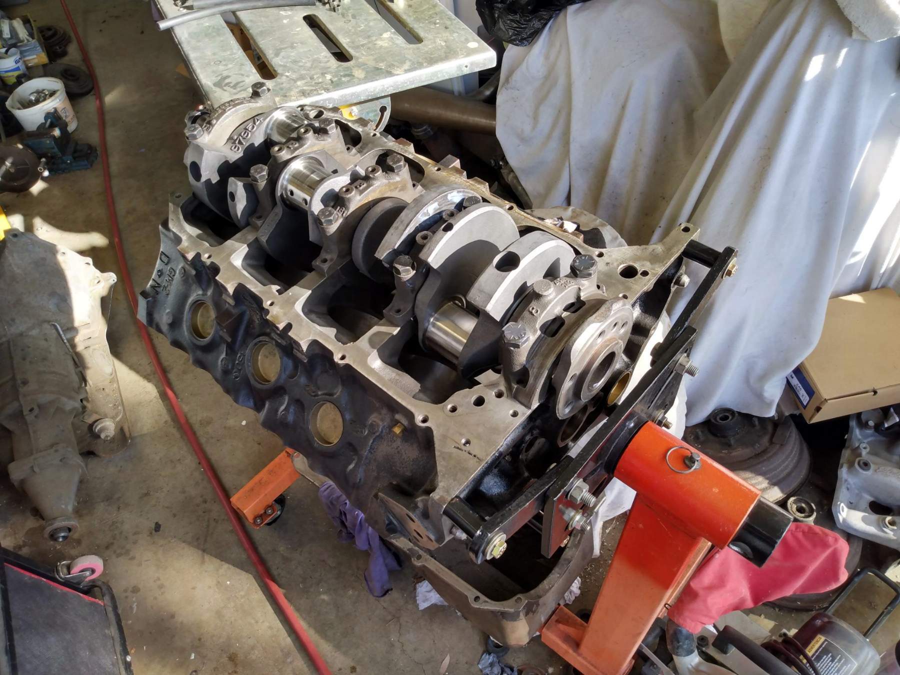

Started to assemble the engine, to dark to be out side after work during the week.
Have to decide on a camshaft, choosing between two comp cams grinds, any thoughts?
According to comp cams one should be used with a slight higher stall converter but for now that is not happening, would like to get a TH200R4 eventually and that would be the time to buy a suitable converter so for now stock but should i get he slight bigger one anyway or stick with the other one?
https://www.compcams.com/xtreme-energy-212-218-hydraulic-flat-cam-for-pontiac-265-455.html
https://www.compcams.com/xtreme-energy-230-236-hydraulic-flat-cam-for-pontiac-265-455.html

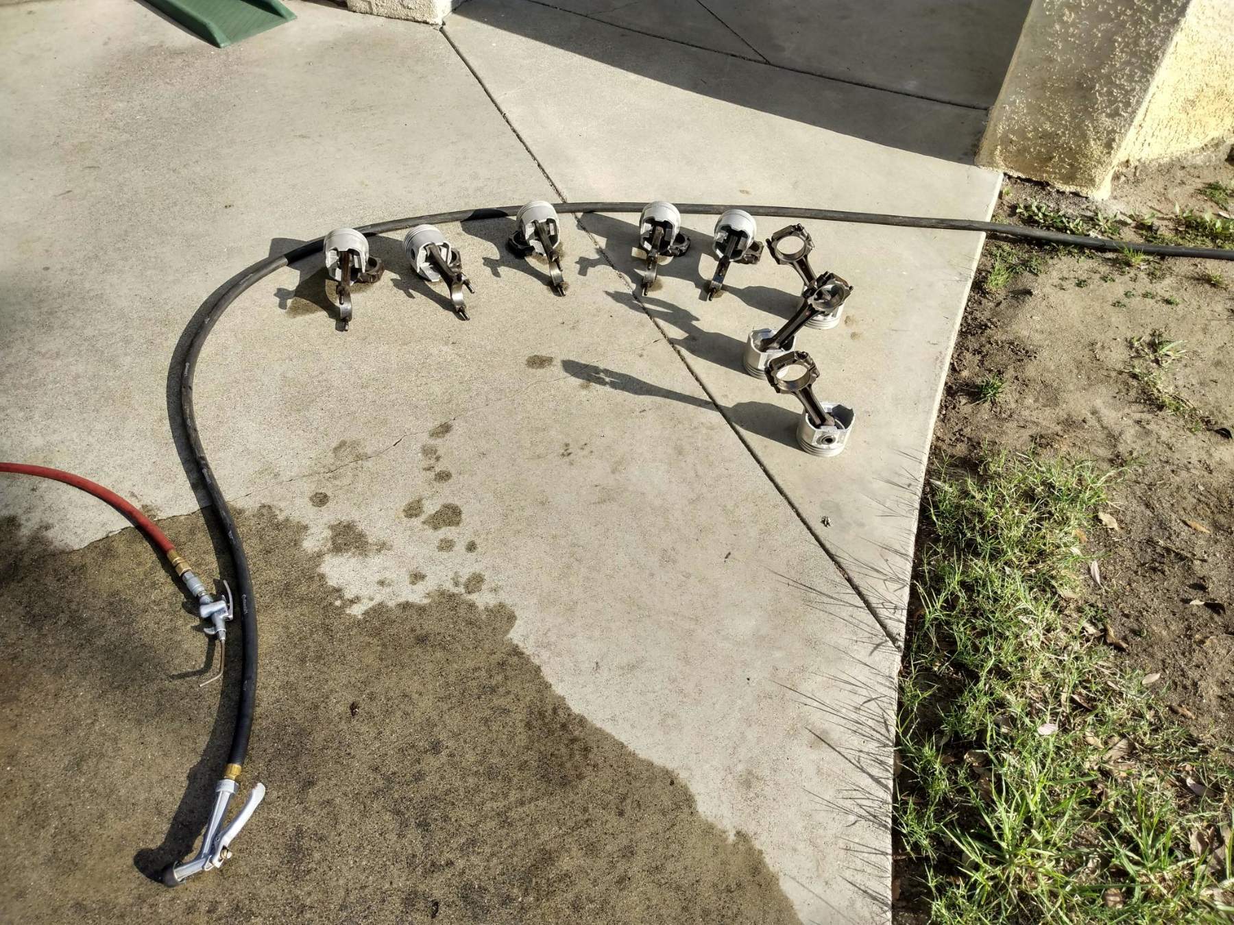

Got a little time on Sunday to wash the pistons and rods and let them dry in the sun so i can install them during the week.

Andy - what is your goal(s) with the refreshed motor?
If you are looking for a simple street cruising motor with some pep, the first cam will work fine with either the TH350 or 200 4R.
If you want a bit more of a street warrior with reasonable idle manners, than the second cam is more appropriate. However, power will move to the middle part of the RPM range rather than at the low end like the other cam. Free(er) flowing exhausts would do you well - a set of Doug's or Hooker headers or some factory headers would help you here.
As for the question on oil pumps, Lucy has a high volume/high pressure pump from Melling in her from my old engine builder. She runs 60-80 psi (according to the gauge)  most of the time except at low idle. When I see the gauge reading bouncing around, it is usually an indication that I am low on oil. While I was never asked what I wanted, that's what I know I have in her.

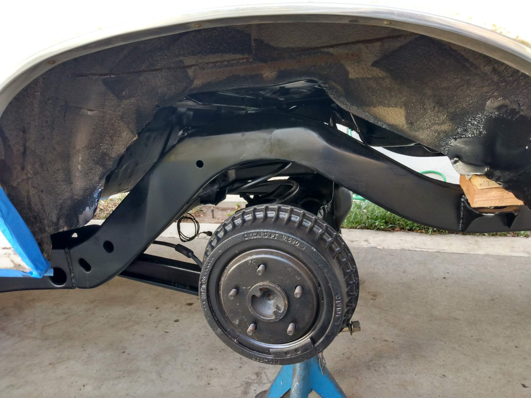

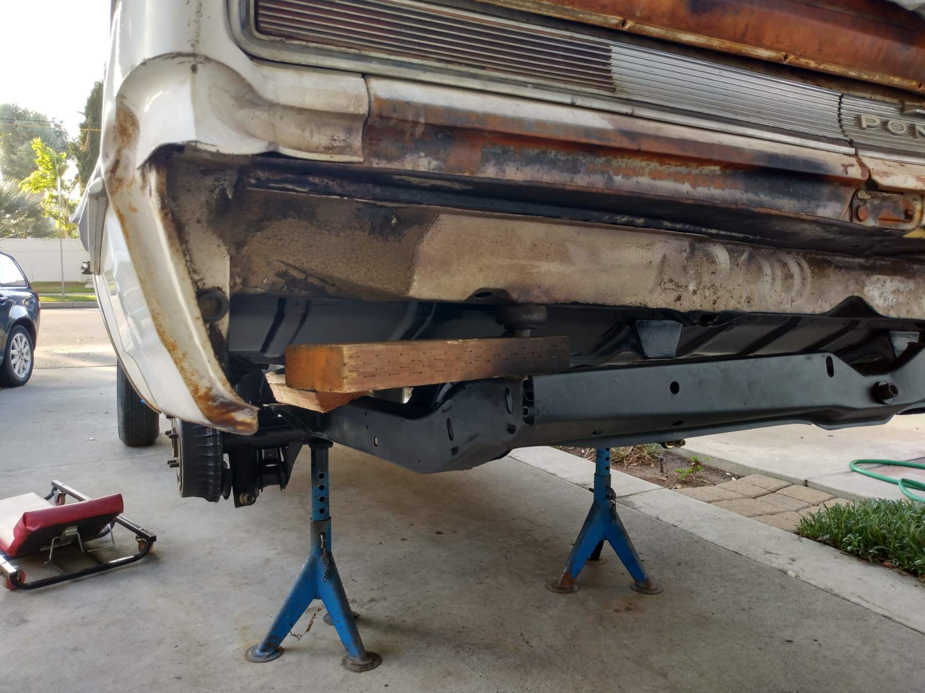

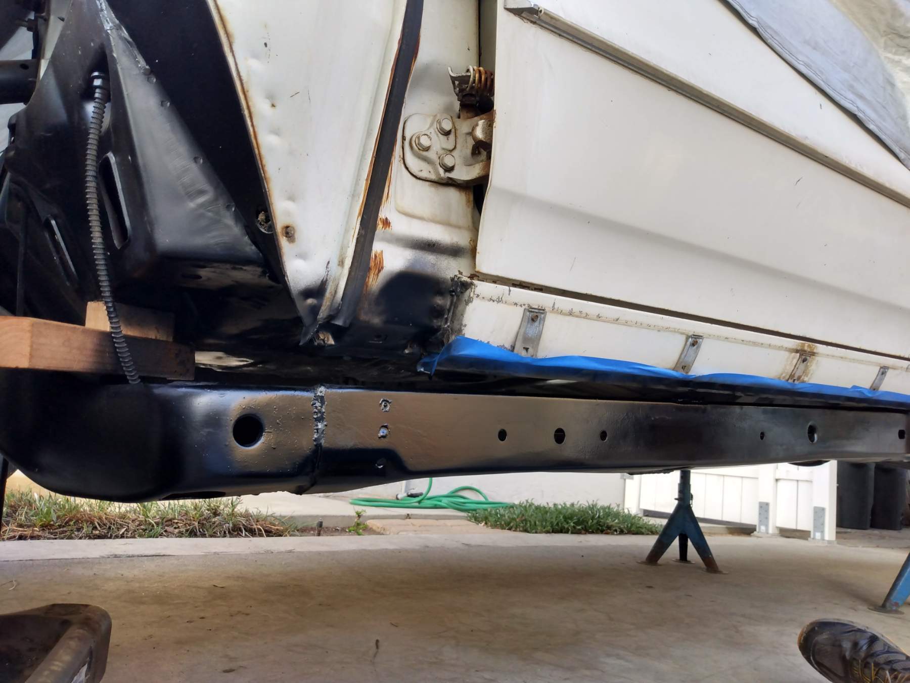

Got some time after work today to do some painting, removed all the bolts for the body mounts except for two on the opposite side from the one that I'm working on and jacked the body up and put some wood blocks in between the body and frame, wire brushed everything that is surface rusty the best i could then sprayed with rust converter  and let it sit for a week and today painting.
Still got the right side to do but the rear part is done.

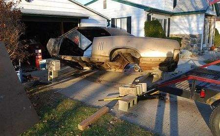

Andy, justA6 knows all about lifting  a pontiac body off its frame!!! would you like to tell Andy your encounter mate ???
Nuff said.....   Don't use cinder blocks with chip's in them.  Justa got my new frame out from under it when I heard PING   PING   PING   and the block exploded and of course the body hit the ground.  Sending my family in a tizzy that I was smashed flat and also bringing the neighbors running to help.  Earlier.... Busting the rusted body mounts loose,  the breaker bar with about 3 ft of pipe on it hit me in the face, when the bolt broke.  Quick patch job with DUCT tape,  but still a facefull N down into my shirt in blood.  After Justa throwing myself backwards away from falling body, I was layin there staring at the sky thinkin I GOT LUCKY that time IDIOT!!!  The sight my wife N daughter saw was a LIL overwhelming.:slap:
wow,Yes you got lucky, goes to show how easy it is that some thing happens, i have had cars upon jack stands many times and it would not take much for it to go wrong especially if you starting to remove heavy components. In the "early" days of being a mechanic i worked on the "floor" meaning removing a trans or replacing a clutch was done on jack stands.
Did not want to do a complete frame off on mine, don't have the space and equipment but when you start at one end and work on a car it is hard to stop, had to step back a few times and rethink how far do i really want to go? what was the plan again now?  I am pretty happy how it is turning out so far but it goes so slow there is always some thing else that you need to take care of kids sports that you need to attend, friends that need help and oh yes you need to collect enough points with the wife.
We had a city bus fall of the lift when a the guy was removing the diff and did not support it the right way, knocked another bus of the lift and crushed a few toolboxes but no one got hurt.
So don't use cinder blocks?
