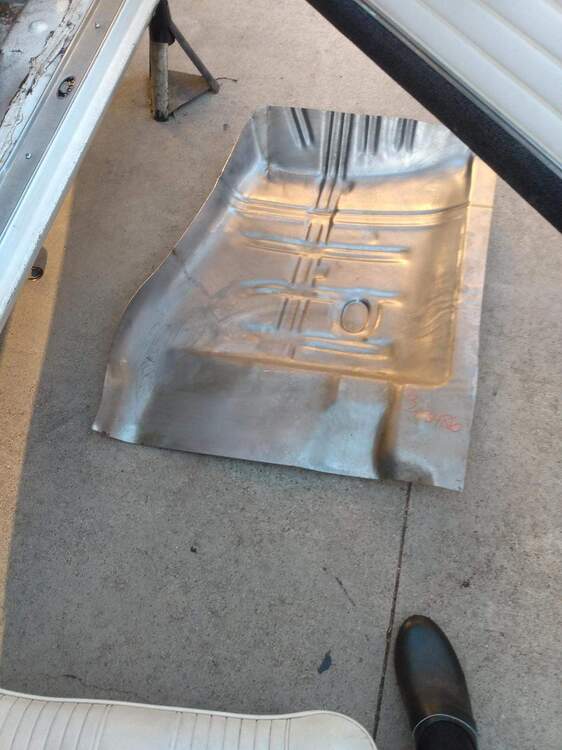

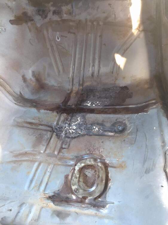

Started to work on the "small" rust holes in the passenger side floor pan ( the only ones in the whole inside floor) and they of course grew when i started to weld,so i decided to buy a patch panel and cut it down to what i need because i didn't feel like making one with all the beads in it.
A new panel from OPGI was $110 and i thought it was a bit hi for the little piece i actually needed ( about 12"X12") so i figured out that most of the GM A body's are the same and i have a place called Truck and Car shop just 5 min from the house that sell Chevy parts and they had one for $65 for a 64 Chevell but the down side was that i had to stand outside for 2 hrs to wait for my turn to buy one, but they usually have the parts in stock so it worked out.
Oh super smart move :bowdown:well done mate :cheers:

Mocked the disc brakes up and had to grind the corner of the spindles of a little so that it cleared the caliper and then starting cutting the piece out of the passenger floor that needs replacing, hopefully i will get the floor finished tomorrow.

Finished fitting the patch panel for the floor, borrowed a tool to flange the edges, painted it with weld through primer,hopefully i get time to drag the welder out next weekend

finally got a few hours to finish up the floor, front suspension installation next.
