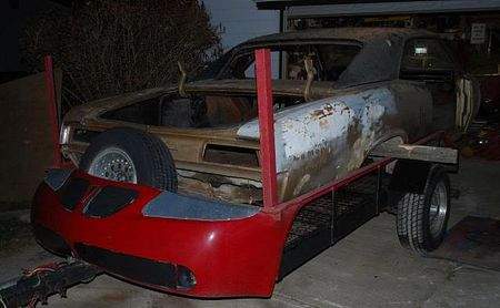

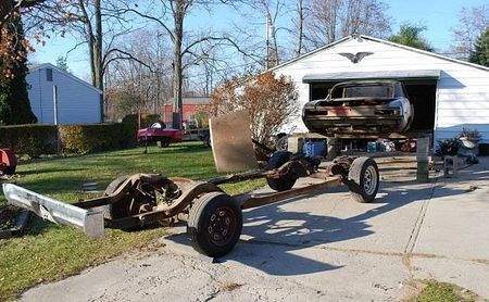

Posted them all at the time.  Justa for the story.  Thurs..Frame shop calls,  Get this POS outta here today.  Question, it's on the jig, If I get a frame would you transfer to new frame.  If it's not here Mon AM when I open, tow truck will be haulin it to the junkyard.  Few calls.   Fri, 7am meet guy in Saline (about an hour away) Completely strip a running car, including wiring down to body on two rolling wheels.  Drag home on T trailer.  People going nuts on me. Flipping off, swerving at me. Pull over to find rear window blew out of car towing @ 60mph on 5 lane expressway. Expected PO PO to be @ my house by the time I got home.  By 6pm, had my prize new frame out and body on trailer.  Worked til midnight, stripping frame, sanding then took my bloody self in for shower and collapsed. Saturday AM back to work straight through til Sunday night.  =  Painted and ready for my body. (2coats rust restore,3 coats frame black, 2 coats clear) Shop dropped my body on, but they didn't throw the 2 bolts I asked for into body mounts.  Had to stop and relocated on frame after almost loosing it twice on way home, esp on my bumpy ass dirt roads. Note my Pontiac utility trailer had 1 inch clearance on each side with body loaded.  All done by myself......Where were you again Frosty???  Had to move my complete front to back new suspension parts over to new frame.  That's the story of my weekend and I'm stickin to it...... Pic's don't lie.  Is that why we all like pic's so much around here?:stars:
Edited by JUSTA6
Like I said - I've heard the story a few times now. JUSTA never saw the photos, especially of the cinder blocks giving way.

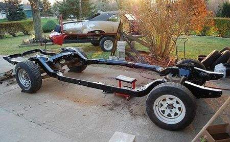

That was the last pic on the bad frame.

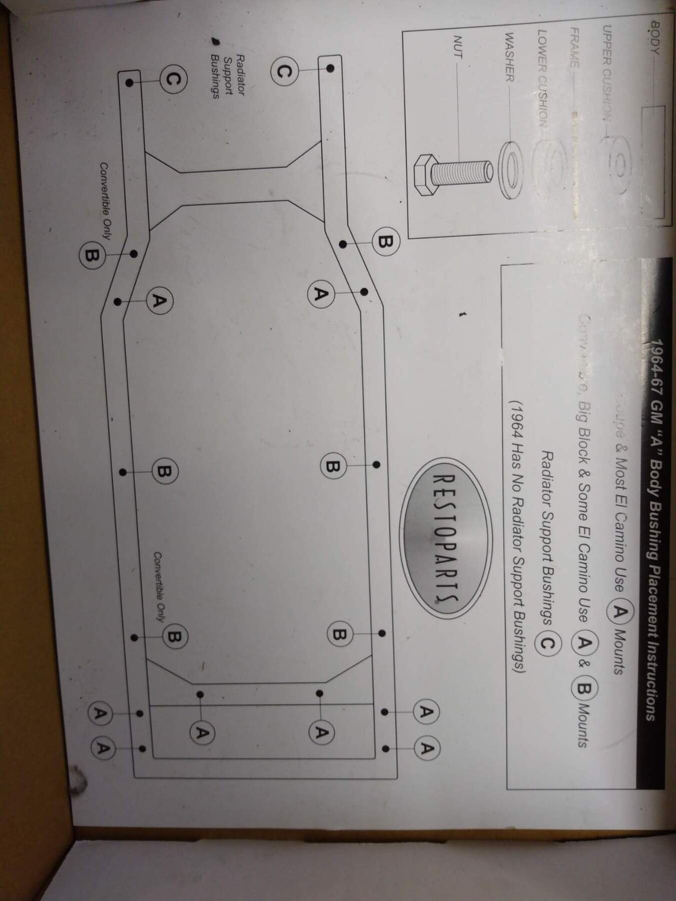

Anybody that has replaced body bushings?
Had a couple of hours last night and started to install the body bushings on the side that i painted the frame on but the bushings in the middle(position B in pic) has a smaller hole in the frame and the bushings in the kit are all the same, anybody run in to this? The kit came from OPGI.
no sorry Andy, the Bonneville, all 14 bushings and bolts where the same
This one only has six mounts per side but the kit had a total of 14 mounts, kit is probably one size fits all.
Also noted that the original mounts had a metal reinforcement ring against the frame and of course the after market ones don't.
Going to see if I can set one up in the lathe and try to cut down the step, otherwise I'll have to cut it down by hand, only need 12 have 14 so i have a couple to practice on.

Found the answer in Ames catalog, they have it explained and listed but of course i bought mine from OPGI because they are right down here and I don't have to pay shipping.opgi don't mention anything about this.
That's what they call find out the hard way.apparently according to Ames there is two types of bushings for the core support also but the instructions that came with mine say no bushings used on 64, have to see if I saved my old ones, don't even recall if it had any. My kit came with round ones.
SO what does the Ames catalog state Andy?
Small diameter mounts used beneath the doors in some 64-67 applications wich is apparently what I got.

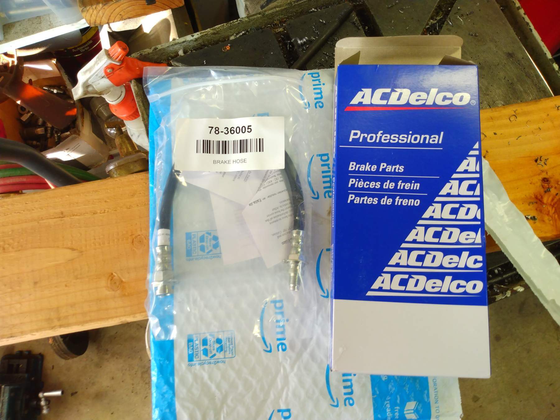

Blew out the fuel lines and rear brake lines with brake cleaner and air, good thing I did found that the rear brake hose was plugged, got a new one coming tomorrow from Amazon.

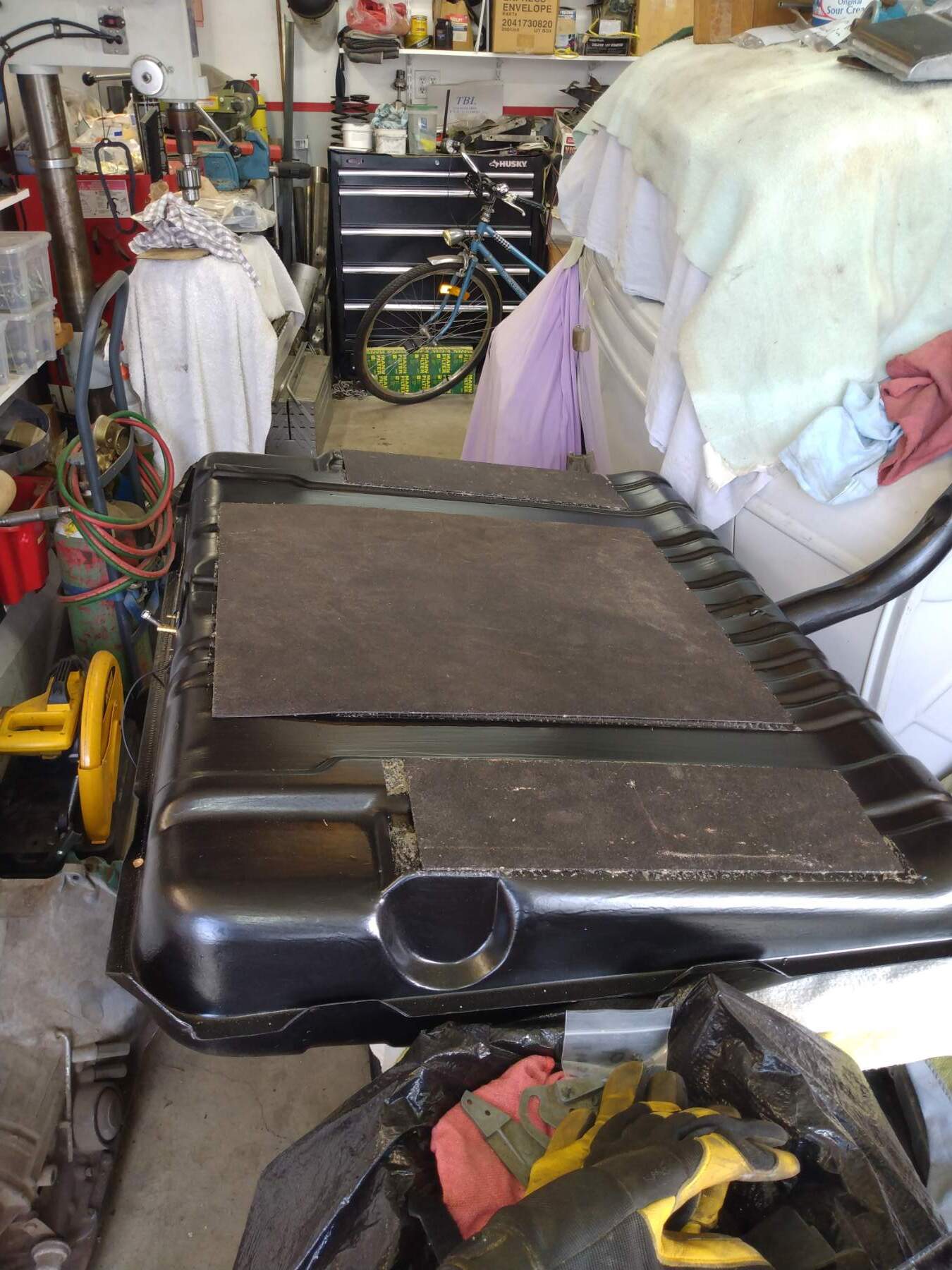

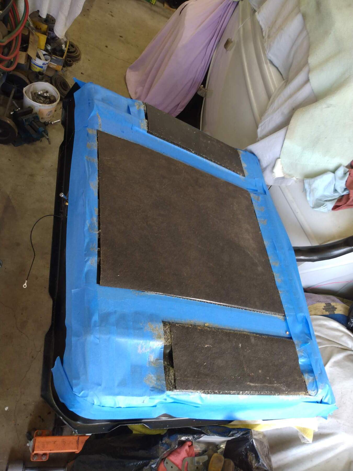

Glued on some tar paper to the top of the tank last night, have seen that there is special insulator's för this for anti rattle but what's wrong with tar paper? Also free in this case left over from the roof replacement last year.

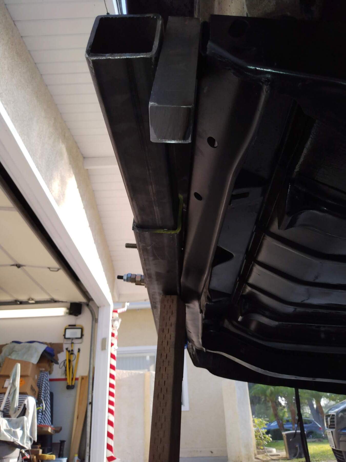

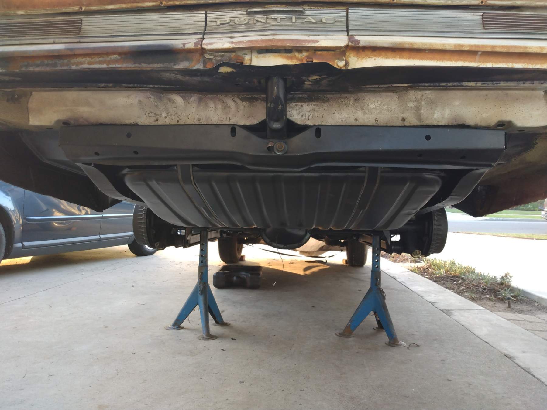

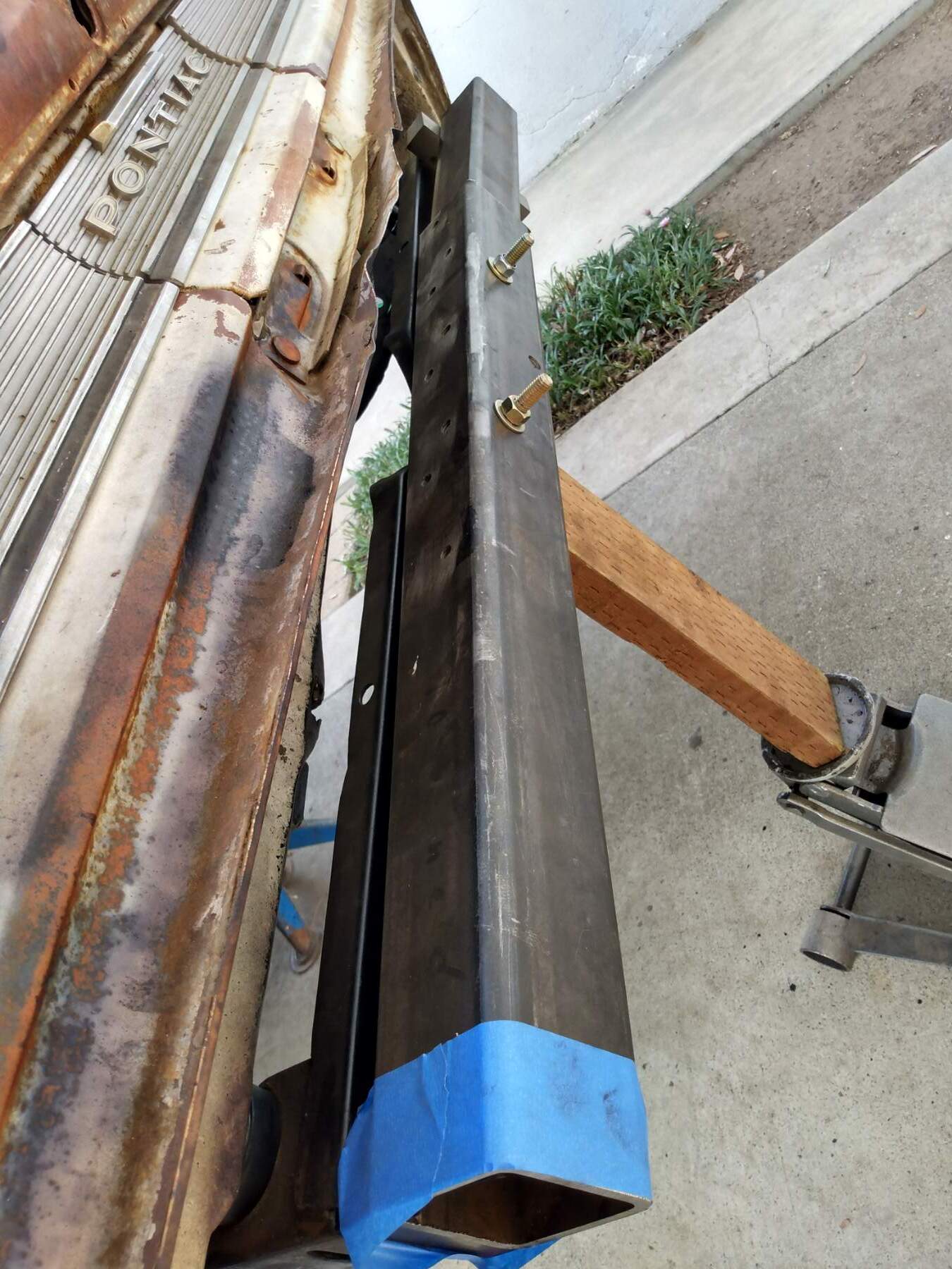

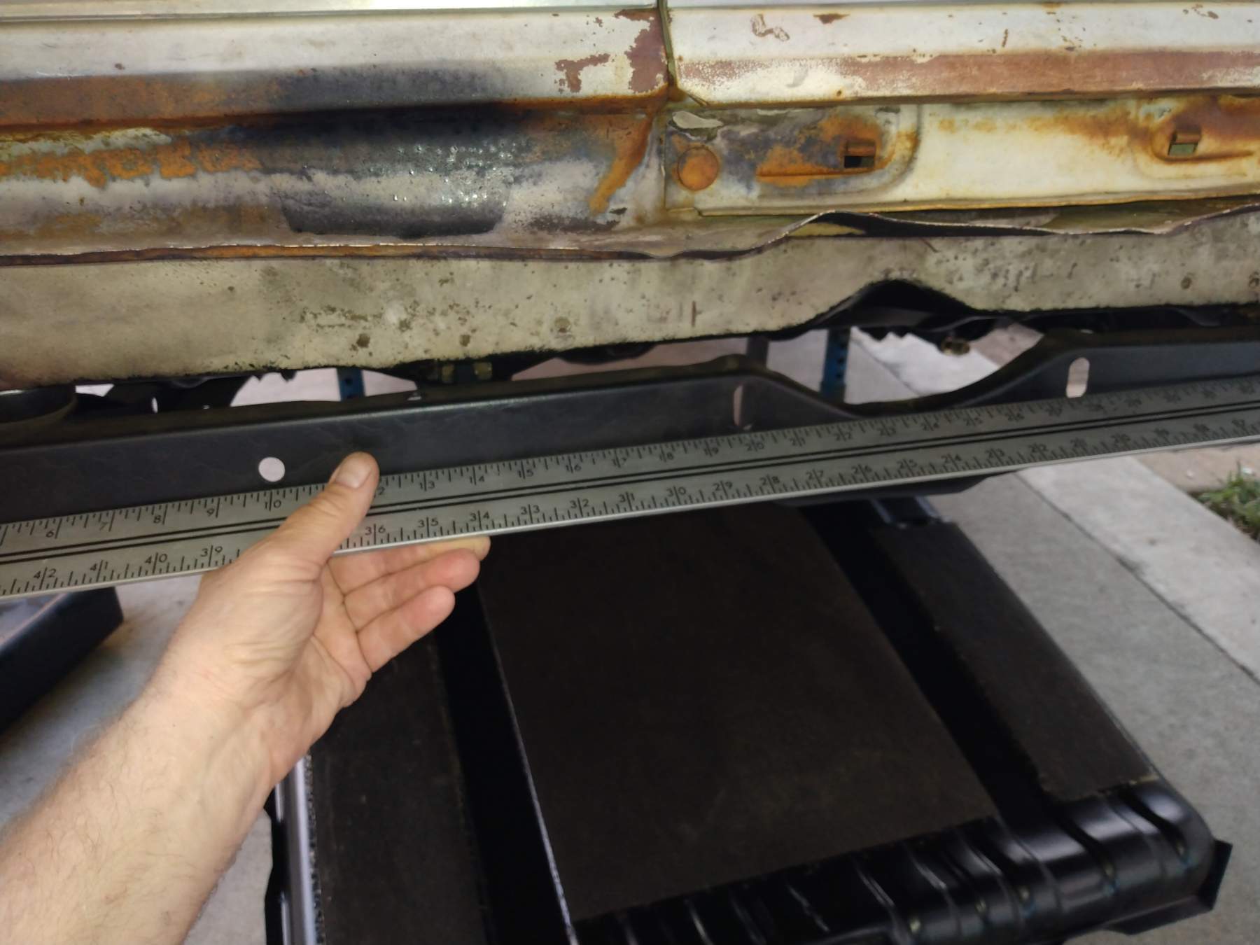

Tried to install tank but the rear frame piece is puched in about 1/2" to 3/4" so the filler tube won't fit between the body and the frame.
Think i will have to flip the car around and hook it up to my suburban to pull it out but my driveway is not flat in i don't have any brakes yeat, I'll have to figure it out.

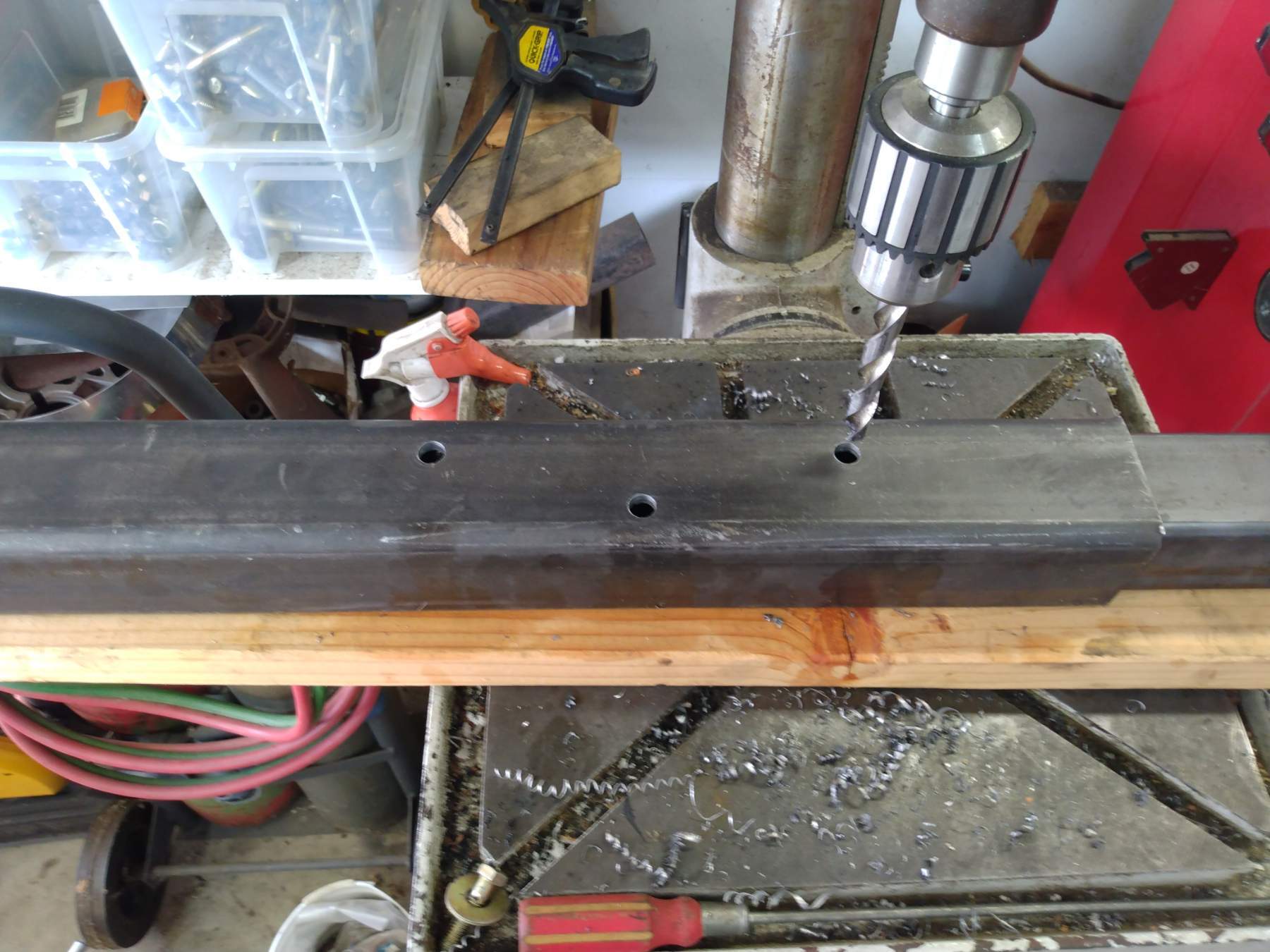

Figured it out, drilled some holes in a heavy gauge square tubing  to match the one's in the frame, spaced it out at the corners installed some long bolts and pulled the frame out.
While I was working on this my brake hose showed up from Amazon 2pm on a Sunday amazing so before i installed the tank i installed the rear brake lines.
