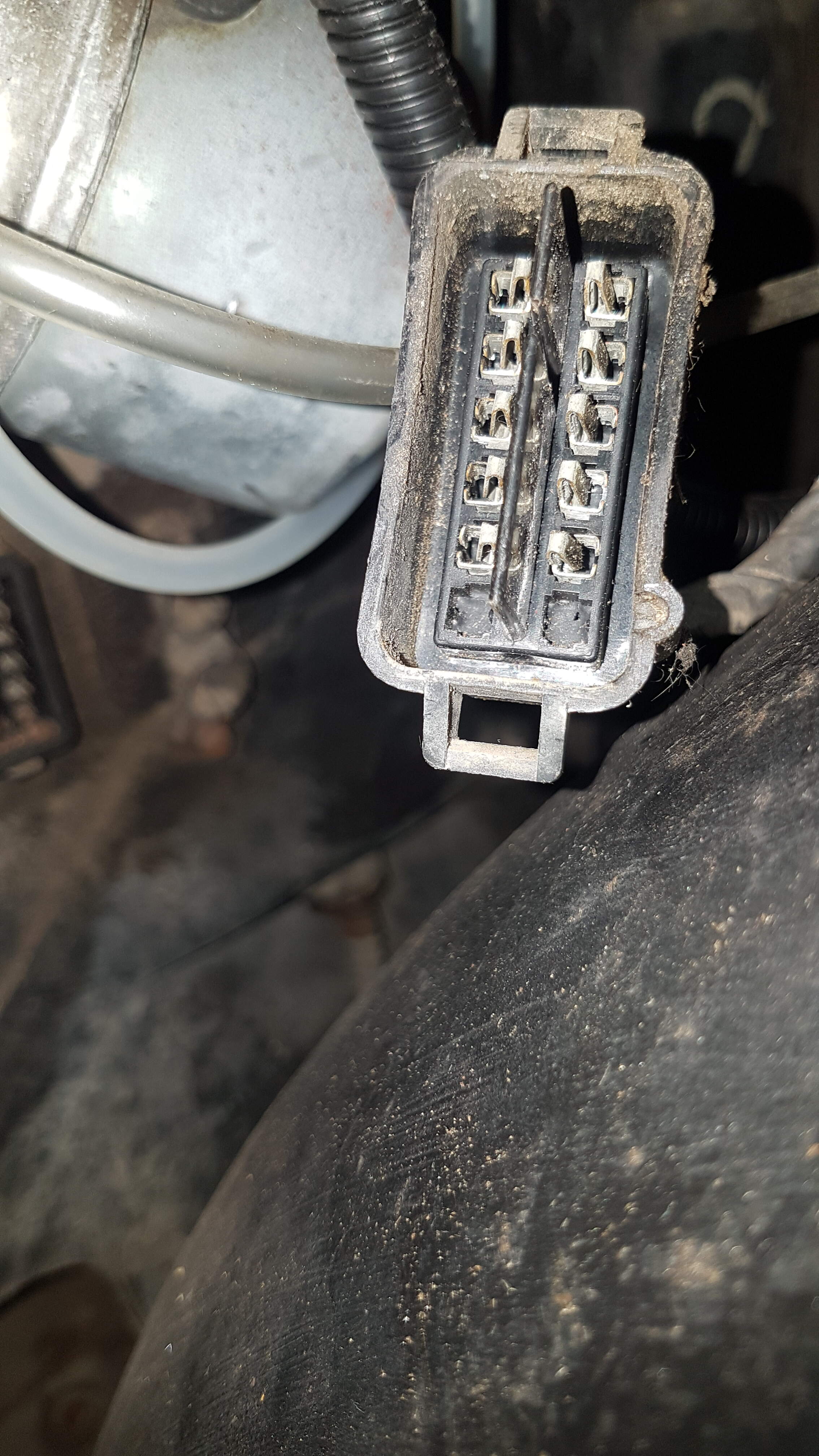

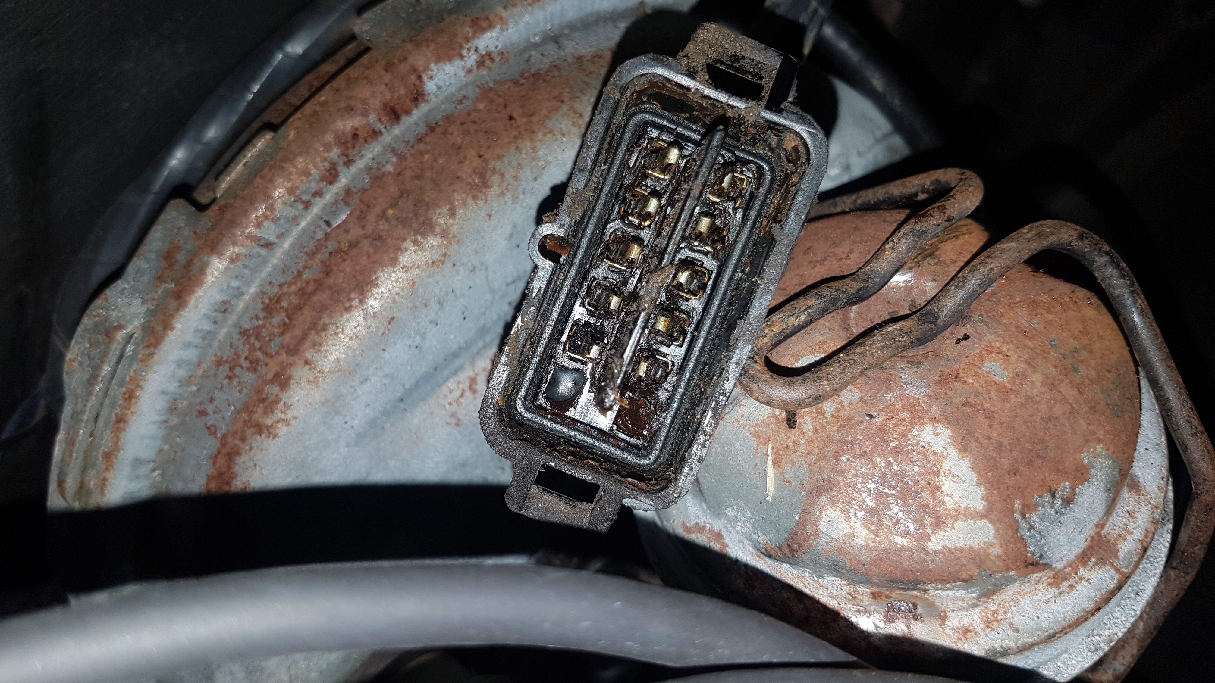

So today I thought I'd at least start it up because I haven't done anything since changing the leads. Took it around the block and it was faultless. Plenty of power, no carry on. I then whipped out the multimeter and checked a few things. Power to coil with ignition 'on' but engine not running is only 5V!!! It should be 12. With engine running it's 7.7V, which is about right due to resistance wire feeding the points. Battery voltage with engine off is 12.4. Engine running: 12.3. Yes, I know that's not enough. Tested fuse box with key to acc: 12.2. With switch 'on:' only 11.7.

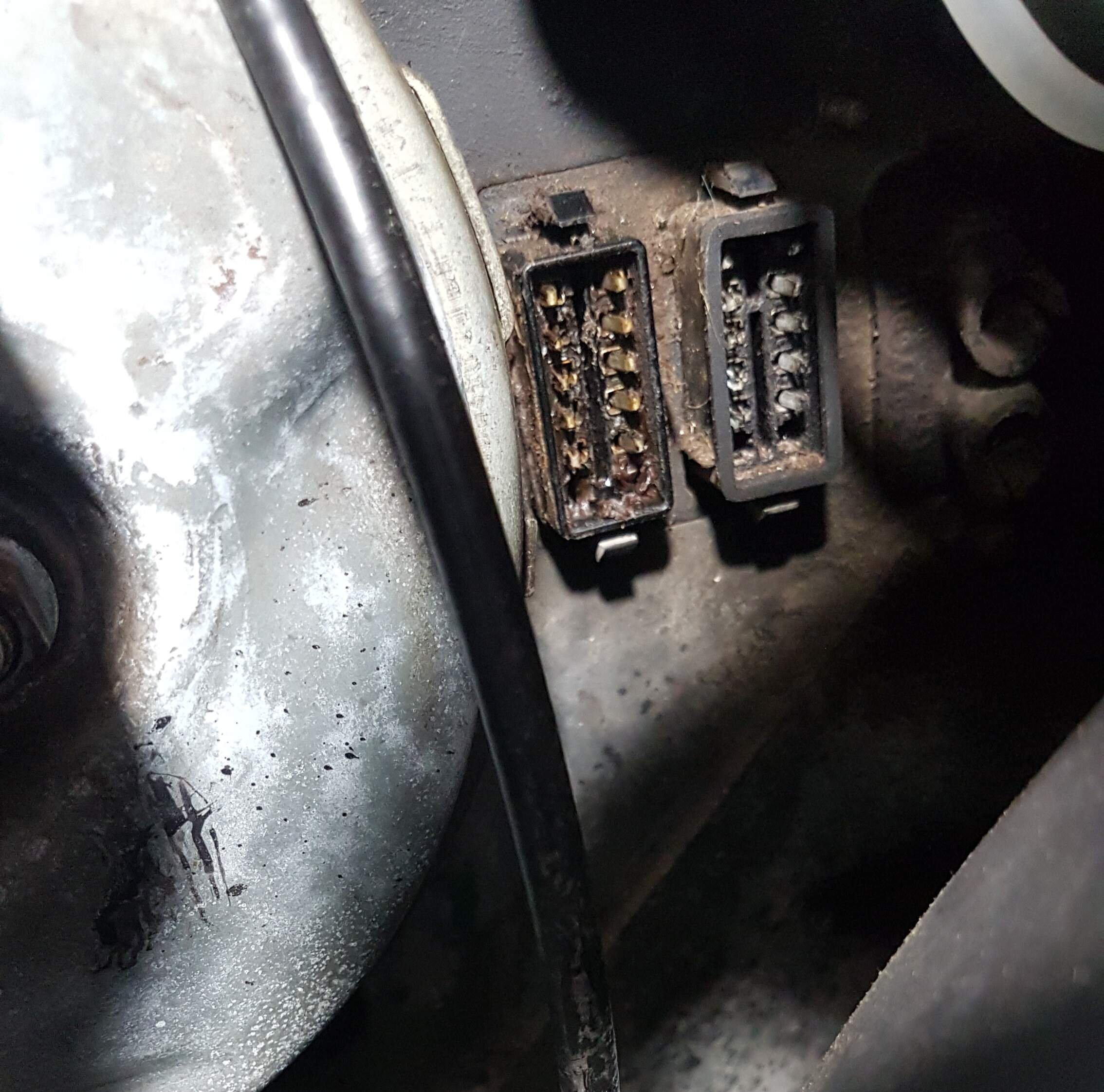

So i'm now thinking there's an issue with the voltage coming out of the ignition switch which shits me because I've checked coil voltage in the past and it was 12V, so something has mysteriously changed. Also an obvious voltage drop between ignition 'on' and 'acc' position.
Whilst I was under the hood getting cranky, I pulled the 2 firewall plugs that feed through it into the footwell. What a mess! 60 years of crap and rust in there. The pics are the 'before' shots. If you're thinking "why doesn't he get rid of the surface rust on the booster & master cylinder," it's because the master will one day be changed to dual circuit and whilst the booster is out, I can clean it up and paint it then. Whilst they were apart, I checked for voltage going in and it was 11.46. I checked for resistance between outer terminals and inner ones - zero. Checked for resistance across all battery terminals and their various connections, the isolaters and all the earth straps and the main earth lead - all zero Ohms.
So...I THINK I'm going to run fresh decent gauge wires from the correct terminals on the back of the ignition switch. The car's original resistance wire seems to be working okay but I wonder if a fresh 12V to the coil via a ballast resistor might be the better way to go?

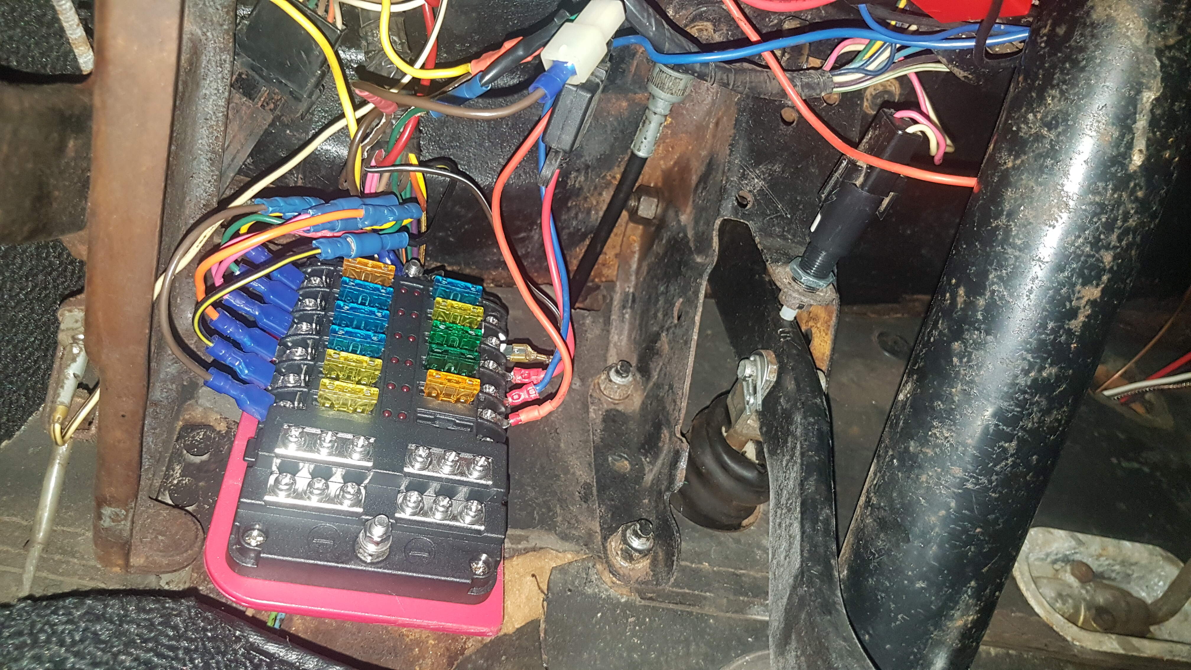

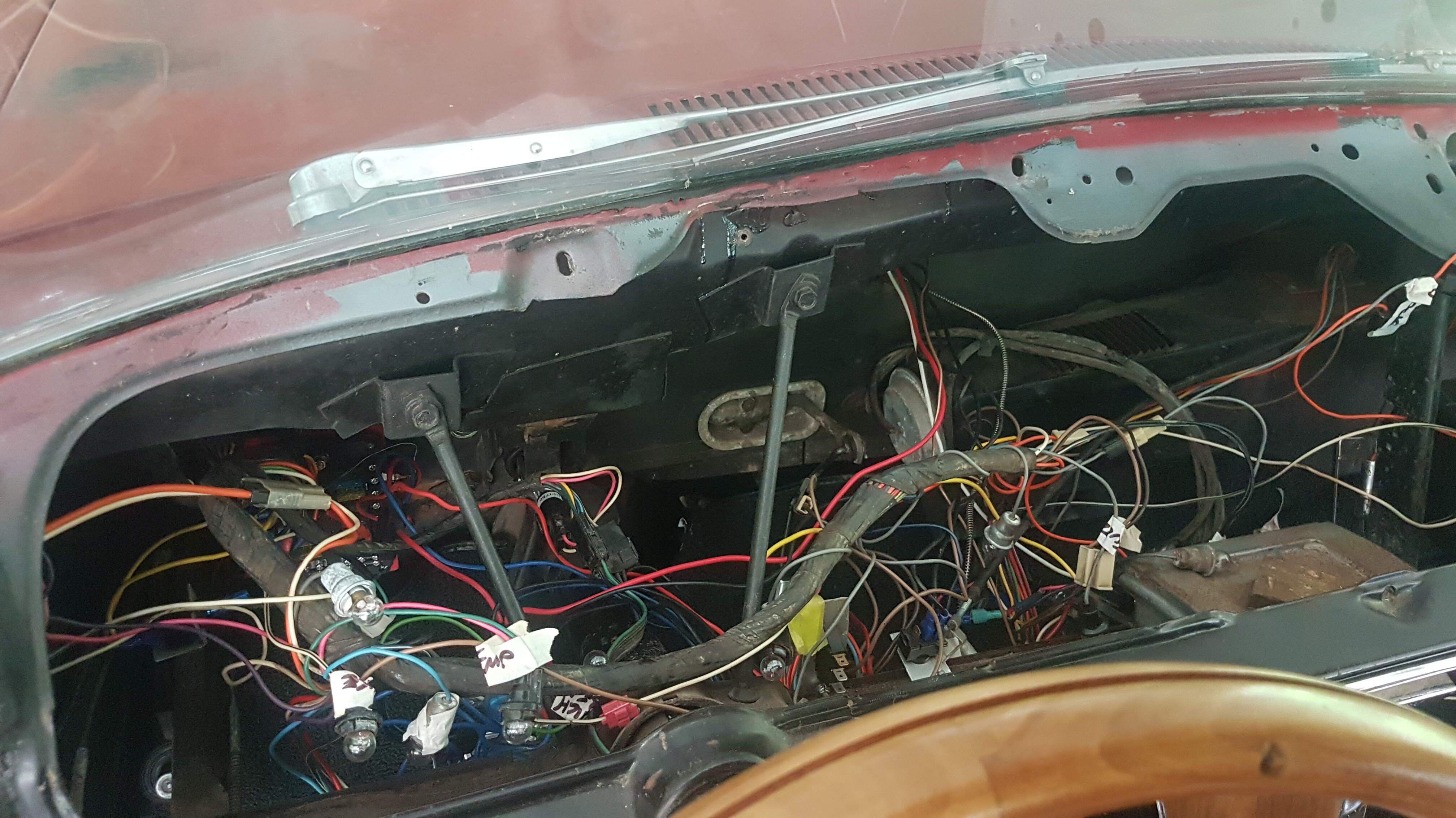

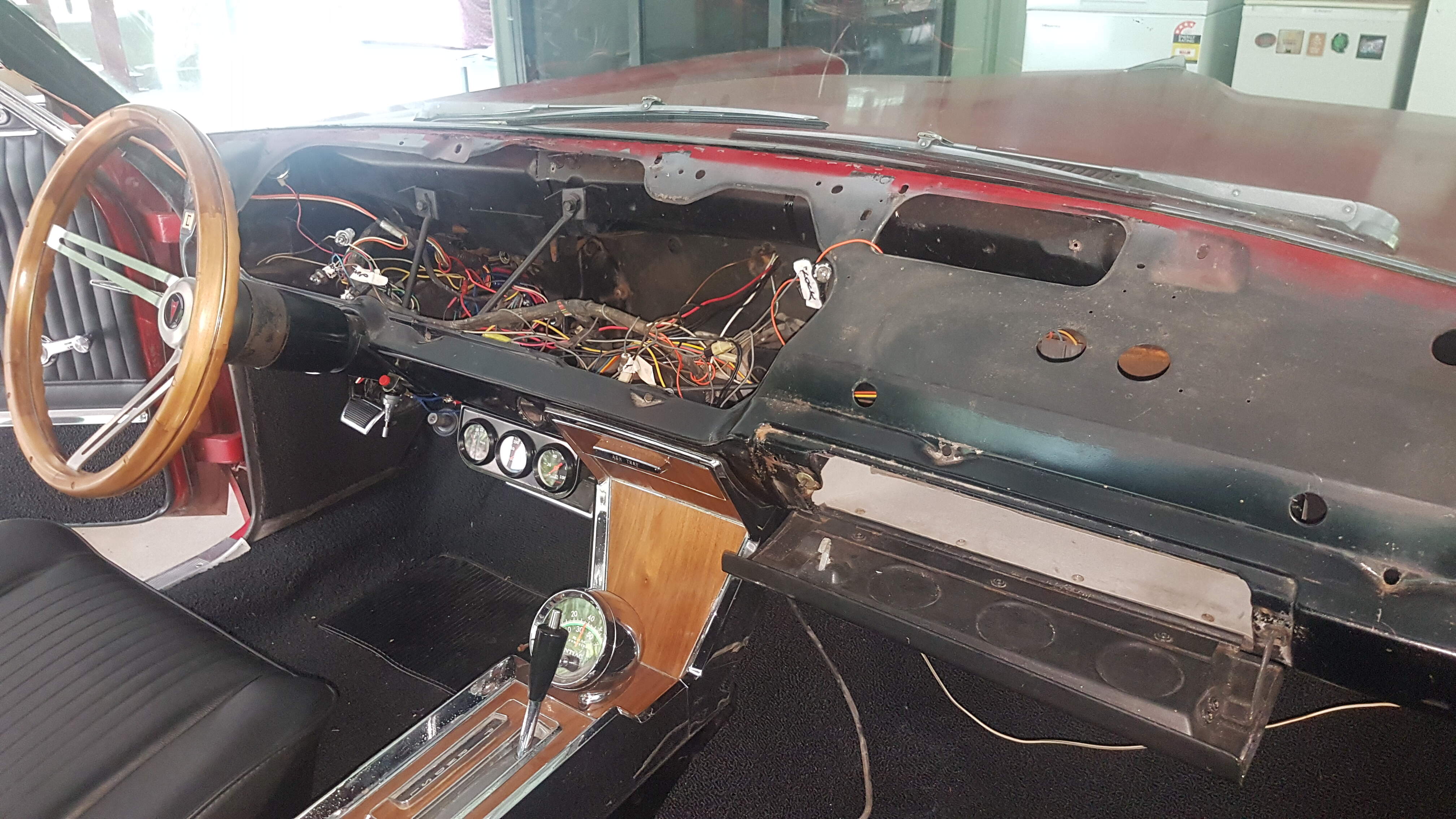

I was never happy with the electrics in that car. By my own admission, I rushed through it and simply plugged everything back in after I had refurbed the interior so it's my fault that it's come to this. The pics are embarrassing but let this be a warning to new players: do it once and do it right.
I saw an excellent YT clip on rewiring your car and whilst I mightn't go the whole hog, I will at the very least clean up the mess under the dash and add a bunch of relays AND a new firewall connection to negate those crappy 60 year old items.
As per the YT suggestion, I made a list of what needs power and divided it between front of firewall, cabin and anything beyond the back seat. Once you make a list, it's surprising how sparse it is. My car is without aircon, power windows & seats and I will simply bypass the heater, cigarette lighter and any other useless items to keep it as simple as possible.
I looked at regulator adjustment and there's a single spring loaded little screw in there. At the appropriate time, I will test alternator output and see what the reg is doing. This is a chance to get the fuel gauge calibrated correcly too and I can clean the faces of the speedo and instruments a lot better than I did the first time. I might even hook up the Frosty Memorial Tacho whilst I'm under the dash grunting & sweating.
