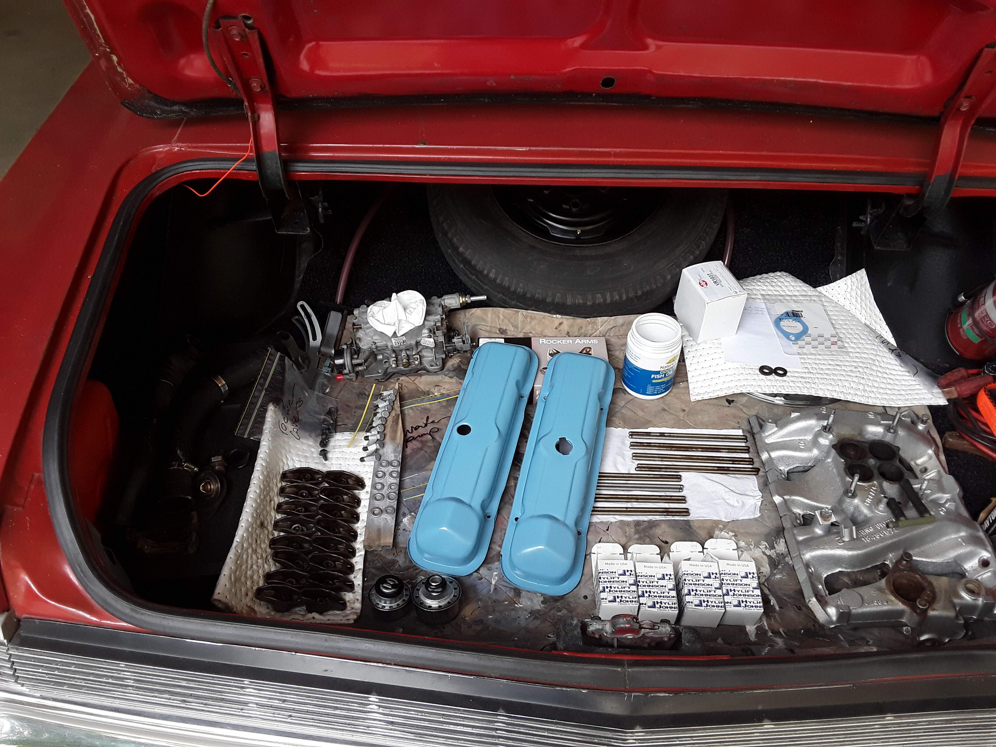

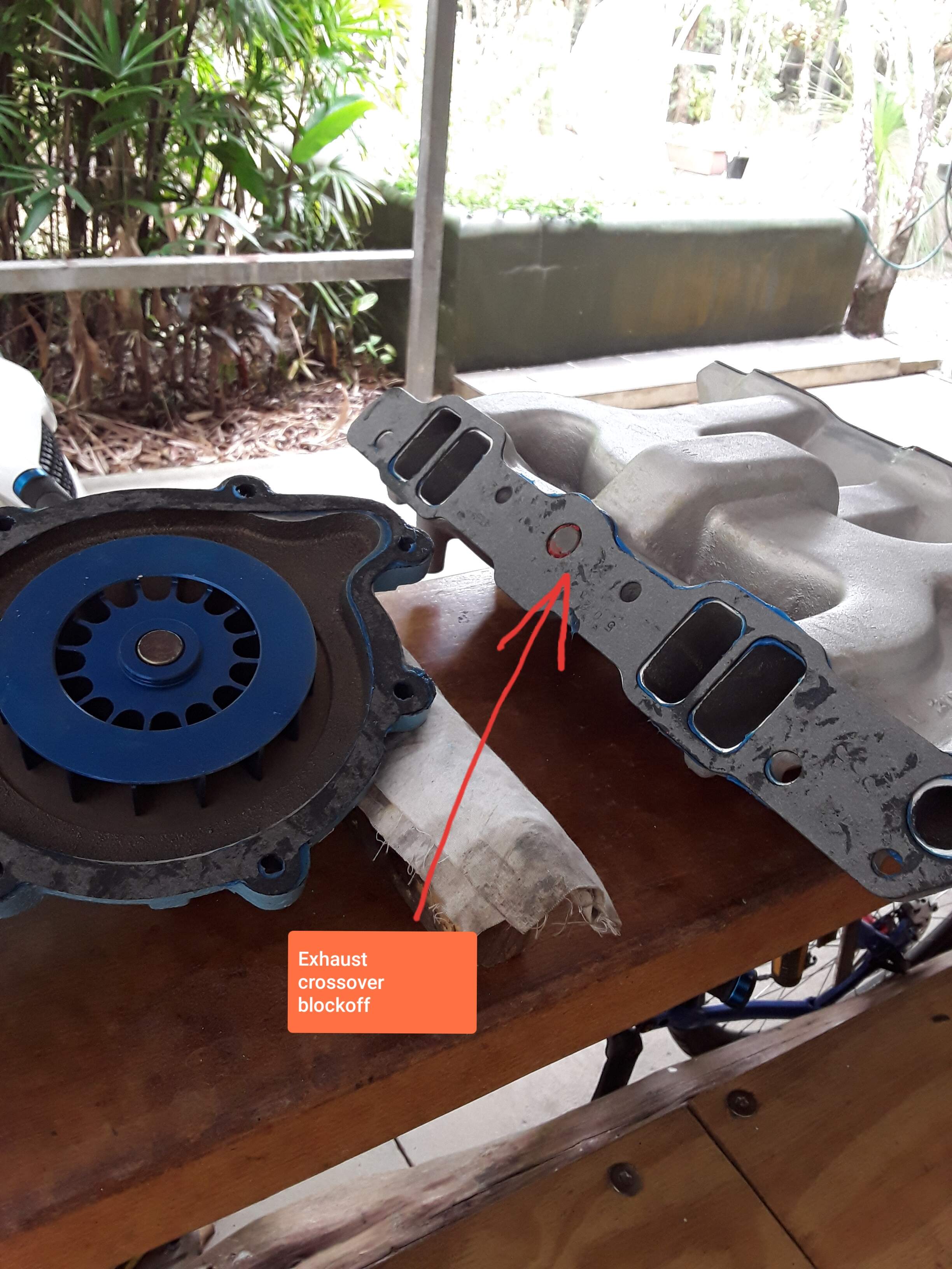

Another day of fluffing about with car bits & pieces. I attached gaskets to intake (note special gaskets that incorporate exhaust crossover block), valley pan & water pump. Chucked a clear coat on the rocker covers, painted the intake & water pump nuts & bolts and soaked the lifters in a bath of oil. I tested them (pushed down with a pushrod) prior to their bath and they were all squishy. Let's see if they pump up overnight.

Oh, and can I add that if anyone reading this is going to rebuild their engine, go for the Flowkooler water pump - a more efficient design, especially at idle when your big 'ol V8 is likely to get hot.

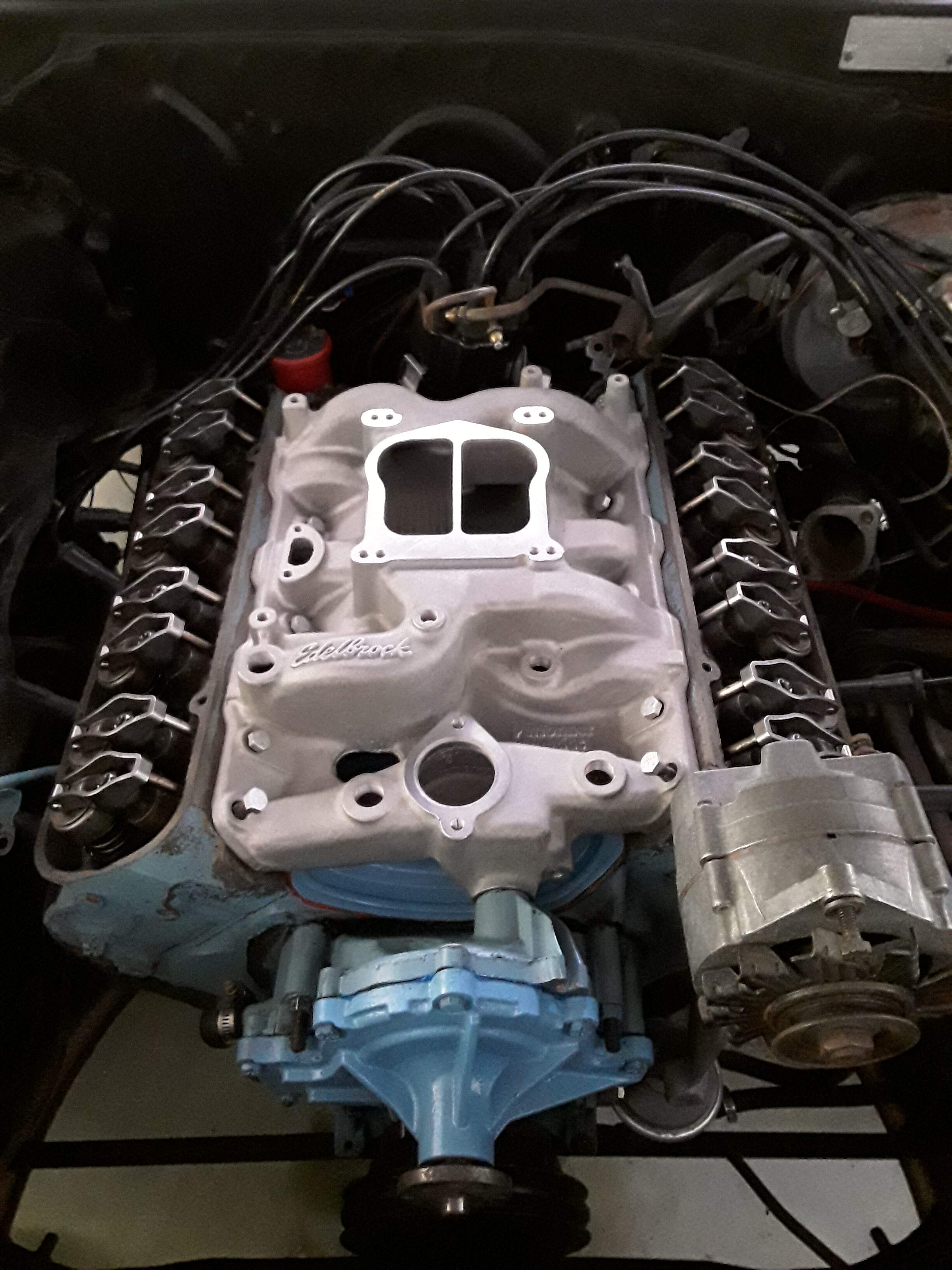

Latest instalment re the car: I was going great guns, new lifters, pushrods & roller rockers installed & adjusted, fitted the water pump & valley pan and was ready to fit the intake. I thought before I commit to applying sealant to everything, I'll just make extra sure that all the bolts line up. When I saw that it was NEVER going to fit, I remembered that the machinist had decked the block & heads by the tiniest amount just to true the surfaces. I looked at the old intake and after removing the old gaskets from it, could clearly see where it had been flycut to fit the newly machined heads. Bloody hell - scrape off my new gaskets (which promptly tore) and readied it to take to a machinist tomorrow to skim the sides. Then I sat down, cracked a beer and ordered yet again another set of intake gaskets. Weirdly, I test fitted the intake a while ago and it looked to be right. It was only after attempting to thread some bolts in that the error had become apparent.

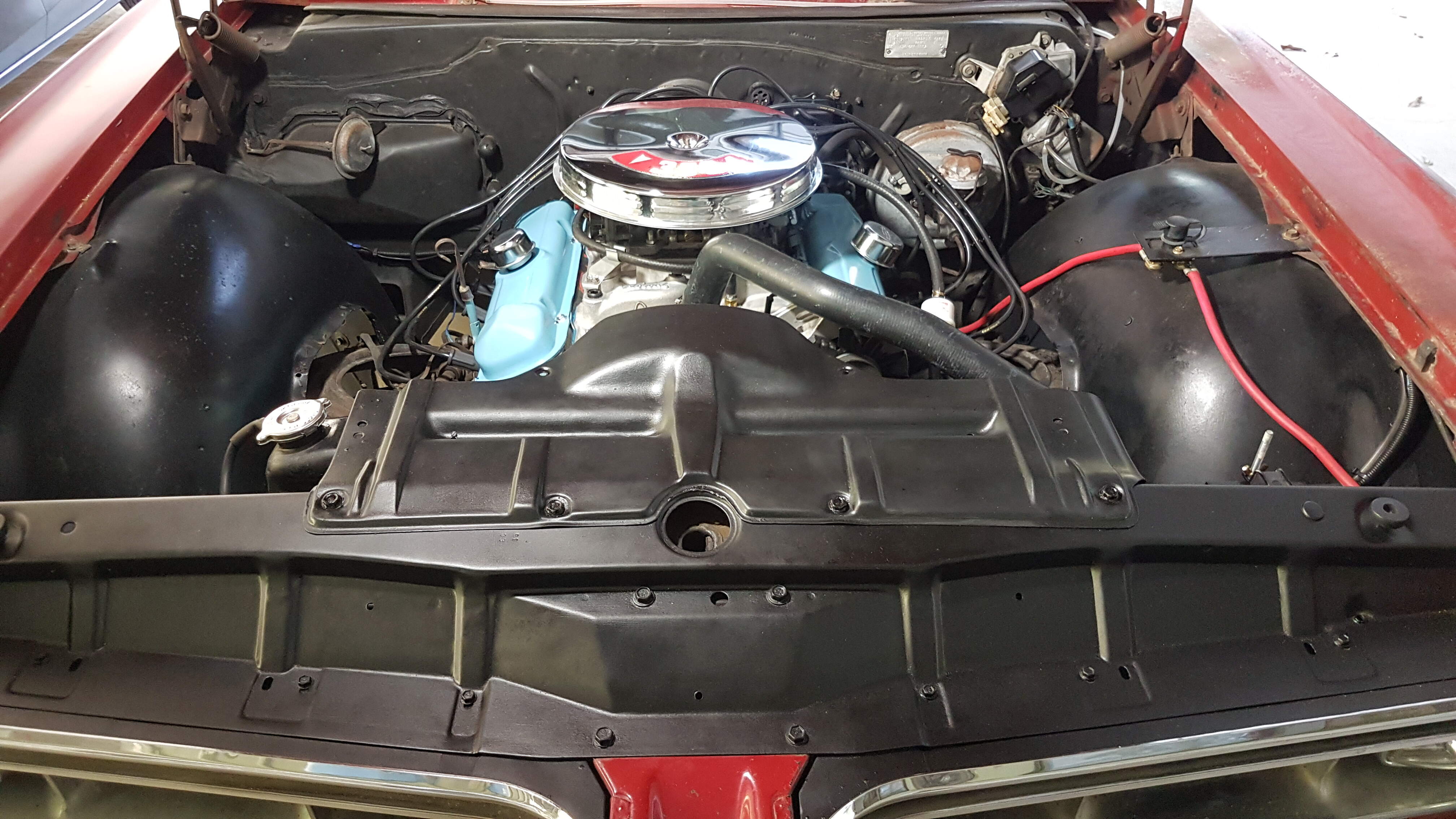

Installed new valvetrian components yesterday. Easy to adjust rockers with valley pan removed as you can see where each cam lobe is. Checked geometry, but lift is so minimal (stock half inch) that roller contacts valve stem perfectly through it's very short arc.
Couldn't resist taking some pics for you - engine is looking really nice.

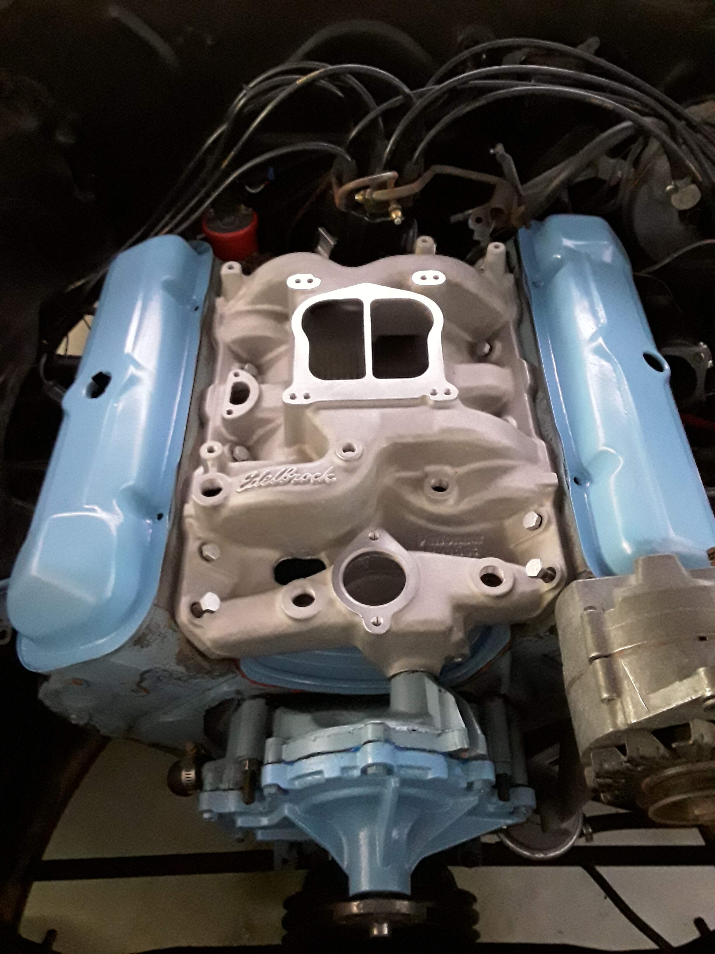

Are you blocking off the preheat ports?
I had to get thicker valve cover gaskets so the rockers wouldn't hit, keep an eye out for that.
I assume you have to make new bracket for throttle cable? No wait you don't have a cable?
Hi Andy. Yep - preheat ports are definitely being blocked off. They were when I did the original rebuild. I shall keep an eye on possible contact between rockers & covers but I think it's safe, and no throttle cable for me, just a rod. The manifold came with all sorts of bibs & bobs including an alternate throttle mounting bracket. I only need one bolt to secure the rod system so that should be easy..remember those words. What I DO have to consider is where I'm going to get vacuum from for the distributor. There are plenty of threaded holes for that purpose so that too shouldn't be too much of a drama.

So you are running manifold vacuum to the distributor instead of ported?
Well, here's a topic that may cause some discussion. As I understand it, manifold vacuum is constant - from idle through to whatever revs you run and ported comes in about 1500rpm. When you set the timing at idle you block the vacuum hose to the distributor. Once the timing is set, reconnect and note how there is now (at least some) vacuum advance, even at idle. Apparently, that's how it's supposed to work.
The original vacuum point is from the hollow carb stud, so that'd be manifold vacuum ie. constant but the Edelbrock has blind threads for the carb. I believe (correct me as you may) that ported vacuum is more of an emissions condition - something my car is too early to have. The only components I will have plumbed into the manifold are the PCV system and the distributor advance. The power brakes & auto plumb into the carb base plate.
Takes deep breath and waits for 10 different opinions.
Every thing between the inlet valves and the underside of the carb butterfly’s will be at the same level of vacuum .
Yes, absolutely but I know that emission controlled cars used ported vacuum for all sorts of black magic. The US (CA first, I believe because of LA's incredible smog problem years ago) were well before us when they introduced emissions regs that strangled all their cars. In Australia, I think it was 1975 or 1976 that the infamous ADR27A (Australian Design Rule 27A) was introduced locally and all of a sudden, every engine bay was a spaghetti of hoses and weird black bolt on bits that choked the engine, reduced power, INCREASED fuel consumption but apparently made the exhaust a bit more friendly. Thank god for EFI.

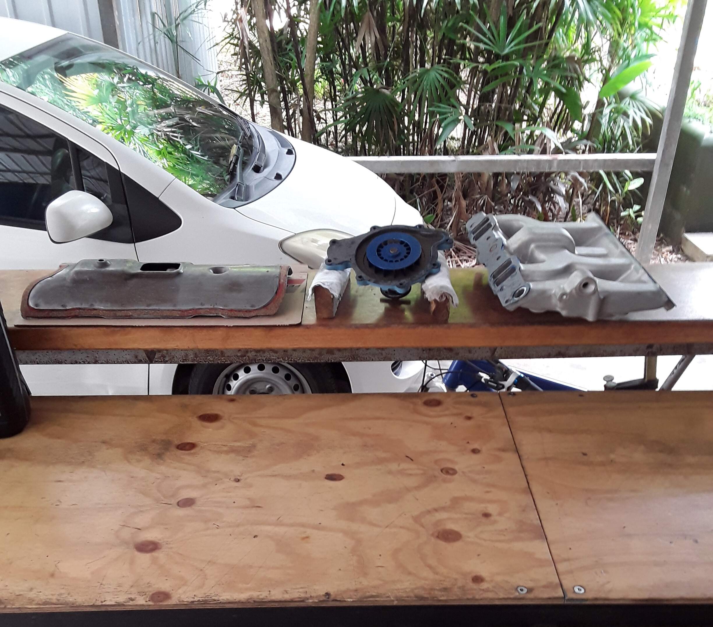

While I'm here, whilst waiting for the intake to be machined I enjoyed some therapeutic sanding & repainting all the little bits & pieces that are needed for engine to work again: nuts & bolts, brackets, etc. I also painted the sheetmetal that sits in front of the radiator. It's a bit like Christine - each day another bit gets exhumed and tarted up ready to eventually wreak havoc. Honestly, I'll be happy if it simply runs.

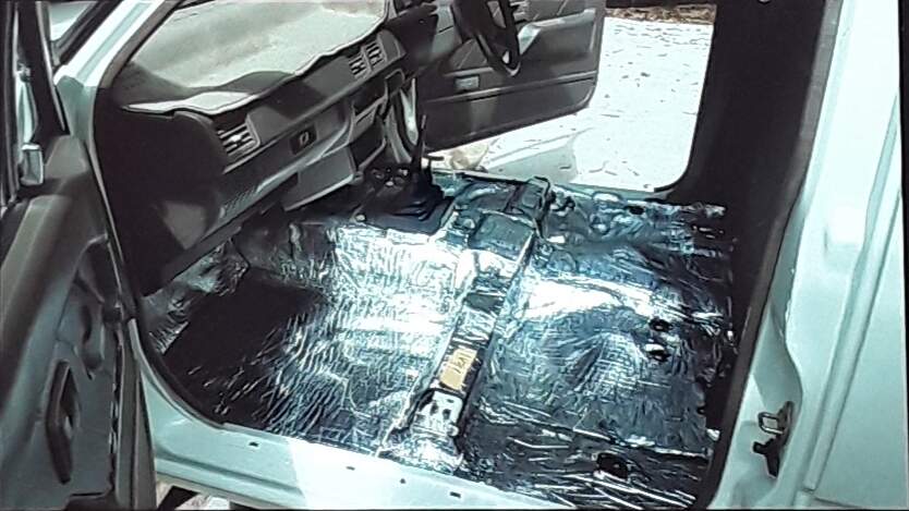

20231109_165009.jpg.ce696a14fc8efb797dc06d2f9f988614.jpgHad a rest from El Poncho today and instead decided to pull my finger out and install some sound deadening insulation onto the floor of my old ute - damn thing is HOT which you don't need in the tropics. I thought "this'll be easy - one bench seat, a coupla seat belts, pop out some plastic trims and there you are." That is essentially how easy it is. The ute is 33 years old and in prime condition. A coupla teeny weeny surface rust specks on the floor, so I cleaned those up and sealed them and then set about measuring, cutting and positioning the self adhesive fancy pants space age silver backed insulation. What I DID notice was that whoever had mucked about with it before neglected to reposition the big heavy duty rubber gearlever surround properly, which meant it had been just sitting atop the floor thereby allowing hot air, noise & fumes into the cabin. The gearlever aperture edge was a little beaten up so I straightened it out and that allowed the rubber cover to seal against the floor - I helped it along with some adhesive. I then replicated the torn up old upper seal out of modern thick high density foam and then put everything back together. I also insulated the entire floor and firewall - something the factory didn't do in 1990. Am yet to test drive it, but I reckon it's going to be considerably quieter now.
Machinist called today and intake is ready for collection. Just need gaskets to arrive and I can then whack everything back on.

Picked up newly machined intake manifold yesterday - the machining cost almost as much as the damn manifold...this is going to end up a very expensive exercise. But that wasn't the end of it, no, no, no. After bringing it home and test fitting it (fits nicely) I thought I'd make sure all the necessary fittings were indeed going to fit. Welcome to the murky world of BSP adapters. We all know about different threads, right? How to measure BSP: you measure the distance between (or across) the threads and then minus 25%. Honestly, who thought this one up? The new intake comes with an assortment of plugs and fittings to cover MOST scenarios, but not all...even though it has 'Performer Pontiac' clearly embossed upon it. I won't go into too much detail but in order to fit my PCV fitting and temp gauge sender, I needed adapters. No point going into the shop with a piece of paper with measurements on it - you need to take the manifold in and make sure what they sell you is going to thread in. At the end of the day - everything is threaded in and sealed with a light coating of RTV on the threads. I recleaned the intake to get the machinist's grimy fingerprints off it and am now waiting for new gaskets to arrive - prolly Tuesday if I'm lucky.
Oh - I told machinist that I was cursed with a batch of faulty Mellings lifters. He said there are plenty of bad lifters out there. He said someone had recently fitted some Crow lifters and they failed and wrecked his engine - after the third day after installation. Tread carefully if you are shopping for lifters. I would have loved to have gone for solids, but that means new cam and apparently solids are hard on the valvetrain as there's no hydraulic cushioning. They mitigate this with a more gentle ramp on cam lobes. No wonder I don't sleep at night.

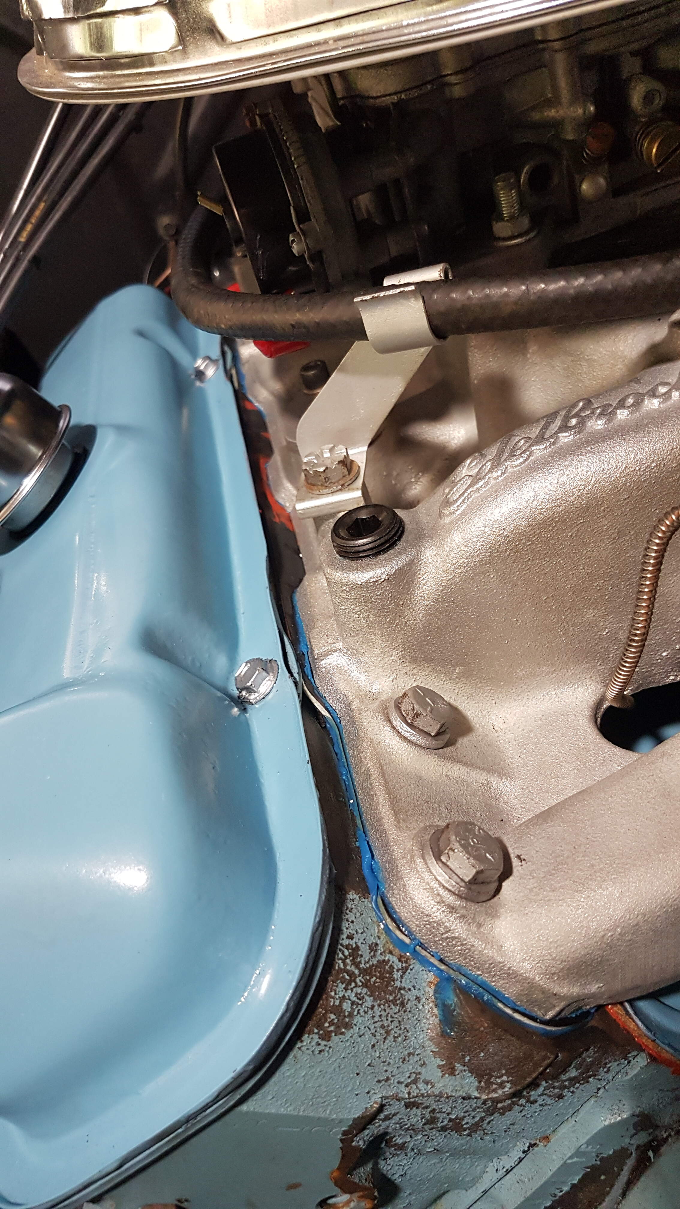

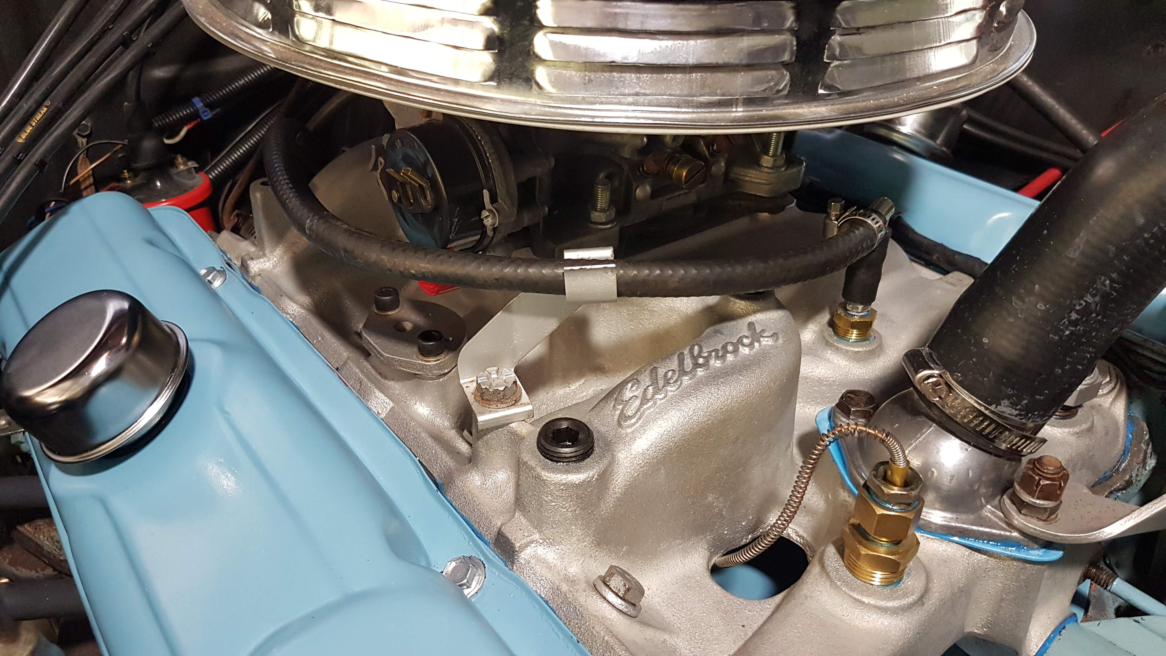

Right - Ames order turned up so straight into it. This time I ordered Edelbrock intake gaskets - apparently you need to use a softer gasket when bolting aluminium to cast iron. Get this: I had to trim (quite extensively) those gaskets just so they would fit. I had to trim the underside edge to clear the valley pan and had to lop off one end because it was too long and was going to foul the heater hose takeoff on one side and on the other it served no purpose at all. Heed my advice: if you are also going to fit an Edelbrock manifold, stick with Mr Gasket gaskets which have always been a perfect fit for me. Fortunately, the Edelbrock ones had an exhaust crossover plug in each gasket, but not as neat as the Mr Gasket ones, I thought. So, after fiddling about, I glued them onto the heads, test fitted the intake, smeared a litte RTV on it's faces and whacked her in. You'll see from the pics that I neatened my old aftermarket temp gauge sender unit arrangement and this time plumbed it directly into the manifold - something I couldn't do with the stock intake. I also modified the PCV intake and it's now snug & neat. I also ordered a remanufactured alternator and new regulator so bolted those in too. Everything looks nice - can probably try and start it tomorrow and see if it runs!

Nice and clean installation, like your routing of the temp gauge Sensor.
