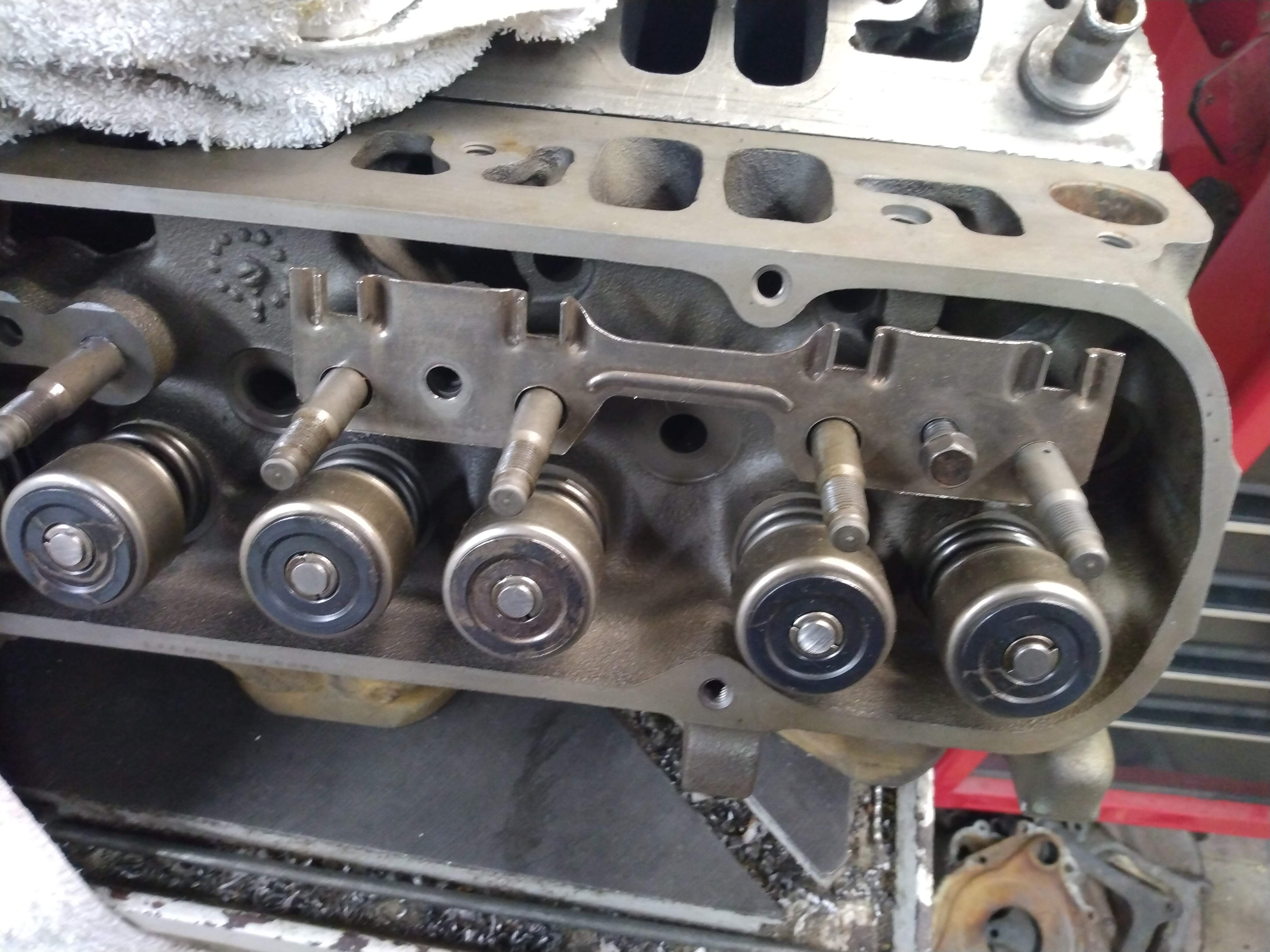

I see you have a one piece guide plate arrangement - how did you attach that? I think I see additional bolts to hold it in place.
So my engine is mix and match kind of deal.
The heads are stock 68 or 69 428 small valve heads so the guide plates are stock Pontiac and came with the heads and the studs are pressed in with a step for none adjustable valves but that's why I used polylocks to make it adjustable , think I'm running about half a turn preload.
I picked these heads for the size combustion chamber to get the compression where I wanted it.
What year are your heads? I thought all heads after 64 had guide plates?

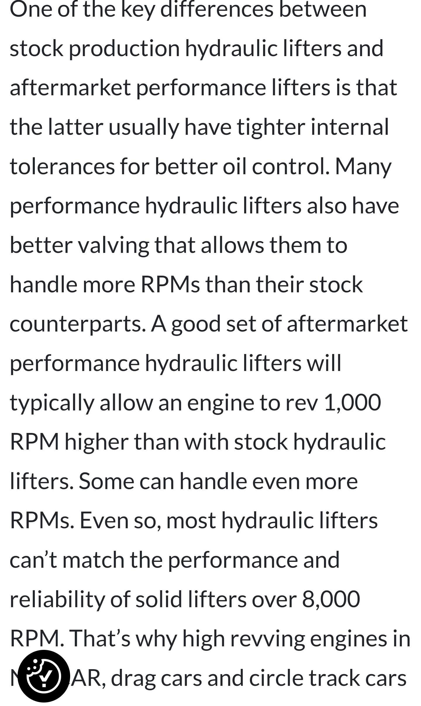

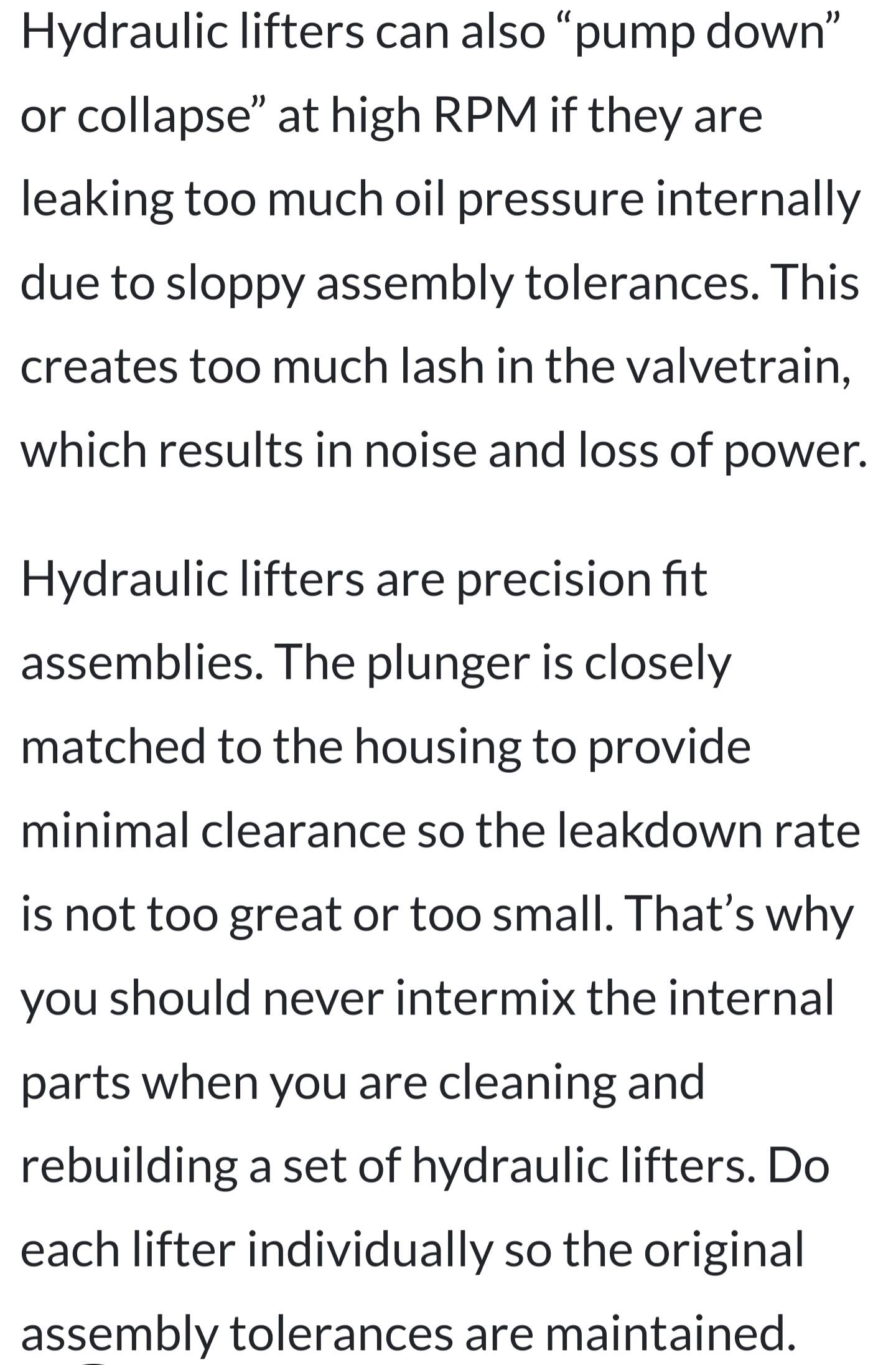

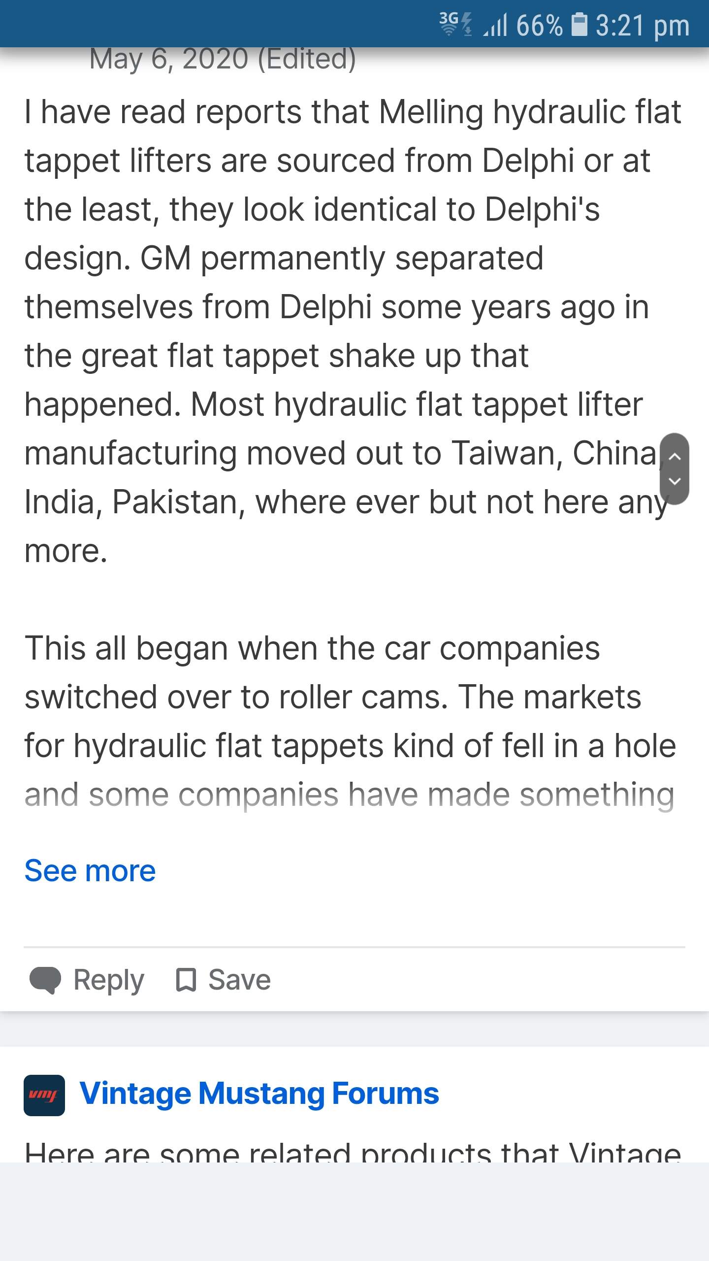

If anyone's interested, I found a snippet of info that might explain what's going on with lifters. Mine were Melling but I still don't know what can actually go wrong with one, except for oil hole blockage.

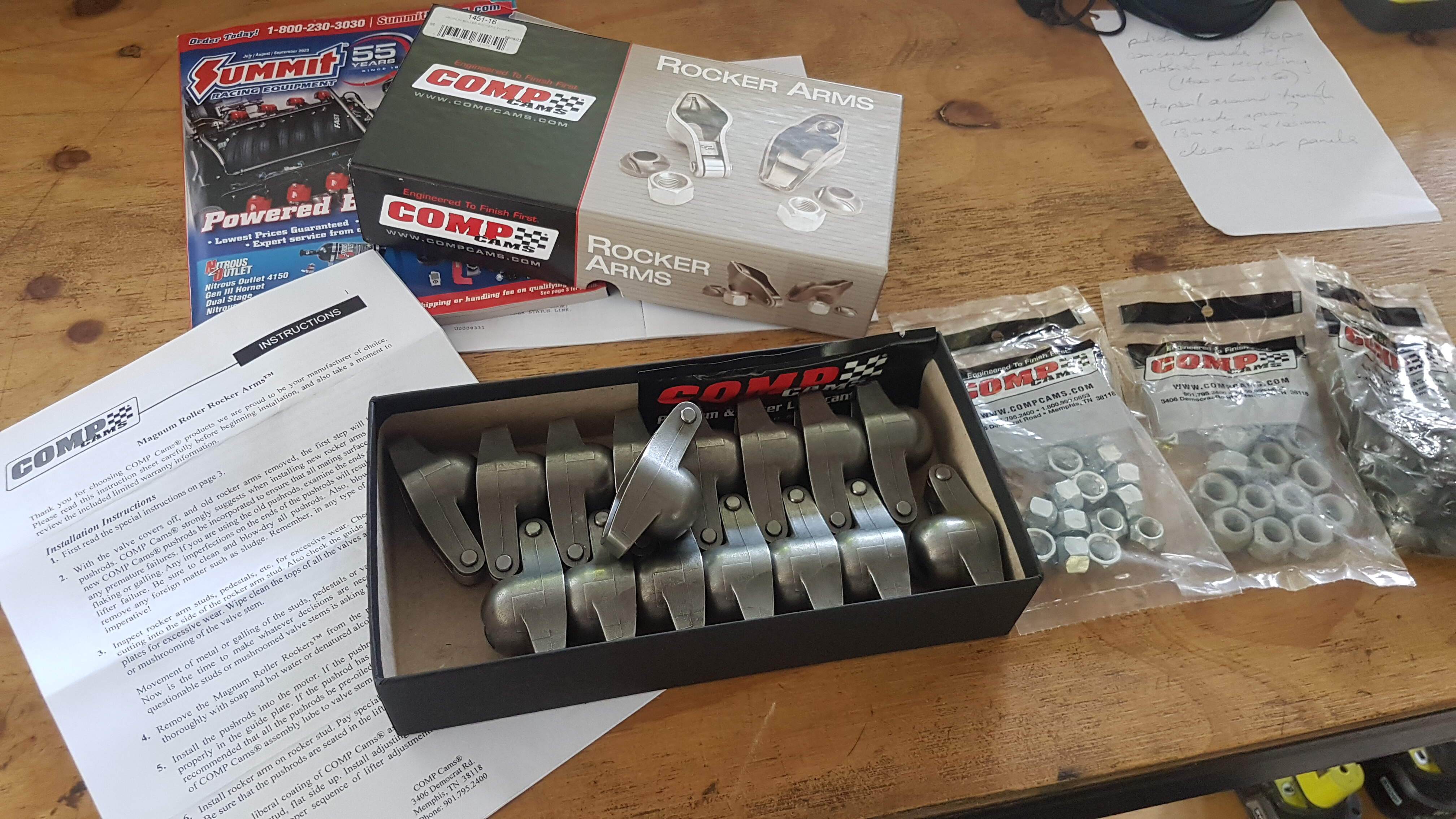

My beautiful looking Comp Cams roller tip rockers were here when I got home last night. I have been talking to Scott at Butler and he's recommended Johnson Hylift lifters AND potentially polylocks - I'll let you know what he says.
The scenario keeps going through my mind - I CANNOT work out how this happened. If it was due to faulty lifters, surely the engine would have been making a racket prior to dislodging a pushrod or two. Engine ran fine. I am yet to do the checks that TwoLane suggested...had to have a skin check today and I am getting sliced up next week, so I'm a little preoccupied with that hovering over my head.

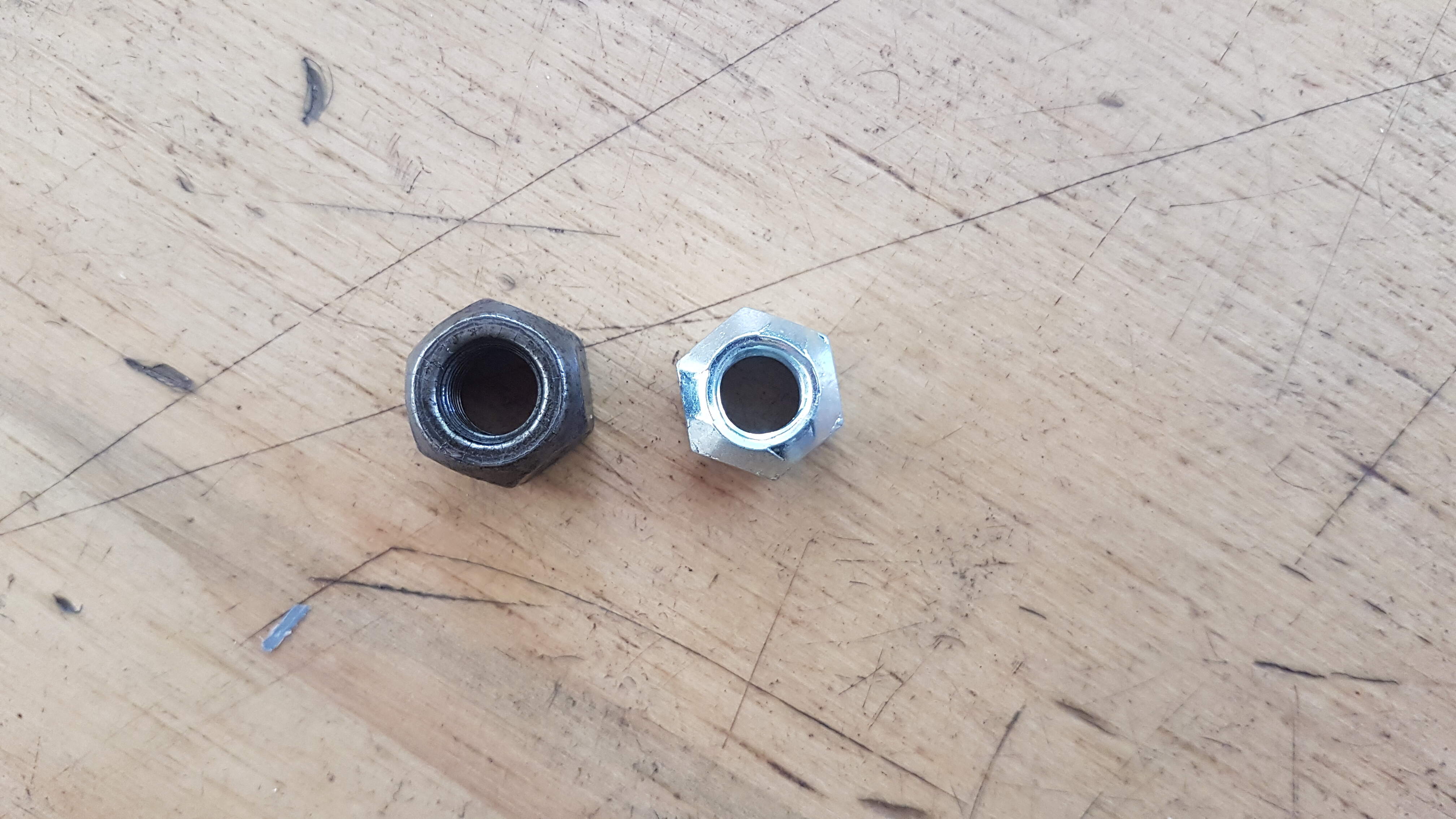

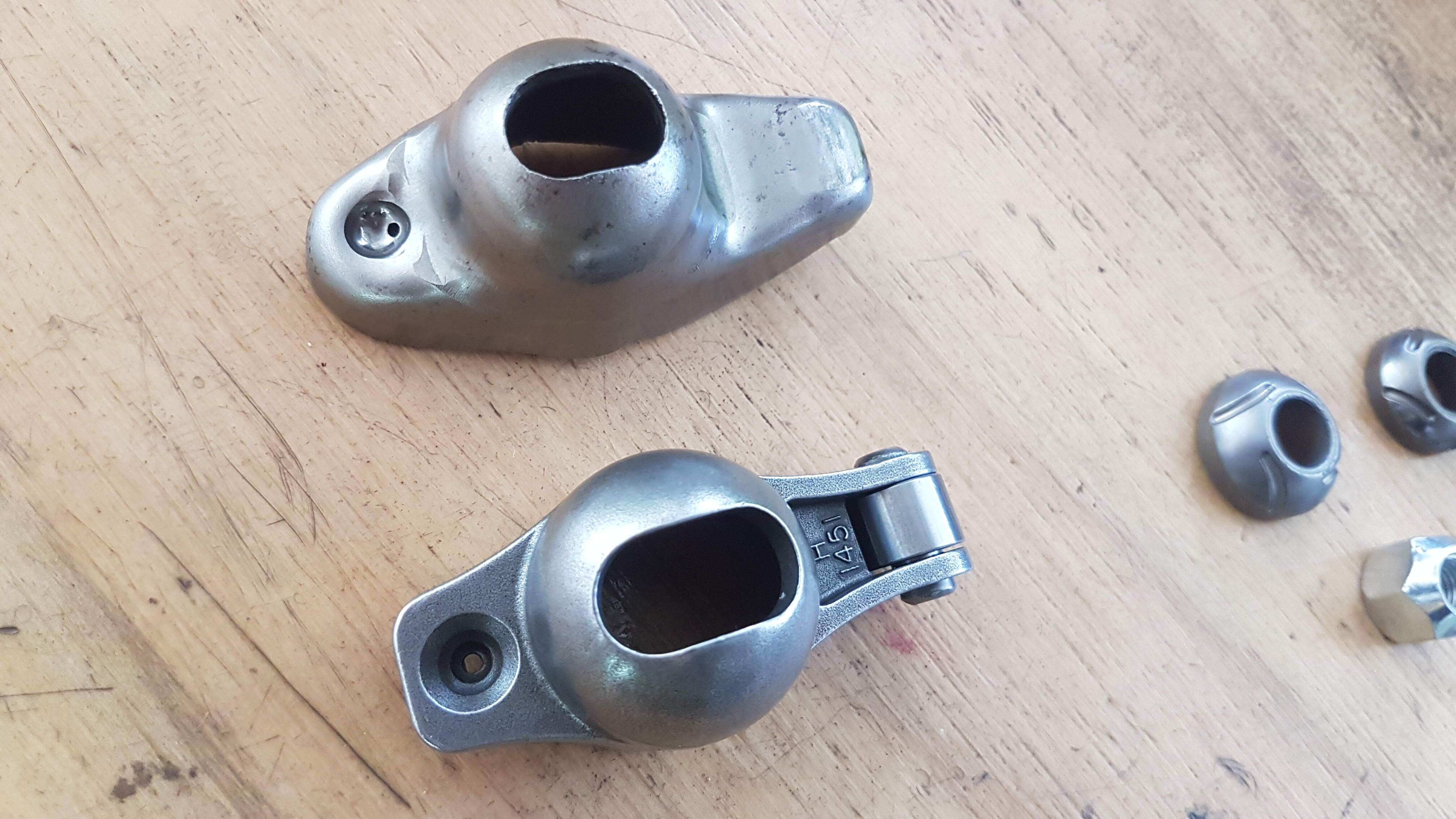

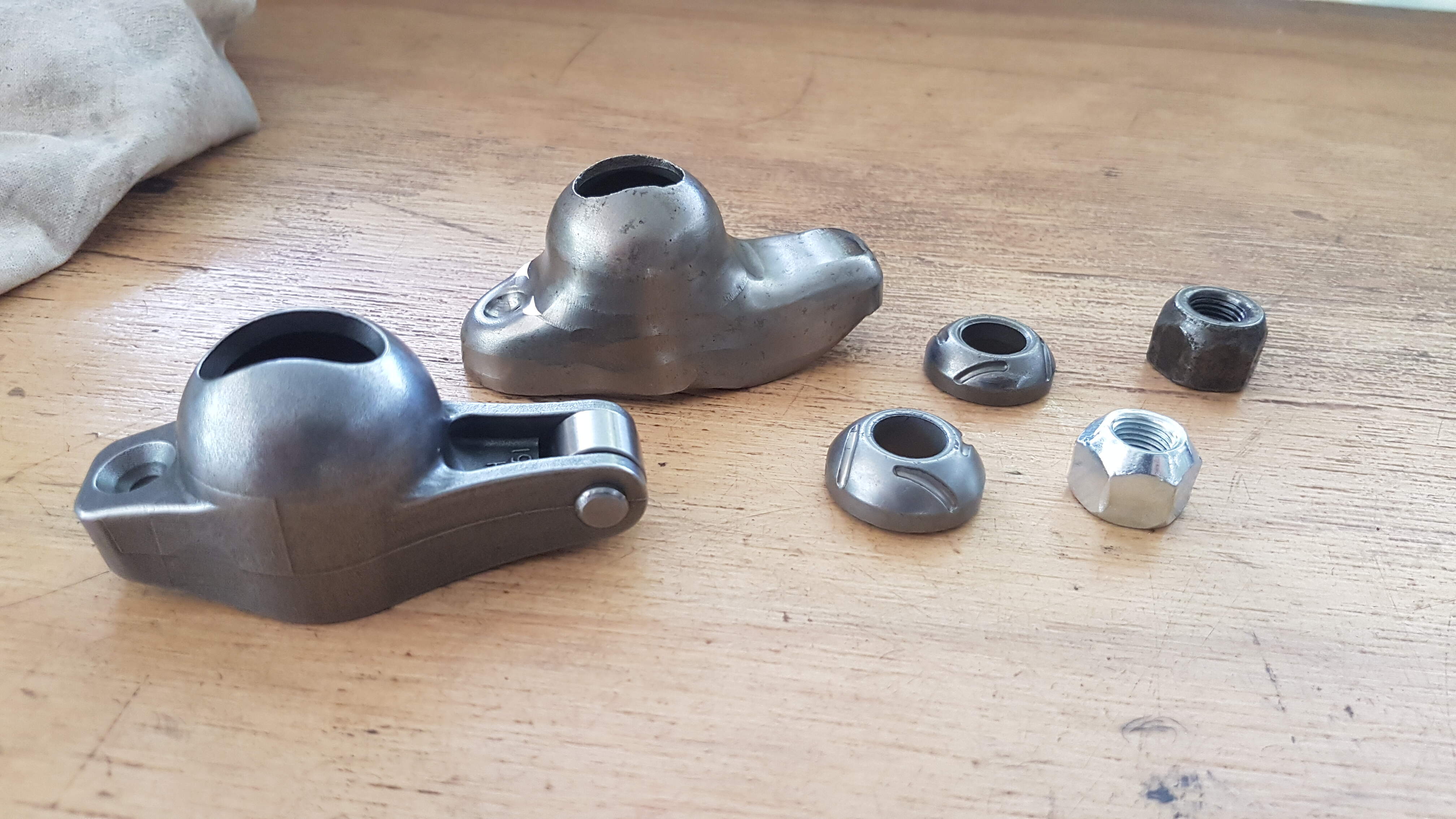

Another question for the FP Brains Trust: does anyone have experience with Comp Cams Magnum roller tip rockers? I test fitted one and the supplied locknut was reluctant to go over the stud. Upon inspection of the bottom of the nut, it doesn't appear to be a perfect circle - they're all like that. If I thread it on upside down, no problem. Is it perhaps a self locking design? The included info sheet said to NOT simply torque the nuts to 20 lbs. They must now be done using the pushrod drag method. This makes me assume that the nuts are designed to be snugged down to the correct spec and they will then hold that setting.20230927_123408.thumb.jpg.ec84384709c4534276742c4754f36306.jpg

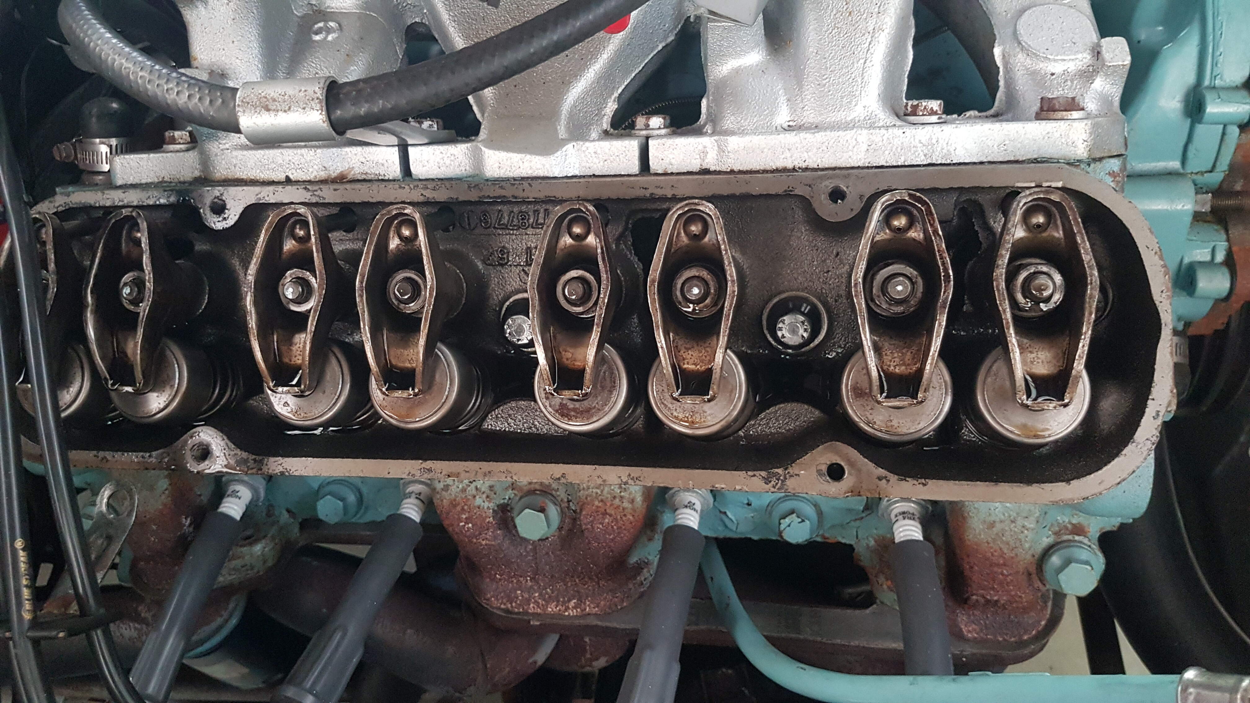

This is a view of the head that didn't fail.
Original vs Magnum
Note thickness of fulcrum spacers: new one in foreground.

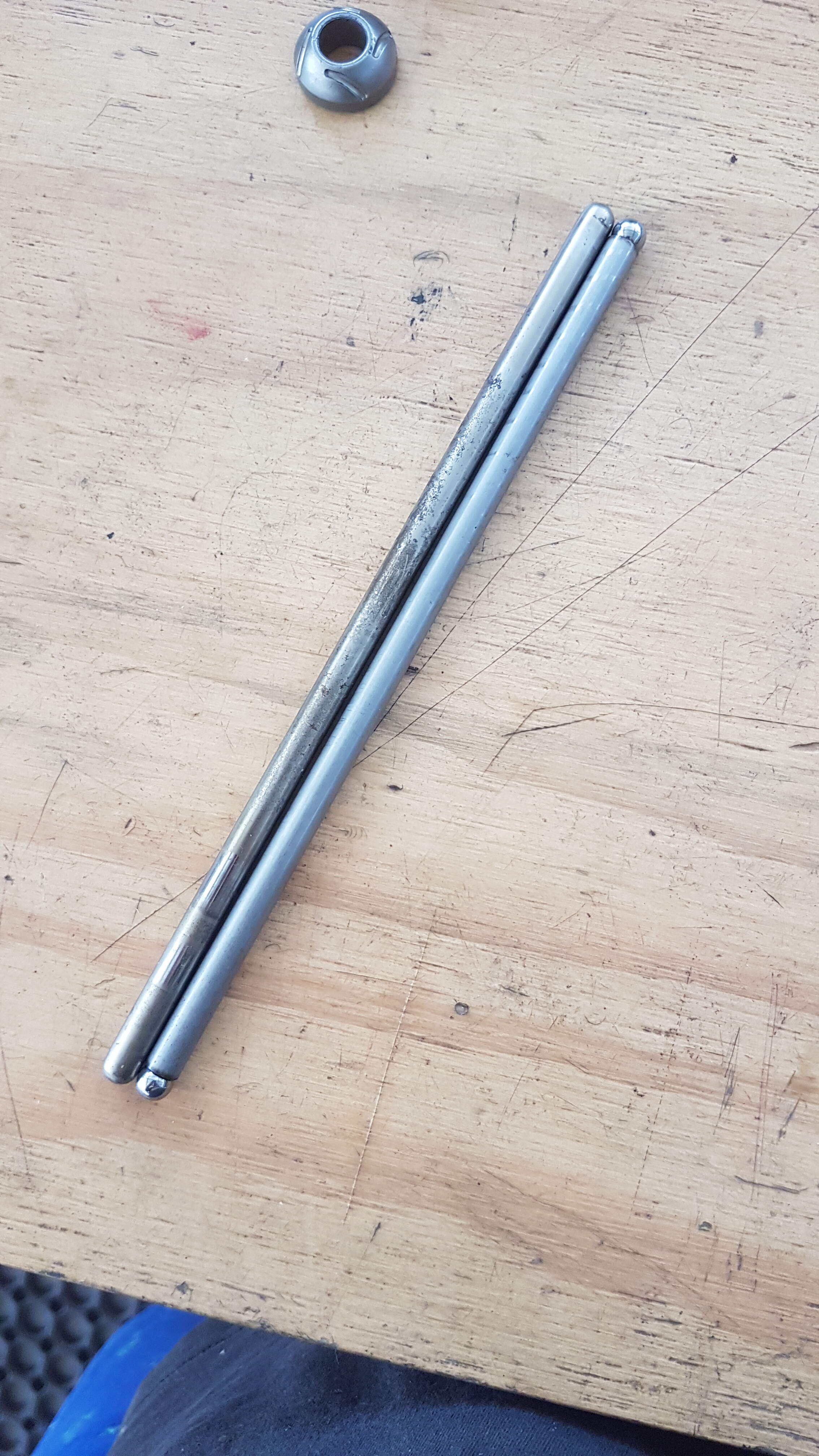

And beneath, old bent pushrod vs new replacement. Yes - both exactly the same length, although with a different design at the ends of the newbie.
This is a view of old & new rocker nuts. If you expand it, you'll see the weirdly out of shape design on the new one. It's this anomaly that is making the nut hard to thread on. I sure hope it's designed this way!

Nuts are correct, JUSTA make sure you start them by hand and they are going on straight before putting a wrench to em.

Are you going to use the Pontiac method and just torque down the nuts against the stop on the rocker stud? in that case i would suggest that you check that you don't get to much preload on the lifters before you bolt the intake back on.
 with the "crushed" nuts you could adjust the valves kind of like a sbc but in theory they could also bottom out before you get enough preload so i think again double checking would be a good idea
On Pontiac with adjustable valve train is this the type of nut that is being used?
I have used these rockers on a Ford 351C and a Chevy BB in the past but i used poly locks on both, they can be reused over and over vs the crushed nuts that looses its tension after so many times.
Good luck with your skin problem, its good to stay on top of these problems.
New rockers came with a nut I haven't seen before - it looks like I was test fitting it upside down. Anyway, I believe it to be a self locking feature. I asked Comp Cams to be sure. Cannot use the 20 lb factory method - gotta use the pushrod drag method.

I found a clue as to how lifters fail: apparently it's potentially sloppy internal tolerances.
