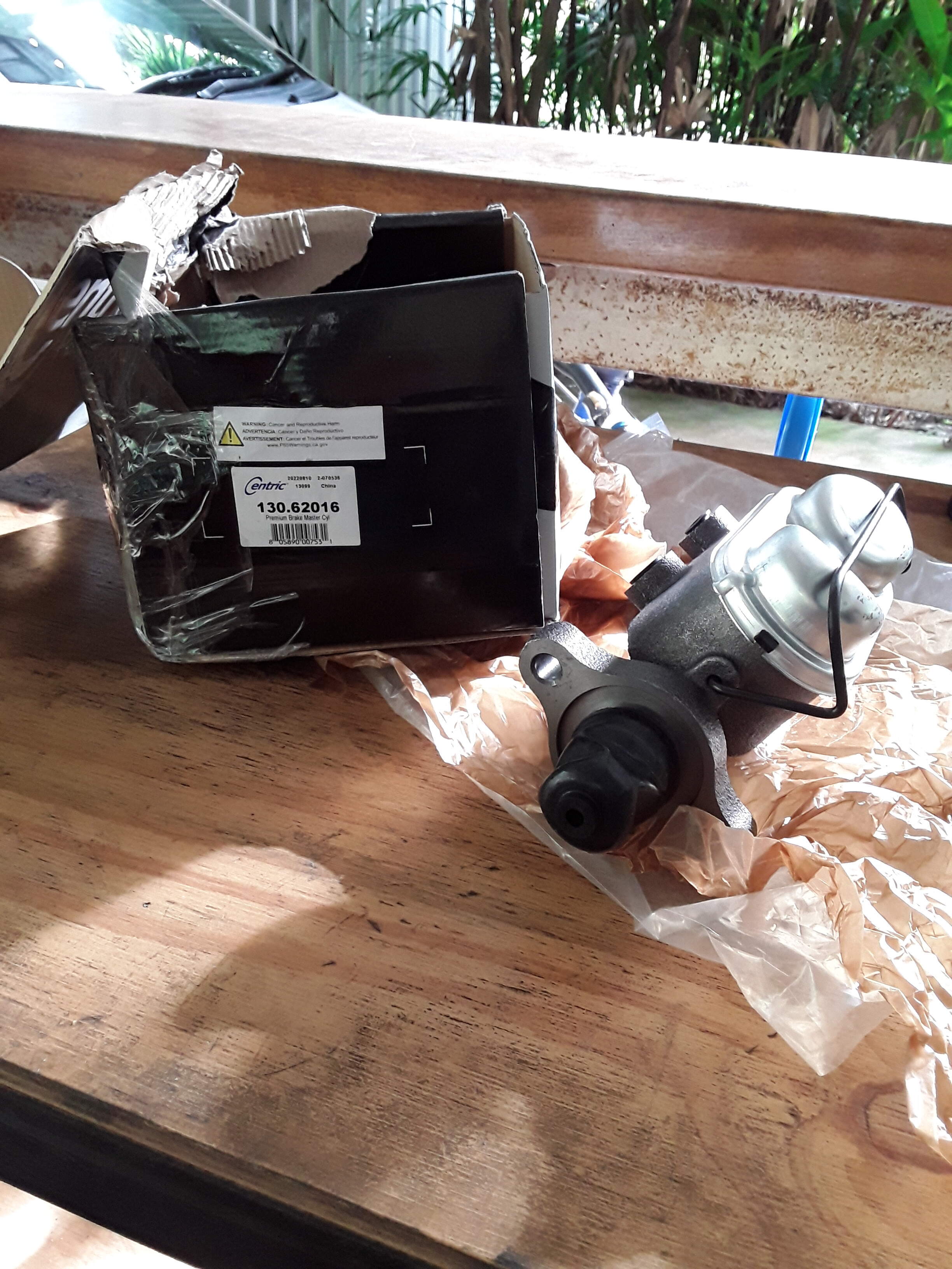

Good ol' Rockauto. It's like I put the credit card away and the parcel turns up almost immediately. One dual curcuit master cylinder. The brake specialist can't do the job 'til September, so I'll book it in this week. I'll get them to go over all the brakes just for absolute peace of mind.

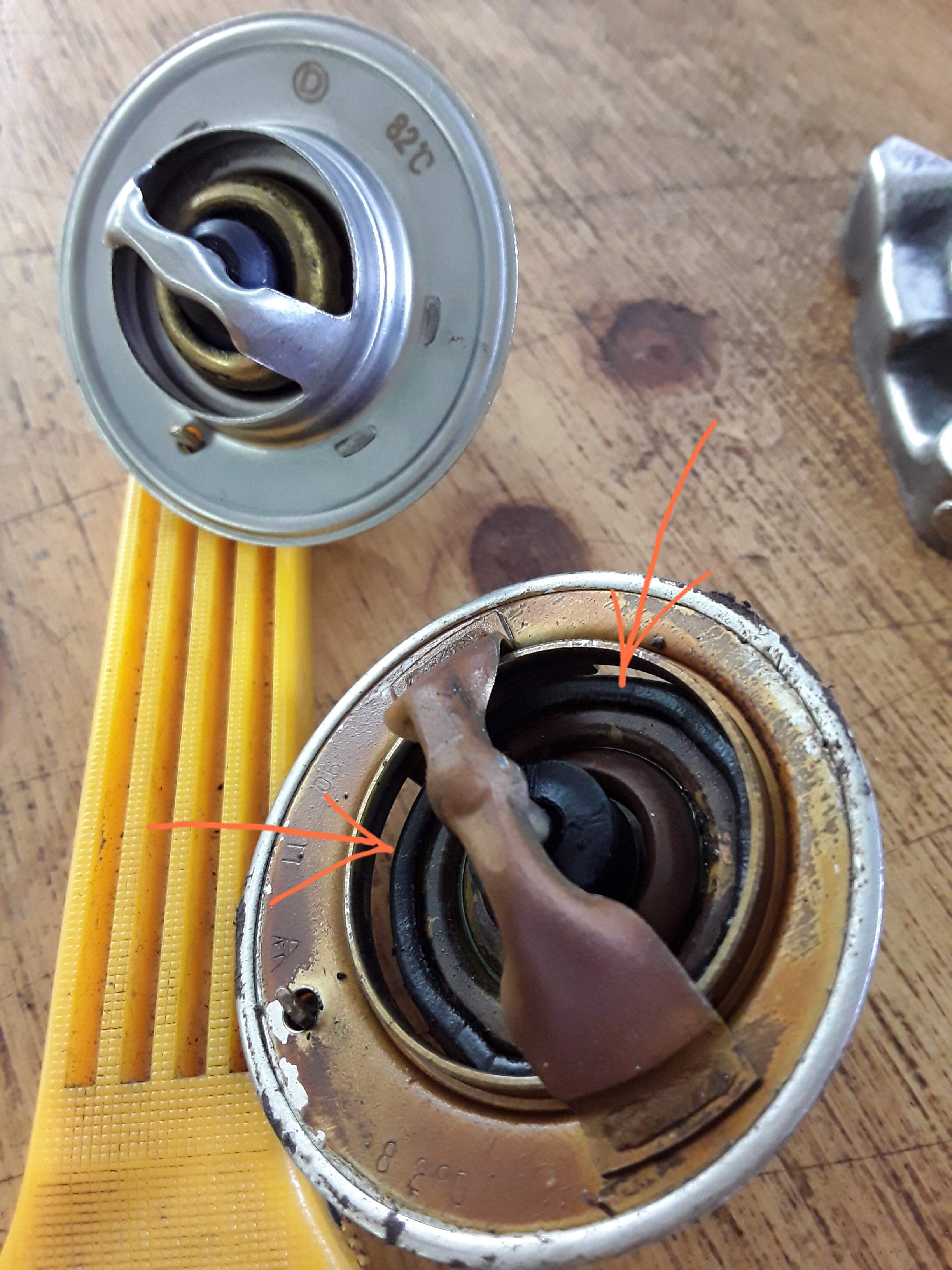

My Isuzu Rodeo pickup never seemed to get to proper operating temperature (according to the temp gauge.) I always suspected a dud thermostat but assumed that the gauge might be out - the vehicle is 32 years old after all. Curiosity got the better of me so I bought a new thermostat & gasket. Today I got around to actually doing the change out and when I withdrew the old thermostat I could see immediately that it looked 'wonky.' Upon closer inspection it is actually stuck open and is skewed in it's housing. Seems I was right after all. But of course, it's never plain sailing, is it? They sold me the wrong gasket. Fortunately I'm off to Cairns tomorrow to see my accountant so shall drop in and get the correct gasket whilst simultaneously shoving the incorrect parts up the salesperson's clacker. One job.
See the pic - the arrows point to my workbench surface which is clearly visible through the opening.
Now I wonder for how long has the car been running and never being at correct temp? Cold engines wear quickly. Fortunately, I've hardly driven it since purchase and the old owner died so I may have gotten away with it. I am looking forward to test driving it and seeing how she runs at proper temp. I guess the takeaway from this is if you suspect your car isn't getting warm enough, check the thermostat. They are a reliable little thing but nothing lasts forever. I have heard of people living in hot climates who simply remove the thermostat altogether - not a good idea. Not only does the thermostat allow your engine to warm up quickly, it also helps keep it cool by restricting the coolant flow allowing the coolant to pass through the radiator more slowly and thereby dissipating more heat.

 and once again your going to beat me too the basic brake upgrade... but paul is going to want all the details as he wants to do this too !:cheers:
i bet your going to find the brakes are wayyyyy better ! ppl bag drum brake front ends, but with a dual master, those front slave cylinders are getting pressure first and that makes for better controlled braking !
Hey Kiwi, when you plumb the dual master in, do they split the braking into 2 triangles like a factory system, so that in the event of failure, you'll always have 3 braked wheels, or do they split it fore & aft? Your comment makes me think that the fronts & rears become separate.
1 hour ago, Fitzy said:
Clearly the weather isn't the reliable phenomenon that we all once knew.  I remember breaking the ice on puddles as a kid growing up in Melbourne. Try that now and all you'll get is a wet, sore foot. Greece & Italy are in flames - they're not used to it but that's an annual occurrence here. The government's reaction will be to exclude certain areas where you can drive your ICE vehicle - there will be 'electric only' zones. I believe that in certain European cities, diesel vehicles are now excluded from inner urban centres. Interesting times ahead.
Yes mate . The master cylinder we have only have front and rear ports so if you lose one corner you will lose that other wheel too . But you will still have two wheels braking ! At the moment if we lose one we lose all !!!!!
But ! The cool part of the dual system is the front brakes will come in first !
provinding better and more efficient braking :cheers:

On my hq I have good old Ozy Pbr master cylinder and they have 3 ports 1 for each front wheel and 1 for rear !
I used those pbrs on all my tri fives … 7/8 and inch ones and they work bloody great !!
Pretty sure both ford and Holden used them right through the 80 90 and 00
Fun fact: PBR stands for Paton's Brake Replacements - we're talking Dark Ages here, prolly 60s & 70s. Good, solid dependable components.
The rain stopped today. I test drove the ute and what a difference. Temp gauge shows about 1/3 and doesn't waver - it's never gotten anywhere neaar that in the past. I will add some engine flush to the oil and give it a long high speed run to get it thoroughly loosened up and then will change the oil & filter. Cold engines produce sludge because they can't burn off combustion byproducts. There could be years worth of crap in there.
