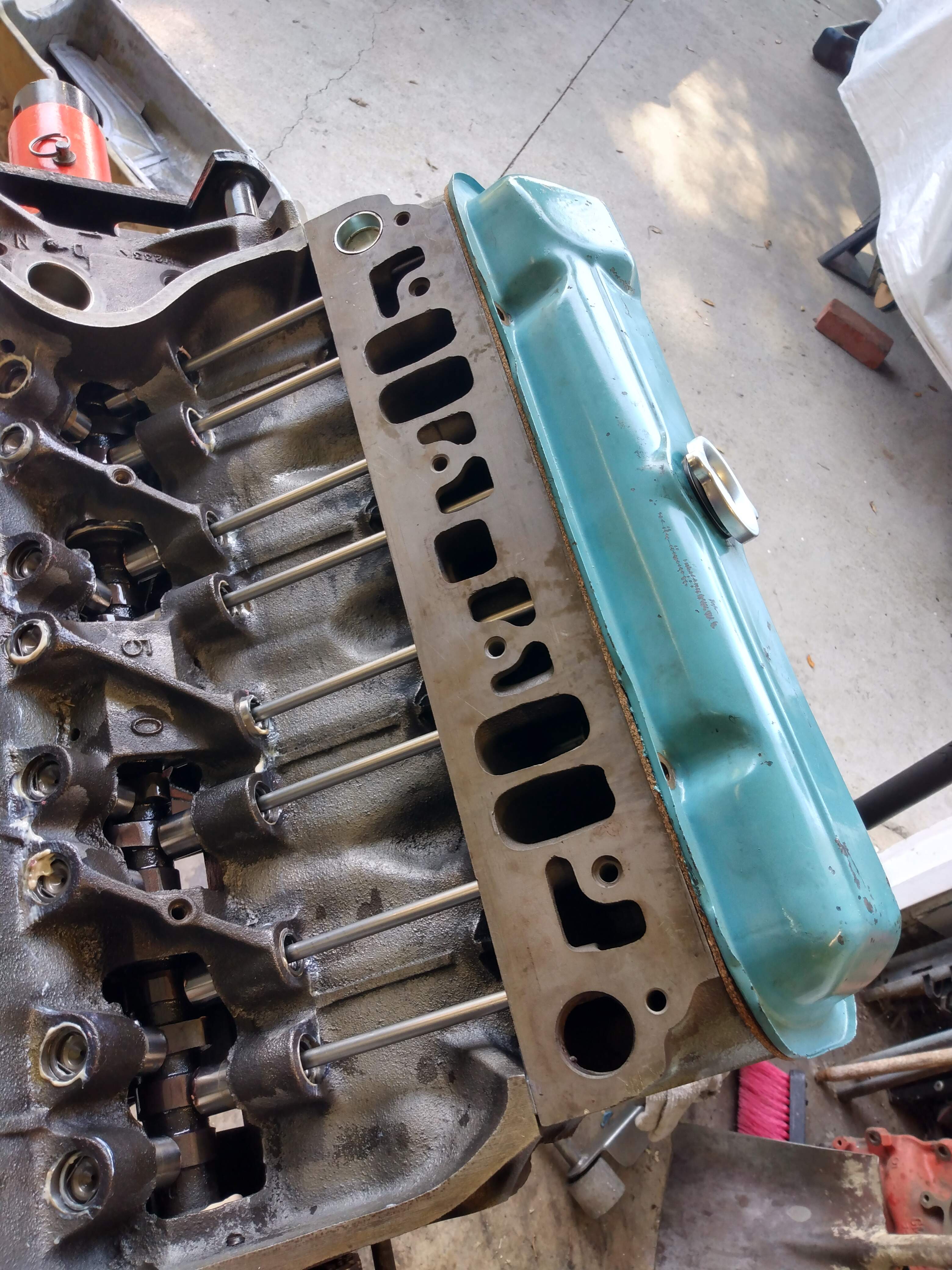

I decided to man up today and started prep for intake removal, albeit gingerly. I can't afford to tear my new wound (internal stitches - if they get infected it's gonna be dramatic.)

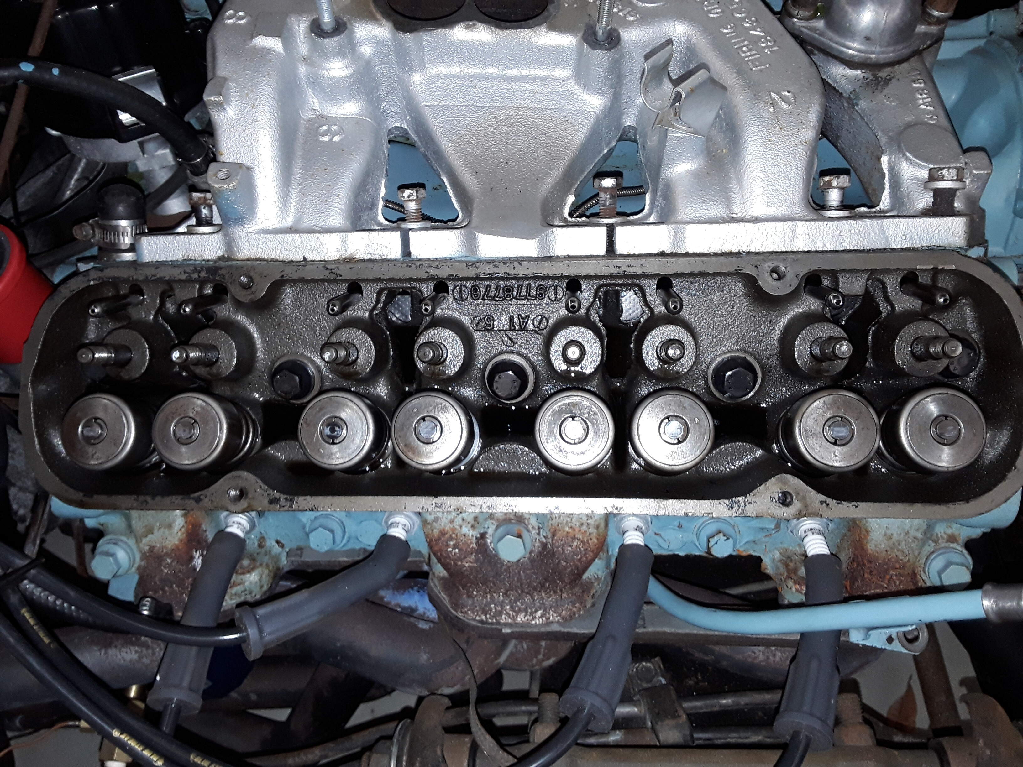

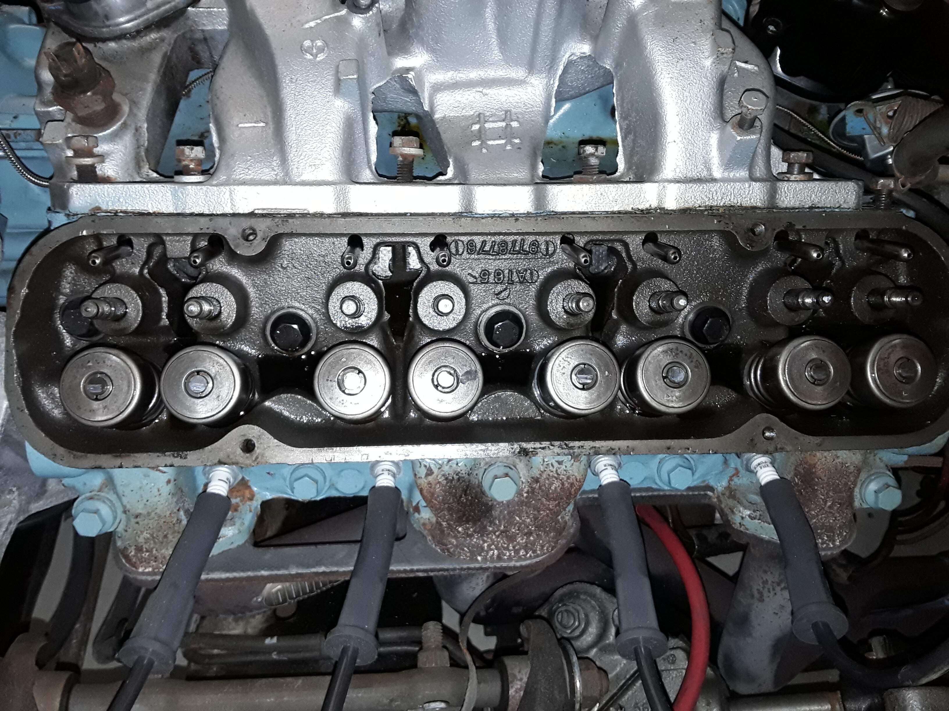

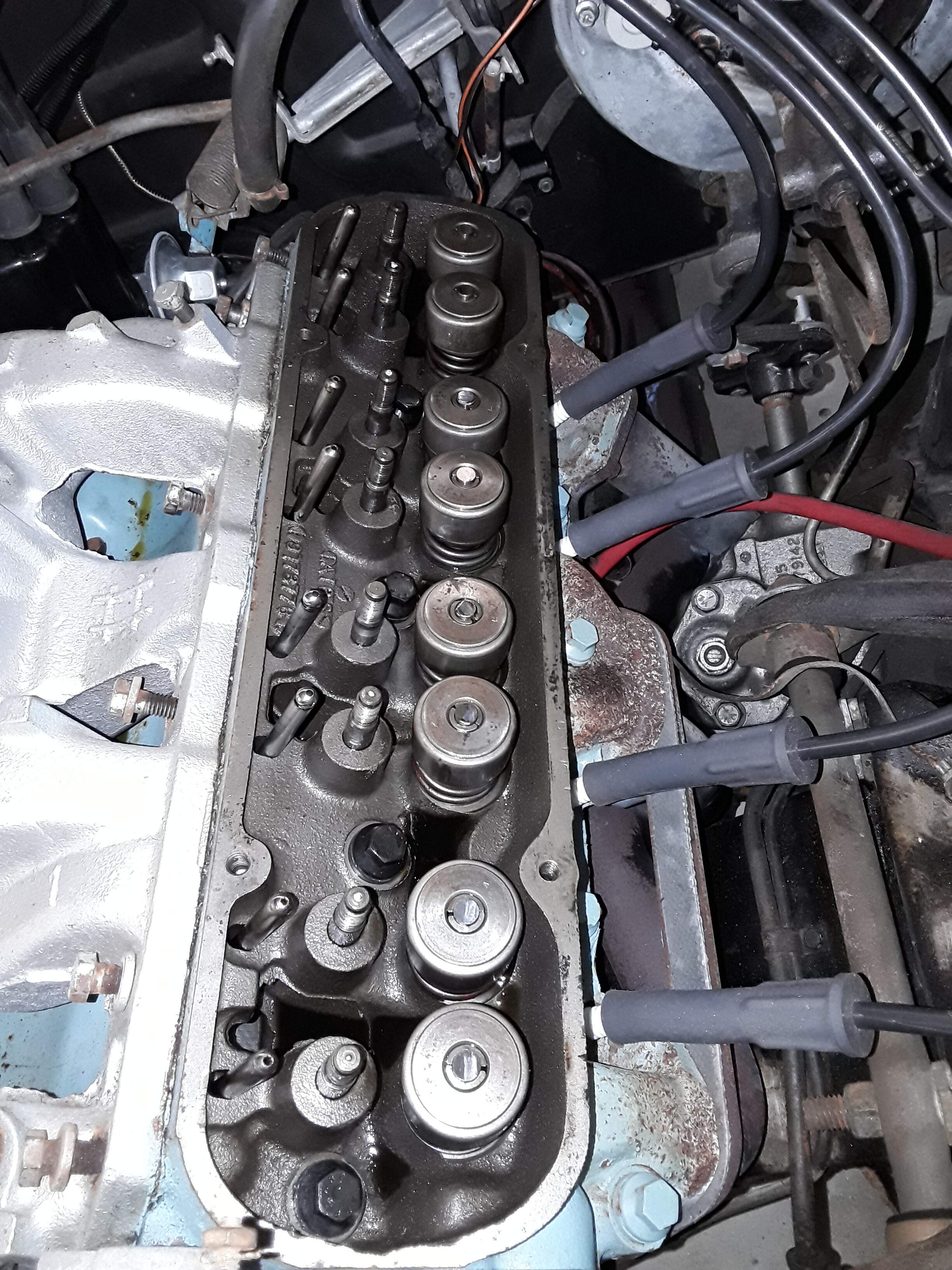

I took some pics. The good news is that all rocker studs look straight and are dead level. Tell me what you think: have a look at the valve stem tops. I don't know if those scratches & wear marks are normal. I would have thought that if rocker clearance was correct, zero lash means no tapping or hammering on the stem tops. The damaged spring retainer is from the rocker that was pushed sideways. Also, I have a lot of spongey lifters - although engine hasn't run for some time, I can push down on several pushrods and feel lots of movement. I inspected all rockers and they look pretty good if they're the original 60 year old ones. Doesn't matter because new ones are going in. Once lifters turn up I can do the install - 7 days at work first.
I need to remember to carefully check all pushrods too. The minimal outlay for new better quality ones might be the go, regardless. Any suggestions?

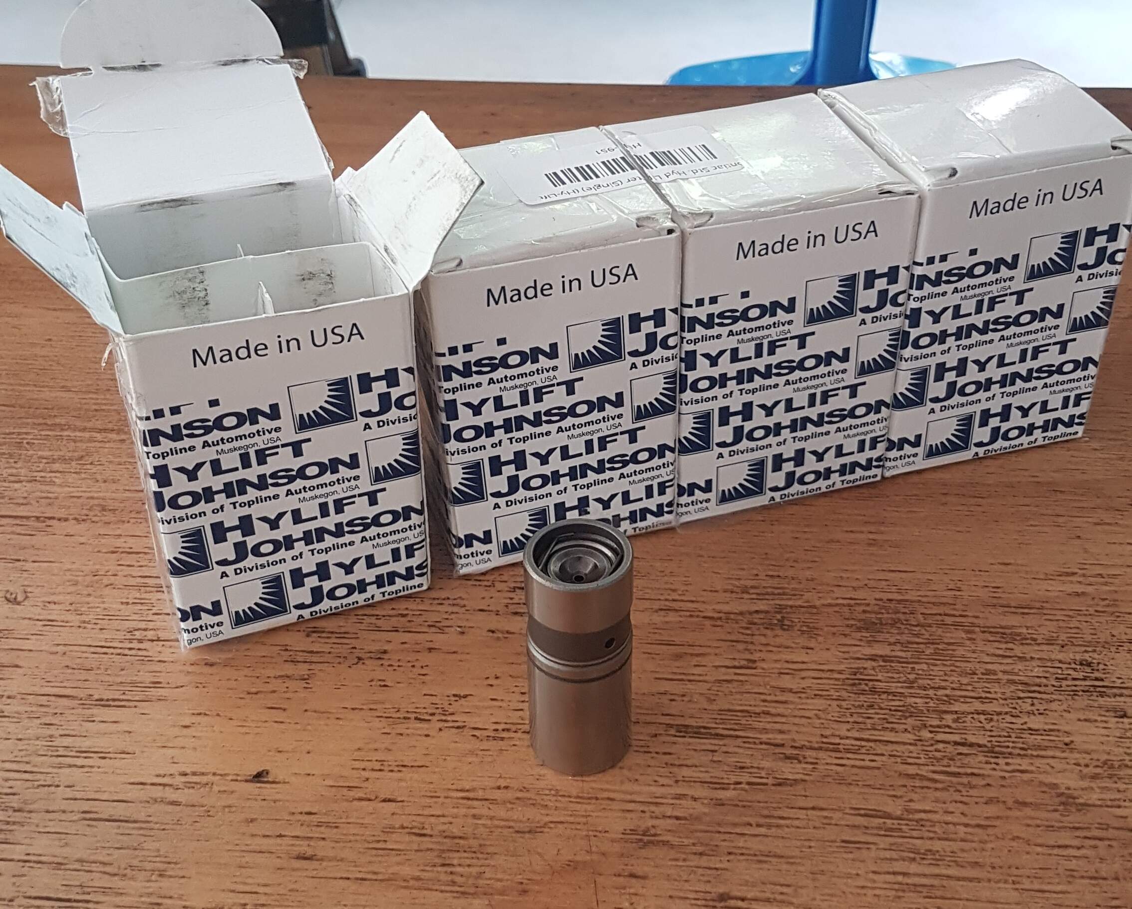

Nice new Johnson Hylift lifters were here when I got home AND I managed to score a secondhand unused Edelbrock Performer Pontiac intake manifold for less than half the price of a retail one, which is on it's way. Just need to remove everything, inspect the cam lobes & pushrods and then whack everything back in. Then it's off to get the dual master cylinder fitted.

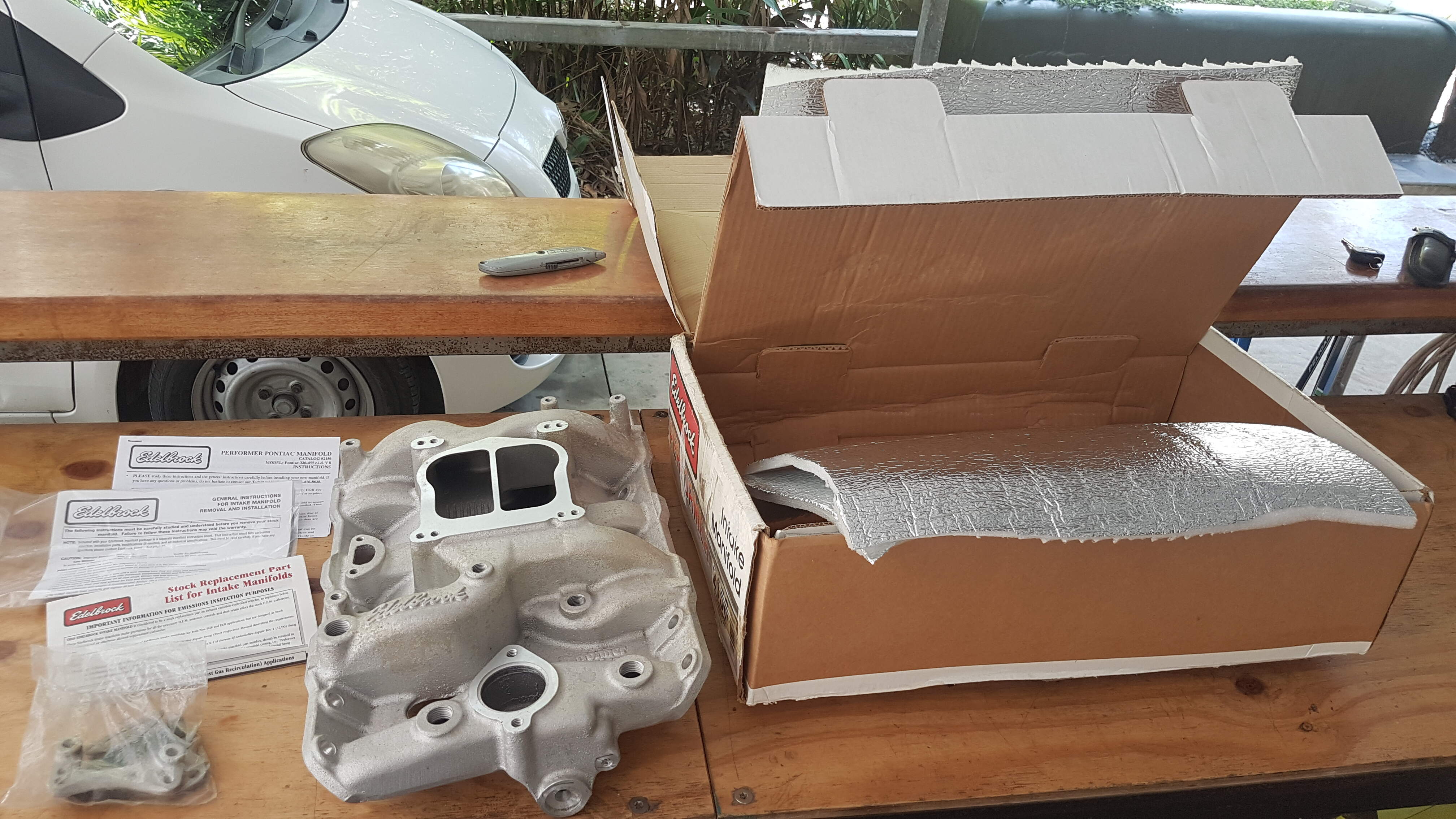

Brand new 19 year old Edelbrock inlet manifold (NOS)  was delivered whilst I was at work. Today I unpacked it - still in it's original box! I read through all the included literature from Edelbrock and it was a glimpse into the past - no website addresses in sight. They also included a leaflet spruiking their (then) new AVS carby. We all know the AVS2 superseded that one ages ago. So today I drained the coolant, removed the water pump and prised the ancient cast iron Pontiac manifold off the engine. The Edelbrock is aluminium and feels like it weighs half of the old monster. I have removed all the bits & pieces and will clean them up and repaint as necessary. I removed the valley pan and there were my lifters.

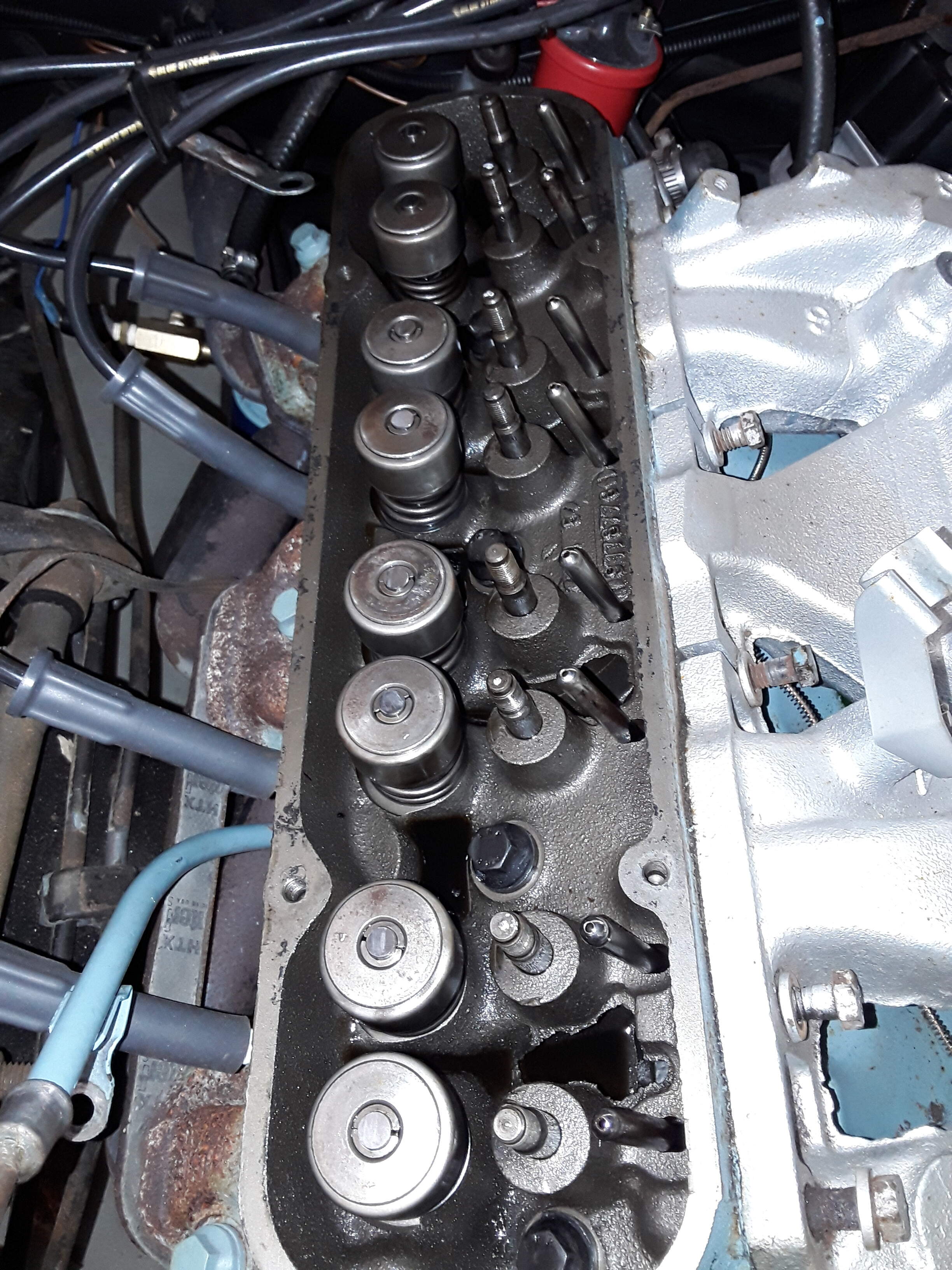

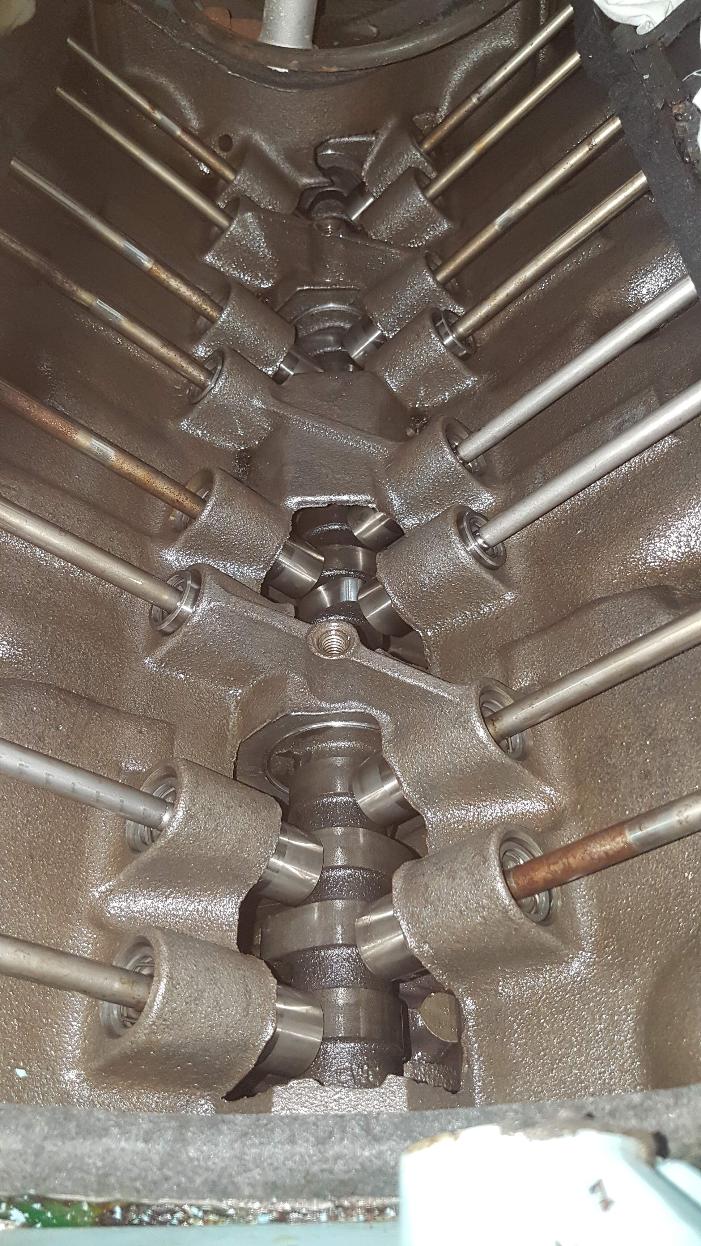

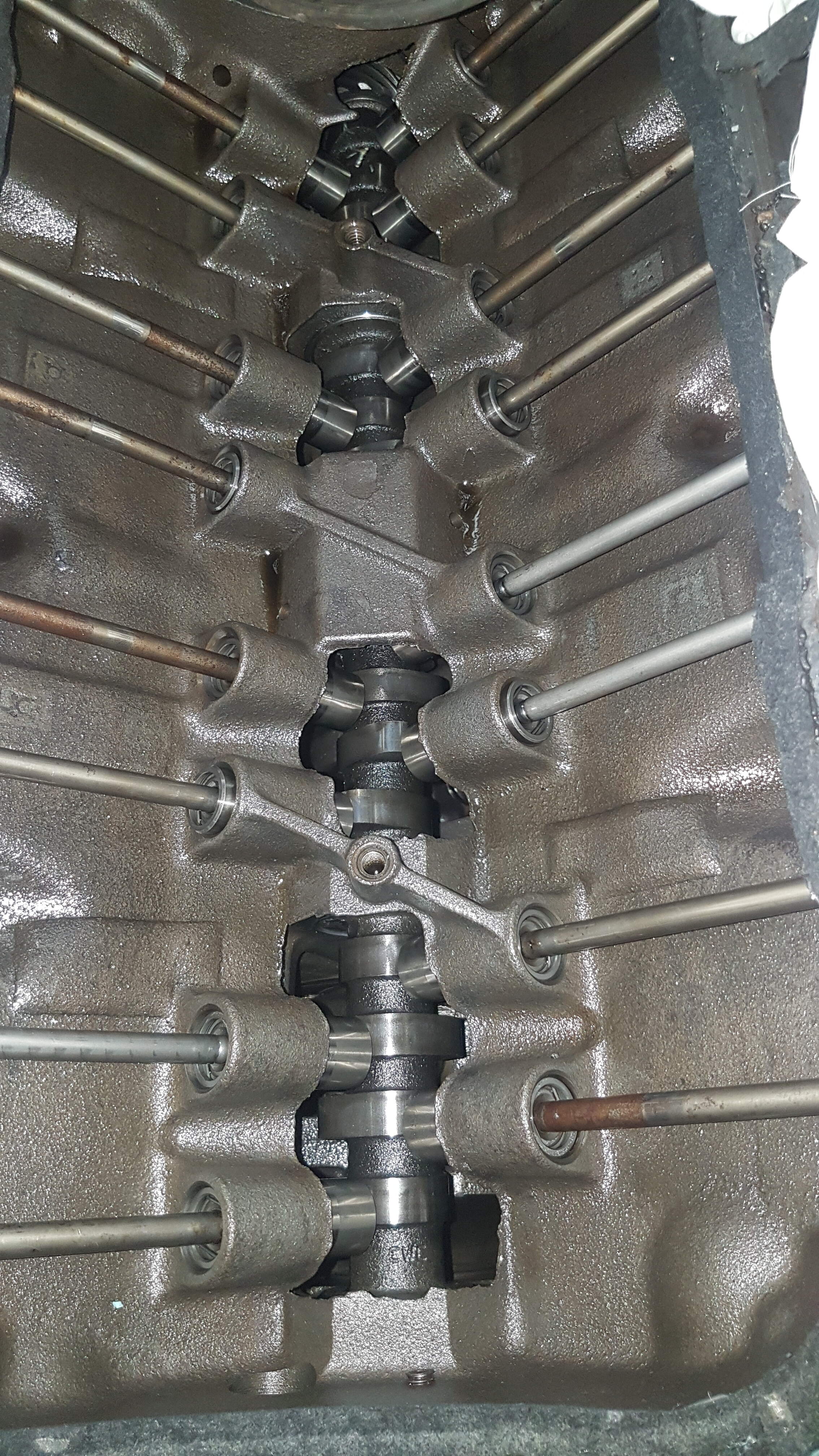

But...upon inspection I see the lifters are not aligned with the cam lobes. I had an inkling that they are supposed to be slightly offset to promote lifter turning, but mine look to be excessive. I got on the Net and looked around, and all of a sudden mine are typical of other posted pics. Have a look at mine and see what you think. I sort of recall buttoning up the camshaft and peering into the valley and noticing misalignment but I can't remember anything after that! Perhaps the old brain blocked it out and told me everything was Archie. I remember checking & double checking the thrust plate installation and I'm sure I got it right. I'll look again with fresh eyes tomorrow and will determine if I can live with it. If so, it SHOULD be a simple reinstallation of all the crap I just took apart. Can't wait to hear the exhaust rumble again - it really does sound the goods...when it runs.
One extra note - goddam lifters are all over the place. Some are firm but most are squishy.  I reckon I got a particularly bad batch from Melling.
it does look quiet a bit offset mate ! but the bearings look centered from what i can see :cheers:
WTF...??....What is the Brand/Part number and Grind of the camshaft...?? The numbers should be on the front cam bearing journal and visible with the cam (top) timing gear removed...
Edited by TWO LANE BLACK TOP

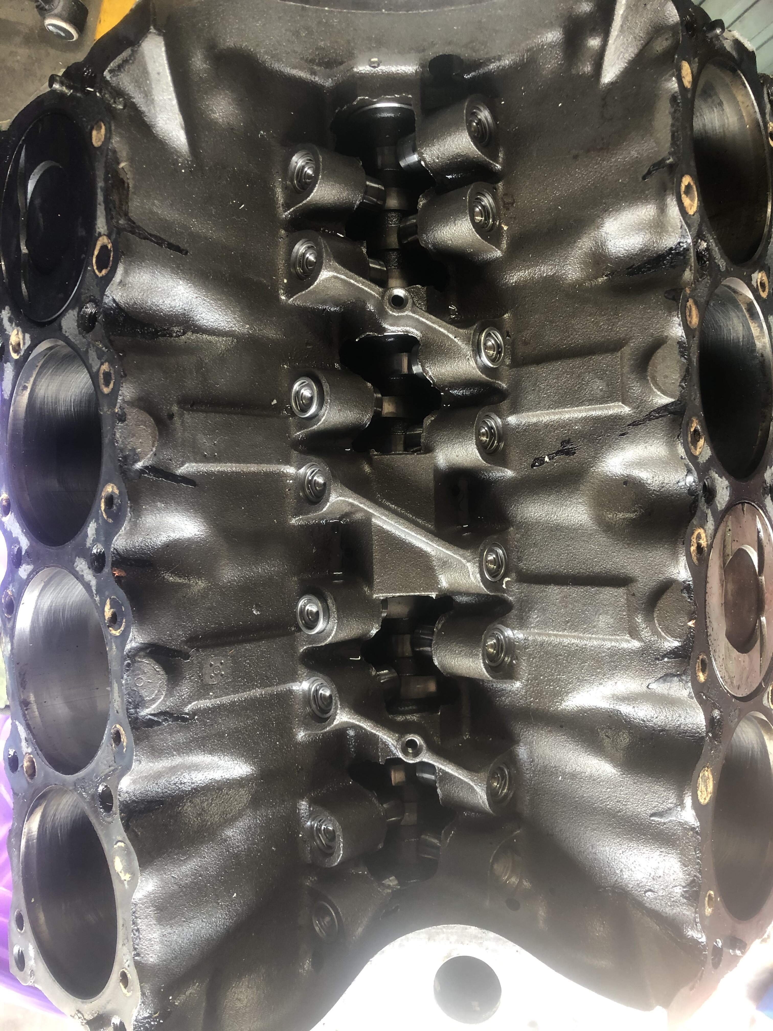

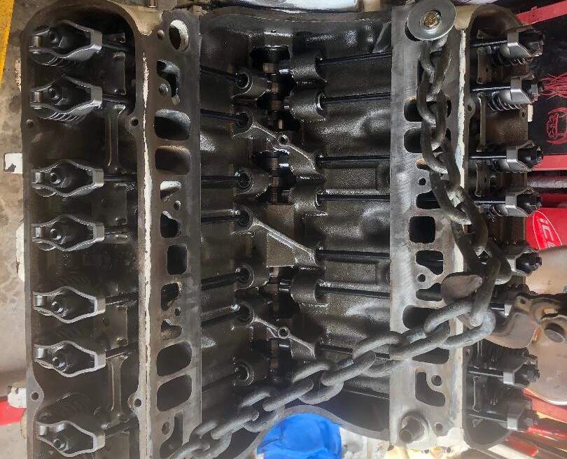

Found this picture from when I did mine, looks pretty close to your's IMG_20220320_162658570_HDR.thumb.jpg.047ac367d3670c1117a4f5e329700391.jpg
The cam is a Melling 068. Thankfully, Andy's & mine look to have similar variance. As I said, all the pics on the net were also similar. TwoLane sounds astonished! It just doesn't look right, but I recall fitting the cam and checking that the bearings were indeed aligned. With the cam bearings aligned and the required clearance at the rear block plug, there's no real adjustment. Once the thrust plate was in, the cam's endplay was just a few thou as it should be. I installed the timing chain and everything looked correct - including exact vertical alignment between the gears. That alone told me the cam was indeed installed correctly. You need to remember that the distributor gear has to mesh with the cam too, and it looks fine and works as it should.
I suppose when you think about it, if the lifters were centred on the lobes, no amount of convex surfacing is going to make the lifters rotate. You need to have them offset to ensure rotation. What do you think?
I also think that the second pic amplifies the offset. From that angle, they look waaaay off centre - I feel more comfortable looking at the top pic!
Here's mine with comp cam and lifter set from when I was putting it together. Offset also.
Thanks Wrongway - that's reassuring. Looks like we stumbled onto a little known piece of engine building tech. You have no idea how relieved I am to see yours & Andy's pics. You always imagine the cam lobes directly under the lifters, but as I said before, no lifter rotation will occur unless there is some offset.

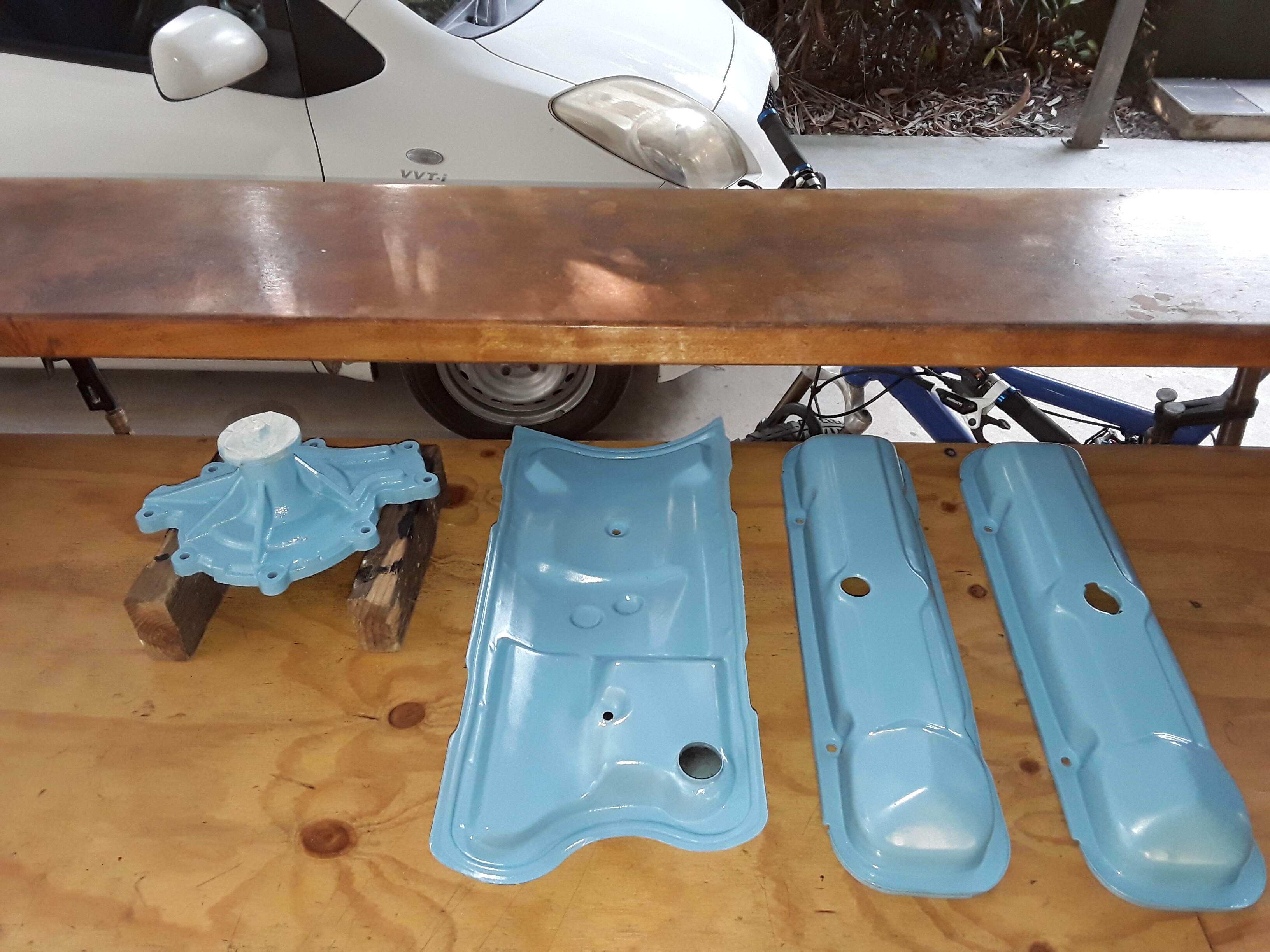

Is there any greater drudgery than scaping off old gaskets? Especially when they have only been on a short while and I did a damn fine job of ensuring there'd be no oil leaks. Anyway, I got all the old gasket and sealer off and ran a rag dipped in thinners over the surface in preparation for the new gaskets. Painted the sheet metal bits & the water pump I pulled off the engine, so they will sit in the tropical sun for a few days to allow the engine enamel to cure. Engine might not go, but it's at least gonna look nice.
Will soak new lifters in oil for most of tomorrow, I'll chuck a little assembly lube on each cam lobe (will change oil shortly after test drive anyway) and will fit the new roller tip rockers. I'll attach new gaskets to various components (incl. intake) and will check that ports match up. Might have to shorten the water pump crossover bolt (Edelbrock's instructions) before final fit so will have a look at that too.
