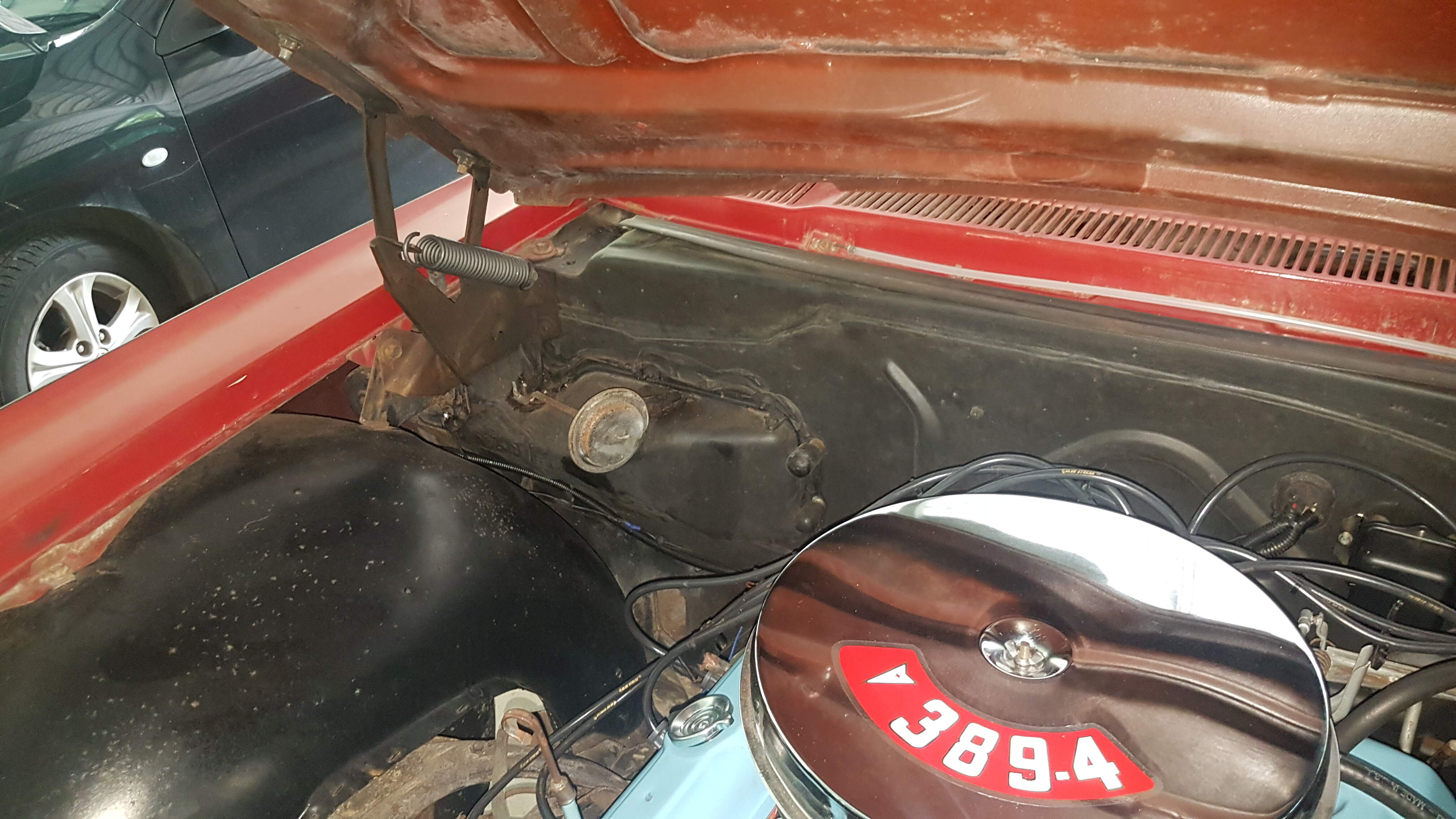

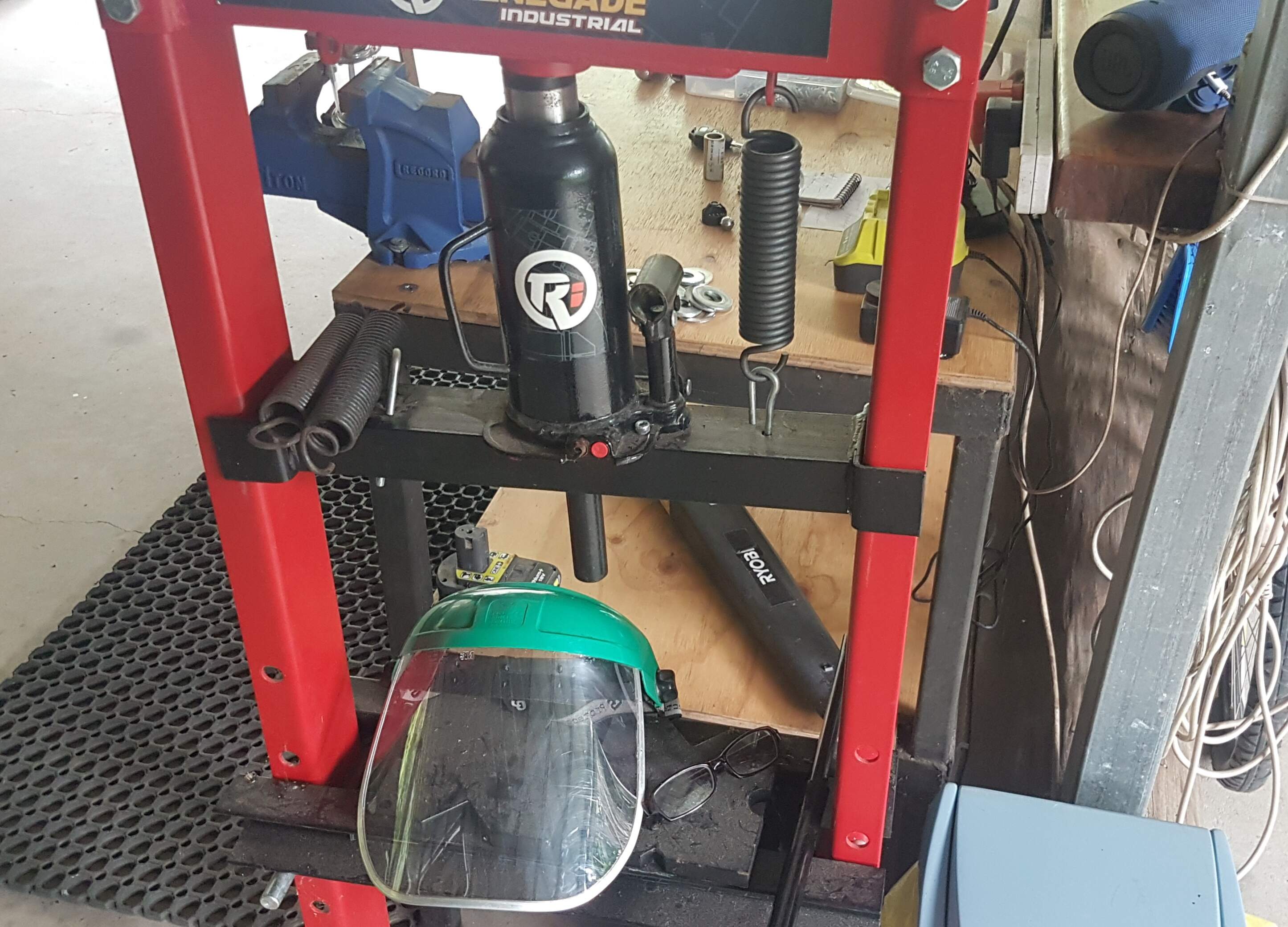

The hood counterbalance springs. These things are TOUGH. You know brake shoe return springs and how tough they are? Pfft. They are like slinkys compared to the hood ones. A friend visited today and I got him to support the hood whilst I brandished a V belt and attempted to stretch one of those springs across it's pivot points. Ha! Mr Universe couldn't stretch one of those suckers. After he left, I decided to try inserting washers in between the spring coils in order to stretch it. I unhooked the regular springs on my hydraulic press and swapped them for the hood ones. I stretched them with the bottle jack and inserted about 20 washers. It took a few goes - you have to insert from different angles to try and keep the thing straight. I was wearing safety glasses, a polycarbonate face shield and gloves! I gingerly took the spring to the car, supported the hood with one arm whilst positioning the spring with the other. Gently closed the hood and listened as the washers fell out. Job done! I present this as a Public Service announcement. I have no idea how I'm going to remove the other spring. I think I'll just wait until it breaks!

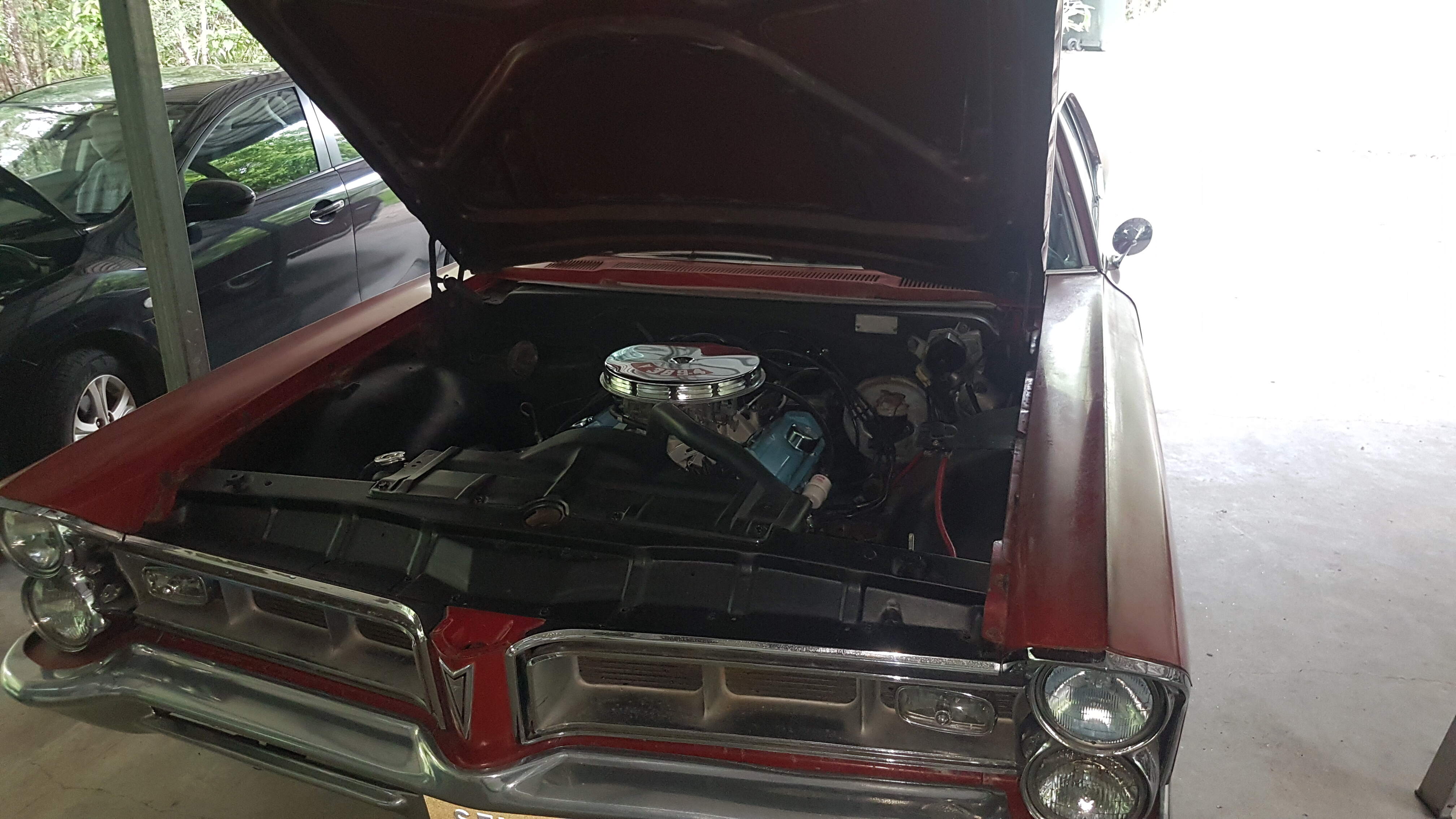

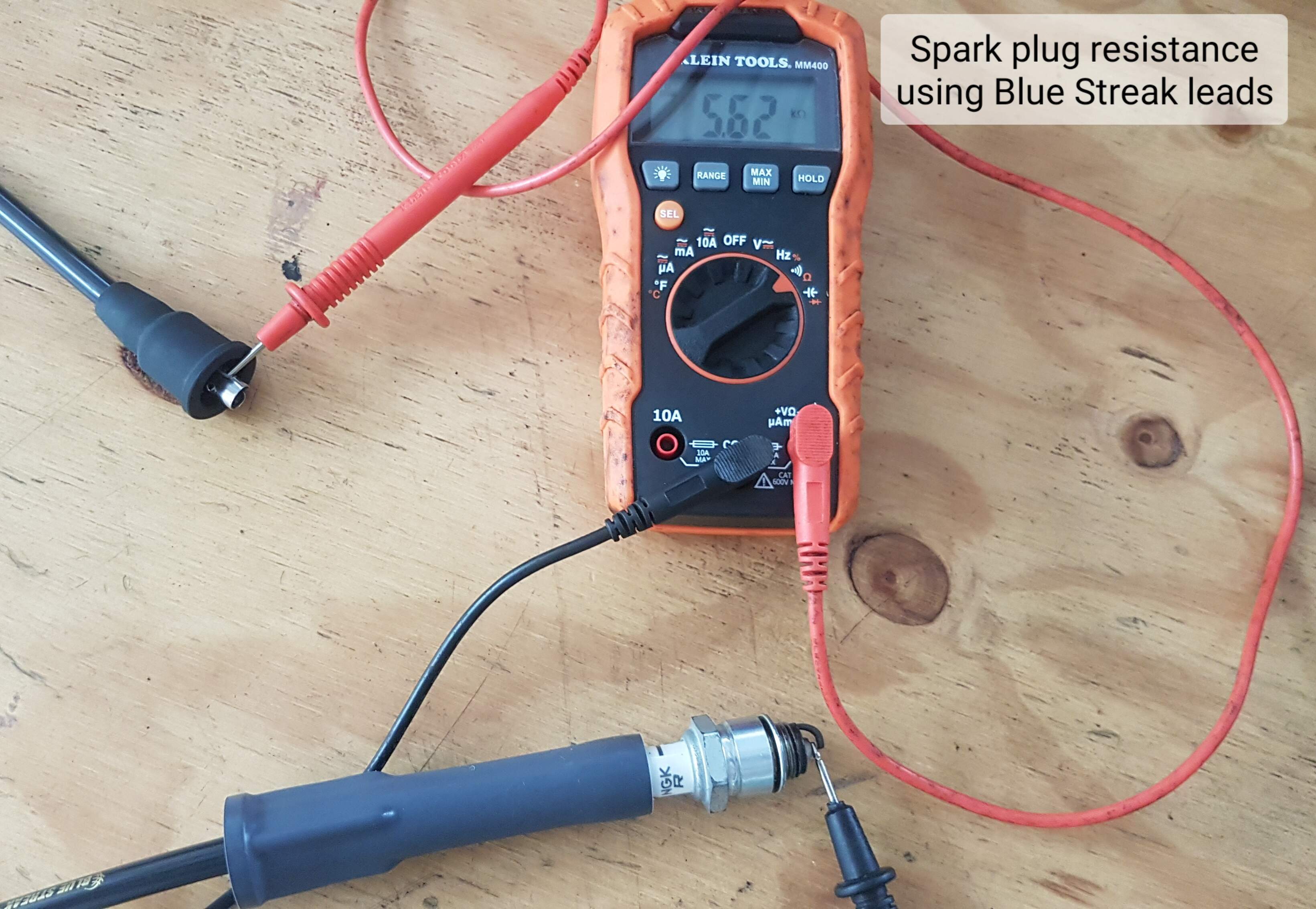

Got sick of walking past my car and not driving it so thought I'd take her for a short run. Started off nicely, then when I went to turn around I thought I was imagining some stumbling (misfiring.) As it turns out, if actually was. It got progressively worse (does this sound familiar) and whilst once on the highway it cruised almost perfectly, once I slowed down to use the smaller road back to my place, it really started to play up. Parked it and whilst manouevring into position, I had to keep a little gas going in to stop it from stalling. Before shutting it off, I idled it for about 10 seconds and it was rough. What is it now? I closed the hood and walked away from it, thoroughly pissed off with it.

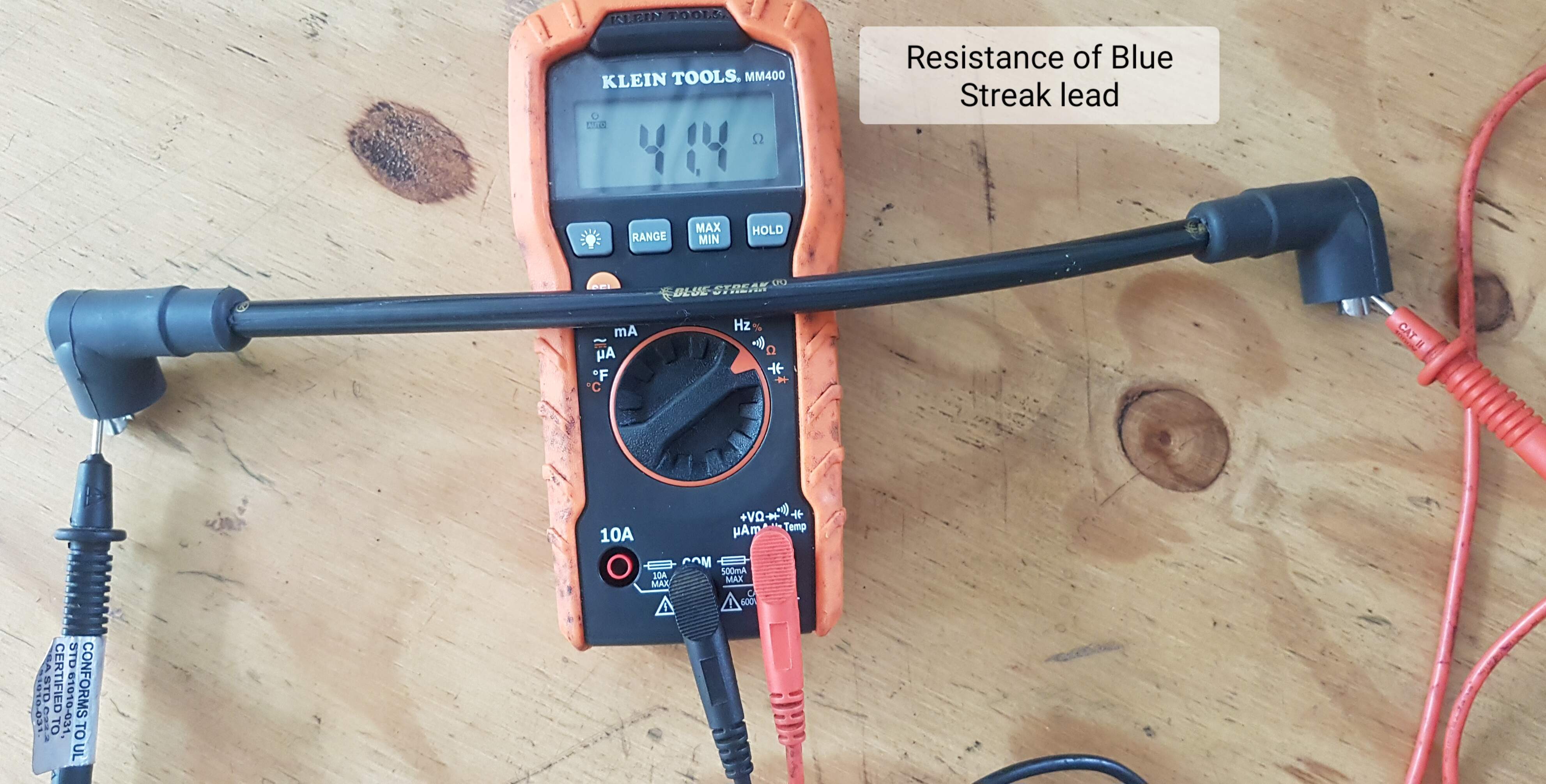

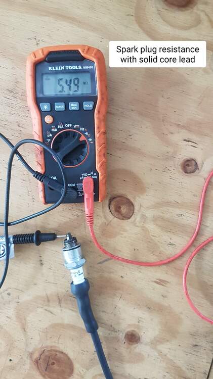

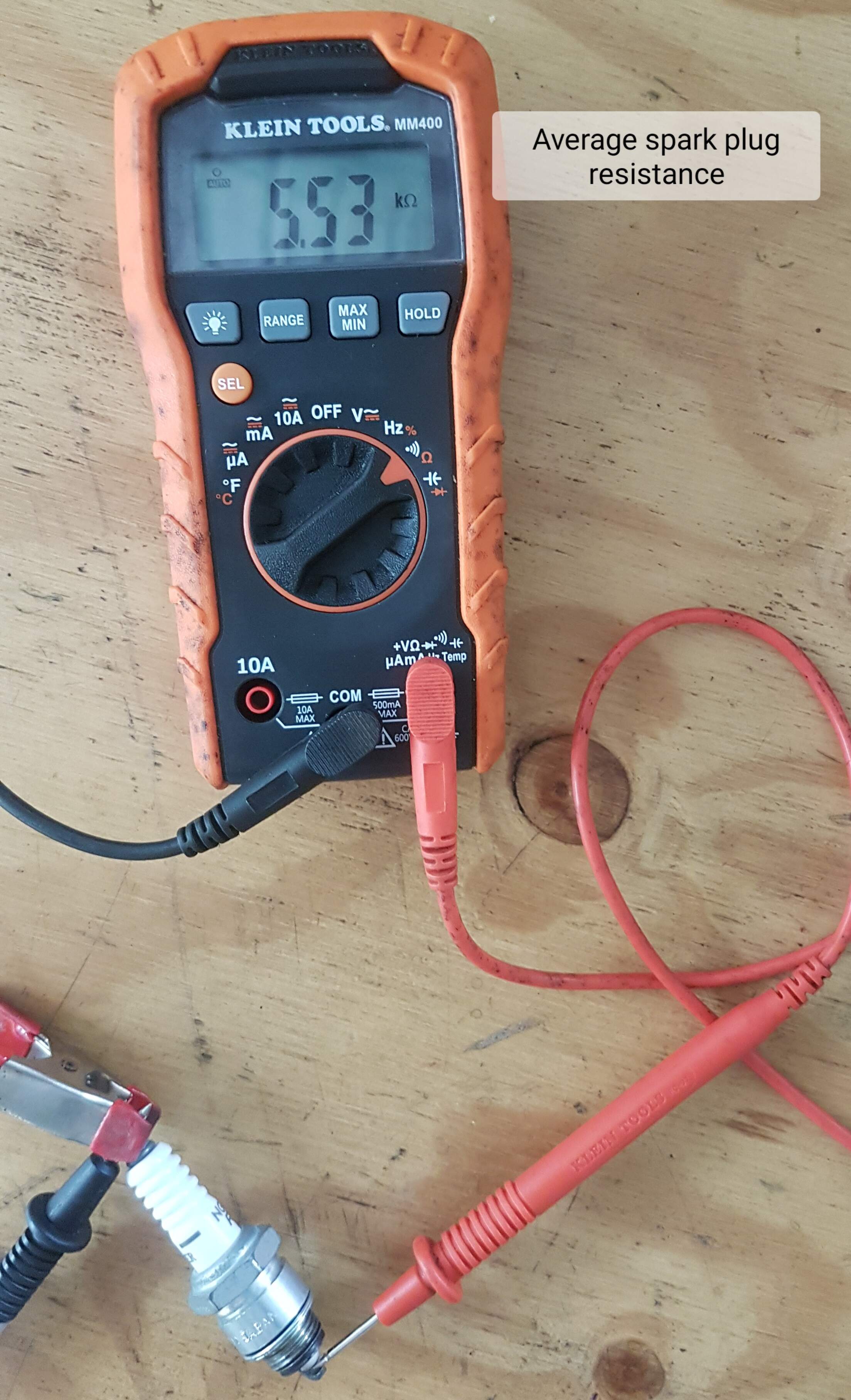

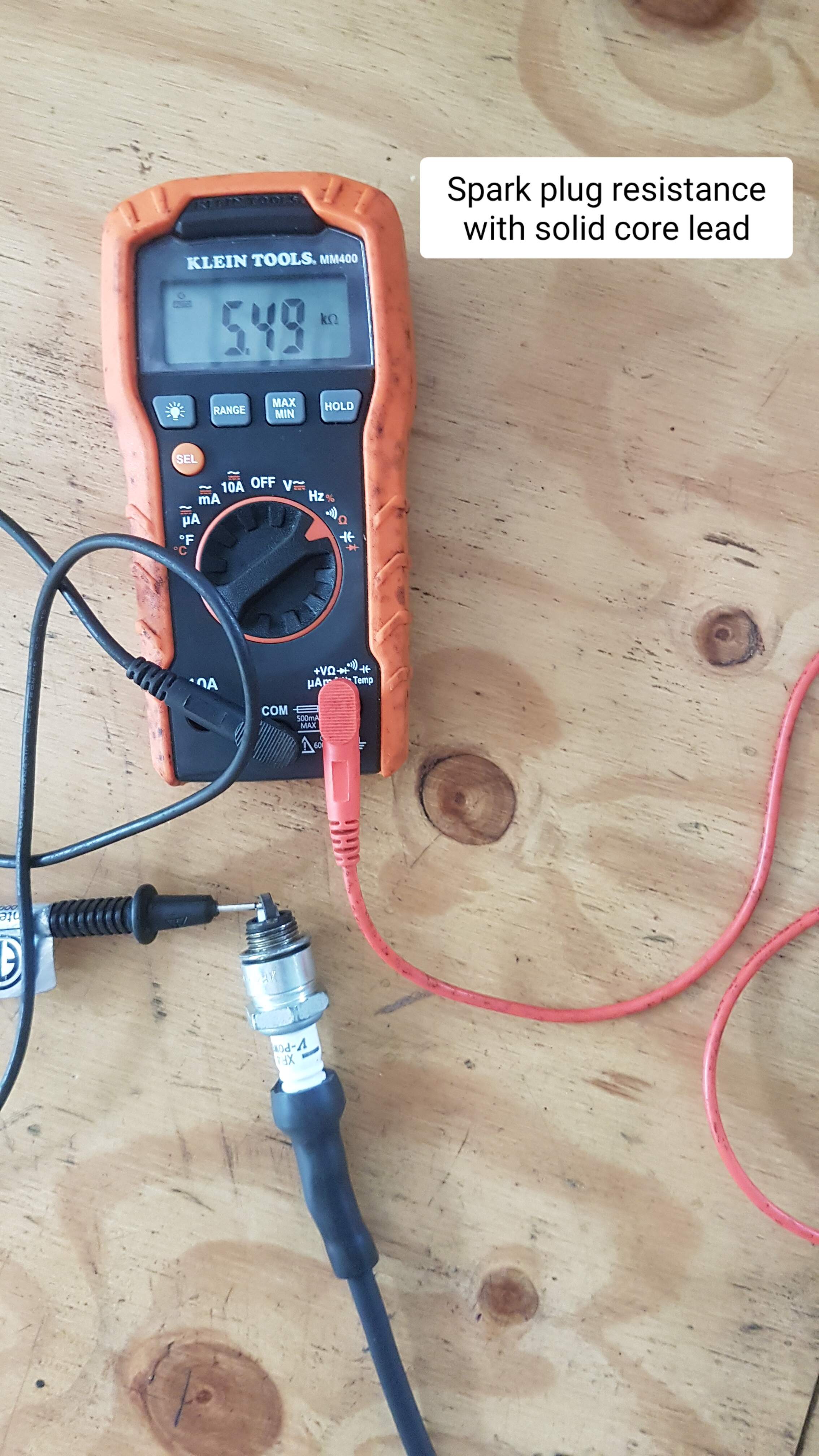

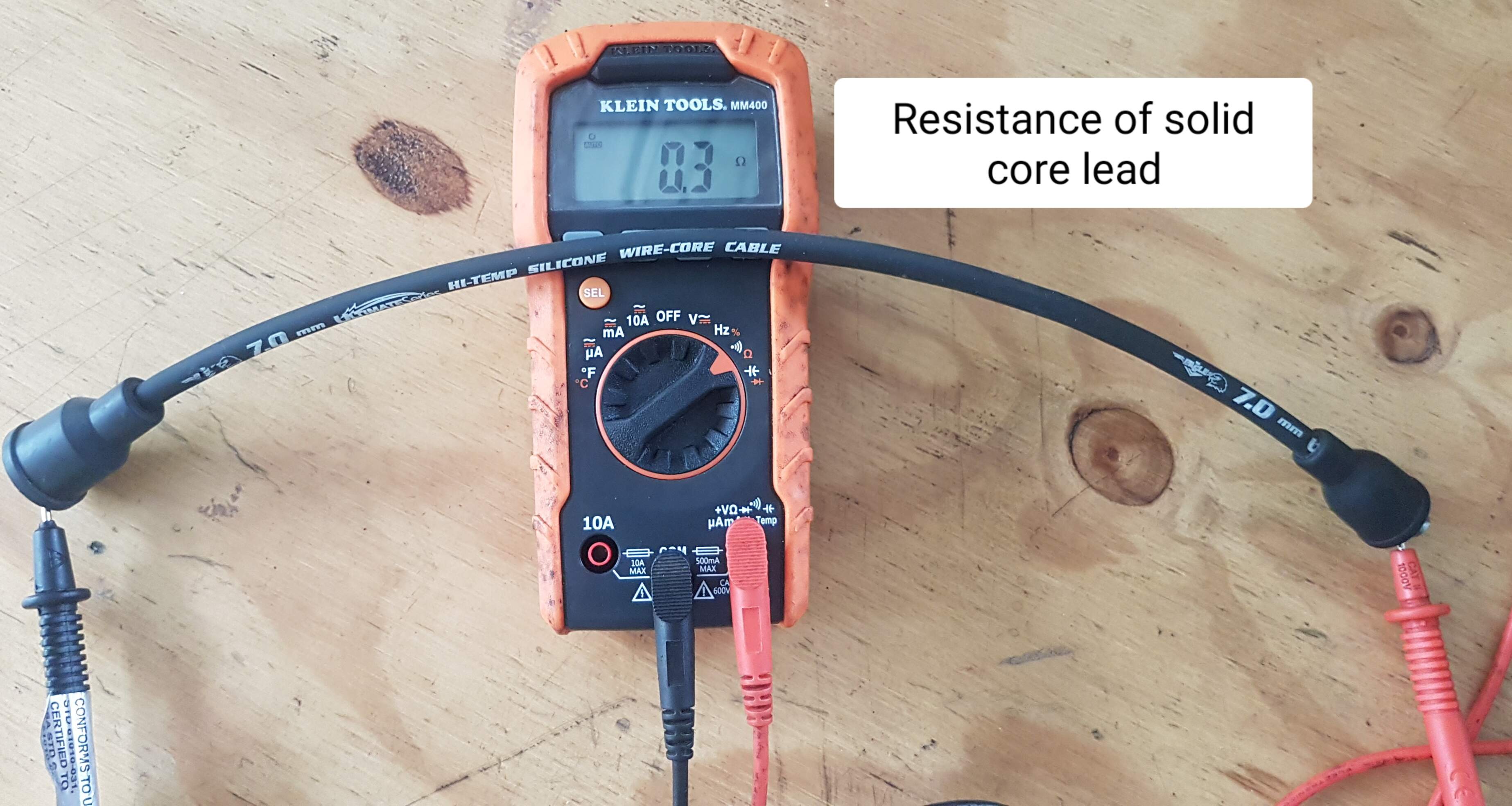

Today, I thought I can't just leave it floundering - it has to be fixed. This is going to be a slow steady process. Started with spark plugs & HT leads. Took each plug and it's lead off in sequence and inspected the (new) NGK plugs. Checked the gap, inspected the electrodes & insulator and reinstalled them. But, before reinstallation I thought I'd check the resistance of all leads & plugs. The fancy pants Blue Streak ones from Rockauto look the business, but their resistance was off the scale, compared to my original rat chewed solid core ones that showed almost nil resistance. Strangely, after attaching a spark plug to one end and retesting resistance, all the leads came up with about the same value. What's happening there?
The pics tell the story. Any ideas why a lead's resistance should drop once a spark plug is snapped into place? I repeated the exercise with all leads multiple times and wriggled and played with them whilst watching the multimeter. No difference. I have decided to reinstall my old solid core leads and haven't had time to start the car yet.
