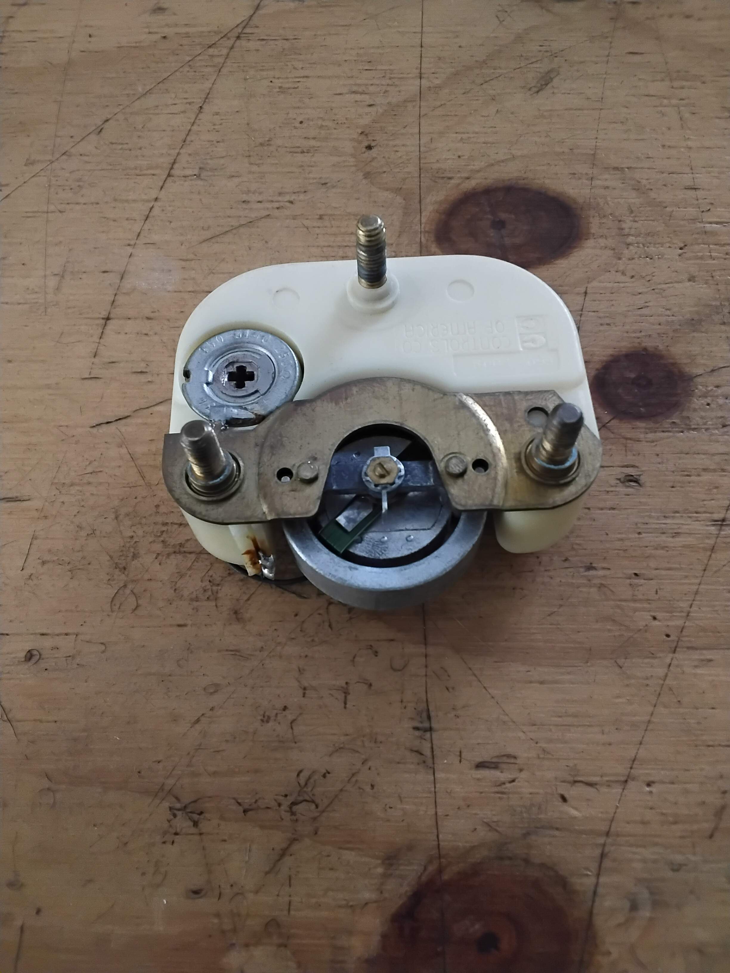

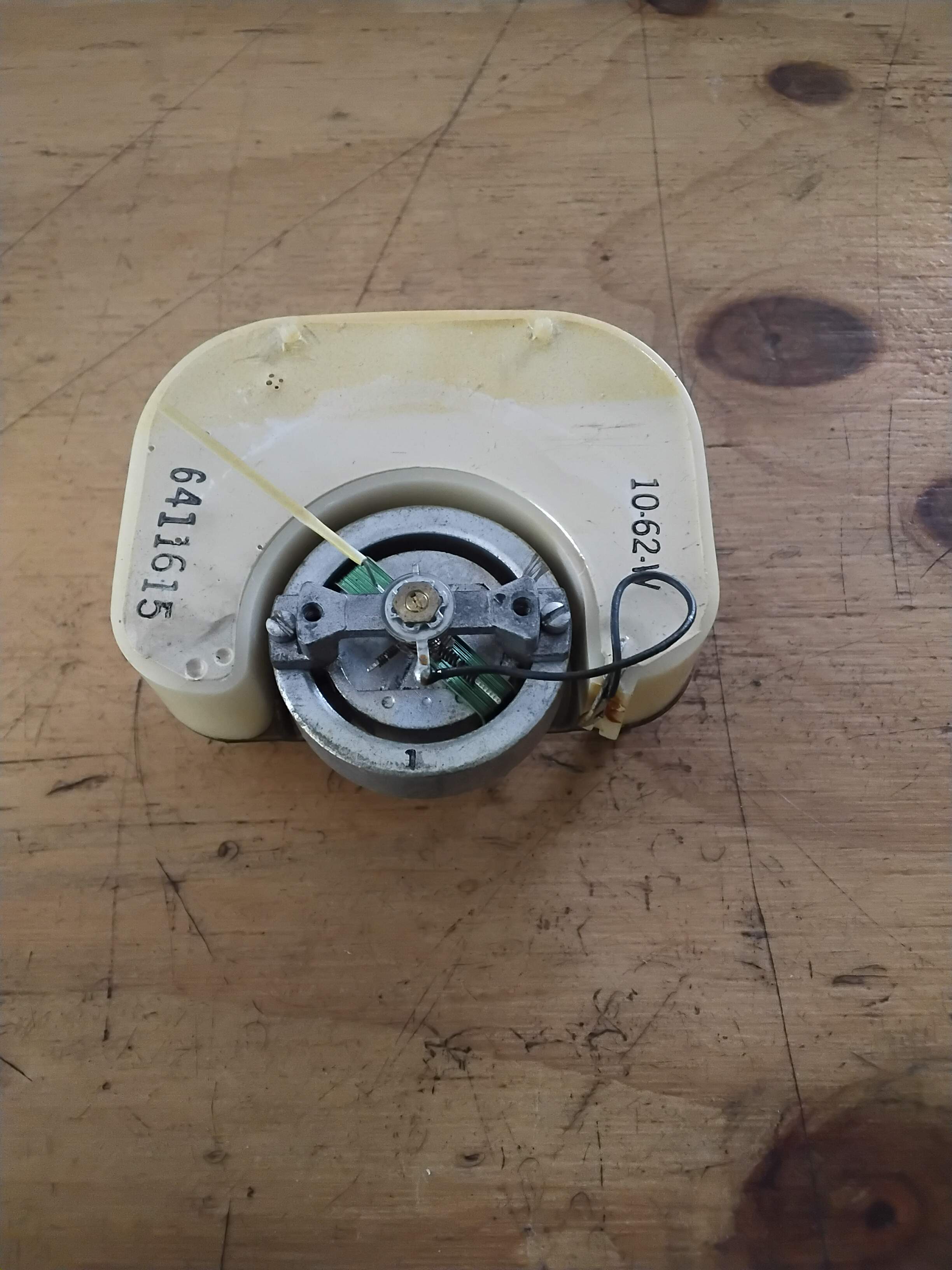

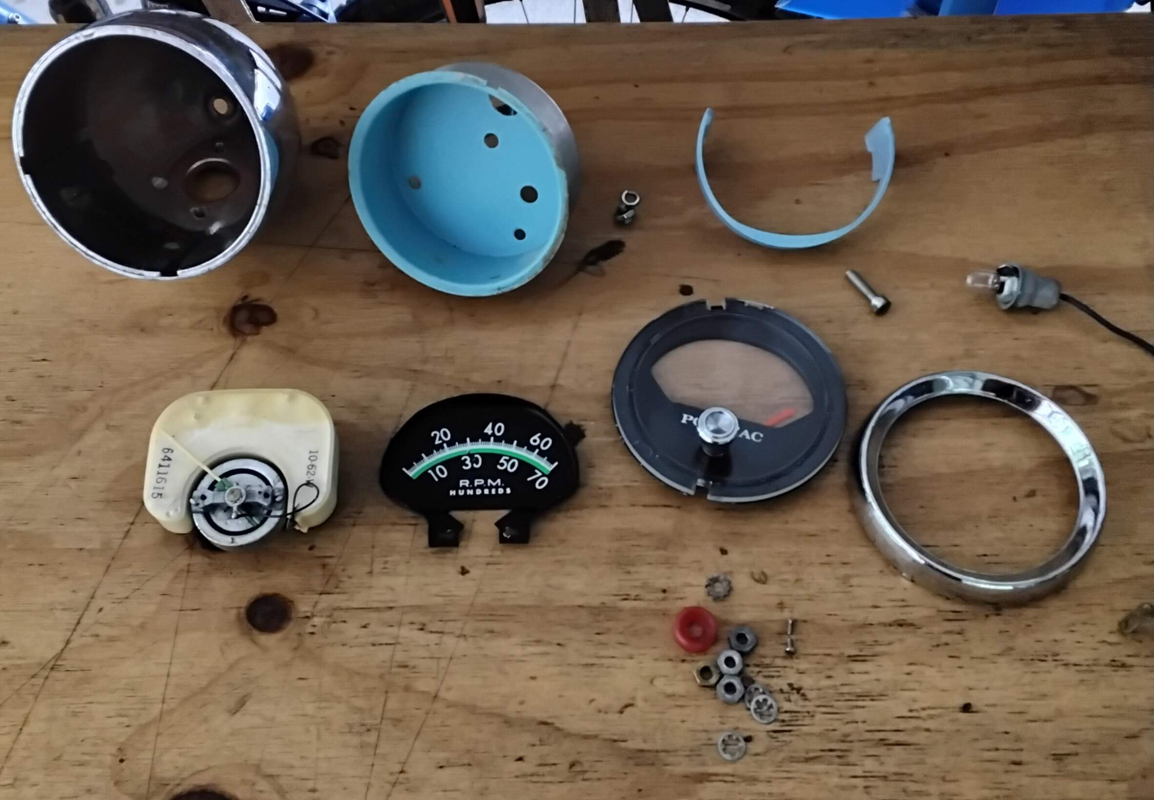

I picked up the Frosty Memorial Tacho today and the dude had pulled it apart but was scared off by the sealed guts of it. He said they couldn't get a response from it, so now I'm wondering if I (or someone properly qualified) can retrofit a modern digital mech to the old skool needle & face. I'm going to email Lionel Otto Instruments in New South Wales. This guy is the Gauge God. If he can't get it to work, nobody can. The first attached pic is what is inside a 60's chrome shelled tach. The next ones are the sealed workings containing the black magic. Somewhere along the way, somebody has decreed that Pontiac blue engine paint is the correct hue for backlit gauges. Fortunately, I have one and a half cans of that stuff still laying about, so I'll zap it like I did the speedo.

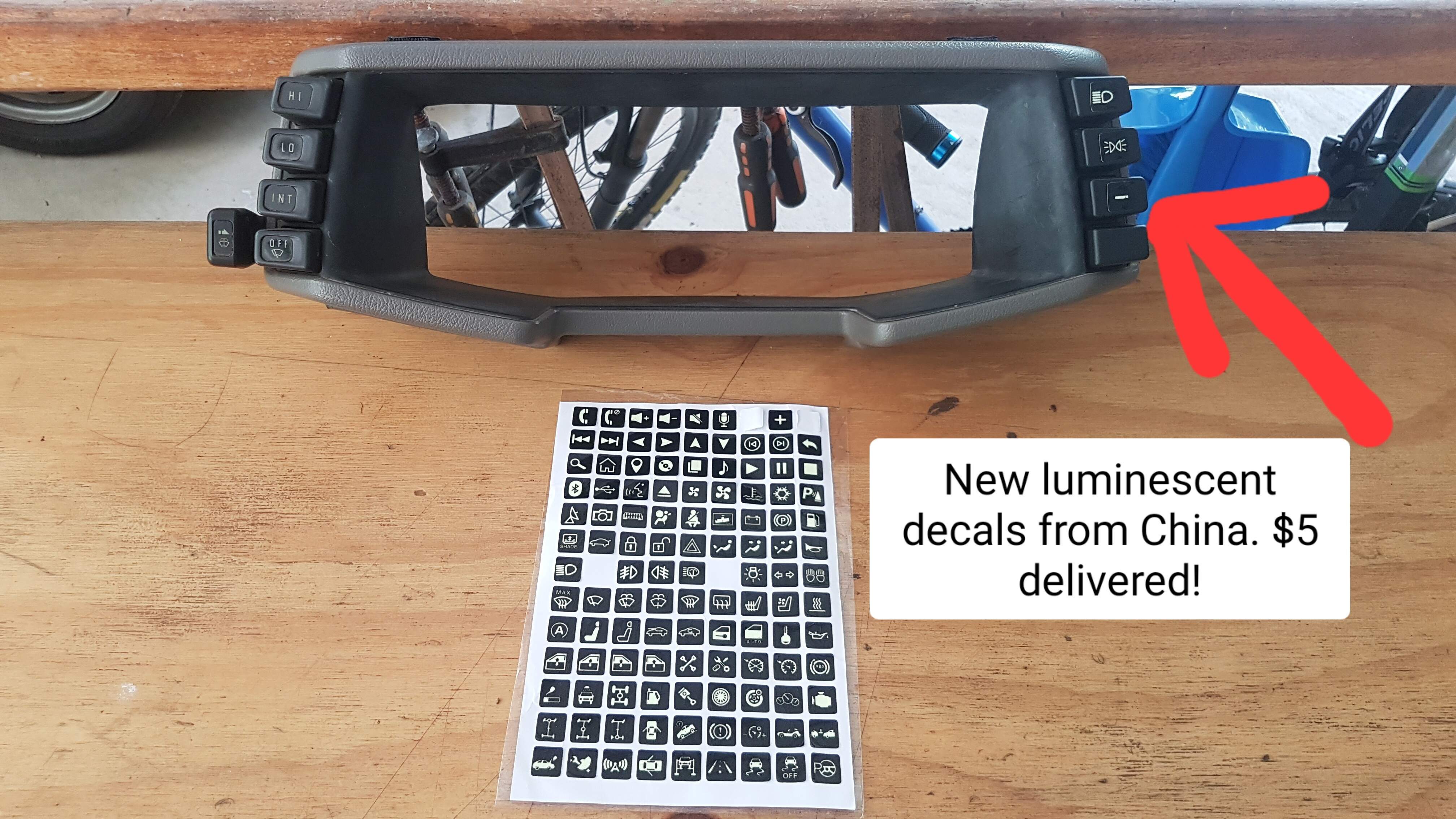

First up: the light switch decals for my Isuzu Pickup arrived so I superglued them in place and gave the switches a misting of clearcoat to spruce 'em up. The old switches had been sun damaged, so I filled the aperture in each switch with body filler first. I also gave the speedo surround a light coat of satin black and then a clearcoat. Some jerk on ebay tried to sell me a second hand set of binnacle switches for $300. I hope he goes hungry. This is Isuzu Forever, isn't it???

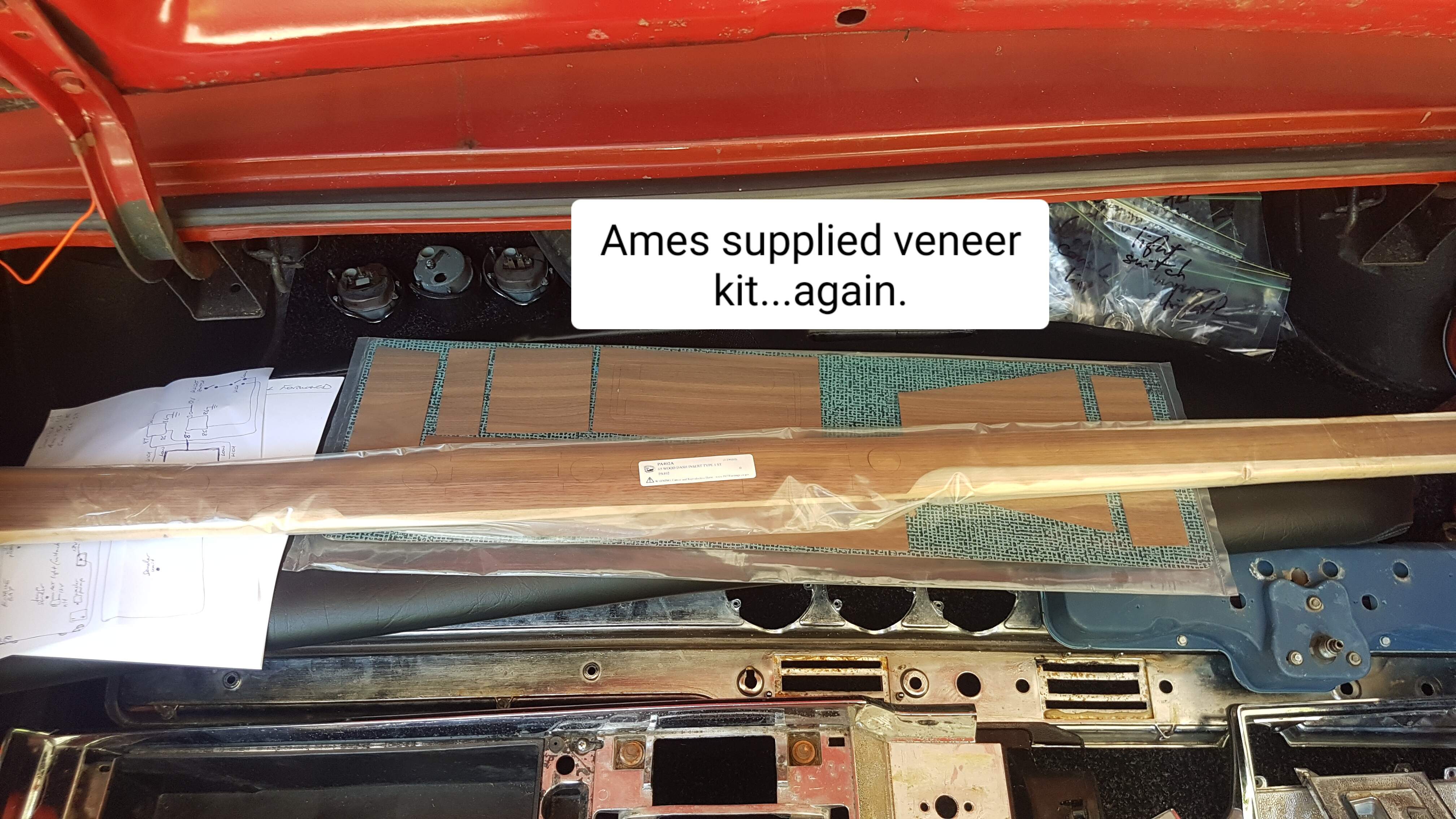

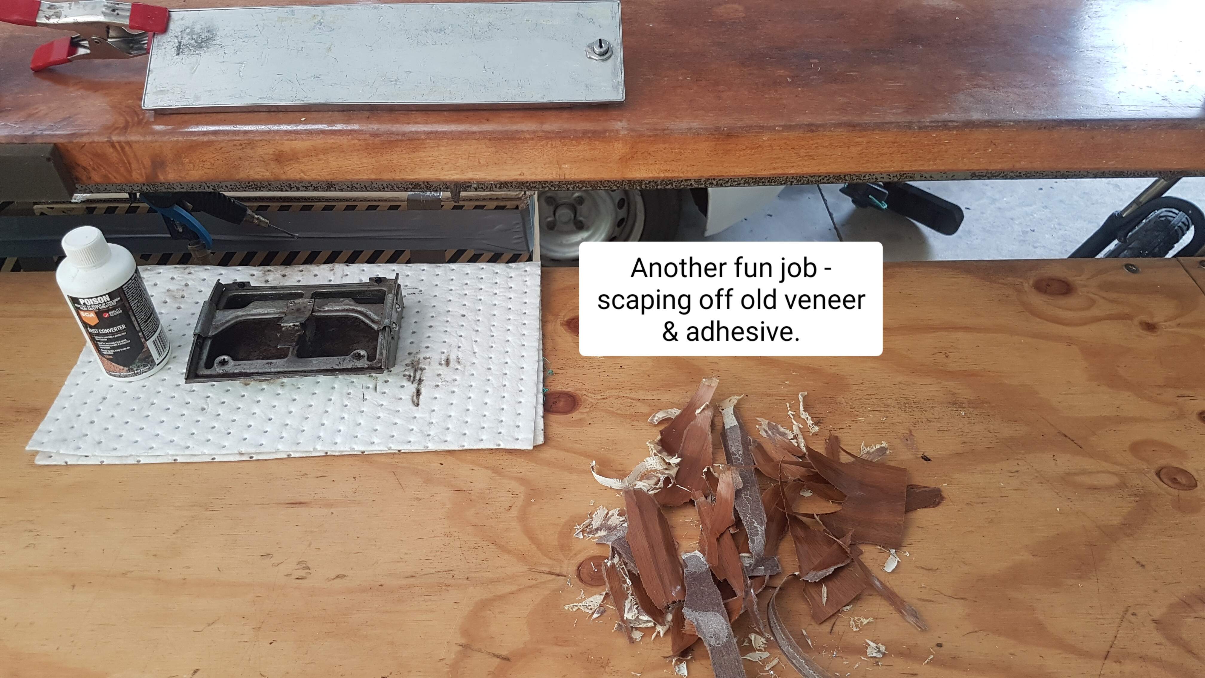

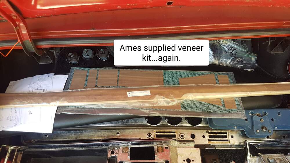

Next in line was El Poncho. I started to remove my old wobbly timber veneer from the interior bits & pieces. New kit arrived from Ames on Friday. For anyone who may remember, I made the fatal error of varnishing the new veneer bits prior to glueing them in place. Lordy - what a mess. The next morning they had all curled up and even though I clamped everything down when I attached them, it was a disaster.

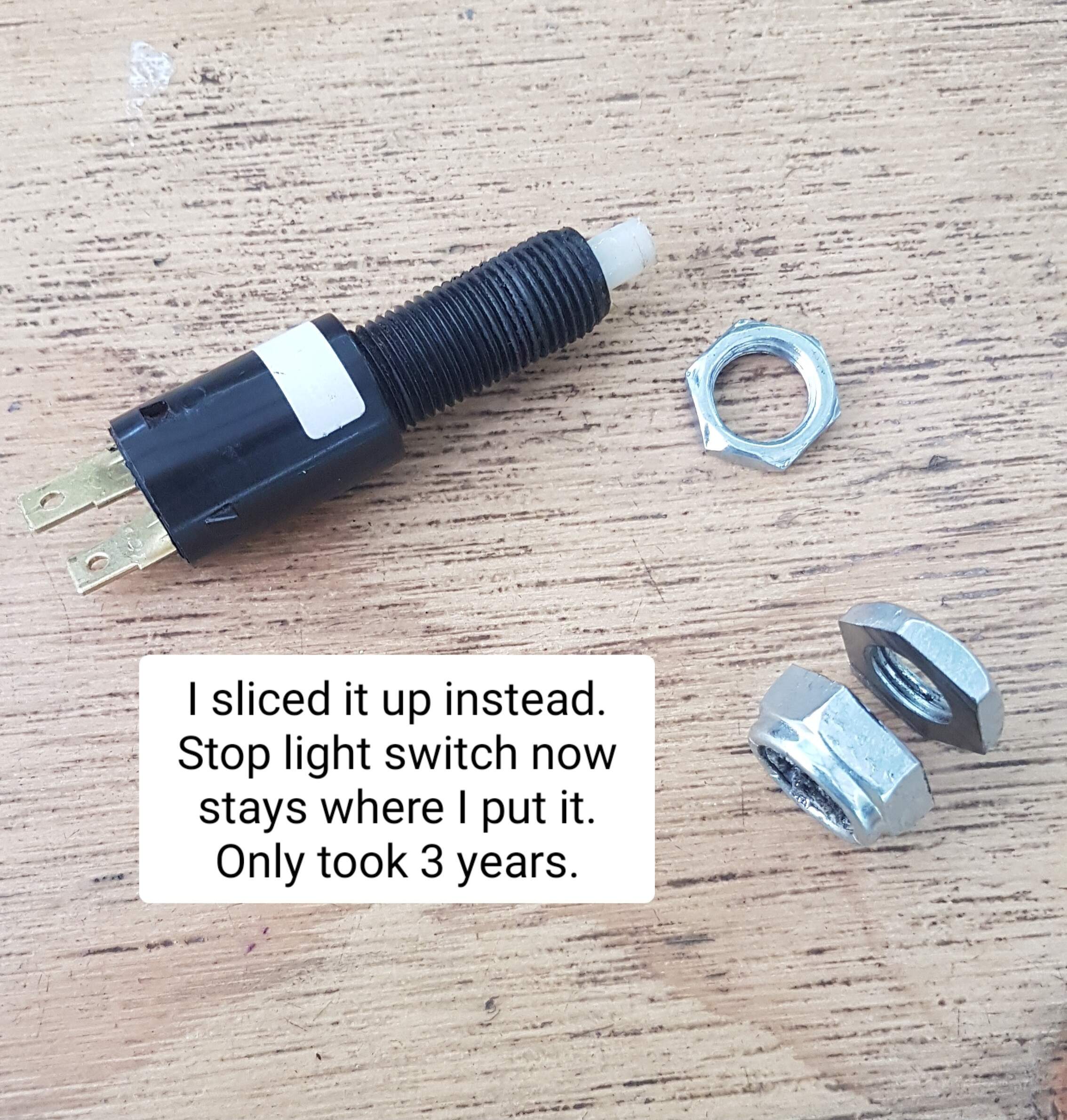

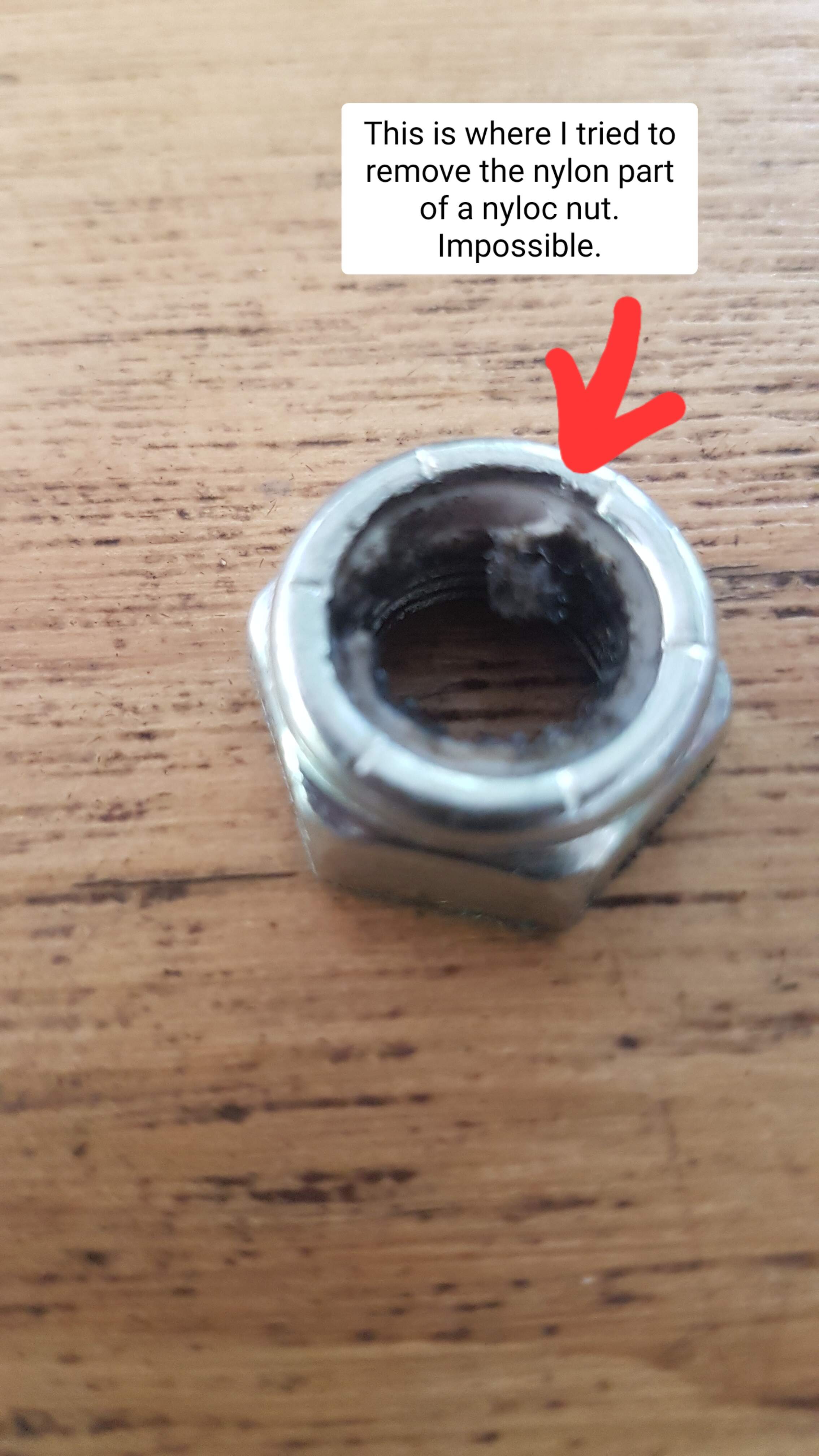

GP stop light switch. Damn thing would never sit in place with the result of eternal brake lights. I did what the factory should have done and ripped out the useless little bracket that is captive in the pedal shaft, and sliced up a 1/2" UNF nyloc nut to keep it slim and now it's fixed - using a nut each side of the pedal shaft.

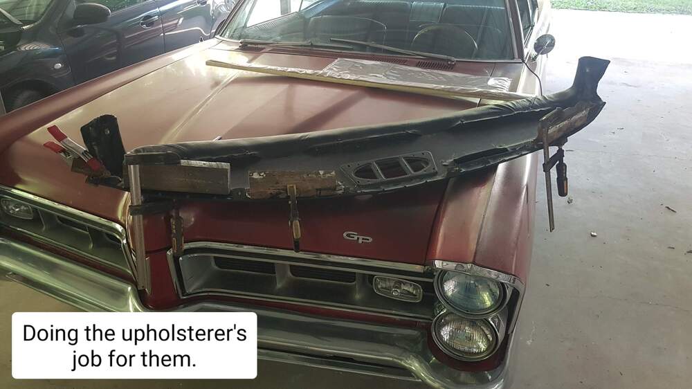

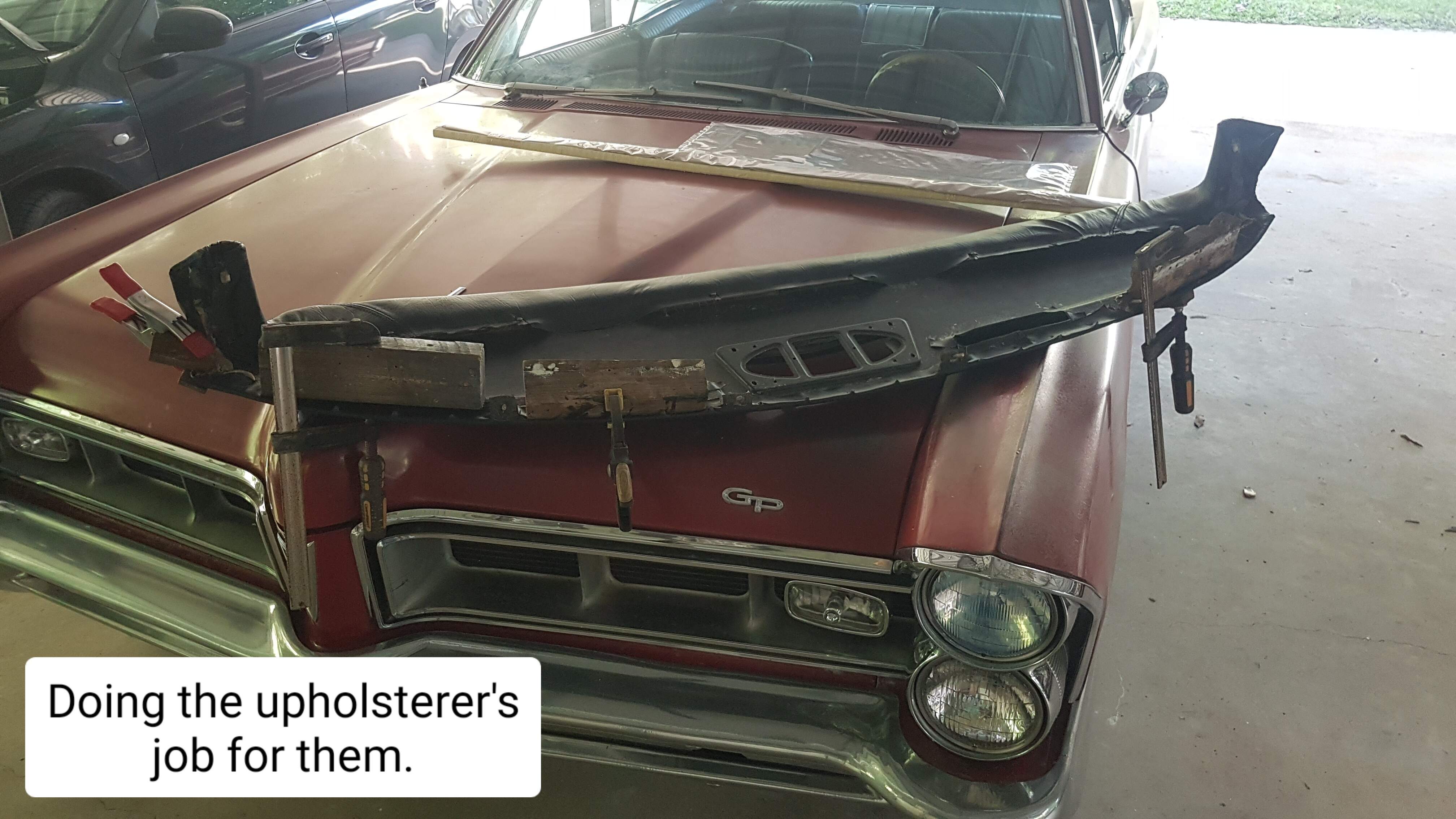

Whilst on a roll, I had a go at the dash top. It never sat right because of excessive padding, so I pulled the vinyl cover off just enough to slice enough padding away. It now snaps into place like a factory one.

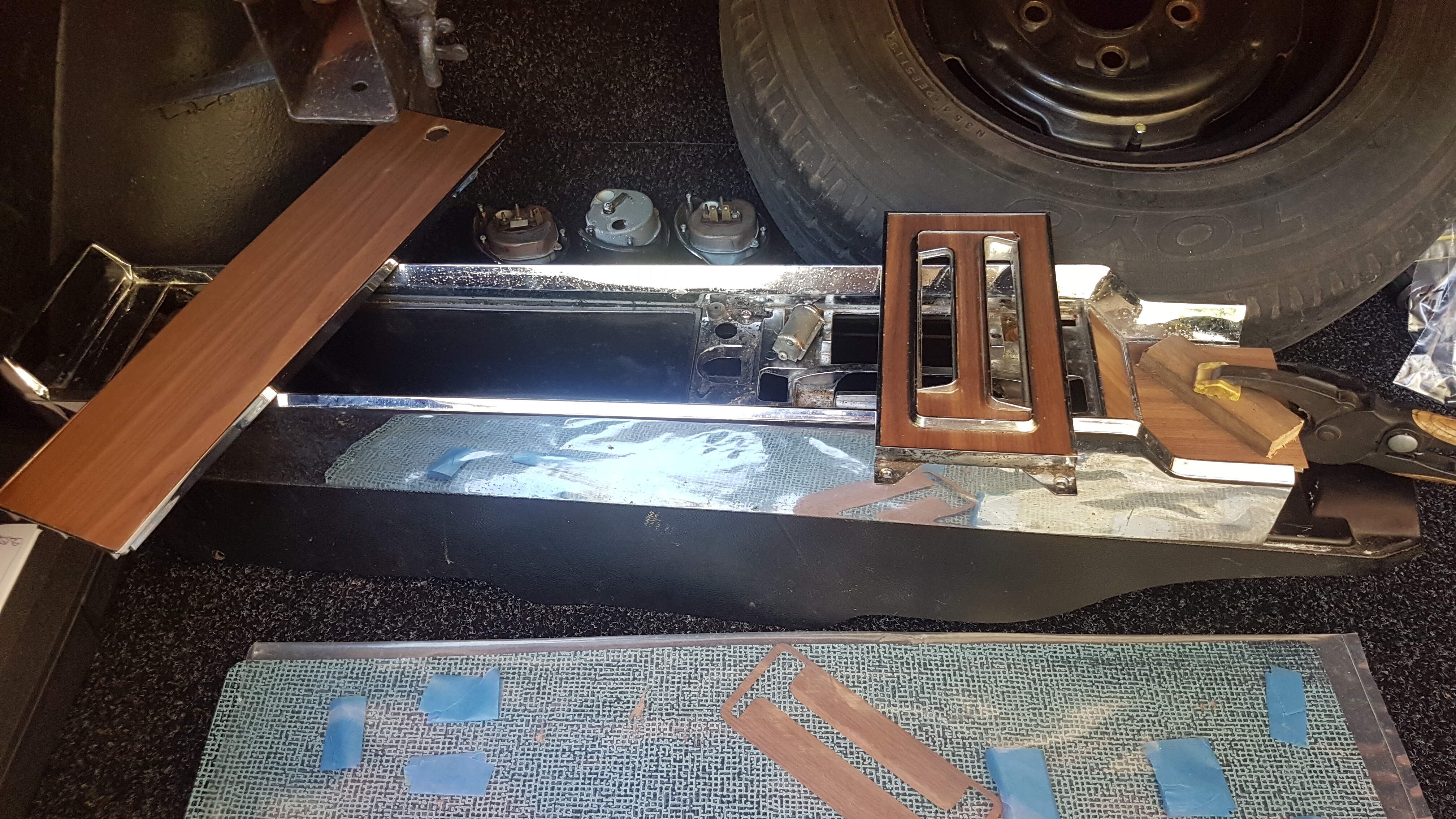

My last day off today so after much fluffing about I had some time spare so got stuck into the wood veneer trim. Kept scraping the old stuff off and reattached the new bits. They are all die cut and fit perfectly, although I had to trim the absolute tiniest few microns off a coupla pieces. I used 3M spray trim adhesive or Liquid Nails depending on the intricacy of the piece to be attached. And THIS time I'm gonna apply a light misting of clear AFTER the adhesive has set! I have included a pic of the supplied instructions. DO NOT lacquer prior to fitment. You have been warned. Everything was done slowly and all pieces clamped whilst setting - I don't want any screw ups this time.

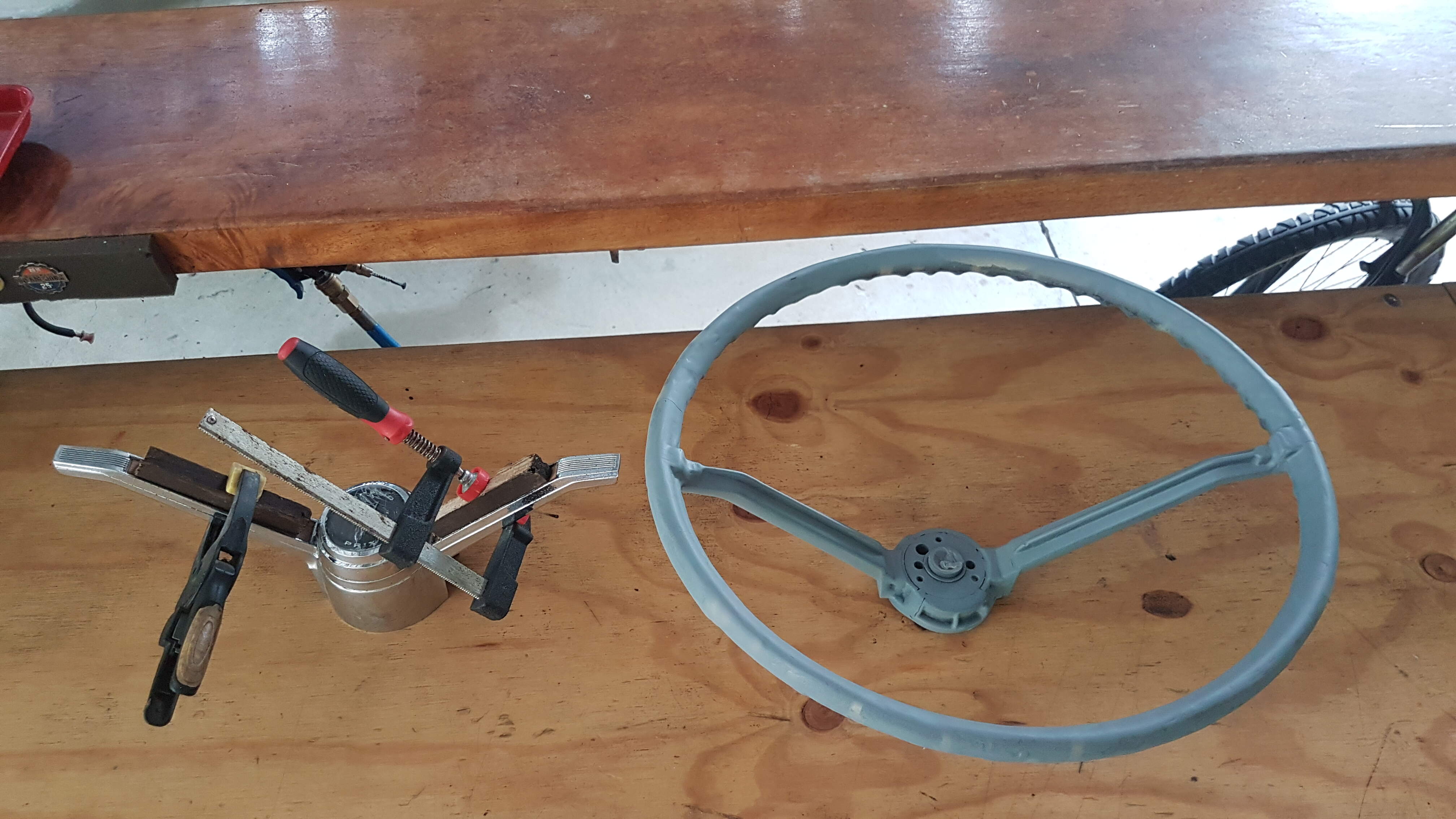

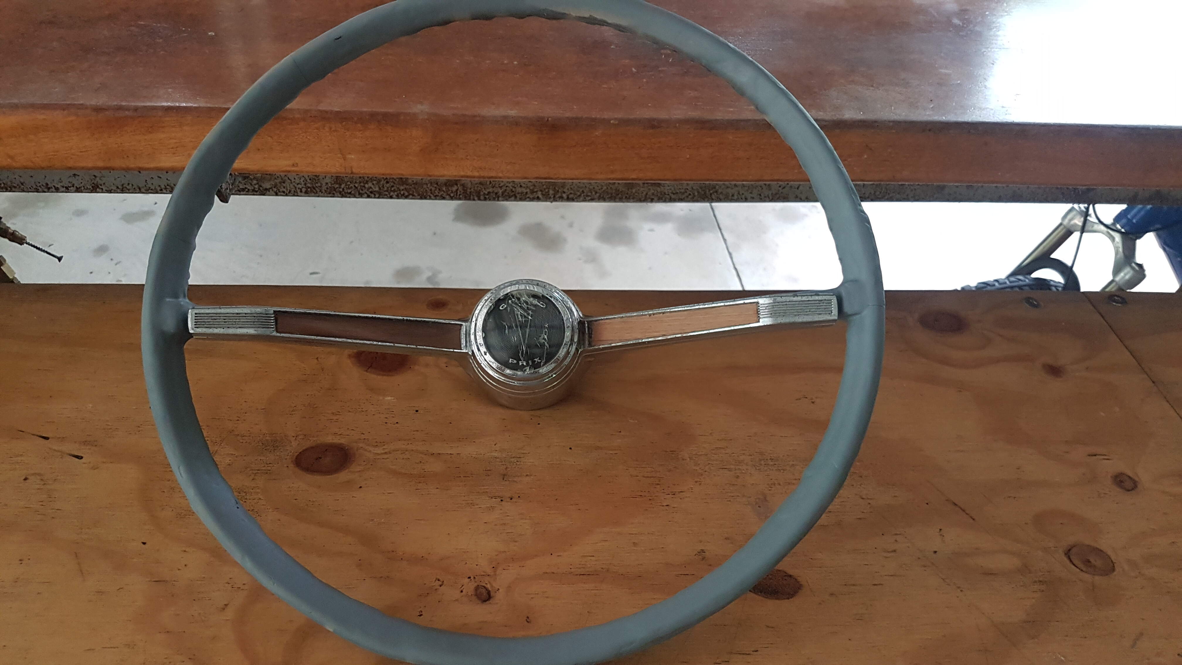

In order to ease my under dash contortions, the front seats will remain out. After I bashed my head on the steering wheel for the third time, I also removed that. Then I dug out my old original one. I have decided the car needs to have it reinstalled, so sanded it and gave it a blow over of primer to highlight any imperfections. Then, to my delight I figured out where the 2 extra bits of timber veneer included in the kit belong - on the horn ring centre piece. They had been missing from when I got the car and I didn't even know they were supposed to go there. They will be a permissible substitute for the woodgrain wheel I took off. Why did Grant decide that a thicker rim was going to look correct? There was no mention of that fact when I ordered it and it has irritated me ever since I fitted it. Never mind - it's only money. I will paint the wheel in gloss black and will coat it with clear resin to finish it off.
Hey, if anyone is at a swap meet and you see the clear lens centre piece, can you grab it? Mine is trashed but I think the GP logo underneath comes apart from the top.

can you take a better pic of that centre section
in case I come across one 🍻
Hair is for girls.
I'll get you a close up of the horn button tomorrow.
