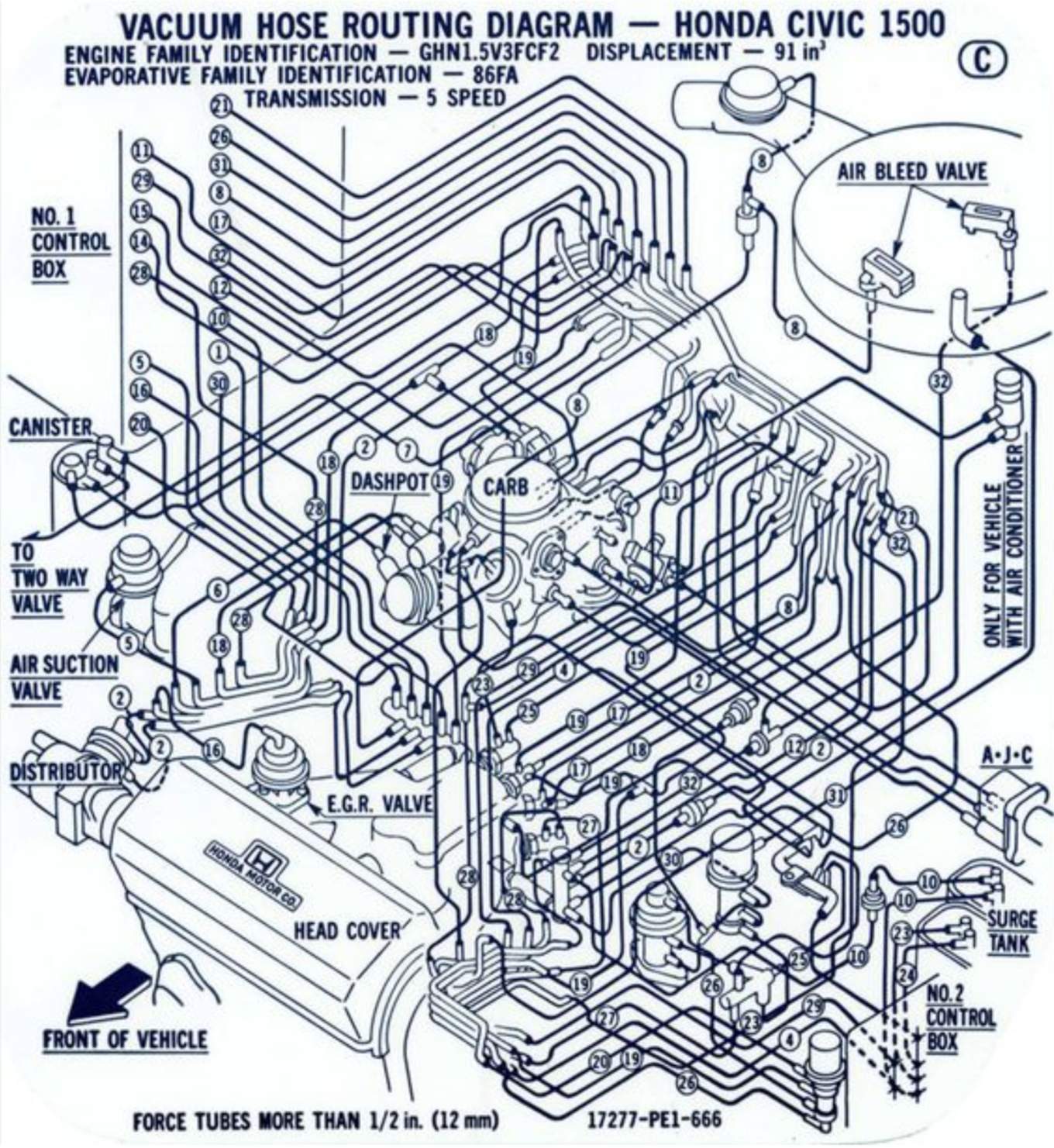

So - you're having car troubles? Can't work out why it's missing & stumbling? Might be a vacuum leak.
Here is a vacuum hose schematic from a 80s carburettored Honda just prior to EFI. It's titled 'Run Away Screaming!'
Yip yip
very straight forward ,,,, where’s the tomato sauce to go with all the spaghetti?
:rofl:

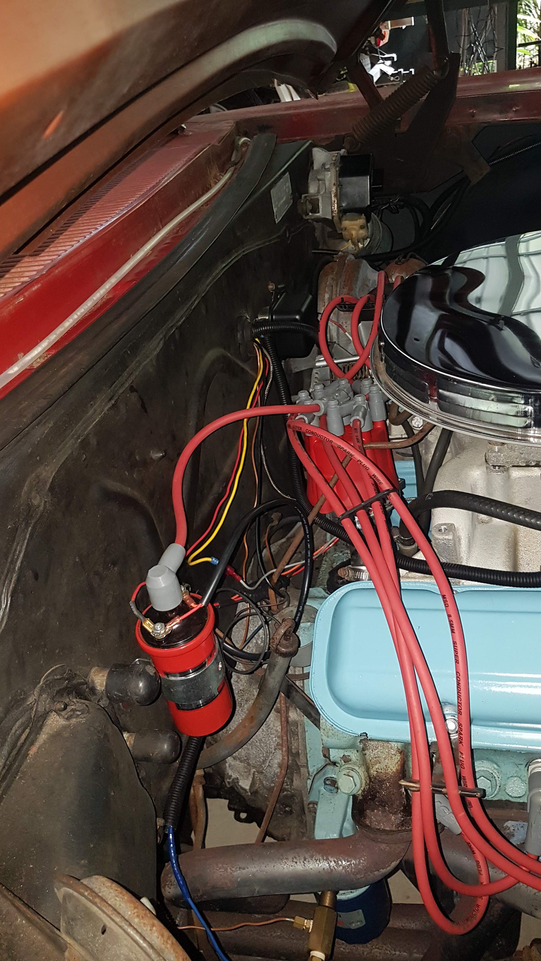

Well, here we are again - it's been a while. After fiddling with the GP a few weeks ago I thought I MUST have fixed everything only to be bitterly disappointed during a short test drive.

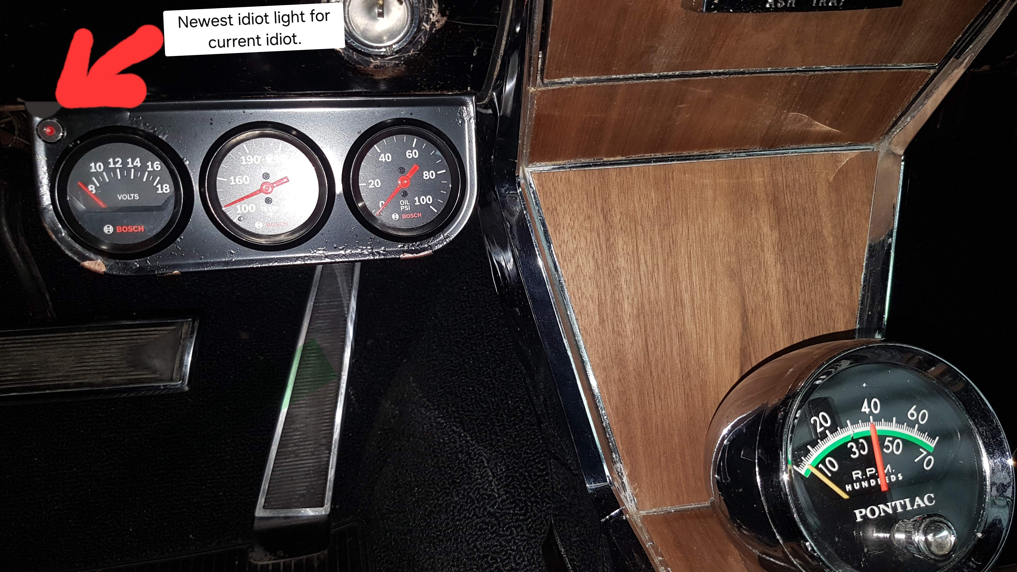

Mechanic has fitted nice new SELF REGULATING 100A alternator. If you ever need to replace your ancient alternator, get one of these babies (thanx to Kiwi on this one.) He also fitted MSD coil, leads & billet electronic distributor. I'll tidy those wires up soon. Picked up the car today and only drove about 10km to get it home but it ran beautifully. I still need to either massage some light oil into that leather accelerator pump plunger (as advised by carb rebuilder) or get another one. Rebuilder said to soak the leather in light oil for 48 hours and then work the oil into the plunger until it plumps up again. I'll try that first. I've seen new plungers for sale where the plunger is some super duper modern material that I am guessing is ethanol compatible so that will be the next option. Car had been sitting out in the open for those weeks so was pretty grubby when I picked it up. Gave everything a good clean, adjusted tyre pressures and if the damn rain gives me a break, I'll take her for a proper spin over the weekend and will attempt to record it on my phone without crashing into something whilst distracted.
An interesting point: mechanic explained that an idiot light needs to be wired in to new alternator in order for it to charge at idle. If you do not do this, charge won't occur until over about 1000rpm. Something about exciting the diodes...whatever. I have mounted a tiny red LED next to the voltmeter in order to complete the installation. A nice healthy 14V now powers everything whilst running, Frosty's tach is working and fuel gauge now works. Oh, the luxury!
The Excited Diodes...good name for an 80s punk band?
Mate ,how come the sparky didn’t hook the tell tail light ?
with out it your not charging at idle
the led won’t work as a tell tail , you would be best to find the wire that came from the existing light in your dash at the old regulator and connect that to the s on the alternator
your existing tell tail light will have a power feed from the key and the alternator is the earth to that bulb .
once the alternator spins the diode pack will switch and that earth becomes a positive and the lamp goes out
For that circuit to operate it has to have resistance and a standard bulb will do that
your led wont !
I have tried to do this myself and you need to add a resistor to both sides of the led
I tried it and failed ! So I went back to a standard bulb … this was in the mk1
I must of had the wrongway resistor
Well, there was no 'sparky.' Mechanic did the install and hooked up the light. Left it connected for me to drill the hole in the gauge cluster and neaten the final installation. My car has no alternator telltale, just an ammeter which I bypassed some time ago amidst anecdotal fears of it burning the car to the ground. I can tell you that the instant the engine fires up, the voltmeter swings to 14V. In addition, I am only assuming it's an LED - it might actually be a tiny incandescant bulb.
Anyway, it appears to work perfectly although I do appreciate your input. If I had done it myself I'd certainly be doing as you suggested. He said he had to fiddle about with the back of the ignition switch as well. I told him there is a REG terminal there and he did whatever he had to do. I'm just happy that it runs and have lost interest in why it runs.

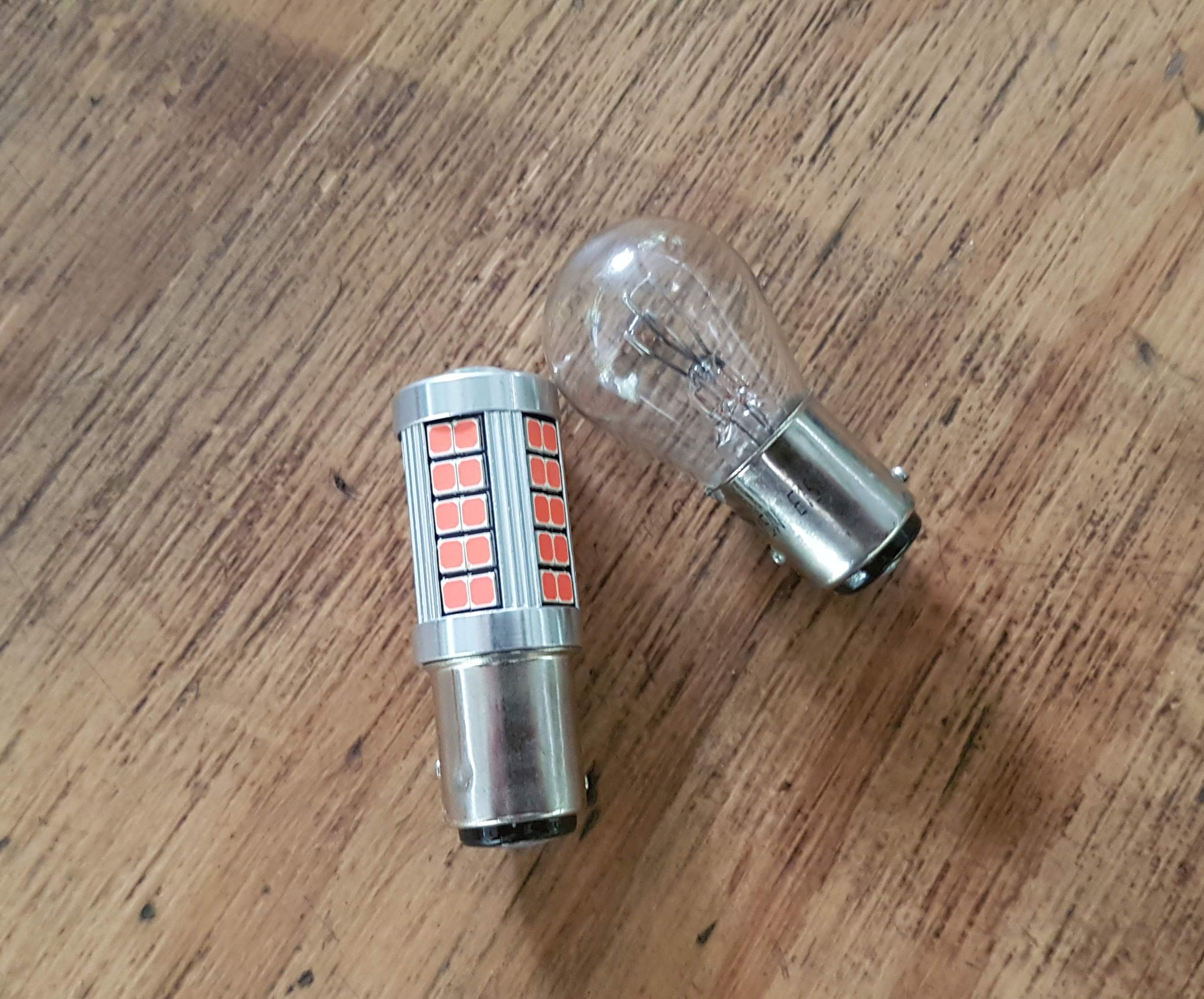

I feel like The Omega Man...the last man on Earth to learn that there are at least 2 types of bayonet style globes. I really wanted LEDs for the rear tail/stop/indicators on the GP so on a whim ordered 4 globes. I thought whilst I'm at it I'll put 2 on the ute. The globes arrived and with a light heart, a spring in my step and the promise of a great day beckoning I attempted to replace the rear globes on the GP. Even I couldn't screw this up. WRONG! There I am trying to fit the spanky new LEDs but they just won't go in. In utter frustration I retrieve the now slightly mangled bulb and notice that the bayonet pins are offset - not at the good ol' 180° that we all know and love. Since when did we get 2 choices of pin configuration? Why did someone bother to unnecessarily complicate an already foolproof configuration (they can only fit properly one way.) So, the old ones went back in and everything works as it did in the first place.
Not to be outdone and stuck with 4 bulbs I can't use, I thought I'd try them in the ute. They reluctantly went in, were a tight fit and everything worked. I drove the ute this morning and every time I applied the brakes, the radio hissed. This is electrical interference from the new globes. Today, I removed them and put the oldies back in and once again normality has been restored.
So, a trap for young (and not so young) players. If you're going to upgrade to new bulbs, just make sure the pins are 180° offset and not something that will only fit on the Space Shuttle. Again, who the bloody hell thought we needed an extra level of complexity to ensure a light bulb goes in only one way???
The attached pic isn't real clear, but be assured that the LED has a 130° pin offset. Apart from that, they look to be a quality bulb...for the Space Shuttle.
If your very own spacecraft needs new bulbs, I've got 4 at a bargain price.

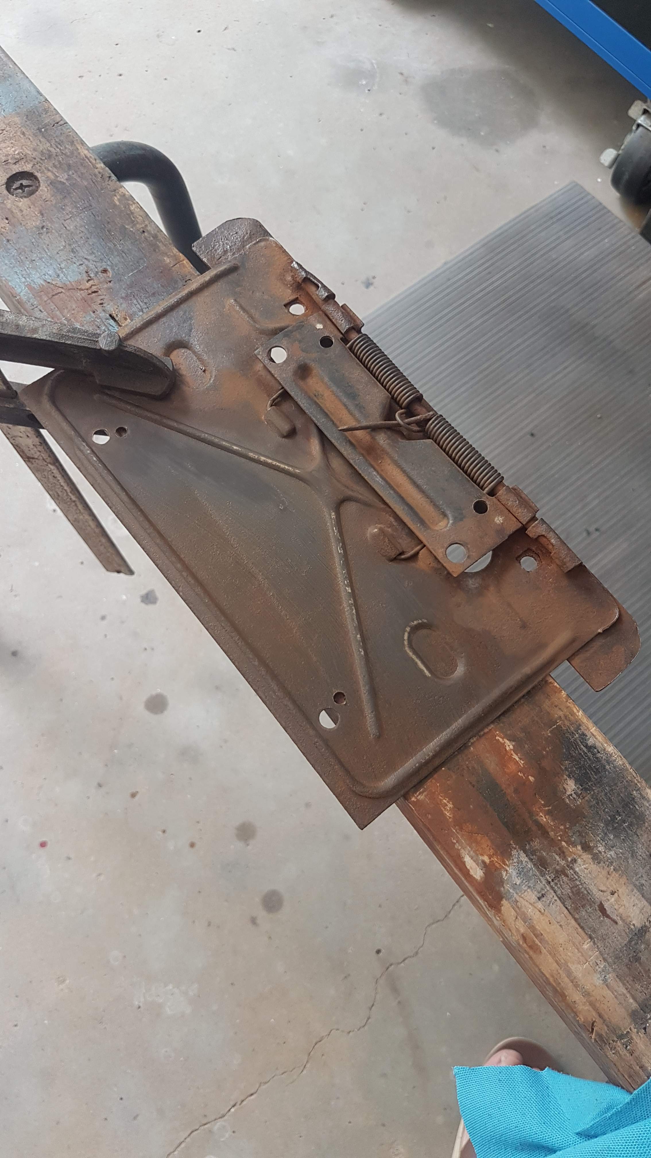

I have fuelled the car twice since we got back (20 litres, then another 20 today) and it finally struck me how crappy my fuel filler flap was. It's rusty and creaks and carries on every time I open it so today was the day I removed it, wirebrushed, sanded, straightened and painted it. I straightened it with my press (again - highly recommended) and will grease the hinge upon refitment.
Because of Andy, I also paid extra attention to my number plate frames and polished them up! I waxed the entire car yesterday and it came up a treat.

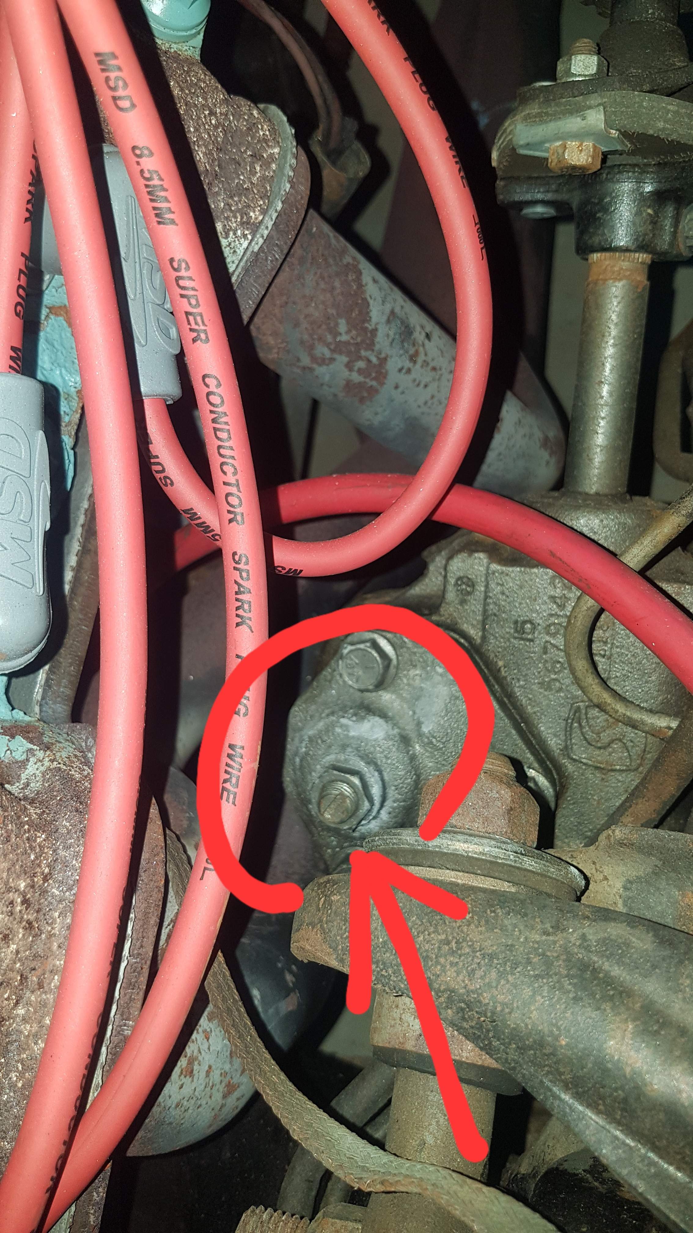

When I caught up with Kiwi I mentioned that although my front end and all steering components have been replaced there is still some play. He suggested adjusting the steering box. It's a reco box and I assumed the adjustment would have been done prior to shipping. I loosened the nut and tightened the screw - it was really loose and I think I might have fixed it. Will test drive tomorrow.

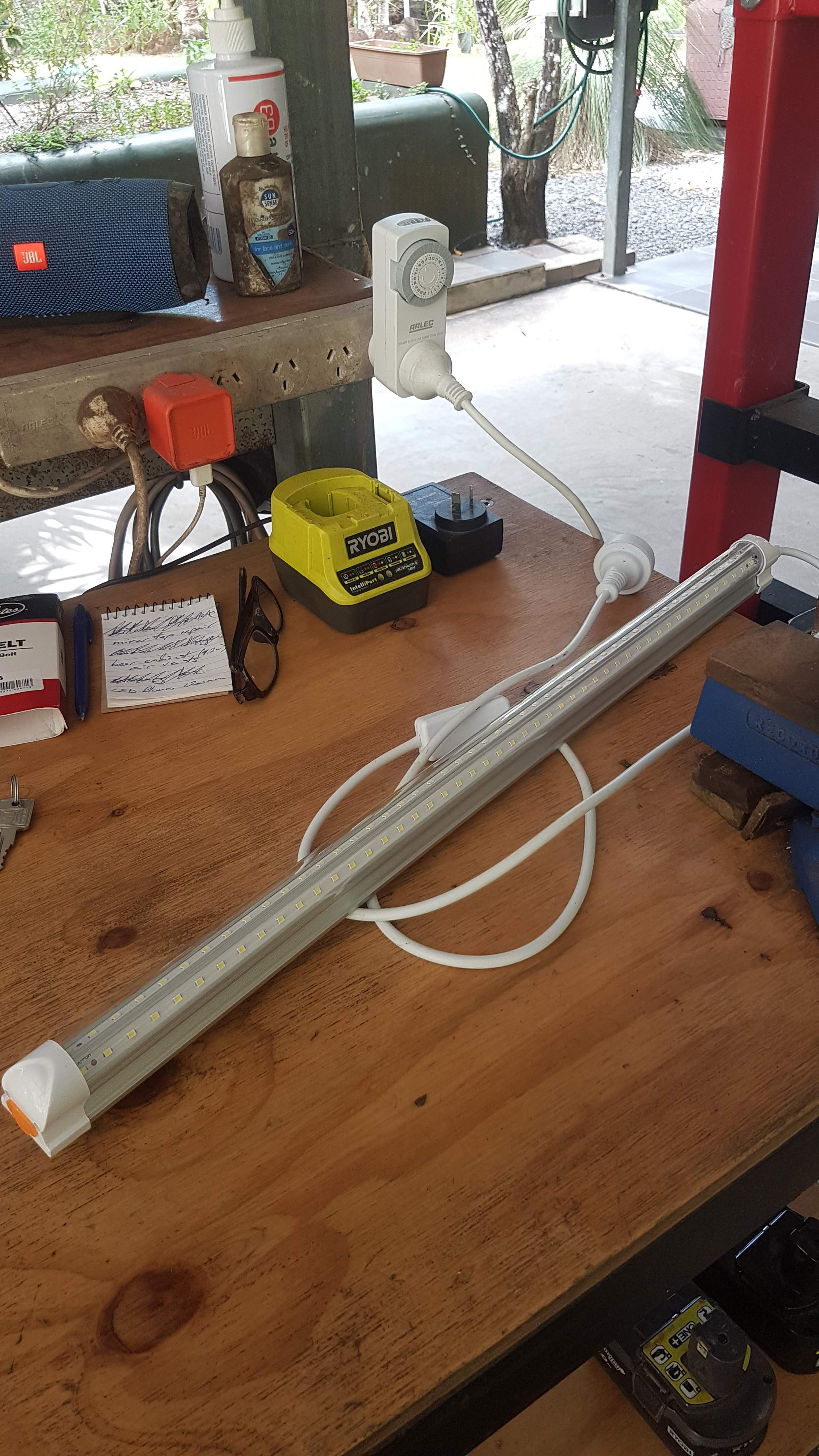

Last thing: remember my rodent issues? Haven't seen one for over a year but bought a portable LED light and hooked it to a timer - through the night the engine bay is lit. Just a tip for anyone else who might have such issues.

Good job on that adjustment mate 👍
my other thought is to get someone to move the steering wheel back n forth while you inspect every joint on that steering system :cheers: cheers to the beers
Is the light for the rats ? So they can see what they are chewing :rofl:
Can you come over and move the steering wheel for me? I don't have any friends.
I was going to light some candles, supply mood music and some menus to give the rats a dining 'experience.'
Tonight's Selection: silicone ignition leads, battery casing, assorted electrical wires and for the brave ones, the 240V cord that feeds the light. Mmm...zappy!
