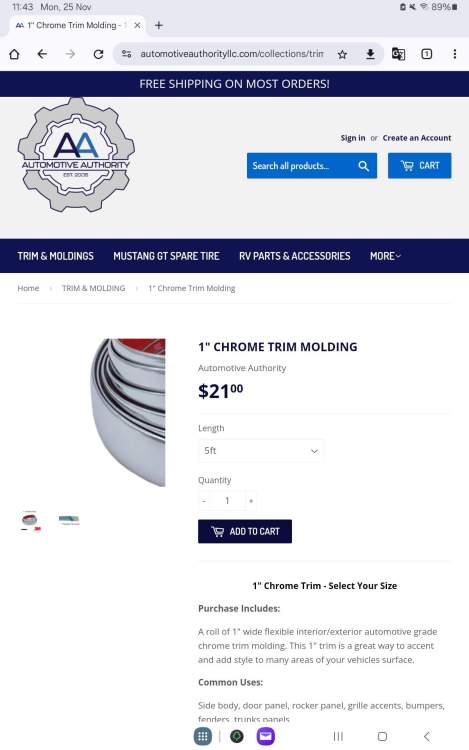

I ordered 10 feet (feet??? About 3m) of 1" wide universal chrome moulding this morning. That's going to be an interesting little job to fit, I'm sure. After Frosty's declaration of "it should only take 10 mins to fit" regarding his shift doodelacky I am NOT going to say that it should be a quick & easy fit. It's going to be a series of intricate cuts and melding together of individual pieces that have to follow the contours of the rear wheel arches. The stuff is self adhesive but I'm planning on reinforcing it with some stainless trim screws as well. The postage was as much as the damn product. If they send it via USPS, it'll be here by Christmas 2025. If it's via DHL, it'll be here next week.

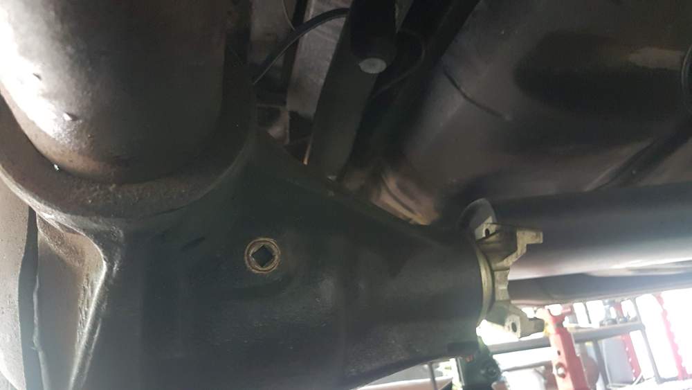

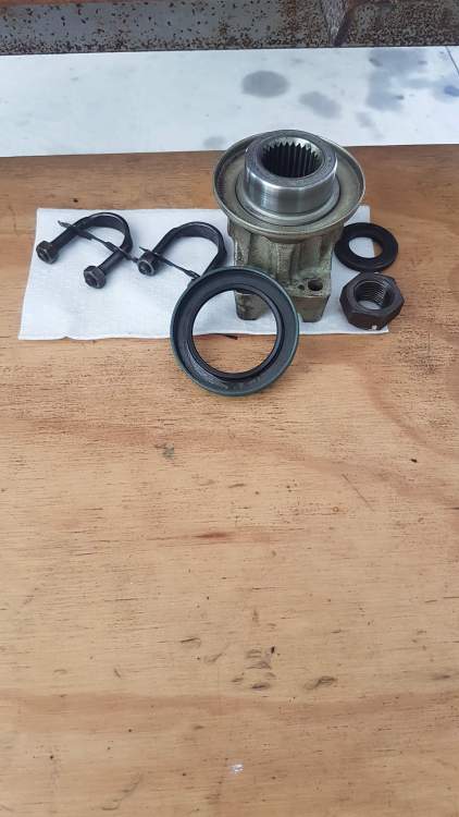

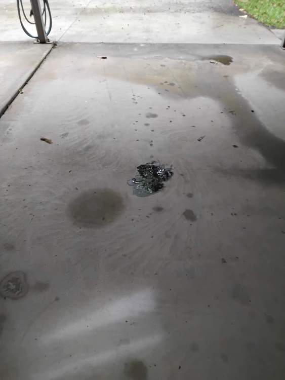

Don't you just love old cars? Today I took the Pontiac to catch up with my local mechanic on something unrelated and ended up spending a couple of hours with him assisting with the installation of a new Landcruiser diesel V8. The cost of a reman Cruiser V8 long motor is about $18k! I casually mentioned that one day I will sell both of my dinosaurs and treat myself to a new Isuzu DMax. He then showed me the inlet ports of the old 300k km Cruiser motor. Totally clagged with a mixture of soot & oil - a result of the mandatory EGR system that all modern diesels have to have. He said combine that with the mandatory DPF that all modern diesels must also have and unless you spend considerable dollars getting a top end clean every 50k km, that buildup will eventually kill the engine. He said he'd never touch a modern diesel. Some food for thought for anyone (including myself) who was thinking of a modern diesel.
Anyway, after assisting with the engine bolt in I drove the GP home and parked it. I then walked around to open the trunk and saw a series of oil drips that followed the car. I KNOW my nice new engine doesn't leak a drop. I peer under the car to see diff oil dripping quickly onto the concrete. The rear cover plate is dry & clean and has a new gasket fitted, so it has to be the pinion seal. Apparently, they can let go with little notice. So...guess what tomorrow's job is?
I have ordered a new cover gasket and seal which were cheap (Rockauto, of course) but the freight was almost exactly twice as much as the parts. I wonder how Trump's new trade tariffs are going to affect stuff being shipped FROM the States?
I can't drive the car anyway because the rain is on & off all day, so I shall sit it on jackstands and prepare it for it's new part.
The pic is a present left for me by the car. Incontinence will get us all one day. All the other little spots are from my ute which incidentally no longer leaks oil.

I feel for you mate 🙄

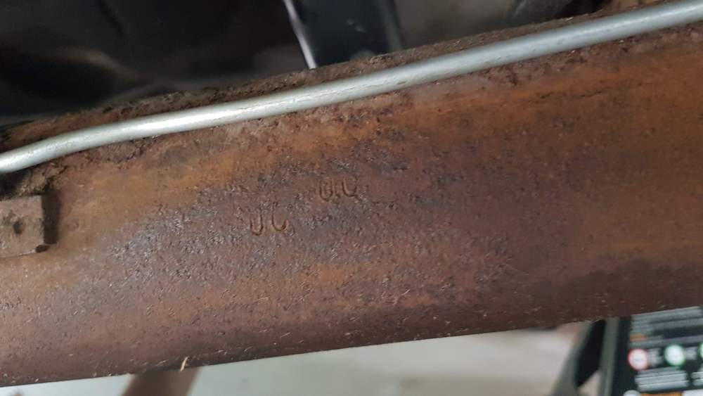

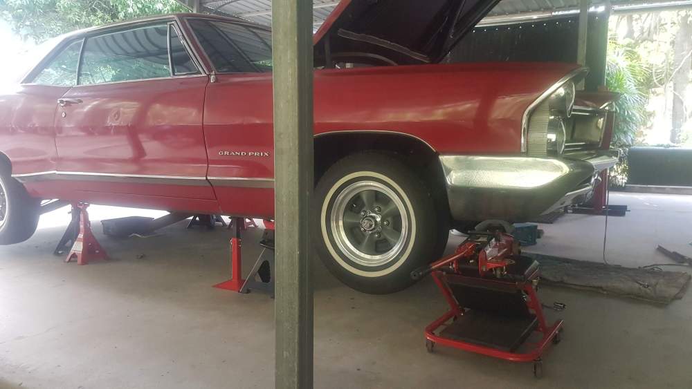

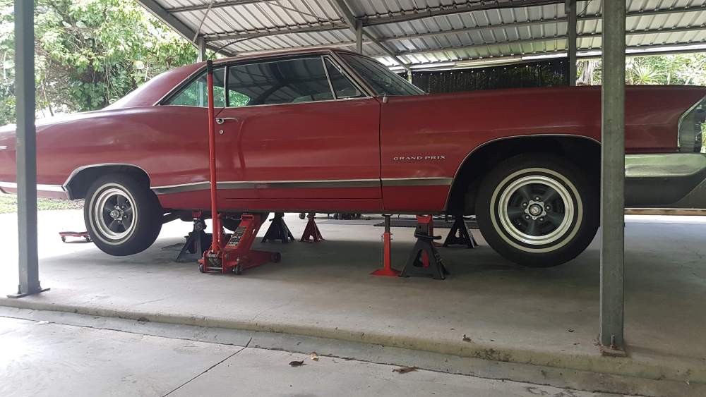

A productive day today. I sat the car on 4 x 4 ton jackstands with an extra 4 smaller ones as a redundancy. I also pumped the trolley jack up and sat it under a chassis rail in case the unthinkable happened and had my mobile close by in case I had to call someone to get the damn car off me! Prop shaft U bolts out, lowered the shaft and borrowed a 1 and a 1/4" socket (fhe ONLY socket I don't have...yet.) Using a rattle gun the pinion flange nut came off easily. I also had to rattle gun the oil filler plug on the side of the diff housing - man, it was tight. Removed the flange & seal. The seal looks to be in perfect condition - even the flange surface has no apparent wear. As I was dismantling everything, I noticed diff oil was dripping from where the edge of the seal sits in the flange. It almost fell out which means whoever installed it didn't apply sealer around it's periphery. I asked my mechanic about it and he said the seal comes with a special coating which is supposed to be a sealing material. Well, it didn't!
I took a pic of the factory diff ratio markings (for 1965 - others should be similar to a point) for anyone who might not be aware. There are 2 letters stamped on the RH axle housing near the centre. U means an open diff, V is a LSD, and in my case C means 2.73 ratio.
Whilst the car is up in the air I did a thorough check of everything underneath and it all looks good. I span each suspended wheel and noticed some brake adjustment anomalies - in particular the rears are dragging a bit too much and the RH front has too much free play. I'm going to dismantle & clean each brake and may as well paint the drums whilst I'm fiddling about.
Last thing was to readjust the front bumper to body clearance. This was a niggling little issue that caught my eye every time I walked past the car, so as you can see in the pic I rigged up an 'adjustable stand' to hold the bumper in the correct position as I tightened the 4 big bolts that support it to the chassis. If you ever do this job, the passenger side rearmost bolt has to be accessed from within the engine bay. You will swear - I did.
Nice work mate.  Overkill on jackstands is always good.  If the thing comes down on ya, needs to be done right so your not left wounded N suffering. :willy_nilly:
:rofl:…..and he did this all in 5 minutes!!! :cheers:
When I die I want it to be quick and NOT being slowly squeezed to death under 2 tons of car. I never like getting under that thing but if I have to, then lotsa very heavy duty jackstands is the way to go. I still remember your cinder block episode...it just doesn't bear thinking about what could have happened to you.

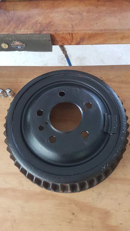

With the front bumper now looking MUCH better I decided to do the same with the rear. Unfortunately at some time in the car's life it must have been hit on the driver's rear quarter corner. I loosened the 4 bolts and mucked around with it. It's better but not by as much as the front. It'll do - nobody is going to notice except me and you guys.

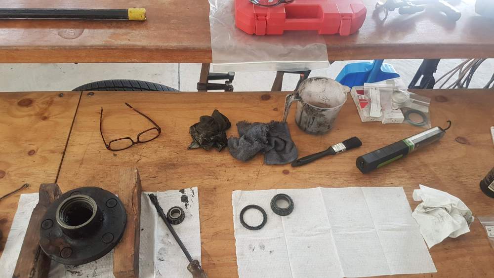

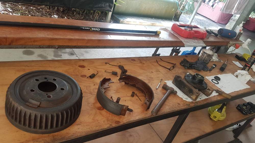

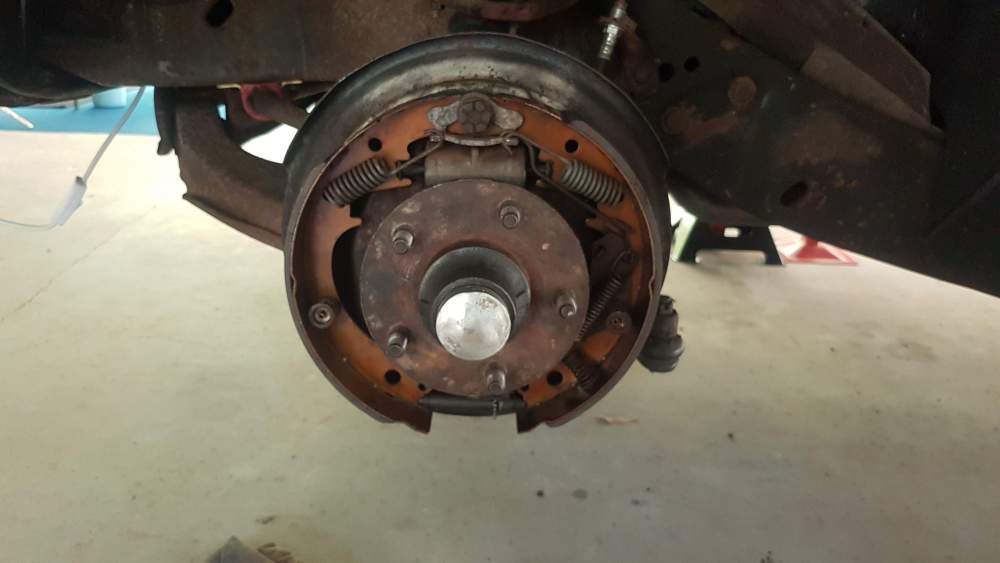

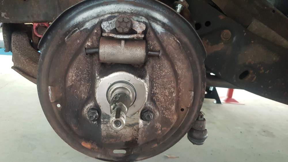

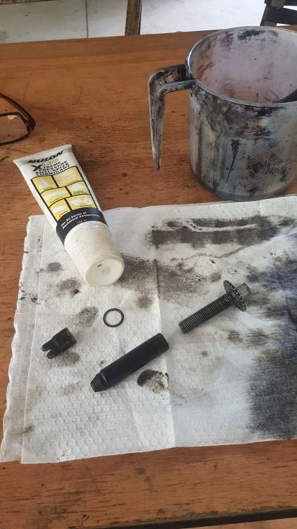

Then it was Brake Time. Would you believe that I had the fanciful notion that I would get through all 4 brakes in one day? I managed ONE and even then I'll need parts. I started with the LH front. It was pretty grubby in there so I took everything out and then noticed the bearing grease seal must be shot. I also saw some worrying rust on the wheel cylinder arm that sits against the shoe. Took off the hub and inspected the Timken bearings. They seem to be perfect and as Rick has pointed out, probably better quality than the new ones I have. I just happened to have a front wheel bearing kit. I decided to retain the old bearings but replaced the seal, castellated nut, washer, split pin & hub cover.
I ordered 4 new wheel cylinders from Rockauto and will just do the lot one at a time next time I'm home - cheap insurance. I painted the outside of the drum and here's a good one: the self adjusting star wheel mechanism...it was NEVER going to self adjust! I had to grip the body in a vise and with much effort unscrewed the shaft. Soaked it in kero and after cleaning everything up applied some leftover engine assembly lube to the threaded shaft and now it spins in & out very easily. It's such a simple mechanism but depends solely on the star wheel being able to move easily. I have done the same repair to another car and it worked a treat.

Good luck with the rock auto slave cylinders mate . When I orders mine the turned up
looked perfect but had the wrongway thread for my factory hoses !!!!!!
Hmm...all my flex hoses are new. I can only hope they fit. If not, it'll be yet another order to Ames.
