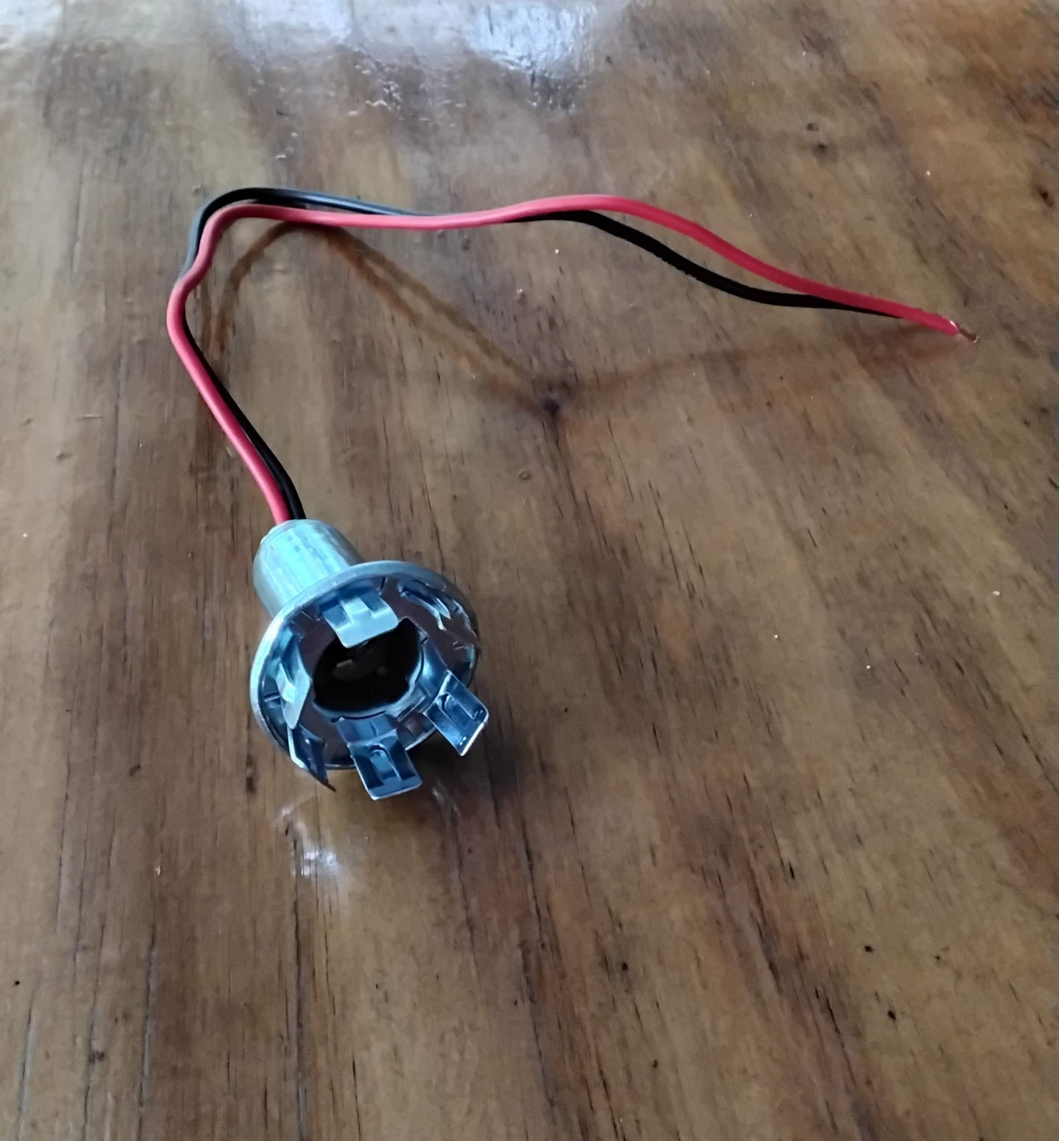

On 4/28/2025 at 8:29 AM, Fitzy said:
How did you make them stay in place? I tried to splay out the plastic tangs and also prised apart the metal ones and nothing worked. I was on the cusp of securing them with a self tapper when common sense returned and I searched for metal pronged snap in ones. They were only 5 bucks each.
Pretty much exactly that - splayed them a bit, then put them in a little off-centre & literally screwed them in ½ turn-ish.
Bam...still there 🤙
Nice work. I also managed to secure mine in place but all it took was 500m of dirt road and one fell out.
I will be sure to post full details of the new ones, as a public service.

So I am now getting some simple little jobs ready to keep me busy. My new stop/tail bulb holders arrived today. It's not exciting nor sexy but it's a start. I did a test fit and they snap in nicely and defo won't fall out but there's the slightest bit of wriggle room whilst they are in place so I may have to bend those tangs out ever so slightly.
use solder mate !! dont bother with those things you used on the engine wiring ..
twist, solder heat shrink ! perminate !

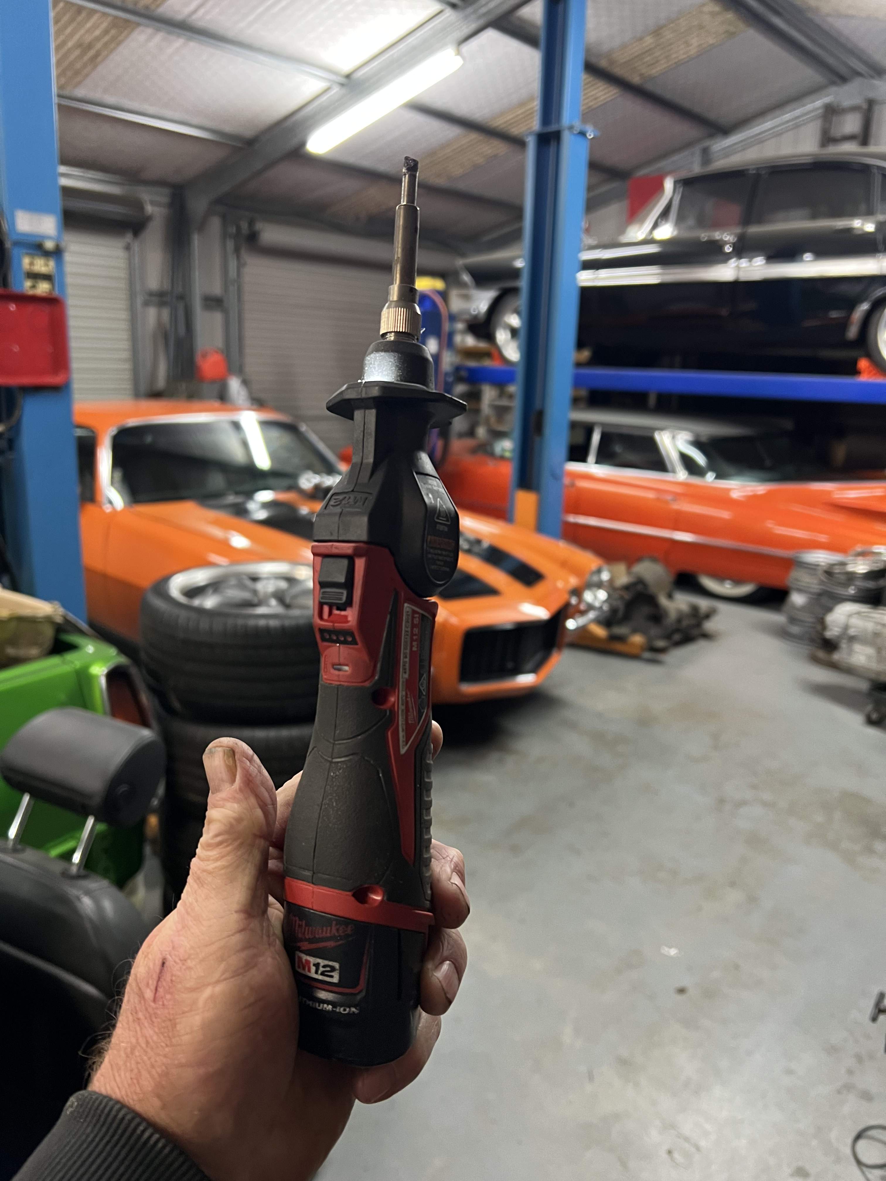

 i should introduce you to my little friend :naughty:...
mr milwaukee  makes a m12 soldering iron that is justA sooooo easy to use !
this sound dumb, but if the fit on those socket tabs is sloppy , tin them and add solder
it will build up each tab just a few thou.
Thats a cool tool Kiwi, I still have to drag an extension cord out to the car when I solder :rofl:

i did to mate !!! it sucked!!
... what do they say, work smarter not harder :cheers:

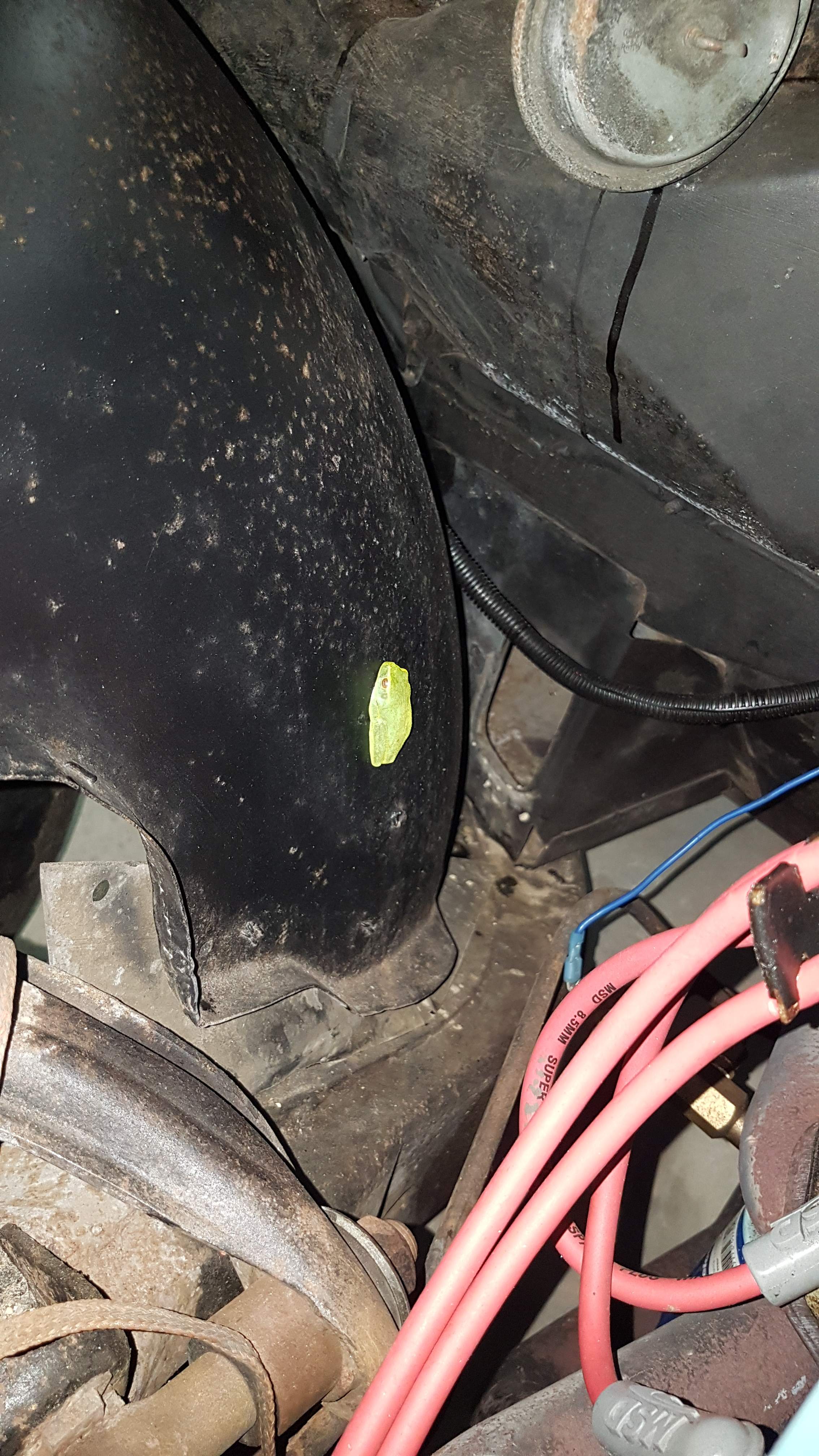

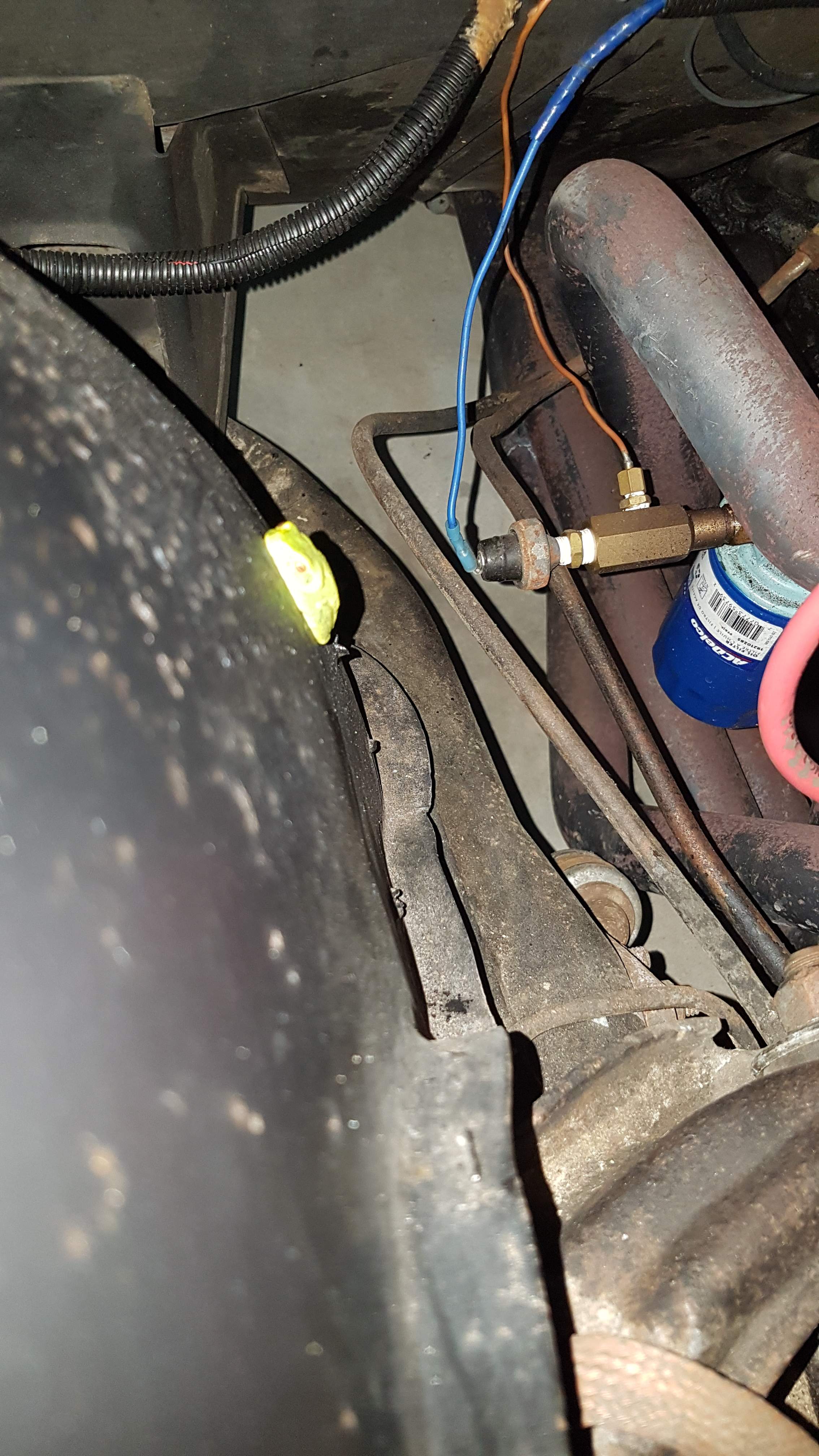

We've had a lot of rain lately and the joint is moist & tropical. I had to move the GP today and popped the hood first as I always do and found a new engine bay resident.  A green tree frog - well he's now the lesser spotted red Pontiac frog but whatevs.
He's toadally awesome...sorry - that's the only frog related gag I could come up with. Good thing he's not on the starter croaker. Don't make me rebbit myself.
