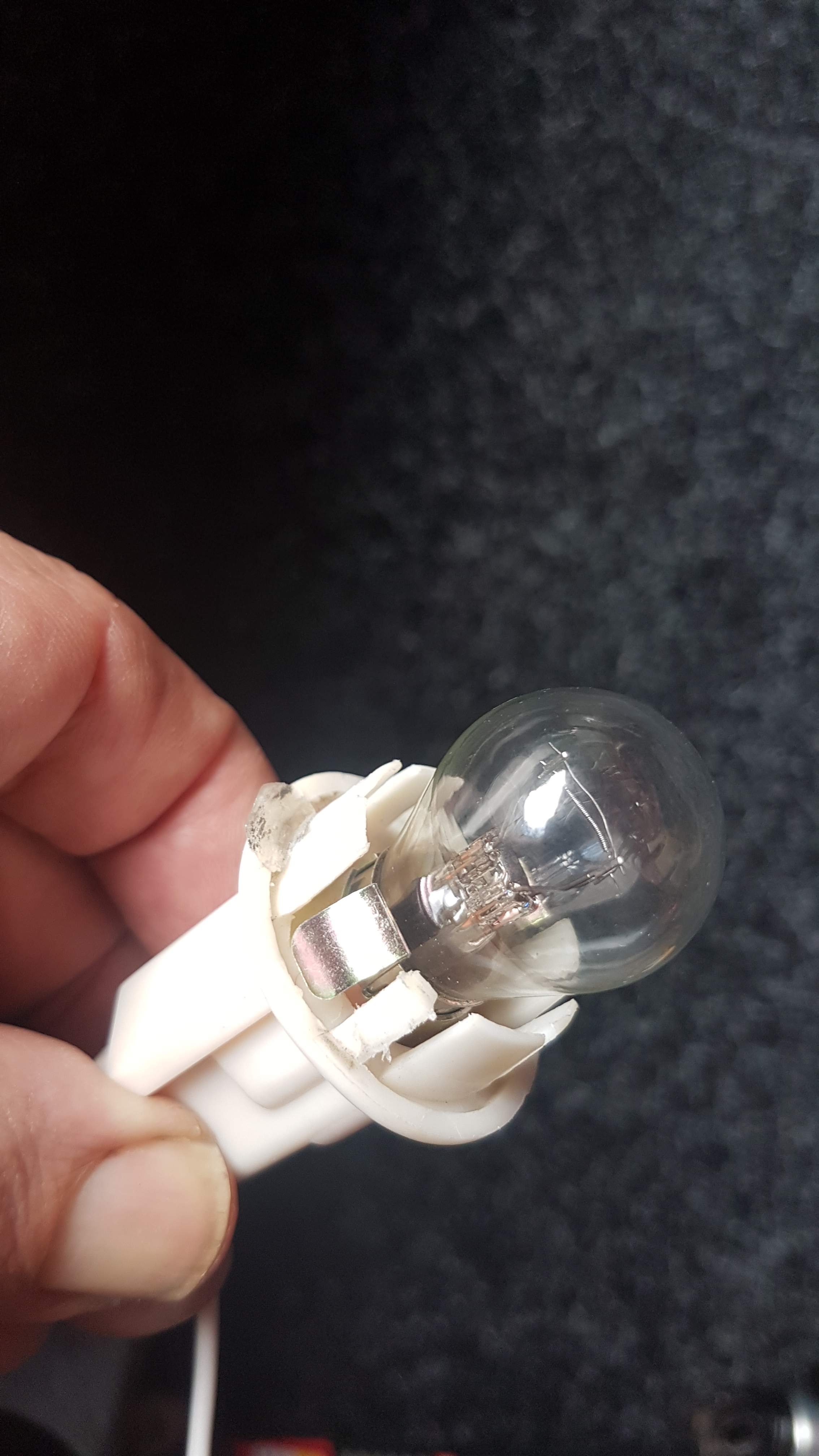

Took GP out for it's customary fortnightly exercise and indicated to turn right and indicator blinked once and that was that. Pulled up and inspected my CRAPPY Ames sourced replacement stop/tail bulb holders to see if they were still sitting where they should be. They have popped out before and are cheap rubbish. No, they were intact so I turned around and of course had to turn right twice more before I could sheepishly get home. You need to remember that turning right in Australia is across traffic, ie. the equivalent of a left turn in Trumpville. I knew it was something simple and tested the offending bulb. Sure enough, even though both filaments looked intact the 'stop' one was not. New bulb and everything's Archie. Now, as we all know, the usual clue as to a failed indicator bulb is faster than usual flashing on that side but I have combo LED park/indicator bulbs up front. The front bulb was lit but not flashing - so a different symptom to the same issue. I have had enough of the crummy plastic bulb holders that Ames supplied and have just ordered 2 metal ones with spring clips that snap into place, just like the originals when things were still made of metal. The Ames ones are encircled with plastic tangs that do bugger all.
I provide this lengthy story so as to assist others - rear bulbs get a good shaking about as the car trundles around and they need to snap snugly into place. Do not be tempted by the plastic ones - go metal.
Whew! Just be thankful I wasn't writing about a more serious issue. That would have been 3 more pages of drivel.

Good advice, but after working really hard to jam my plastic ones in tight after replacing my globes I think I'll wait until they fail before changing them 🤣

How did you make them stay in place? I tried to splay out the plastic tangs and also prised apart the metal ones and nothing worked. I was on the cusp of securing them with a self tapper when common sense returned and I searched for metal pronged snap in ones. They were only 5 bucks each.

Can't keep mine in place in the GTO.
