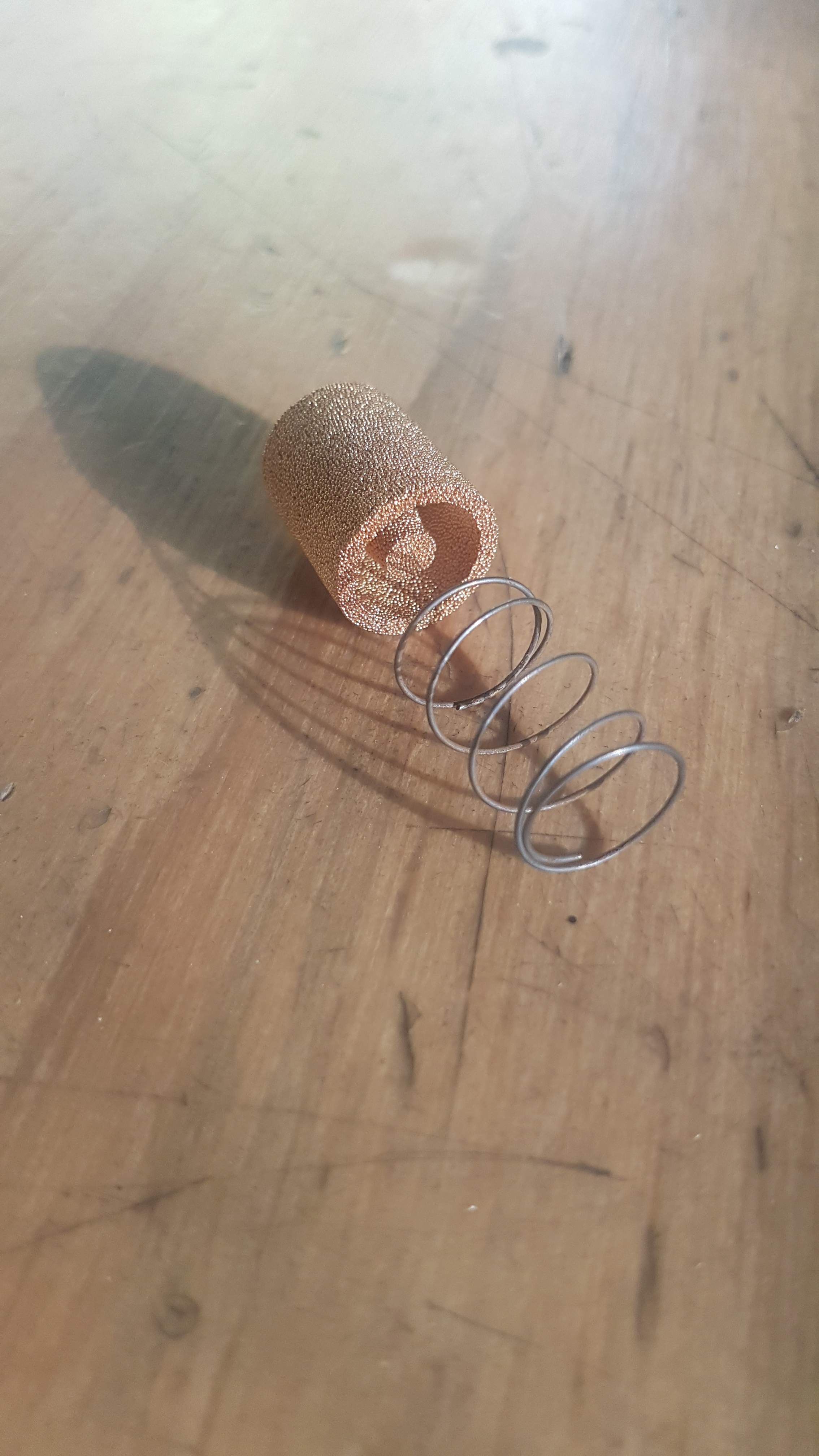

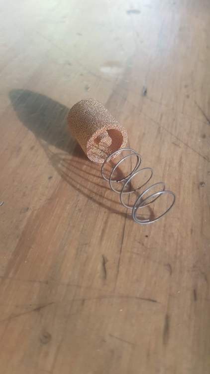

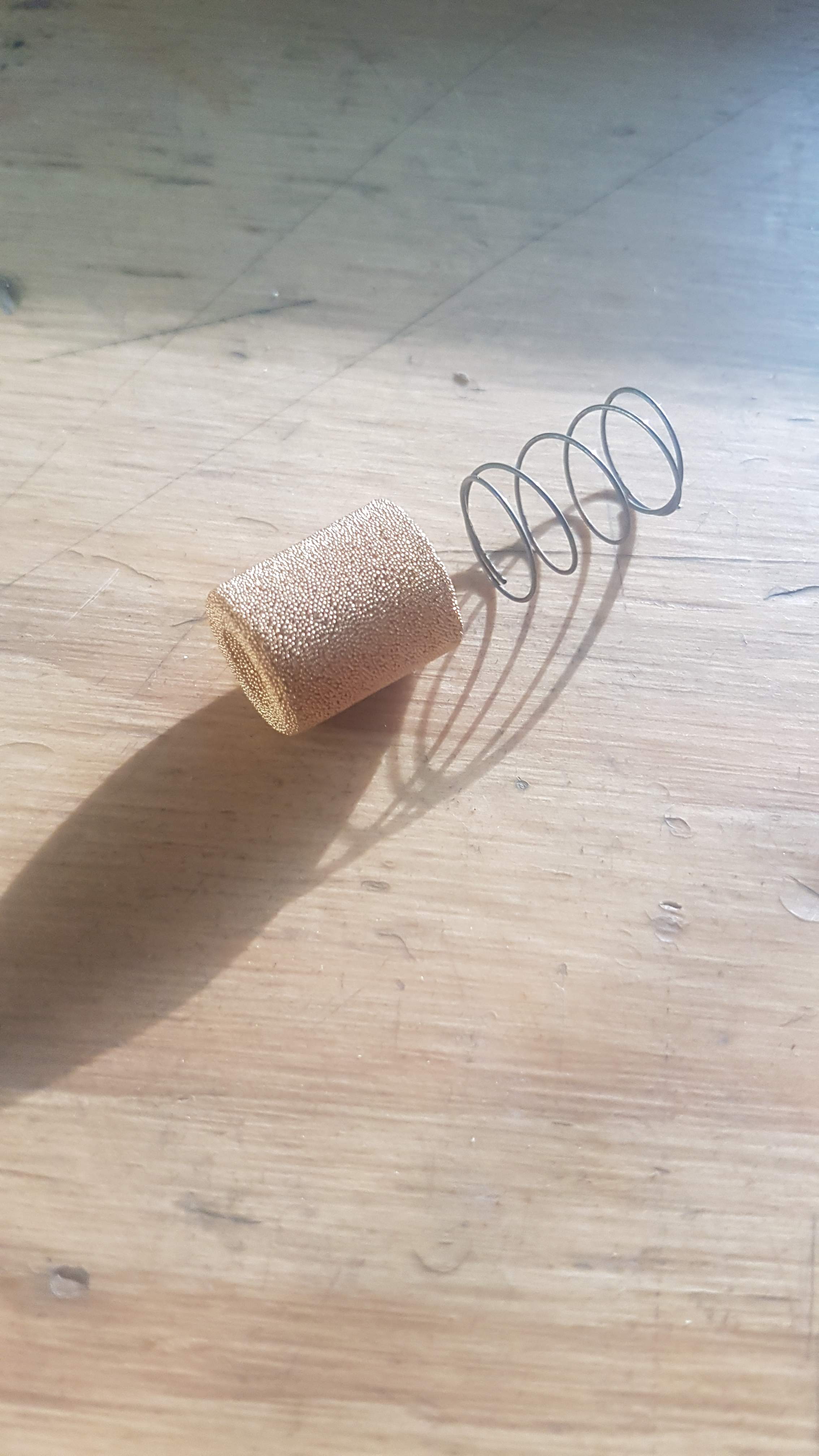

Got talking to an Old Skool mechanic who lives about 10km away. He's retired but now works from home and his reputation is legendary. I introduced myself and told him about the car. We chatted for the best part of half an hour and he bombarded me with questions. His conclusion (without even seeing the car) was that if the points AND electronic systems produced the same symptoms it's gotta be fuel. This was a conclusion I had already come to at 3am the previous morning. Why waste time sleeping?
He said to check the fuel pump (it's new) whether there was a healthy squirt of fuel from the accelerator pump (there was) and to check the gauze filter that sits in the Carter inlet. I know what you're thinking: this is all obvious fundamental stuff and I had already done those basic checks BUT I never checked the gauze filter. I removed it and it's brand new from the carb rebuild. I blew through it. Whew! That was tough. I turned it around and blew again - even tougher. I then wondered if this was impeding the flow of fuel so much that the carb was starving. Besides that, I already have a disposable inline filter between the pump & carb inlet - the gauze seems unnecessary. I removed it, replaced the inlet and drove the car. Fixed! No more carry on and plenty of power on tap. It needs a highway drive to properly test it so early days yet.

Glad you found the problem. I am surprised that you had a problem with that one. I've had good luck with these fuel filters. Of course, I try to buy old AC NOS stock, I try to avoid the new stuff. Again I am biased.
You know Frosty, I put that thing to my mouth again today and could hardly blow through it. I held it up to the sun and no light was getting through. Surely, these mesh filters are an old fashioned hangover from the past before plastic inline filters were commonplace. I see no reason why the carb rebuilder deemed it necessary to install the damn thing, unless it 'tempers' the fuel pump's outlet pressure, but I would think the simple needle & float will overcome that pressure to prevent flooding.
More to the point, I can't understand why it's apparently blocked. It appears to be of immensely dense & fine porous material, but I reckon if I suspended it above a container and carefully poured some petrol into the top, none would make it through.
Whatever - it's out of the carb and is staying out.
